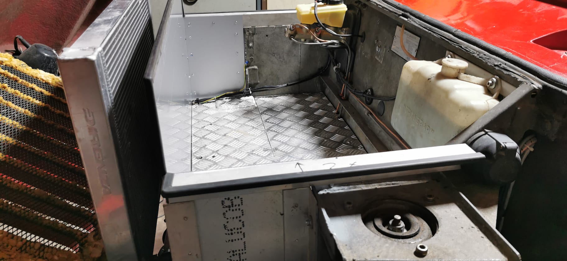

this is the parts i used
over size radiator for summer temps passive no fan, 3 way bypast and heated in winter.
temp controlled using a PLC

snelly wrote: Fri Dec 06, 2024 11:59 am this is the parts i used
Nicely done!
I would recommend you use Fiat 500 Siecento radiator. It is much smaller in height and size and is plentiful for summer.
I recognized the greatest source of heat is actually charger when car is stationary. This is the only reason to keep a cooling fan.

thanks I understand, so far only seen a plus 2deg rise over summer outside temps, but only using granny charger :-]
