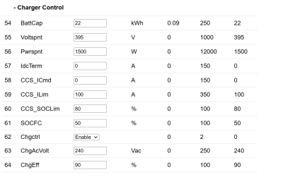

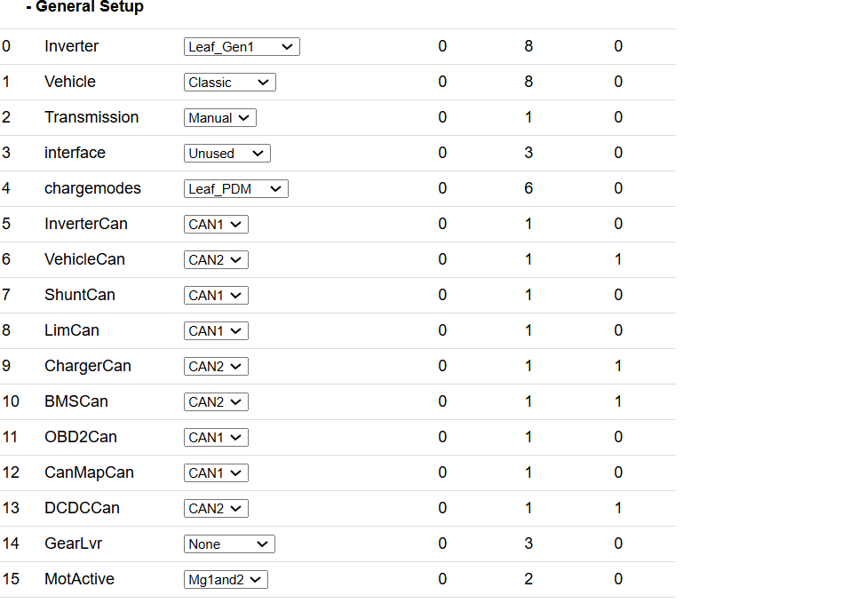

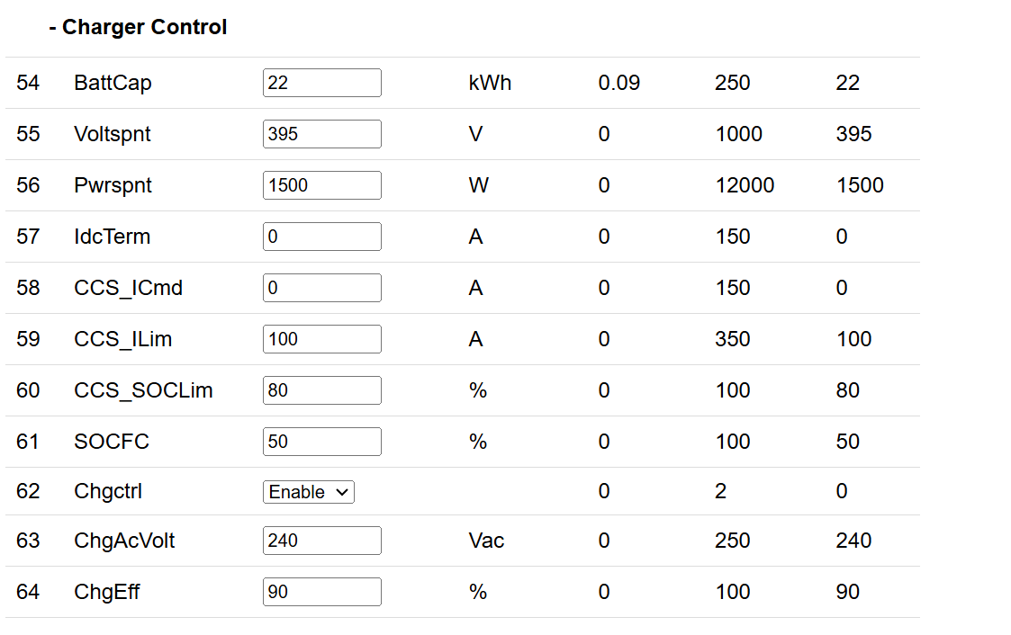

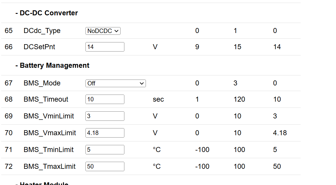

I’m using a 2015 Nissan Leaf (EM57 motor, inverter, and 3.6kW PDM) along with a Zombieverter running the latest release (2.17A). The motor, inverter, and DC-to-DC converter are all functioning properly. However, I’m encountering an issue when trying to charge the battery.
The PP and CP lines are correctly connected. When I plug in the Type 1 charging cable, the contactors click, and the VCU switches to charge mode. However, when I measure the current going to the battery, it only shows 0.05A, indicating that no power is being delivered by the PDM.

Below are screen shots of the parameters of the vcu, incase you need more please let me know
Been thanked: 1914 times
Re: zombieverter firmware with working charging (Leaf PDM)
Better than screenshot is this (Download Parameter File):
or the result of http://192.168.4.1/cmd?cmd=json as a text file attachment

maiks wrote: Thu Nov 07, 2024 5:26 pm I’m using a 2015 Nissan Leaf (EM57 motor, inverter, and 3.6kW PDM) along with a Zombieverter running the latest release (2.17A).
Fix is incoming with the next release that is currently undertest. Turned out there was a message missing in charge mode.
