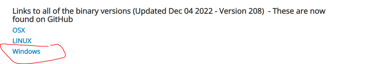

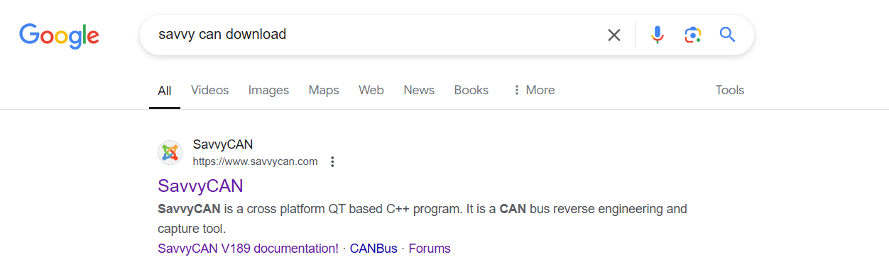

I have tried to post pictures but, I cannot. I have also tried to download SavvyCAN but, I have yet to find where to down load the program . All the sites I look at seem to be for computer experts that know their way around computer systems
Posts: 2762
Location: Bristol
Has thanked: 265 times
Been thanked: 721 times
Re: Deleting canbus modules
Falcemach1 wrote: Wed Nov 06, 2024 5:35 am sites I look at seem to be for computer experts that know their way around computer systems
Let me help you out.
If you fall at this hurdle buckle up, the learning curve is STEEP
