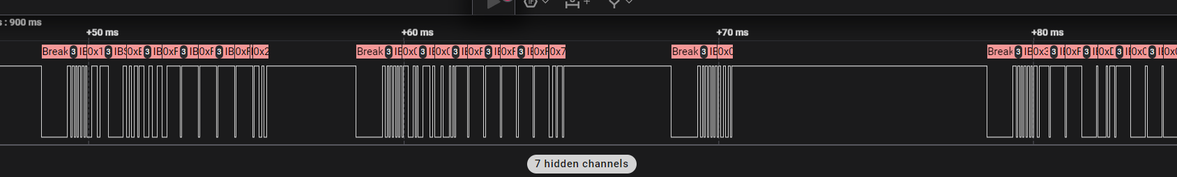

Surprisingly I do see ID 0x07 (PID 0x47) which is indicated as the command from the info above.
However the response from the compressor, which should be ID 0x09 (PID 0x49) seems to be missing and very poor. How did you make the connection for logging? As I would not expect this on the bench it is very stable for me.

- Posts: 2962
- Has thanked: 328 times
- Been thanked: 847 times
Re: Nissan Leaf ZE1 AC compressor LIN
That be super, I have no clue why ID 0x09 is so random and inconsistent in nature. It varies in length and even has times where it not responds, all of which is very much unlike LIN bus.

- Posts: 2962
Nope all other IDs and the waveforms match, this is why it is wierd.
The one with just the data request and id 0x09 us the short burst

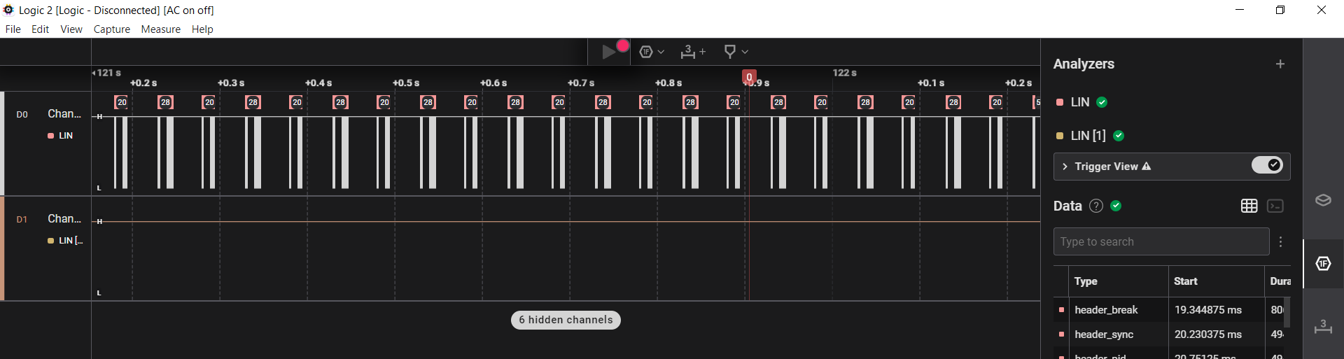

Here are another set of captures. 0x09 looks a little better in these to me?
To note - it sounds like the compressor is slowing down towards the end of these.

- Posts: 2962
Unfortunately not
I have been playing back more and more info from your logs but it all does not seem to matter. Possibly my Compressor is dead?
My AC compress shows the following:
|ID: 49- Data 0:0:C1:0:60:0:87:54:- Check: B8
Where C1 is the voltage of 386V, your screenshot shows mostly zeros except the end. Is this an indication there might be an issue with my AC compressor?
Mind sharing any more information you have on this?
