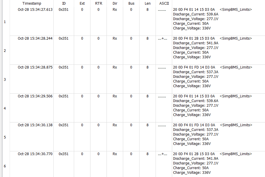

Re: (SDU, OI board) control of derating via CAN, from BMS
How do you find the drive performing with dynamic idcmax/idcmin at 48ms repetition?
I tried mine last night setting idcmax dynamically per BMS and I would sometimes get the drive to studder when I'd accel.
Theories:
1. Need to increase the frequency of BMS update - currently ~600ms (default BMS)
2. During discharge current derating I receive decimal values, not sure if SDU cares.
3. During discharge current derating BMS values derates almost linearly, i.e they sometimes dance +/- around the value, not sure if SDU cares.
My setup from SimpBMS on the SDU custom CAN message
Sample reading on the can bus for the BMS discharge current.
Theories:
can rx idcmax 849 32 16 0.1
- Posts: 6768
- Has thanked: 383 times
- Been thanked: 1589 times
v5.35.R has the parameter "idcflt" that low pass filters DC current before feeding it into the derater. This should make derating smoother.
