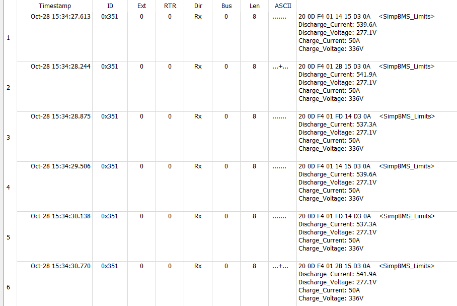

How do you find the drive performing with dynamic idcmax/idcmin at 48ms repetition?
I tried mine last night setting idcmax dynamically per BMS and I would sometimes get the drive to studder when I'd accel.
Theories:
1. Need to increase the frequency of BMS update - currently ~600ms (default BMS)
2. During discharge current derating I receive decimal values, not sure if SDU cares.
3. During discharge current derating BMS values derates almost linearly, i.e they sometimes dance +/- around the value, not sure if SDU cares.
My setup from SimpBMS on the SDU custom CAN message
can rx idcmax 849 32 16 0.1
Sample reading on the can bus for the BMS discharge current.
Been thanked: 1918 times
Re: (SDU, OI board) control of derating via CAN, from BMS
v5.35.R has the parameter "idcflt" that low pass filters DC current before feeding it into the derater. This should make derating smoother.
