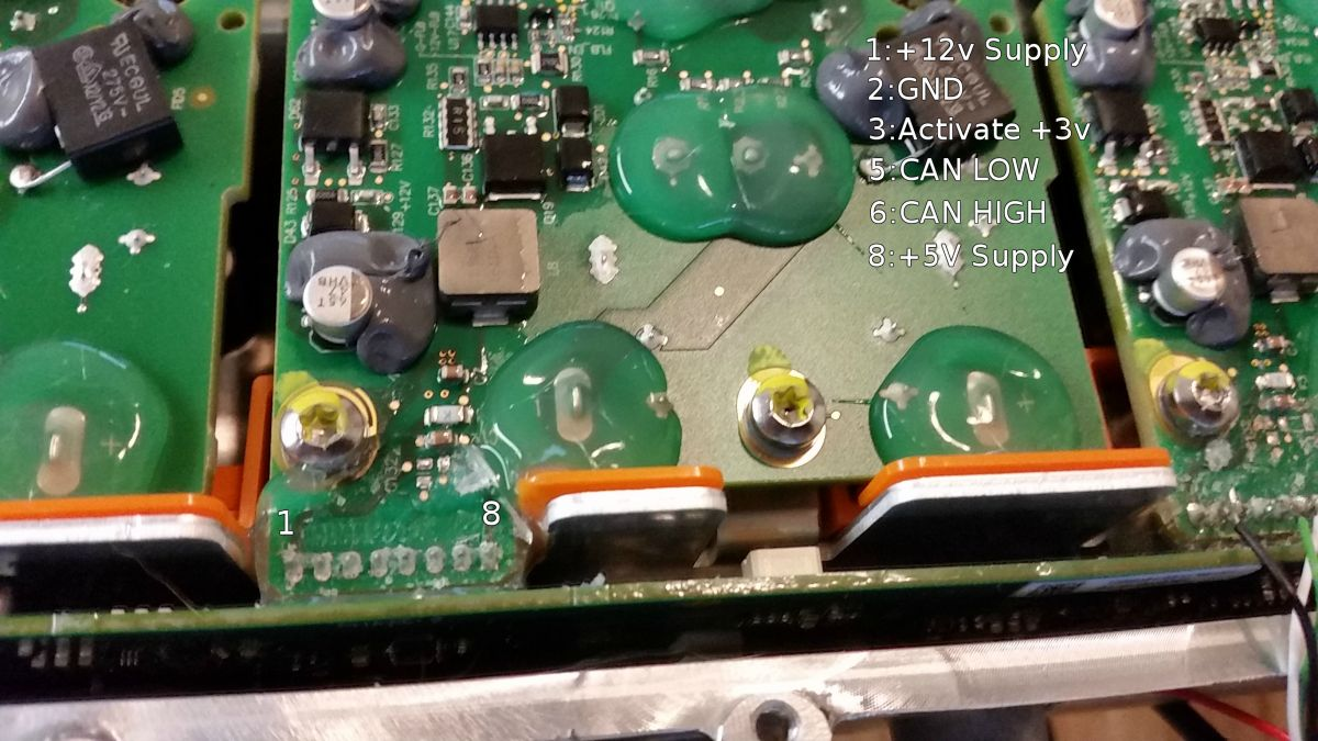

I measure 119.8 Ohms across the can terminals at each module board with the control board connected to the charger, but not powered up.

RobCote wrote: Thu Jul 11, 2024 1:52 pm I measure 119.8 Ohms across the can terminals at each module board with the control board connected to the charger, but not powered up.
Might not be an issue but please add 120 ohm the the last module in the series, as it can work like this but ideally needs 120 ohm on both ends.

No, please add a 120 ohm resistor across the module furthest down the wiring. This is just to be safe.
Have you measured to see if there are voltages at the pins as expected as per pinout? Do not worry about activate for now.

I'm a little unclear on how the resistor is installed. Does it bridge the CANL and CANH terminals, or is it inline with the wire coming into CANL or CANH terminal?

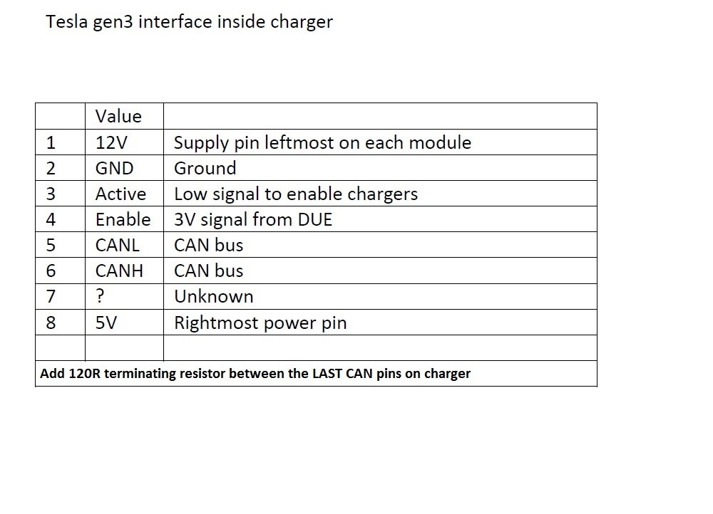

I've checked voltages at the charger module terminals. Here's what I measure (powered on, EVSE and HV battery connected):
- Pin 1: 11.3V
- Pin 2: 0.0V
- Pin 3: 42mV
- Pin 4: 48mV
- Pin 5: 1.39V
- Pin 6: 2.7V
- Pin 7: N/A
- Pin 8: 4.89V

120 ohm across/between CAN Low and CAN High on last module

As regards checking voltage at the module boards, I did that earlier:
- Pin 1: 11.3V
- Pin 2: 0.0V
- Pin 3: 42mV
- Pin 4: 48mV
- Pin 5: 1.39V
- Pin 6: 2.7V
- Pin 7: N/A
- Pin 8: 4.89V
It seems like there should be more than milivolts at pin 4 when the module is on, but I never see that occur. I don't know what it means in the table you posted where it says "3V signal from DUE".
