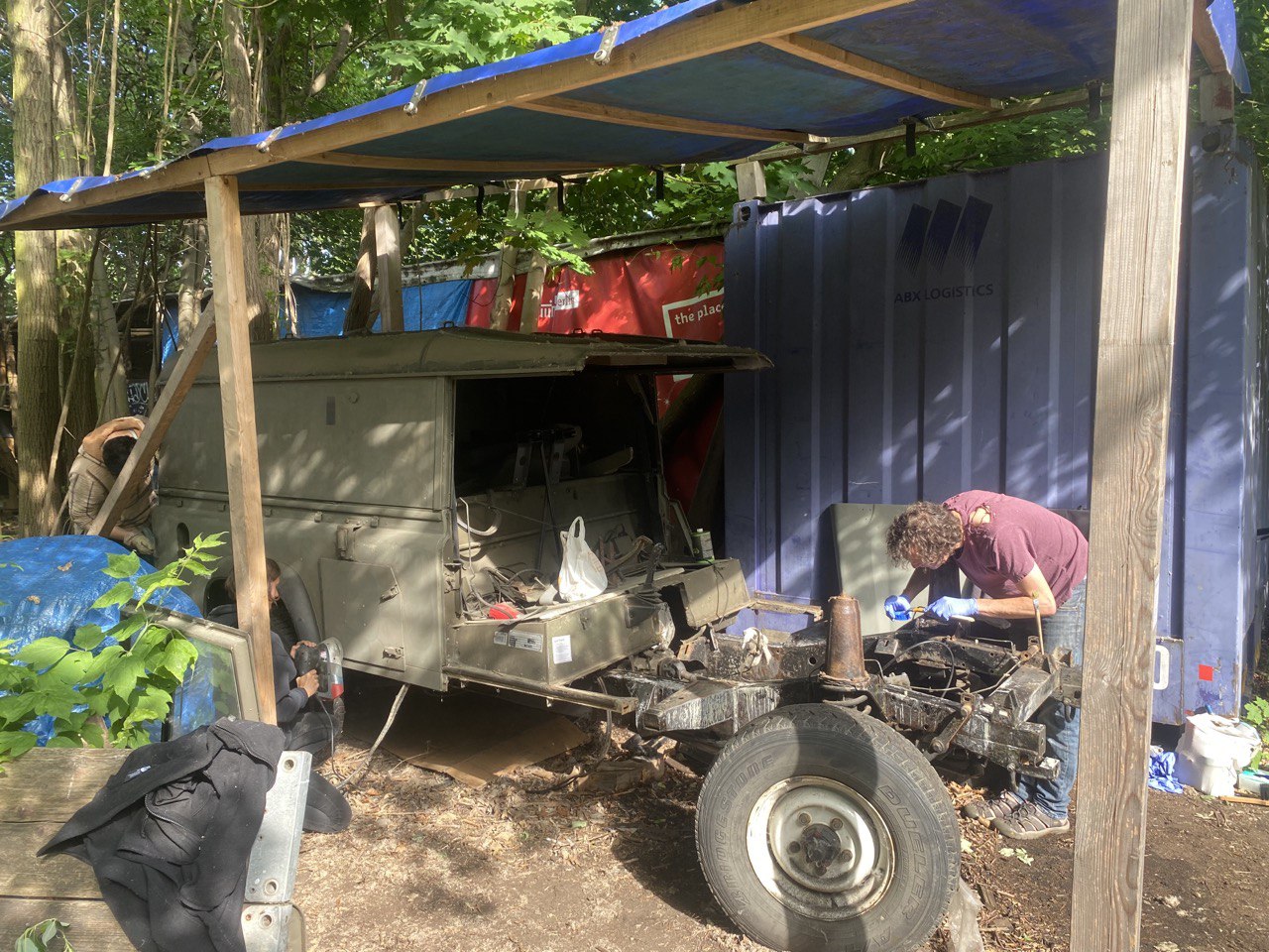

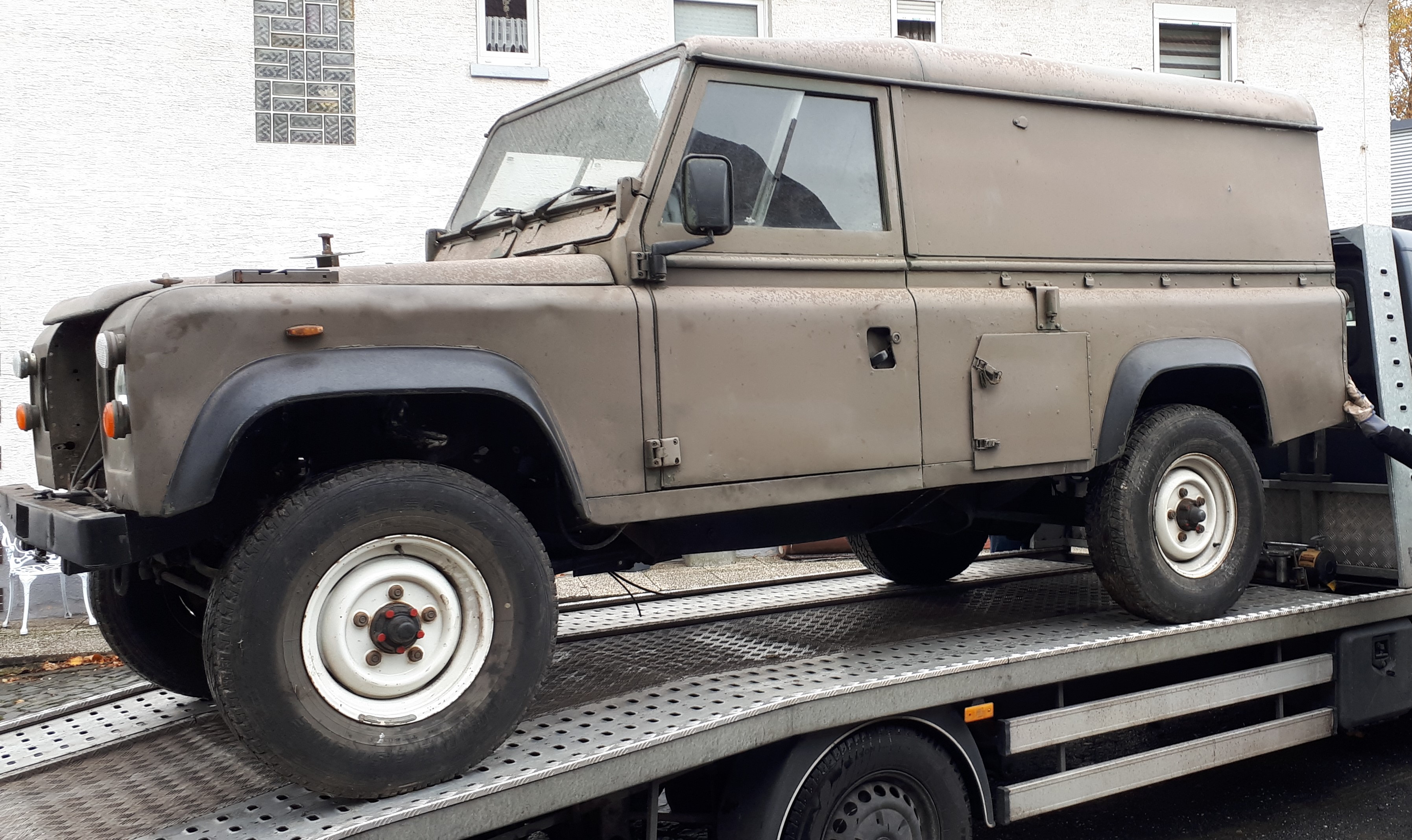

Vehicle: So, when I came back home and had earned some money, I bought a Land Rover Defender exMoD from 1988 (actually they called them simply "one ten" back then) with an engine issue and comparably few rust holes, following this community's first rule and having learned from previous projects.
(Turned out that I had to weld the whole bulkhead)

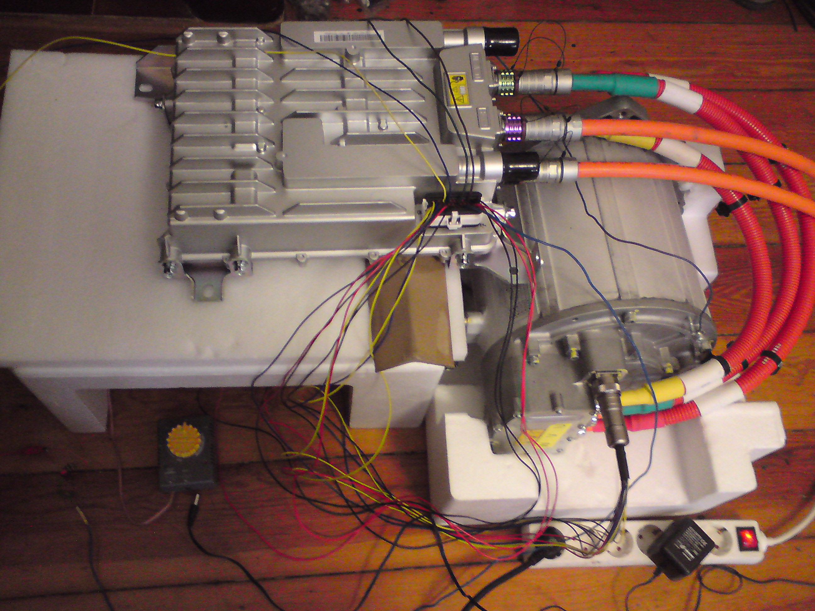

Motor: I also learned about the EV conversion community and the motor options available. I didn't find any suitable OEM motor - Tesla parts were absurdly expensive, the Leaf motor didn't fit, and I didn't many other options -, so I went on Alibaba and purchased a suitable PMSM with controller from the Chinese automobile industry. Somehow I thought this was a good idea...

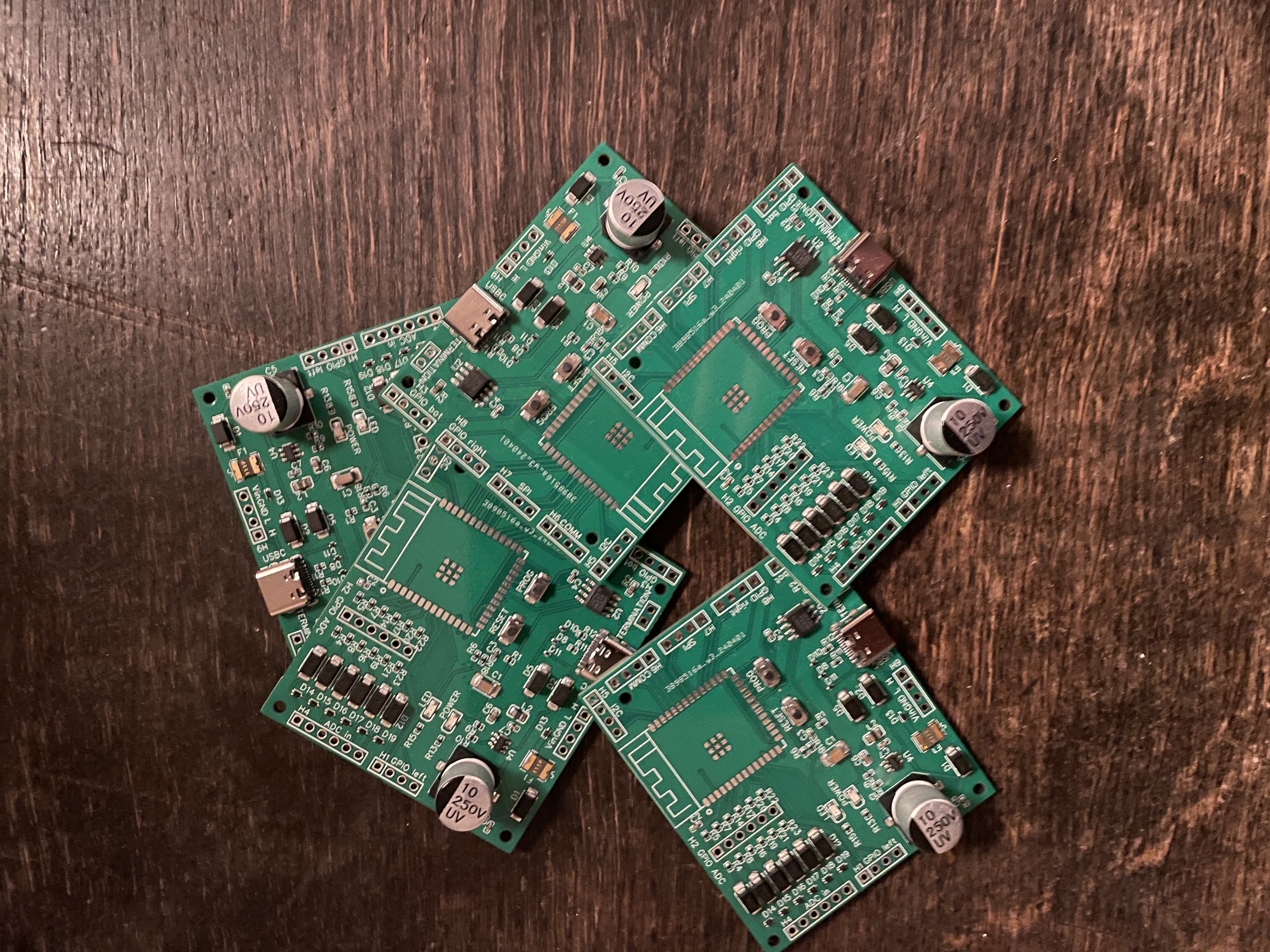

VCU: I also thought I would be able to easily control it via CAN bus (which I hadn't known at this time) and that I'll just write my own code to combine the CAN controls with controls of analogue devices. Back then, I found only the EVSE GEVCU, and closed source Tesla/Leaf VCUs, which did not provide the flexibility I had in mind. Had I searched a bit better or waited a few more months, I would probably have found the openinverter project. Instead, I spent Covid programming my own open source VCU framework based on the ESP32, which I really like. It's an event-driven, non-hierarchical software design, which I can elaborate upon at a later stage. I also just created a little ESD-TVS protected dev board so that the system can be used anywhere in the car (still WIP).
This project is progressing very slowly for many reasons, but the most depressing reason is that I'm still unable to spin the motor (and I don't have a proper manual, just a CAN matrix). I have it connected to various CAN sniffers, a 370V battery bench, and my little test bench. It listens and reacts to my VCU commands, but it doesn't switch into drive mode. I'm also unsure about the right start sequence, so I'd appreciate, if anyone could verify that my logic is correct: viewtopic.php?p=67619

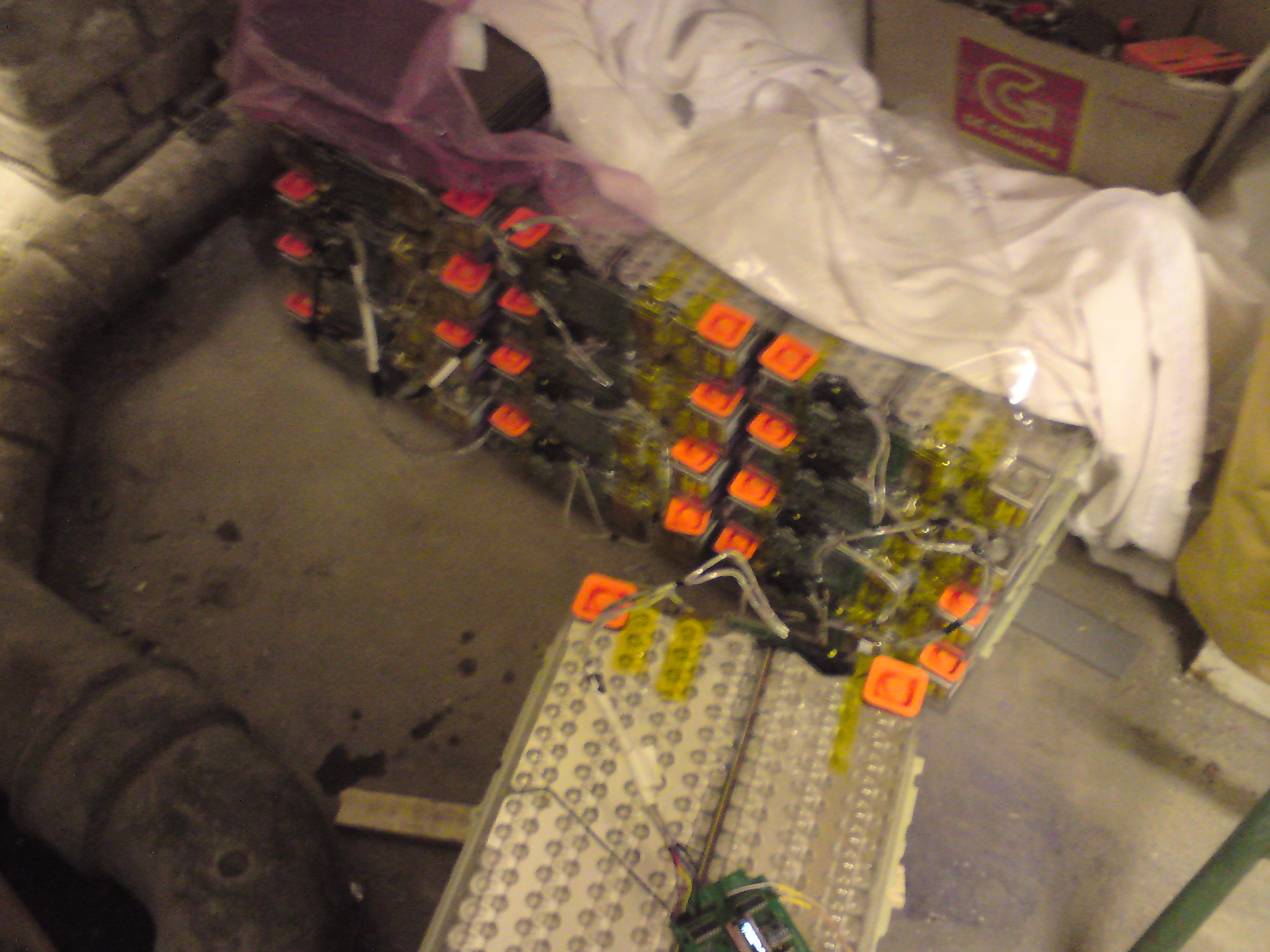

Battery: There is a Tesla model S P85 battery pack sitting in my cellar, which I successfully managed to connect to a modified version of the SimpBMS. I will certainly use the SimpBMS code (big thanks to Tom De Bree!), but would prefer different hardware, maybe using my own ESP32 framework and board. Does someone have an overview of SimpBMS-compatible hardware projects post V2.3, which don't rely on the Teensy 3.2?

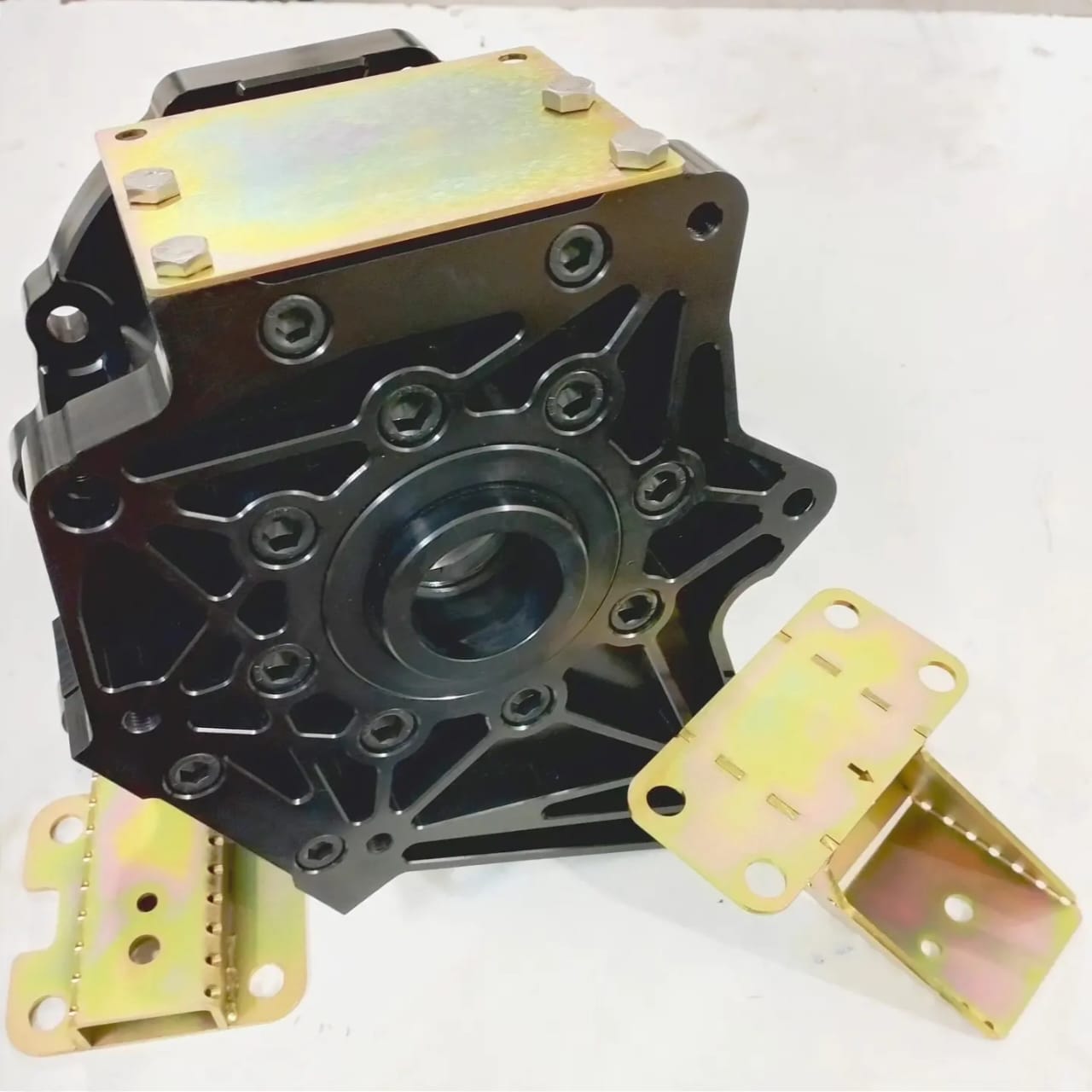

Drivetrain: Giving some thought to the gear/diff ratios, I decided to drop the LT77 gearbox, flange the motor onto the LT230 transfer box with a 1.667:1 ratio, and replace the axle diffs with a 4.75 ratio. That should give enough climbing ability, even in rear-wheel drive. The transfer box motor adapter is a complicated piece of work, as it needs to house the shaft adapter, be long enough to overcome the LT230 diff box, fit into the transmission tunnel, bolt onto the original frame mounts, and hold the LT230 diff/ratio shifter. That goes far beyond my skills, so I have it manufactured by a professional.

More and more i am convinced your motor uses CAN FD for communication instead of plain CAN bus. Try to see if you receive any reports on 0x105 telegram if you rotate the shaft with inverter started.
