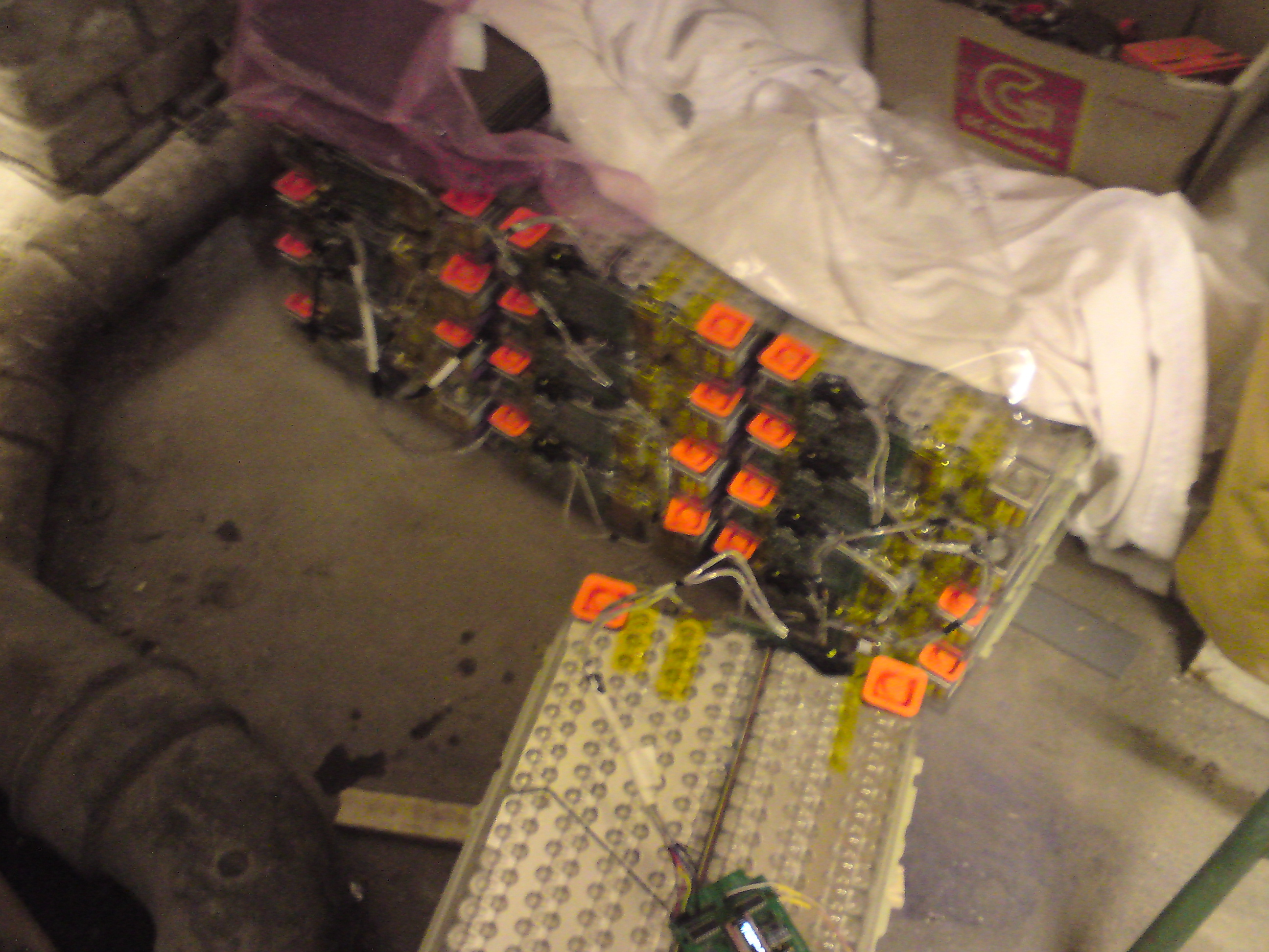

Battery: There is a Tesla model S P85 battery pack sitting in my cellar, which I successfully managed to connect to a modified version of the SimpBMS. I will certainly use the SimpBMS code (big thanks to Tom De Bree!), but would prefer different hardware, maybe using my own ESP32 framework and board. Does someone have an overview of SimpBMS-compatible hardware projects post V2.3, which don't rely on the Teensy 3.2?

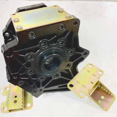

Drivetrain: Giving some thought to the gear/diff ratios, I decided to drop the LT77 gearbox, flange the motor onto the LT230 transfer box with a 1.667:1 ratio, and replace the axle diffs with a 4.75 ratio. That should give enough climbing ability, even in rear-wheel drive. The transfer box motor adapter is a complicated piece of work, as it needs to house the shaft adapter, be long enough to overcome the LT230 diff box, fit into the transmission tunnel, bolt onto the original frame mounts, and hold the LT230 diff/ratio shifter. That goes far beyond my skills, so I have it manufactured by a professional.
