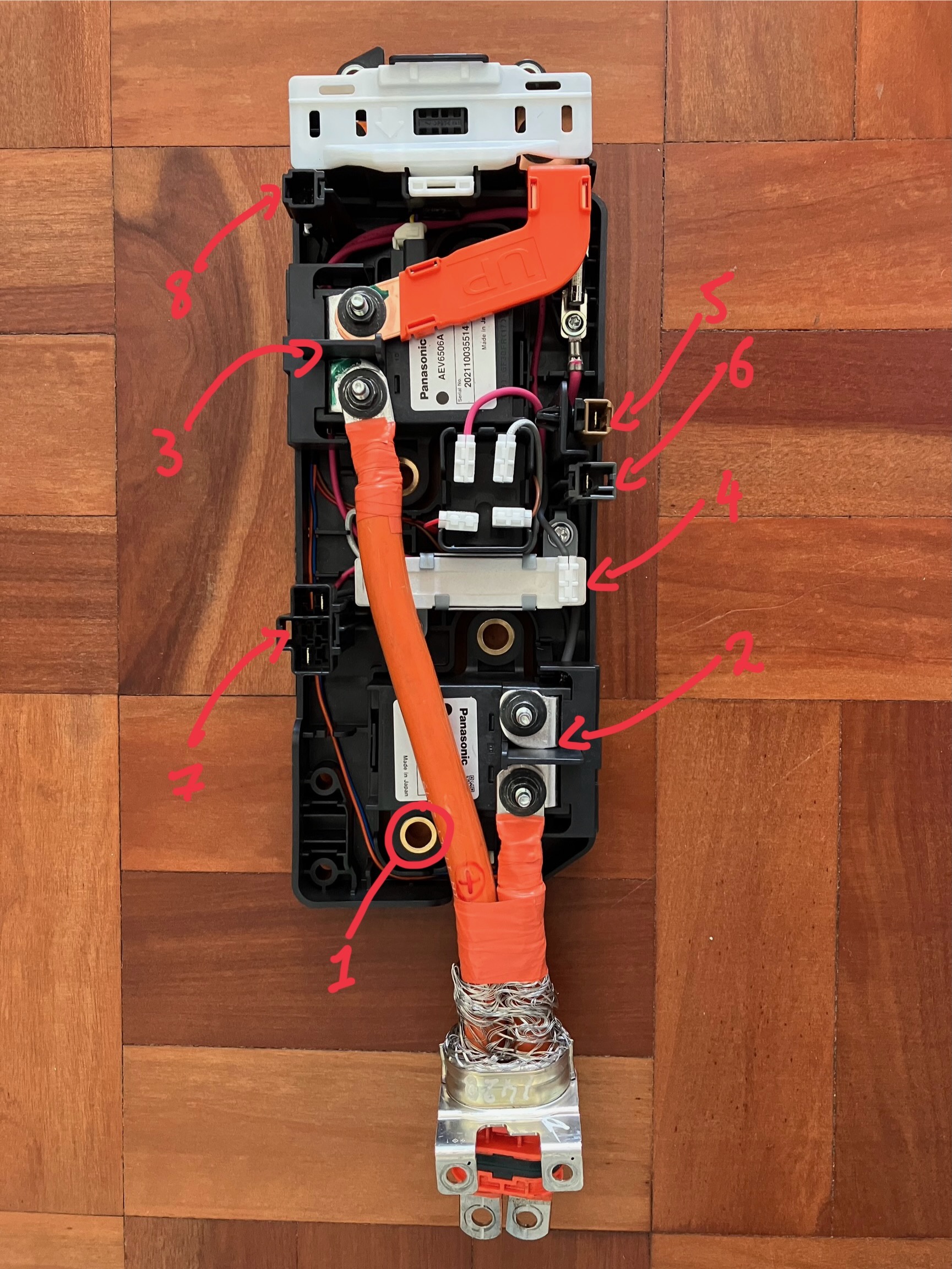

Hello,
I have a leaf precharge circuit, and I'm trying to figure out how to wire it up, and how to control it. I have looked through the forum and through the wiki and can't find much, so I thought I'd ask here and make the answers into a wiki page. I don't have access to an actual Leaf to see how they are wired on an OEM vehicle. Apologies if this is documented somewhere - you can just send me to the right place!
I've attached a picture of my circuit, along with numbered annotations. Here are my questions.
1. What is the purpose of the brass rings next to each contactor? See (1) as an example.
2. Why are there 2 large contactors (annotation 2 and 3)? Are they supposed to be wired in parallel, with each contactor on the positive side of two battery packs, or are they supposed to be wired in series, with one on the positive end and one on the negative end of the battery?
3. Is (4) what forum discussions call the precharge contactor? Or is it something else? The precharge resistor perhaps?
4. How do I control these large contactors? Do I just supply 12v to (5,6,7) or do I have to control it via some protocol via the small pins at (8)?
5. How would I actually wire this guy up? I have a clue that the large wires are negative and positive HV, so I'd imagine that I simply connect those to the battery and the terminals (at (2) and in the fuse holder at (9)) to the other end of the HV circuit.
6. If these contractors are controlled independently, are they supposed to be controlled simultaneously, or separately, with some time lag?

1. The brass rings are the mechanical bolting points for the contactors
2. One positive contactor (usually #3) and one negative (#2)
3. #4 is the precharge resistor. The precharge contactor is the part above it with the 4 wires
4. You just supply 12V. Economizing is optional, one pulls 500mA as far as I remember
5. Yes, fuse usually gets positive voltage from the battery and negative goes directly to #2 and it all comes out the other end
6. On ignition on you immediately close negative contactor #2 and precharge relay #4-ish. When voltage before and after the contactor block has like less than 20V delta you close #3 as well
The delta can be calculated by the BMS reported battery voltage and e.g. the voltage reported by the inverter, charger or DC-DC converter. Usually all these devices have CAN messages that contain this info.

Thank you, johu. I'll put together a wiki page.
What is (8) for? Safe to ignore?

Oh those are the relay coils aka control signals!
5, 6 and 7 are for the PTC heater and battery heater. They are always on

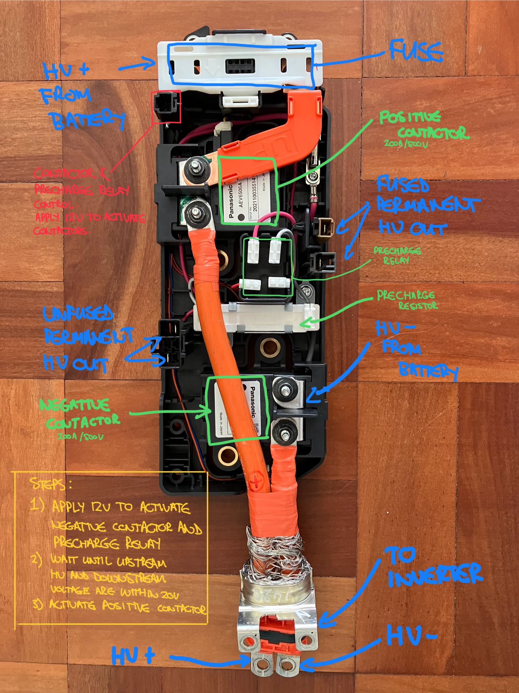

Thanks johu, this is very helpful. So if I have got this right, the means of controlling the contactors is via the plug labeled (8) above.
I have found a wiki page that relates to this contactor box here - https://openinverter.org/wiki/HV_Contactor_Box - but it's poorly named and could do with an update, so I'll transfer this info there.
A few more questions if I you have a little more patience - just so everything is totally explicit.
1. Looks like polarity of the precharge relay control wires matters so I will trace the pinouts, or, at least, the wire colours, and include in the wiki.
2. Does the polarity of the HV contactor coil wires matter?
3. So I see how we close a contactor or relay - by applying 12v.
4. But how do we keep it closed? Do we keep applying 12v?
5. When we are finished driving, how do we open the contactors? Just by cutting 12v?
6. If so, can we cut 12v simultaneously, or must it be phased in a similar manner to the starting procedure?

Ok, here is the outcome of this thread. Tomorrow I’ll add it to the wiki.

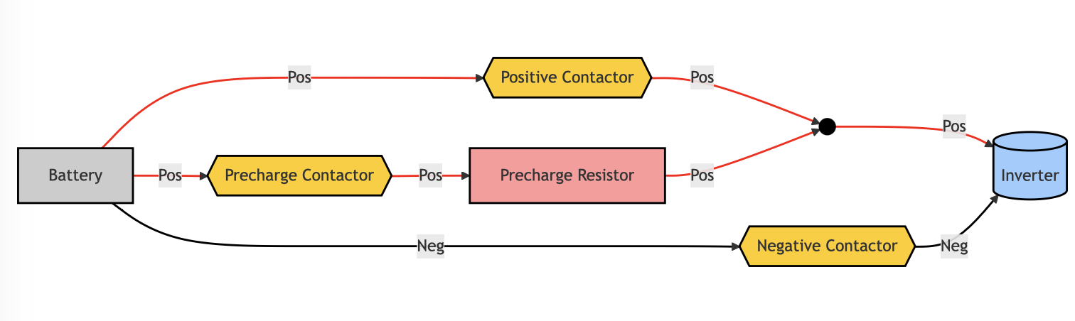

I'll just leave this here for anyone who is having trouble visualising a precharge circuit.
