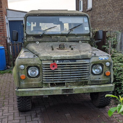

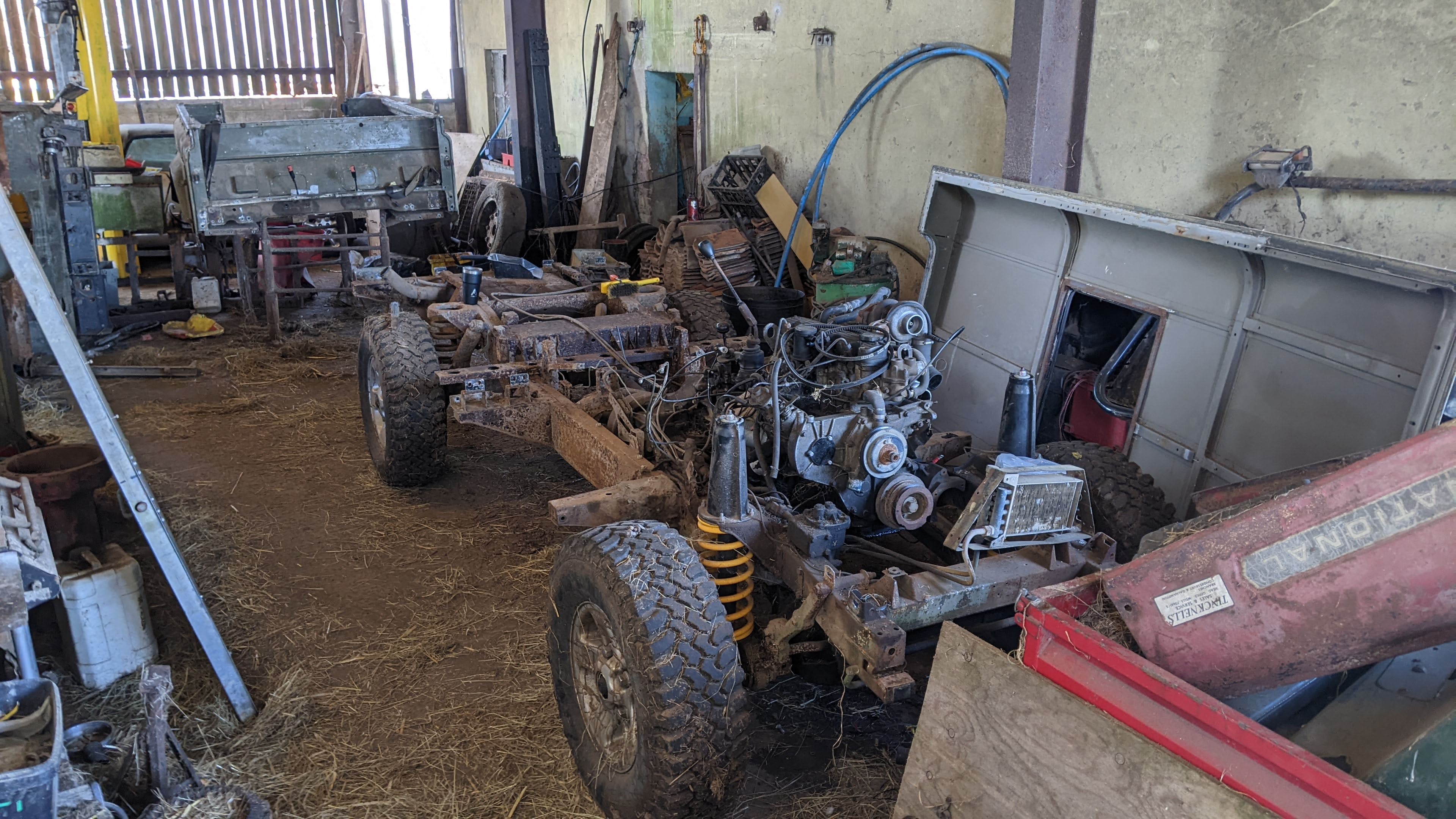

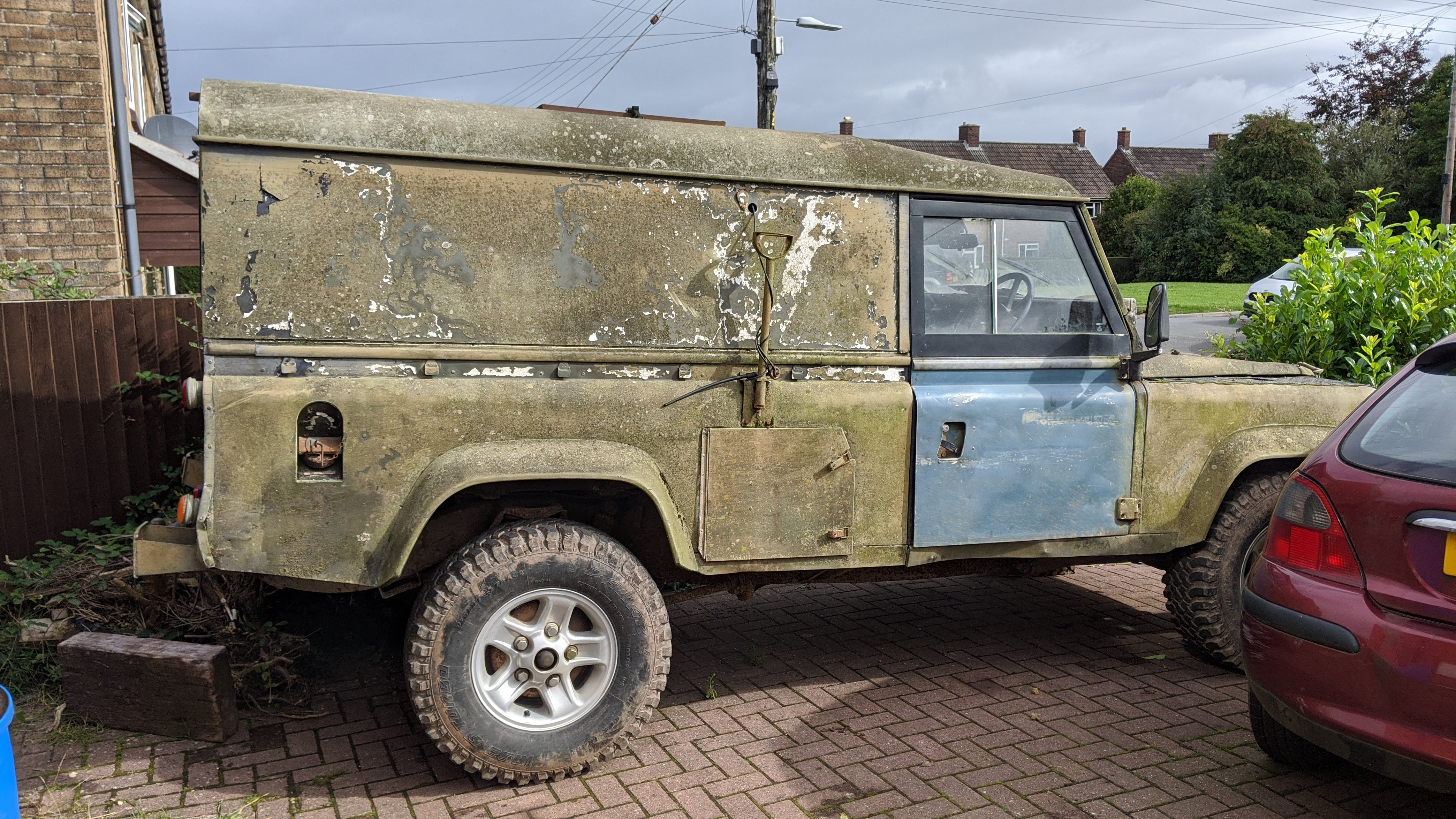

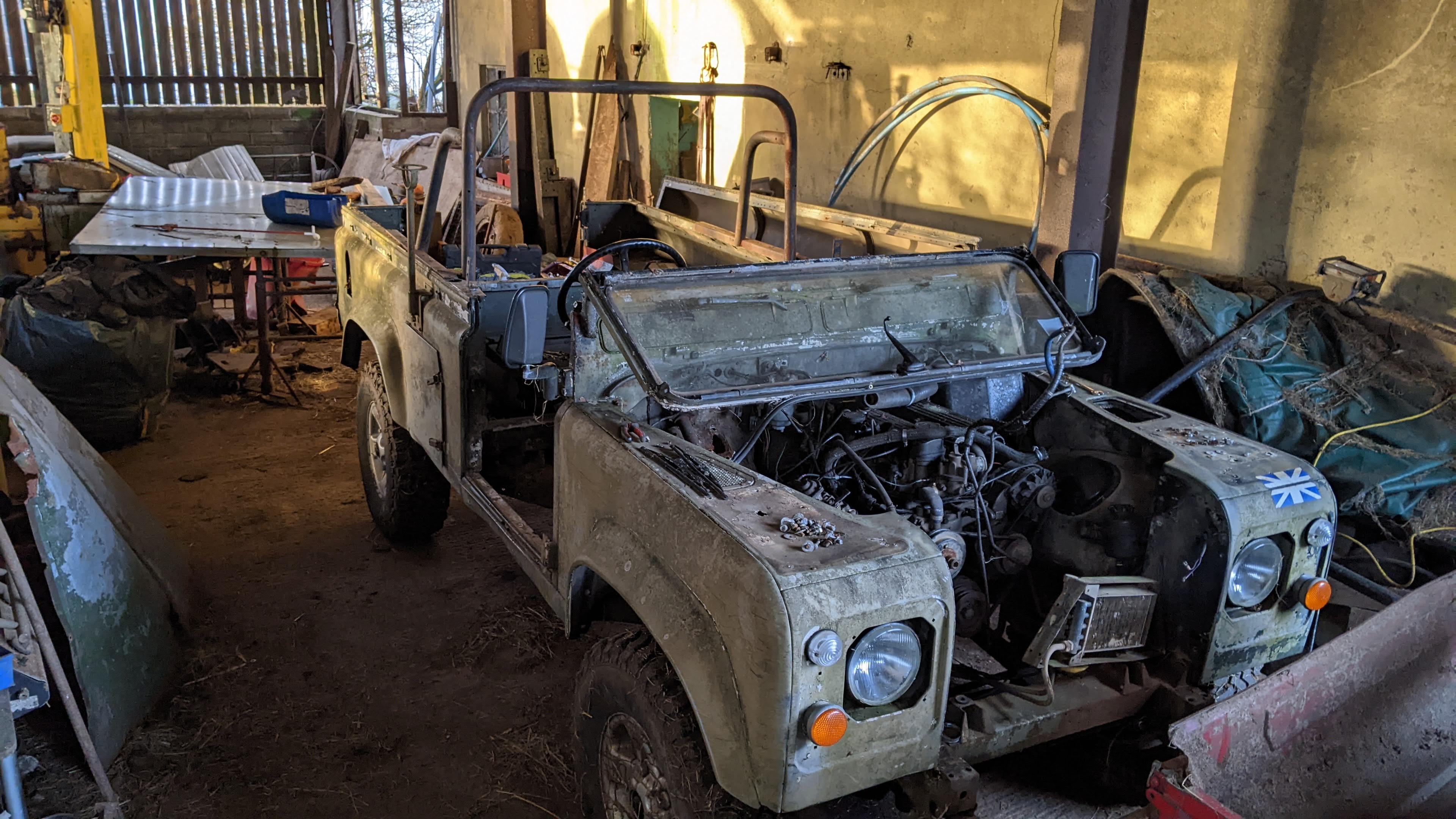

The Vehicle

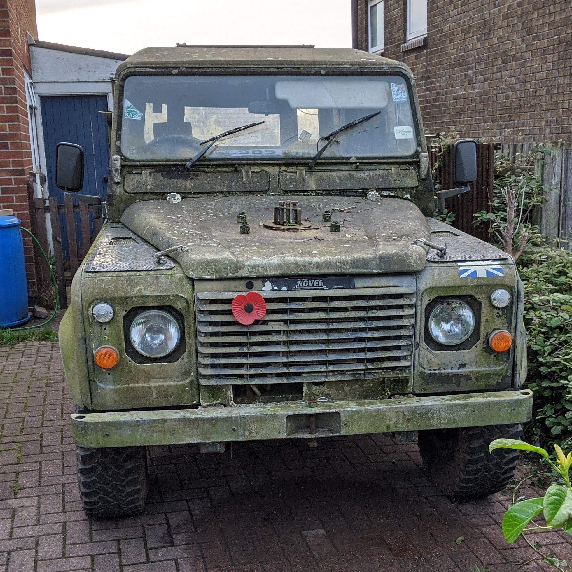

This was pretty much an impulse purchase in the middle of Covid way back in 2020, I was still half way through the MG so had no intention of doing an EV conversion to this. Originally I was going to transplant in an L series Diesel engine from the Rover 25 you can see in the side of one photo, then do the NC500.
It had been sat in a wood for two years previously, but started up and was cannonballed home (luckily only a few miles). I managed to get it through an MOT with only a bit of welding to the rear crossmember and some new spring turrets. It also needed a bit of rewiring just to get it functioning again.
I didn't drive it for long before storing it at the farm. In 2022 I made a start stripping it down for a nut and bolt rebuild. Still intending to ICE swap it and just make bits of progress when the EV conversions were waiting for parts etc. This was when the chip shortage was still in effect.
This above photo is the rough plan I have for the aesthetics. I want to go with a sort of Mad Max/beach buggy look. With a roll cage, bikini soft top and the option to push the windscreen down. Obviously this is the ideal setup for the UK weather. I haven't decided if I want to keep the original patina or nato desert brown paint.
I have some ideas for a bit of decoration down the sides of the chassis rails, I have the military records of this vehicles so I was thinking regimental cap badges where this was used down one side and then maybe something to represent the three civilian owners down the other. Not sure about this though.
This is the stage where I left in back in 2022, last year I sold the engine and bought chassis repair parts. Now it's covered in the usual farm accumulation. Last year I also made the decision to just skip the ICE swap and convert it to electric.

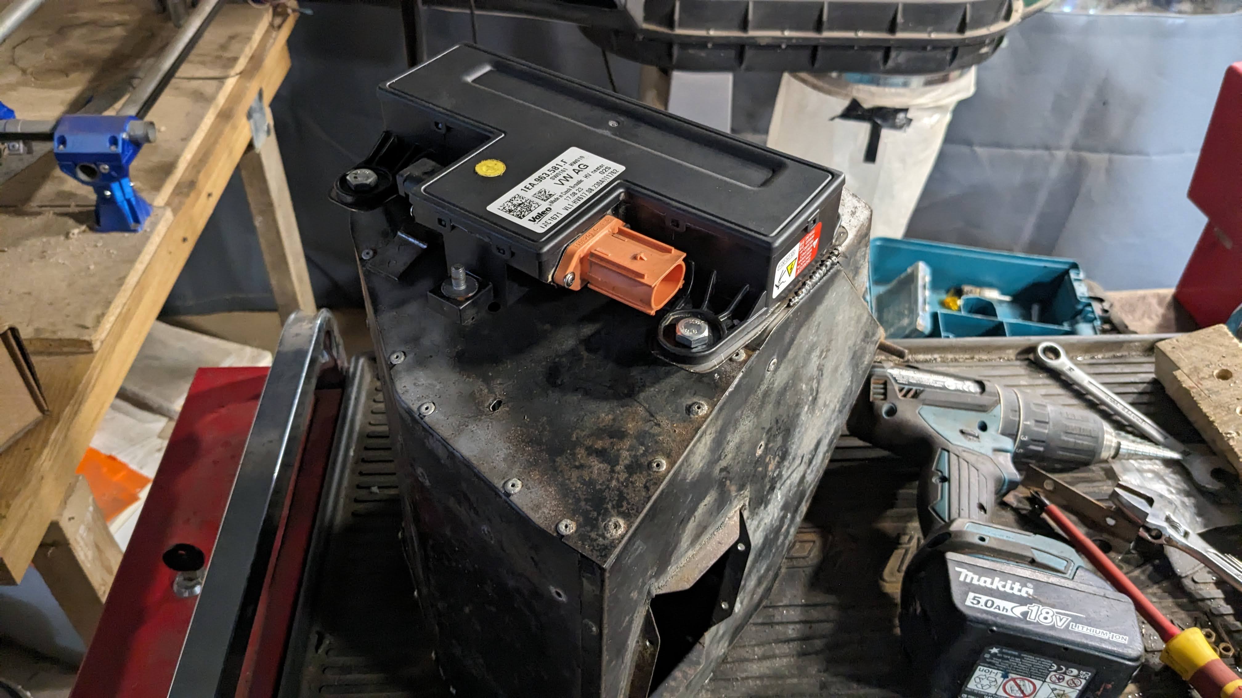

Originally I was thinking E-Corsa batteries given the price. But I have recently had some experiences with the VW batteries and I think I prefer the bigger but few module approach. So will probably go with a 55kWh ID3/4 pack, although I'll wait until the motor is in and spinning then see what the battery market is looking like. I have made a start designing some coolant plates for this pack since I'll be going with CCS for fast charging, plus after running the MG over a couple winters I would really like some options for battery heating as well.

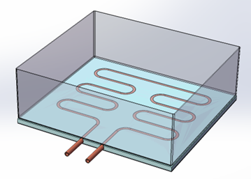

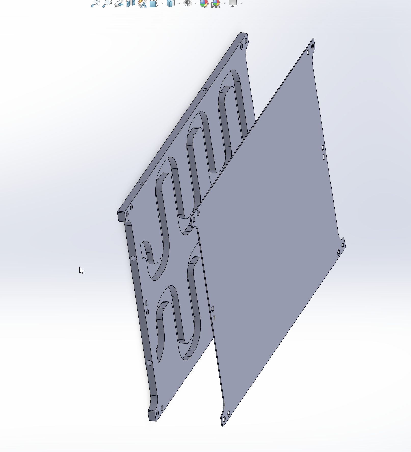

I'll post a screen shot of the design later on, It's a big plate of aluminium with machined out spaces for pipework to be pressed in. Each plate can support 4 modules, two each side. So I'll only need two for the whole box. Less plates also means less coolant connections and potential for leaks. I'm hoping the cost of manufacture won't be too prohibitive.rstevens81 wrote: ↑Wed Feb 28, 2024 7:45 am coolplates are defo a unicorn item for diy because of their cost
Potentially I might also use this battery for the tractor as well.

Re: cooling plates, one thought I had was aluminium sheet sandwiching a 3d printed piece with channels for coolant. Might be a cheapish DIY option

This is where I am currently with the chill plates. holes for bolting in four modules, plus some extra tabs on the end with a couple tapped holes along the side to aid with securing.
Currently with a lid, perhaps it could be secured by a ton of counter sunk screws to the main plate and sealed with silicone. Not 100% keen on this idea.
If I get them manufactured there is potential for stir welding them on, might have to buy quite a few for that but it could work.

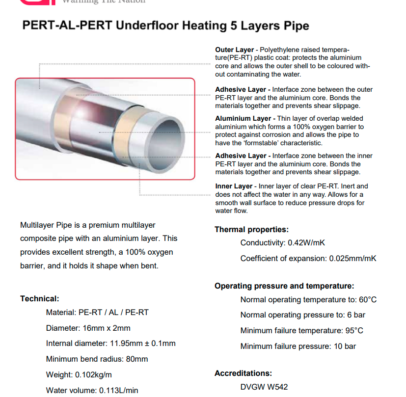

What might work would be underfloor heating pipe ... Cut a groove in the al heatsink, this can be done with a router with ali

Yeah this is something I'd also considered, you just need to find a panel of the right dimensions for your battery.rstevens81 wrote: ↑Wed Feb 28, 2024 10:20 pm What might work would be underfloor heating pipe ... Cut a groove in the al heatsink, this can be done with a router with ali

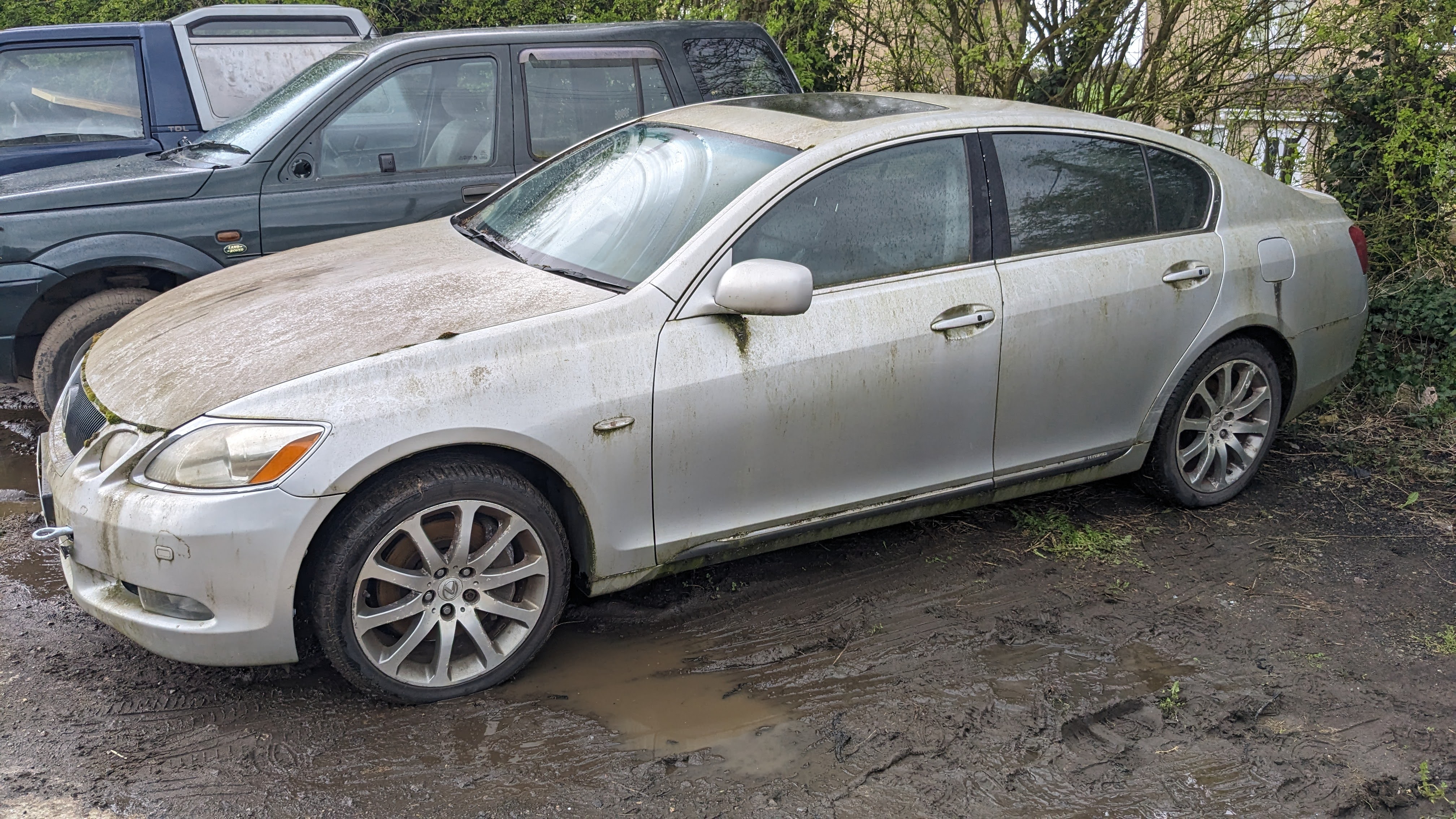

Picked up the donor car today, currently only planning to use the gearbox and inverter but the seats are very comfortable.

My idea was to simply cut a straight passage where one cell would lie and then add an obstacle on the inside to obstruct the flow somewhat, to swirl the water. Two plates in sandwich with countersunk screws still apply. I am thinki9ng on how to do this by simple method of jigsaw and metal blade with lots of WD40. In the past i have proven it can be done with 8mm plate. Outside plates need to be at least 5mm for even thickness and eventual welding of the end pipes. This is the only part i cant do alone. An expert should do it not to overheat and bnd the plate. It must keep the seal.LRBen wrote: ↑Wed Feb 28, 2024 5:40 pm This is where I am currently with the chill plates. holes for bolting in four modules, plus some extra tabs on the end with a couple tapped holes along the side to aid with securing.
Or if you have professional help you can cut channels in a 10mm plate with an O ring channel all around it and single 5mm plate on the top.

I wondered about a cooling plate setup that didn't require alu machineing or welding. Something that could work on the outside of a battery box, but also be a sandwich plate style for between battery modules. Using the underfloor heating tube idea above, and simple 2mm or 3mm alu sheet, is there somehting like a heat transfer settable gel or liquid that could pour around the tube and set in place!

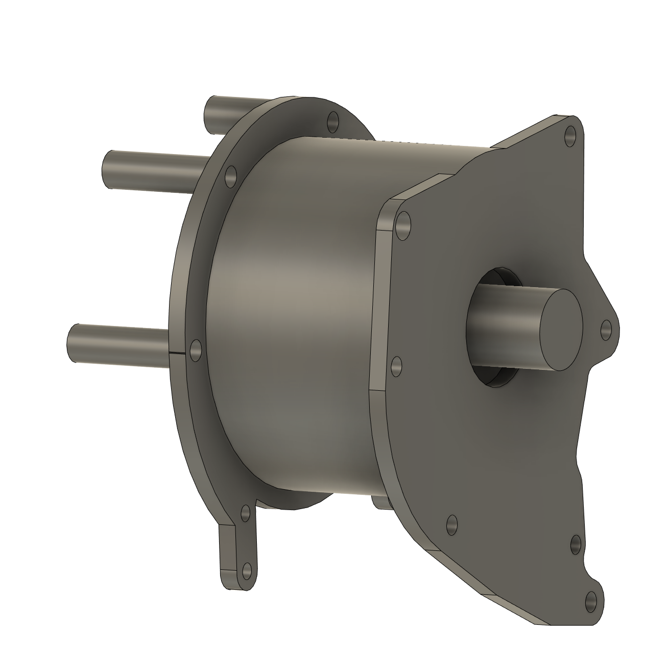

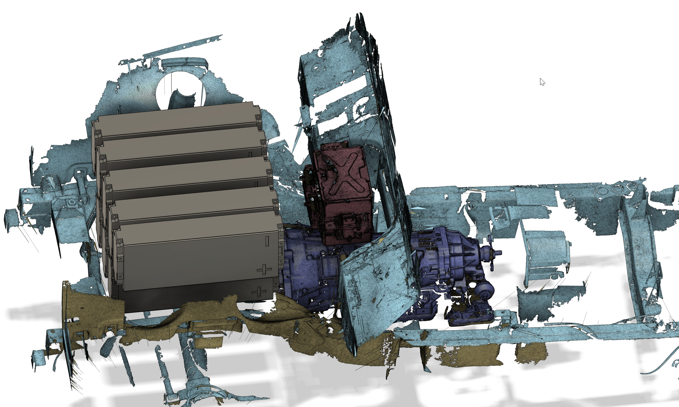

Thanks to Tom I have some scanning data to play with. GS450H should fit nicely in the transmission tunnel. It does make space a little bit tight in the engine bay but I think I can in theory fit in the 8 modules from a 55kWh VW pack.
Currently working on connecting the GS450H to LT230, I have a rough idea planned out in my head. Going to take a few scans of the back of the GS450H and front of the LT230 and see if I can work something up.
At some point in the next few weeks I'll also get setup to start the chassis welding

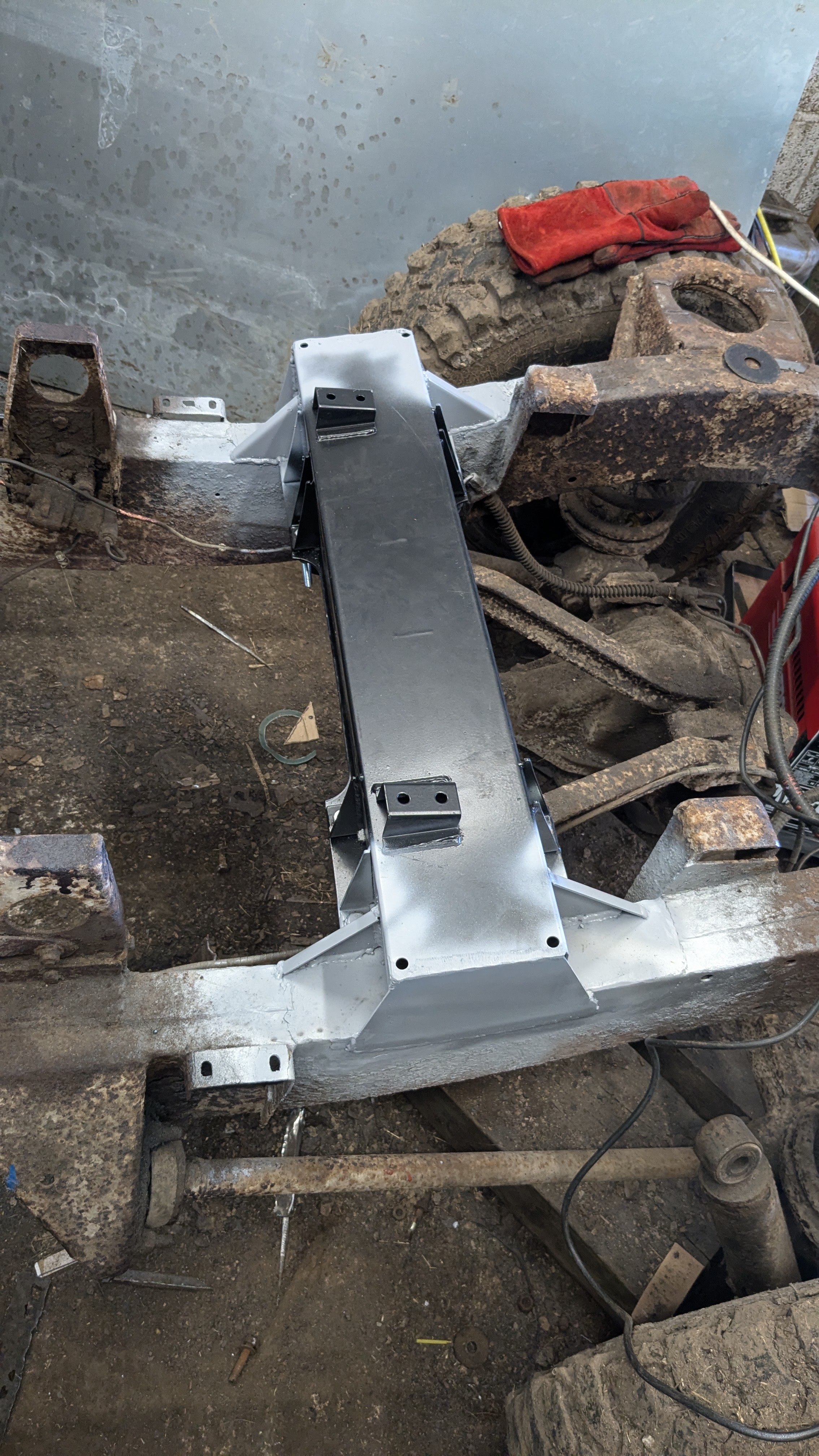

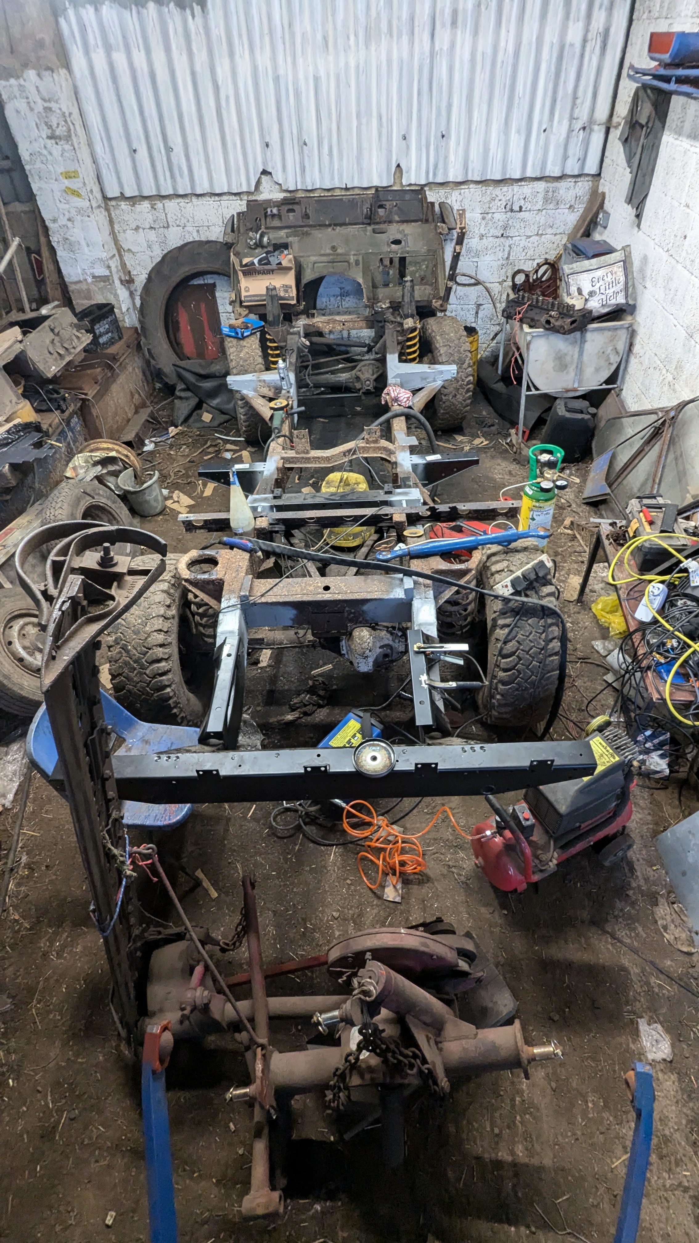

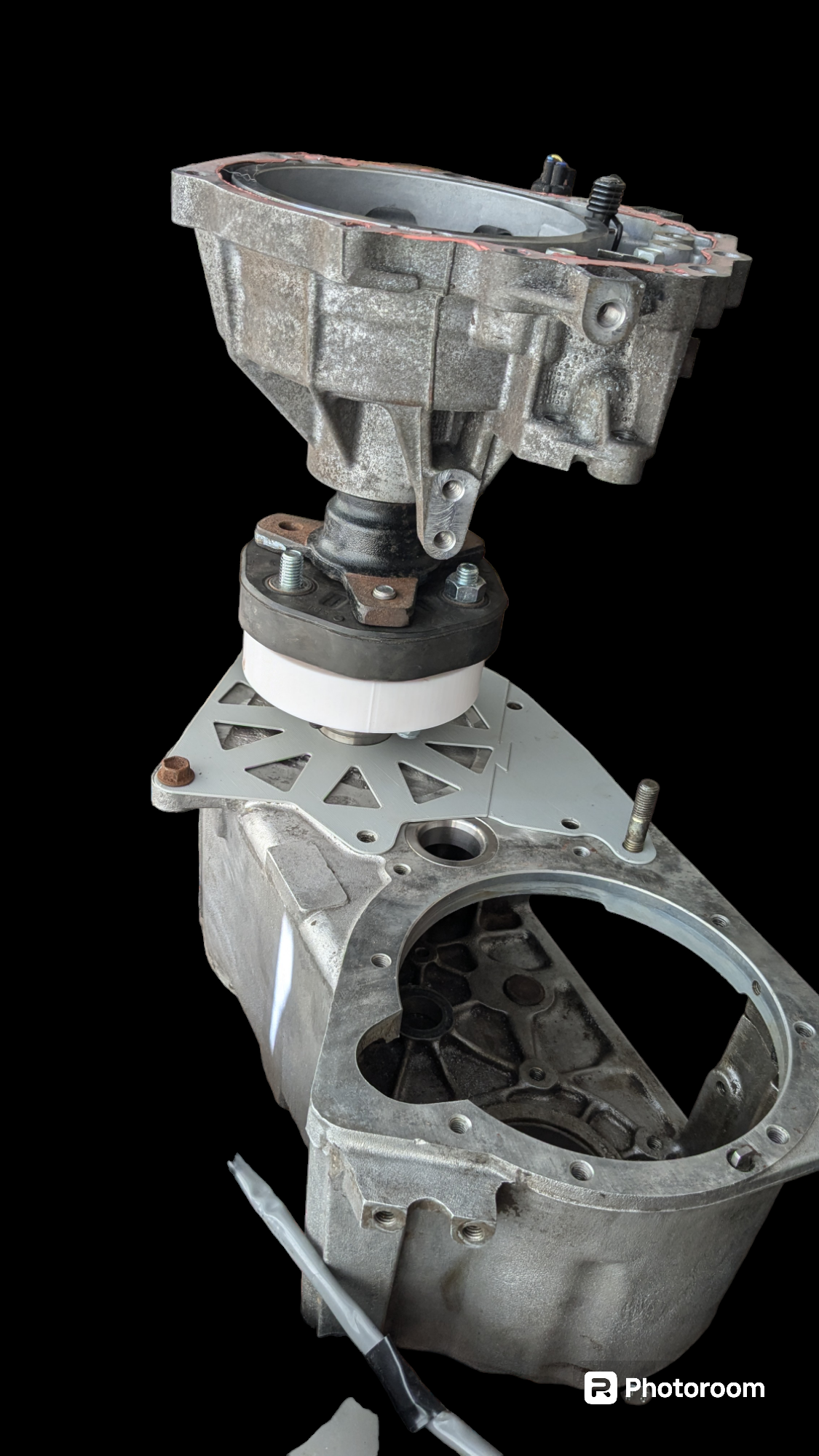

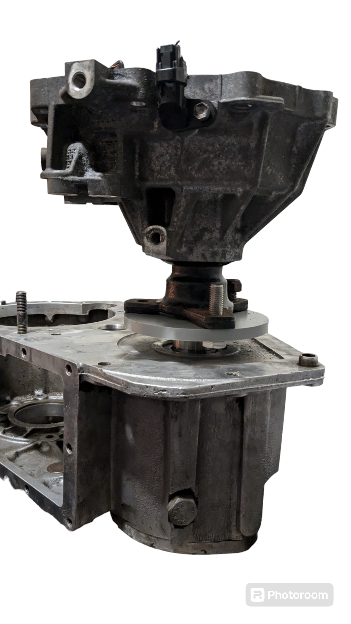

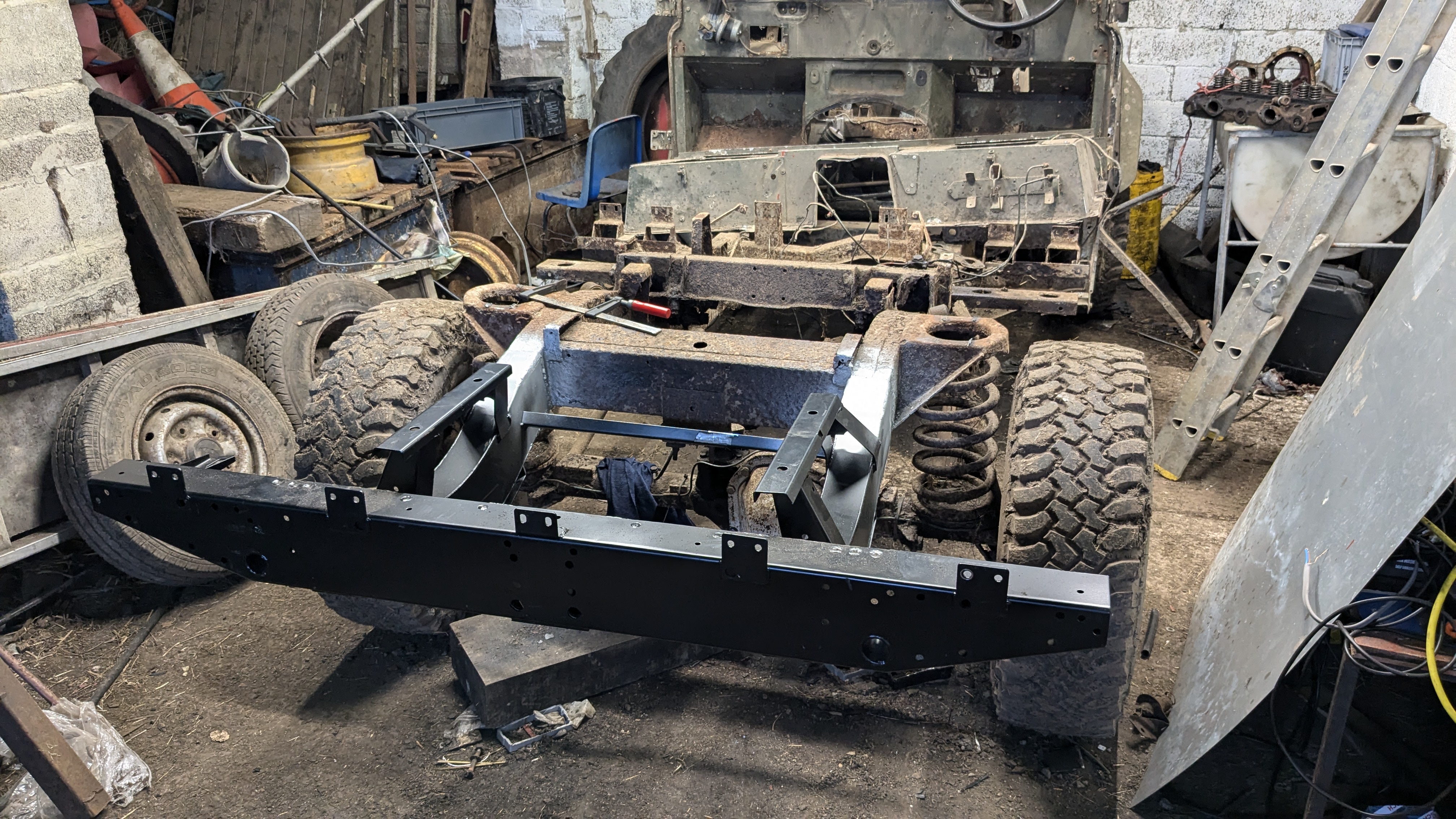

Bit of progress on the Land Rover this week. Got the rear cross member attached with just a little more welding to do to finish it off. Then I can move onto the more complicated A Arm cross member.
I have also made some progress connecting the GS450H gearbox to the LT230. I think I have shaft adaptors pretty much there. Just need to connect the two boxes.
I have a decent bolt pattern for the LT230 thanks to @boltsnjolts on Instagram who generously let me have the datum points for an adaptor he made up for his Series 2 conversion. Just need to do the same for the GS end now.

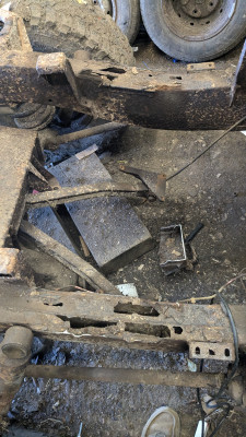

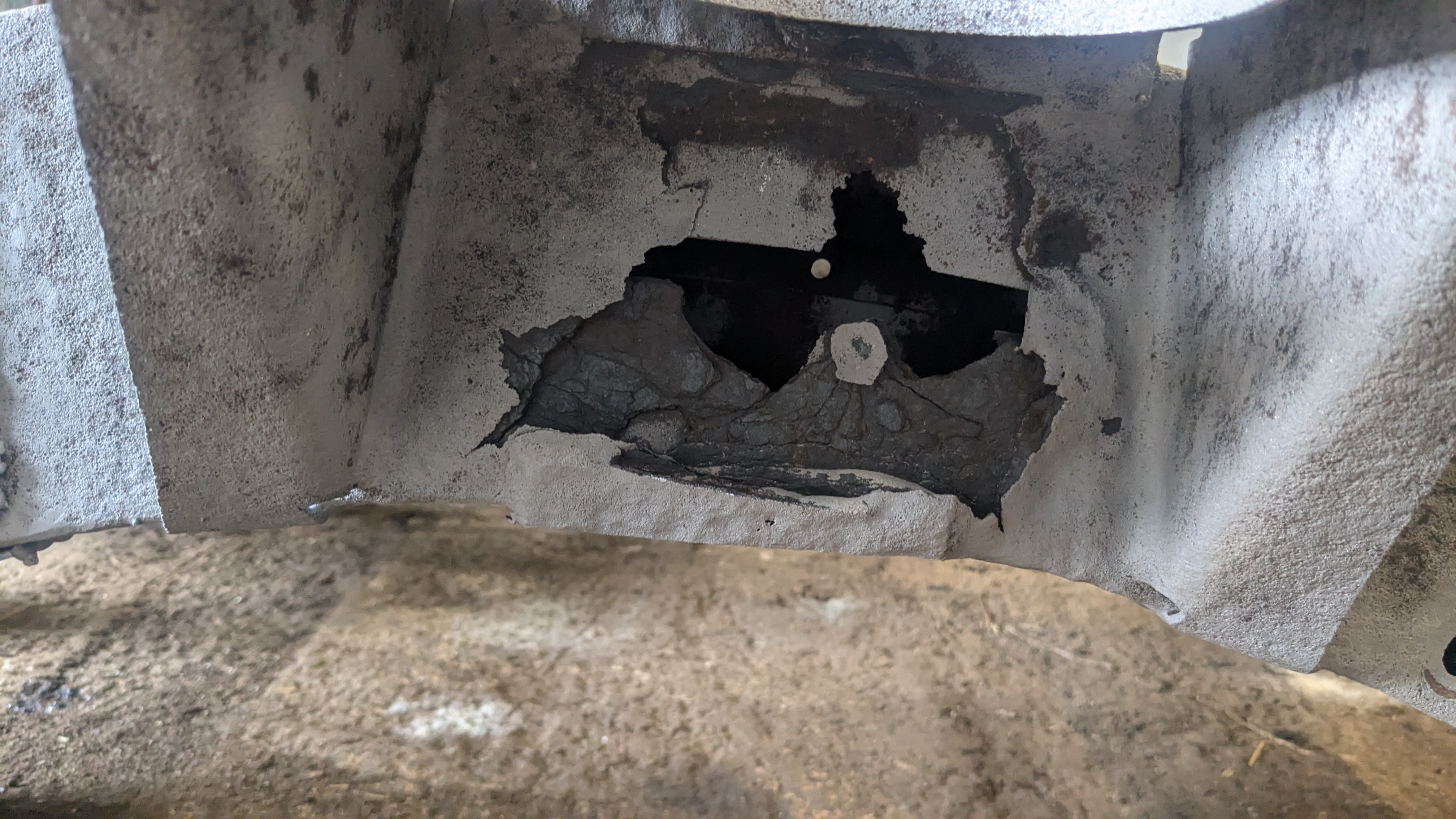

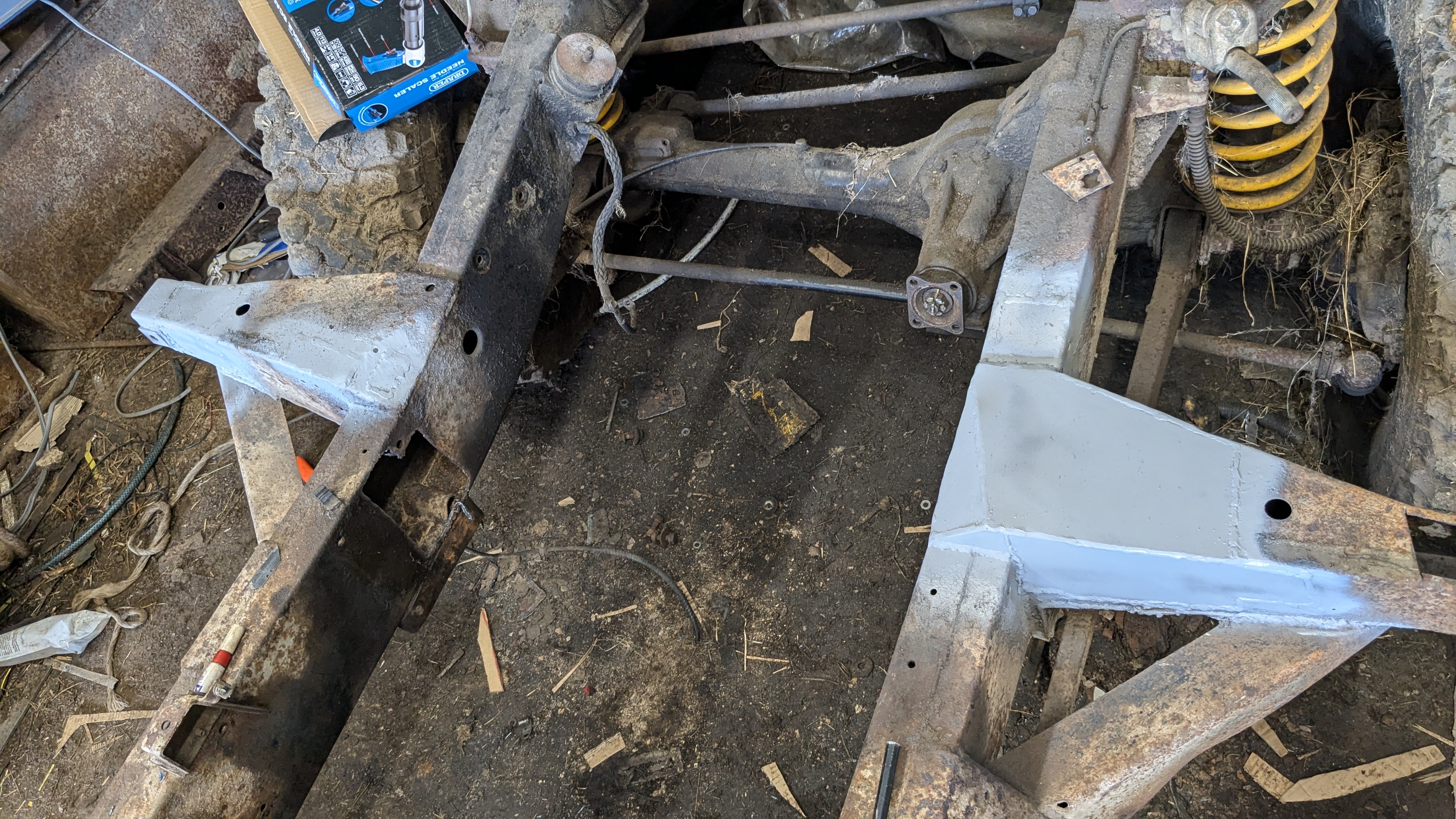

Lots of rust, lots of cutting, lots of welding. Still more rust.
Finished with what I thought was the last of the big repairs and was just expecting some patching. However the rear tub outriggers are pretty far gone so I think I will cut those off and weld on new ones. The bulkhead outriggers are also quite bad but have rusted in places that I can patch up. I also found a botched repair hiding under the gearbox cross member.

Started to use my plasma cutter for this project and it's made things a bit quicker and slightly more pleasant than constantly filling the air with grinding dust.Finished with what I thought was the last of the big repairs and was just expecting some patching. However the rear tub outriggers are pretty far gone so I think I will cut those off and weld on new ones. The bulkhead outriggers are also quite bad but have rusted in places that I can patch up. I also found a botched repair hiding under the gearbox cross member.

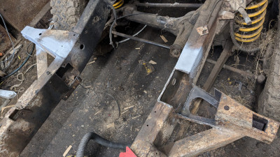

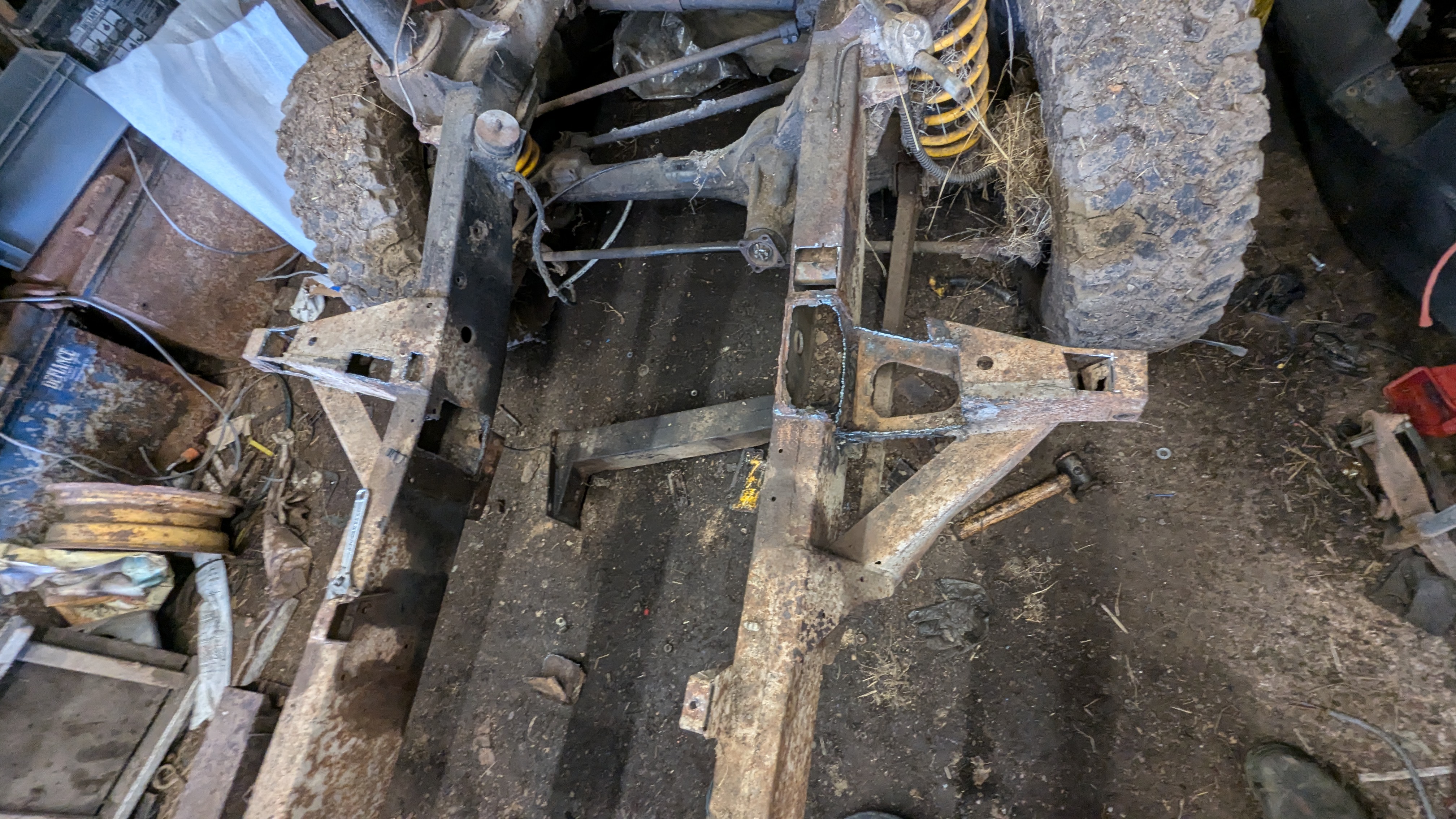

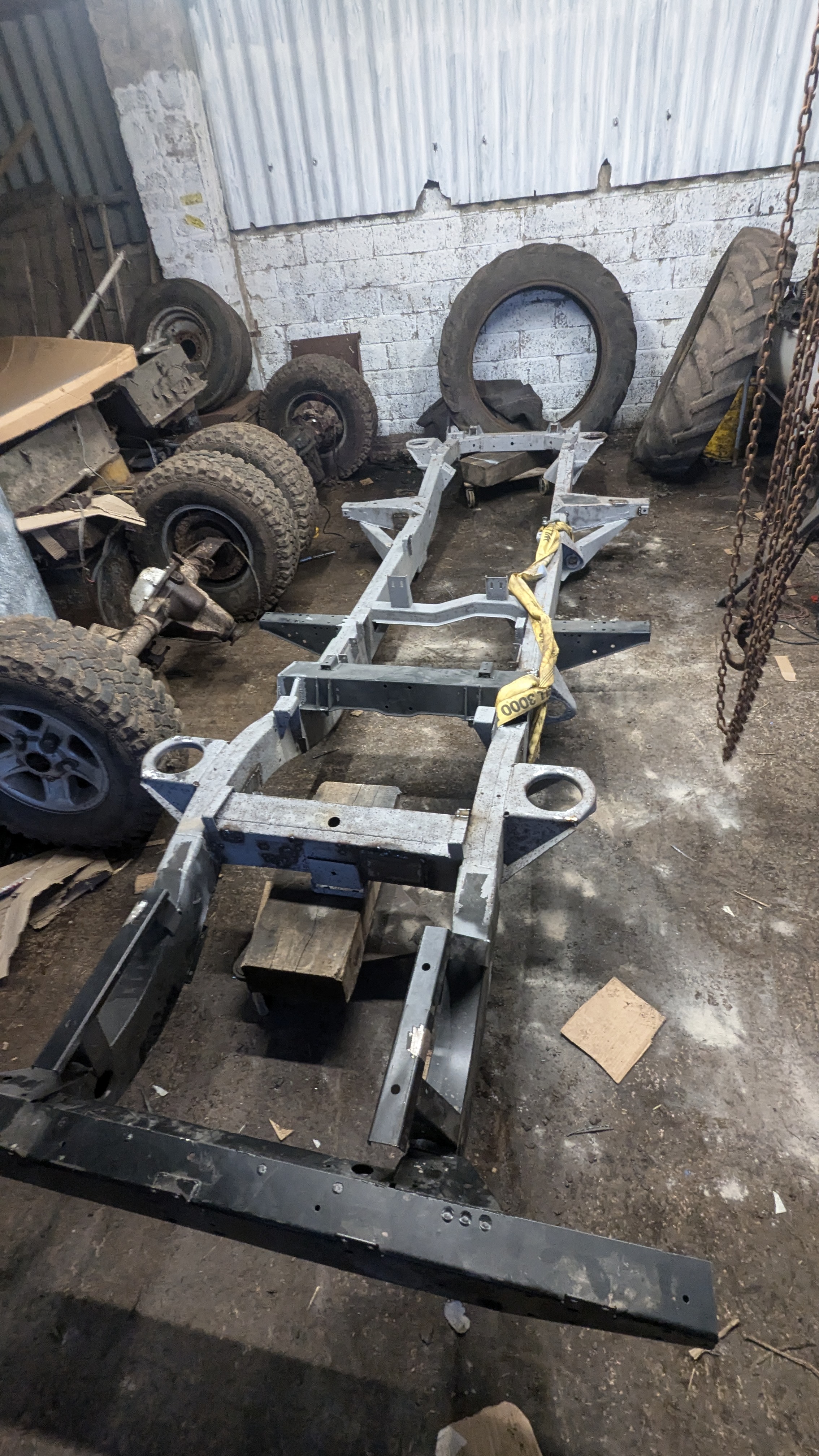

Lots of welding done this month. Rebuilt the bulkhead outriggers, replaced the rear body outriggers, a few more patches done.
I also striped the rest of the chassis parts off so the next step in restoration is to take the chassis of the axles, flip it over and then do a tiny bit more welding of course.
On the motor attachment front I have been playing around with the output shaft from a ZF Auto gearbox used in Discoverys. It's not going to be too hard to attach this to a small adaptor plate that the GS450H output flange can bolt into. It's quite a bit short than the first draft of this, I can also add the rubber donut if I wanted too without too much hassle. Then for something to hold it all together, with my bolt patterns for the gearbox and LT230 I just needed to connect the two faces at the right distance. Here is my current draft of this. The plan is for this to bolt to the GS450H, along with the shaft adaptor. Then it will bolt onto the LT230 as per any normal gearbox. Currently I'm not sure if I will actually get this part machined or split it down so I can make it out of spacers and laser cut plates as per the tractor adaptor. I'm going to print it off first and see how it all fit, then make a decision once the dimensions are verified.

So a tiny bit more welding turned into a tiny bit more. Got it sand blasted and we found a little bit more rust.
All done now though, only took 2 replacement outriggers, 2 new crossmembers and 0.5 square meters of sheet steel for patches. Taking it for a final sandblast and powder coat on Friday. Then I'll spray the internals fulls of Lanoguard.
After that I'll hang it up to one side as I have another project coming in for someone else which will last a month or two. But at least now I know the chassis is finally solid, once I get my workspace back I can start on the axle refurb and building it all back up again.

What are you going to protect it with? 2K epoxy mastic paint like Jotamastic 80/90, Epoxy Mastic 121 etc.?

Whatever the powder coating guy uses.Then lanoguard on the insides. I'll possibly also go over it with raptor coating, haven't decided yet.
