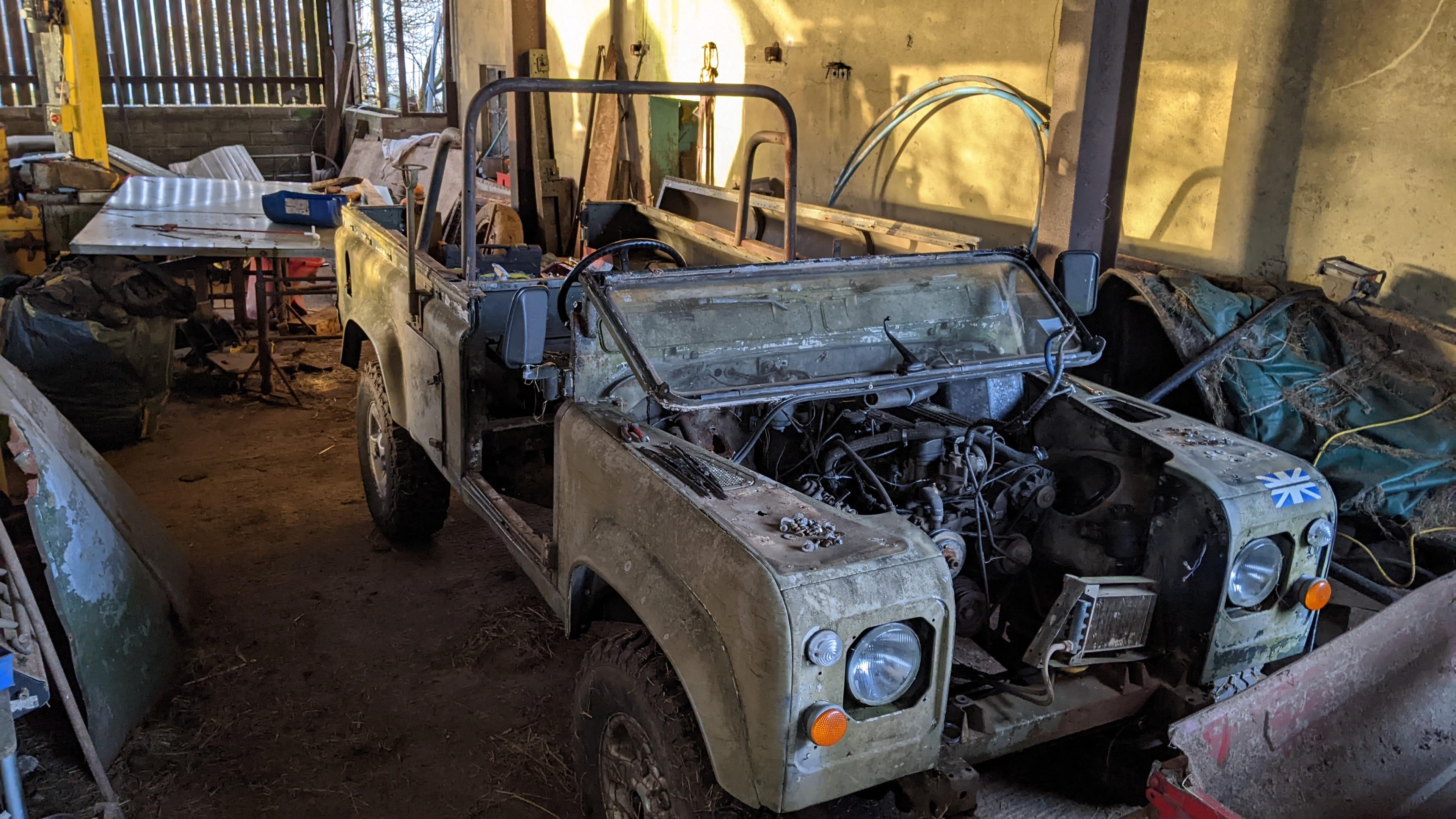

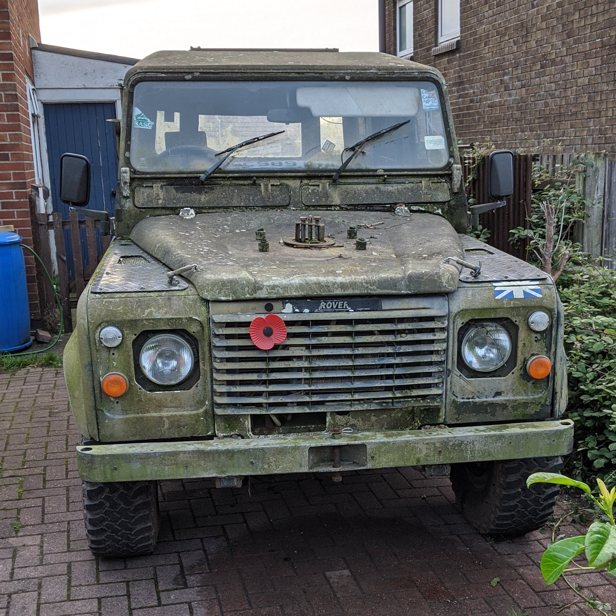

The Vehicle
This was pretty much an impulse purchase in the middle of Covid way back in 2020, I was still half way through the MG so had no intention of doing an EV conversion to this. Originally I was going to transplant in an L series Diesel engine from the Rover 25 you can see in the side of one photo, then do the NC500.
It had been sat in a wood for two years previously, but started up and was cannonballed home (luckily only a few miles). I managed to get it through an MOT with only a bit of welding to the rear crossmember and some new spring turrets. It also needed a bit of rewiring just to get it functioning again.
I didn't drive it for long before storing it at the farm. In 2022 I made a start stripping it down for a nut and bolt rebuild. Still intending to ICE swap it and just make bits of progress when the EV conversions were waiting for parts etc. This was when the chip shortage was still in effect.
This above photo is the rough plan I have for the aesthetics. I want to go with a sort of Mad Max/beach buggy look. With a roll cage, bikini soft top and the option to push the windscreen down. Obviously this is the ideal setup for the UK weather. I haven't decided if I want to keep the original patina or nato desert brown paint.
I have some ideas for a bit of decoration down the sides of the chassis rails, I have the military records of this vehicles so I was thinking regimental cap badges where this was used down one side and then maybe something to represent the three civilian owners down the other. Not sure about this though.
This is the stage where I left in back in 2022, last year I sold the engine and bought chassis repair parts. Now it's covered in the usual farm accumulation. Last year I also made the decision to just skip the ICE swap and convert it to electric.

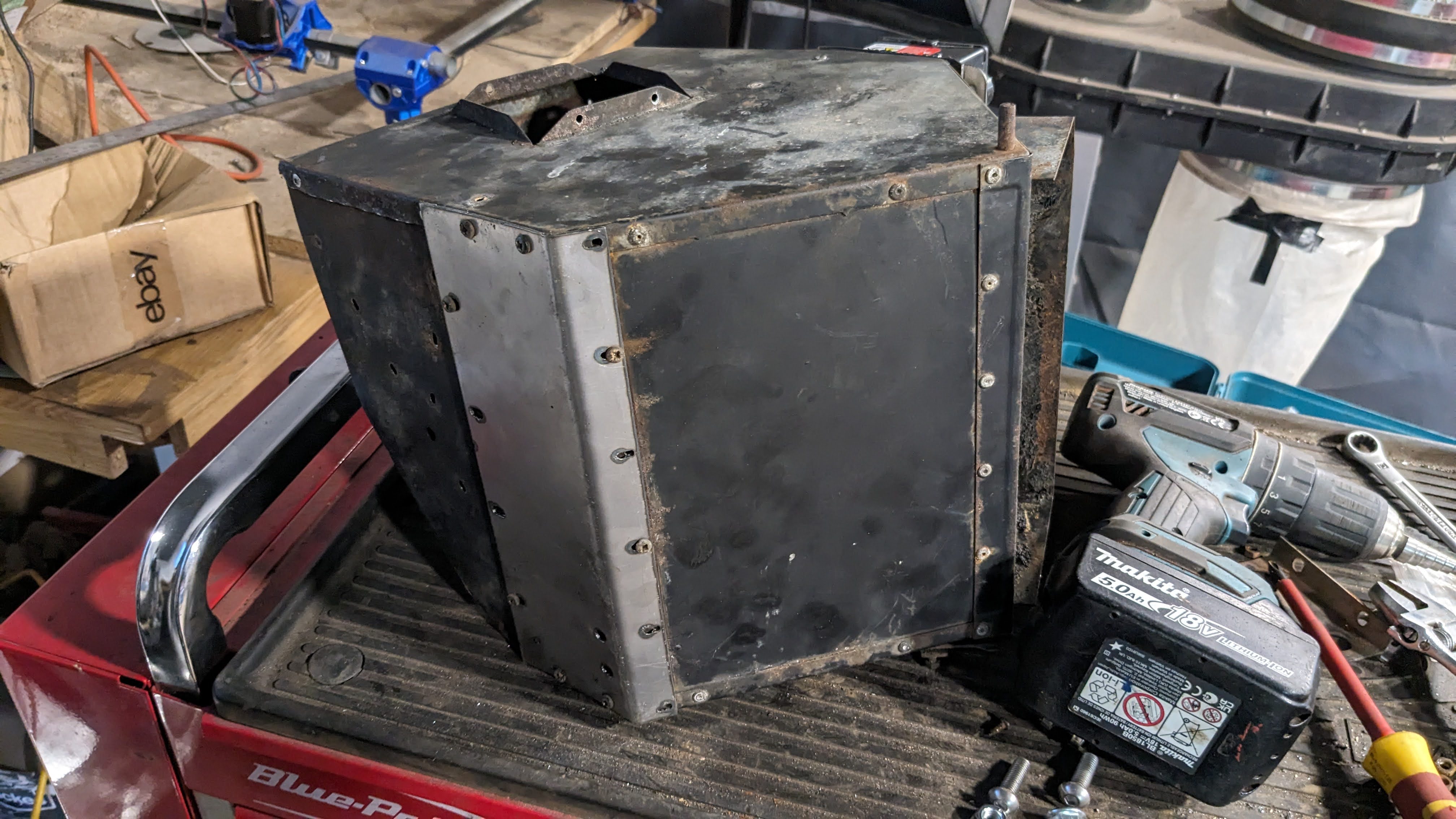

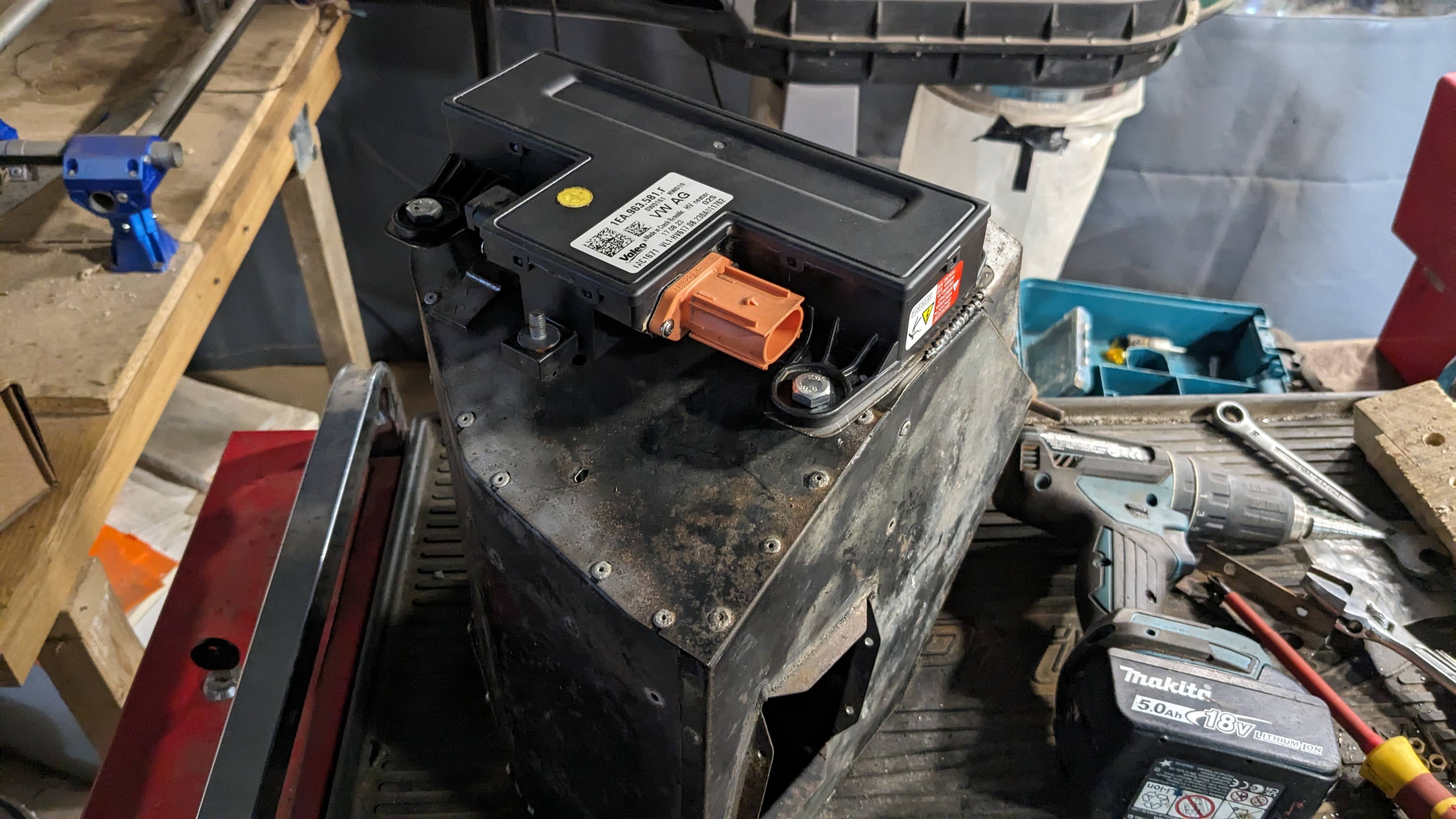

Waiting on the weather to dry out a bit so I can take the tractor out onto the fields for some testing. So I have a bit of time to work on some small bits for the Defender.
Currently stripping down the transfer box to swap ratios up to a 1.41 from the 1.22 is it currently. I'm only really doing this as I have spare gears so it isn't going to cost me a whole lot. Otherwise the 1.22 would be just fine I expect. However the 1.41 gives more torque and there is still plenty of rpm headroom. I thought about putting in an ATB but I think for now I'll leave it. Maybe make it an upgrade at a later date. I don't want to go spending all of my money at this early stage.
I also stripped down the heater box, the HV PTC matrix from an ID3 fits perfectly in this box, the matrix is bigger than the original so it might actually be able to throw out some decent heat. I'm also upgrading the blower motor with the fan unit from my old Rover 45, it's a bit beefier and moves noticeably more air. I'm also taking the controls from the Rover as well, so the Defender will have a decent fan speed control for a change.

Haven't gotten as far as controls yet. I am due to take some logs from an ID3 in the next few months though. So that should open up ID3 PTC heaters and AC compressors for everyone once the reverse engineering is done. By that I mean that Tom91 will probably be doing all the hard work and it will end up on a Zombie release in the distant future.marlinarnz wrote: ↑Tue Apr 23, 2024 5:09 pm It's good to know that the ID3 PTC fits into the heater box! Can you share the controls?
I did get a chance to try the heater box on the bulkhead and I think I will have to mount it slightly lower than originally so the top of the matrix doesn't hit the bonnet lip on the bulkhead. So not completely bolt in but it's pretty close.

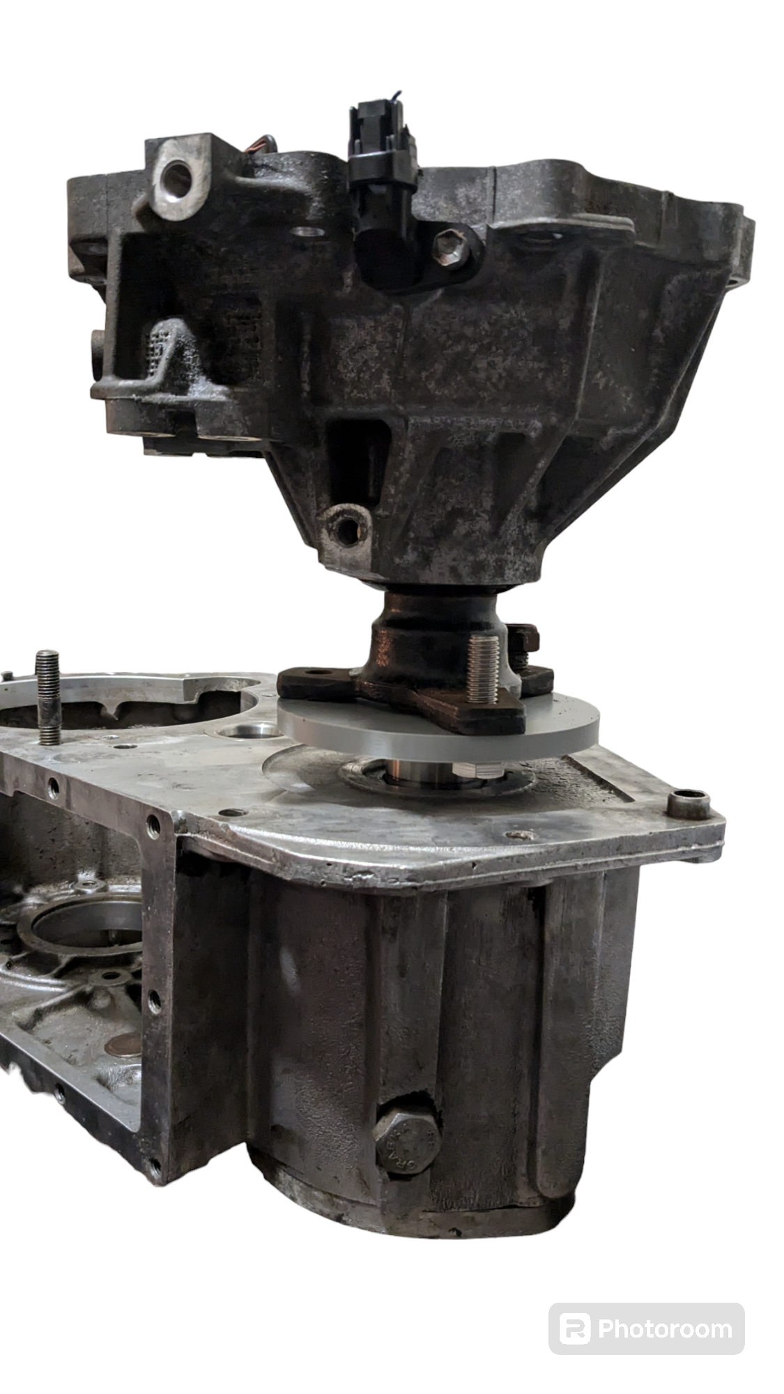

Thanks to Tom I have some scanning data to play with. GS450H should fit nicely in the transmission tunnel. It does make space a little bit tight in the engine bay but I think I can in theory fit in the 8 modules from a 55kWh VW pack.
Currently working on connecting the GS450H to LT230, I have a rough idea planned out in my head. Going to take a few scans of the back of the GS450H and front of the LT230 and see if I can work something up.
At some point in the next few weeks I'll also get setup to start the chassis welding

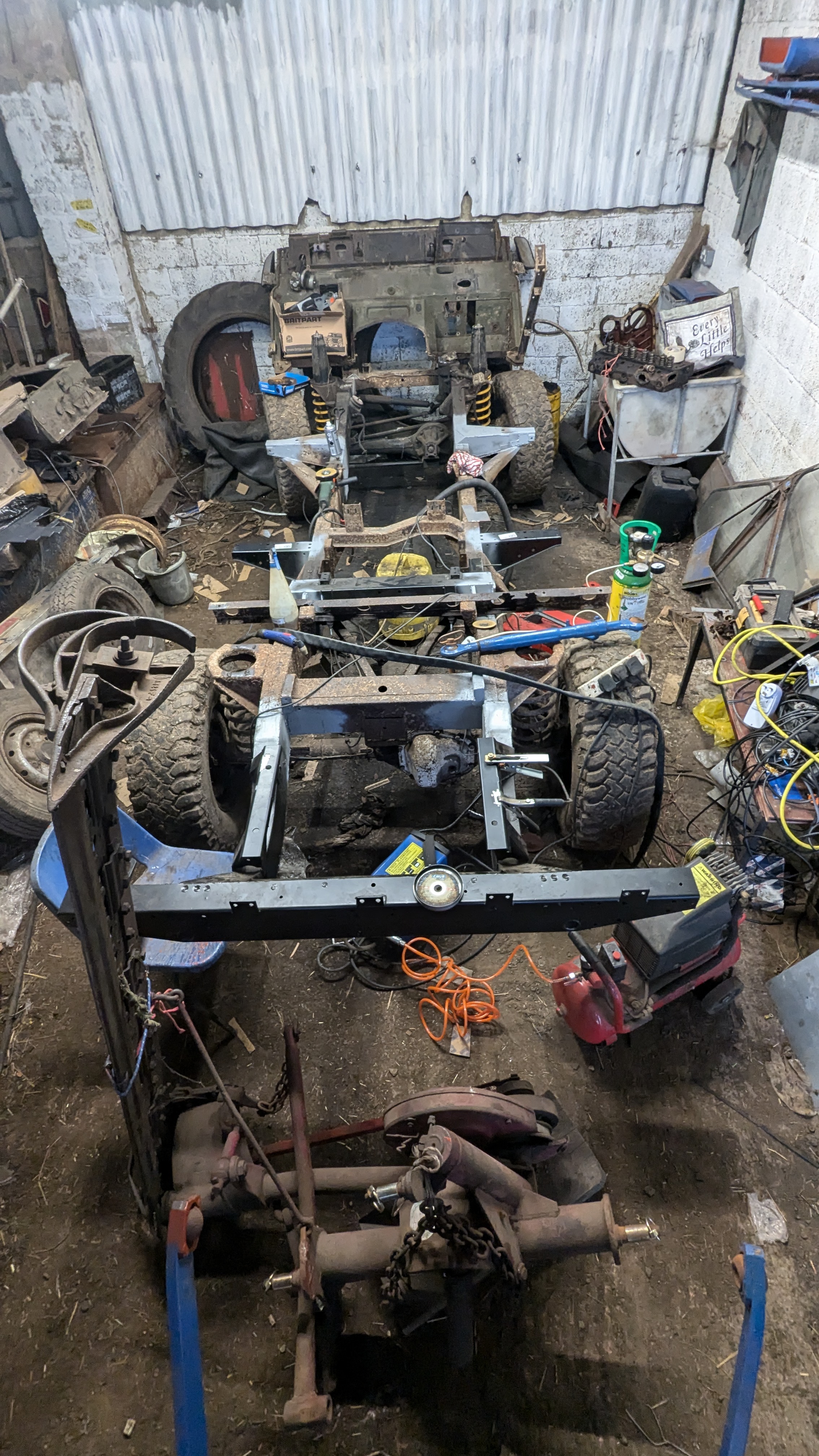

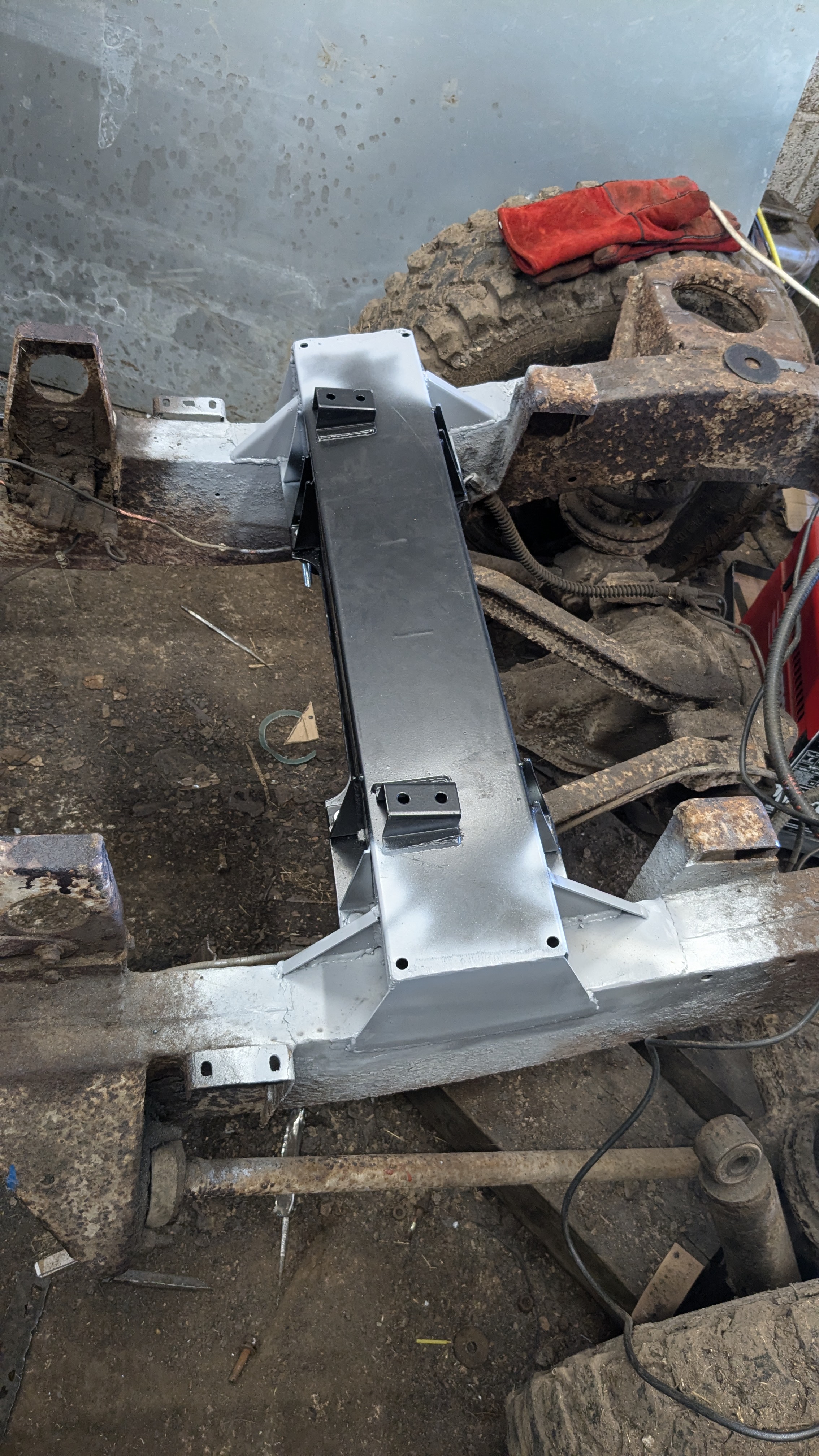

Bit of progress on the Land Rover this week. Got the rear cross member attached with just a little more welding to do to finish it off. Then I can move onto the more complicated A Arm cross member.
I have also made some progress connecting the GS450H gearbox to the LT230. I think I have shaft adaptors pretty much there. Just need to connect the two boxes.
I have a decent bolt pattern for the LT230 thanks to @boltsnjolts on Instagram who generously let me have the datum points for an adaptor he made up for his Series 2 conversion. Just need to do the same for the GS end now.

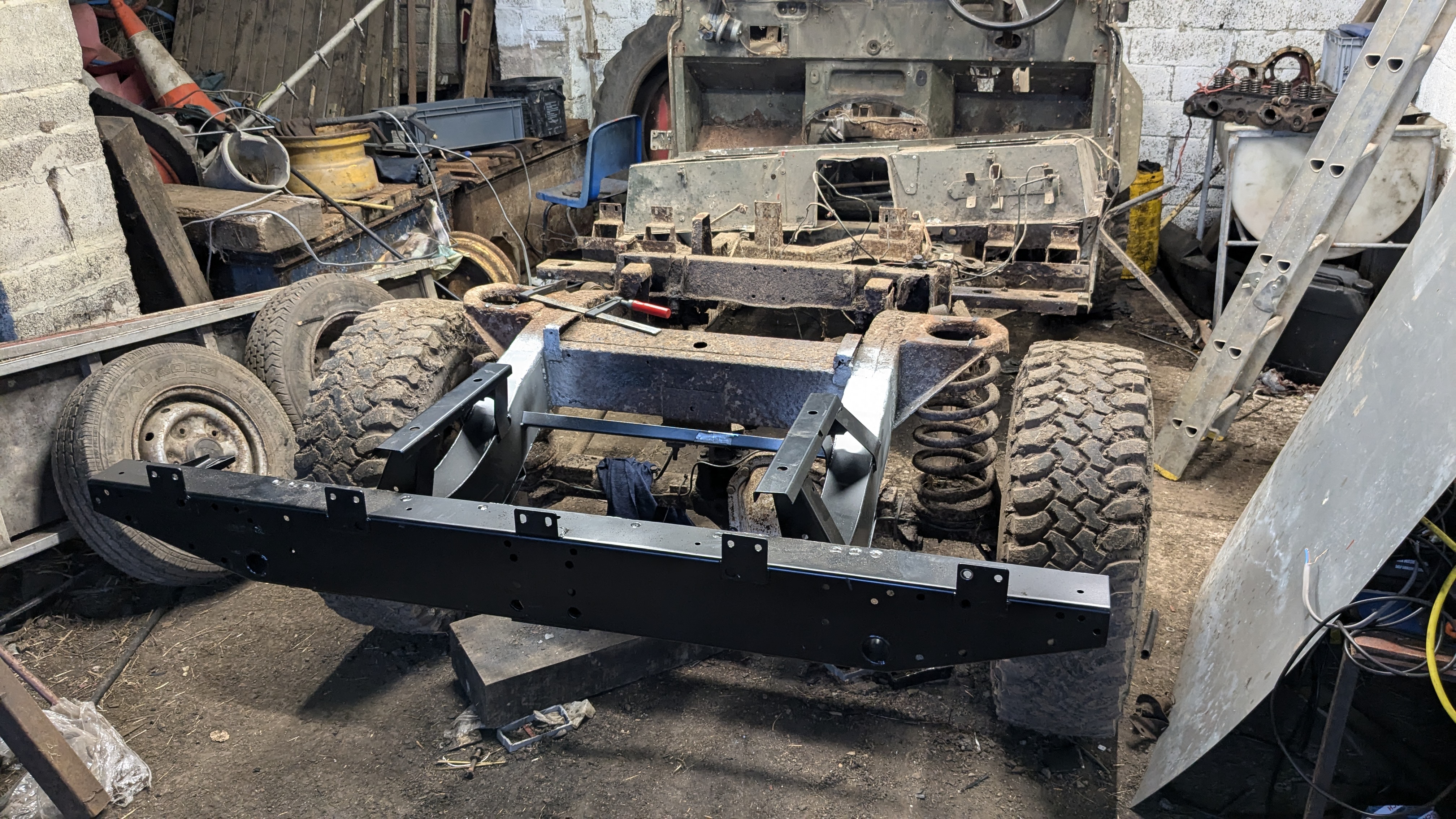

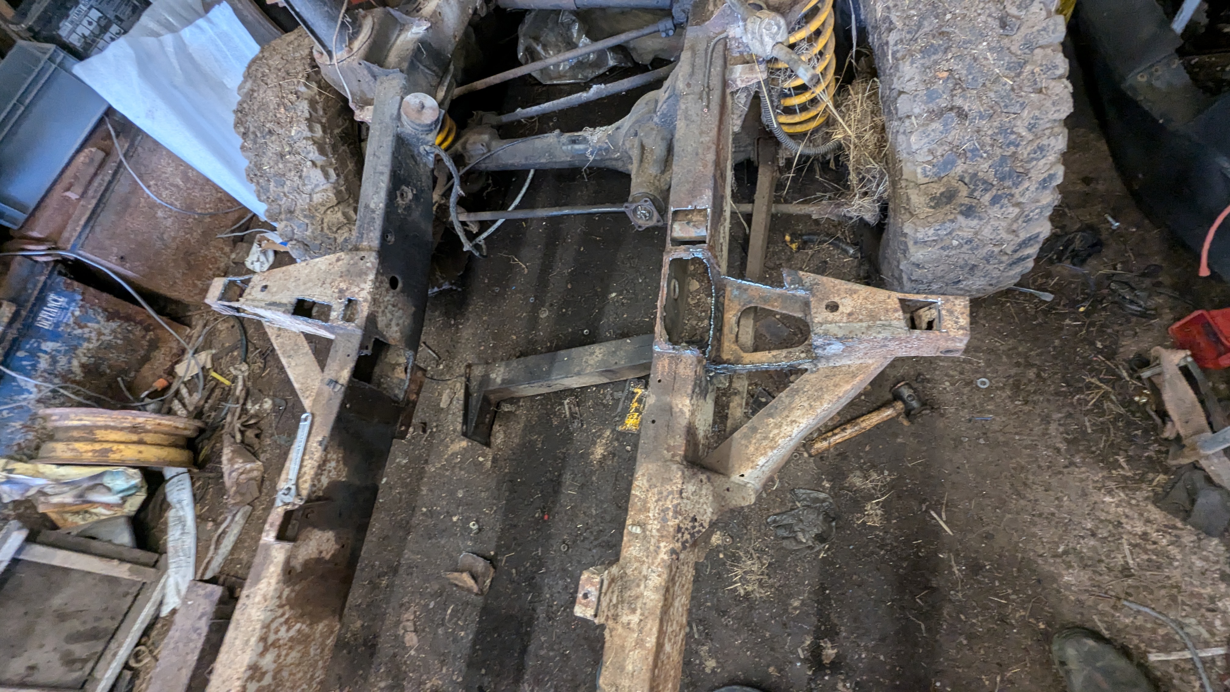

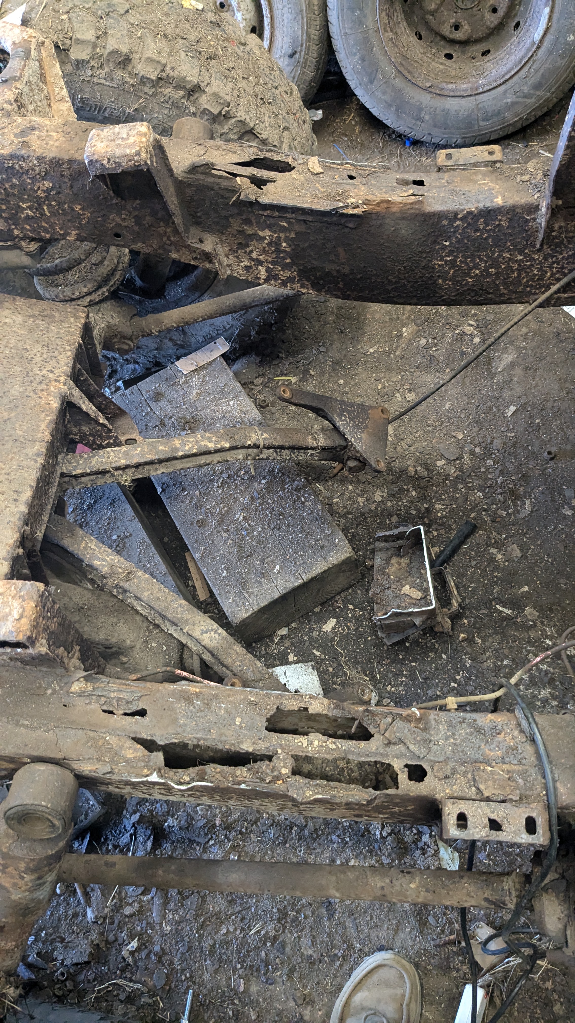

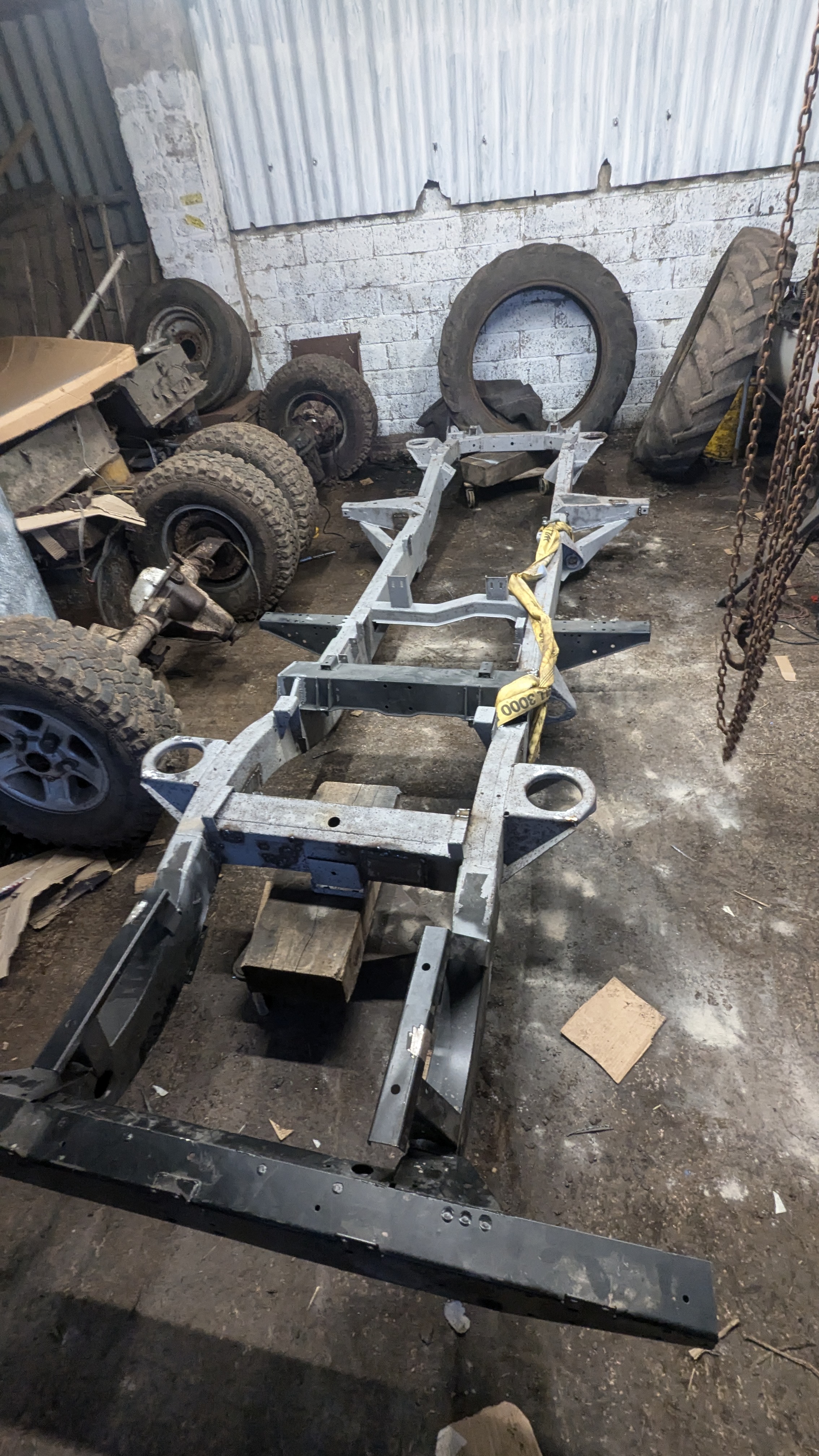

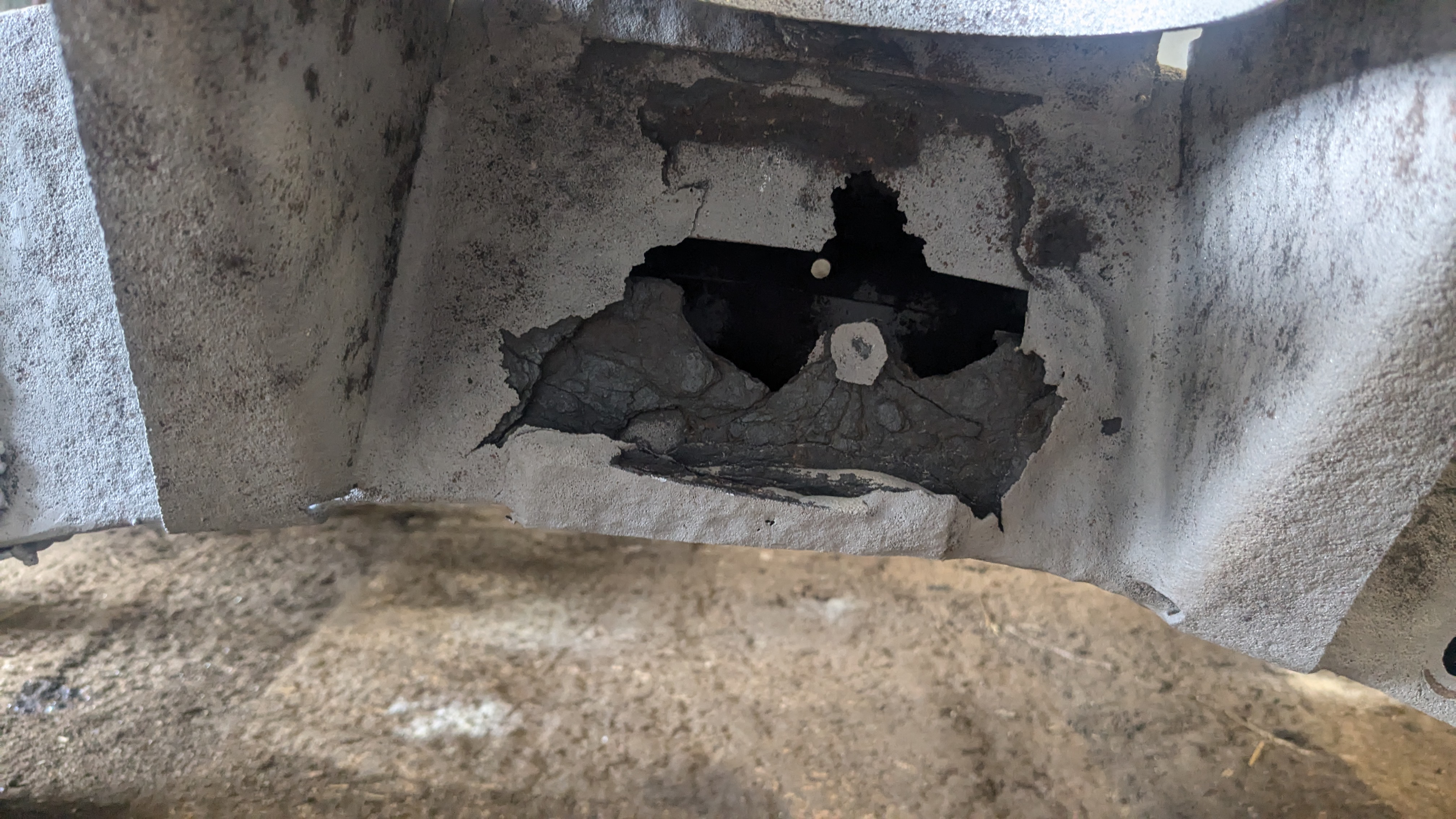

Lots of rust, lots of cutting, lots of welding. Still more rust.
Started to use my plasma cutter for this project and it's made things a bit quicker and slightly more pleasant than constantly filling the air with grinding dust.
Finished with what I thought was the last of the big repairs and was just expecting some patching. However the rear tub outriggers are pretty far gone so I think I will cut those off and weld on new ones. The bulkhead outriggers are also quite bad but have rusted in places that I can patch up. I also found a botched repair hiding under the gearbox cross member.

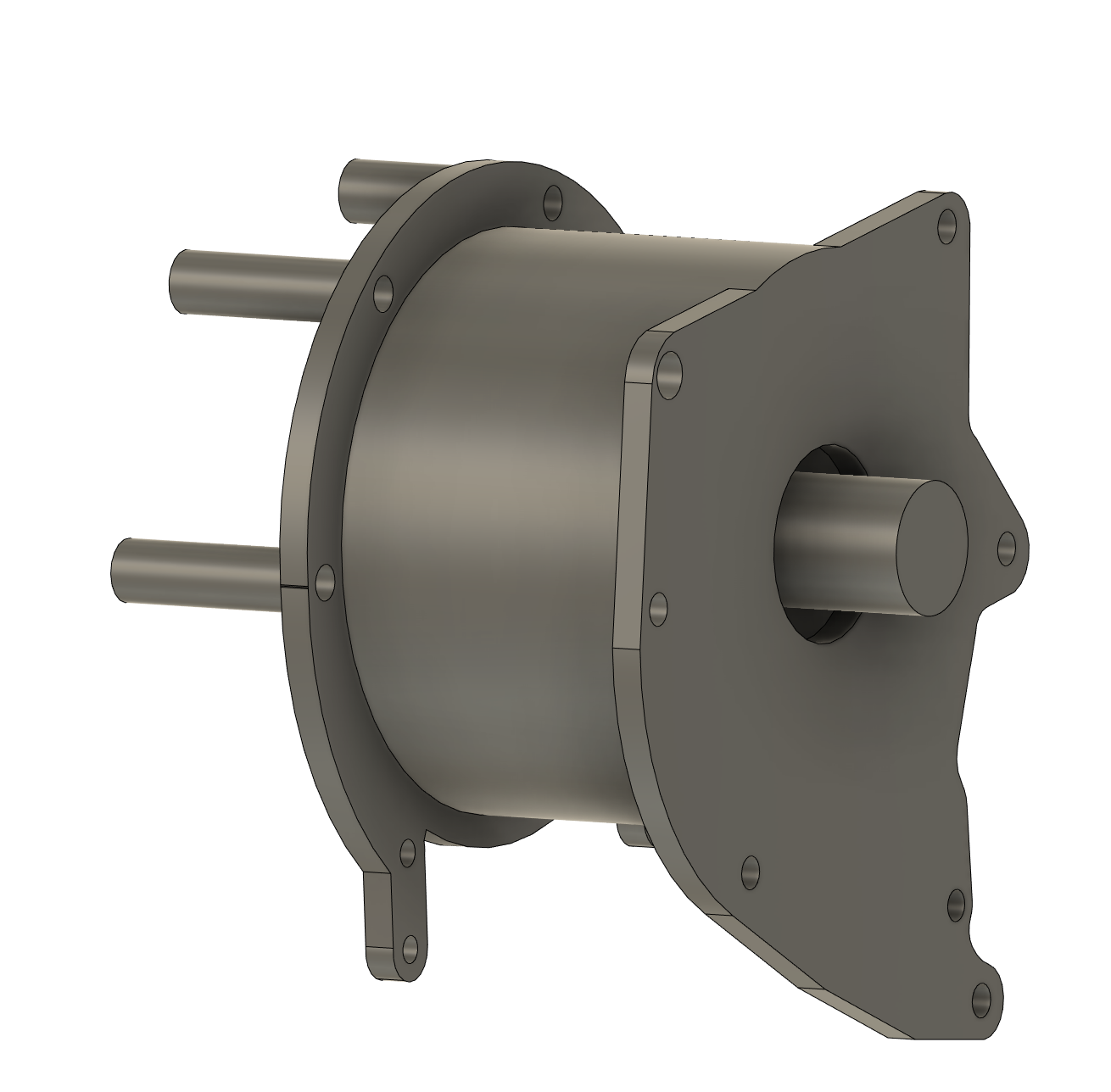

On the motor adaptor front I have been in discussions with a company called Landy Luvver down in South Africa who have been very helpful sharing their experience of attaching Lexus auto boxes to LT230s. It's put me off the bulk adaptor I have previously been looking at and going down the route of a solid shaft.
I got the rear end of the GS450H bolt pattern measured via CMM this week so now I have both ends of the puzzle, just need to connect the dots.

Lots of welding done this month. Rebuilt the bulkhead outriggers, replaced the rear body outriggers, a few more patches done.
I also striped the rest of the chassis parts off so the next step in restoration is to take the chassis of the axles, flip it over and then do a tiny bit more welding of course.
On the motor attachment front I have been playing around with the output shaft from a ZF Auto gearbox used in Discoverys. It's not going to be too hard to attach this to a small adaptor plate that the GS450H output flange can bolt into. It's quite a bit short than the first draft of this, I can also add the rubber donut if I wanted too without too much hassle. Then for something to hold it all together, with my bolt patterns for the gearbox and LT230 I just needed to connect the two faces at the right distance. Here is my current draft of this. The plan is for this to bolt to the GS450H, along with the shaft adaptor. Then it will bolt onto the LT230 as per any normal gearbox. Currently I'm not sure if I will actually get this part machined or split it down so I can make it out of spacers and laser cut plates as per the tractor adaptor. I'm going to print it off first and see how it all fit, then make a decision once the dimensions are verified.

So a tiny bit more welding turned into a tiny bit more. Got it sand blasted and we found a little bit more rust.
All done now though, only took 2 replacement outriggers, 2 new crossmembers and 0.5 square meters of sheet steel for patches. Taking it for a final sandblast and powder coat on Friday. Then I'll spray the internals fulls of Lanoguard.
After that I'll hang it up to one side as I have another project coming in for someone else which will last a month or two. But at least now I know the chassis is finally solid, once I get my workspace back I can start on the axle refurb and building it all back up again.
