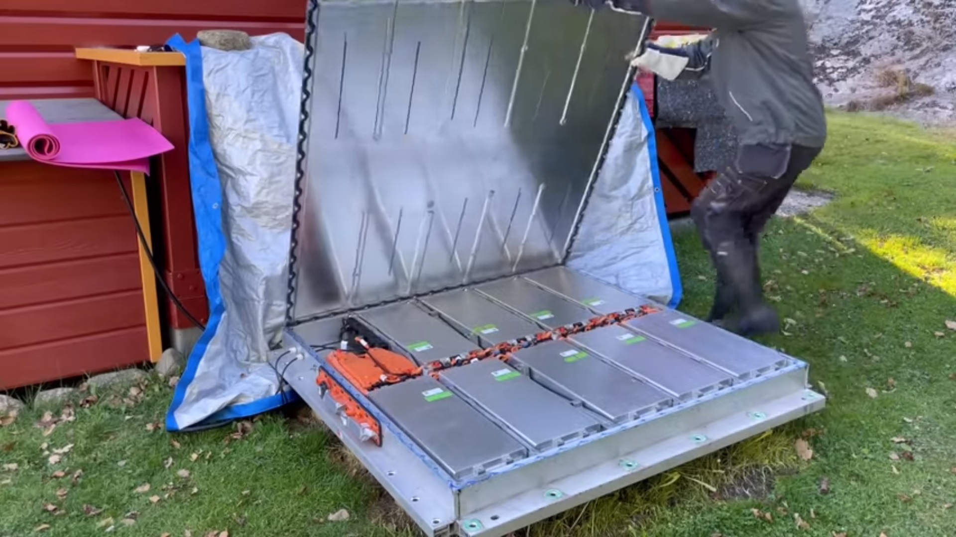

VW ID.3 62kwh Battery Pack Teardown
Gregski
Posts: 3164
Has thanked: 635 times
Been thanked: 1610 times
Post by Gregski »
this gentlemen does a proper 2021 VW ID.3 62kwh Battery Pack Teardown, hope you enjoy
Configuaration
  • 108 Cells
  • 450 Volts

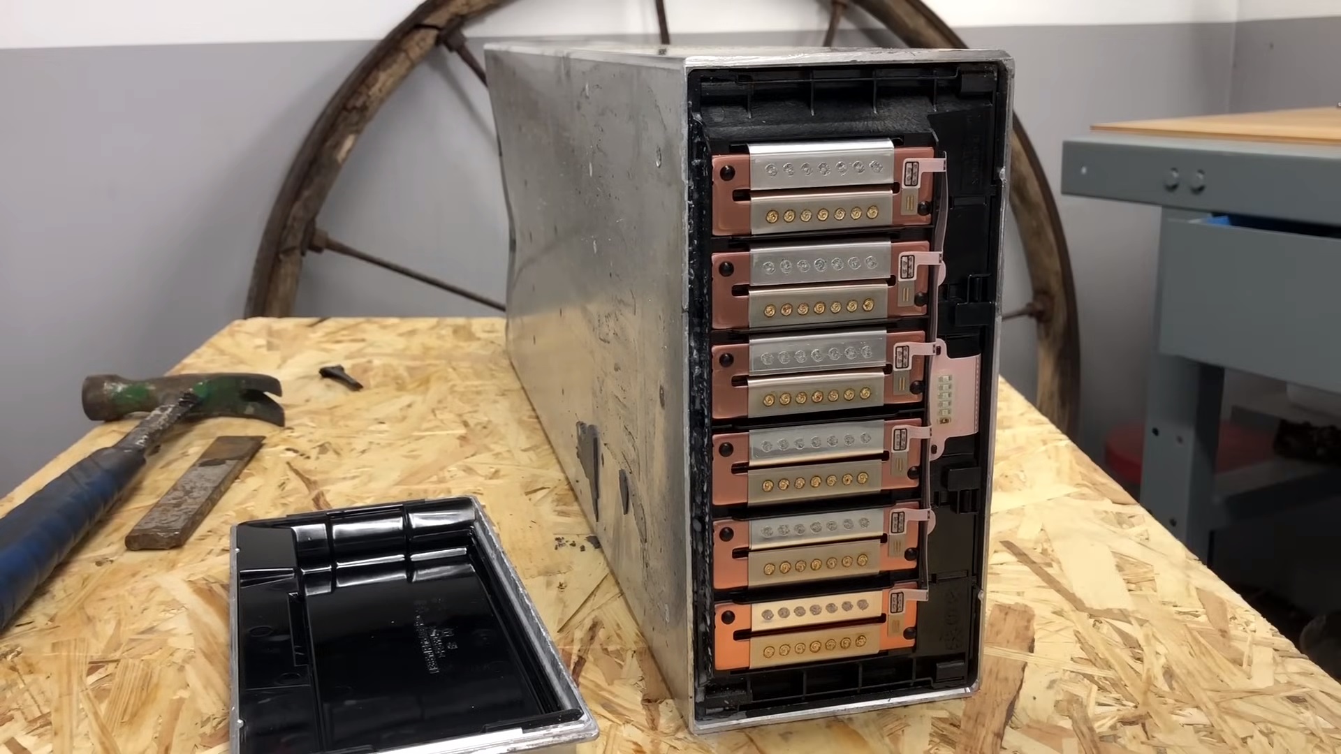

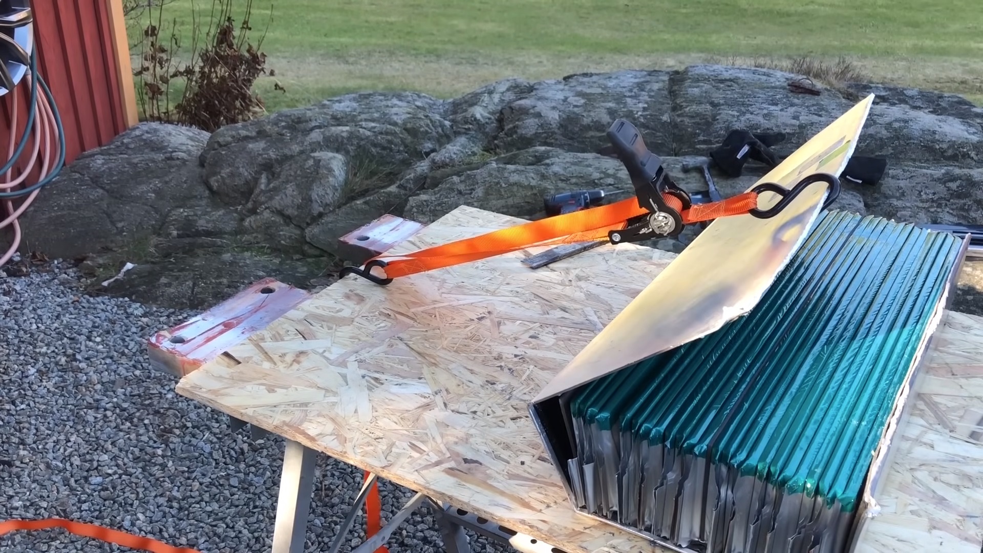

Open up a VW id3 id4 lithium battery module.
Posts: 3796
Been thanked: 413 times
Re: VW ID.3 62kwh Battery Pack Teardown
Gregski wrote: Mon Nov 20, 2023 2:46 am Open up a VW id3 id4 lithium battery module.
Yeah... i just managed to burn some fuses in my modules. I will have to cut those modules and then figure out how to fix them in place since i will be cutting the back flange off...
After i repair the fuse i intend to glue the block back but for sure it wont be able to carry 30kg!!!
