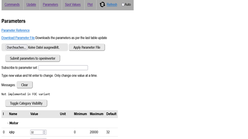

Just switched on ,the new board Toyota Prius Gen2 reports : NOT implemented in FOC variant .
What shall be set or done to set the just FOC variant?

Re: Toyota Prius Gen2 board reports NOT implemented in FOC variant
It reports "not implemented"? Please post a screenshot of what you mean
Here is screenshot of the programm message.
Oh I get it, you're trying to run in manual mode. Yes that no longer exists, there is only normal run mode in FOC.
If you want to do the basic setup just flash stm32_sine.bin which you find here: https://github.com/jsphuebner/stm32-sine/releases
If you want to do actual FOC setup just start in normal mode and use manualiq/id as before

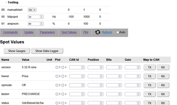

FAILED OPEN LOOP & TUNING with the new 5.32R sine/foc
By misfortune I damaged my well running ToyotaPrius2 board.
With this board I was able to get syncofs stop and run the motor at ease.
But now with the new board replacement and the newest 5.32R sine/fos.bin files I am unable to perform even the Open Loop test.
There is any light flashing and motor turns ,no matter of fact which value you set manualud/manualiq.
I am able to map the pot but not the angle. The three phase terminals on the controller reeds 3.6V each.
I am exhausted with testing and testing, leading to no result.
What else should I do, to get to the correct procedure.

Re: FAILED OPEN LOOP & TUNING with the new 5.32R sine/foc
Sorry to hear this. And if you go back to earlier version it works?
While testing download the result of http://192.168.4.1/cmd?cmd=json and upload the result as a text file here

- Posts: 6711
- Has thanked: 368 times
- Been thanked: 1541 times
In this dump opmode is off so no PWM is generated. As long as you're doing basic checks use sine software not foc
- Posts: 61
- Joined: Mon Jan 03, 2022 11:34 am
- Has thanked: 21 times
It is also a not big help.Do`t change anything.I am able to map the pot but not the angle.No lamps are blinking or motor turning.
Should be some other reason ,but which one ?
- Posts: 6711
opmode is still off, set udcsw to 0 to be able to start.
Alternatively, flash some older software with the known behaviour and manual mode: https://github.com/jsphuebner/stm32-sin ... ag/v4.97.R
- Posts: 61
Just performed a test with the 4.97R version.
Set UDCSW to zero, but again opmode is off, all lamps dark but able to map pot.
Any idea which setting is wrong?
