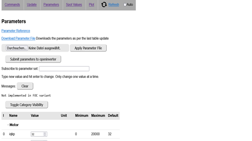

Just switched on ,the new board Toyota Prius Gen2 reports : NOT implemented in FOC variant .
What shall be set or done to set the just FOC variant?
Thanks in advance !
Thanks in advance !

It reports "not implemented"? Please post a screenshot of what you mean

Re: Toyota Prius Gen2 board reports NOT implemented in FOC variant
Here is screenshot of the programm message.
- Been thanked: 1914 times
Oh I get it, you're trying to run in manual mode. Yes that no longer exists, there is only normal run mode in FOC.
If you want to do the basic setup just flash stm32_sine.bin which you find here: https://github.com/jsphuebner/stm32-sine/releases
If you want to do actual FOC setup just start in normal mode and use manualiq/id as before

"idlethrotlim": {"unit":"%","id":65,"value":50.00,"isparam":true,"minimum":0.00,"maximum":100.00,"default":50.00,"category":"Automation","i":68},
"idlemode": {"unit":"0=Always, 1=NoBrake, 2=Cruise, 3=Off, 4=HillHold","id":66,"value":3.00,"isparam":true,"minimum":0.00,"maximum":4.00,"default":3.00,"category":"Automation","i":69},
"holdkp": {"unit":"","id":138,"value":-0.25,"isparam":true,"minimum":-100.00,"maximum":0.00,"default":-0.25,"category":"Automation","i":70},
"speedkp": {"unit":"","id":53,"value":0.25,"isparam":true,"minimum":0.00,"maximum":100.00,"default":0.25,"category":"Automation","i":71},
"speedflt": {"unit":"","id":57,"value":5.00,"isparam":true,"minimum":0.00,"maximum":16.00,"default":5.00,"category":"Automation","i":72},
"cruisemode": {"unit":"0=Off, 1=Switch, 2=CAN, 3=ThrottlePot","id":62,"value":0.00,"isparam":true,"minimum":0.00,"maximum":3.00,"default":0.00,"category":"Automation","i":73},
"cruisethrotlim": {"unit":"%","id":155,"value":50.00,"isparam":true,"minimum":0.00,"maximum":100.00,"default":50.00,"category":"Automation","i":74},
"udcsw": {"unit":"V","id":20,"value":330.00,"isparam":true,"minimum":0.00,"maximum":1000.00,"default":330.00,"category":"Contactor Control","i":75},
"udcswbuck": {"unit":"V","id":80,"value":540.00,"isparam":true,"minimum":0.00,"maximum":1000.00,"default":540.00,"category":"Contactor Control","i":76},
"tripmode": {"unit":"0=AllOff, 1=DcSwOn, 2=PrechargeOn, 3=AutoResume","id":86,"value":0.00,"isparam":true,"minimum":0.00,"maximum":3.00,"default":0.00,"category":"Contactor Control","i":77},
"bootprec": {"unit":"0=Off, 1=On, 2=na","id":135,"value":0.00,"isparam":true,"minimum":0.00,"maximum":1.00,"default":0.00,"category":"Contactor Control","i":78},
"pwmfunc": {"unit":"0=tmpm, 1=tmphs, 2=speed, 3=speedfrq","id":58,"value":0.00,"isparam":true,"minimum":0.00,"maximum":3.00,"default":0.00,"category":"Aux PWM","i":79},
"pwmgain": {"unit":"","id":40,"value":100.00,"isparam":true,"minimum":-100000.00,"maximum":100000.00,"default":100.00,"category":"Aux PWM","i":80},
"pwmofs": {"unit":"dig","id":41,"value":0.00,"isparam":true,"minimum":-65535.00,"maximum":65535.00,"default":0.00,"category":"Aux PWM","i":81},
"canspeed": {"unit":"0=125k, 1=250k, 2=500k, 3=800k, 4=1M","id":83,"value":1.00,"isparam":true,"minimum":0.00,"maximum":4.00,"default":2.00,"category":"Communication","i":82},
"canperiod": {"unit":"0=100ms, 1=10ms","id":88,"value":0.00,"isparam":true,"minimum":0.00,"maximum":1.00,"default":0.00,"category":"Communication","i":83},
"nodeid": {"unit":"","id":129,"value":1.00,"isparam":true,"minimum":1.00,"maximum":63.00,"default":1.00,"category":"Communication","i":84},
"controlid": {"unit":"","id":156,"value":63.00,"isparam":true,"minimum":1.00,"maximum":2047.00,"default":63.00,"category":"Communication","i":85},
"controlcheck": {"unit":"0=CounterOnly, 1=StmCrc8","id":157,"value":1.00,"isparam":true,"minimum":0.00,"maximum":1.00,"default":1.00,"category":"Communication","i":86},
"manualstart": {"unit":"0=Off, 1=On, 2=na","id":150,"value":0.00,"isparam":true,"minimum":0.00,"maximum":1.00,"default":0.00,"category":"Testing","i":87},
"manualiq": {"unit":"A","id":151,"value":0.00,"isparam":true,"minimum":-400.00,"maximum":400.00,"default":0.00,"category":"Testing","i":88},
"manualid": {"unit":"A","id":152,"value":0.00,"isparam":true,"minimum":-400.00,"maximum":400.00,"default":0.00,"category":"Testing","i":89},
"version": {"unit":"4=5.32.R-foc","id":2039,"value":4.00,"isparam":false},
"hwver": {"unit":"0=Rev1, 1=Rev2, 2=Rev3, 3=Tesla, 4=BluePill, 5=Prius","id":2036,"value":5.00,"isparam":false},
"opmode": {"unit":"0=Off, 1=Run, 2=ManualRun, 3=Boost, 4=Buck, 5=Sine, 6=AcHeat","id":2000,"value":0.00,"isparam":false},
In this dump opmode is off so no PWM is generated. As long as you're doing basic checks use sine software not foc
