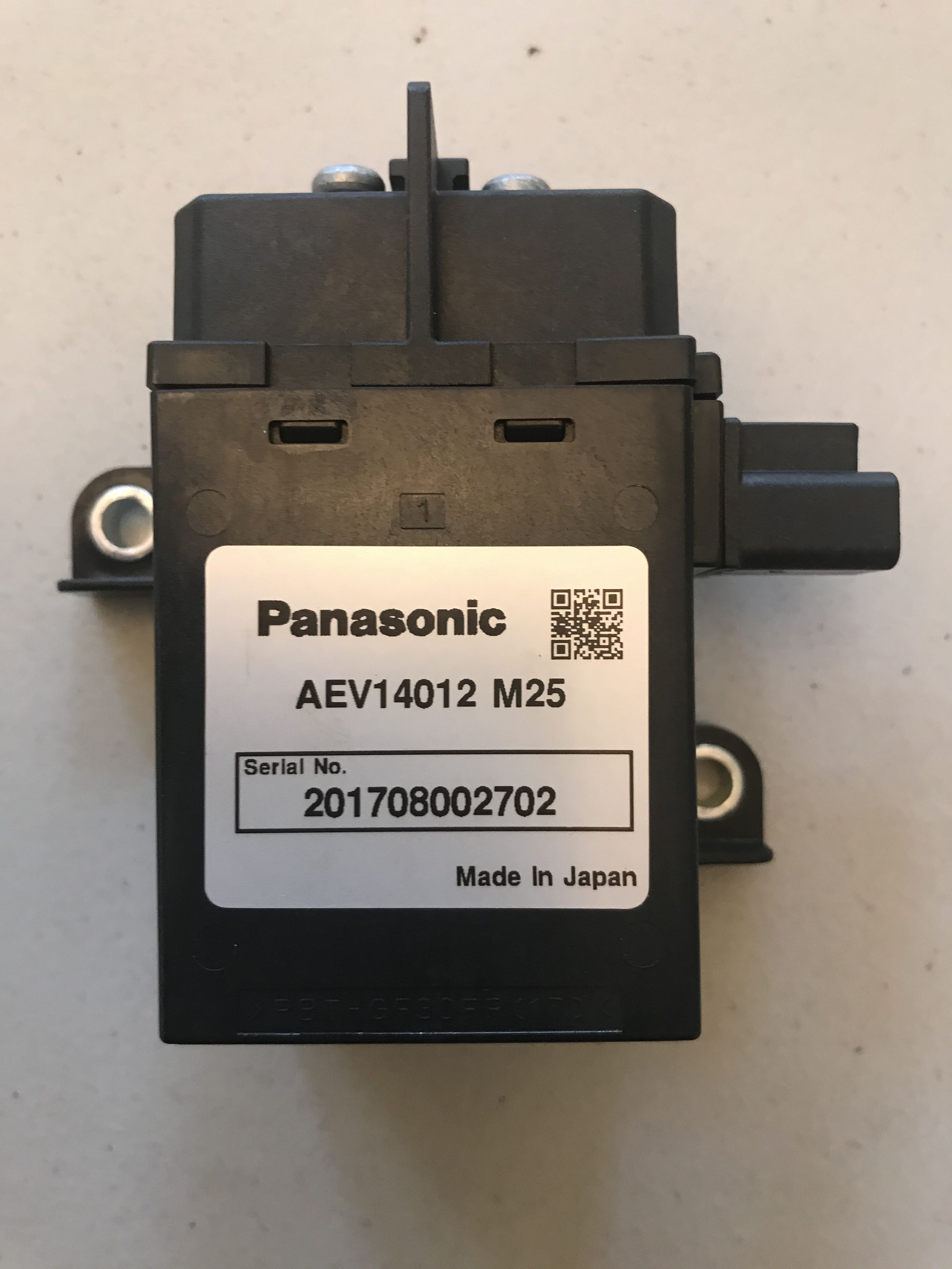

Newb Asks: Hey, what does the inside of a contactor even look like?

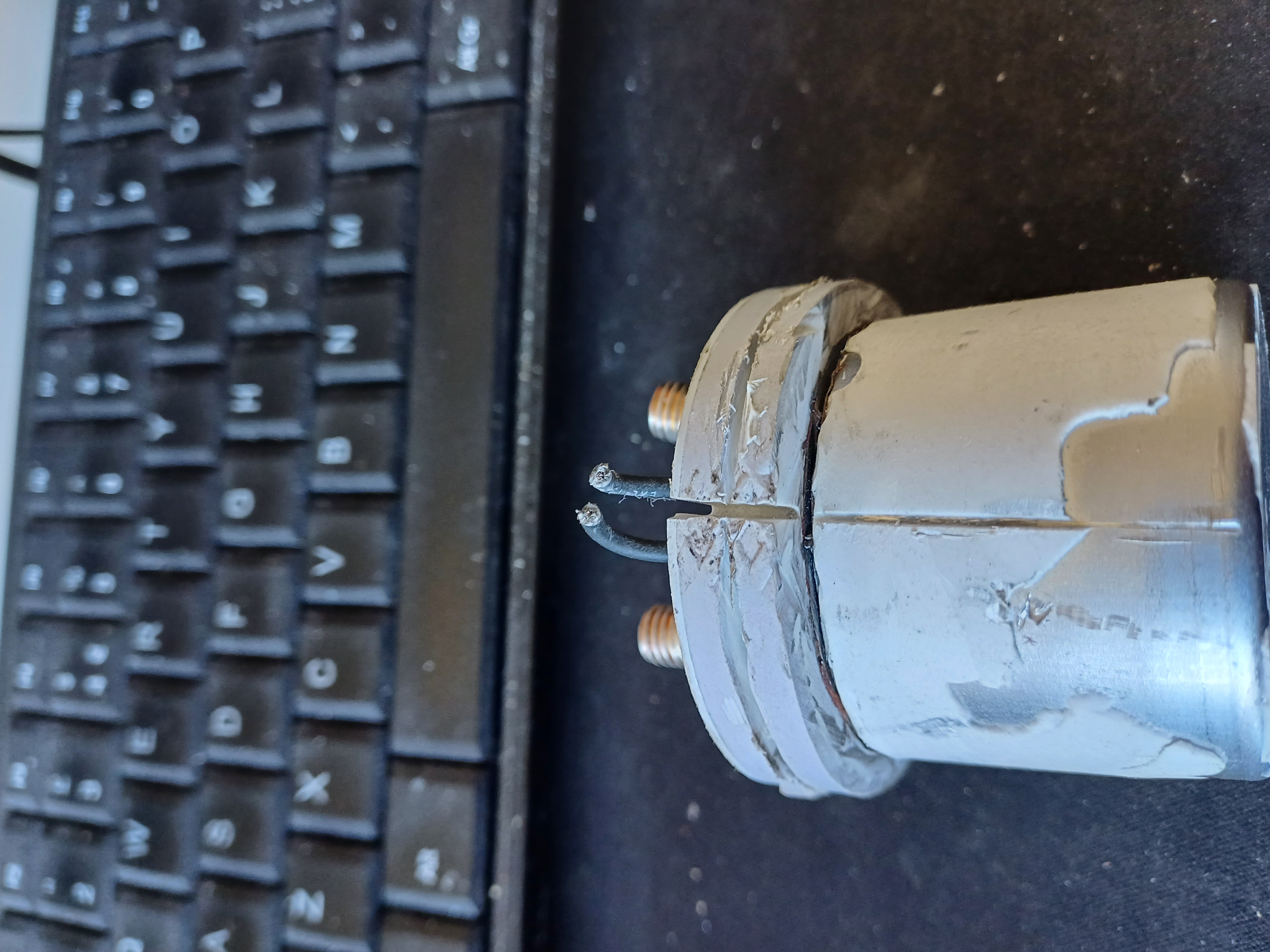

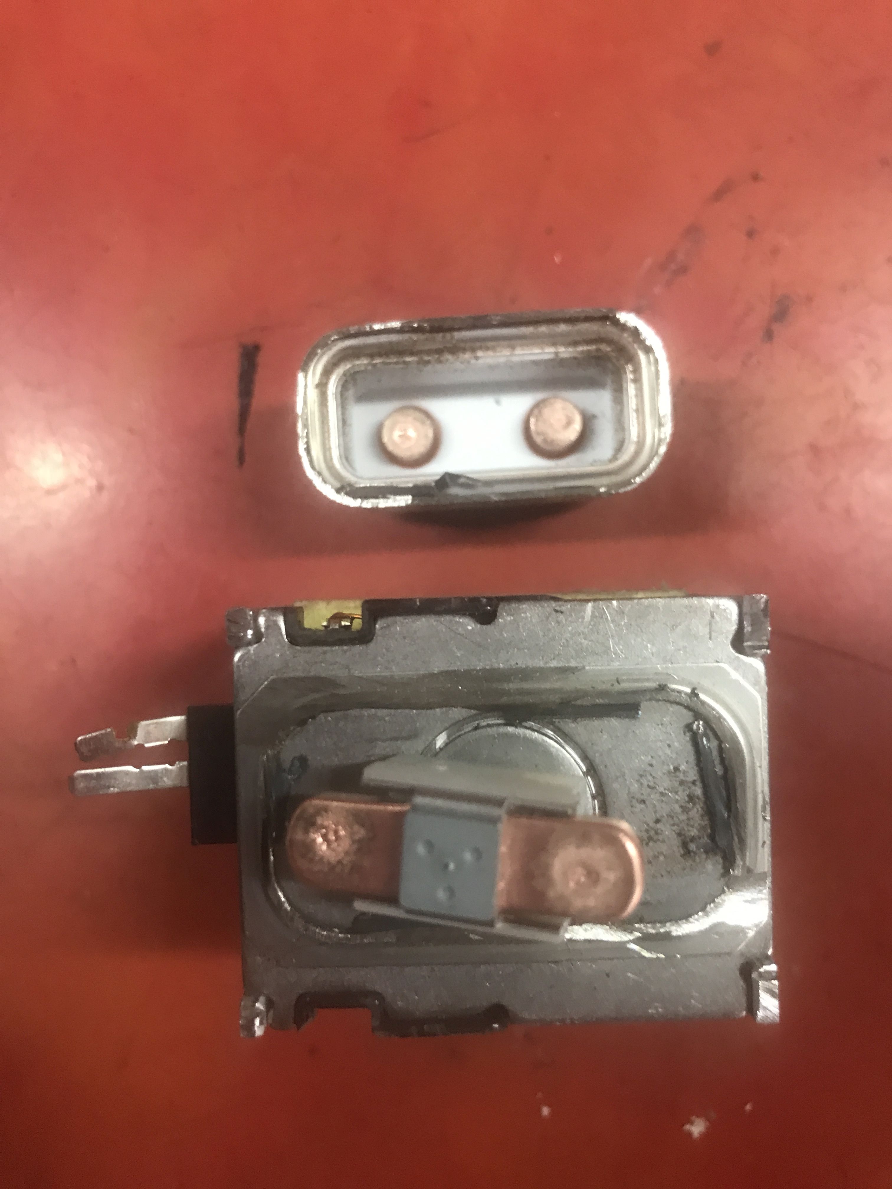

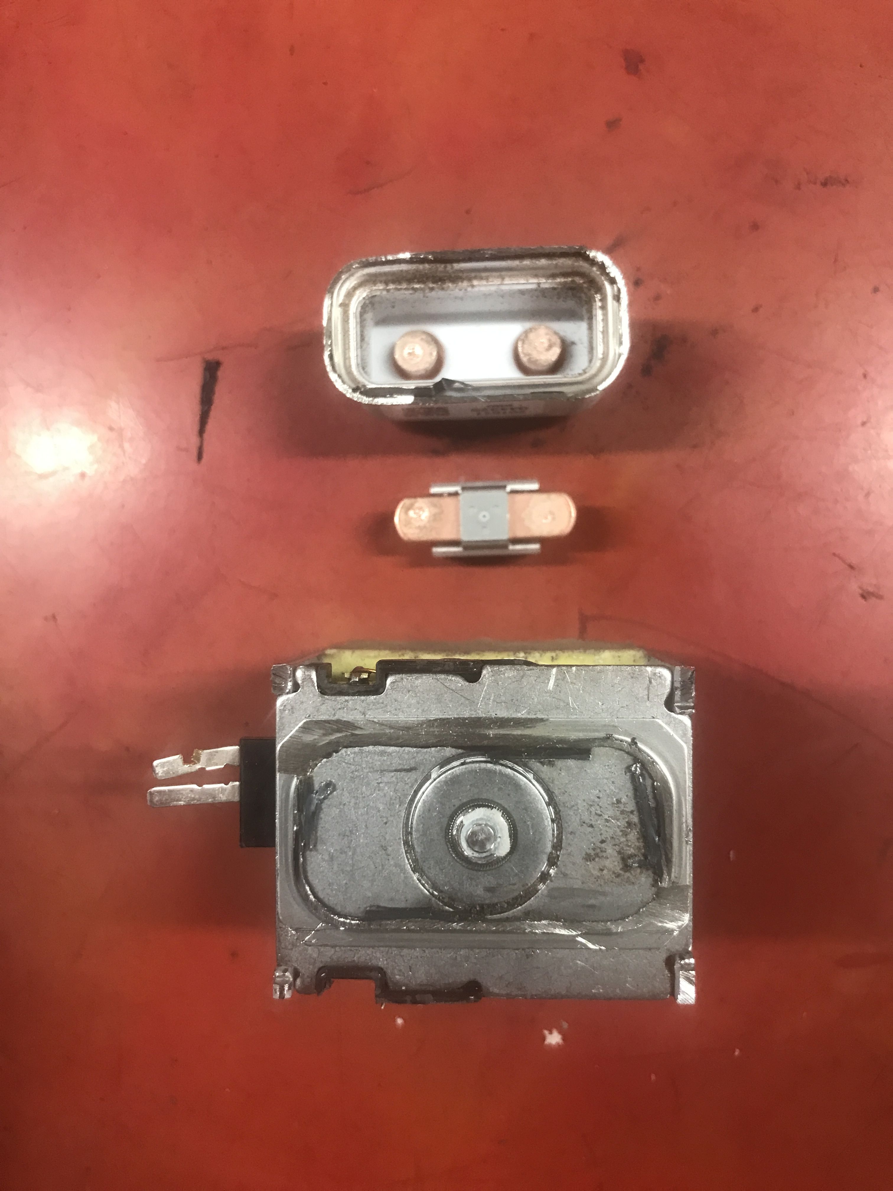

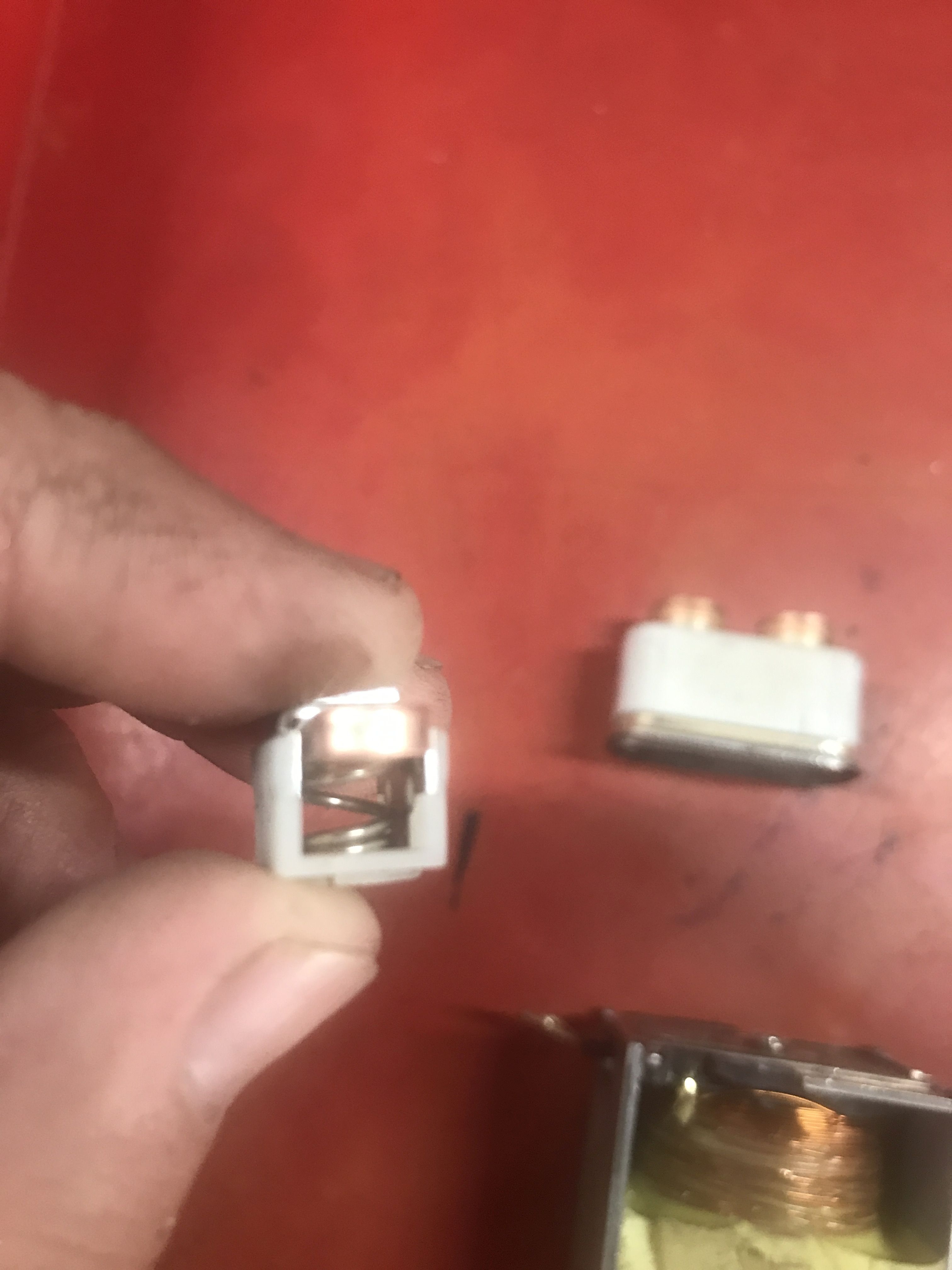

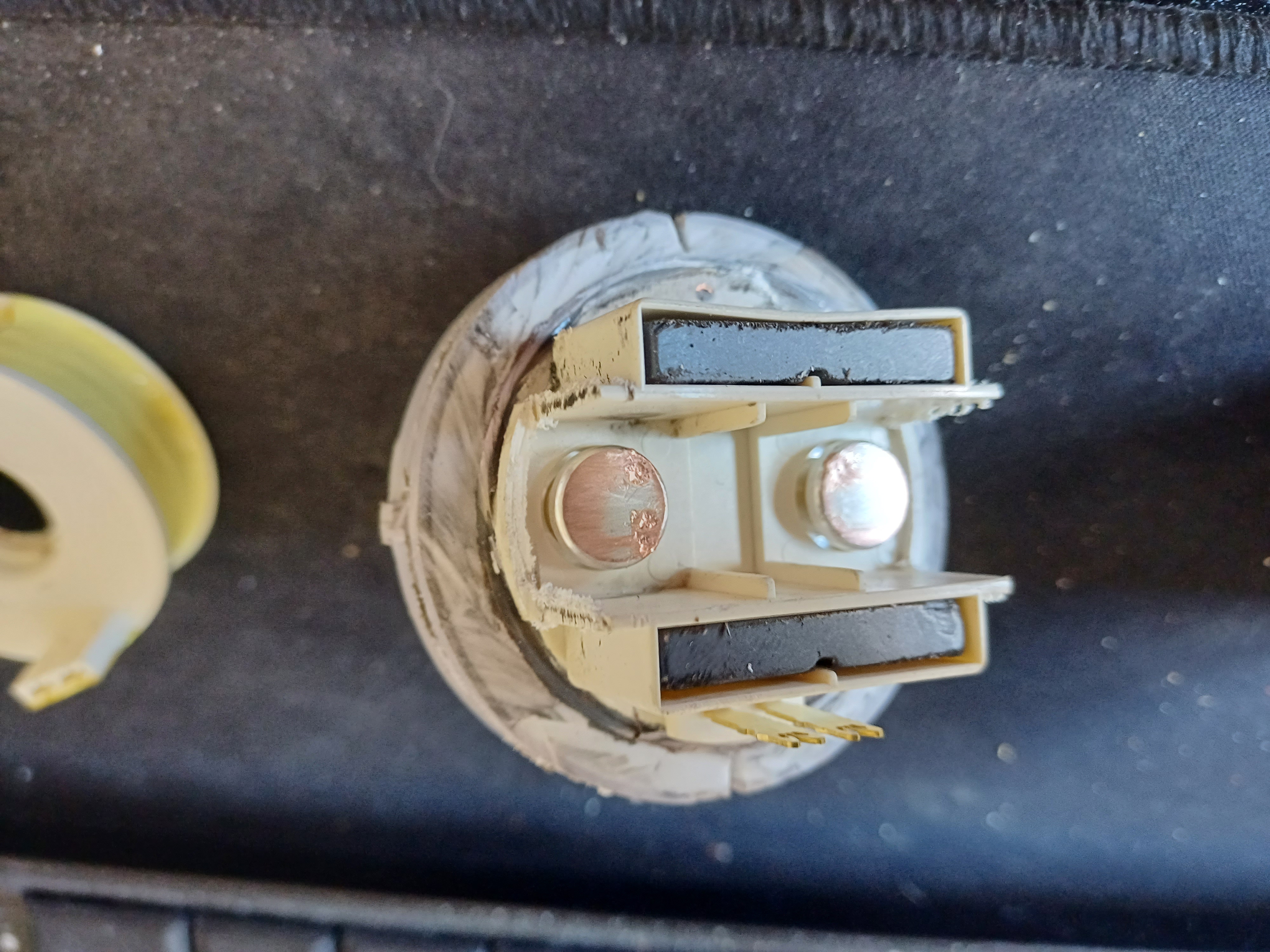

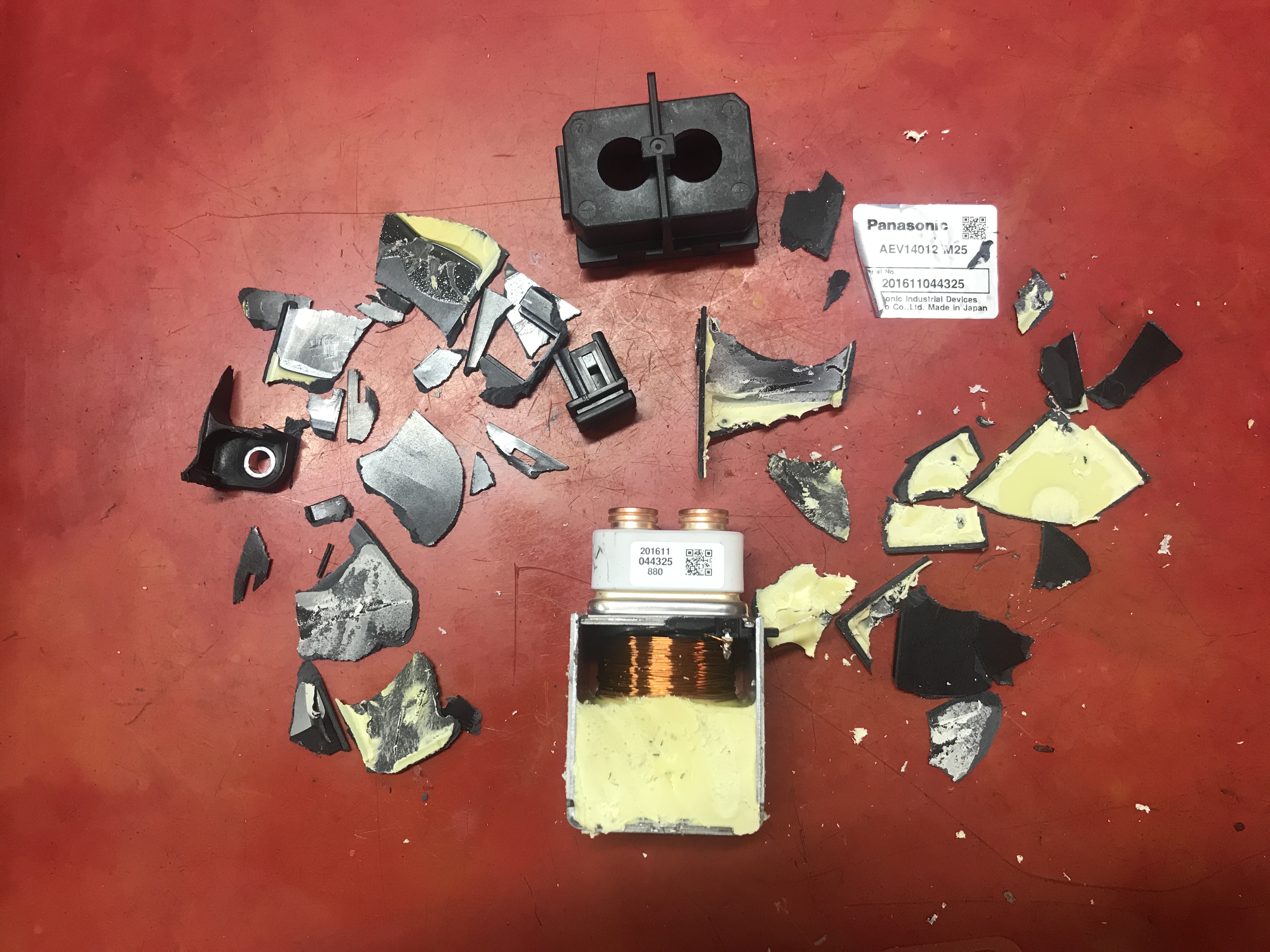

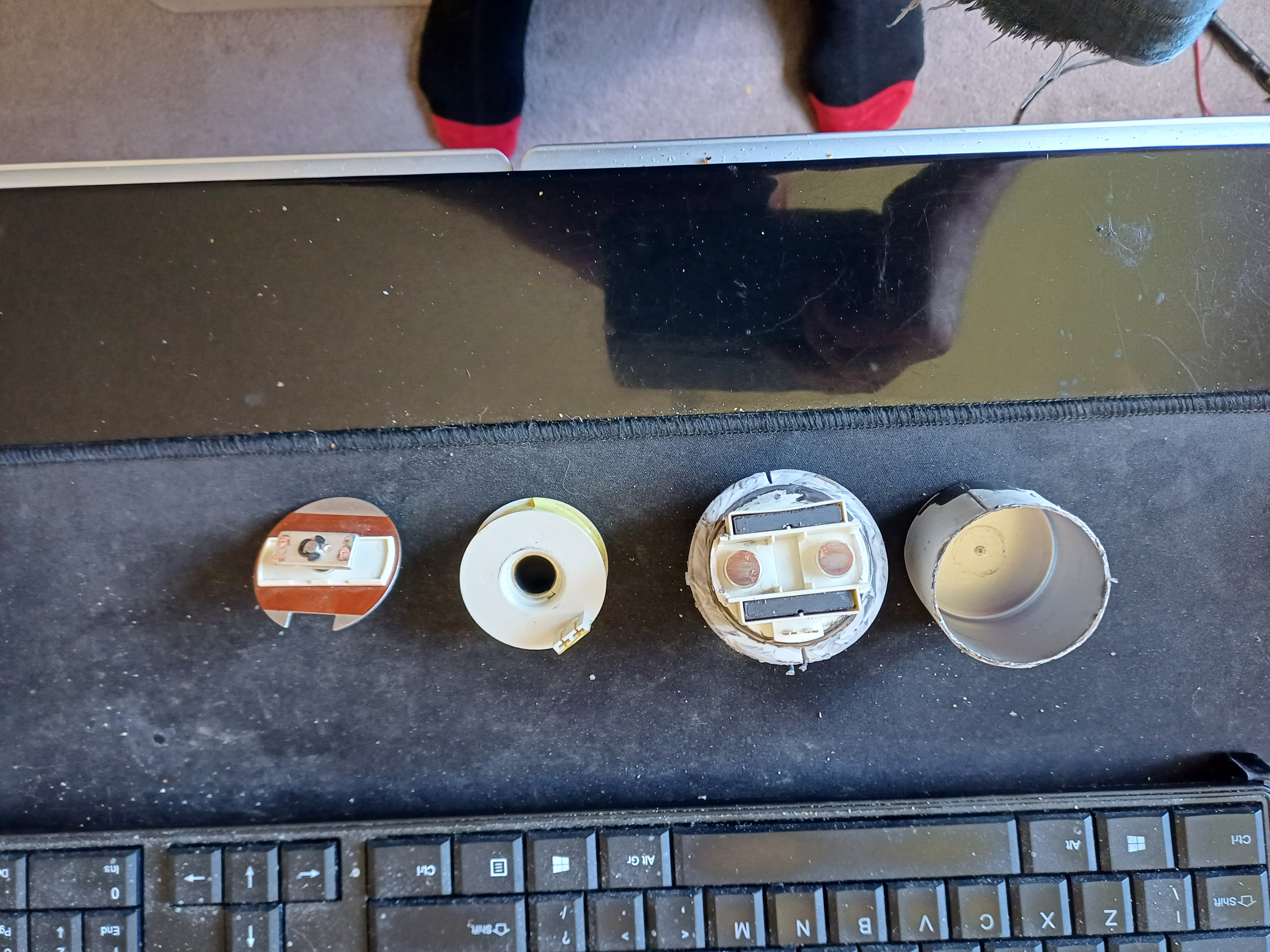

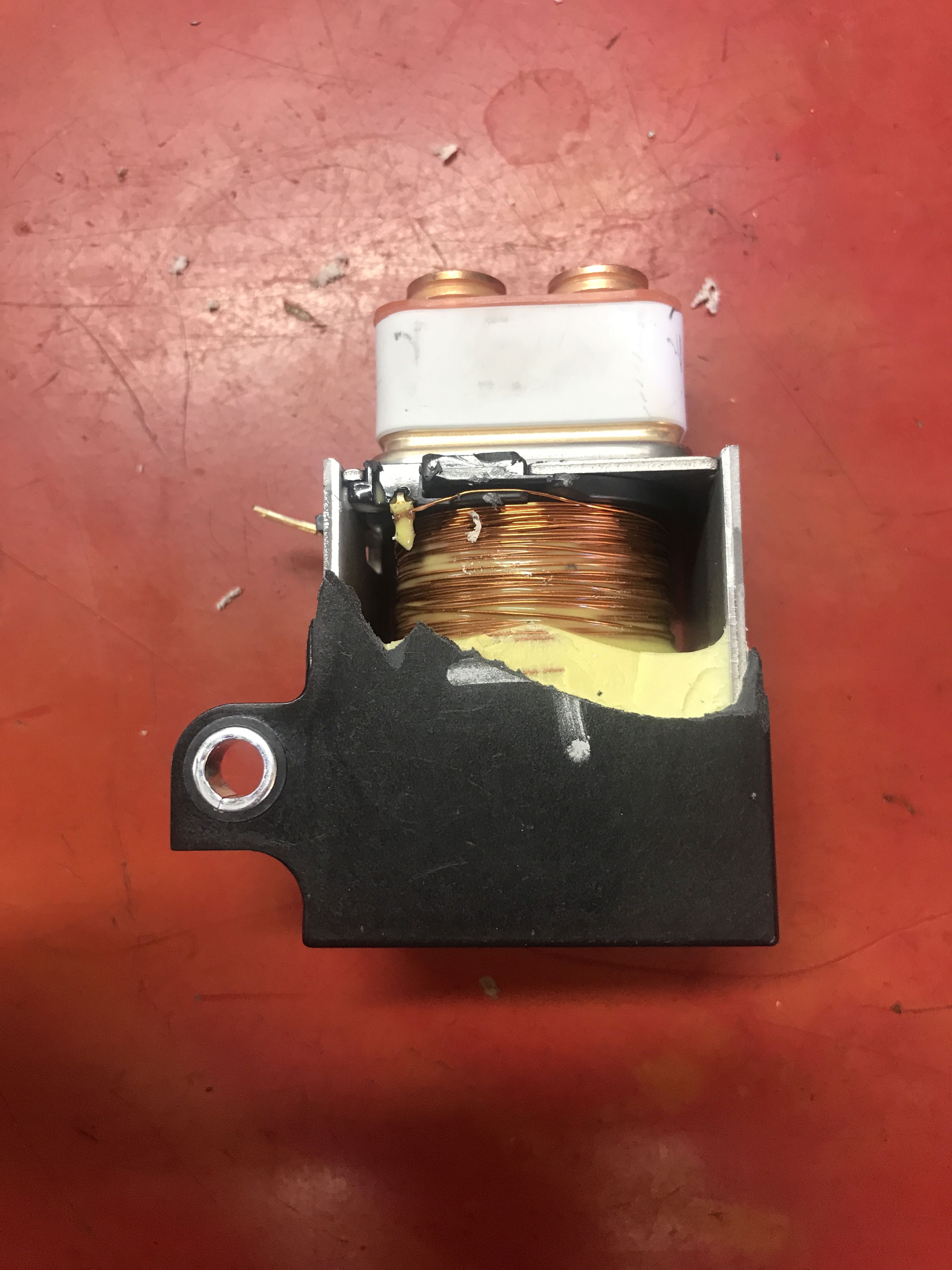

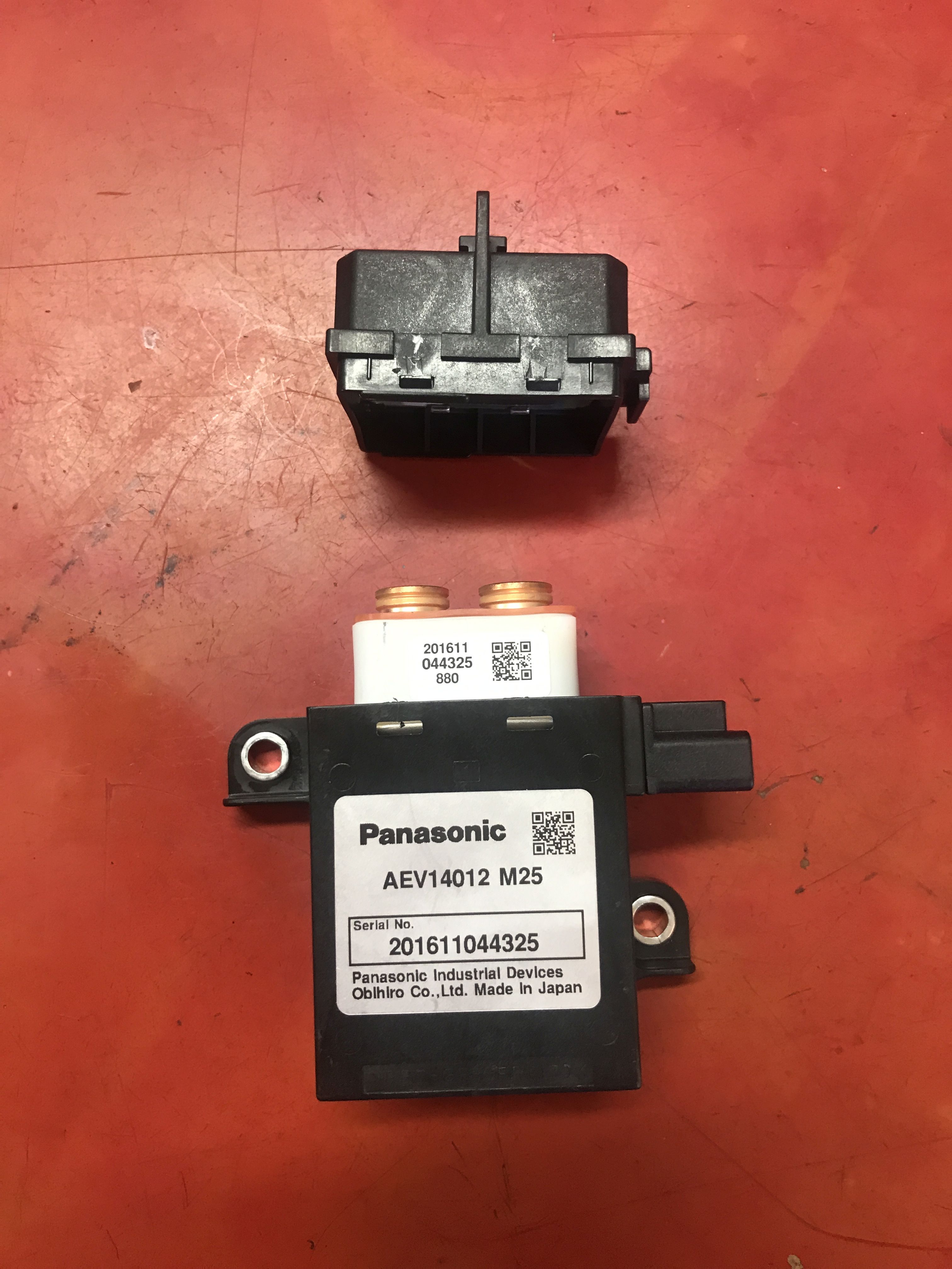

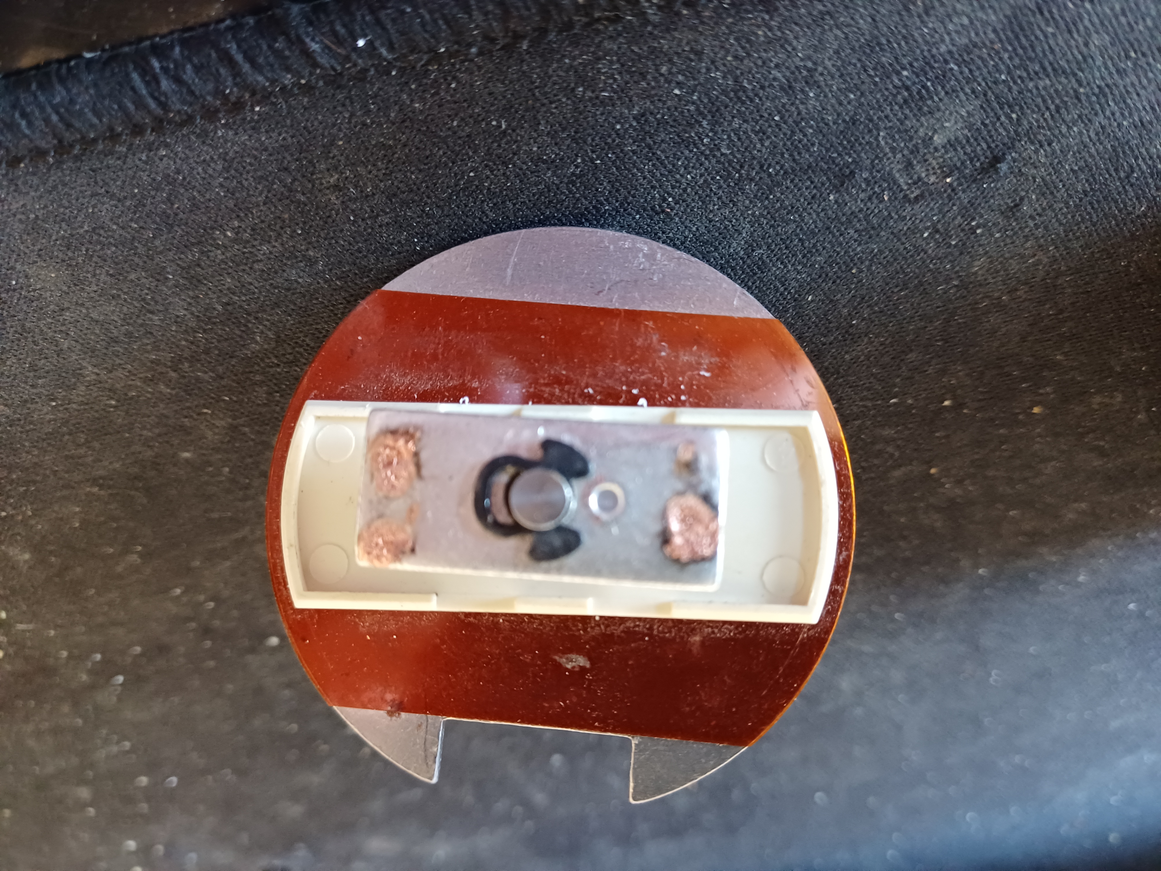

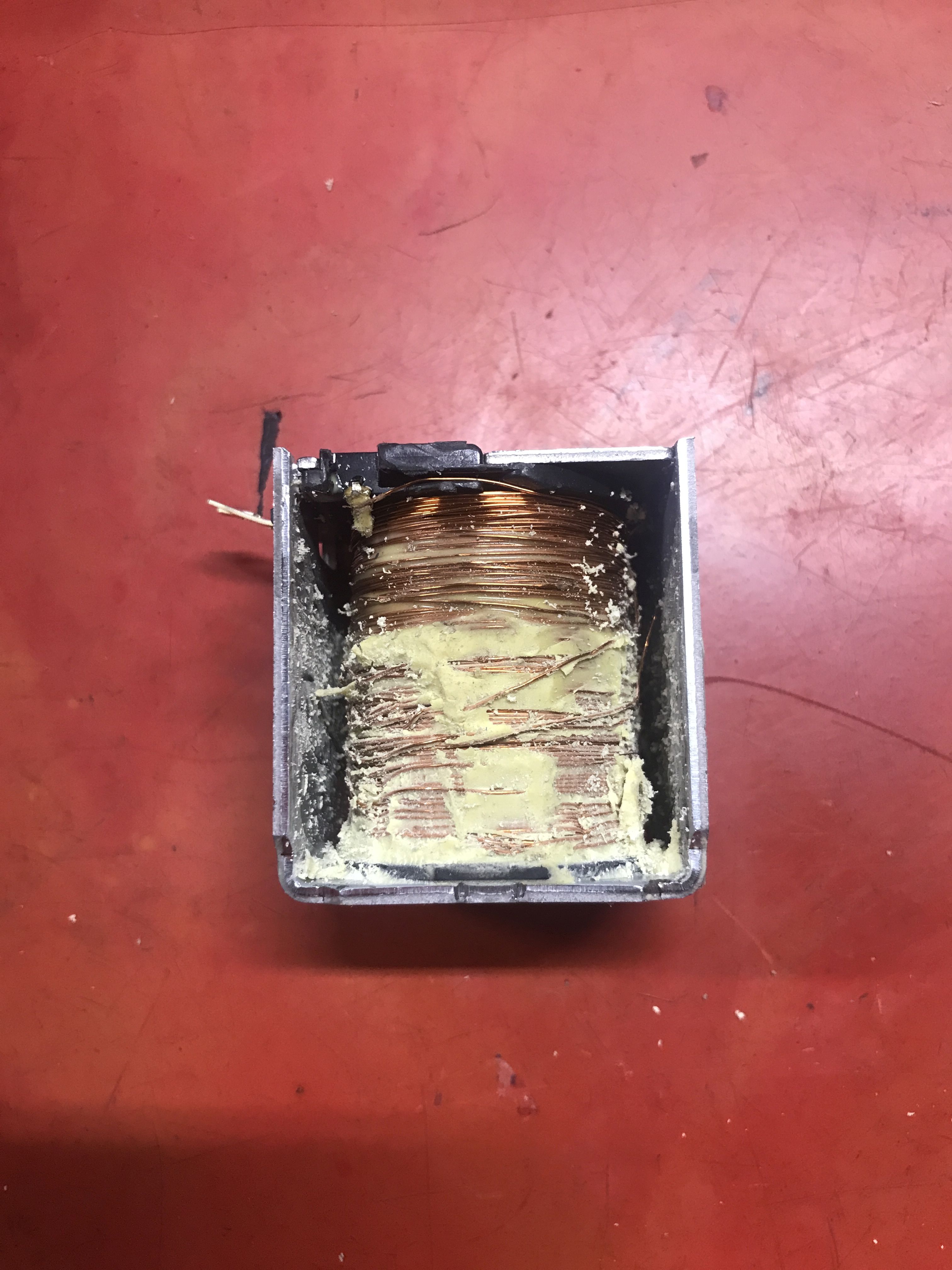

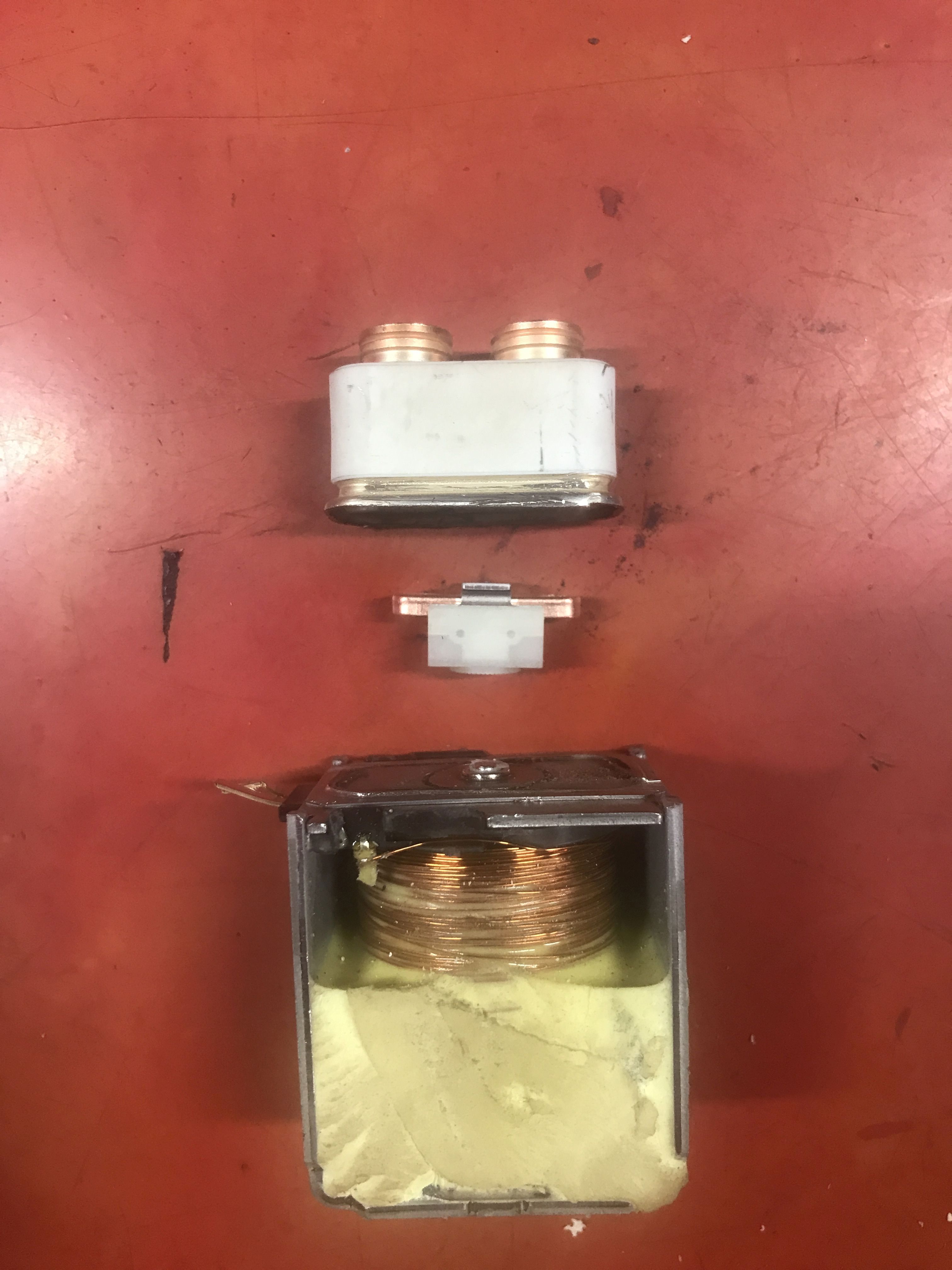

word on the street is sometimes they get welded shut/closed, which part does that?
ah yes, the spring loaded tippy top

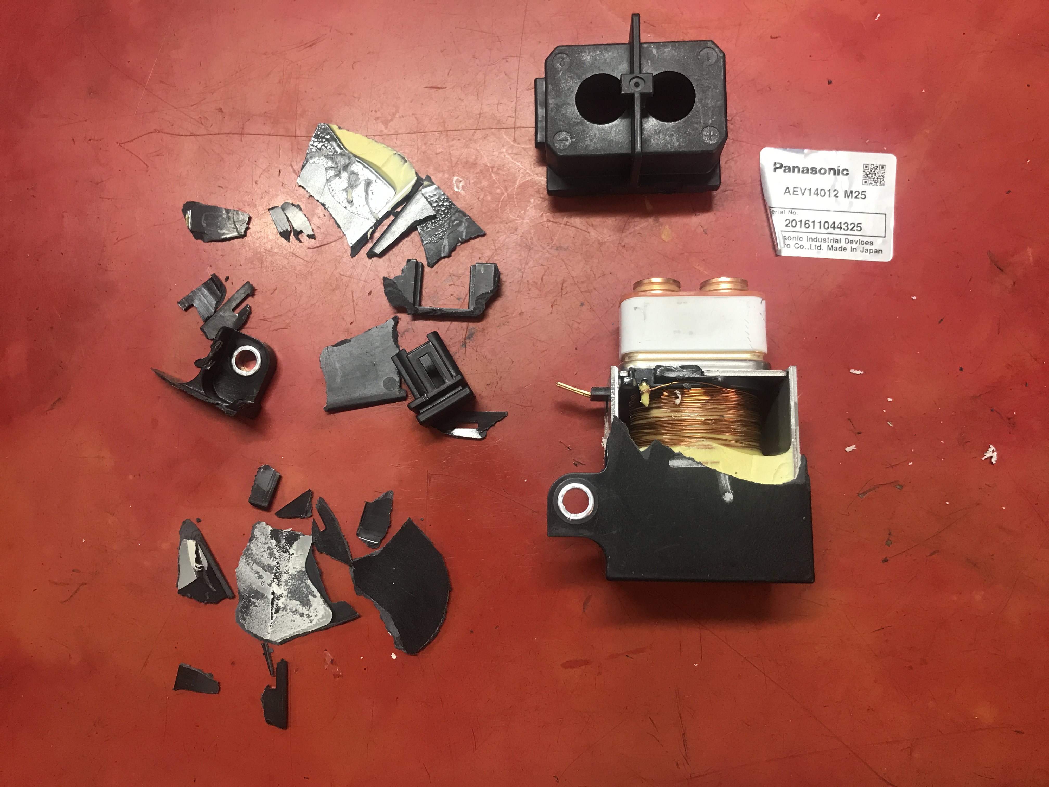

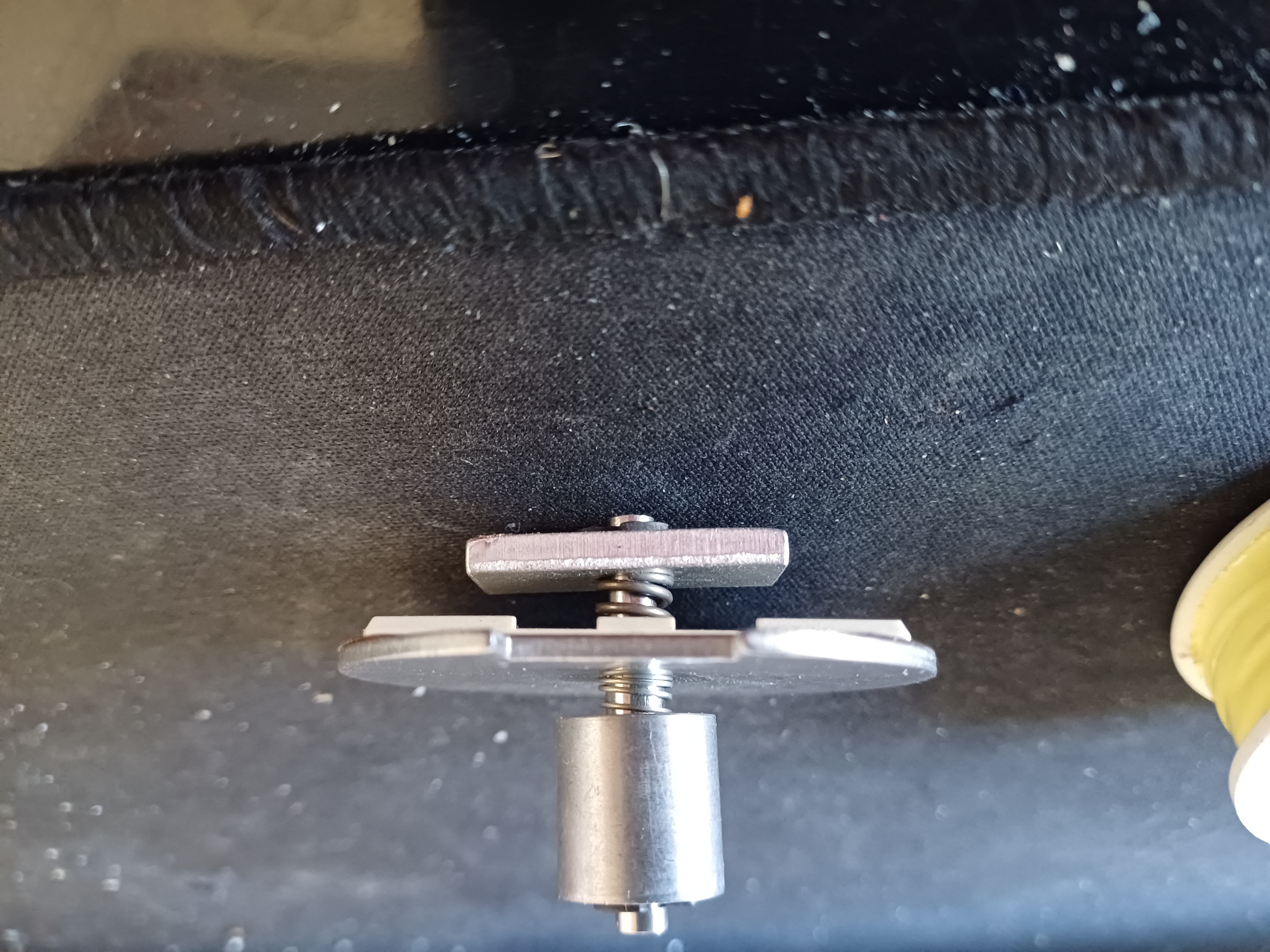

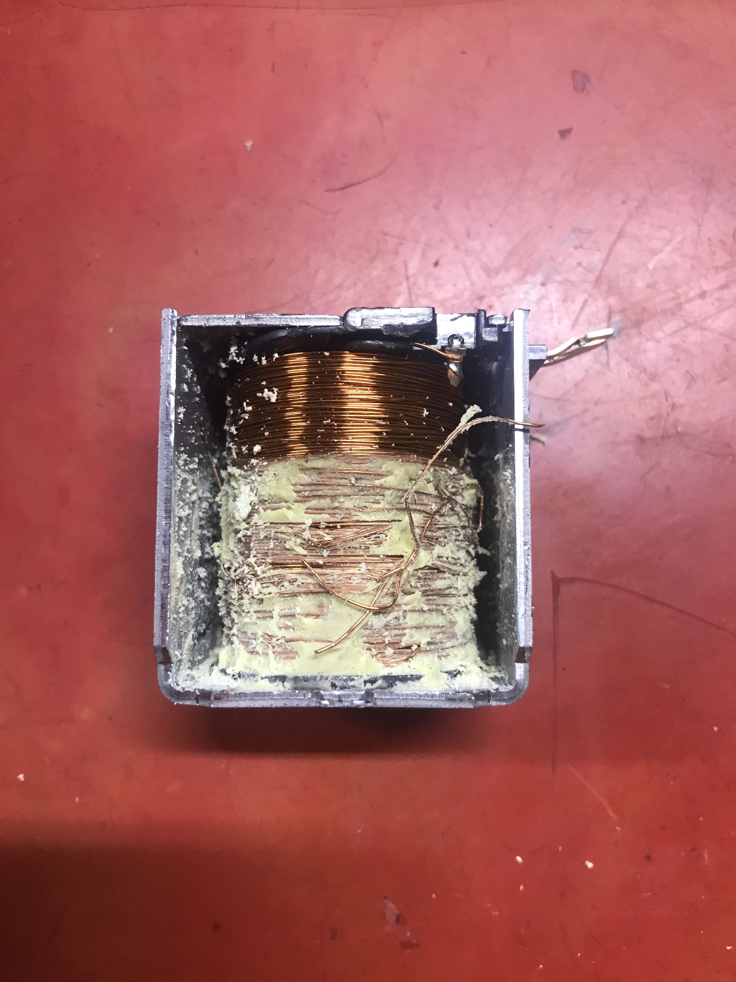

Very cool! So is that spring in the second last photo part of the bit that 'hammers' open to prevent minor welding? What's inside the mustard pudding at the bottom?

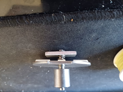

Zieg wrote: Mon Jul 31, 2023 10:35 pm Very cool! So is that spring in the second last photo part of the bit that 'hammers' open to prevent minor welding?
that is a good question, seems to me counter intuitive since that spring is pushing up on that bus bar, as if to make contacts with the two nipples above it, so creating a magnet would pull that bar down, and open the contactor not close it, hope someone else can explain this VooDoo to us more better
Zieg wrote: Mon Jul 31, 2023 10:35 pm What's inside the mustard pudding at the bottom?
looks like jsut some more of that fine, gold fishing line

Gregski wrote: Tue Aug 01, 2023 5:15 am that is a good question, seems to me counter intuitive since that spring is pushing up on that bus bar, as if to make contacts with the two nipples above it, so creating a magnet would pull that bar down, and open the contactor not close it, hope someone else can explain this VooDoo to us more better
Would think the rod inside the magnet pushes the spring/bar assembly up against the copper nipples. The spring ensures a defined force. If you weld the relay by switching into an uncharged capacitor, the bar is welded to the nipples. Then even when the rod return the copper bar is still up there. Tapping it might break it loose.

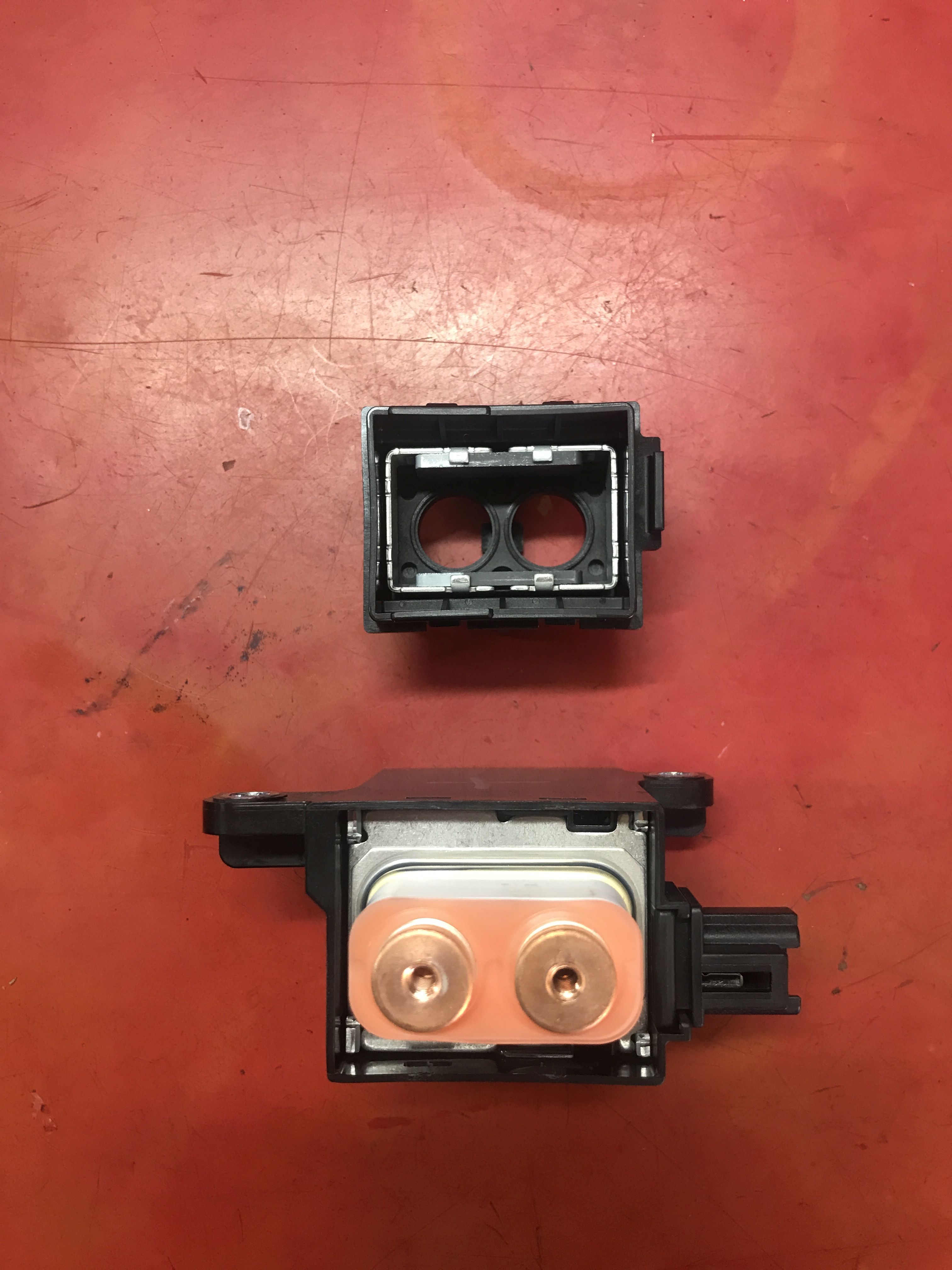

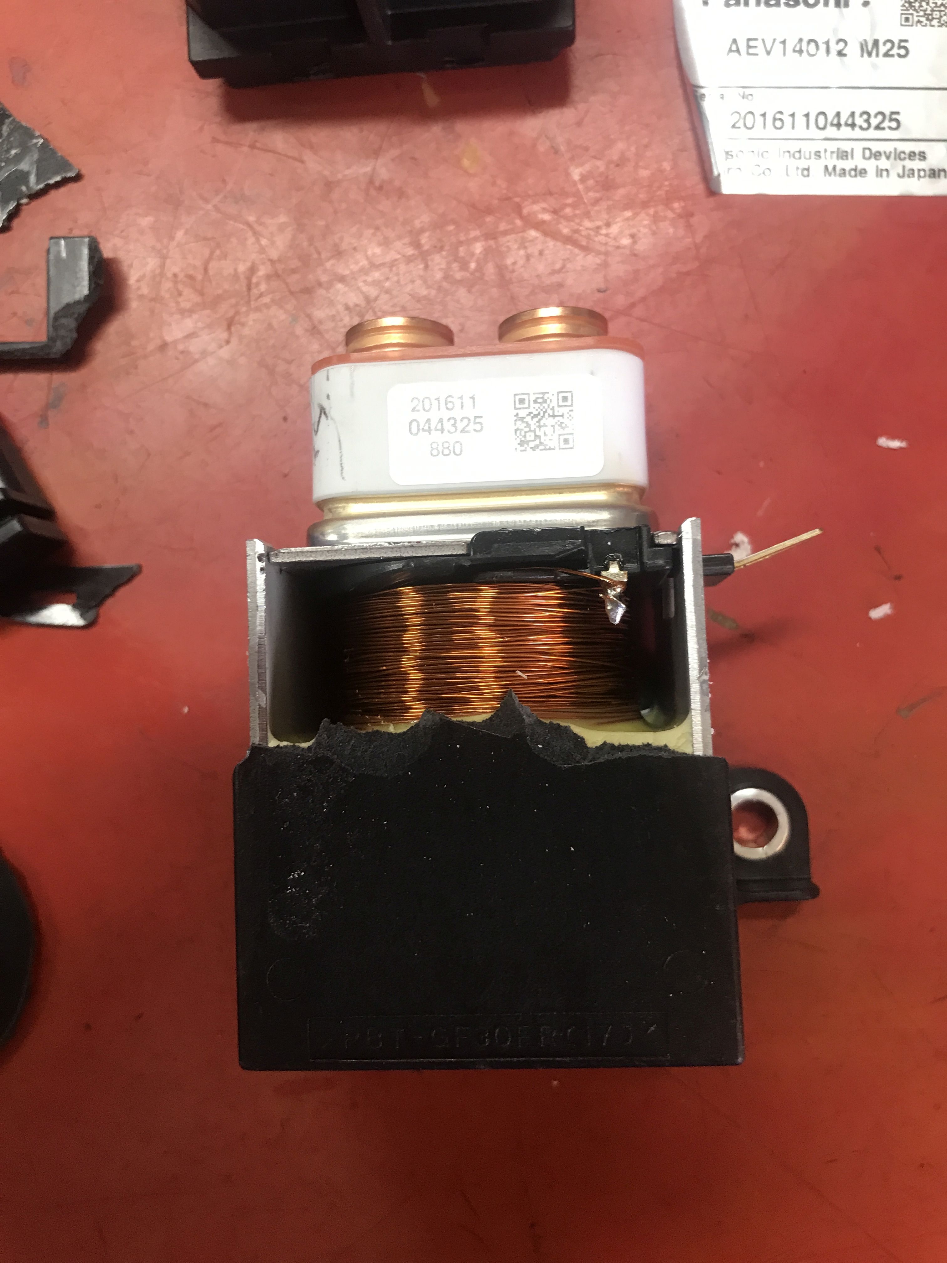

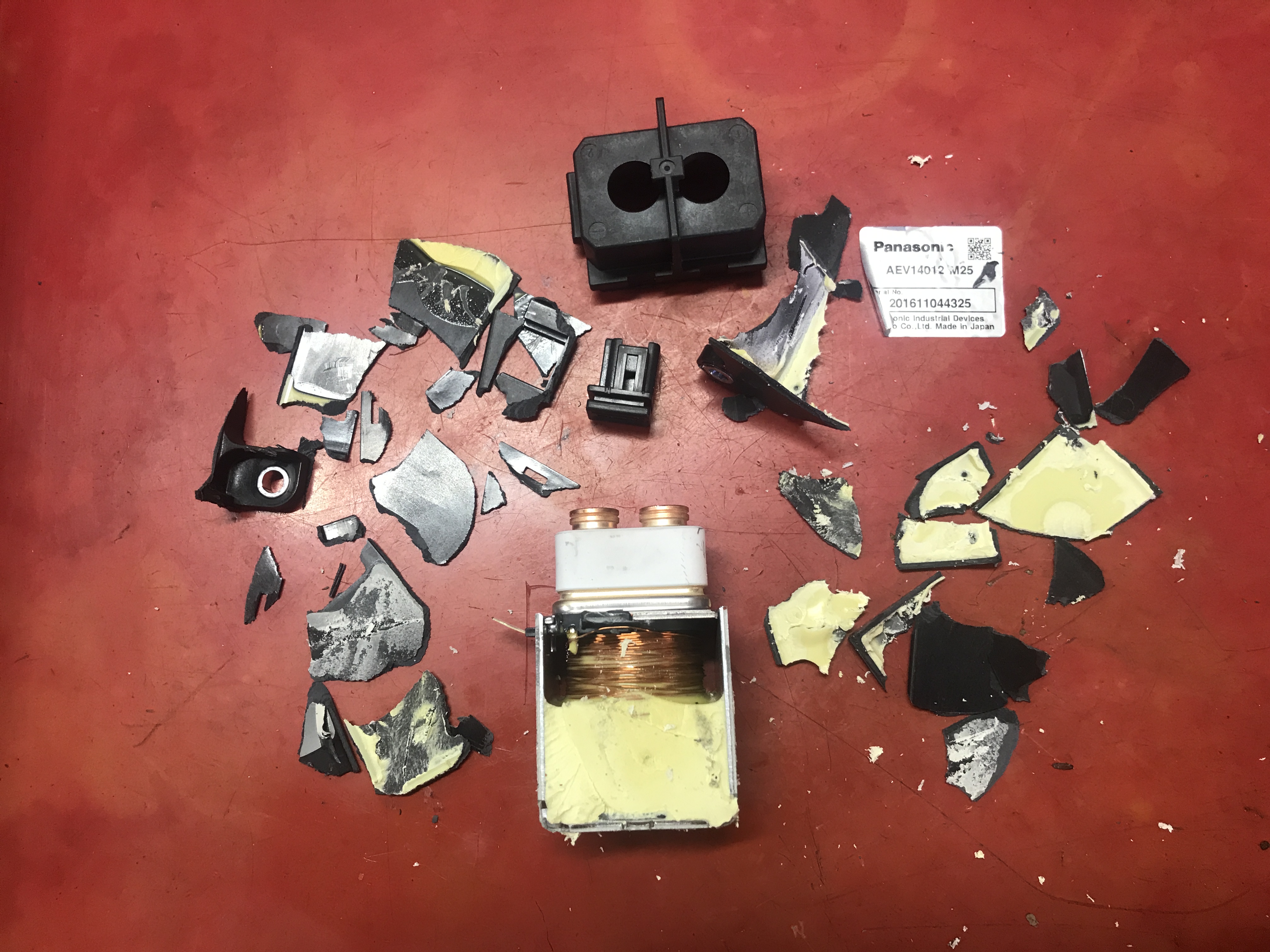

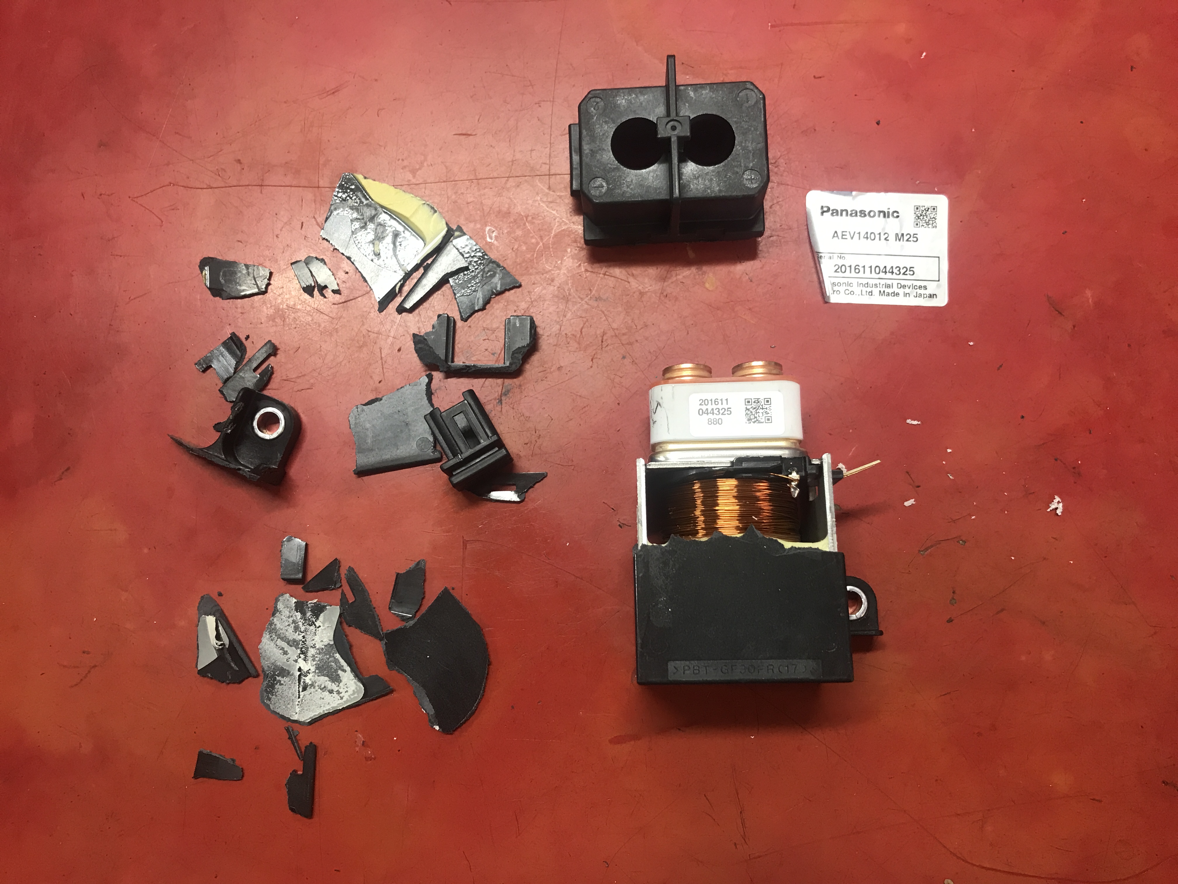

It's amazing what you can do with a disc cutter!
I really struggle to understand how these cost so much
EV_Builder
Posts: 1205
Location: The Netherlands
Has thanked: 18 times
Been thanked: 37 times
Re: New Asks: Hey, what does the inside of a contactor even look like?
Post by EV_Builder »
Materials aren't cheap. Some are gas filled. Reliability is an important cost driver too. So maybe it's more R&D then production costs.
