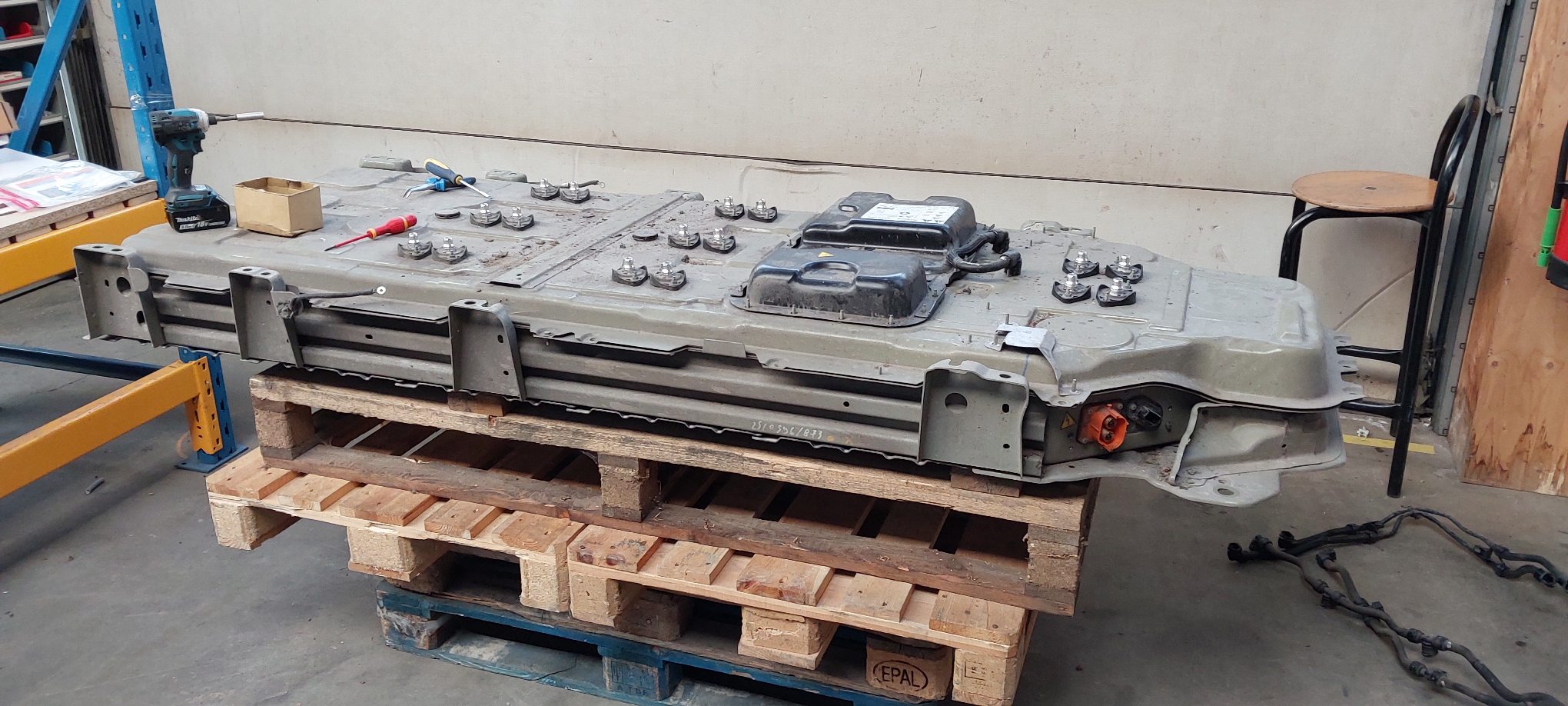

used in lots of vans: 75 kWh battery pack, 33k km
still unopened, might be usable to upgrade a 50 kWh car? (not sure about tools needed)
Price: as is (closed battery), in NL (Zaandam), €5000,- ex tax

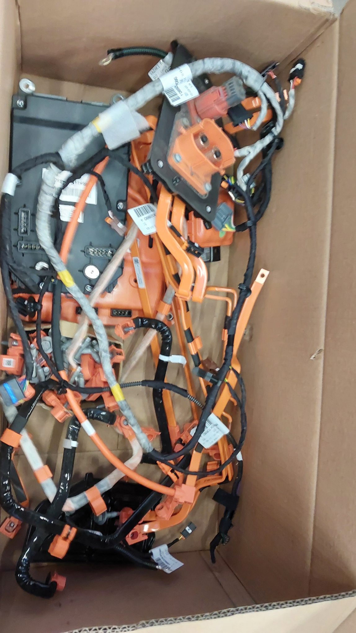

So I opened the pack...
CATL modules and BMS
seems like every other module has a CMU that also reads the next module
nice watercooled blocks with 4 modules (plus one with 2 and one with 1 module)
4s / 2.73 kWh / module
