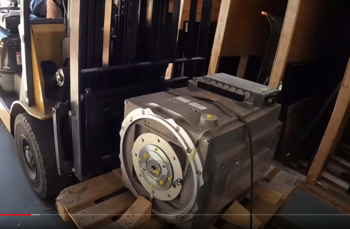

What inverter could be used with a motor like the one in this video. they are saying that motor runs at only 70% to push the BUS.
1. What kind of inverter can power this big motor?
2 Any inverter can run any AC / 3 faze motor?

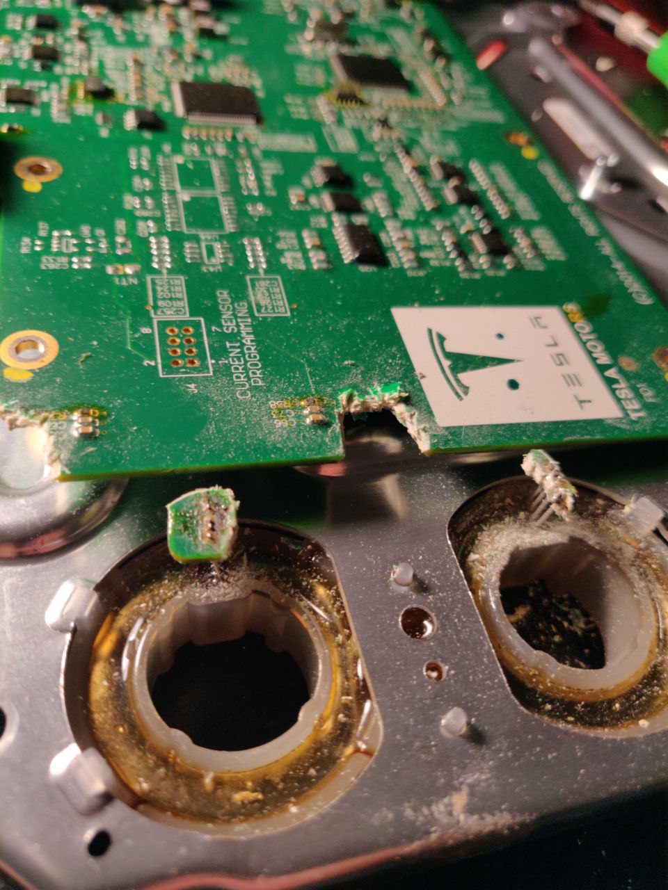

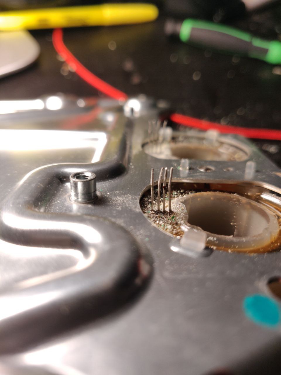

Found a new method to swap the board :D

Thats the thing, I paused the video but was not able to get the motor info and they do not give any details in the video.
They are saying 483HP. Looks like 6 cables go in. so 2 inverters?
I am just asking since I do not understand yet exactly how this motor inverter pairing works.
royhen99
Posts: 261
Location: N. Wiltshire. UK
Has thanked: 22 times
Been thanked: 133 times
Re: Mixing motors and inverters
Post by royhen99 »
A quick image search suggests it is propably a Siemens 1DB2024 – WS36. 6 ph requiring dual inverter

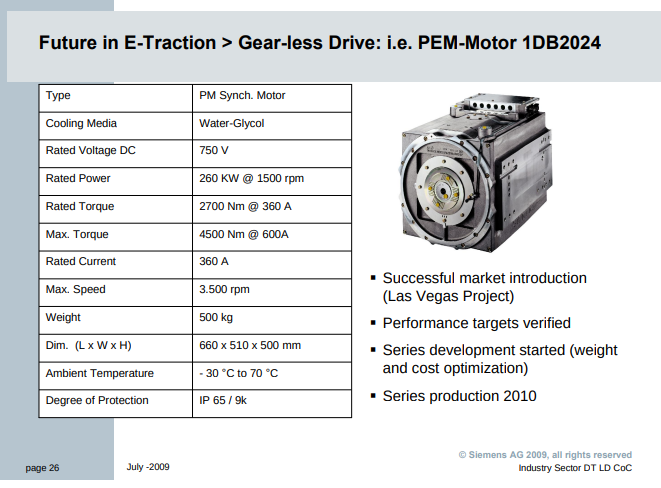

This is 750V probably more complicated setup for the batteries.
https://silo.tips/download/drive-motor-1pv5135-4ws18

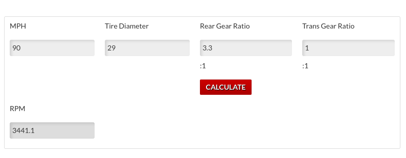

So this motor has at 3500 RPM max speed.
to reach 90MPH the gear ratio needs to be arround 3.3:1
https://purperformance.com/p-29669-rpm-calculator.html
