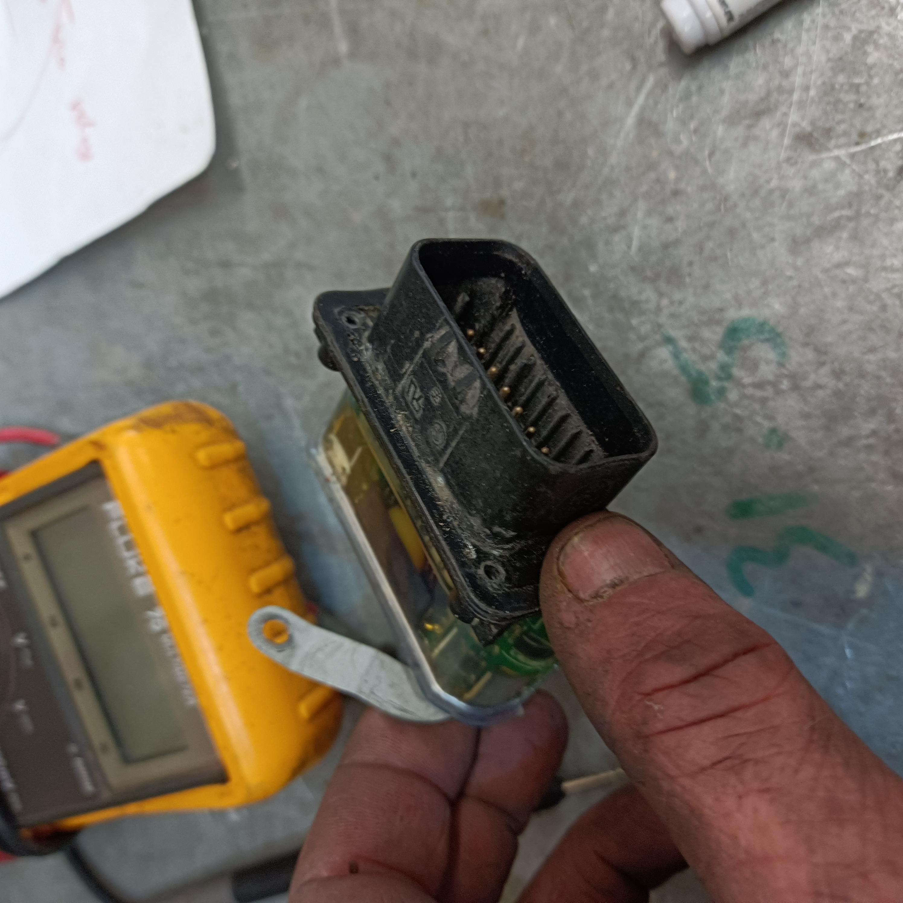

Hi All,
I have the LDU logic board installed in a Tesla LDU (LDU or unknown origin). I have power going to the 23 pin connector on the ldu but it seems as if the board is not powering up, i.e no wifi available and no current at all is being drawn.
I have removed the inverter cover and nothing obviously not connected so I checked continuity from the pins on the 23 pin connector to the rear where they connect inside the inverter and I'm not seeing any continuity. For example pin 1 which is 12v ignition seems to have no continuity through to the smaller plug at the internal side of the connector. I have attached a pic, and if you look closely I think this 12v pin is the one that I have drawn a red arrow towards - it seems discoloured? I have also shown with a yellow arrow a bit of strange material inside the connector - I can't get in there as it has a clear perspex cover which is glued in place.
Anyway, can anyone tell me how best to test what is going on here? How I can be 100% sure whether or not 12v is reaching the logic board...?
If anyone is familiar with this Tesla connector that I have shown and whether I am testing it correctly I would be very grateful!

If I remember correctly, it is not a completely uncommon for that connector to be damaged.mtrehy wrote: ↑Tue Apr 11, 2023 6:30 pm Hi All,
Zero EV/Felten typically has some available, but they are out of stock
https://shop.fellten.com/shop/ldu23dbte ... 3785#attr=
I'm not sure if anyone else carries just that part.

THanks gents, I've ordered one from Zero Ev, which is one they make themselves (not oem). Should have that tomorrow so will report back (hopefully with good news).
https://shop.fellten.com/shop/ldu23db-l ... 2873#attr=
Re: LDU Board - Not getting Powered Up
SO some progress. I installed the new connector and it all lights up and I can connect via wifi!

Brilliant! The thing spins. I'm not entirely sure what fixed it. I gave it 36v and swapped the encoder pins and spins nicely. One very minor thing is that it seems to spin forward when it should be reverse but that's no issue.
So big thumbs up for the zero ev replacement 23 pin data interface connector. Seems strange though - I don't know the history of the motor but nothing I have done since I have had it could have damaged that connector so would have to assume that it was damaged when it was in the original vehicle but I can't see how that would happen through crash damage.
