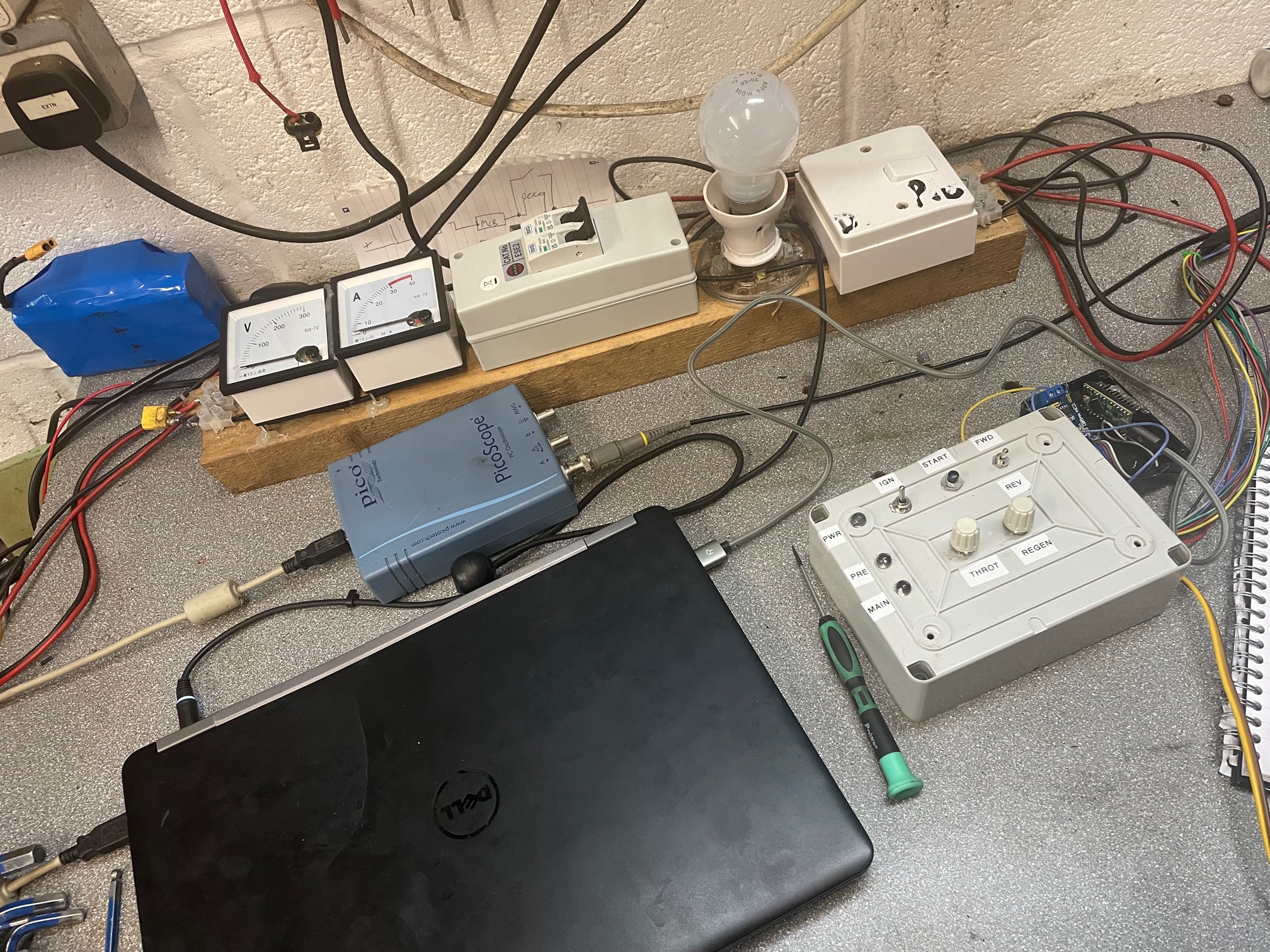

I hooked this up to the prius inverter with V1c board on the bench and got it turning ok on 120v with some tweaking.

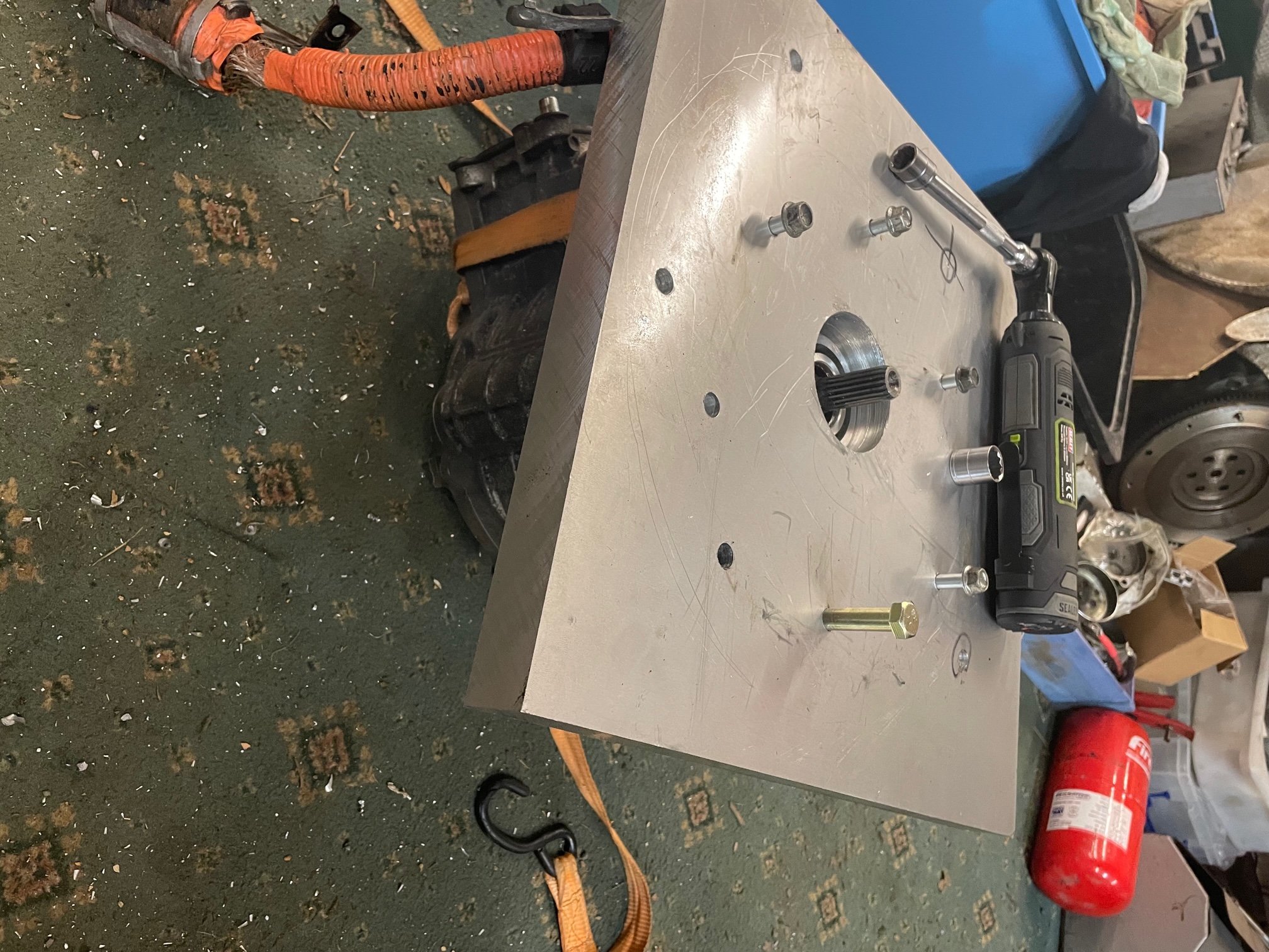

Adapter plate is made, just waiting for machine shop to make the coupler from the part supplied (splines from phev diff, and clutch centre from BMW).

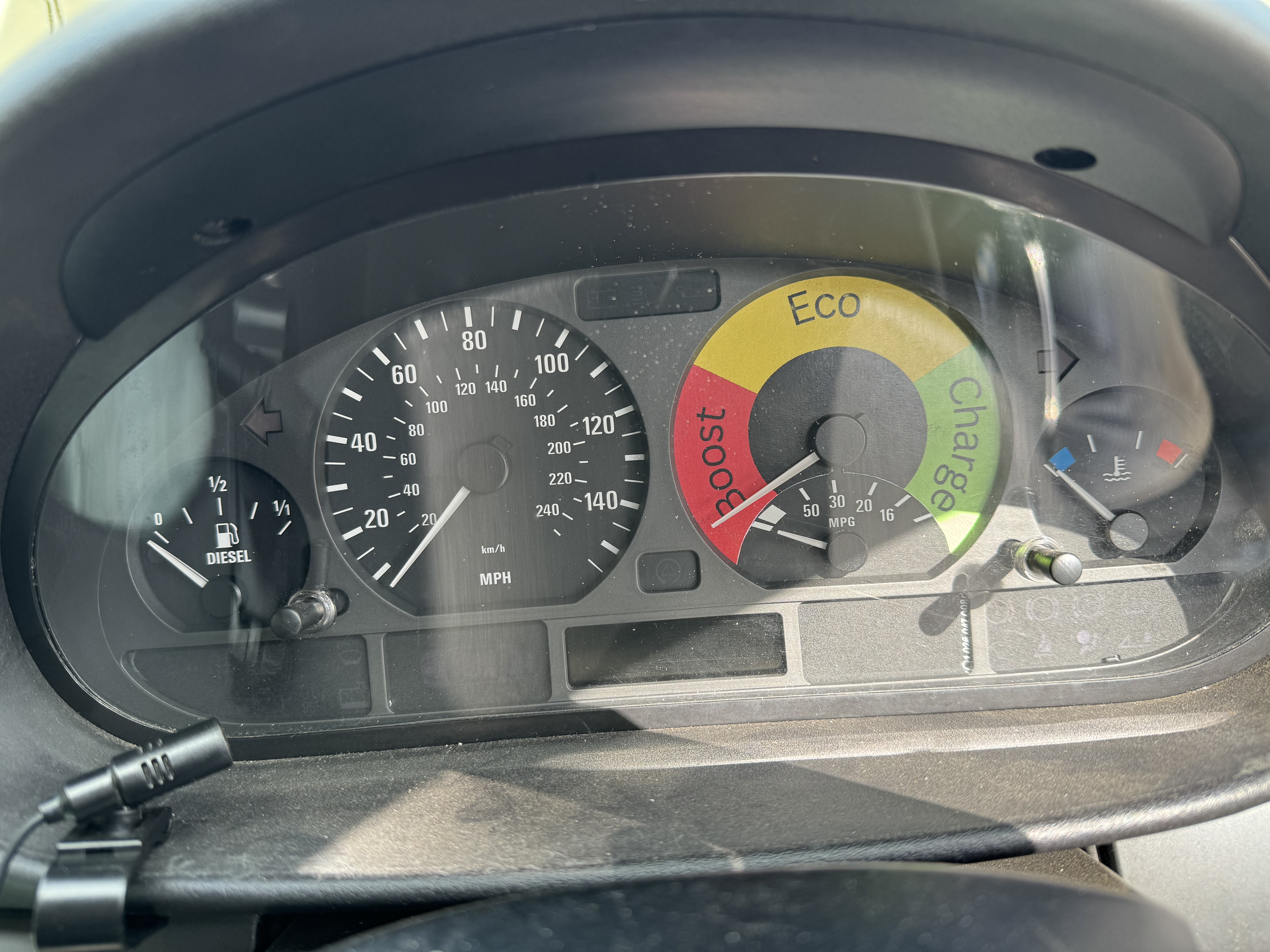

Questions around engine management light, local friendly mot tester suggested removing the bulb/led from the dash as i've got 3 pages of fault codes related to the engine. I hear there are people who can flash the ecu to tell it to ignore faults, if anyone has done this, or got round the issues in other ways i'd like to hear about it.

given all the engine codes are related to engine, i don't mind removing the bulb. it's not elegant but ensures the light stays off now and in the future.
i'd be interested to see how other conversions dealt with this, specifically on e46.

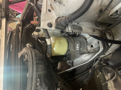

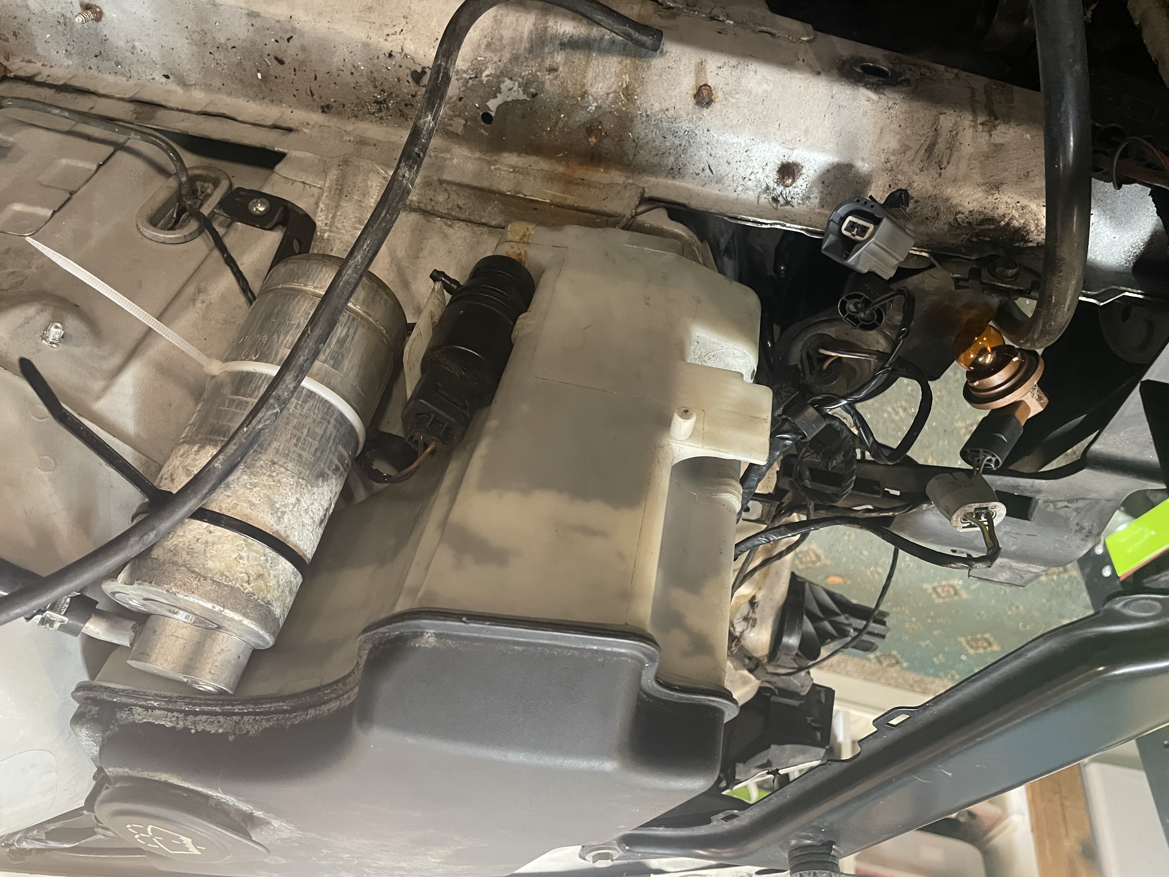

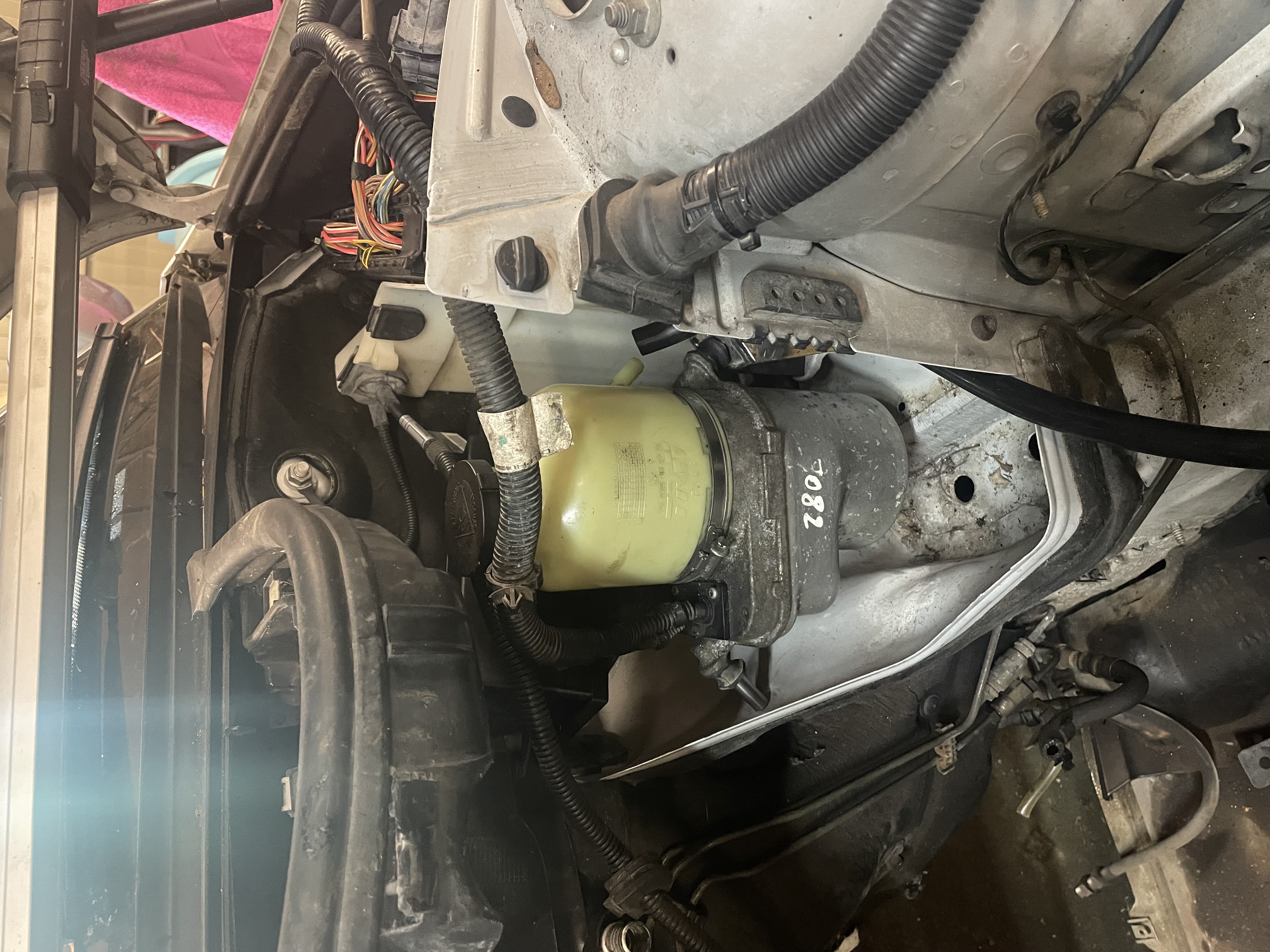

Couple of snaps showing power steering pump prototype and vac pump. I've been told the power steering is the noisiest part of the build, so i've mounted it as in-board as i can. There is a stout plastic cover to go round that corner.
The vac pump itself it mount under the headlight where the drying cannister used to be, and the cannister is relocated to beside the washer bottle. Just need to add a non-return valve and the wiring.
12v fuse box fits behind the PS pump on the firewall but not shown yet. Need to work out how to mount it without drilling any holes.

What functions does the original ecu still do that means it needs to be kept, can these also not be taken over by something else?
That is one hell of a chunk of aluminium you have there!

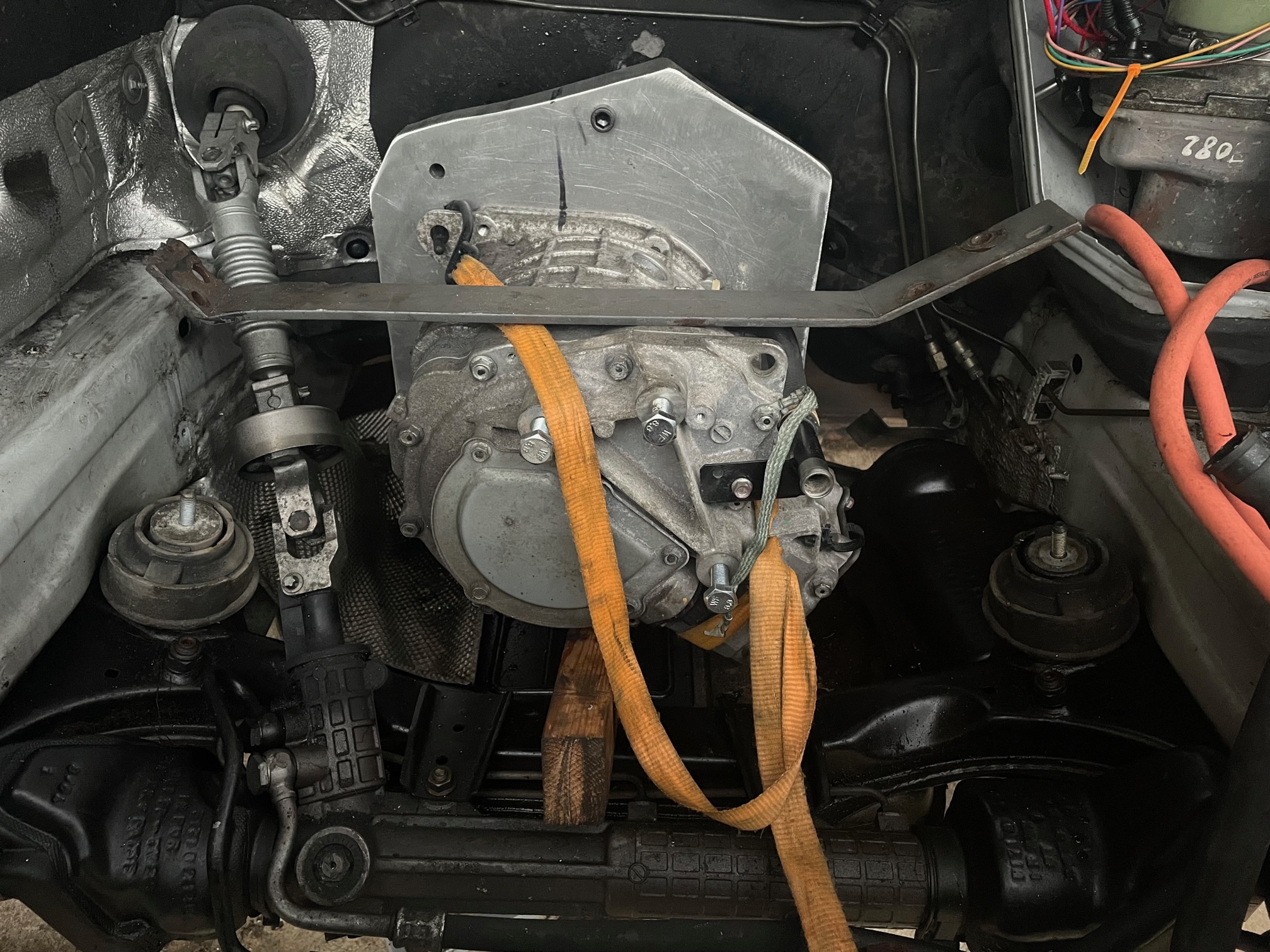

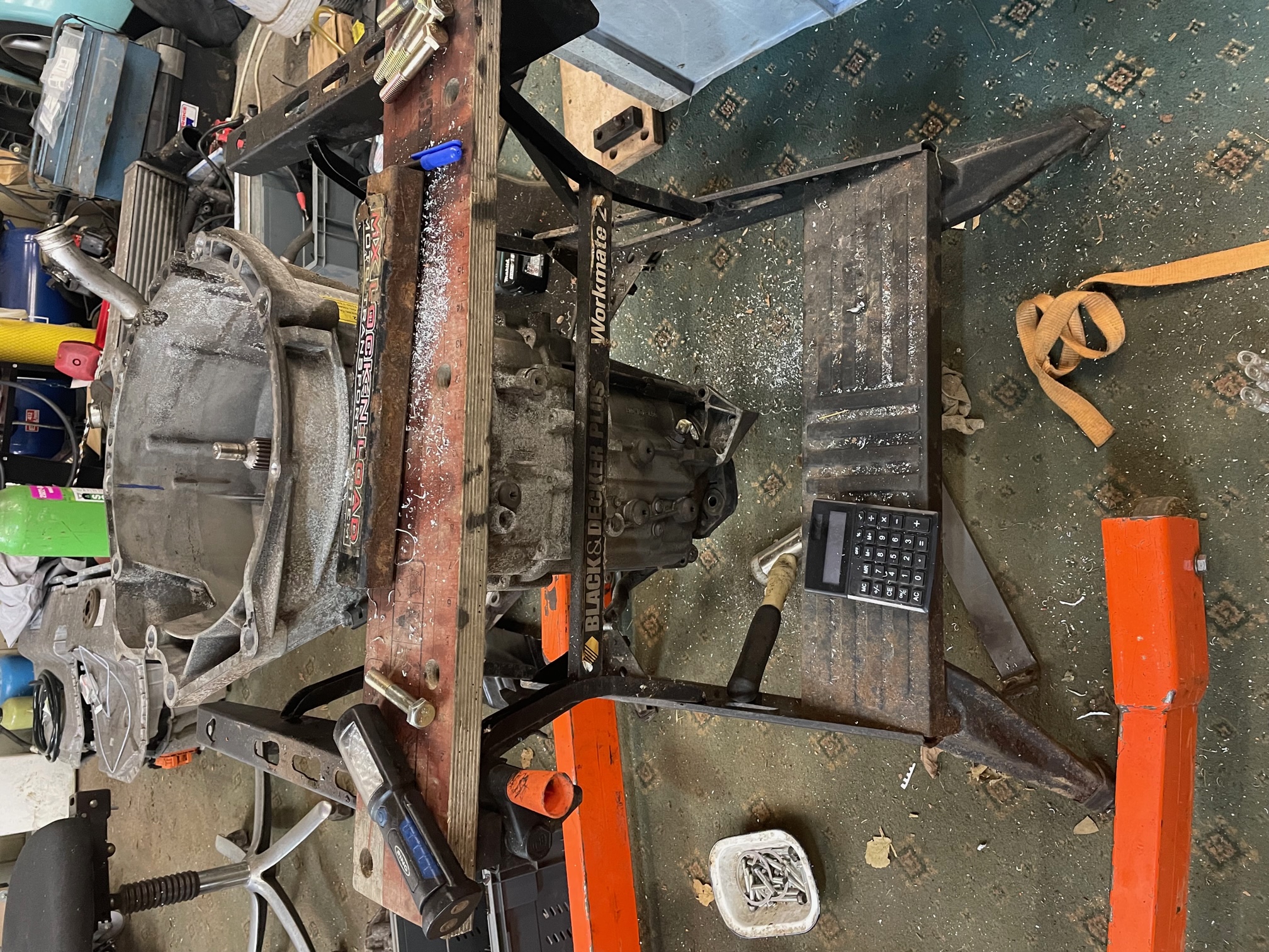

So the coupler has finally been done, not before i trial fitted the motor and gearbox, so think i'll take that out tomorrow, fit the coupler and run it up on the bench to check for balance etc.
The motor mount is mostly done, just need some lugs welding on and tidying up. Next stop, battery box, and the question - how much effort should i put into retaining the BMW cooling/heating pipes - might be useful later coupled to the ex-BMW pre-heater ?

yep - today got the coupler installed, then test ran the motor & gearbox on the bench @ 120v, then installed it in the car.
Motor mount is just about done now, so next step battery tray. The BMW set fits neatly behind the radiator once i've made a tray.

Quick update here as some progress has been made.
I've got the 240v charging working and the dcdc bit sorted, and after some self induced issues have just got back to the point where i can spin the motor under pot control cleanly both ways. The charging cicruit is based on Teensy 4.1, which usefully has 3 can bus interfaces also (inverter, shunt & charger). Coupled serially to the Teensy is an ESP32 which has wifi capability and that receives a stream of data from the Teensy whilst charging which it drops into Influx (a time series database) for monitoring purposes. The ESP32 also transmit the data over LoRa to be received by a handheld unit repurposed from another project.
The Teensy has an sd card socket, so in drive mode, i'll get it to log pertinent data from the inverter to aid tuning and issue resolution.
So next few days will see the 12v & control wiring completed and hopefully some testing with wheels off the ground, and then maybe a trundle up & down the drive all being well.

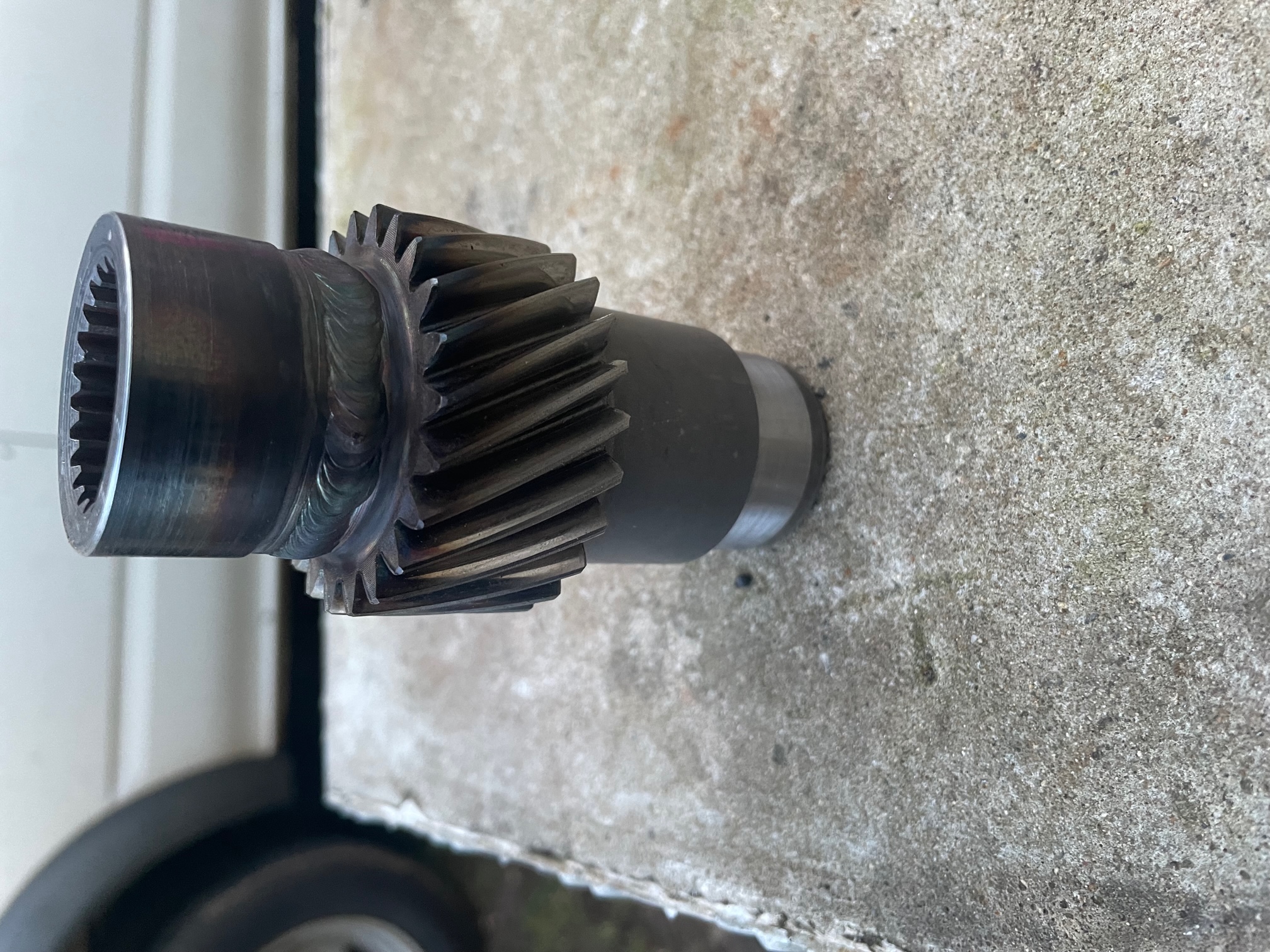

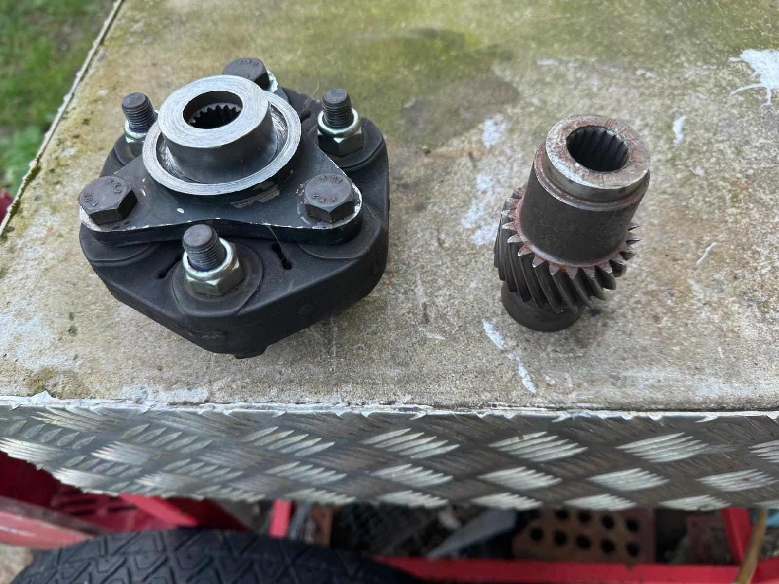

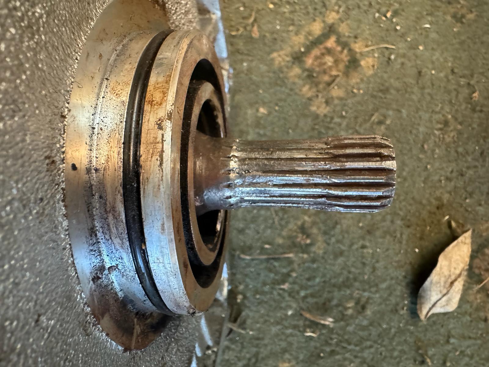

Progress has been made - the car now moves under it's own power using f/w 5.24r. I've only driven it slowly round the back where it is parked.
It developed a nasty squeel noise during the first couple of moves. Feels like a coupler or alignment issue. It wasn't there at first but developed a few mins in. This weekend i'll investigate, suspect need to drop the gearbox, which hopefully i can still do without taking the inverter, charger and batteries out of the front. But it was designed to come apart so if needed not the end of the world. luckily i have a 2 post lift :-)
thanks as always to forum members who have helped me get this far

I pulled the gearbox this morning and discovered the source of the noise. The coupler was able to touch the gearbox shaft shroud (or is it shrowd) under load, and that was metal on metal, plus the shroud added a nice ring to the timbre. I've shortened the shroud as its redundant without the clutch apart from holding the oil seal in pace. Ironically if i just put up with the noise, the shroud would have worn down anyway and would have been ok, but hindsight is a wonderful thing.
took the opportunity to tune the motor some more with the gearbox off. With a syncof of 5268 i was able to turn the motor with a manualid of 60. Now i've reduced the syncof to 5000 i can get to 200amp and no movement at all . That feels like a good place to be or should i go higher ?
In run mode, spins up nicely on the gas pedal.

i replaced one of the headlights, just to extinguish a few warning lights on the dash that currently looks like a xmas tree. The ABS is the most concerning, not sure what i did to break that, it reports loss of canbus to ECU/DME (in BMW terms) and lost connection to 3 wheel sensors. Need to get it back up on the lift, though that is blocked by my wife's volvo after an abortive timing belt change (don't ask).

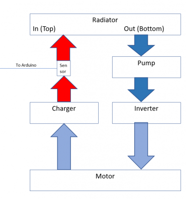

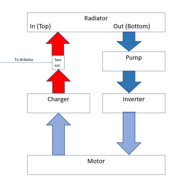

So the next tasks are hook up the cooling loop which will look like this:-

Looks like a sensible cooling loop mine follows this exact plan

On the engine management light, mine sailed through MOT with that lit. Tester told me it was irrelevant. I also haven't solved the ABS/ASC light issue - if you gave a can capture of the messages being spammed to the dash, that would be very welcome.

bobby_come_lately wrote: Tue Apr 18, 2023 9:49 am On the engine management light, mine sailed through MOT with that lit. Tester told me it was irrelevant. I also haven't solved the ABS/ASC light issue - if you gave a can capture of the messages being spammed to the dash, that would be very welcome.
did you manage to MOT it with ABS/ASC light on ?
My code reader reports it's got no contact with 3 wheel sensor and no CAN comms to DME (ECU). I think this could be tricky to solve, but I have a 325 as my daily so i cam hoping i can sense check the signals against that.

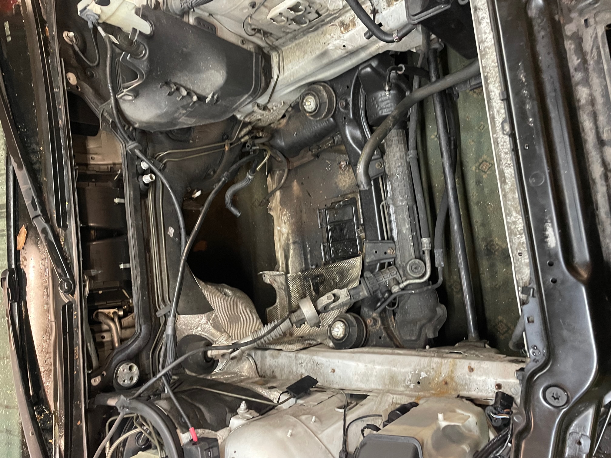

So this weekend we largely spent removing all the batteries so i can get at the power steering pipes and isntall the cooling. Several attempts to make pipes from the rack to the electric pump have not ended well. The pressure is much high than expected, so today i'm taking my leaky made up hoses to the local hydraulics shop to get them properly made. On the plus side, power steering fluid seem to make a good rust inhibitor and its spread all over the underside :-)
But i did get to install all the cooling pipes whilst it was apart and test it for leaks - all good.
Now to reassemble it and run some road tests on a local private road. The reassembly is half done, i'm taking the opportunity to tidy some wiring, install a temp sensor on the cooling loop, install the shunt and install the BMW BMS loom the aim of getting that talking over CAN at some point.
