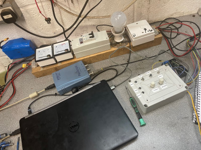

I hooked this up to the prius inverter with V1c board on the bench and got it turning ok on 120v with some tweaking.

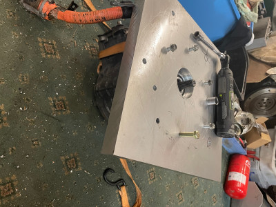

Adapter plate is made, just waiting for machine shop to make the coupler from the part supplied (splines from phev diff, and clutch centre from BMW).

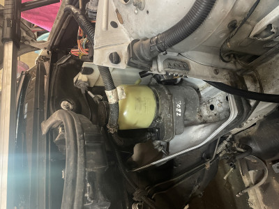

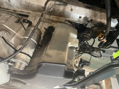

Couple of snaps showing power steering pump prototype and vac pump. I've been told the power steering is the noisiest part of the build, so i've mounted it as in-board as i can. There is a stout plastic cover to go round that corner.
The vac pump itself it mount under the headlight where the drying cannister used to be, and the cannister is relocated to beside the washer bottle. Just need to add a non-return valve and the wiring.
12v fuse box fits behind the PS pump on the firewall but not shown yet. Need to work out how to mount it without drilling any holes.

Re: BMW Touring + prius + phev
What functions does the original ecu still do that means it needs to be kept, can these also not be taken over by something else?
That is one hell of a chunk of aluminium you have there!
- Posts: 328
- Has thanked: 8 times
- Been thanked: 47 times
yeah tell me - wasn't cheap but i do have a tendency to over-engineer with an aim of only doing it once

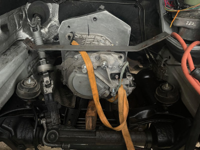

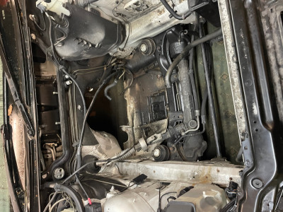

So the coupler has finally been done, not before i trial fitted the motor and gearbox, so think i'll take that out tomorrow, fit the coupler and run it up on the bench to check for balance etc.
The motor mount is mostly done, just need some lugs welding on and tidying up. Next stop, battery box, and the question - how much effort should i put into retaining the BMW cooling/heating pipes - might be useful later coupled to the ex-BMW pre-heater ?

yep - today got the coupler installed, then test ran the motor & gearbox on the bench @ 120v, then installed it in the car.
Motor mount is just about done now, so next step battery tray. The BMW set fits neatly behind the radiator once i've made a tray.

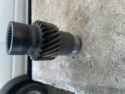

Progress has been made - the car now moves under it's own power using f/w 5.24r. I've only driven it slowly round the back where it is parked.
It developed a nasty squeel noise during the first couple of moves. Feels like a coupler or alignment issue. It wasn't there at first but developed a few mins in. This weekend i'll investigate, suspect need to drop the gearbox, which hopefully i can still do without taking the inverter, charger and batteries out of the front. But it was designed to come apart so if needed not the end of the world. luckily i have a 2 post lift

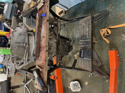

I pulled the gearbox this morning and discovered the source of the noise. The coupler was able to touch the gearbox shaft shroud (or is it shrowd) under load, and that was metal on metal, plus the shroud added a nice ring to the timbre. I've shortened the shroud as its redundant without the clutch apart from holding the oil seal in pace. Ironically if i just put up with the noise, the shroud would have worn down anyway and would have been ok, but hindsight is a wonderful thing.
took the opportunity to tune the motor some more with the gearbox off. With a syncof of 5268 i was able to turn the motor with a manualid of 60. Now i've reduced the syncof to 5000 i can get to 200amp and no movement at all . That feels like a good place to be or should i go higher ?
In run mode, spins up nicely on the gas pedal.

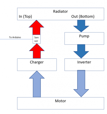

So the next tasks are hook up the cooling loop which will look like this:-
The lunchtime run revealed a recurring issue of power steering leak, there's a lot of pressure in there and one of the solid to flexible pipe joins doesn't have a flare on it, so i need to rectify that.
My vac pump also won't stop, suggesting a leak somewhere, need to track that down, maybe try it without the reservoir as other members report there is enough capacity in the servo for 3 good brake depresses. I'll try that, though i kind of like the concept of a vacuum reservoir, the 'fuller' it is, the less it holds etc
i replaced one of the headlights, just to extinguish a few warning lights on the dash that currently looks like a xmas tree. The ABS is the most concerning, not sure what i did to break that, it reports loss of canbus to ECU/DME (in BMW terms) and lost connection to 3 wheel sensors. Need to get it back up on the lift, though that is blocked by my wife's volvo after an abortive timing belt change (don't ask).

So this weekend we largely spent removing all the batteries so i can get at the power steering pipes and isntall the cooling. Several attempts to make pipes from the rack to the electric pump have not ended well. The pressure is much high than expected, so today i'm taking my leaky made up hoses to the local hydraulics shop to get them properly made. On the plus side, power steering fluid seem to make a good rust inhibitor and its spread all over the underside
But i did get to install all the cooling pipes whilst it was apart and test it for leaks - all good.
Now to reassemble it and run some road tests on a local private road. The reassembly is half done, i'm taking the opportunity to tidy some wiring, install a temp sensor on the cooling loop, install the shunt and install the BMW BMS loom the aim of getting that talking over CAN at some point.
Thank to Pete008 for more help with tuning, it now pulls away like a regular car.
