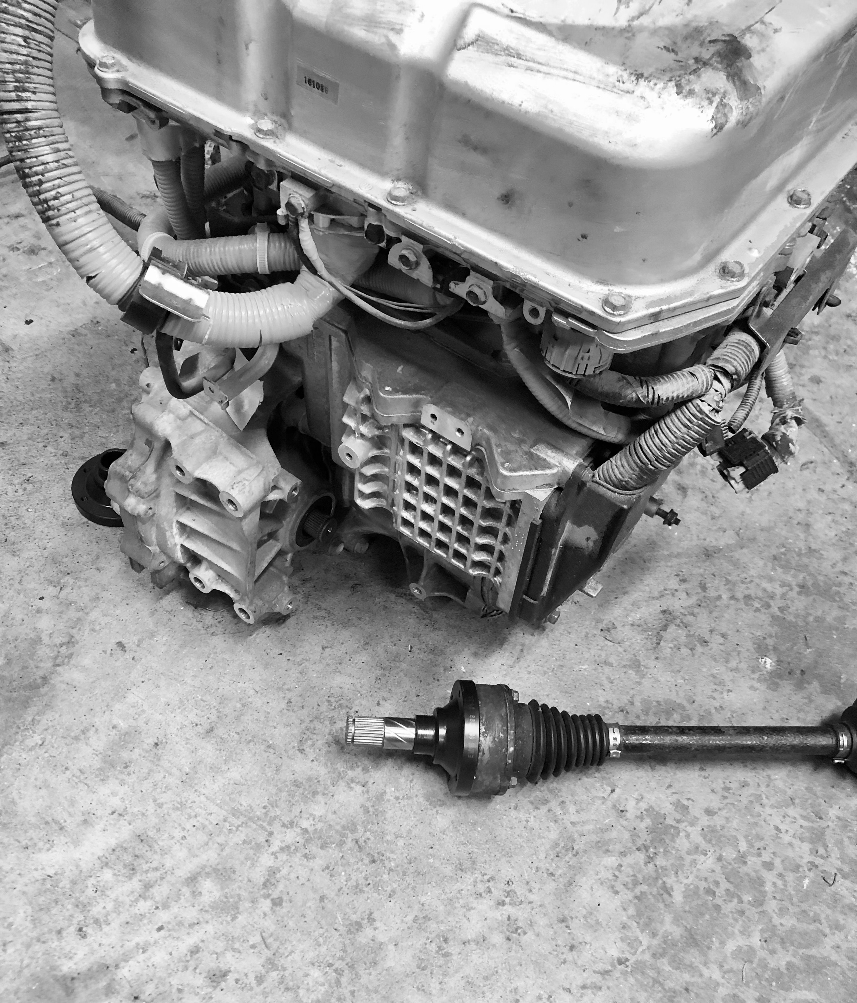

-Nissan leaf gen2 drive unit (em57)
From first measurements it’s very tight fit for the full leaf stack(gearbox, motor, inverter, pdm) without the pdm, the leaf motor/gearbox/inverter should fit great!
Drive shafts are pretty simple, the leaf-to-vw conversion stubs allow the original vw axles to bolt right up to the leaf gearbox
Once motor is mounted, a new oil feed system is needed, as the motor and gearbox will be running in reverse. looks like one of the fill/drain plugs could be used for an oil feed insert.

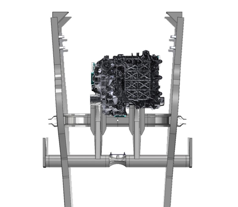

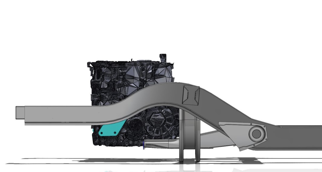

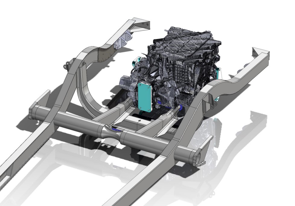

modeling everything in cad, so here's putting the leaf drive stack in the rear so we can fab some brackets
trying to make this a bolt in afire with no cutting of the bus. its a challenge!
looking at rotating the drive stack 90 degrees, maybe the pdm will fit aswell..

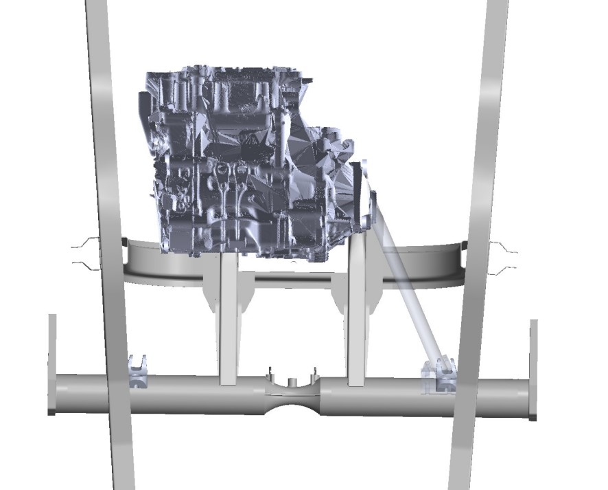

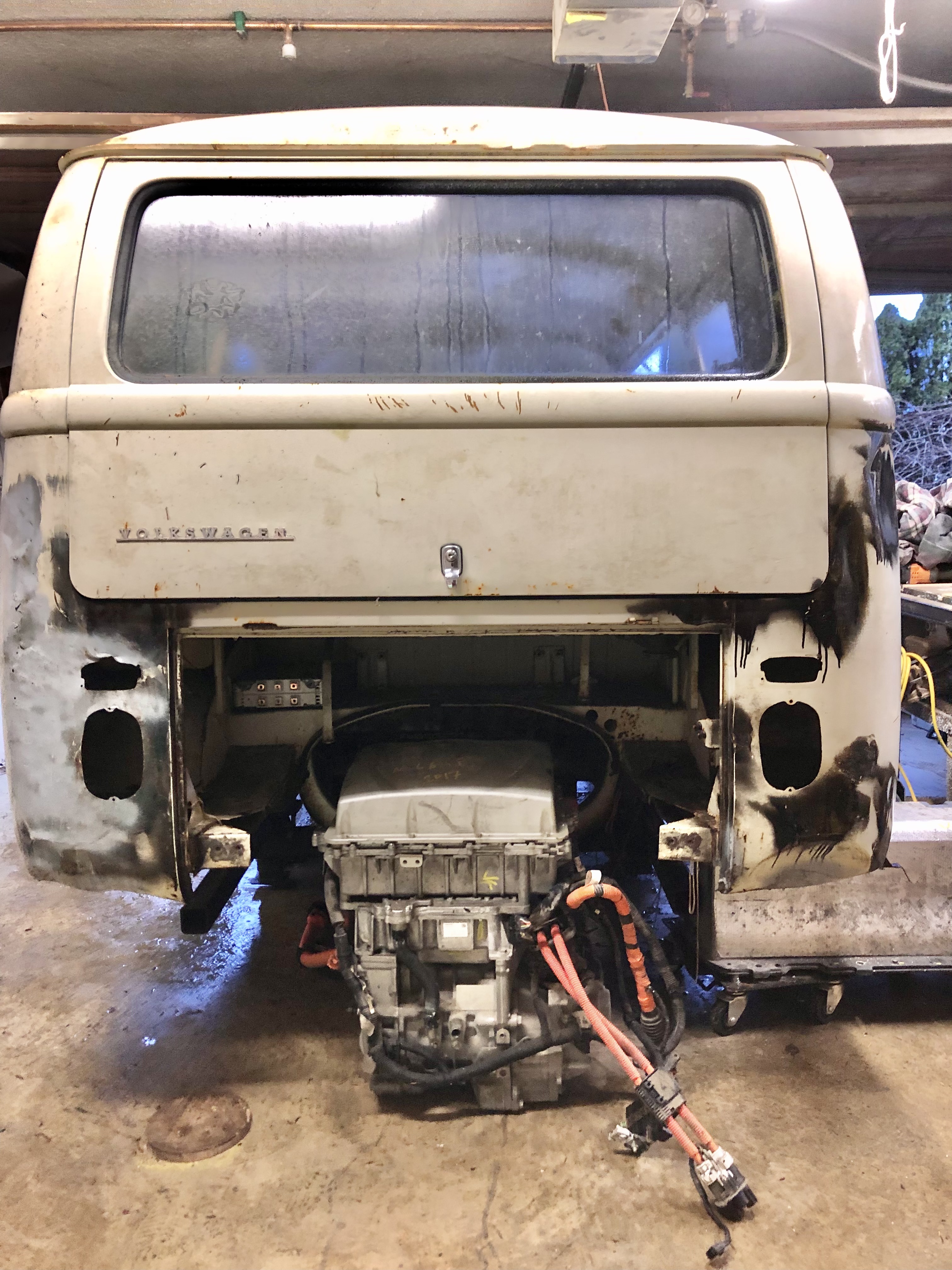

rotated the full stack 90 degrees.
mount design is drilling down to something quite simple and elegant. will most likely cast the main parts out of aluminum, and use swaged tube and rod ends. full bolt on kit. bottom mount on the engine horns, and 2 side mounts triangulating to the torsion tube.
diff is centered and axles are in the same location as a stock bus.
sadly the top (or side depending how you look at the stack) will collide with the bottom of the engine bay roof in the split window. 2-3in. but that means it should clear a bay window just fine, no cutting!
