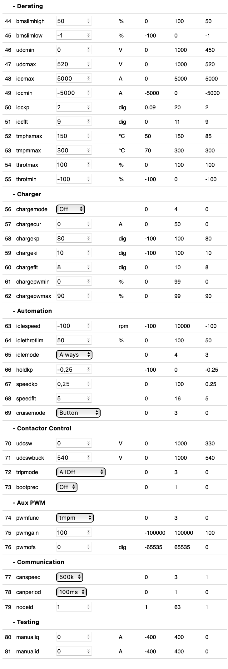

So, there are probably broken things here. yesterday I installed this firmware and the settings file from tauran in a green buggy for tests from 360 volts.
1) first, starting the charging boost mode via a diode bridge from the 220 network gave 85 amperes of current in the 220 line!! (the setting in the inverter is 20 amps, on the previous setting it worked fine correctly) I lowered the charge current in the setting to 10 amps and there was 50 amps on the 220 line!
With that, I finished checking the charging and moved on to the next stage.
2) if you just turn everything on, then the buggy was driving. with the hubs hung out and the wheels removed, I pressed the gas several times, adjusting the regen using an external variable resistor. once when I pressed the gas hard, I got an uncontrolled acceleration and had to press the brakes hard to stop.
3) having received this uncontrolled acceleration, I thought that it was worth adjusting the angle of the offset of the syncofs , however, there was a failure here. manual run was turned on, but it did not start the contactor. I disconnected the high-voltage battery and connected the 72 volt motorcycle battery directly to the controller, I also changed the operating voltage thresholds in the settings, started the manual run, however, no manipulations with changing the angle and adding manual current caused the motor to rotate.
4) having suffered the third fiasco, I decided to try to drive into the hill with the default angle of the sincofs (after all, the buggy used to go with this setting), but on the first attempt I got a probable overload of the inverter and the failure of the power modules with a desat error. This is the end of the experiments with the new firmware. I must add that it drove perfectly on a straight road!
one clarifying question, why is the current sensor setup now 2.31 instead of 1.68? is this correct for nissan leaf gen2, could this be the reason for the huge charging current?
evil neodymium :twisted:

I used the Nissan leaf gen 2 kit (motor + inverter + v3 board) and slightly modified settings from your tauran (changes in gas pedal control and pinswap 4), yes, the manual ran did not respond to commands.
parExTract.json
(1.47 KiB) Downloaded 205 times
Posts: 5791
Has thanked: 157 times
Been thanked: 1025 times
Re: Inverter Firmware 5.24.R
Ok, running the same parameters as me. Please change ilXgain back to 1.7 when running on the V3 mainboard. Because now your throtcur is essentially 7.5A (factor 2.3/1.7) or 755A RMS. That will trip the inverter.

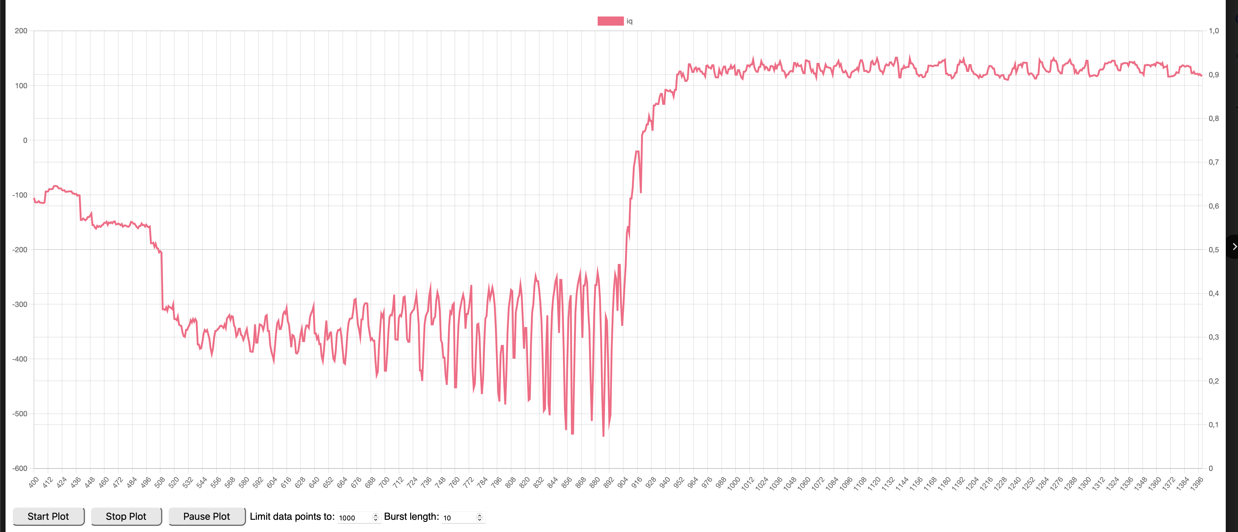

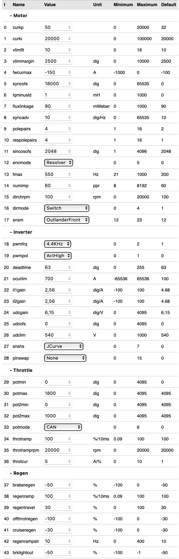

hi all,
i have a triumph spitfire with a mitsubishi generator as a motor and i was running it on the stock inverter. this was working super smooth but I felt like there was more in the motor so i gave the openinverter a try, i got the mini mainboard and put it in a opel ampera inverter. i got it running on the bench before on firmware 5.14, now the inverter is in the car i updated to the 5.24R version. it was a bit of a fight but i finally got it running, and how is it running!? the motor has a LOT more power so i'm supper happy. but i have a couple of questions, first i don't get the regen working. i do run the throttle via the CANbus so maybe that has something to do with it? i mapped it correctly i think, the first part of the throttle is doing nothing because that is the regen part i assume? and after the first part i got the potnom from 0 to 100%. is there something i'm overlooking here?
secondly, if I give it a lot of throttle and the motor speed starts to increase. the Id current starts to oscillate and eventually trips the overcurrent. if i lower the throtcur then it won't trip but i can still see the Id oscillating. i can simply rase the ocurlim but eventually something will break. it looks like the oscillating starts with RPM and not especially with current, is this normal or can i do something with tuning to prevent this? so the Id line starts nice but af the speed of the motor goes up during the graph the oscillating starts.
Id current graph
Id current graph
settings dump:
to be clear, I'm already very satisfied with the performance now, but I mainly wonder if that oscillation is normal
thanks in advance for the help

I'm assuming that this is a permanent magnet motor from you captures and that you have syncofs corretly tuned? If so then it looks like you need to get the lqminusld, flux linkage, fw current and kp/ki values tuned to your motor.
Do you have any more details on the motor or a way of measuring the motor inductances? Alteratively if you can run and log the motor use you can use the calculator to work them out https://openinverter.org/forum/viewt ... p?t=3047
Once you have those set up right ki and kp need tuning, you can either do this by trial end error, start from values people have used on motors with similar values or use the simulator to see what type of value might work well https://openinverter.org/forum/view ... ?t=2611

In that case your Ki is probably way too high for such a low inductance motor.

my syncofs is correct I think, I followed Damians video for tuning this and also read the wiki about this. motor is not turning in manual mode if I put some Id current, up to 100A or so. what strikes me is that the margin appears to be quite large at 14000 the motor was slowly turning one way and at 22000 it was slowly turning the other way, all the values in between is the motor not spinning so I put 18000 in there because that is the middle. that was my thought. maybe if I tune the other values you suggested I can redo the syncofs tuning.
@Bigpie, so all the values Pete9008 suggest are already in your params? I'm looking forward to test this in the next days if I found some time.

Not sure Bigpie's link above is working but they are also listed here https://openinverter.org/forum/view ... #p53764
He's spent a lot of time tuning these so they should be an excellent base to work from. Obviously keep your own installation specific values as they are and just copy across the motor specific ones from Bigpies parameters.

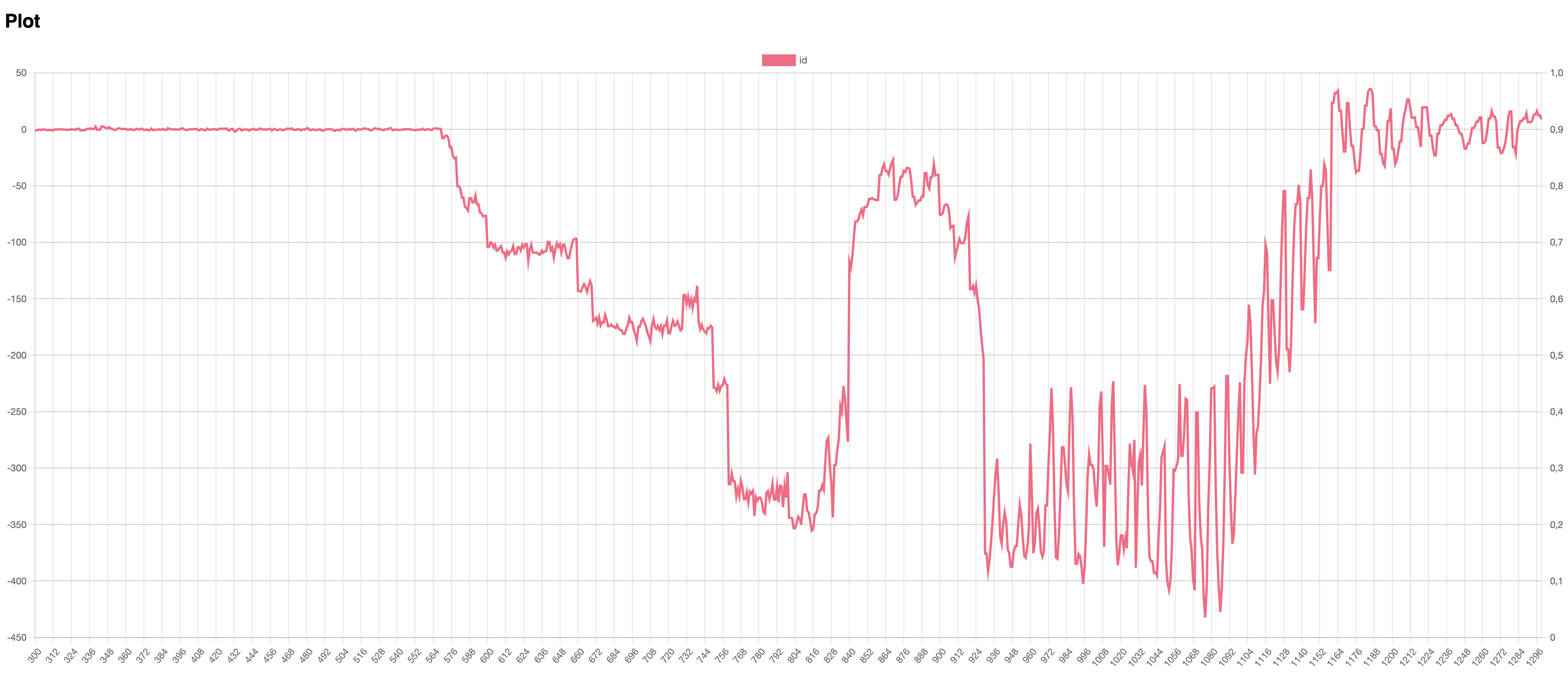

i have tested the parameter settings from bigpie, the. motor runs smoother and better especially from a standstill so i'm happy. it had so much power that it broke the coupling so i need to redo it, so that caused some delay. but the Iq current oscillation is still happening, it is less but it is still there and trips the overcurrent eventually. do you have any idea what is causing this? I would guess it's in the current control loop, but then i only have the curkp and kurki to work with?
the regen is working btw, idle mode setting was not set.

That does look like a current loop stability issue. It also looks suspiciously like an instability I've been chasing when using the simulator recently (see https://openinverter.org/forum/v ... 69#p53769 ) but to date hadn't seen any evidence of it happening in real life. What speed does it start to happen? Is it anywhere around 550Hz ( 8000rpm)? Is it present in both Iq and Id?
This is going a bit off topic now so it would probably be best to start a new thread specific to this issue.
Edit - or even better a build thread - would be great to have a few more details and some pictures of your car :)
