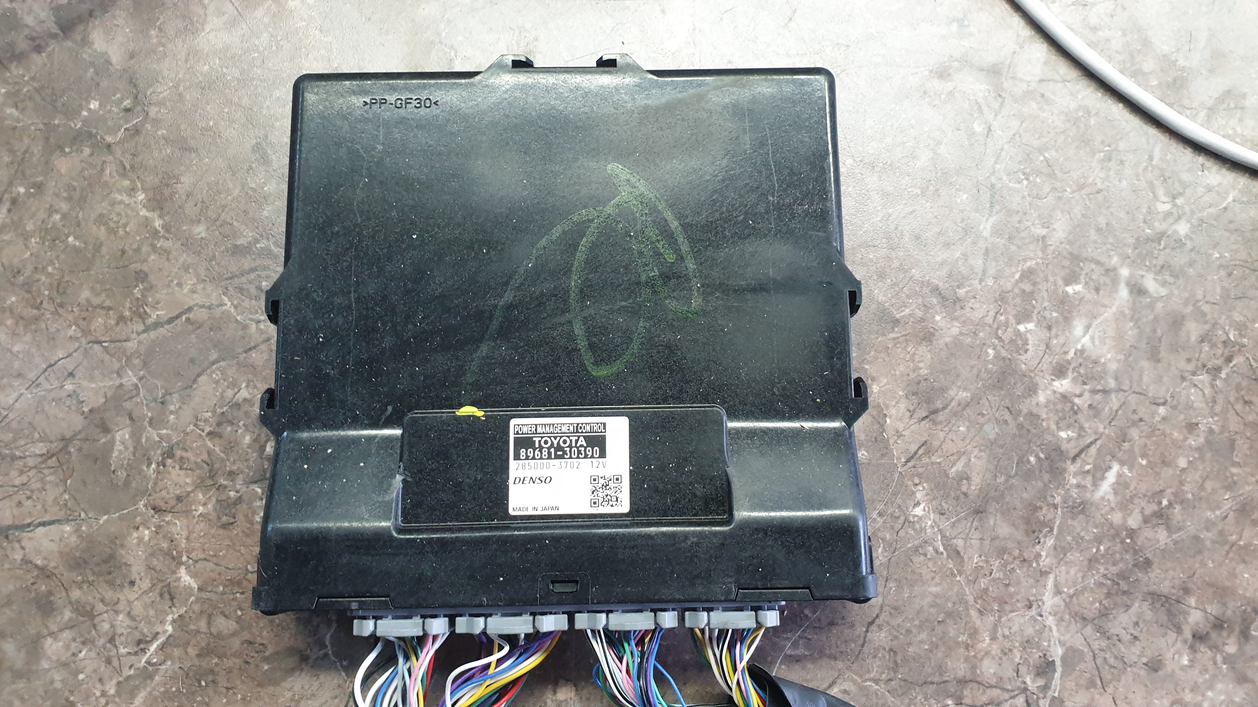

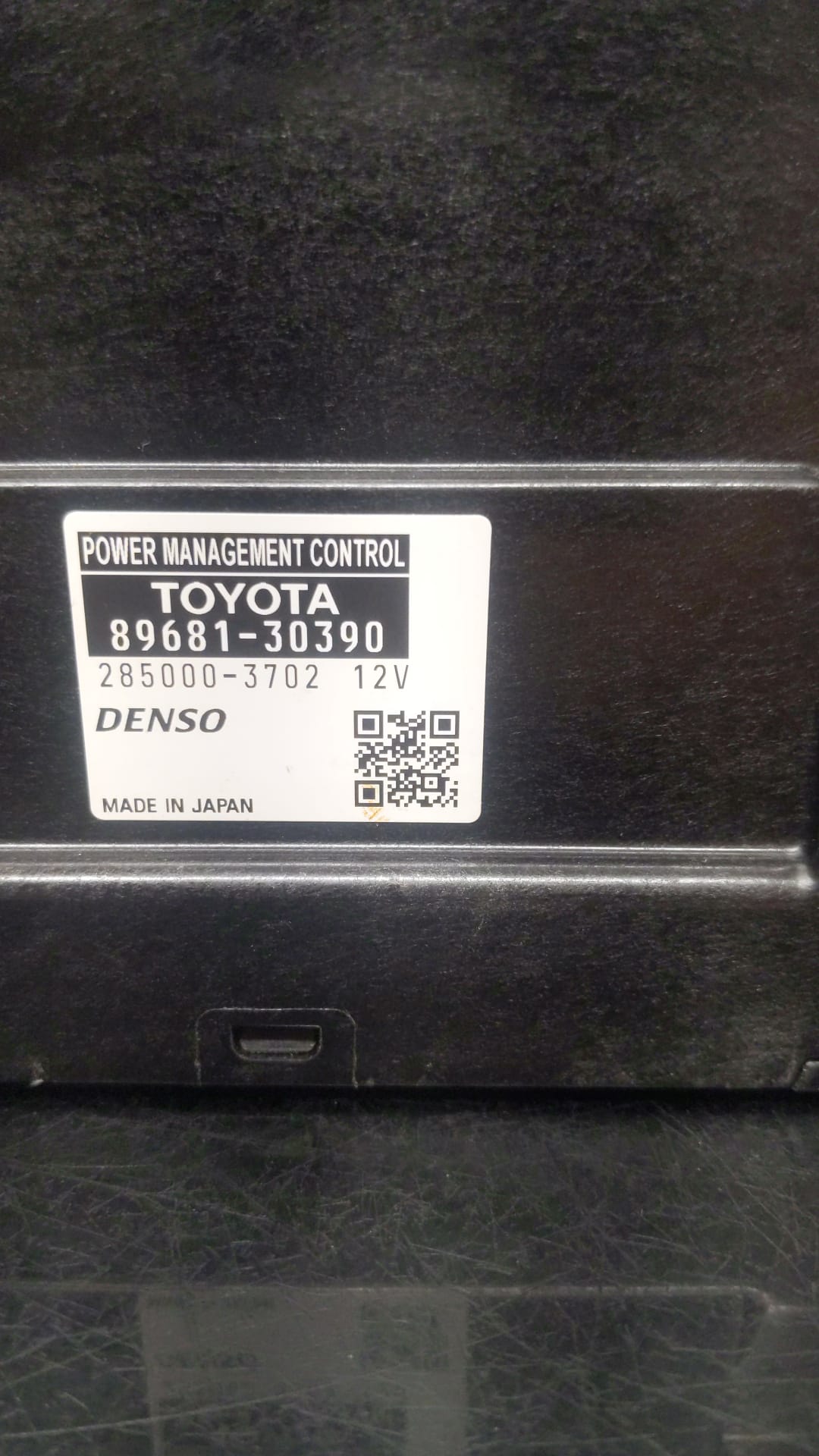

Got hte gs300h hybrid ecu today. Looks like a HTM packet of 105 bytes and MTH 140 bytes. Seems quite similar to here :
viewtopic.php?p=37578#p37578

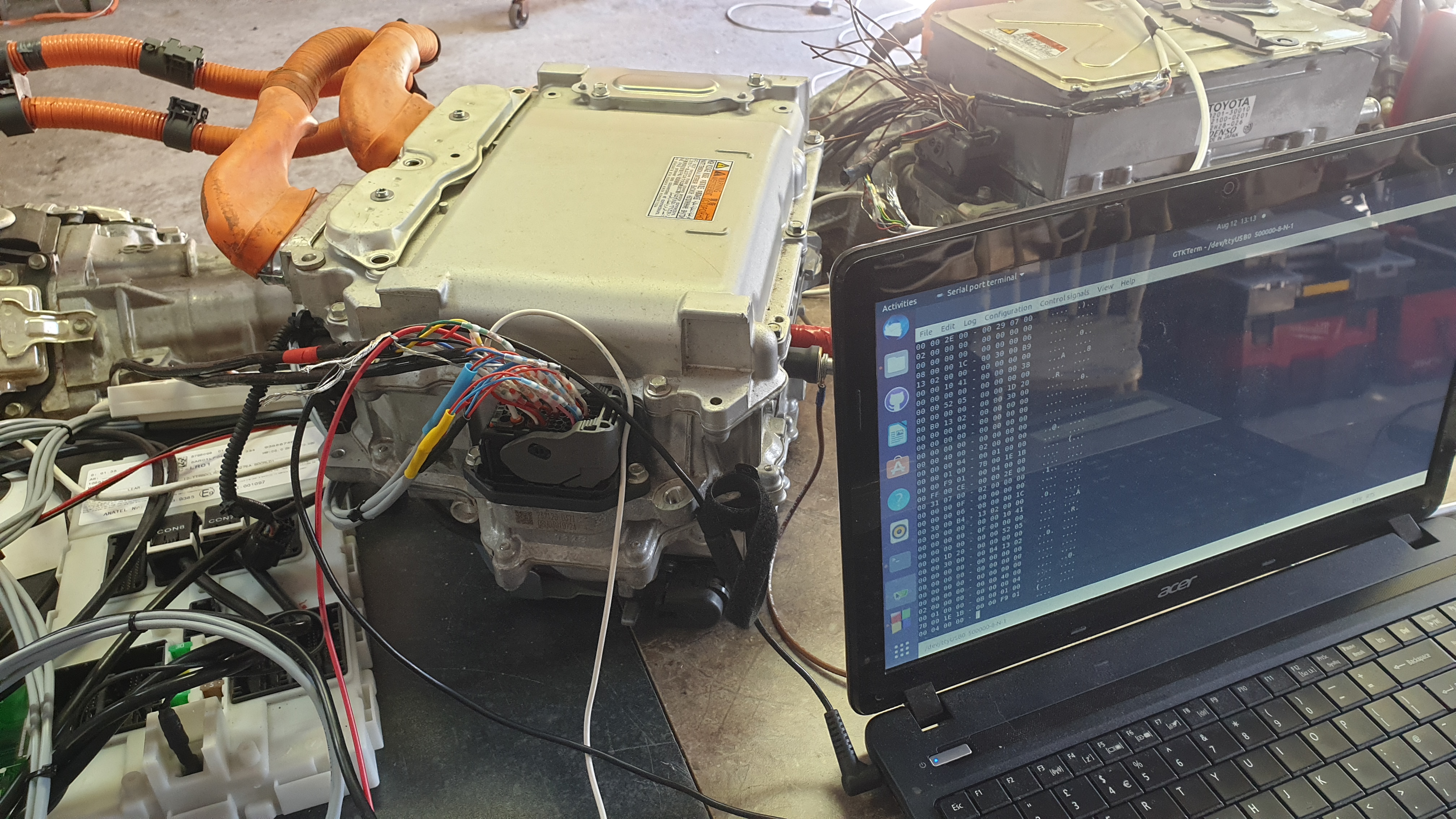

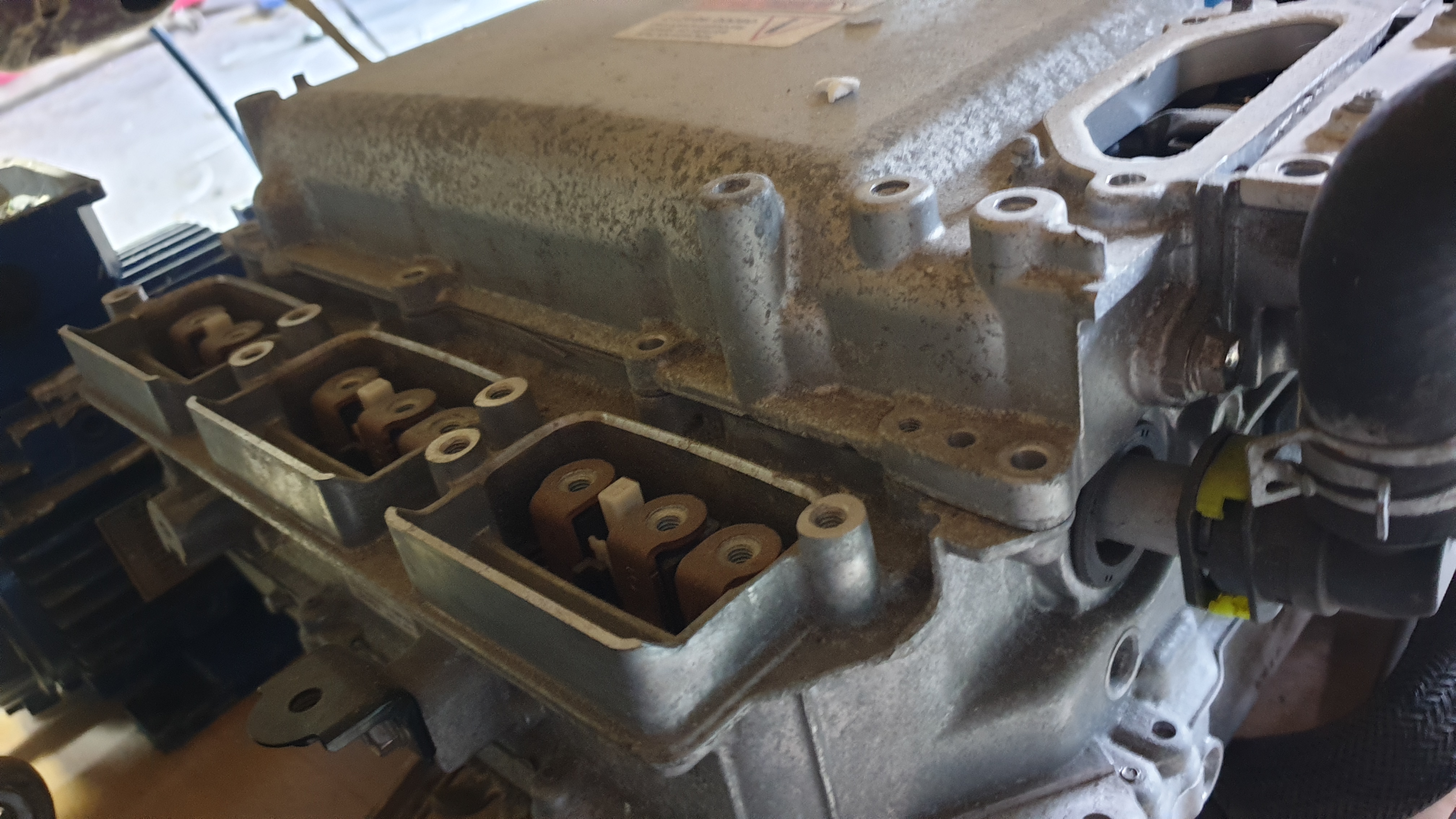

I'll let this speak for itself while I go clean up the oil spill. More details to follow.

Awesome awesome work. I wish I was able to do the same with an rx450h inverter
Posts: 4000
Been thanked: 1115 times
Re: Is300H Inverter Hacking
Thanks:) I have an Rx450h inverter waiting on the bench. So just found the MG1 and MG2 torque commands. With a bit of luck will have code released next week for the Zombieverter VCU and the original Lexus gs450h vcu for running this system. Biggest hurdle was my python script seemed to be one column out with the data sorting. Once I realised that the inverter woke up:)

Ev8 wrote: Fri Aug 19, 2022 4:24 pm Awesome awesome work. I wish I was able to do the same with an rx450h inverter
You mean like this one:)
Full throttle control of MG1 and 2 now working with the GS450h vcu. Porting to Zombi on the way.
