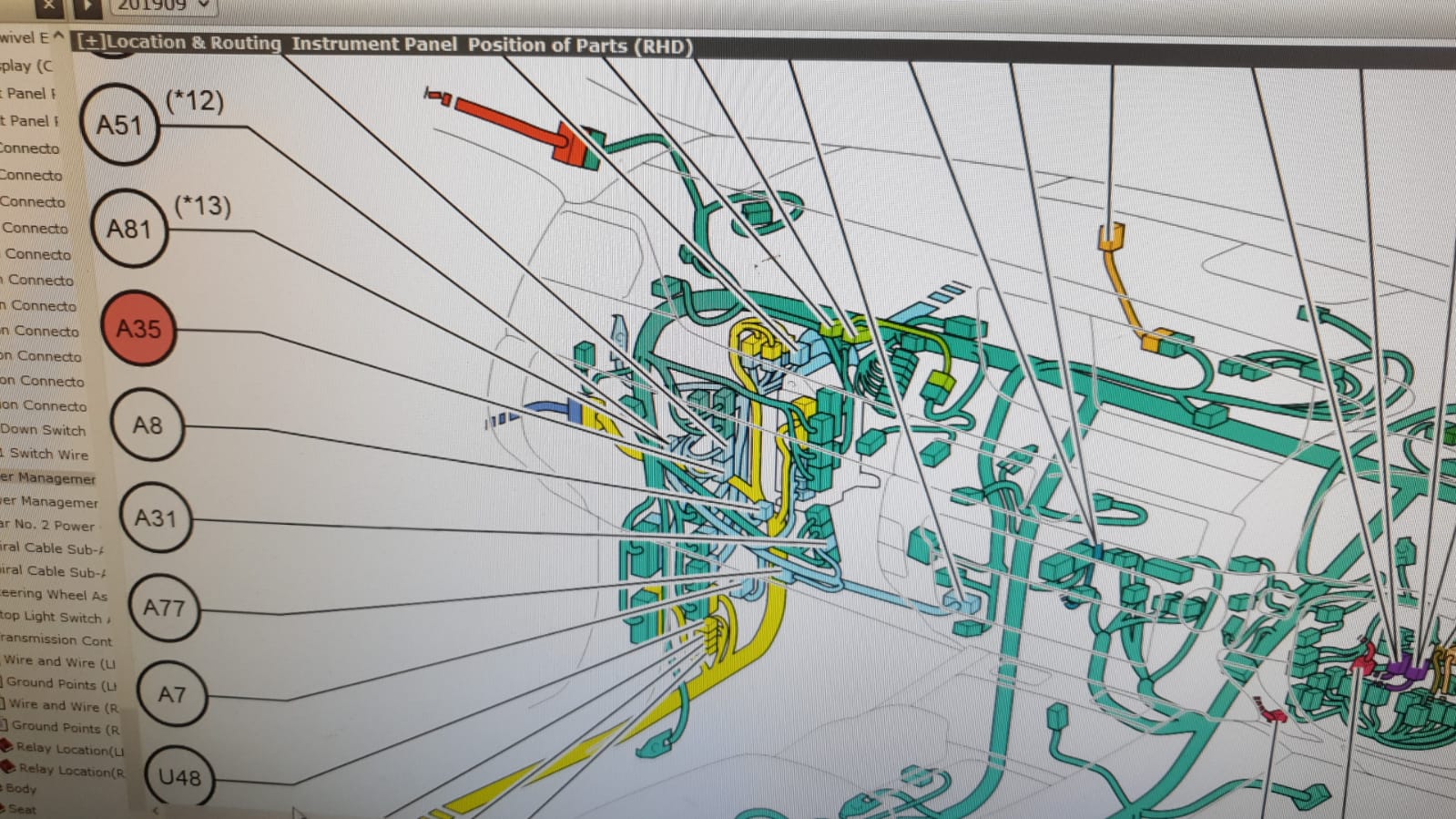

Decided to start a separate thread for hacking the OEM Toyota/ Lexus IS300H inverter. Hooked it up to the VCU today and surprise surprise the serial protocol is different to both GS450h and Prius Gen3. How much so am unsure as yet. Grabbed a few MTH logs for analysis. Have also got a line on a GS300h hvecu which I hope to have in a few days for more analysis as I doubt it will be possible to get a log from a running car.

GS300h hvecu location.

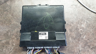

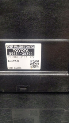

Got hte gs300h hybrid ecu today. Looks like a HTM packet of 105 bytes and MTH 140 bytes. Seems quite similar to here :
viewtopic.php?p=37578#p37578

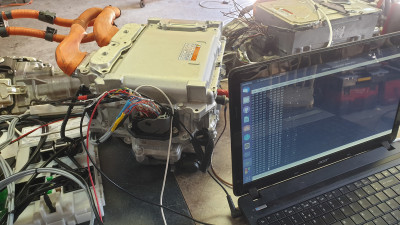

Ev8 wrote: Fri Aug 19, 2022 4:24 pm Awesome awesome work. I wish I was able to do the same with an rx450h inverter
You mean like this one:)
Full throttle control of MG1 and 2 now working with the GS450h vcu. Porting to Zombi on the way.
