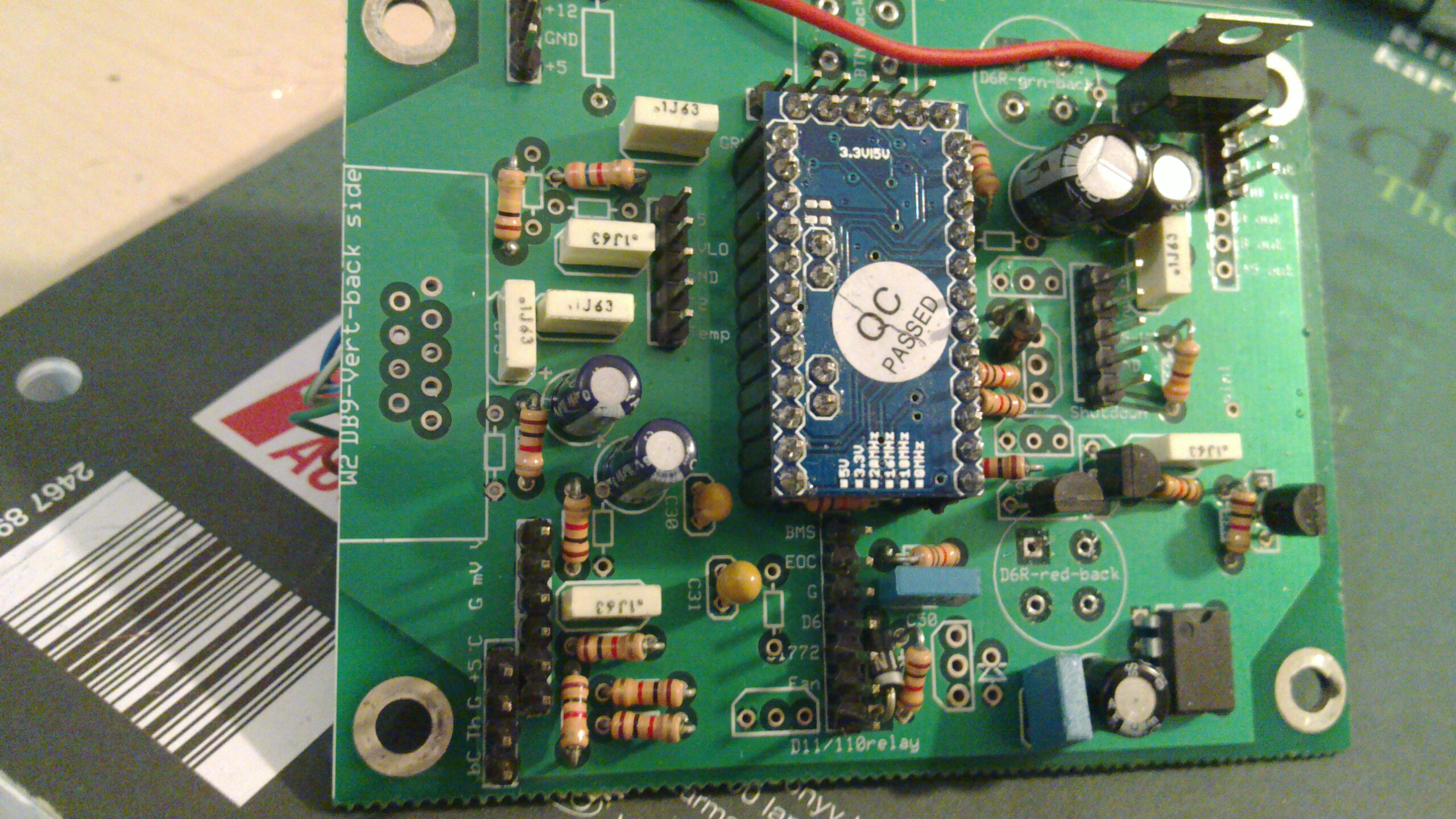

I decided to start and make a charger with Prius inverter.
I will use a complete inverter with casing. It will be water cooled. as intended.
I will connect 3phase input directly to MG2 (MG1) RST contacts. Reverse diodes inside transistors will act as rectifiers to make 580Vdc from 380Vac. Precharge will be made with 3x 20W 220R resistors across contactor pins. Voltage usually rises up to 500Vdc in 20s. I will put some delay in software.
I will use BUCK configuration from AC towards DC side in the same configuration as former EMW DIY charger. I will not use PFC control (no use since it would complicate things much). Main chip will be Arduino Nano which is in every way the same as pro mini of old.
I decided i will not use original current sensors. They are located on MG lines that will be my inputs. I would need to calculate PWM difference etc... Rather i will put one Tamura L31S100S05FS 5V or such sensor after capacitor output line.
There is still a problem where (if) to mount output diode. But if we consent to keep charger permanently connected we can use an NTC resistor across DC contactor to keep positive DC link precharged. I always use diode like VS-RA160FA120. It could be mounted directly to the car chassis to dissipate heat.
Additionaly i will use dedicated relay to turn on DCDC 14V power unit for those cars that have main battery voltage 150Vdc to 310Vdc. Also i will use main cooling system for inverter and charger with single pump driving the system
What we know about signals in Prius gen 3 inverter. Thanks Damien.
- To drive charger i will use EMW setup with some of my twists :).
- HVIL = High Voltage Interlock. For DIY built we can ignore this one IF we use our own safety in maintenance - our brain.
- Fault signals are 5v when not faulted and pull low when a fault is detected. I will definitely use this with some NC interface to inhibit PWM
- I will use original NTC and later compare characteristic to semicron in code. If not i see i can use whatever sensor on the coolant line i can imagine :).
- Current sensors are 5v centered and react at 10mV/A
- MG and BOOST drivers have their own pullups in the circuit and we can ignore them if we dont use them.
- Since i will be using HCPL-7520 to sense output voltage i will ignore DCBUS contacts for now. Maybe later in adaptation we could just use that I/Os and adapt the code.

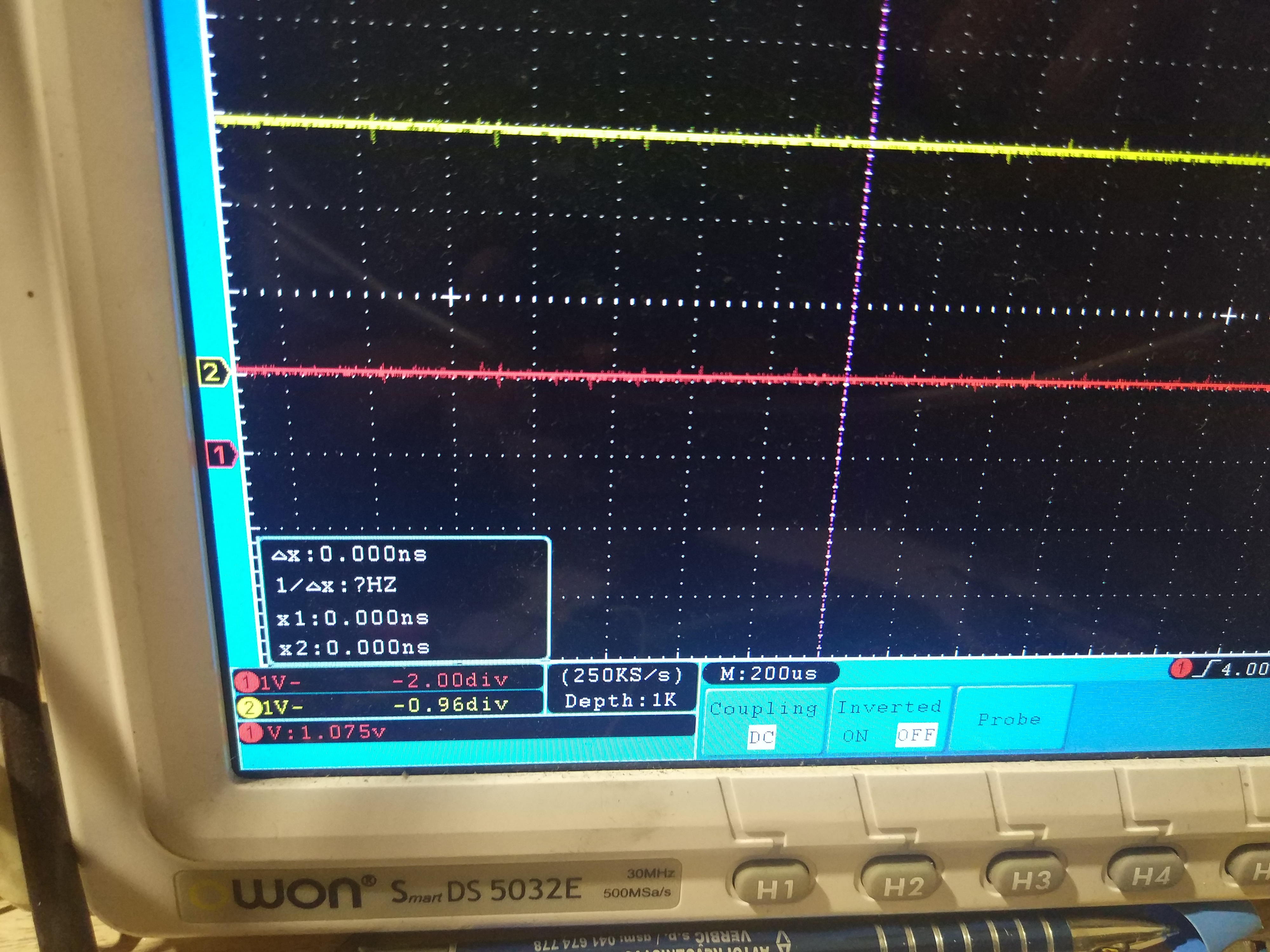

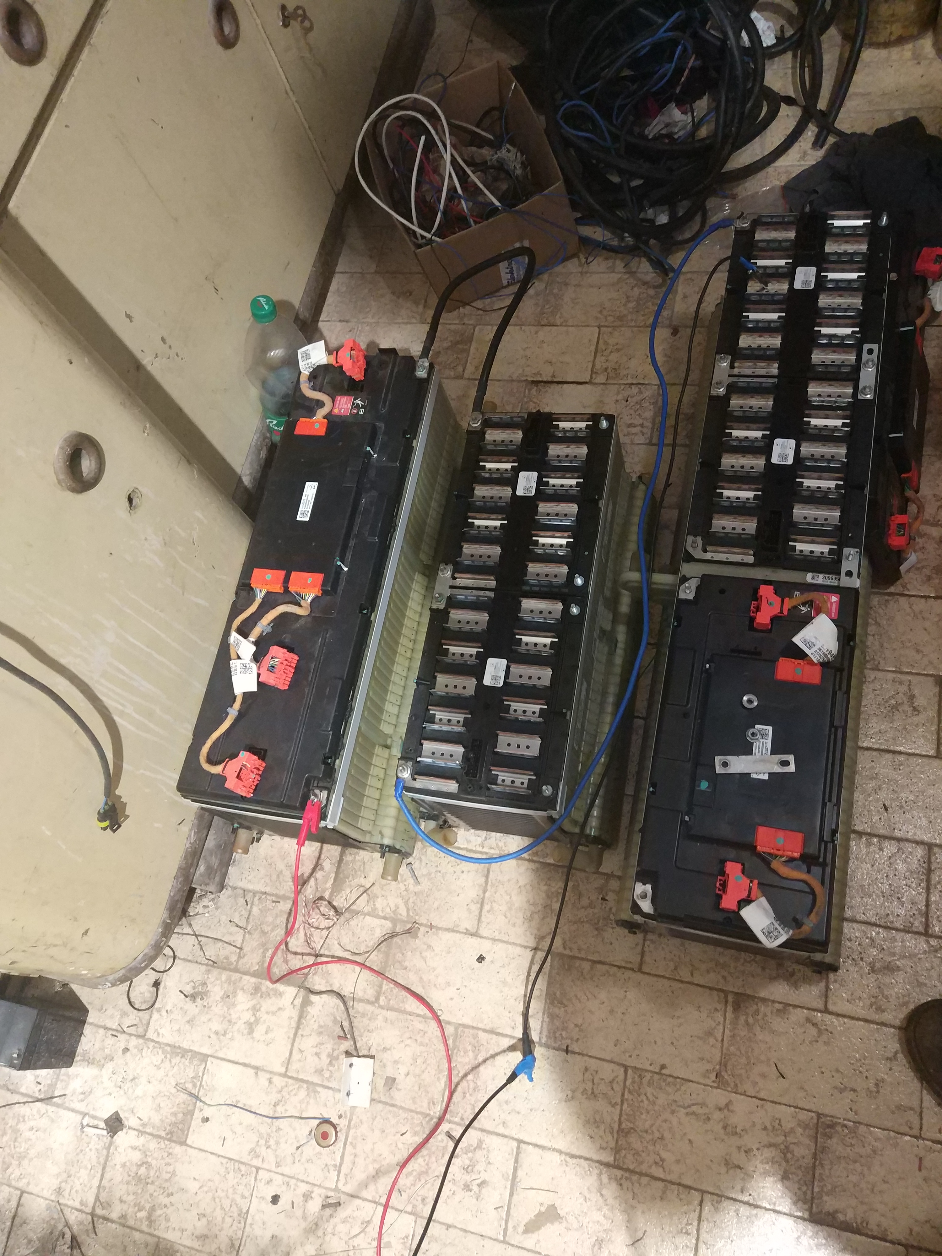

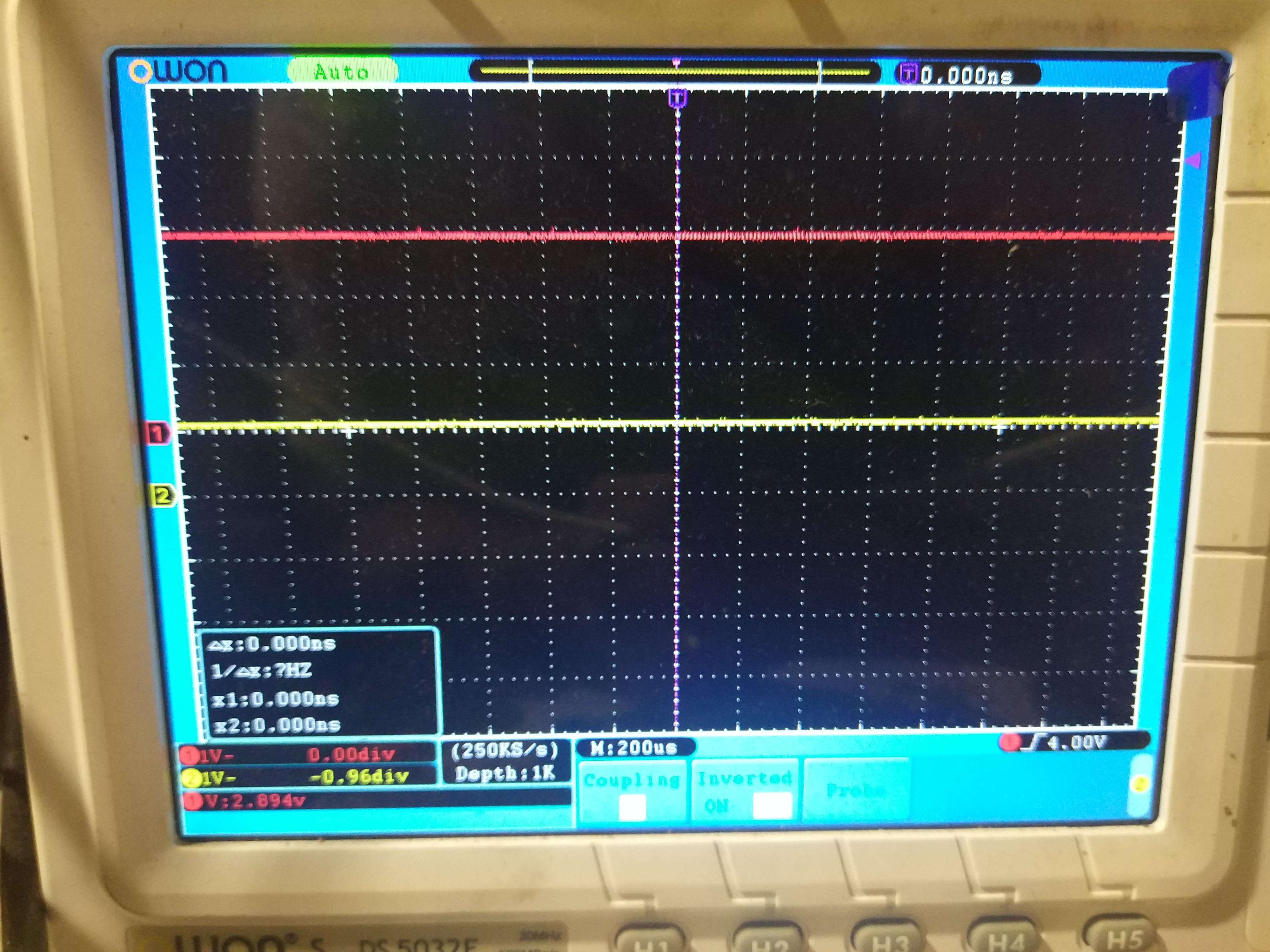

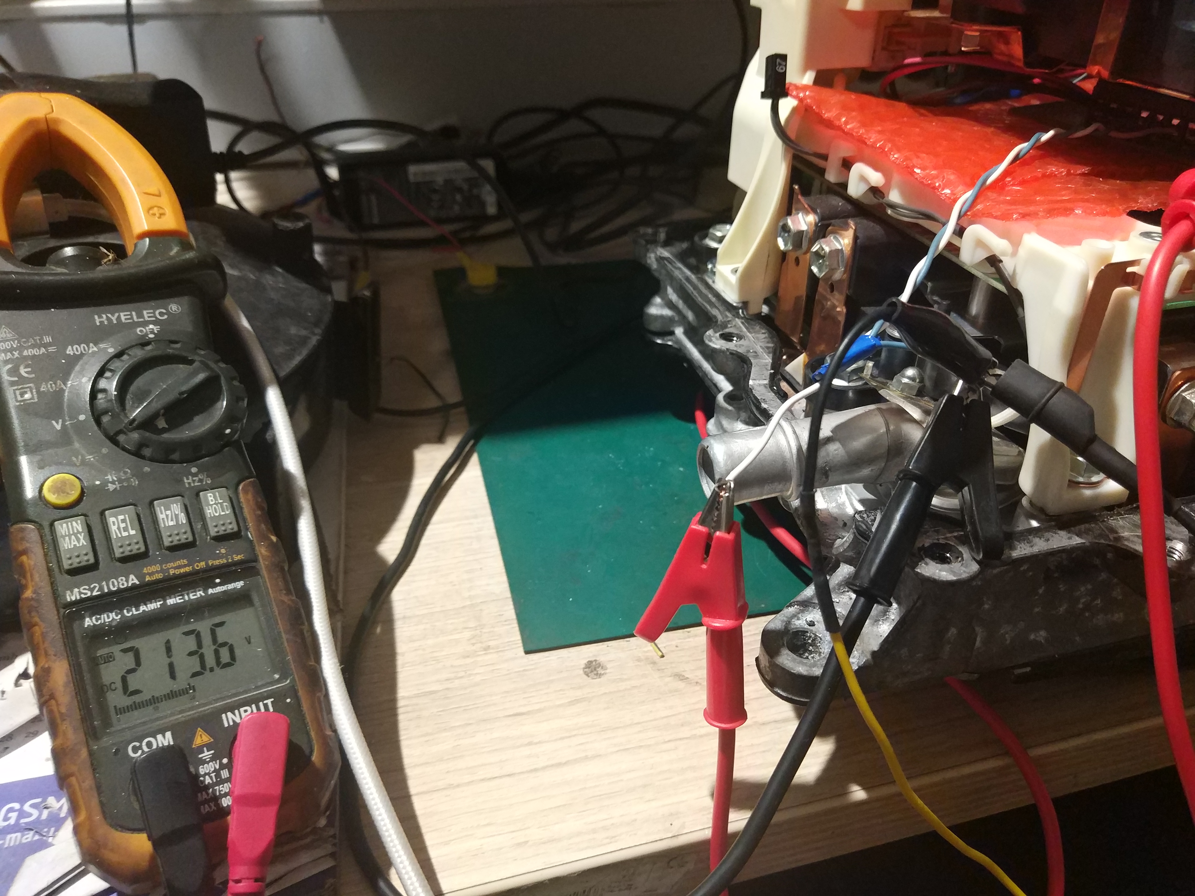

OK Guys!
I have connected my Ampera battery to Prius inverter and observed DC_BUS1 and DC_BUS2 signals. There are three power supplies needed for operation of power section. I used Lab PSU for 13.7Vdc and 2x simple 5V 1A ACDC power supply. Since we need to supply -5V and +5V i wired outputs in series so i got +5V, GND and -5V. This can be done because both 5V supplies have isolated inputs. I see i will have to make 2 simple split supplies for my board design similarly to what JB did.
Heres what I found out:
1. DC_BUS1 measures voltage on the Battery side, when battery is disconnected it is effectively 0V.
2. DC_BUS2 measures voltage on the motor DC side. When i move outside source its value is 0.554V.
3. When battery is at 213Vdc i get DC_BUS1 value and DC_BUS2 value 1.075V.
I could go up to 380Vdc with Ampera battery and i arrived to BUS voltage 4,758V.
I can see from data that battery voltage is limited to something around 400Vdc. There DC_BUS1 becomes 5V and Arduino AD wont be able to reference above that. I have yet to try over 400Vdc. I have 32V power supply which i can wire in series with battery. This will show how high this inverter can go.
Also i intend to try to connect 3phase 400Vac and inverter should make 600Vdc rectified.
I input rest of values into XLS file to interpolate between them, see the file.
EDIT: I had my first try at interpolation :)
Prius Voltage response.xlsx
(25.82 KiB) Downloaded 841 times

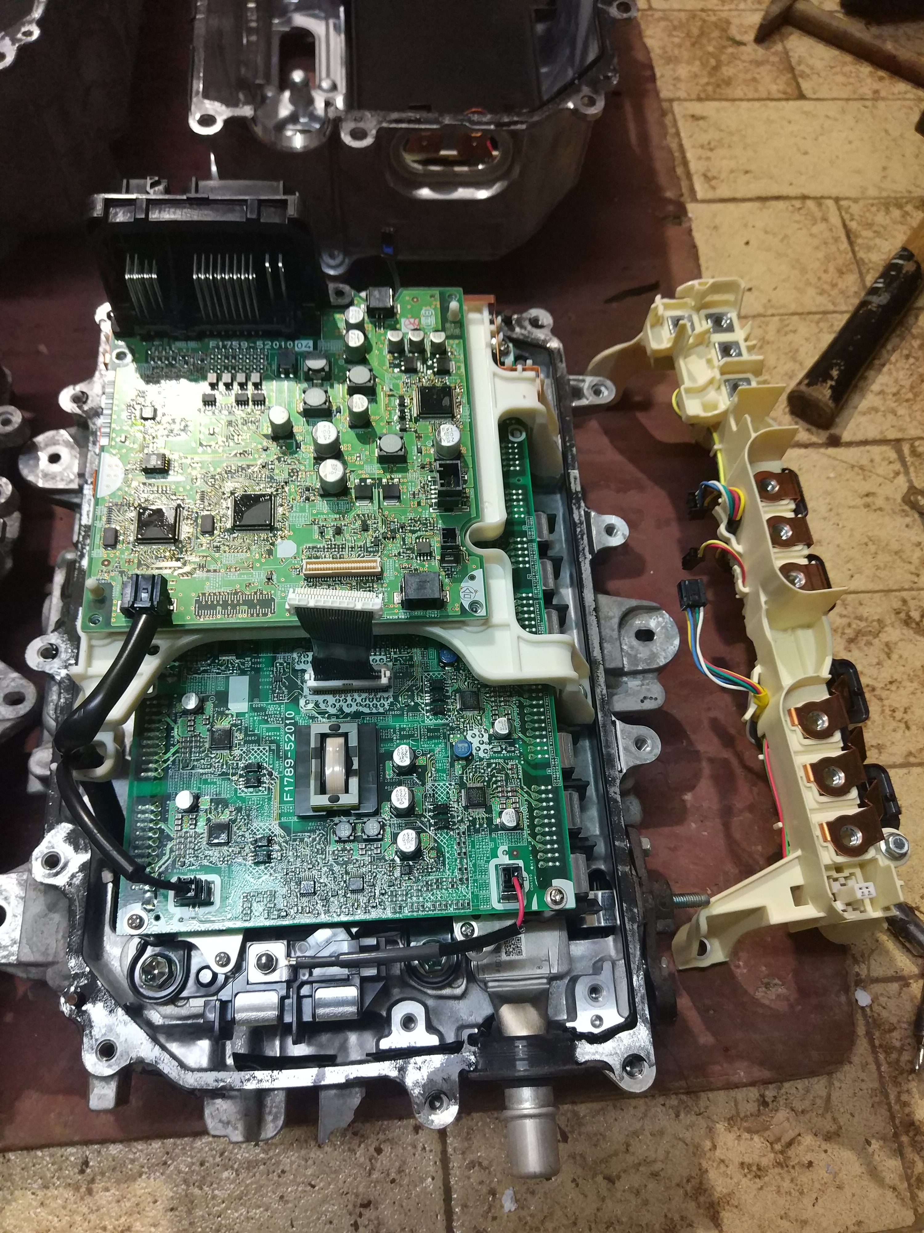

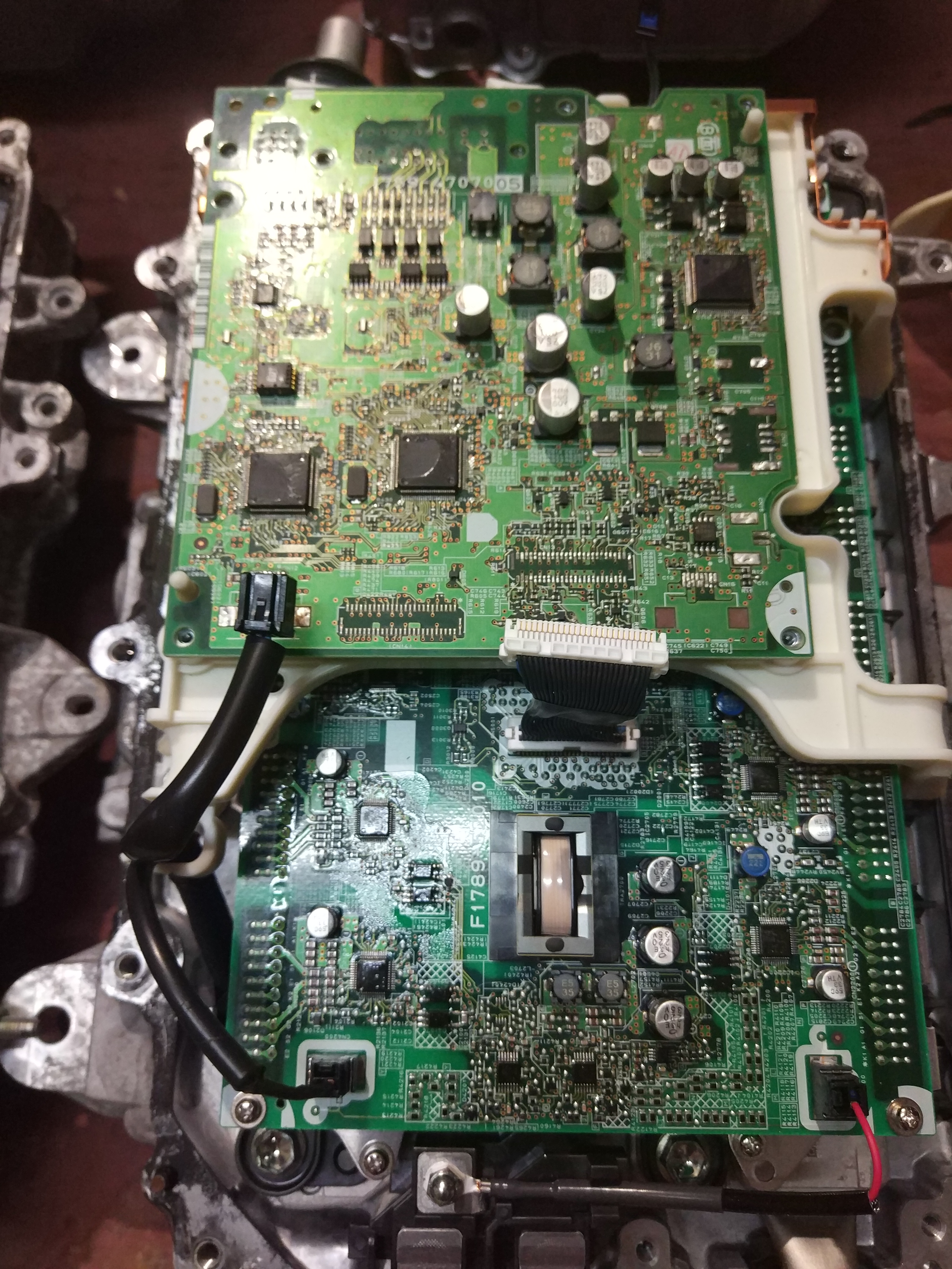

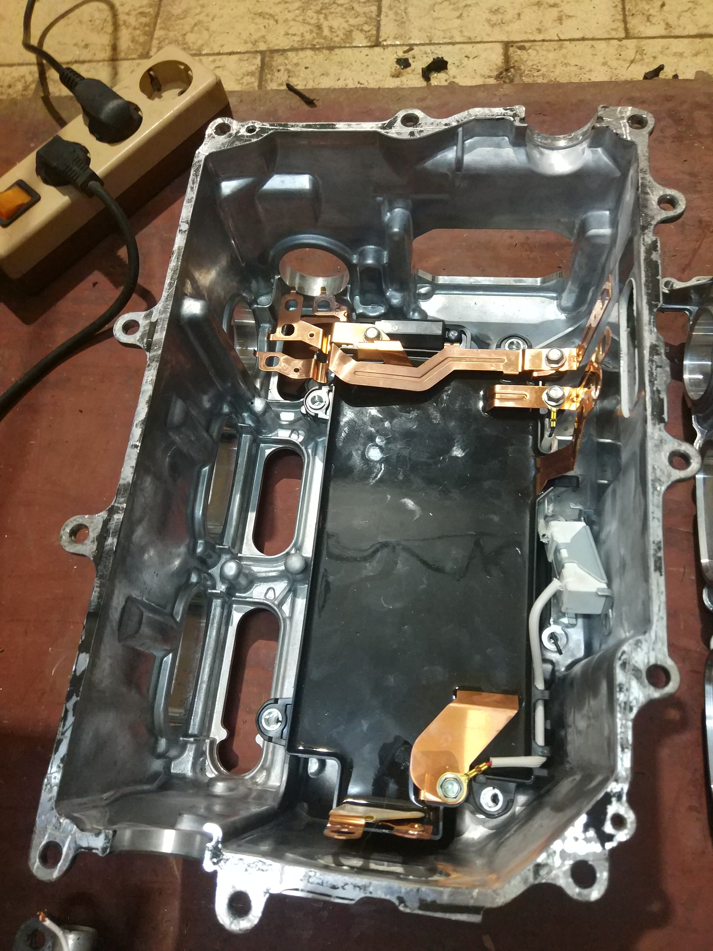

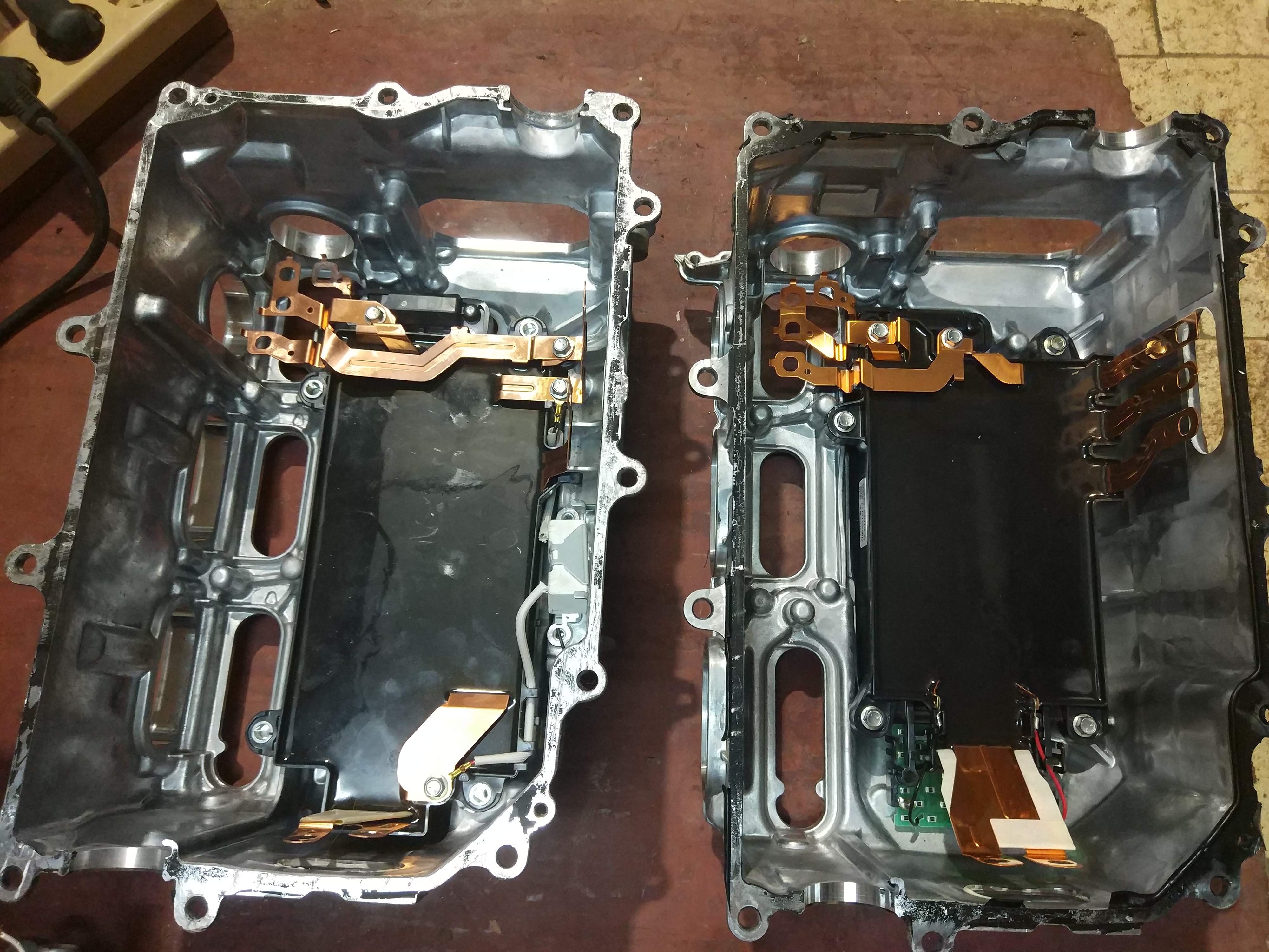

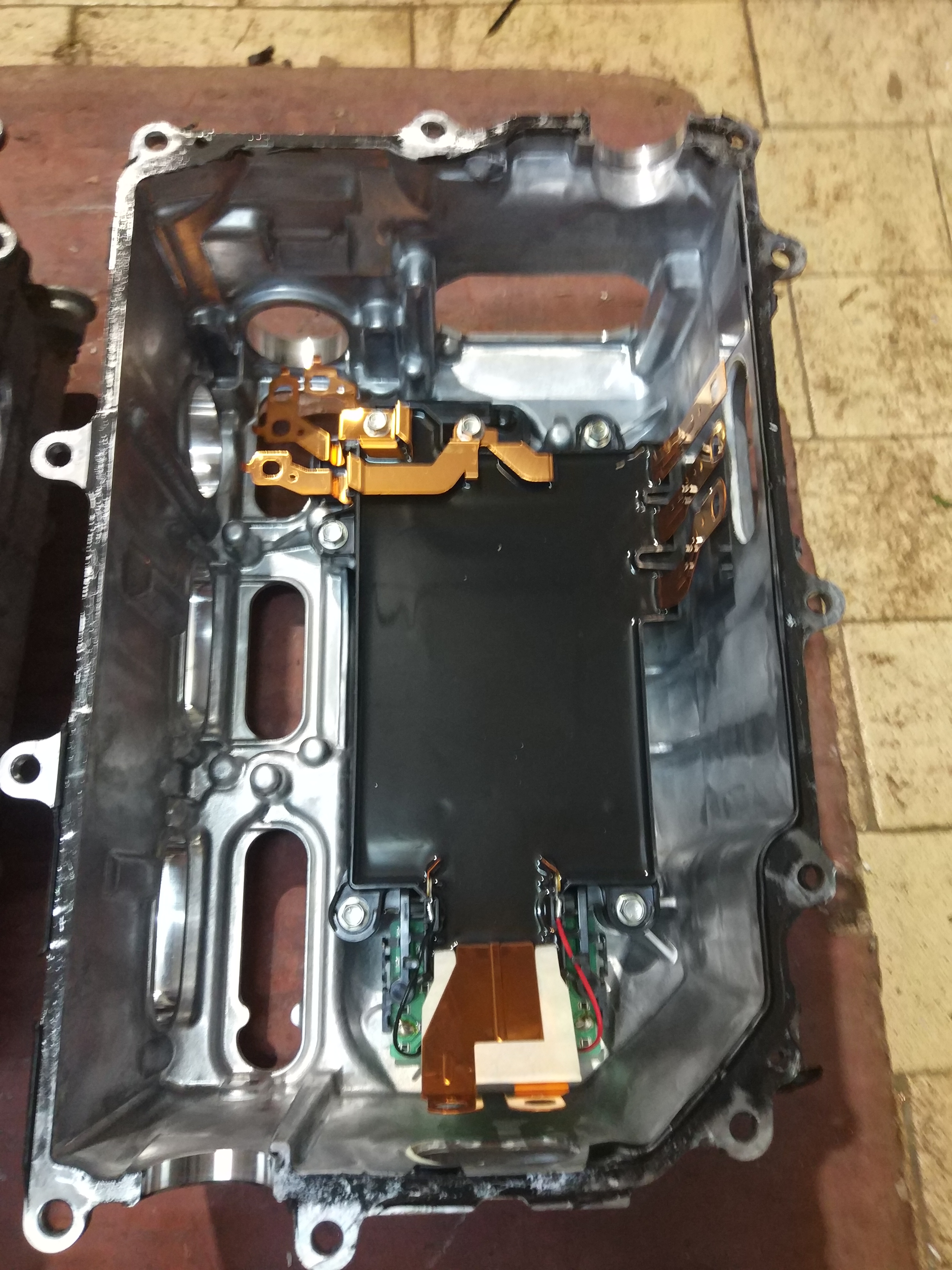

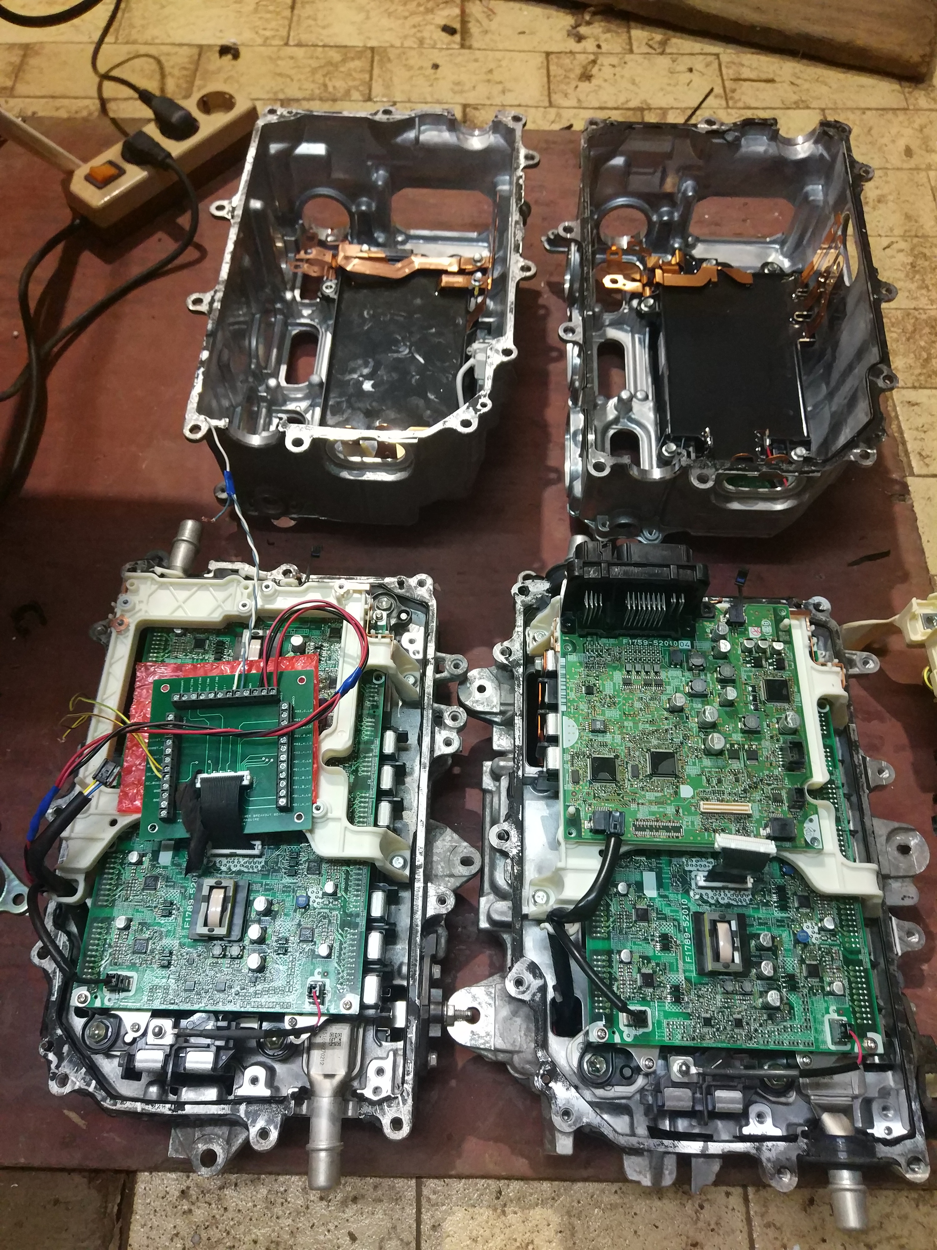

I got Toyota Yaris inverter at home. Thank you Damian.Io.
I immediately went to disassembly. I used a flat screwdriver to pry open the seal and took the lid off. I was surprised how small main capacitor is.
Next i took off the current sensors which look the same as the ones on Auris inverter btw.
Then i came to main board which is EXACTLY the same as my Auris main board. I even switched them on their mounts and each connector fits.
So now that i know those things i can safely make a universal charger board. Some pics...

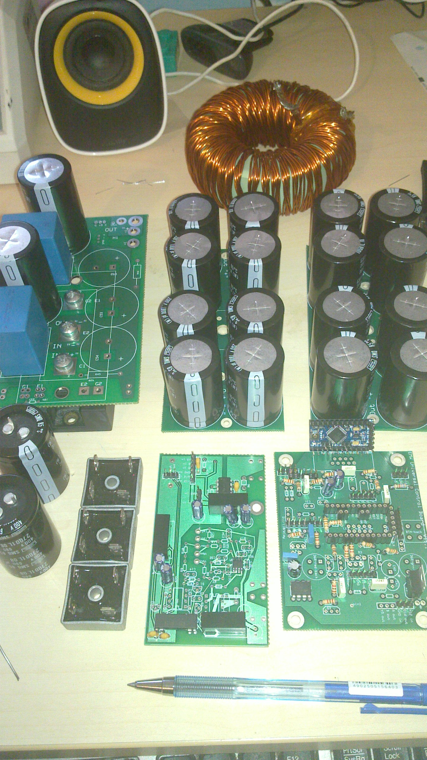

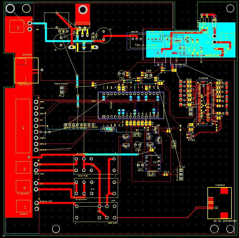

Main boards for hybrid EMW charger were sent to manufacture. I used additional relays independent control of DCDC converter (if inverter will be OK with voltage), coolant pump and finally external AC and DC contactors.
I will have to add 100A 5V Tamura current sensor for native current control. Prius current sensors are too complicated.
After boards return i will populate them and play some with code to calibrate charger brain to Toyota voltage report.
Then comes 600Vdc rectified into charger!
