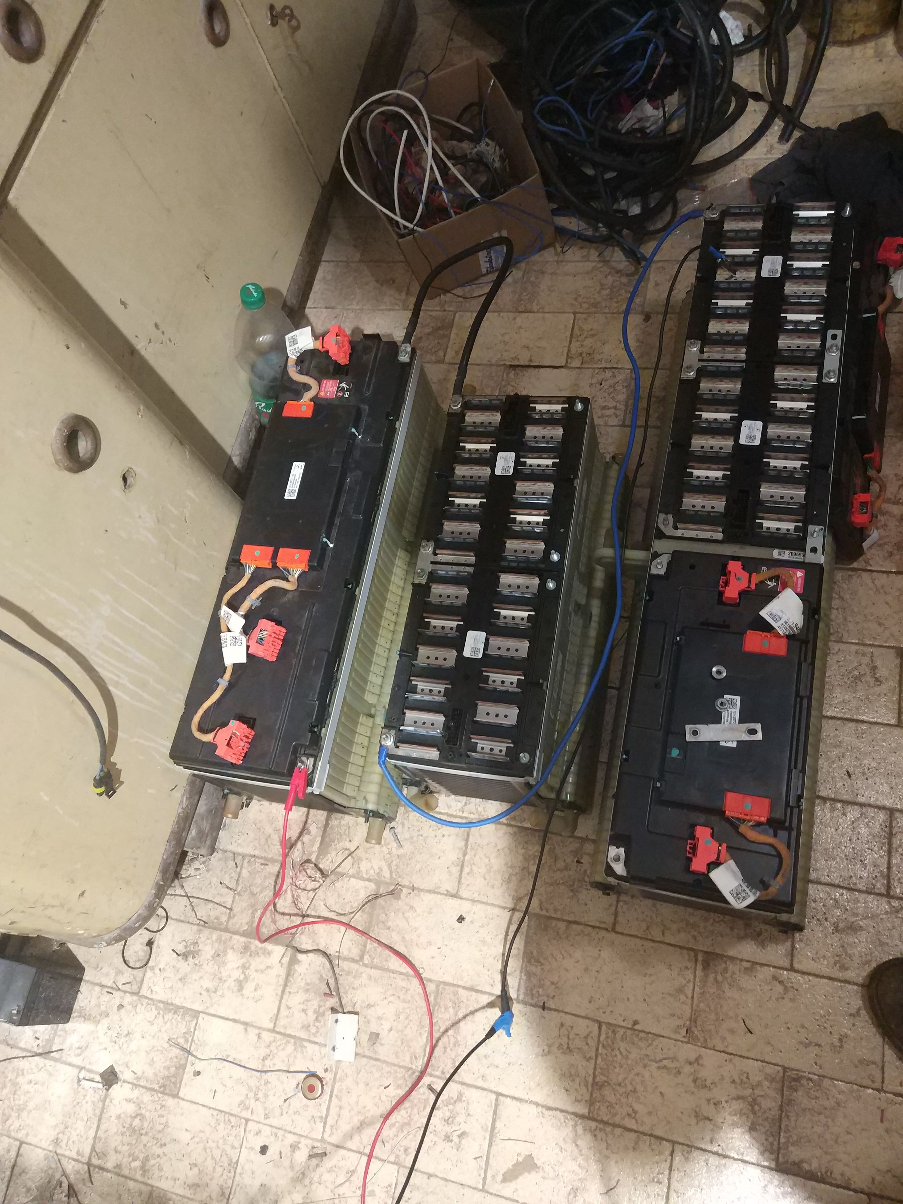

OK Guys!
I have connected my Ampera battery to Prius inverter and observed DC_BUS1 and DC_BUS2 signals. There are three power supplies needed for operation of power section. I used Lab PSU for 13.7Vdc and 2x simple 5V 1A ACDC power supply. Since we need to supply -5V and +5V i wired outputs in series so i got +5V, GND and -5V. This can be done because both 5V supplies have isolated inputs. I see i will have to make 2 simple split supplies for my board design similarly to what JB did.
Heres what I found out:
1. DC_BUS1 measures voltage on the Battery side, when battery is disconnected it is effectively 0V.
2. DC_BUS2 measures voltage on the motor DC side. When i move outside source its value is 0.554V.
3. When battery is at 213Vdc i get DC_BUS1 value and DC_BUS2 value 1.075V.
I could go up to 380Vdc with Ampera battery and i arrived to BUS voltage 4,758V.
I can see from data that battery voltage is limited to something around 400Vdc. There DC_BUS1 becomes 5V and Arduino AD wont be able to reference above that. I have yet to try over 400Vdc. I have 32V power supply which i can wire in series with battery. This will show how high this inverter can go.
Also i intend to try to connect 3phase 400Vac and inverter should make 600Vdc rectified.
I input rest of values into XLS file to interpolate between them, see the file.

I got it working by not using the low side switch at all. Did a test converting about 2kW into a 2kW 230VAC heater just now which it did at 39% PWM from 230VAC mains rectified to 300VDC. 39% of 300VDC equals 230VDC? Ehm... well it converts power, it's fine enough to me.
Now I need to find the encouragement to connect this to 3 phase. Already have the cable and connector, and I do have a 32A 3-phase RCBO (from china, of course) and a set of input side contactors with precharge resistors sitting on the inverter, with automatic control. So it should be a fairly "hands-off, look elsewhere" type of situation.
The sound is awful.
The sound is awful.

Bucking is always weird. I tried calculating the output voltage of inverter buck mode as input*dutycycle and failed miserable. It works perfectly for current in boost mode, output=(1-dc)*input.
good luck with 3-phase, can relate to what you're saying

While my control software isn't the most stable, it's likely I bucked about 7kW from a 16A 3 phase supply into two parallel 2kW heaters, outputting about 25A @ 270VDC.
That's quite useful. I had some brass rod, welding cable and stuff ordered. I'll make a DIY CHAdeMO connector so that I can use this as an external charger on the EVPrevia, as I'm too lazy to install it on the car right now and making a grossly out-of-spec portable CHAdeMO charger seems like fun.
