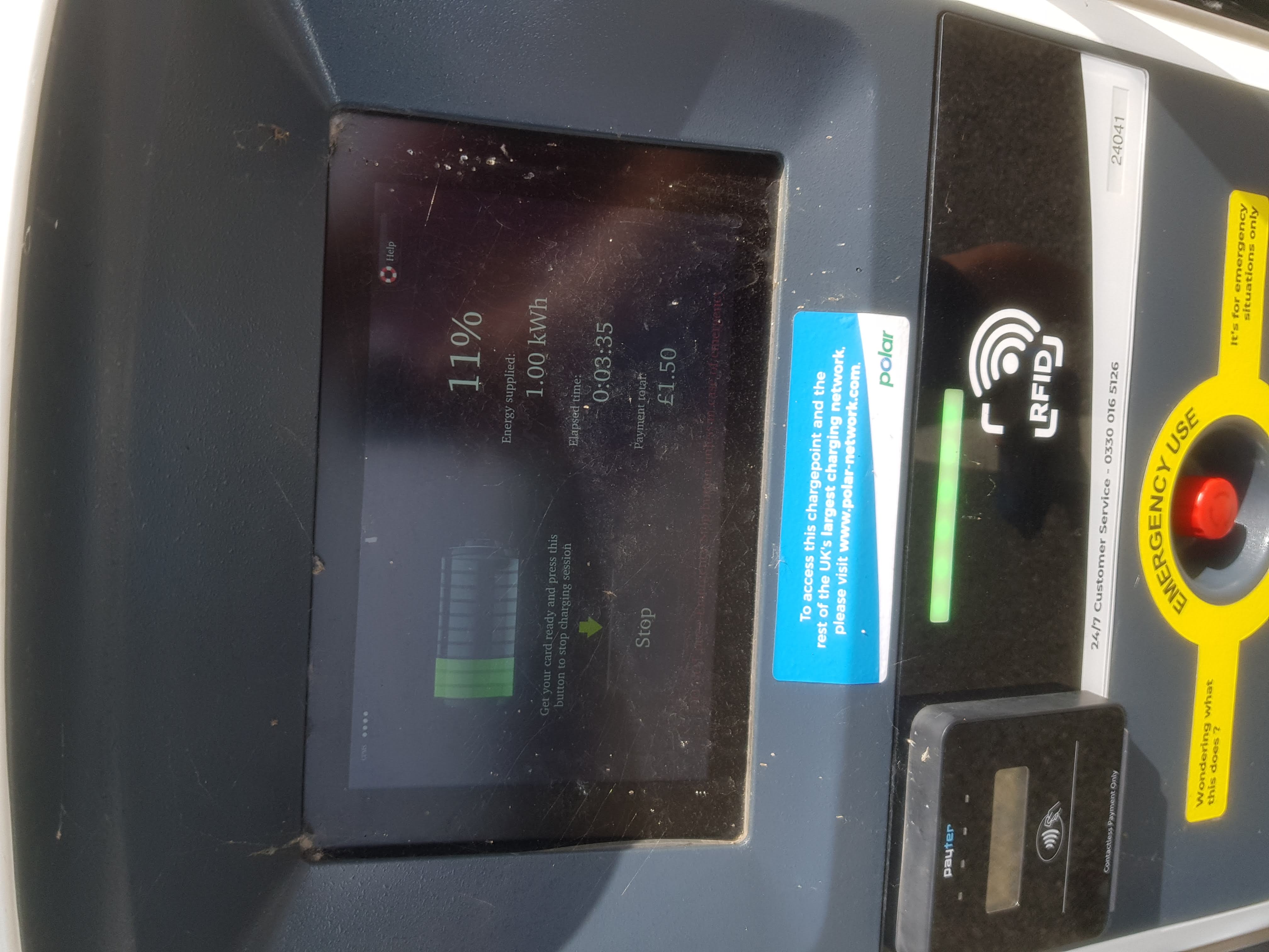

That's the ones with the advertising screens, right? If so they worked for us even with early ramping

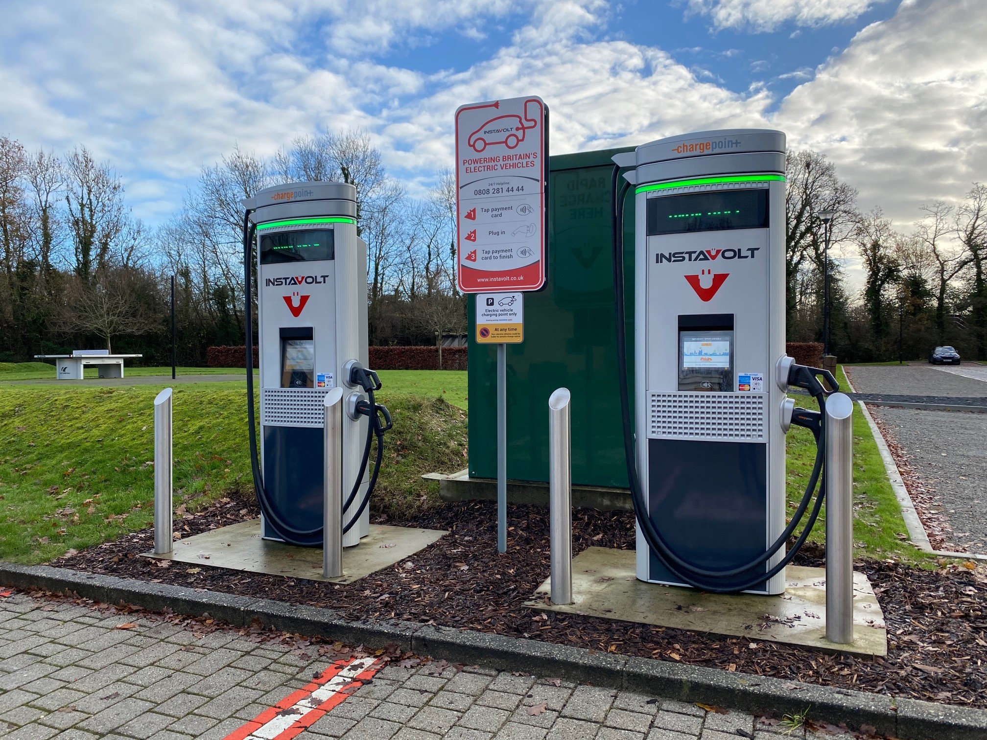

Dont recall advertisements, but they look like this
Pretty much stumped so taking a punt, dont suppose you have any logs from these units to compare with?
