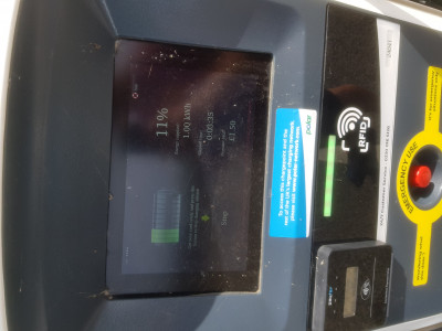

I'm having issues getting Chademo working on the InstaVolts. Other units locally work, but these InstaVolts are popping up all over the place so would ideally like them to work.
(IN1 is d1, logs show 1 when 12v applied and 0 when not, IN2 is d2, logs show 1 when not grounded and 0 when it is)
Anyone got any ideas what might be up? Log and can log attached.

Re: InstaVolt Chademo Failure
Having looked at these logs and logs of other stations that aren't an issue, the thing that stands out the most is the current requests starts ramping up before the reported voltage and car voltage are equalised. I've added an extra step in the code after closing contactors to wait until the reported station voltage is greater than (the cars voltage - 50) before going in to the RUNNING state. Will test and report back.

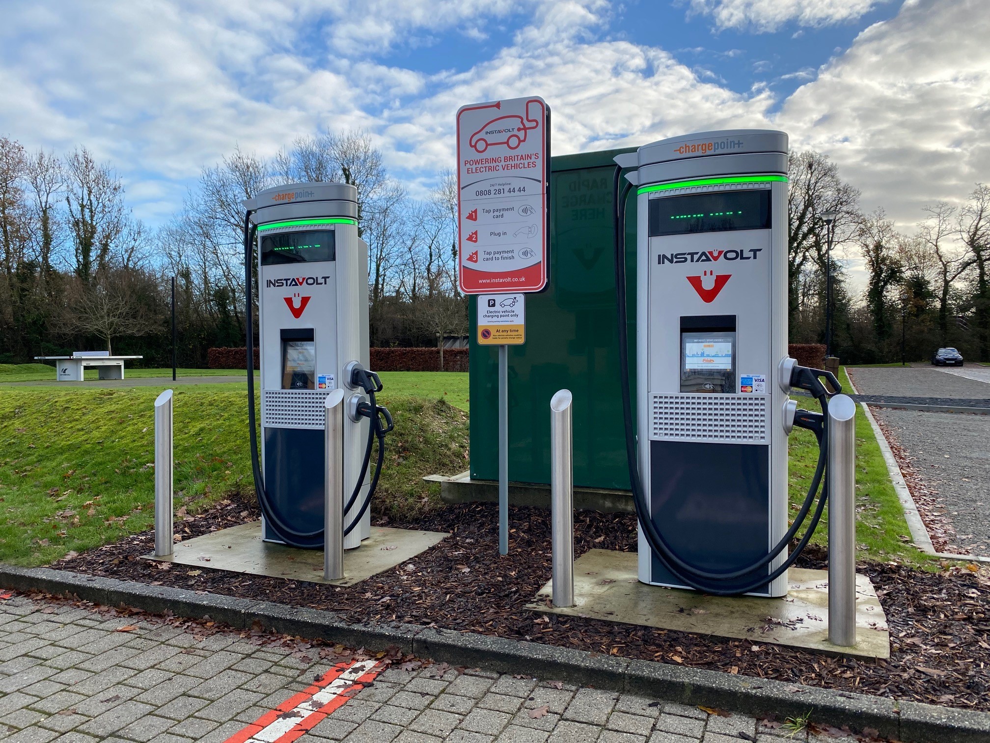

That's the ones with the advertising screens, right? If so they worked for us even with early ramping
- Posts: 1884
- Has thanked: 91 times
- Been thanked: 517 times
Dont recall advertisements, but they look like this
Pretty much stumped so taking a punt, dont suppose you have any logs from these units to compare with?
