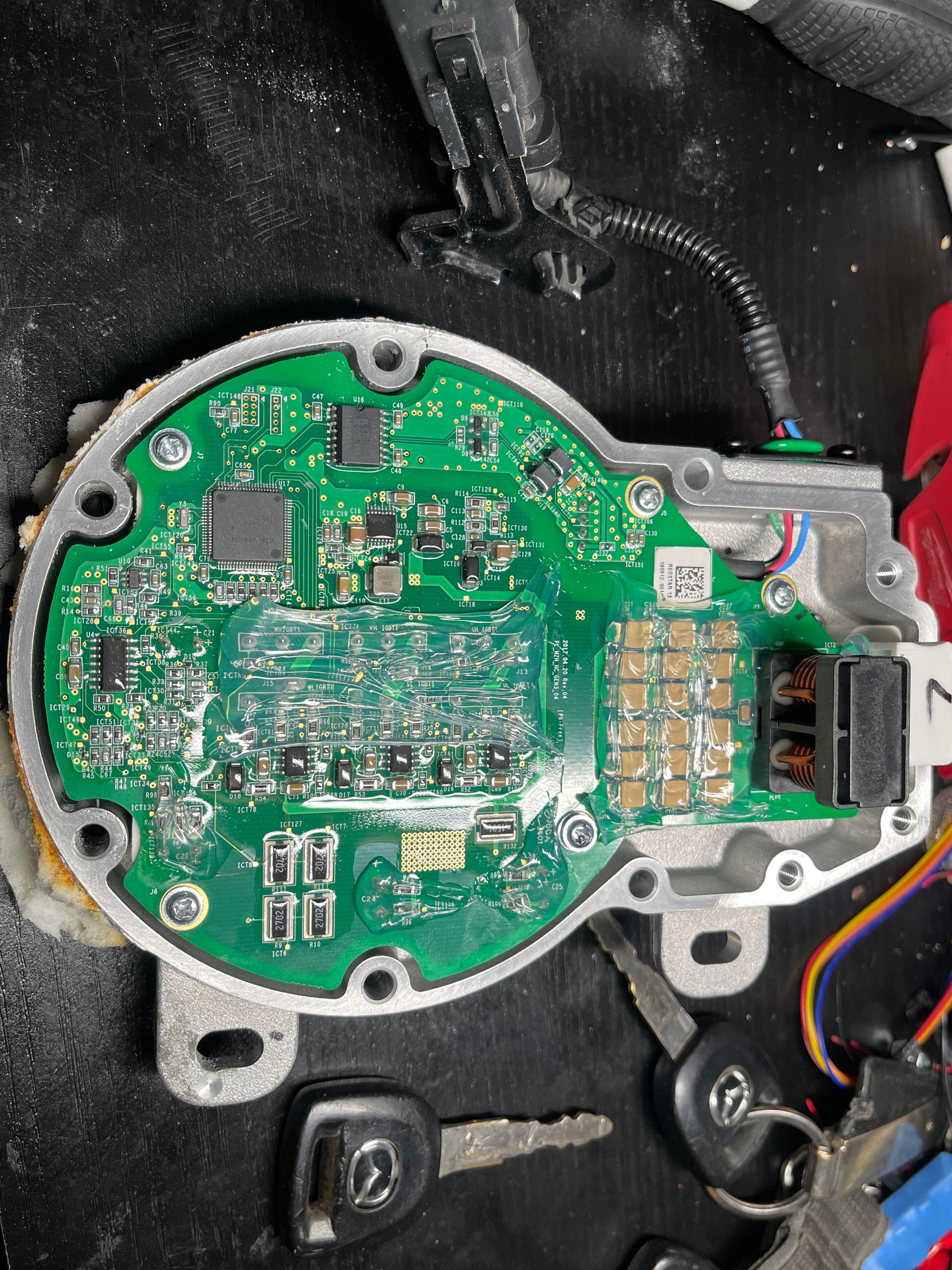

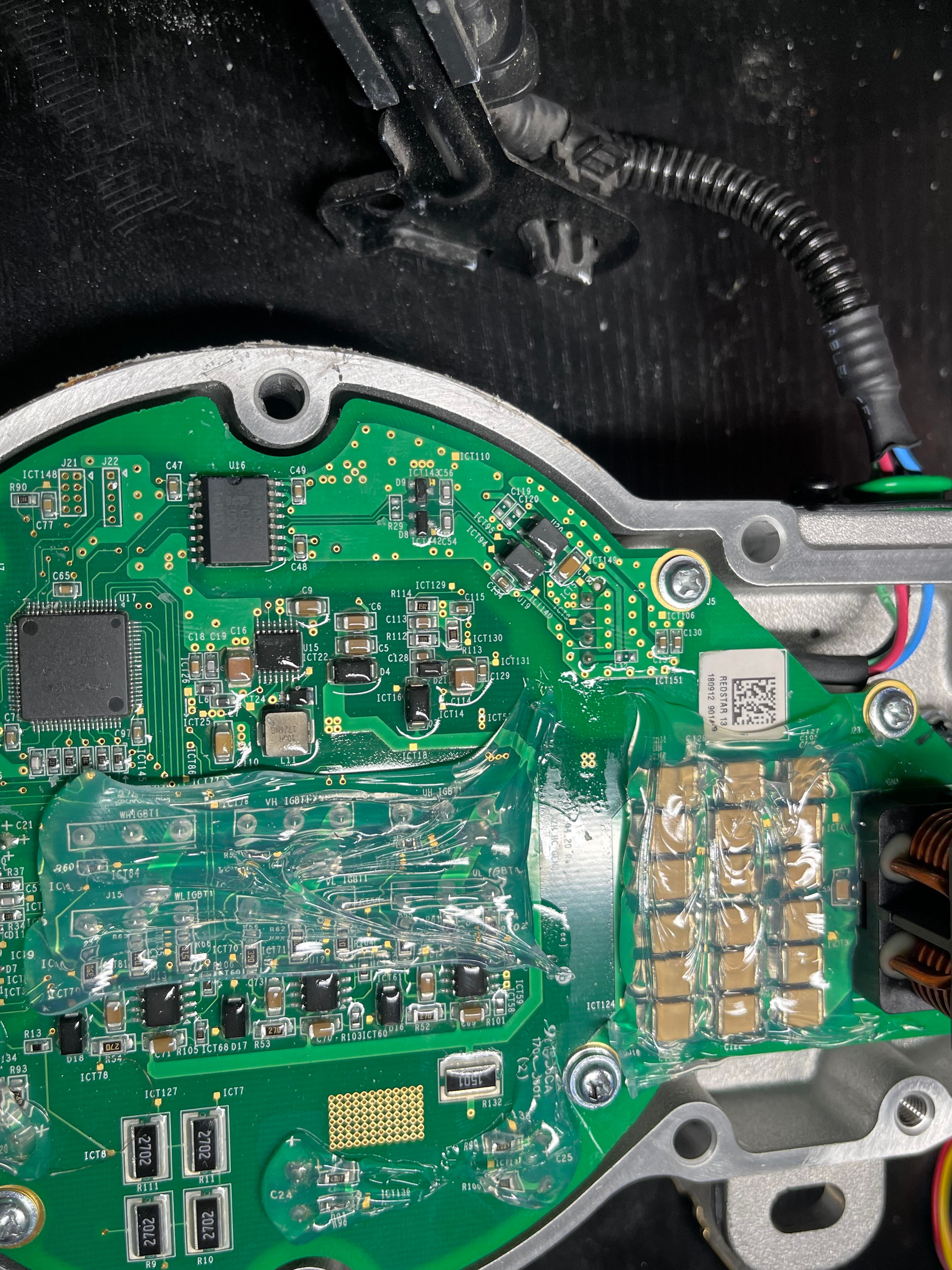

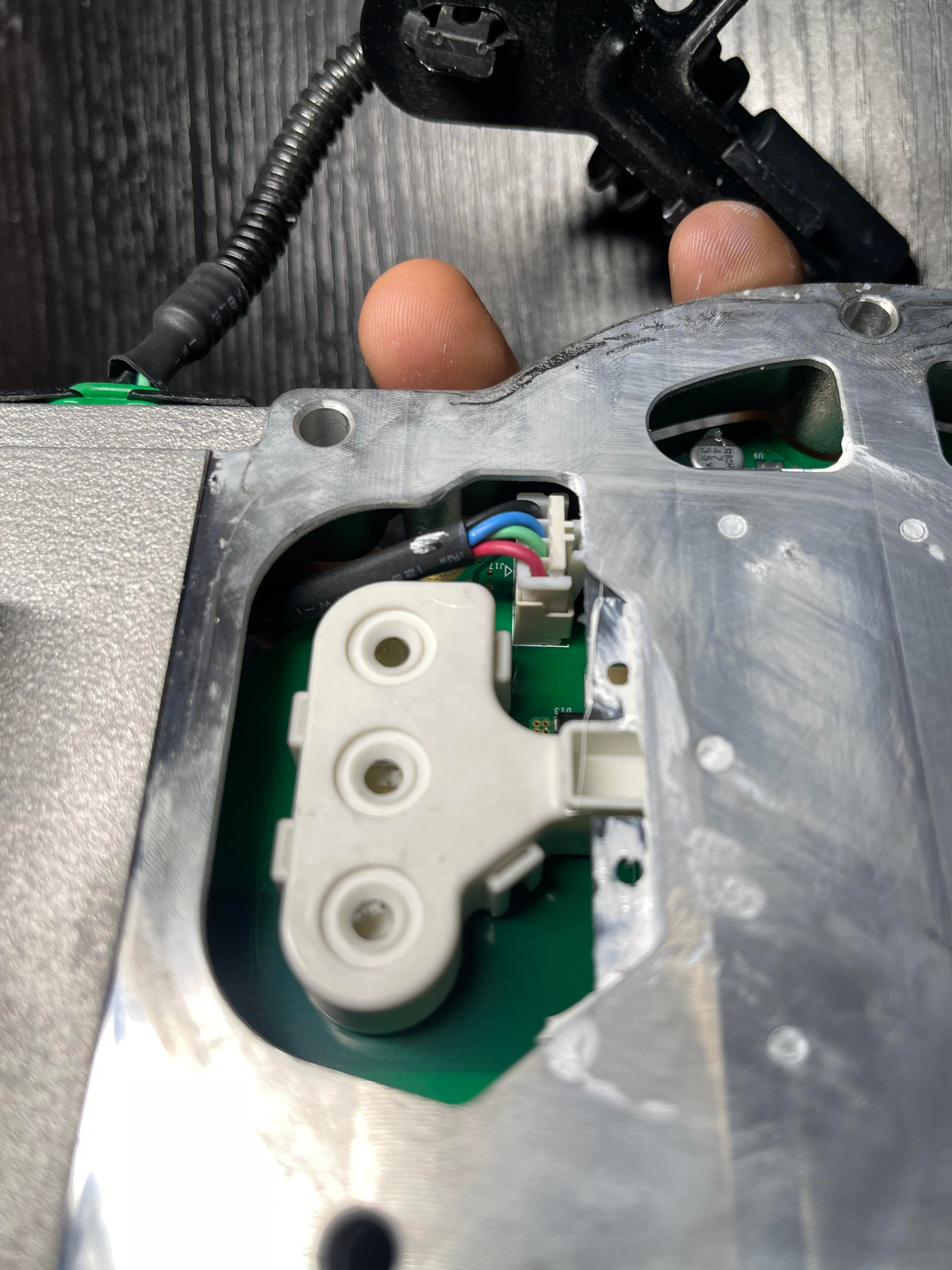

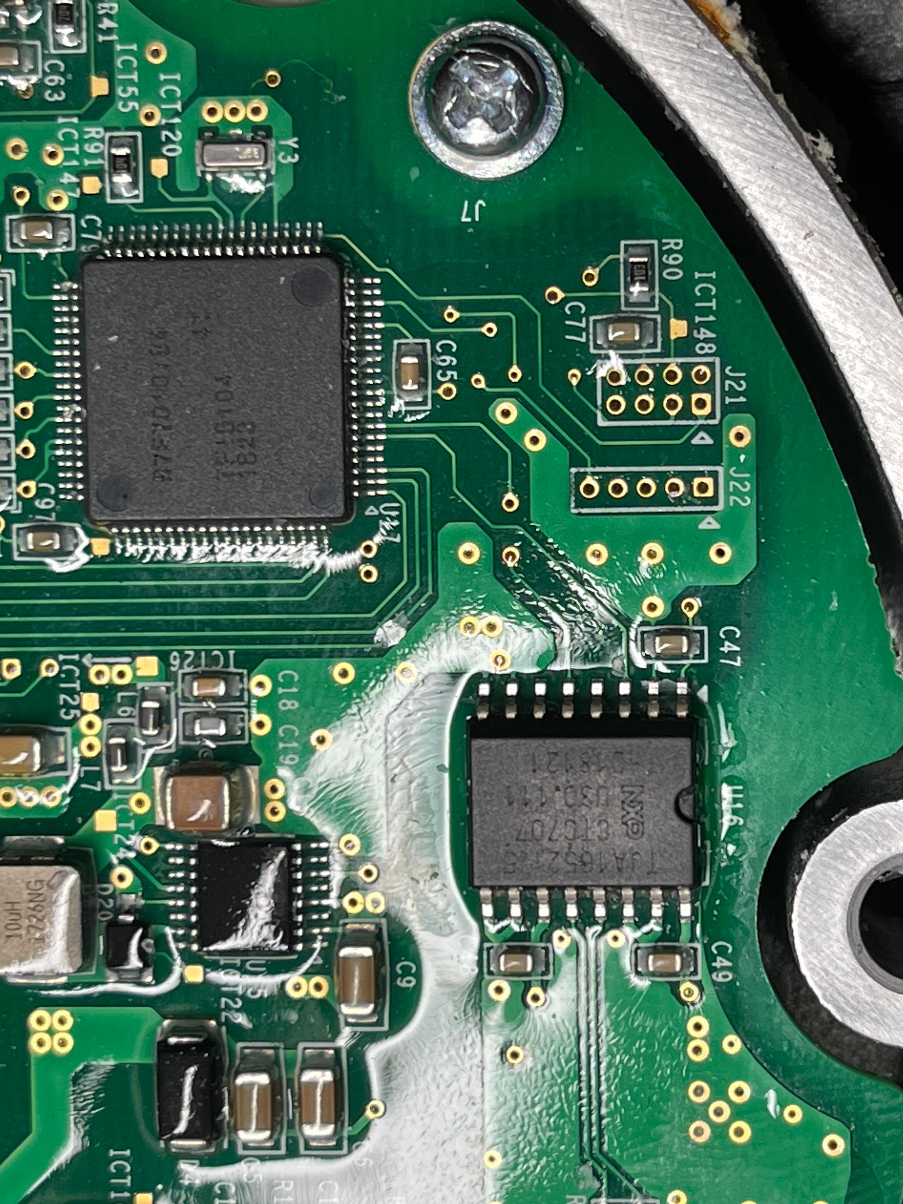

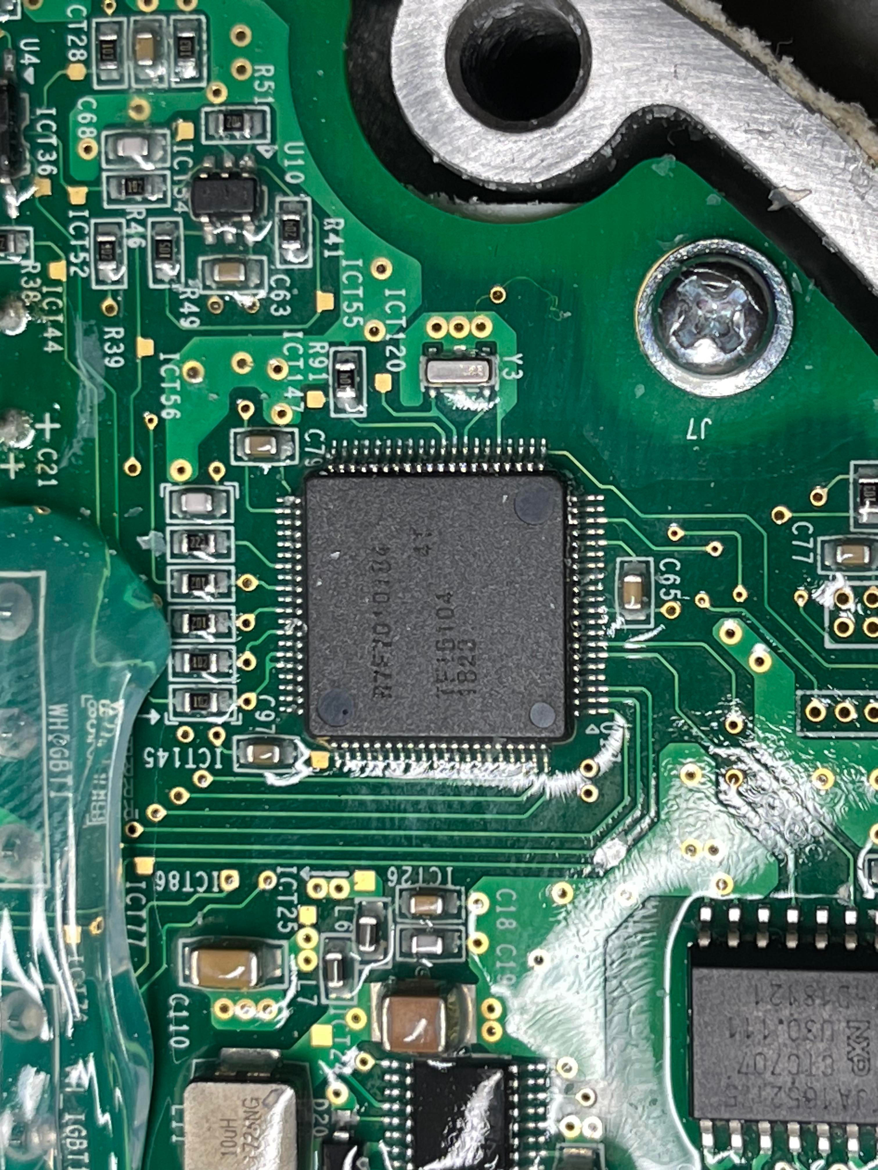

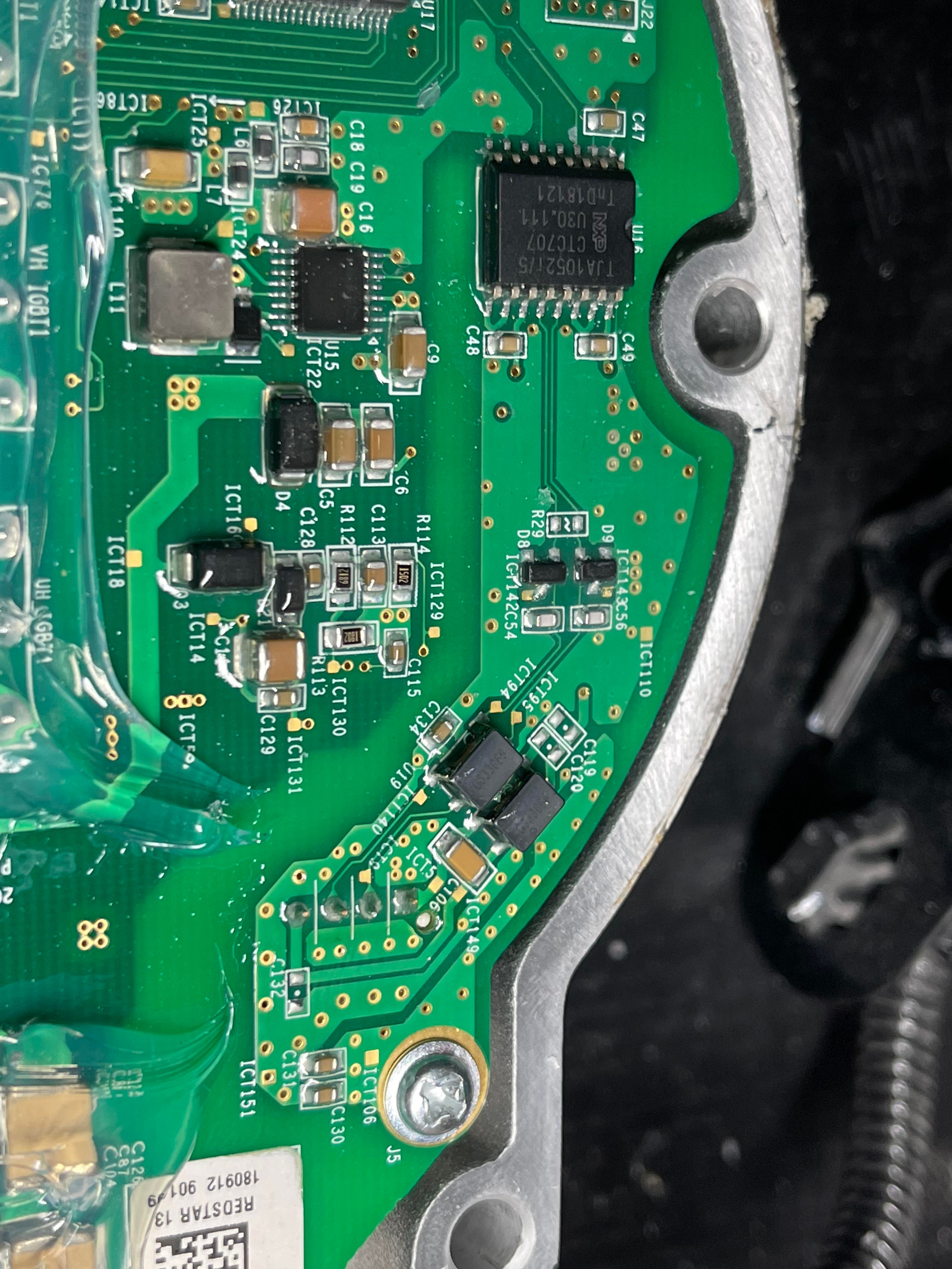

im working on a electric Mazda rx8, i bought this ac compressor thinking it would be easy to communicate with it, but found a forum where the canbus data hasn't been hacked, so i went ahead and took the control board off the back of the compressor. here are a few pictures of it. anyone have any ideals for me on making it easy to work with would be appreciated

Ok now build it back together and install it because we need/ can focus on implementation. Is this the same as 'my' partnumber?
