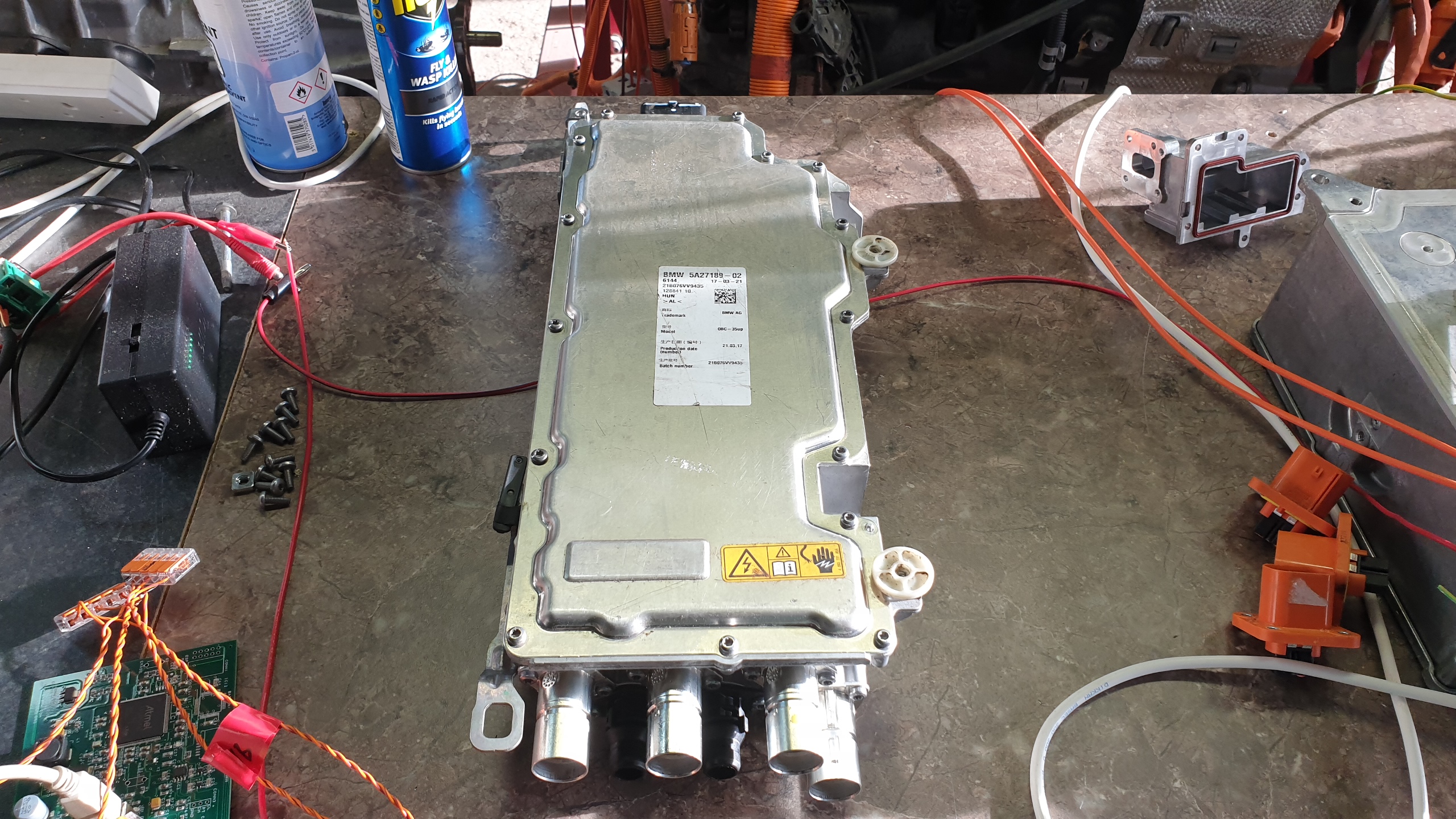

I bought a BMW 530e onboard battery charger - now what?
- Gregski
- Posts: 2873
- Has thanked: 530 times
- Been thanked: 1189 times

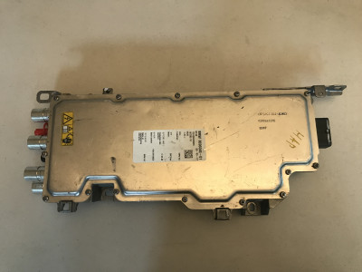

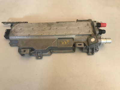

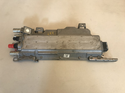

so it started out innocent enuff, another overpriced eBay listing for a 2018 BMW 530e "battery charge control module" ok, oh this one is local, from a wrecker in my town (helps to live in a town with one of the world's largest wrecking yards, but I digress) and free shipping, but hey I could pick it up, maybe chat them up for additional parts, I know I'll low ball 'em and forget all about it - um how about $300 ? Offer Sent
- Gregski
- Posts: 2873
Re: I bought a BMW 530e onboard battery charger - now what?
Wait what? Offer accepted? Great !
- Gregski
- Posts: 2873
wait, my bad, this isn't from a BMW at all, it fell off an alien space craft, what in the world are these tubes?

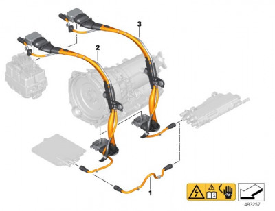

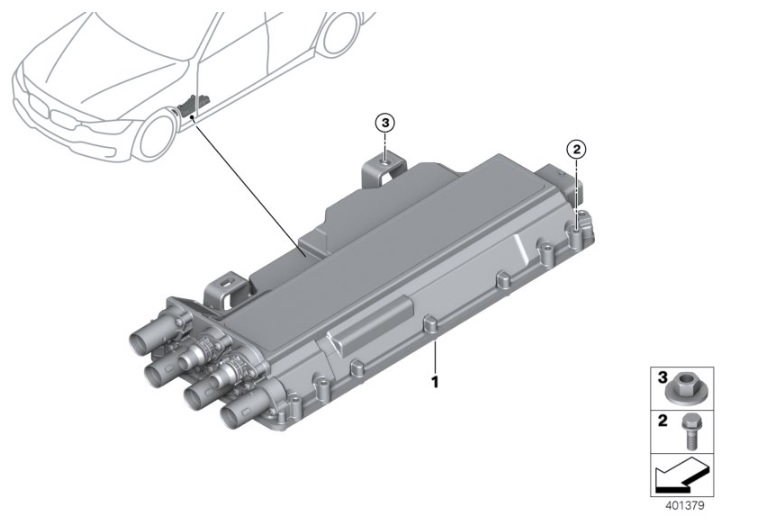

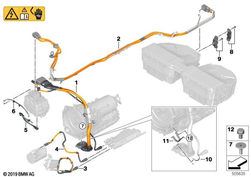

so I'm starting to piece together some info on this unit, forgive me if this is known already and redundant
5' G30 530e Control unit, KLE convenience charging
5' G30 530e Various wiring harnesses, hybrid
#1 High-voltage wiring harness SLE- EME
Part # 61126823572
#3 High-voltage cable set, EDH
Part # 61126823582
#4 HV wiring harness for el. AC compressor
Part # 61126823581
Part # 61126823572
Part # 61126823582
Part # 61126823581

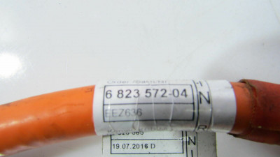

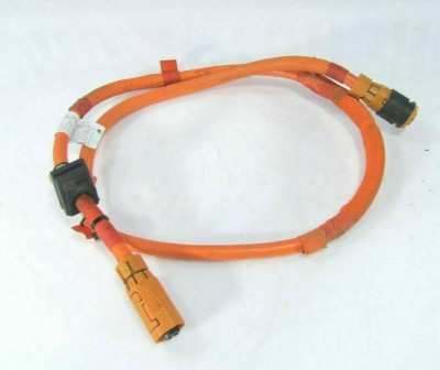

so cable #1 looks like this in the wild and is going for only $500 bucks on eBay

and then there's this diagram of Inductive charging where Cable #1 runs to something called a Car Pad Module aka CPM (#1 below) whatever that is, if you know please chime in
5' G30 530e Vehicle wiring harness induct.charging
5' G30 530e Car Pad Module CPM

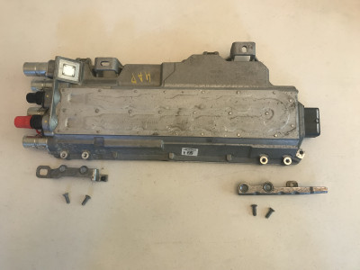

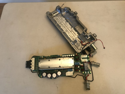

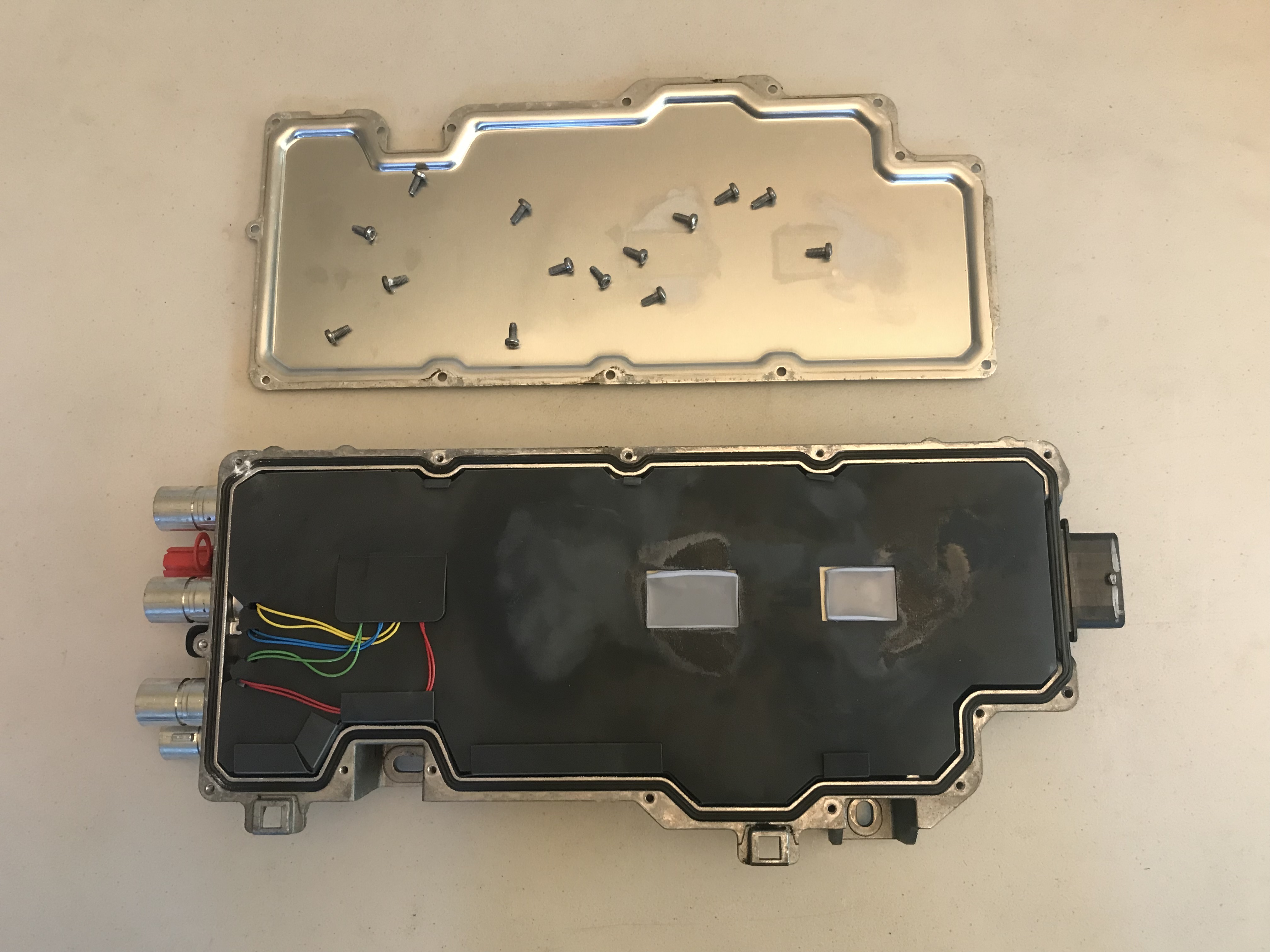

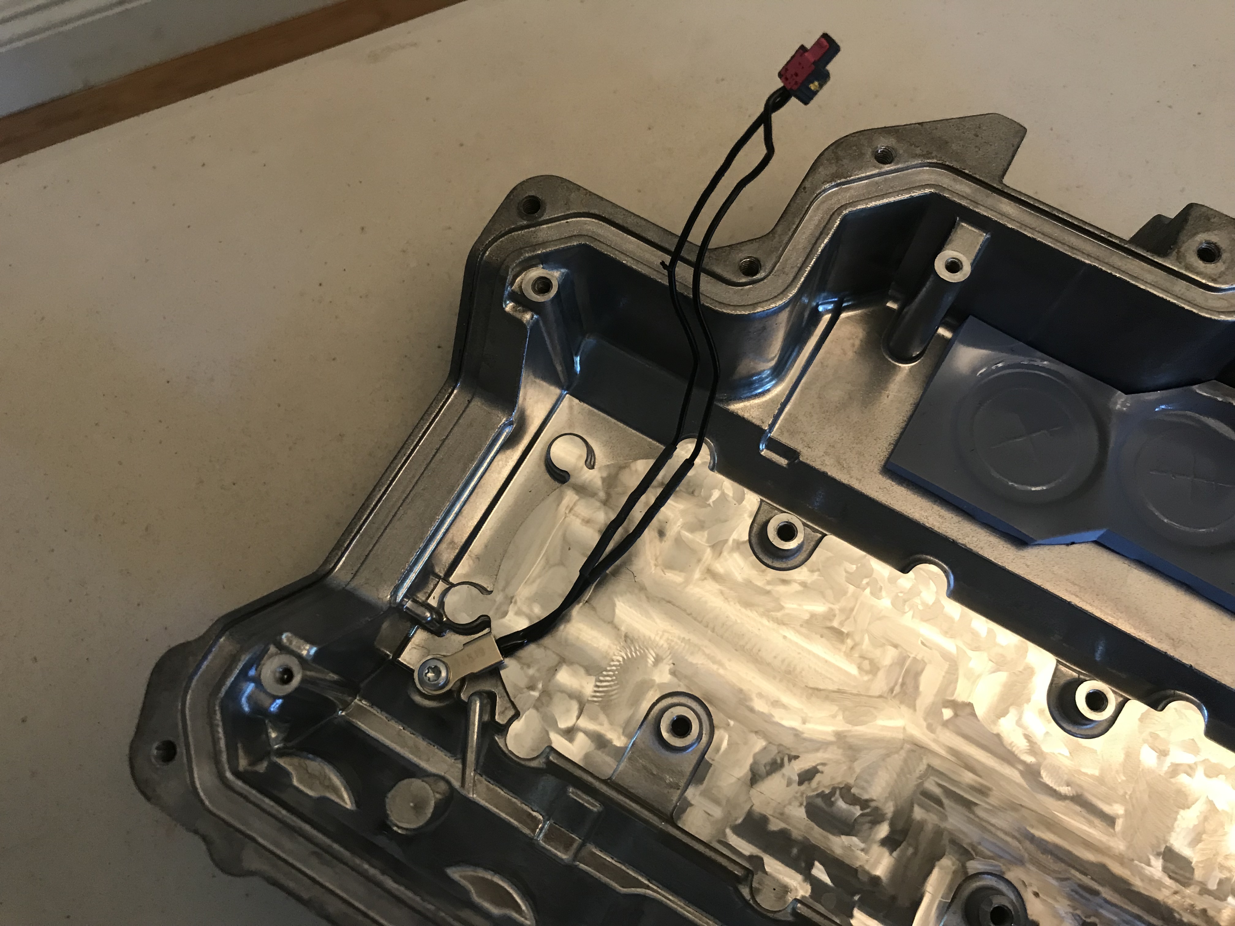

so first I removed the two funky mounting brackets
- Gregski
- Posts: 2873

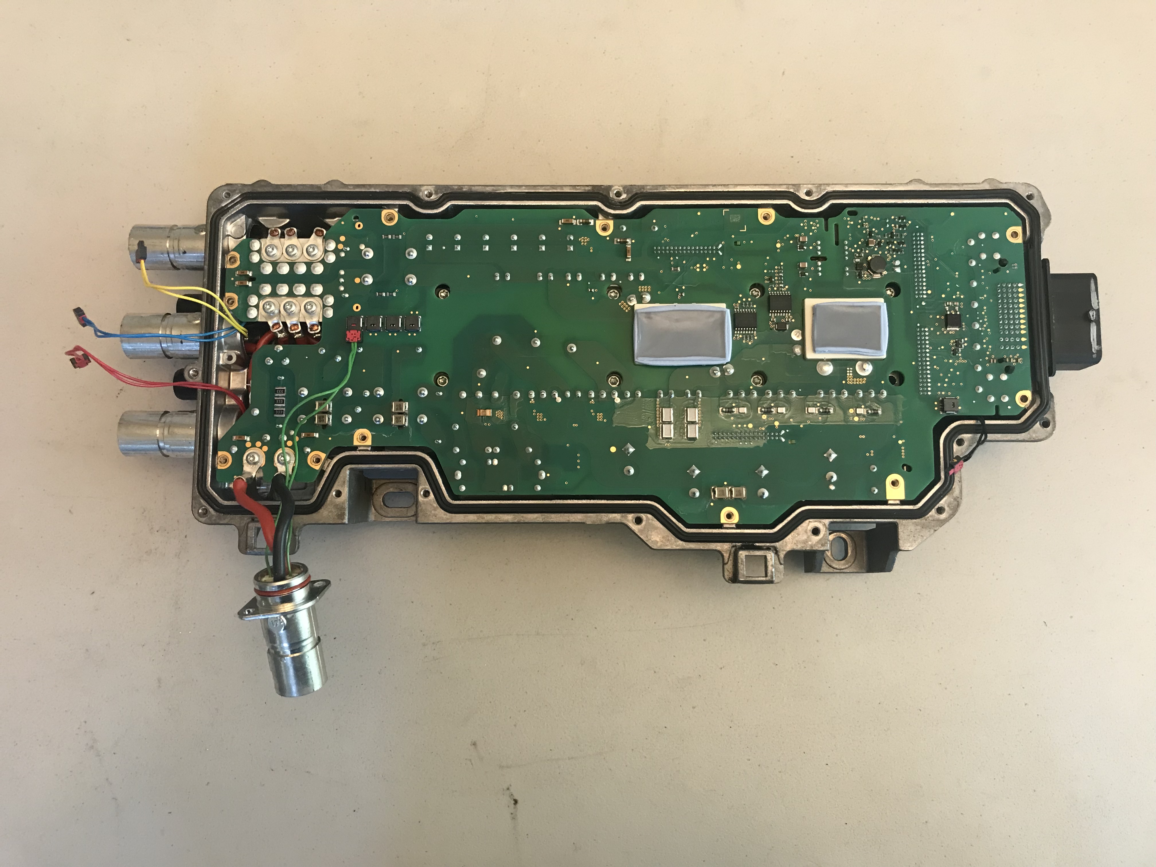

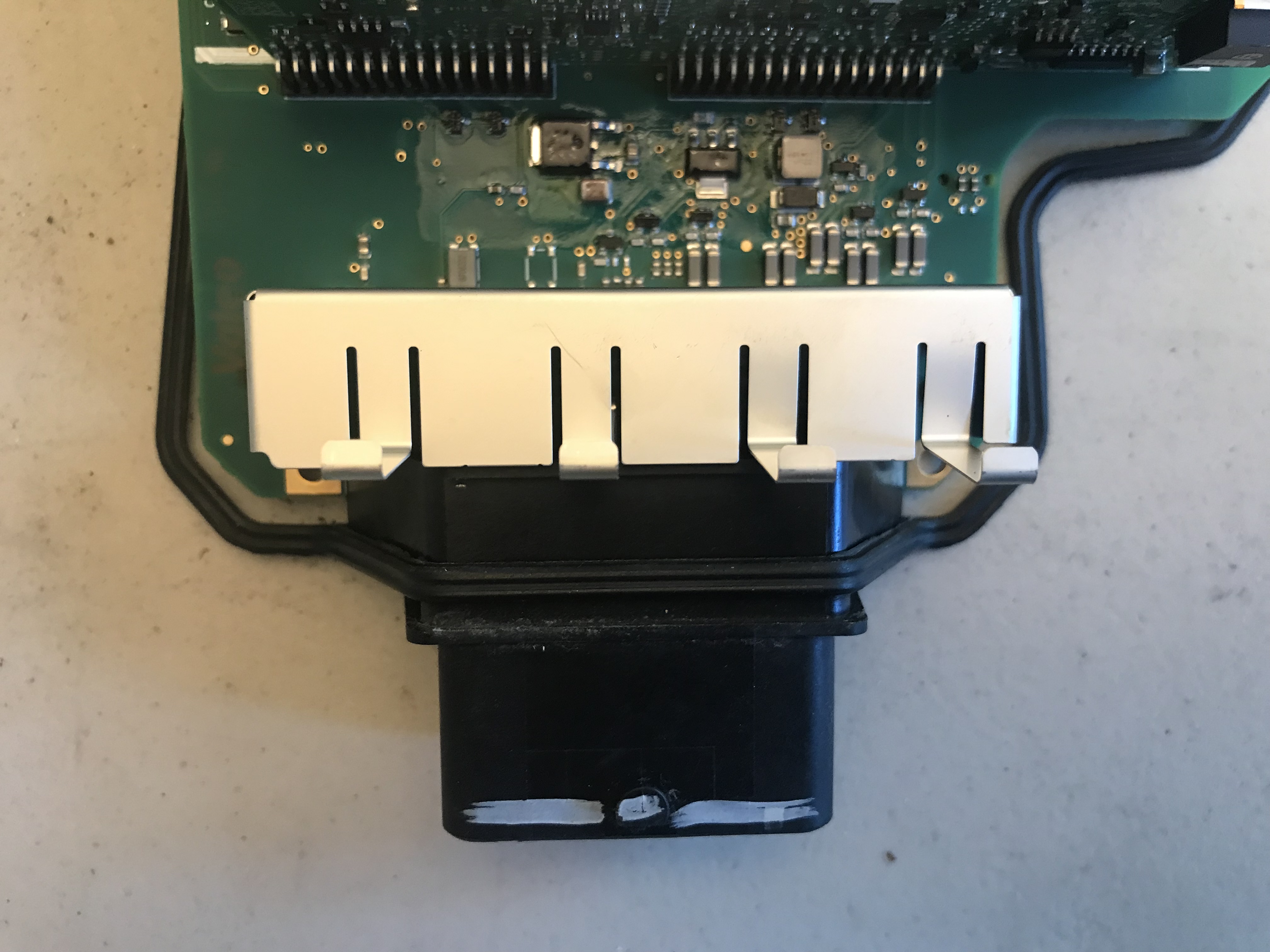

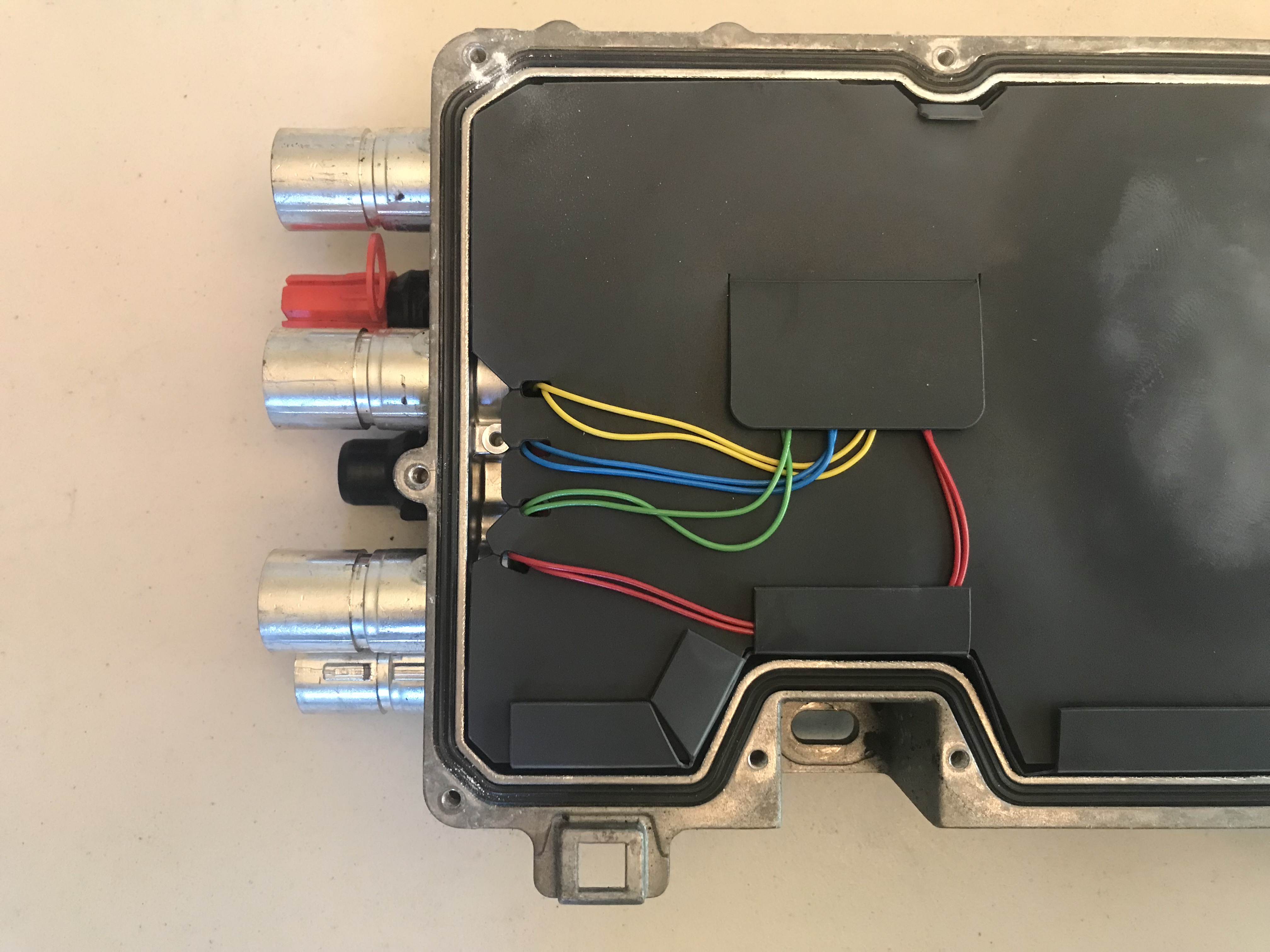

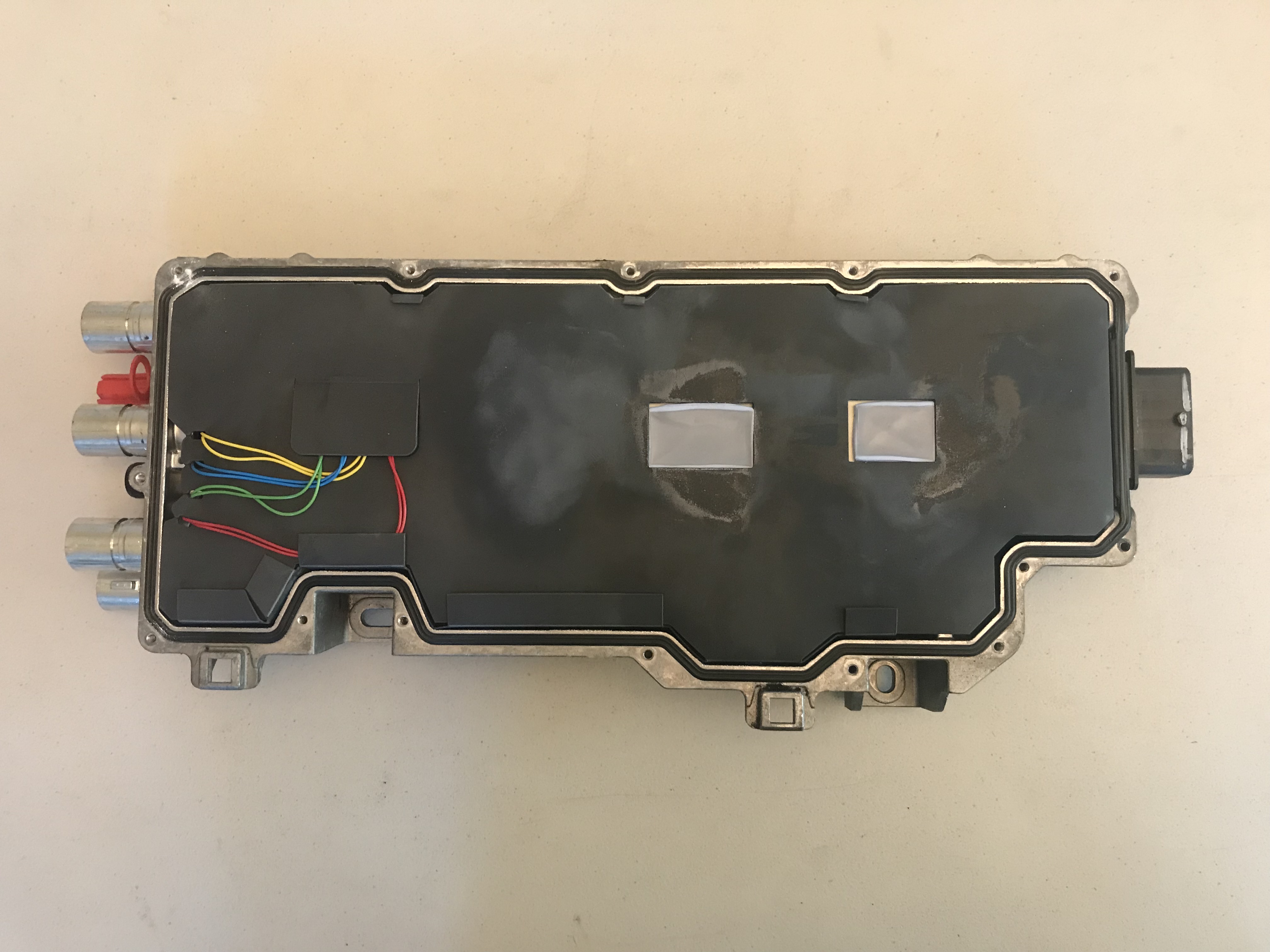

not having a wiring diagram, then I took a peak inside
ah yes, a rainbow
ah yes, a rainbow
- Gregski
- Posts: 2873
the good ol' cover under the cover trick

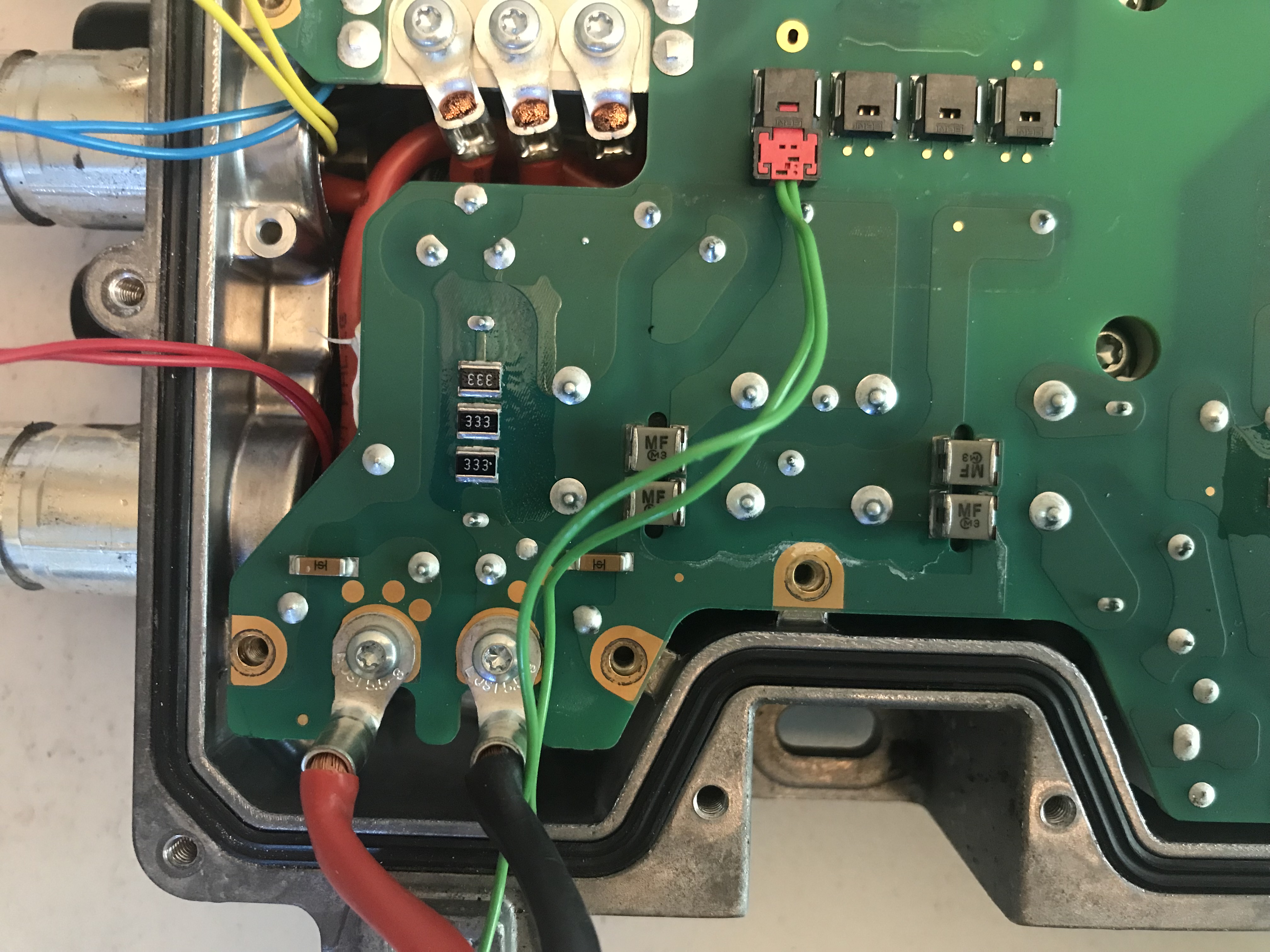

- Gregski
- Posts: 2873

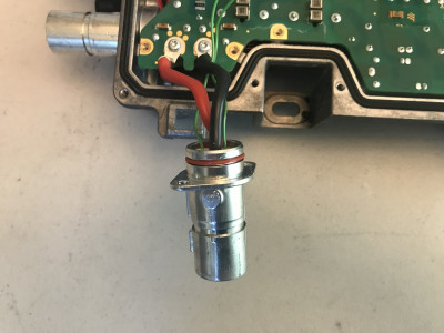

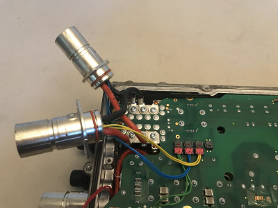

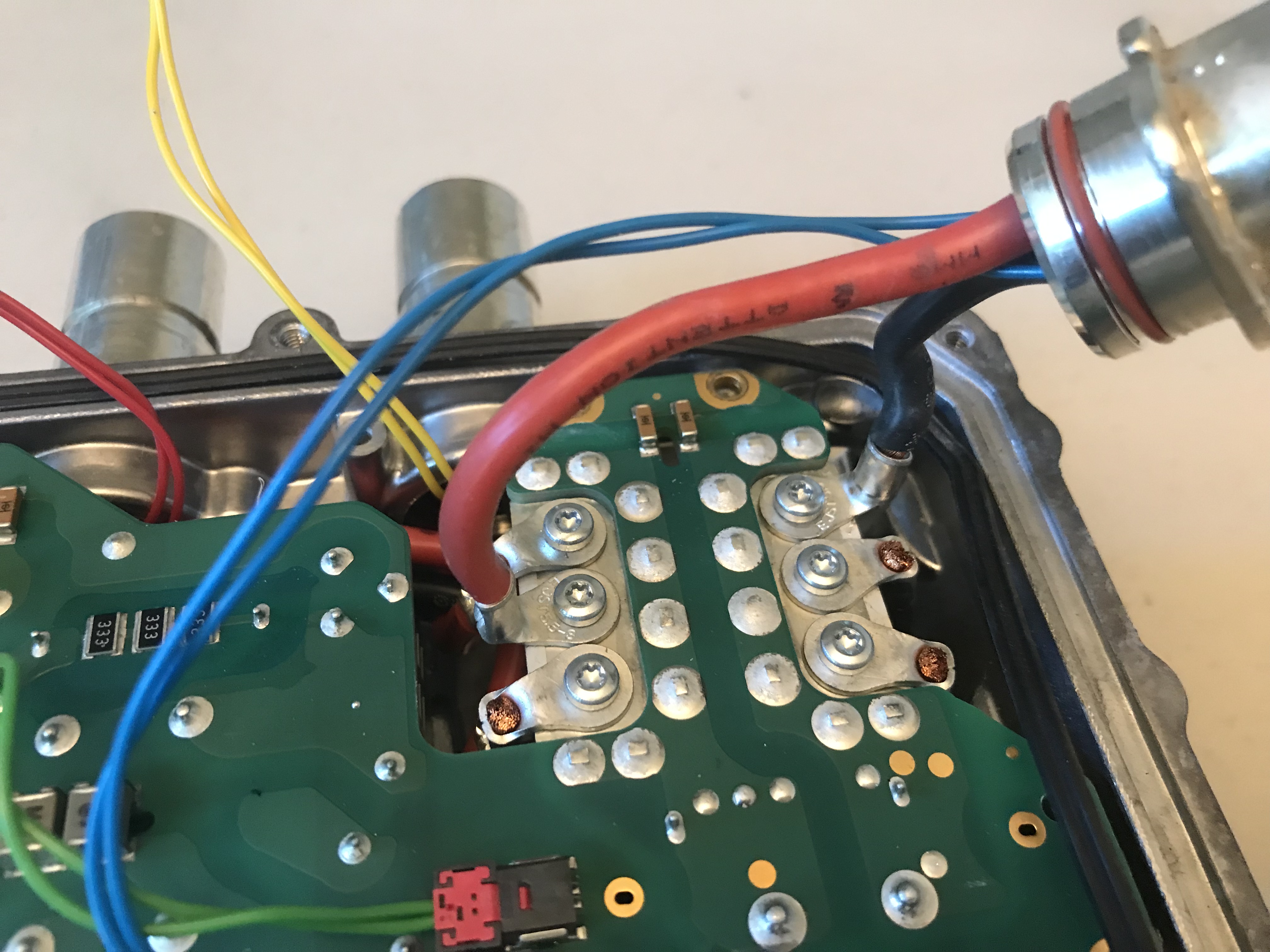

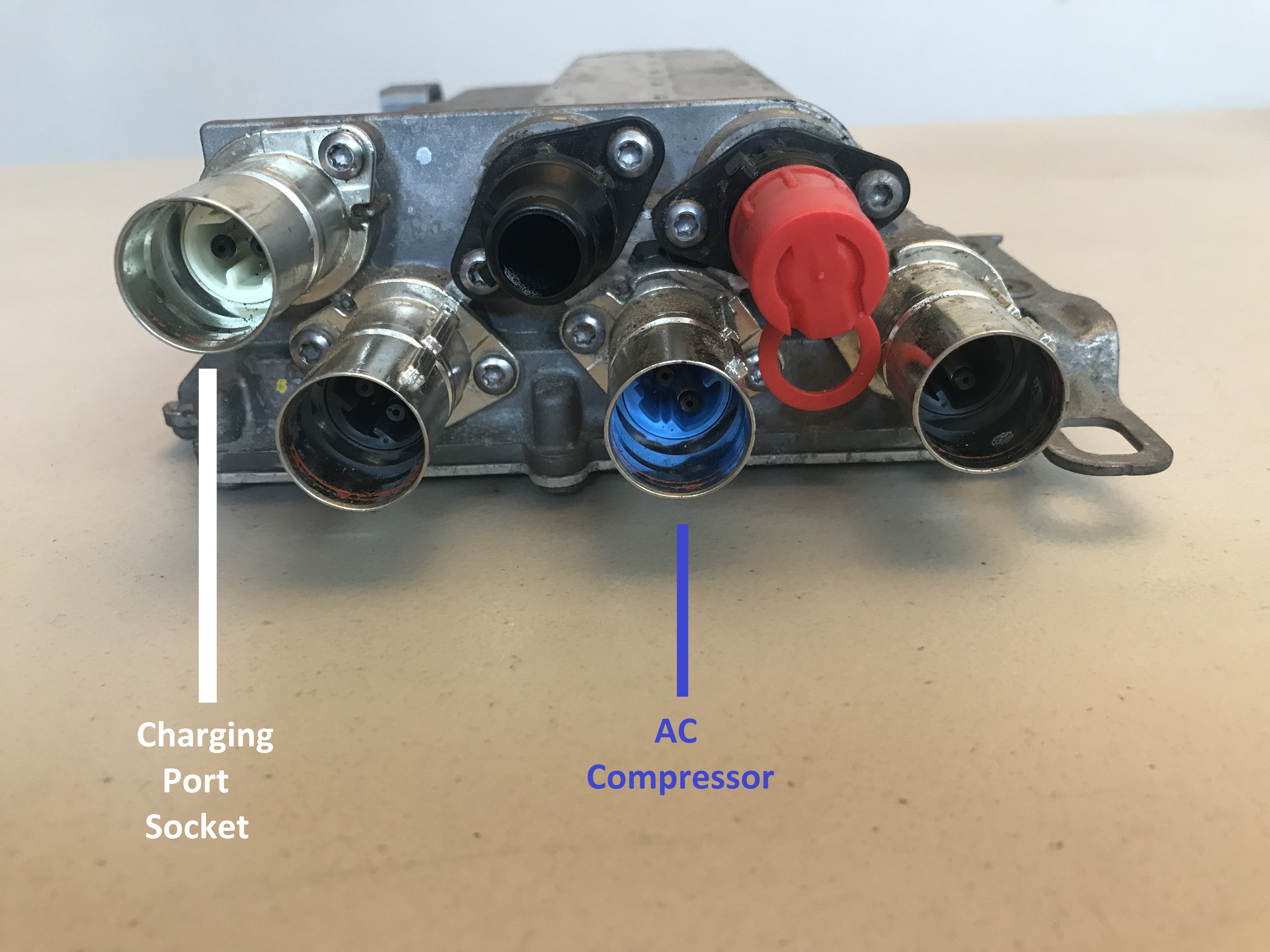

I just had to know where those tubular connectors run to, so I think this first one is actually the AC input plug that runs to the charging port socket, I rerouted it for demonstration purposes, at least in the end it's just a ring terminal connection, so that can easily be replaced with a regular high voltage orange cable, but what are those green thin wires for?
OutlandishPanda
- Posts: 50
- Joined: Fri Jun 26, 2020 7:25 pm
- Location: West Sussex, UK
Possibly HVIL (High Voltage Interrupt Loop)? The mating part of the connector shorts them out or takes the loop on another journey to another connector. If the whole loop is conducting end to end, it means all the connectors are in and secure. It runs all around the HV system, sometimes critical low voltage connectors also. If you pull a connector when the system is live, it will open the contactors to prevent, well, nasty accidents...
- Gregski
- Posts: 2873
Ah, makes sense thank you for that.OutlandishPanda wrote: ↑Fri May 13, 2022 7:10 pmPossibly HVIL (High Voltage Interrupt Loop)? The mating part of the connector shorts them out or takes the loop on another journey to another connector. If the whole loop is conducting end to end, it means all the connectors are in and secure. It runs all around the HV system, sometimes critical low voltage connectors also. If you pull a connector when the system is live, it will open the contactors to prevent, well, nasty accidents...

QUESTIONS:
1. What do they mean by inductive charging, is that just another way of saying regen?
2. Why does one of the front tube connectors run to the AC Compressor, I have never seen that on a battery charger?
3. Can this be a charger/converter combo unit?
4. What is that other gizmo in the first diagram below the AC Compressor where wire #3 runs to? EDH?
Pete9008
- Posts: 1801
- Has thanked: 102 times
- Been thanked: 350 times
I would guess:
1. Inductively coupled - it's got a transformer in it??
2. Is it to allow it to run the AC to cool the battery? The battery does have refrigerant lines to it so it kind of makes sense.
3. No idea, they could just be using it as the HV junction box with integrated switching for the AC and heater?
4. Looks like a water heater to me.

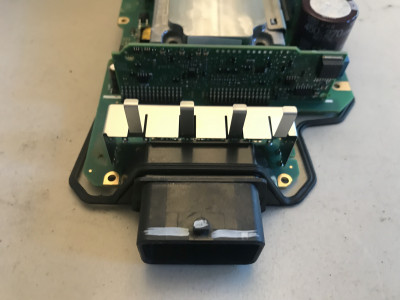

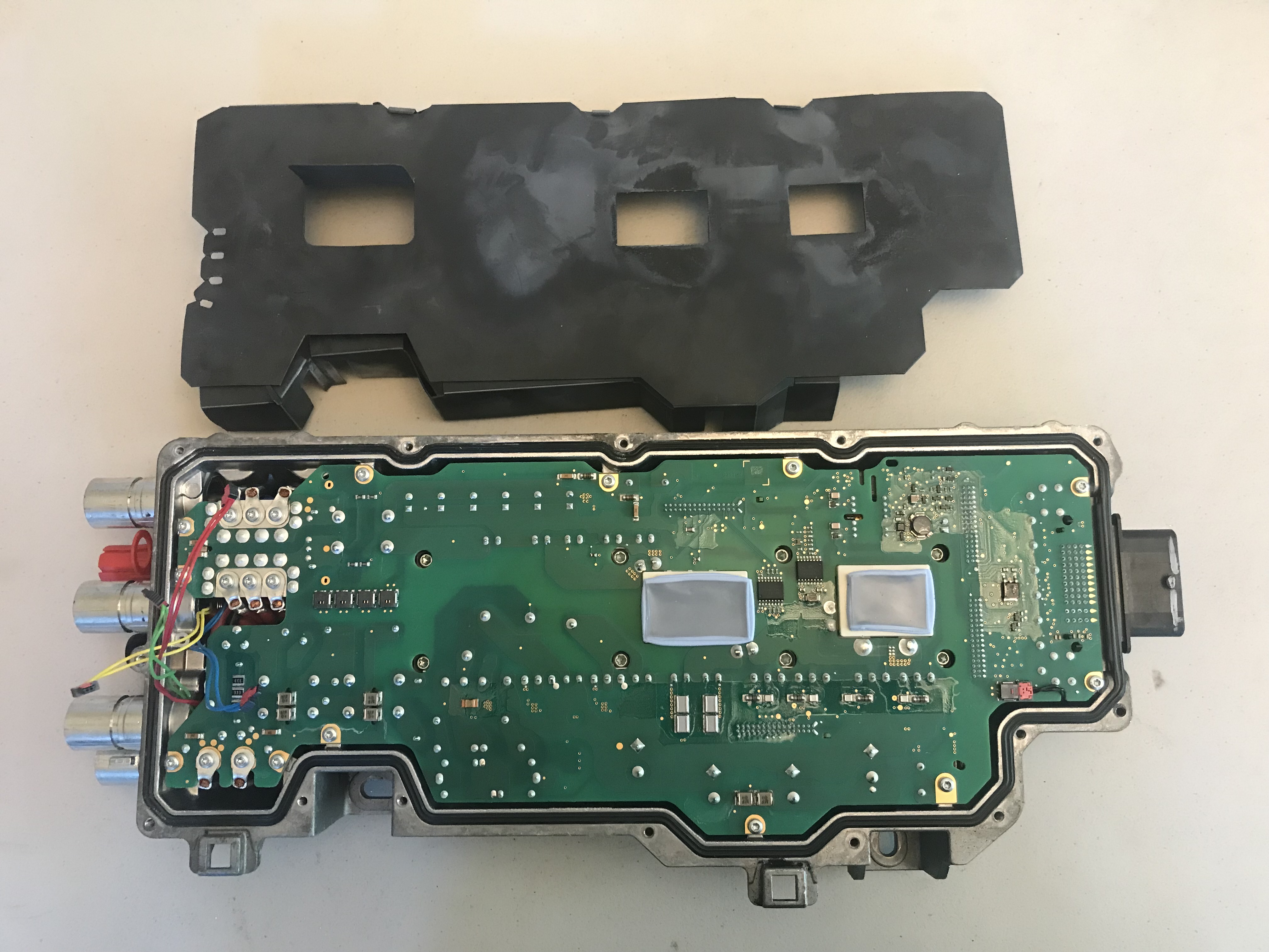

some more pictureness
one of the do dads going to the main bus bar thingie
another of the do dads going to the same bus bar thingie

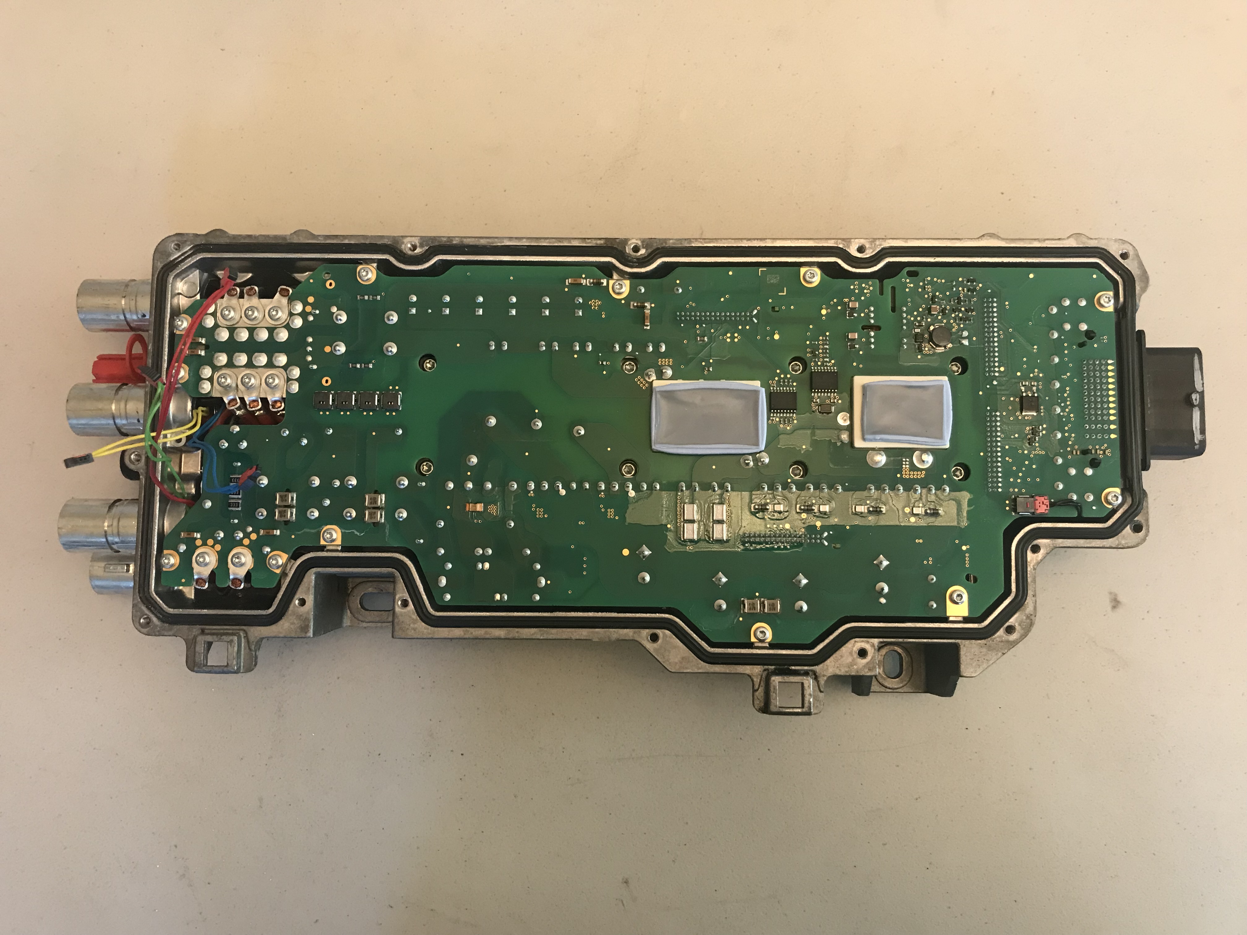

- Gregski
- Posts: 2873
and I took the guts out and flipped it belly up
- Gregski
- Posts: 2873
I wanted to see where these pins ranned to but there's a dam preventing it from happening
- jalovick
- Posts: 96
- Location: Sydney, Australia
- Has thanked: 10 times
- Been thanked: 7 times

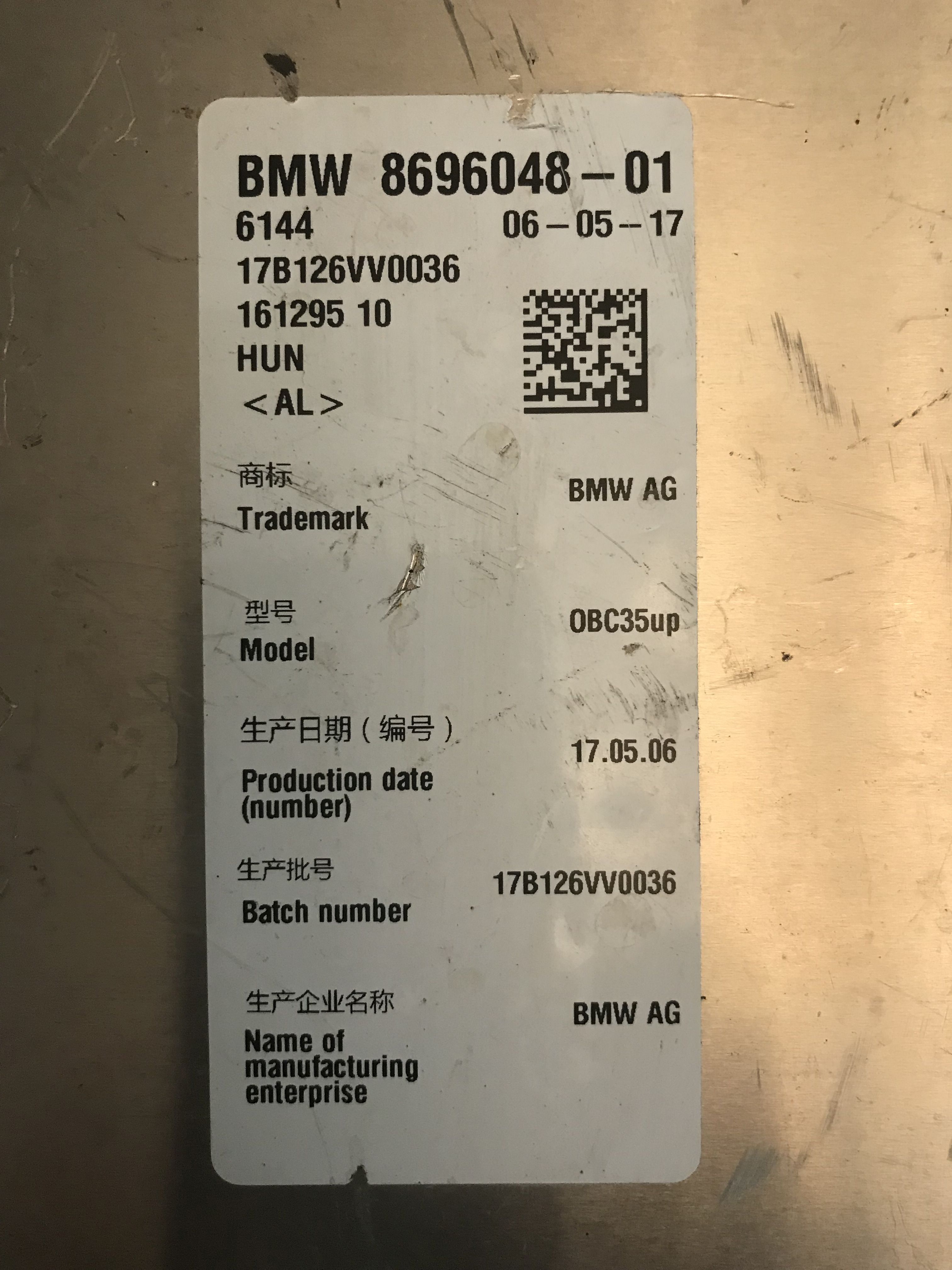

Based on the charging speed for those vehicles, it's a 3.6 kW single phase charger. It's used across the BMW plug-in hybrids and on the Mini Countryman Cooper SE plug-in hybrid. I've been hunting around for the 11 kW KLE for the Mini Cooper SE EV, but keep coming across these. They're quite cheap on eBay, some part numbers for this or similar KLE's are 61449485031, 61448742334, 61448699722, 61-44-8-742-334, 61-44-9-469-686, 61-44-9-456-002, 61448742334, 61449469686, 61449456002, 61-44-8-697-850, 61-44-8-699-722, 61-44-8-741-470, 61448697850, 61448699722, 61448741470, 61-44-8-655-217, 61-44-8-657-865, 61-44-8-661-458, 61448655217, 61448657865, 61448661458, 61-44-8-678-851, 61-44-8-654-202, 61-44-8-654-728, 61448678851, 61448654202, 61448654728, 61-44-8-663-249, 61-44-8-667-579, 61-44-8-671-959, 61448663249, 61448667579, 61448671959, 61-44-8-677-319 61448677319, 61445A02157 61449456002; 61449469686, 61-44-5-A02-157, 61-44-9-456-002; 61-44-9-469-686, 61-44-5-A2A-F55
If you come across the 11 kW version, let me know...
- Gregski
- Posts: 2873
define cheap, as I have seen them going for $800 bucks here in the states, and are you saying you know how to control one of these?
