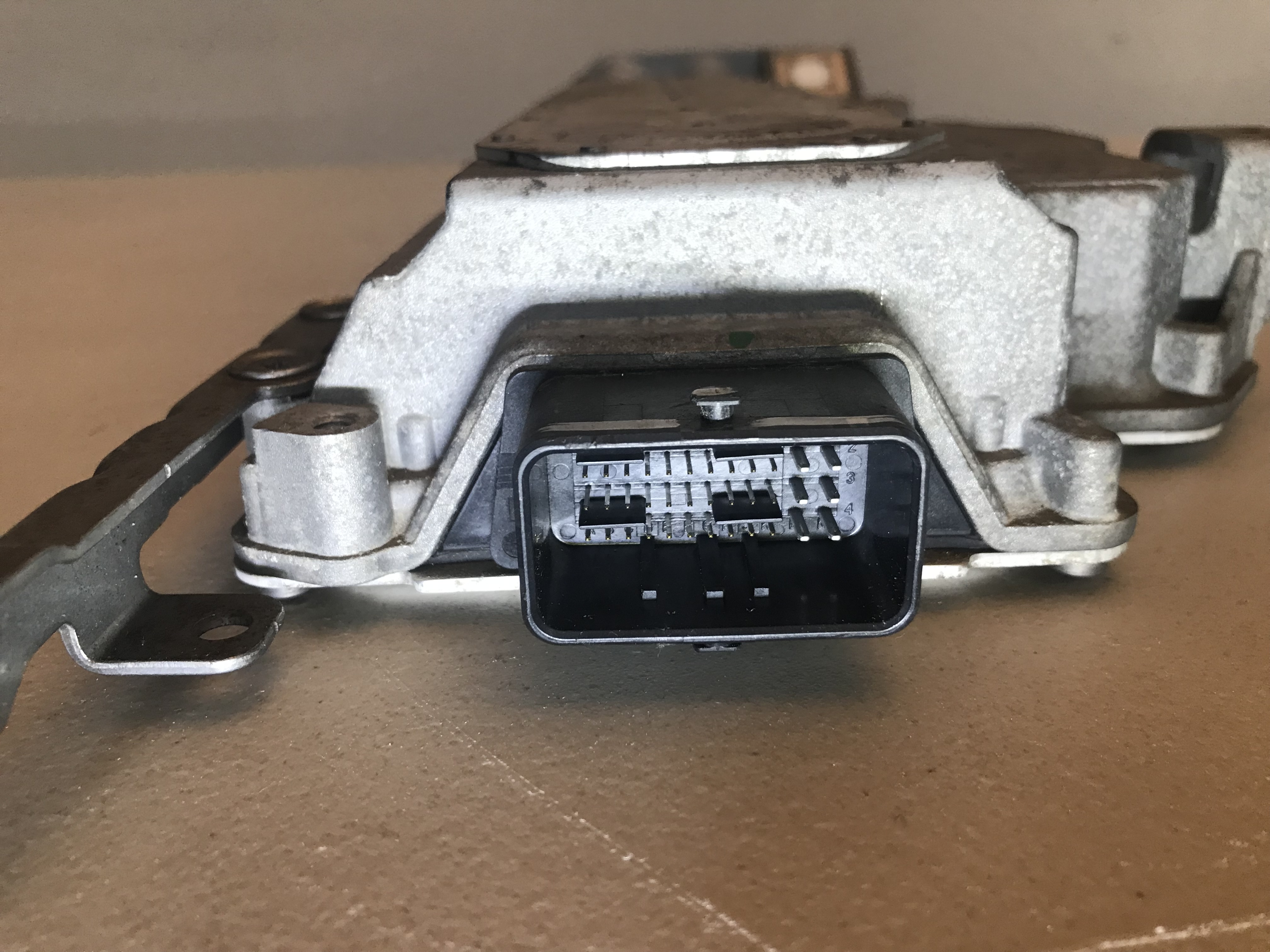

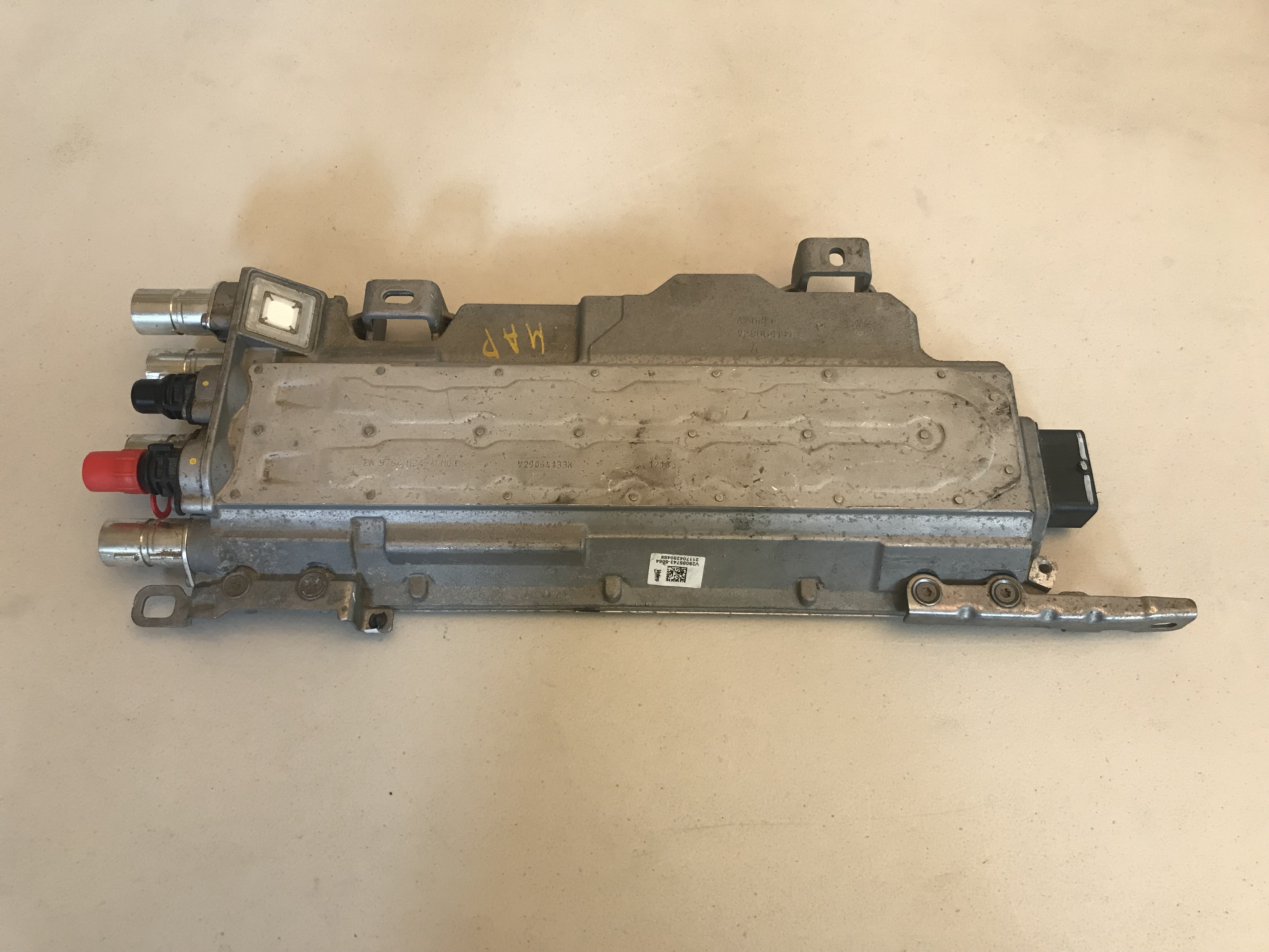

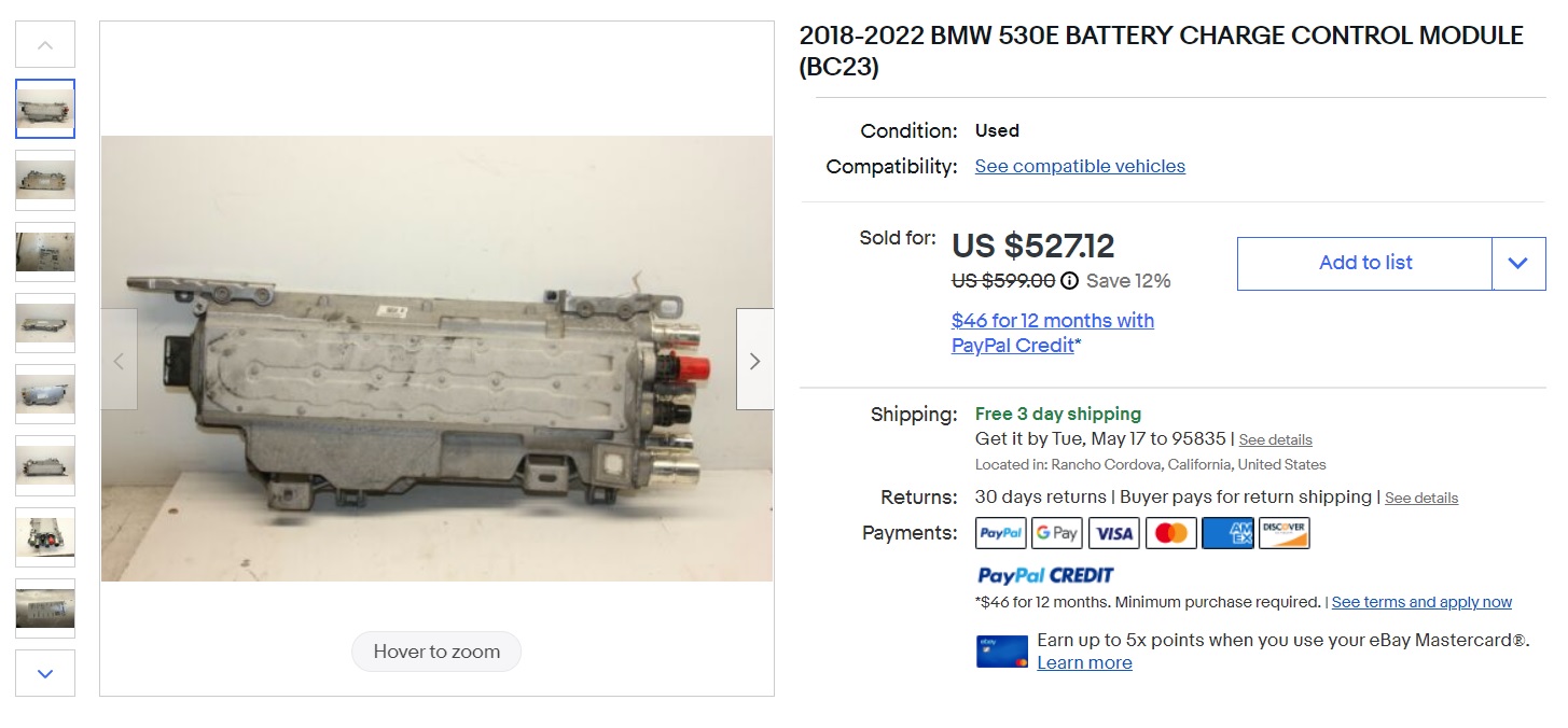

so it started out innocent enuff, another overpriced eBay listing for a 2018 BMW 530e "battery charge control module" ok, oh this one is local, from a wrecker in my town (helps to live in a town with one of the world's largest wrecking yards, but I digress) and free shipping, but hey I could pick it up, maybe chat them up for additional parts, I know I'll low ball 'em and forget all about it - um how about $300 ? Offer Sent

Wait what? Offer accepted? Great !

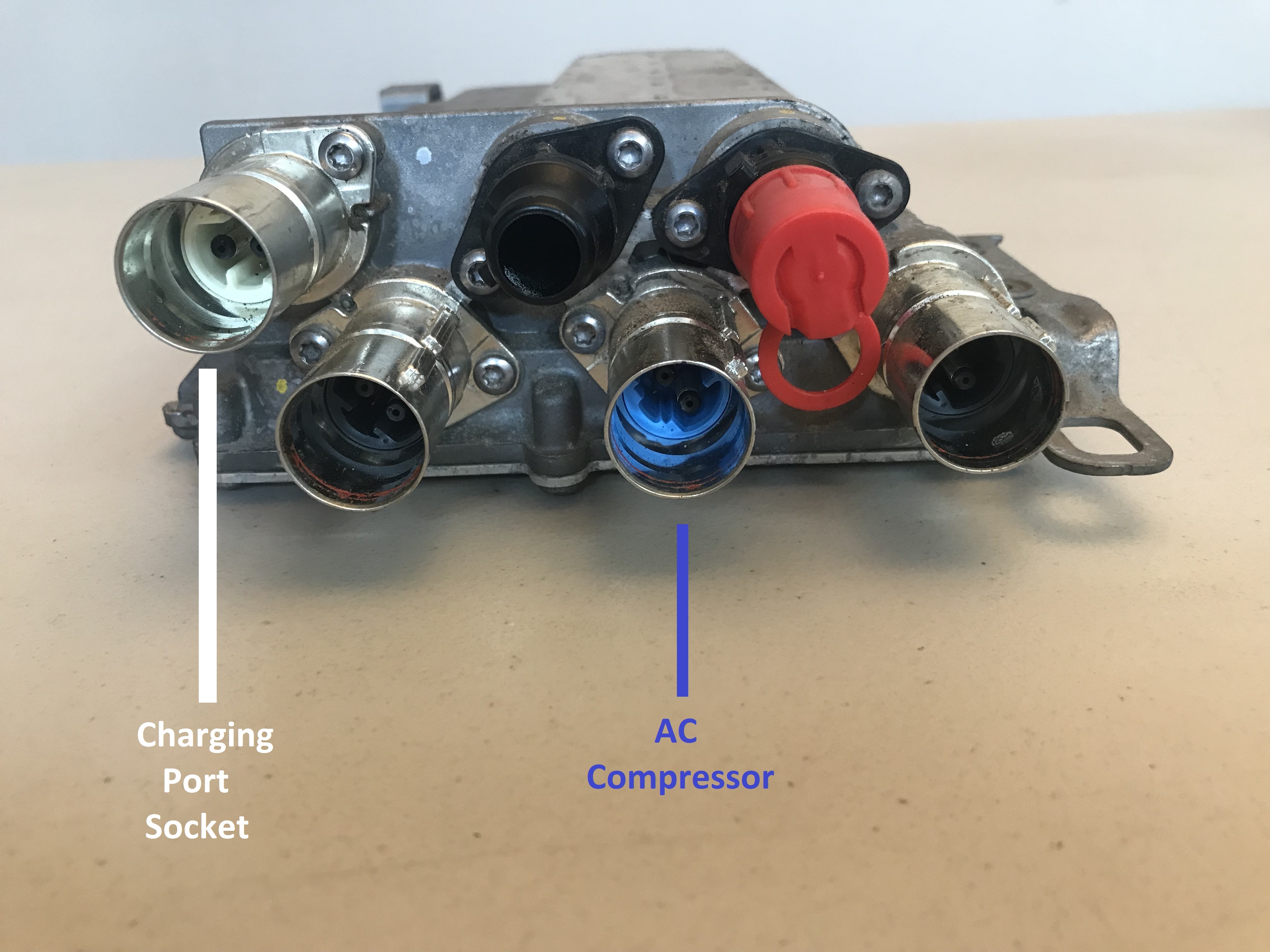

wait, my bad, this isn't from a BMW at all, it fell off an alien space craft, what in the world are these tubes?

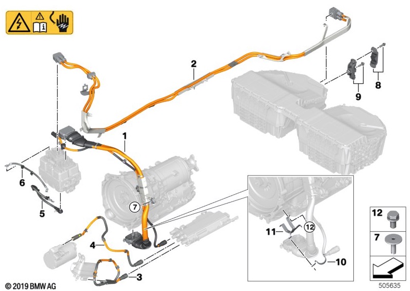

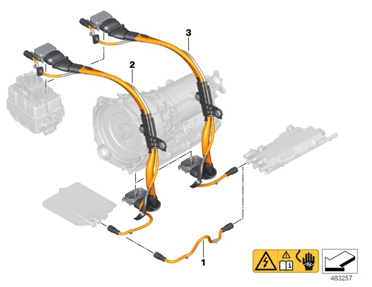

so I'm starting to piece together some info on this unit, forgive me if this is known already and redundant
5' G30 530e Control unit, KLE convenience charging
5' G30 530e Various wiring harnesses, hybrid

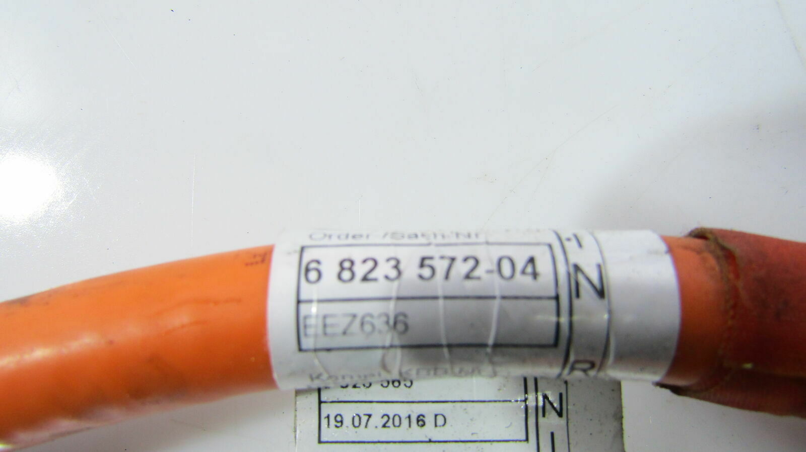

#1 High-voltage wiring harness SLE- EME
Part # 61126823572
#3 High-voltage cable set, EDH
Part # 61126823582
#4 HV wiring harness for el. AC compressor
Part # 61126823581

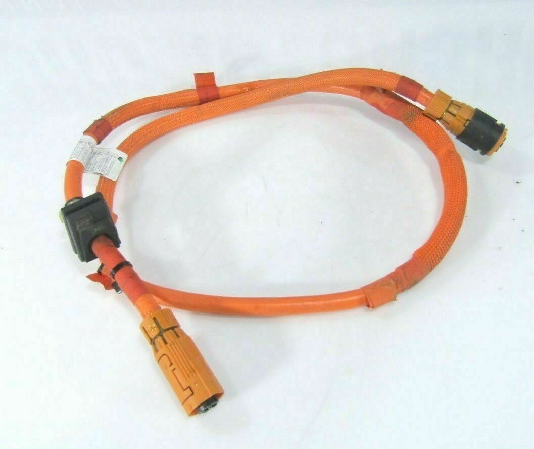

so cable #1 looks like this in the wild and is going for only $500 bucks on eBay

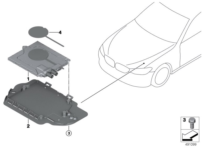

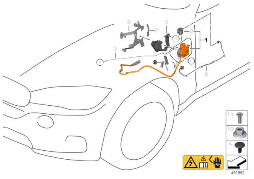

and then there's this diagram of Inductive charging where Cable #1 runs to something called a Car Pad Module aka CPM (#1 below) whatever that is, if you know please chime in
5' G30 530e Vehicle wiring harness induct.charging
5' G30 530e Car Pad Module CPM

is it just me or do these diagrams go out of their way of being not helpful, I mean ok, here's an orange cable, where the hell does it plug into? that charger has 17 ports on it
5' G30 530e Charge socket with charge cable
Part # 61126841559

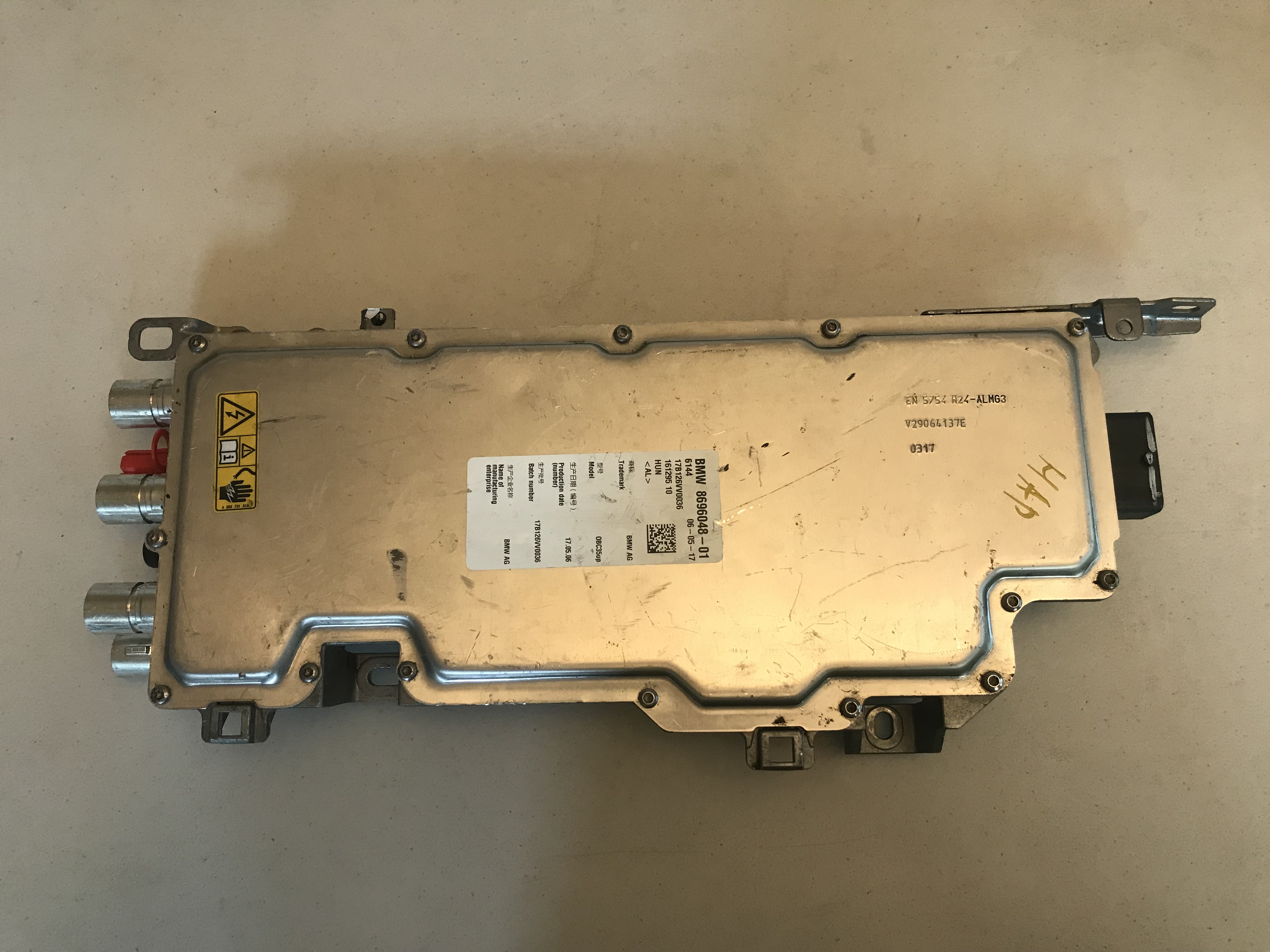

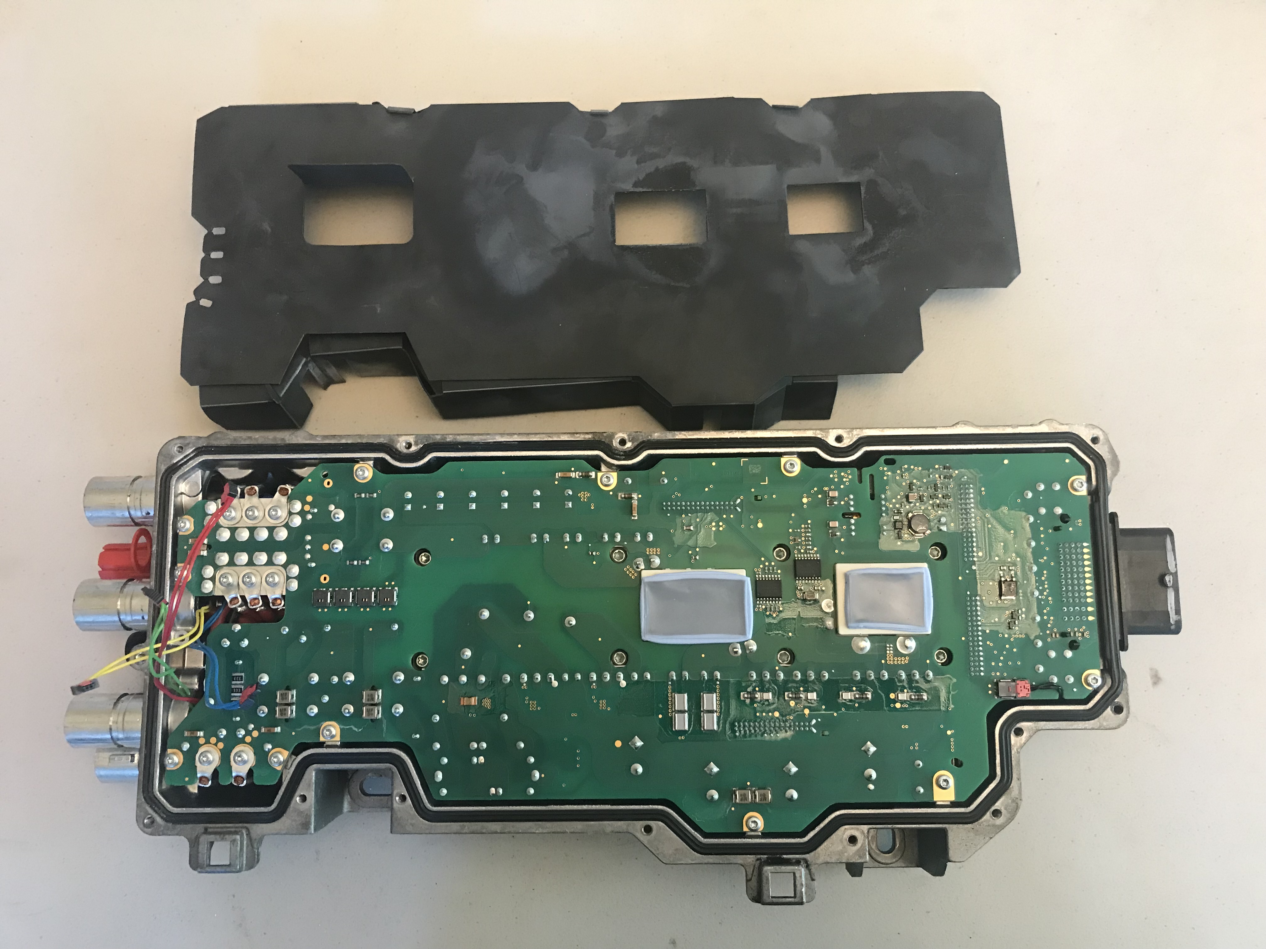

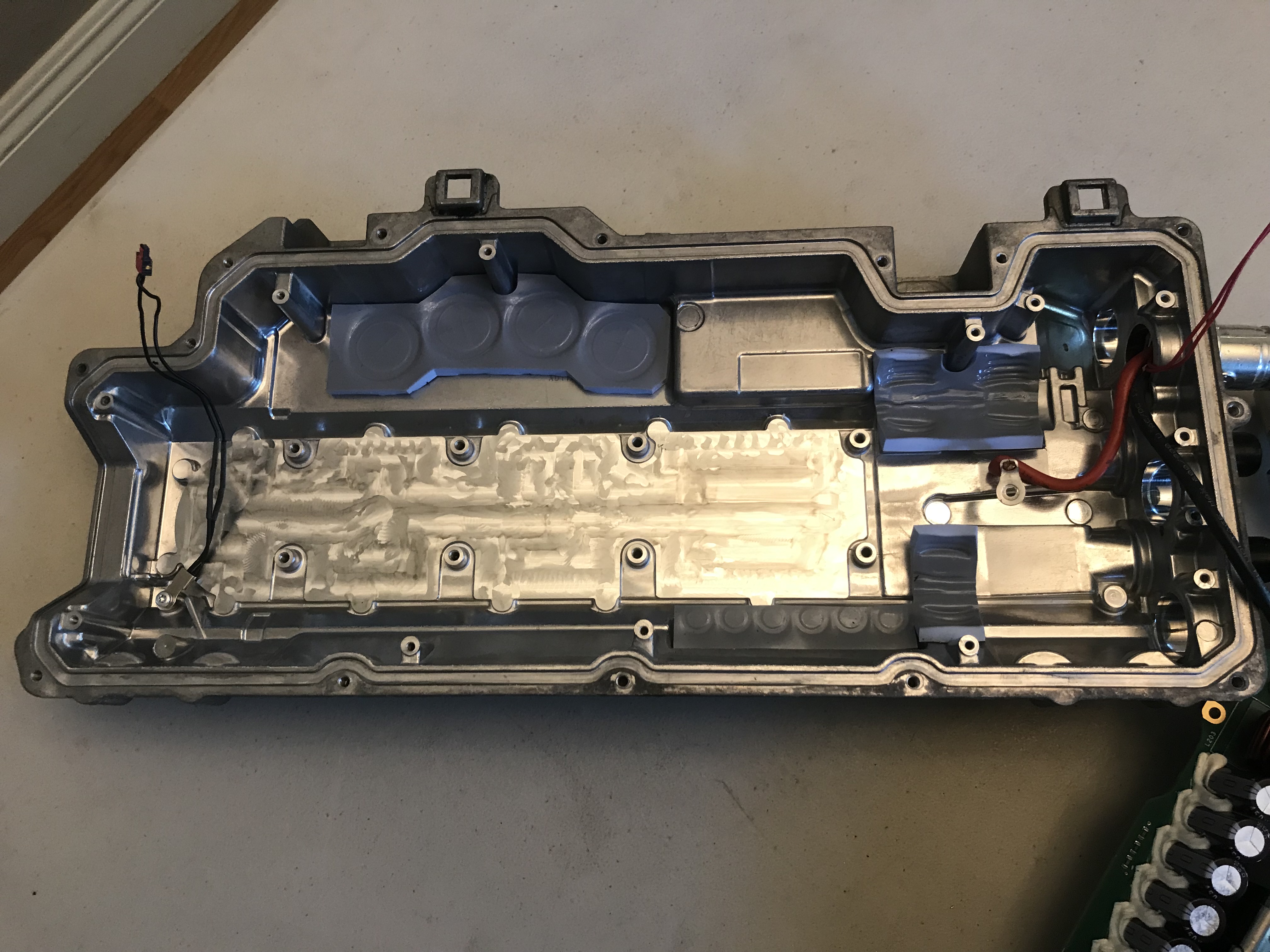

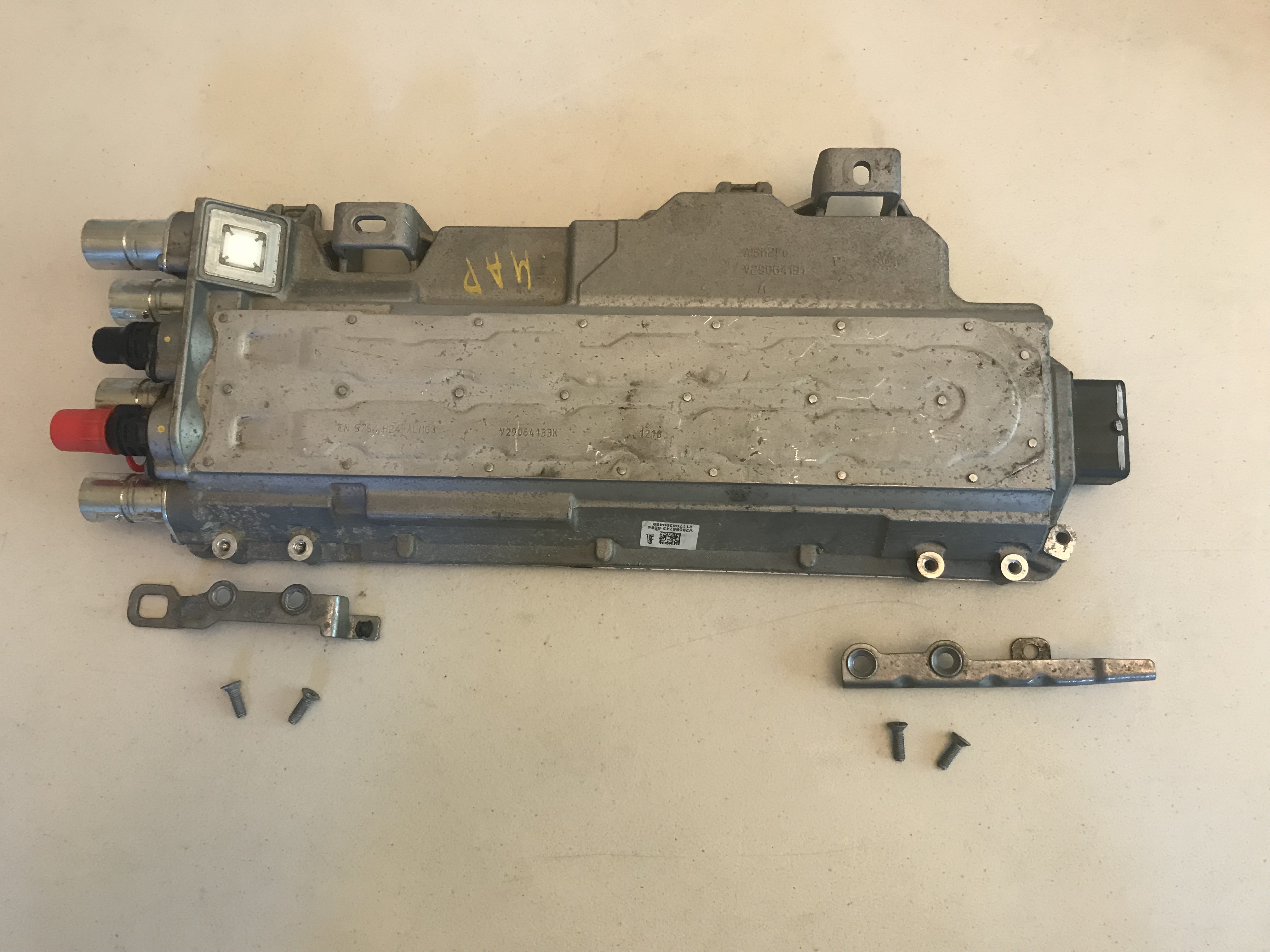

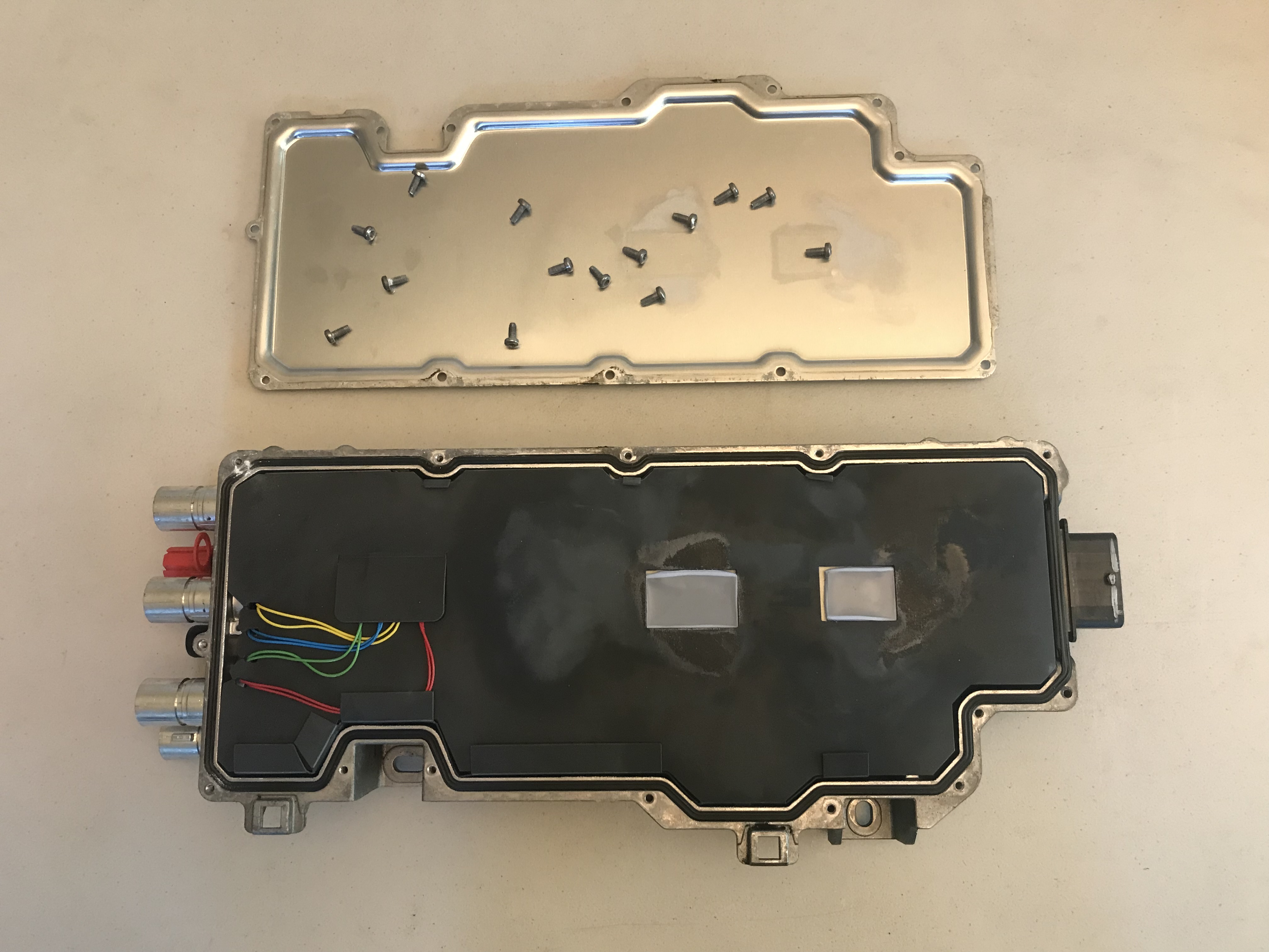

so first I removed the two funky mounting brackets
Gregski
Posts: 2873
Has thanked: 530 times
Been thanked: 1189 times
Re: I bought a BMW 530e onboard battery charger - now what?
Post by Gregski »

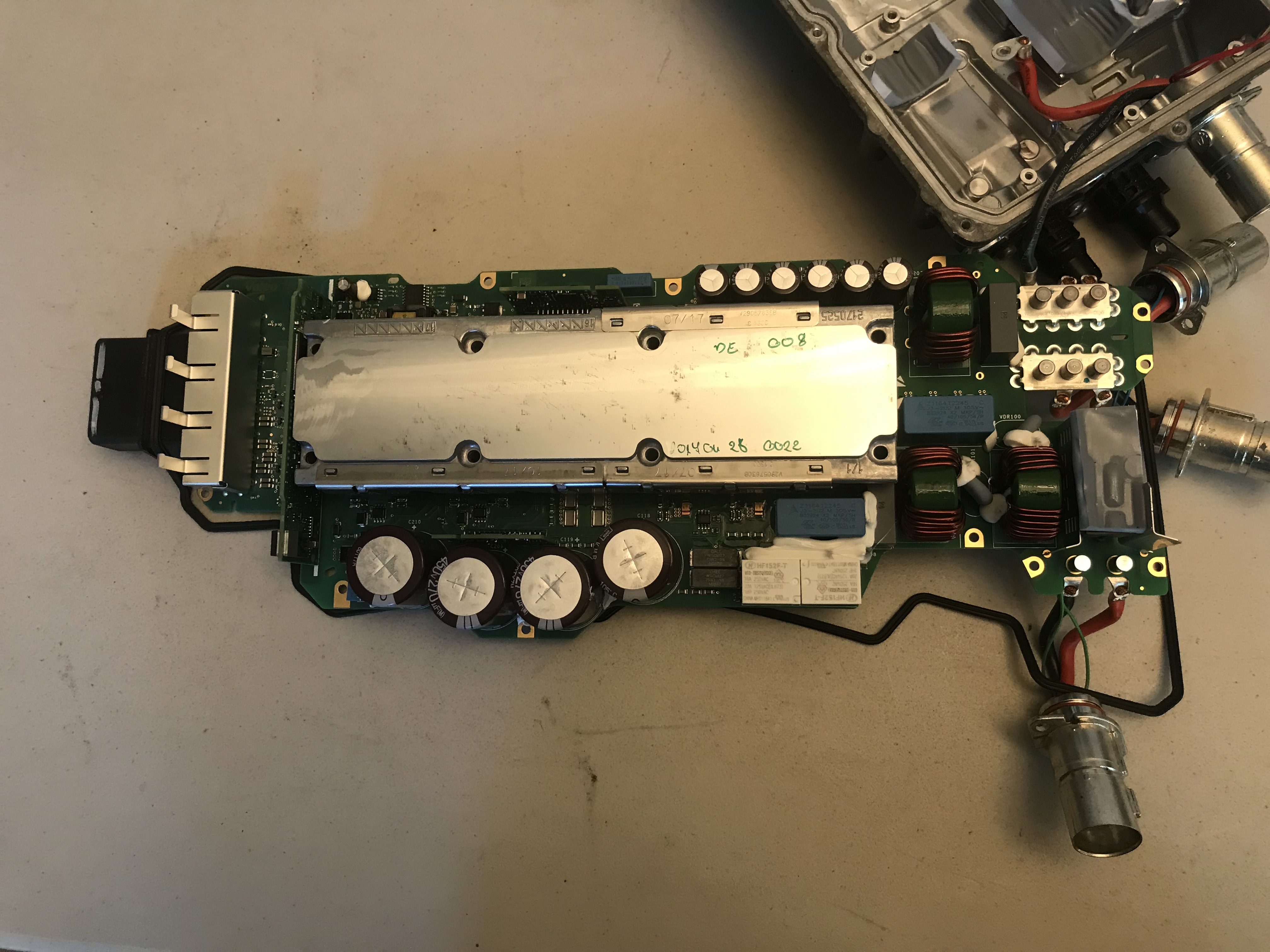

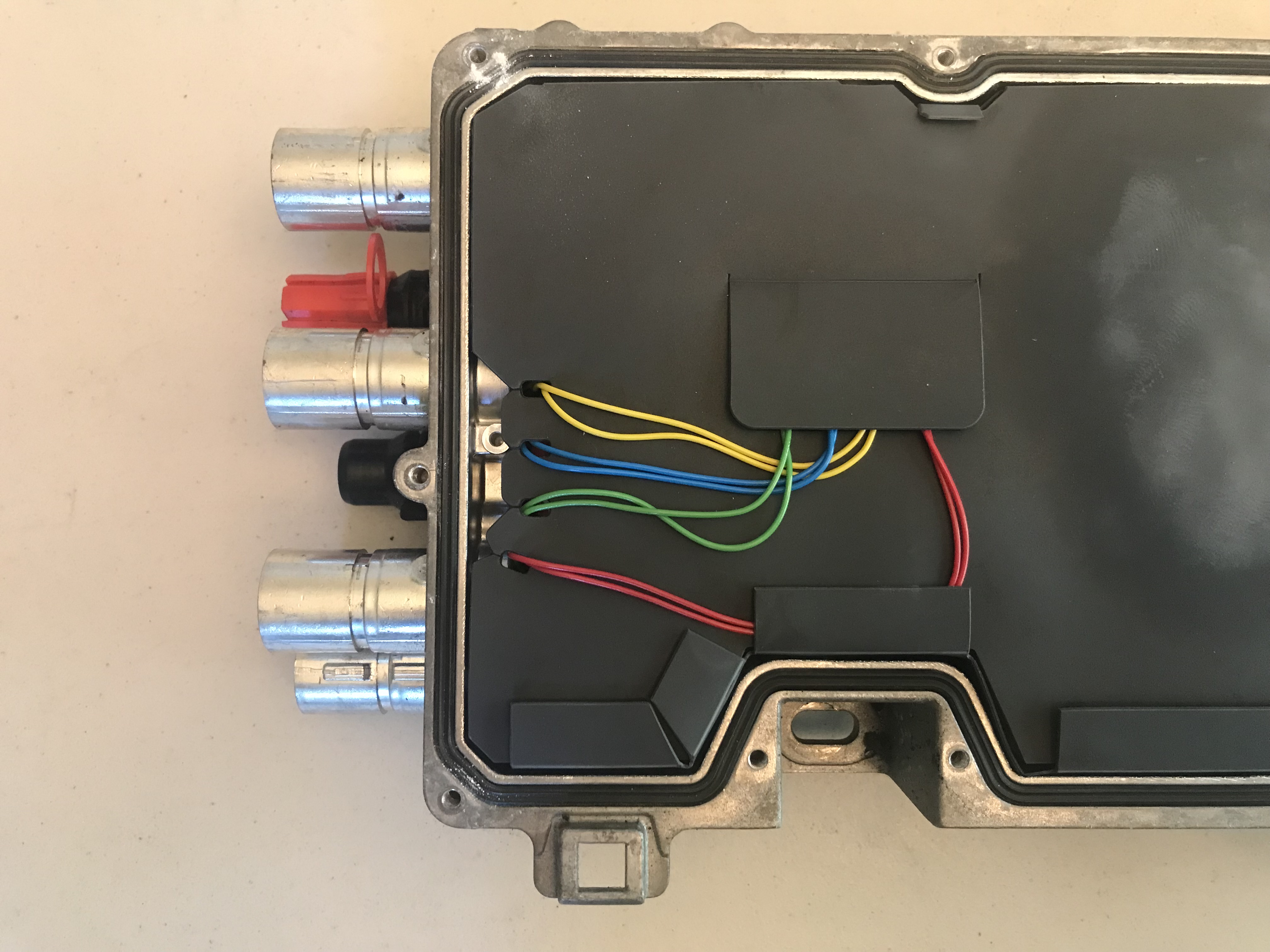

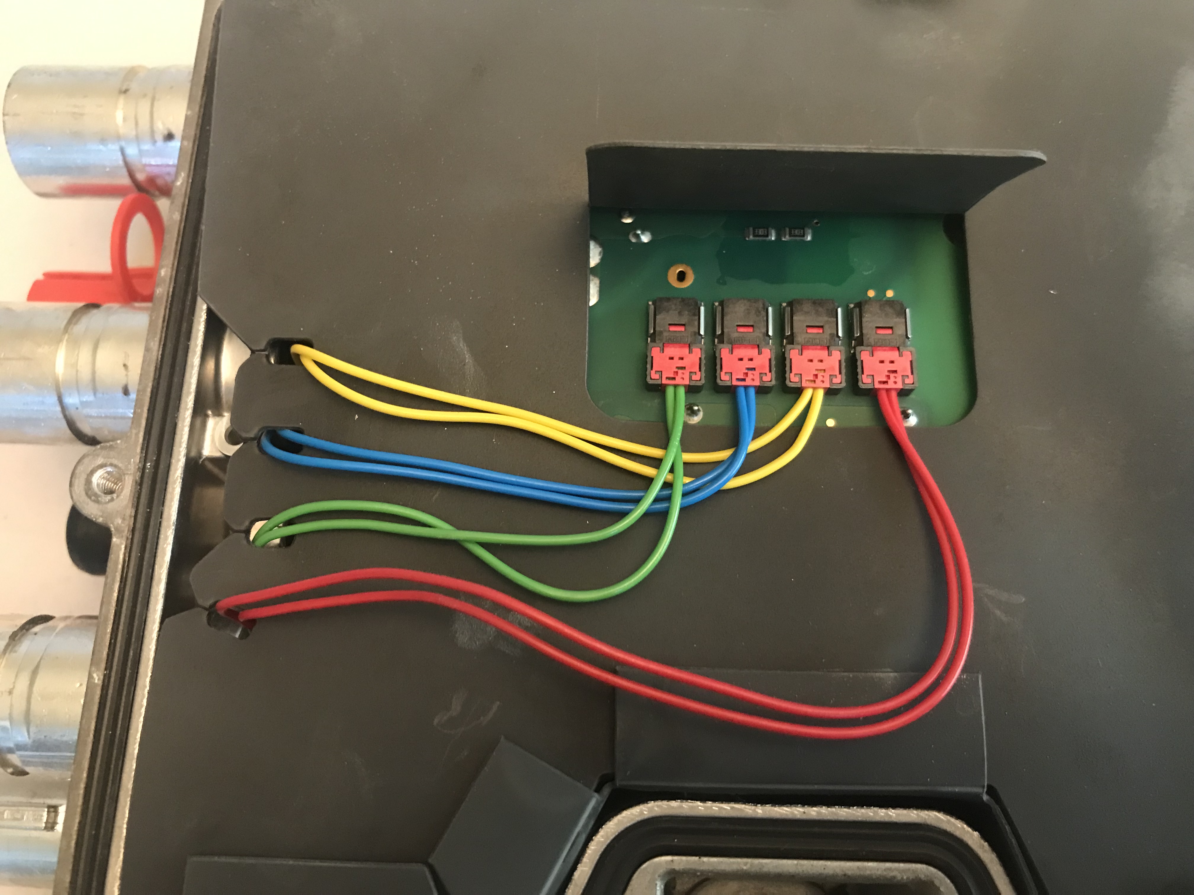

not having a wiring diagram, then I took a peak inside
ah yes, a rainbow
Gregski
Posts: 2873
Post by Gregski »
the good ol' cover under the cover trick
Gregski
Posts: 2873
Post by Gregski »

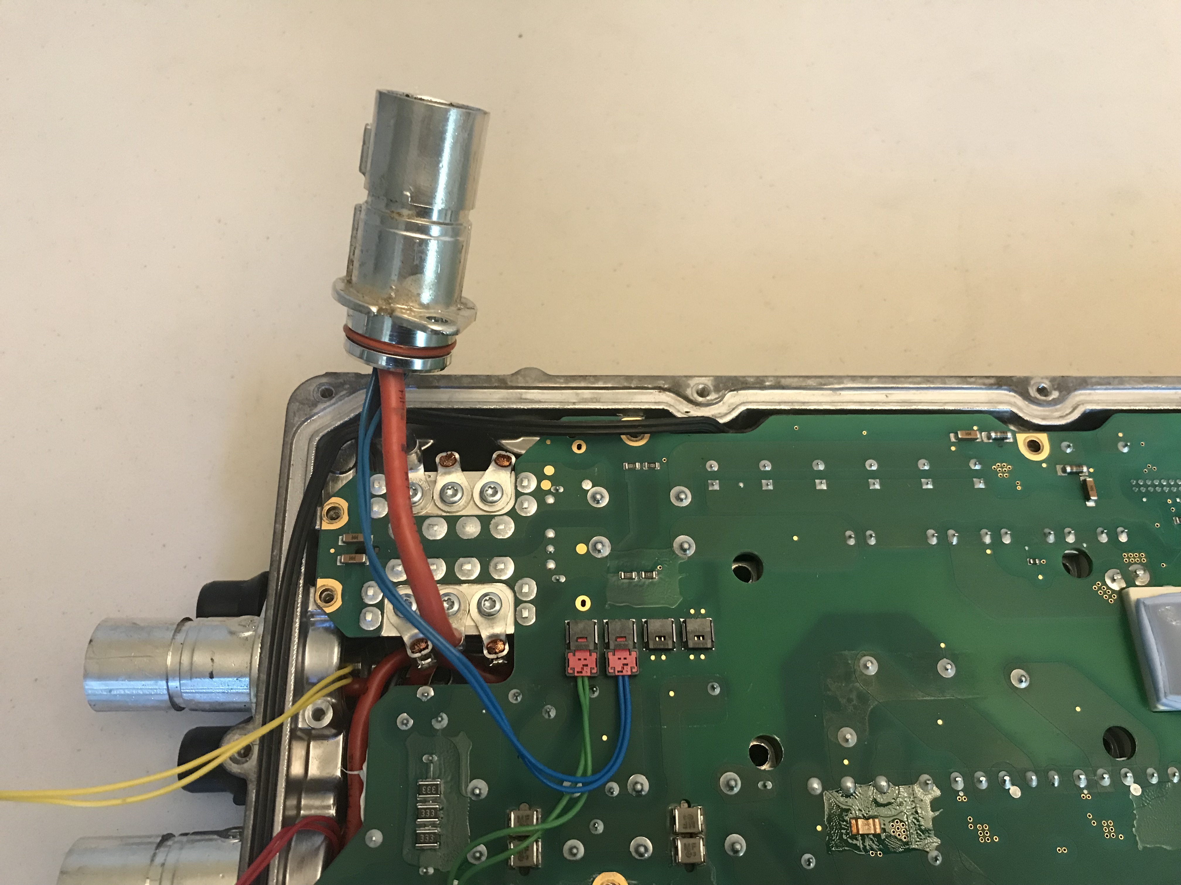

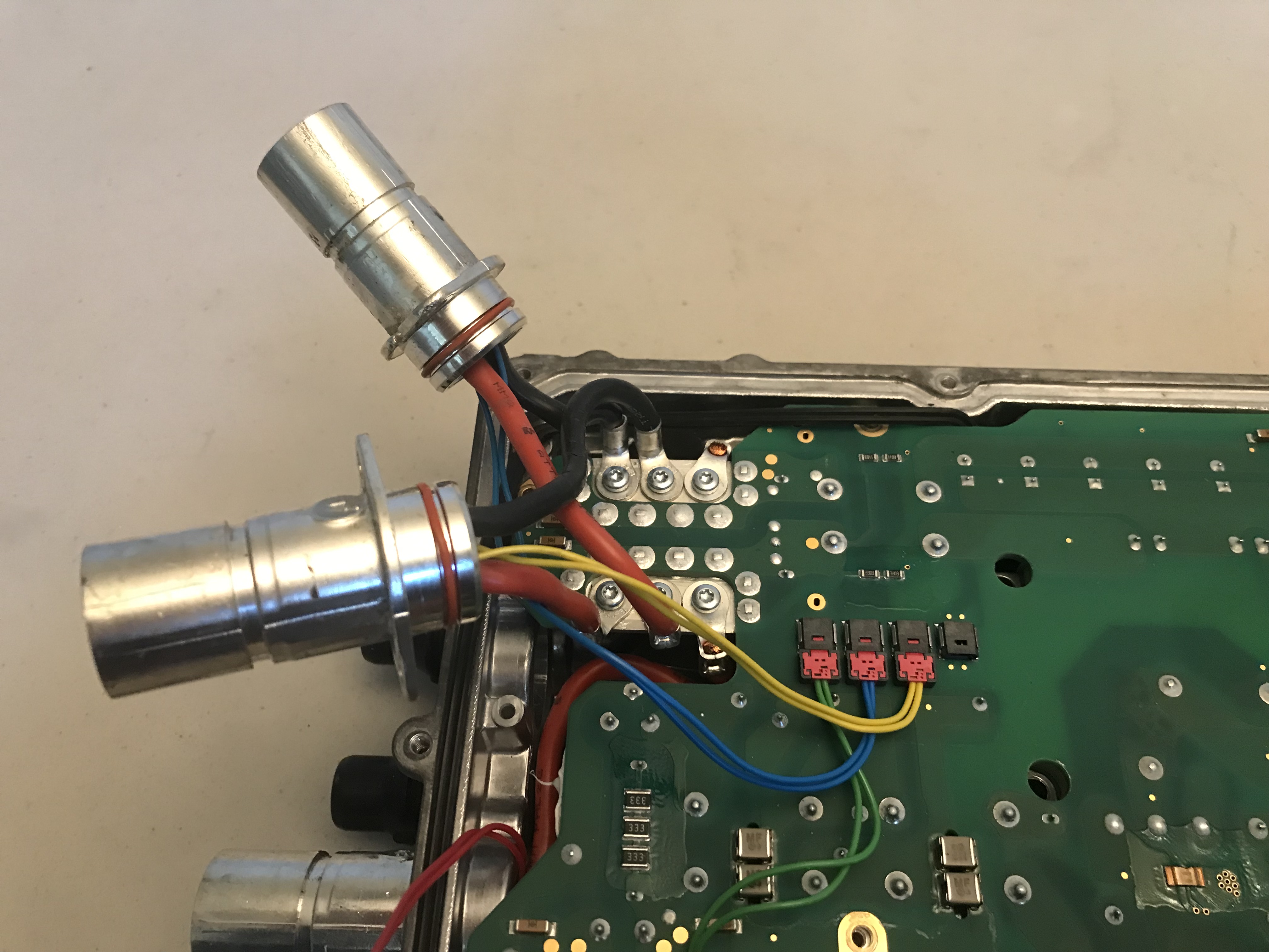

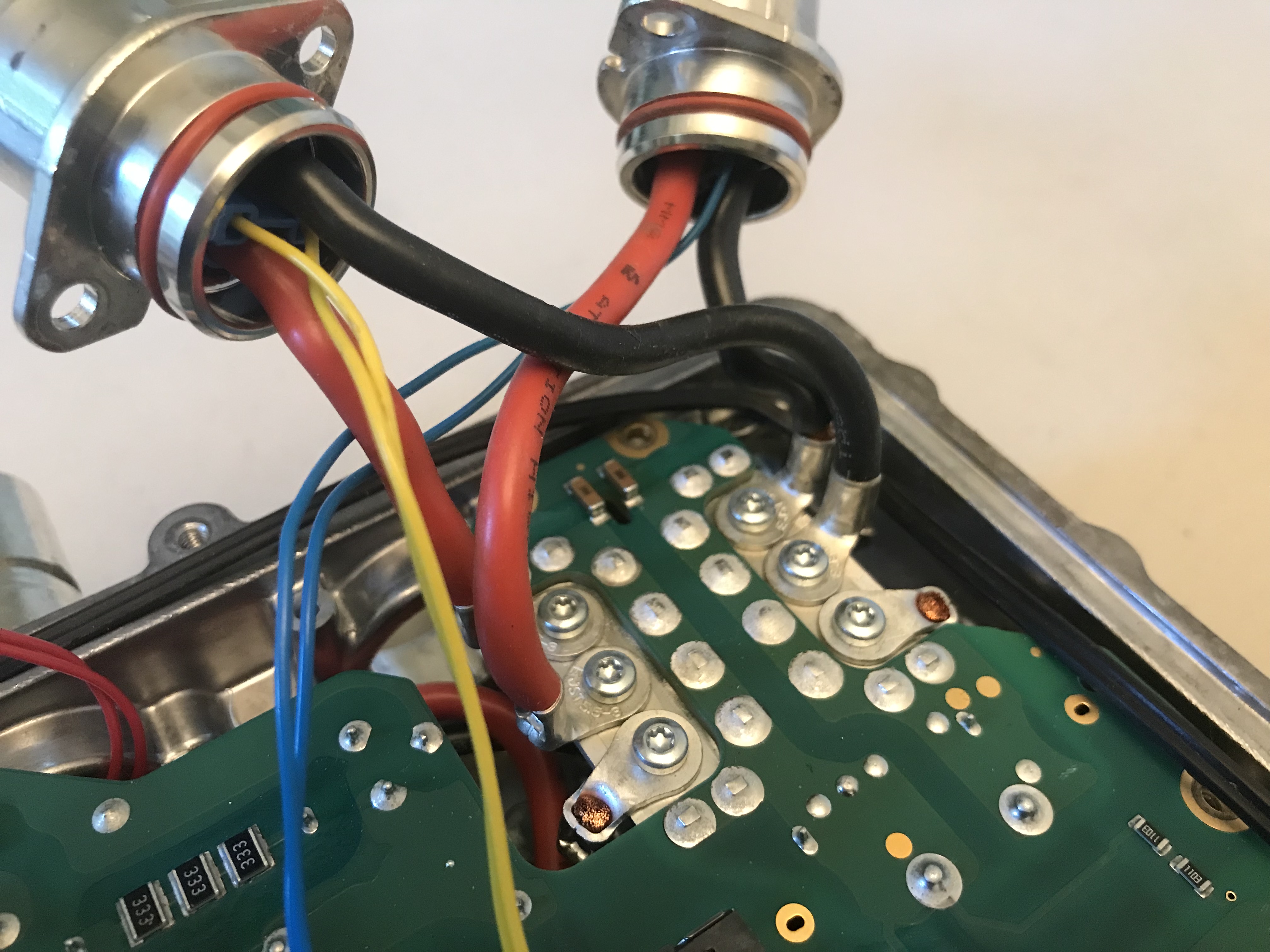

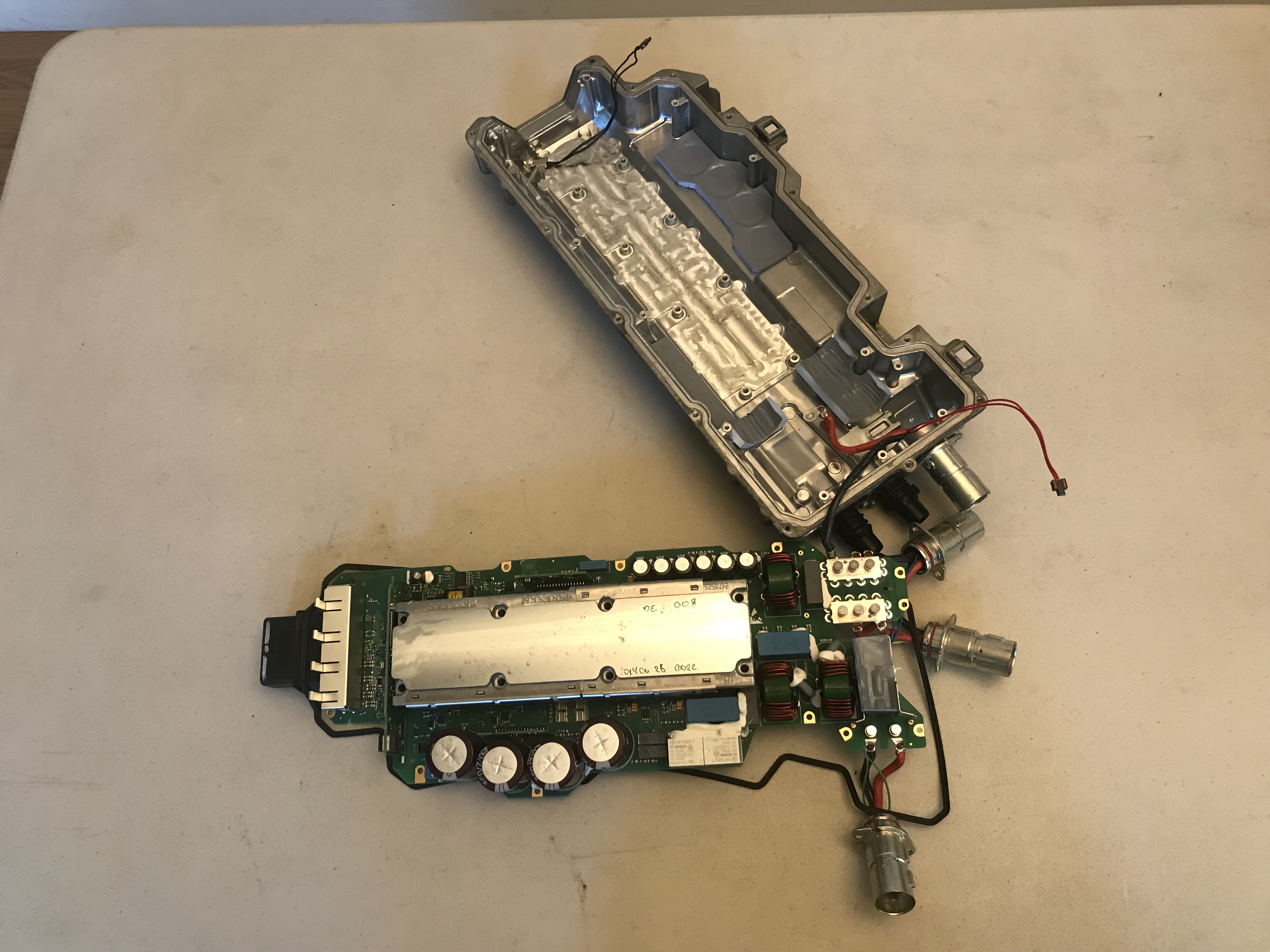

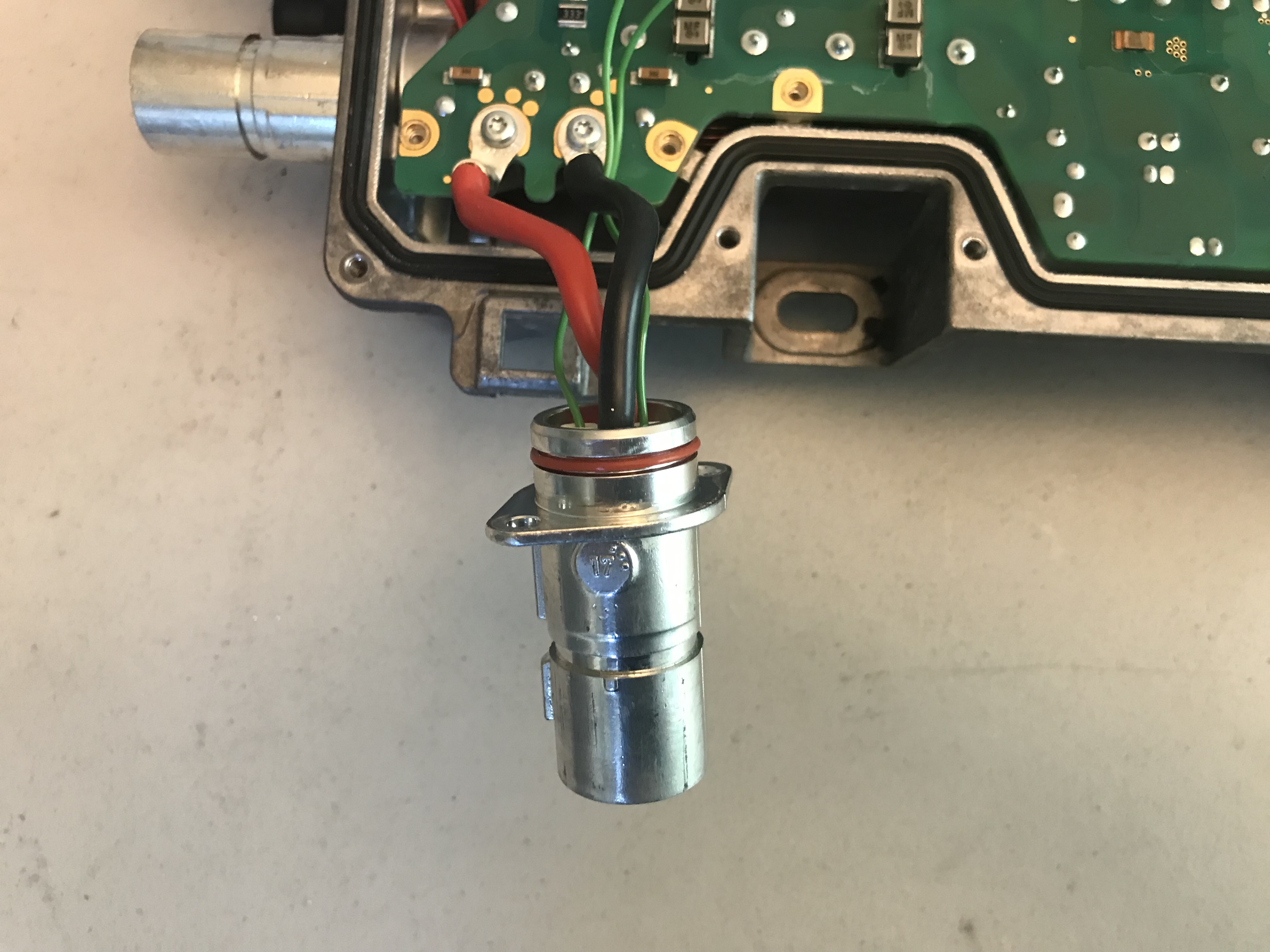

I just had to know where those tubular connectors run to, so I think this first one is actually the AC input plug that runs to the charging port socket, I rerouted it for demonstration purposes, at least in the end it's just a ring terminal connection, so that can easily be replaced with a regular high voltage orange cable, but what are those green thin wires for?
OutlandishPanda
Posts: 50
Joined: Fri Jun 26, 2020 7:25 pm
Location: West Sussex, UK
Post by OutlandishPanda »
Possibly HVIL (High Voltage Interrupt Loop)? The mating part of the connector shorts them out or takes the loop on another journey to another connector. If the whole loop is conducting end to end, it means all the connectors are in and secure. It runs all around the HV system, sometimes critical low voltage connectors also. If you pull a connector when the system is live, it will open the contactors to prevent, well, nasty accidents...

OutlandishPanda wrote: Fri May 13, 2022 7:10 pmPossibly HVIL (High Voltage Interrupt Loop)? The mating part of the connector shorts them out or takes the loop on another journey to another connector. If the whole loop is conducting end to end, it means all the connectors are in and secure. It runs all around the HV system, sometimes critical low voltage connectors also. If you pull a connector when the system is live, it will open the contactors to prevent, well, nasty accidents...
Ah, makes sense thank you for that.

QUESTIONS:
1. What do they mean by inductive charging, is that just another way of saying regen?
2. Why does one of the front tube connectors run to the AC Compressor, I have never seen that on a battery charger?
3. Can this be a charger/converter combo unit?
4. What is that other gizmo in the first diagram below the AC Compressor where wire #3 runs to? EDH?
Pete9008
Posts: 1801
Has thanked: 102 times
Been thanked: 350 times
Post by Pete9008 »
I would guess:
1. Inductively coupled - it's got a transformer in it??
2. Is it to allow it to run the AC to cool the battery? The battery does have refrigerant lines to it so it kind of makes sense.
3. No idea, they could just be using it as the HV junction box with integrated switching for the AC and heater?
4. Looks like a water heater to me.

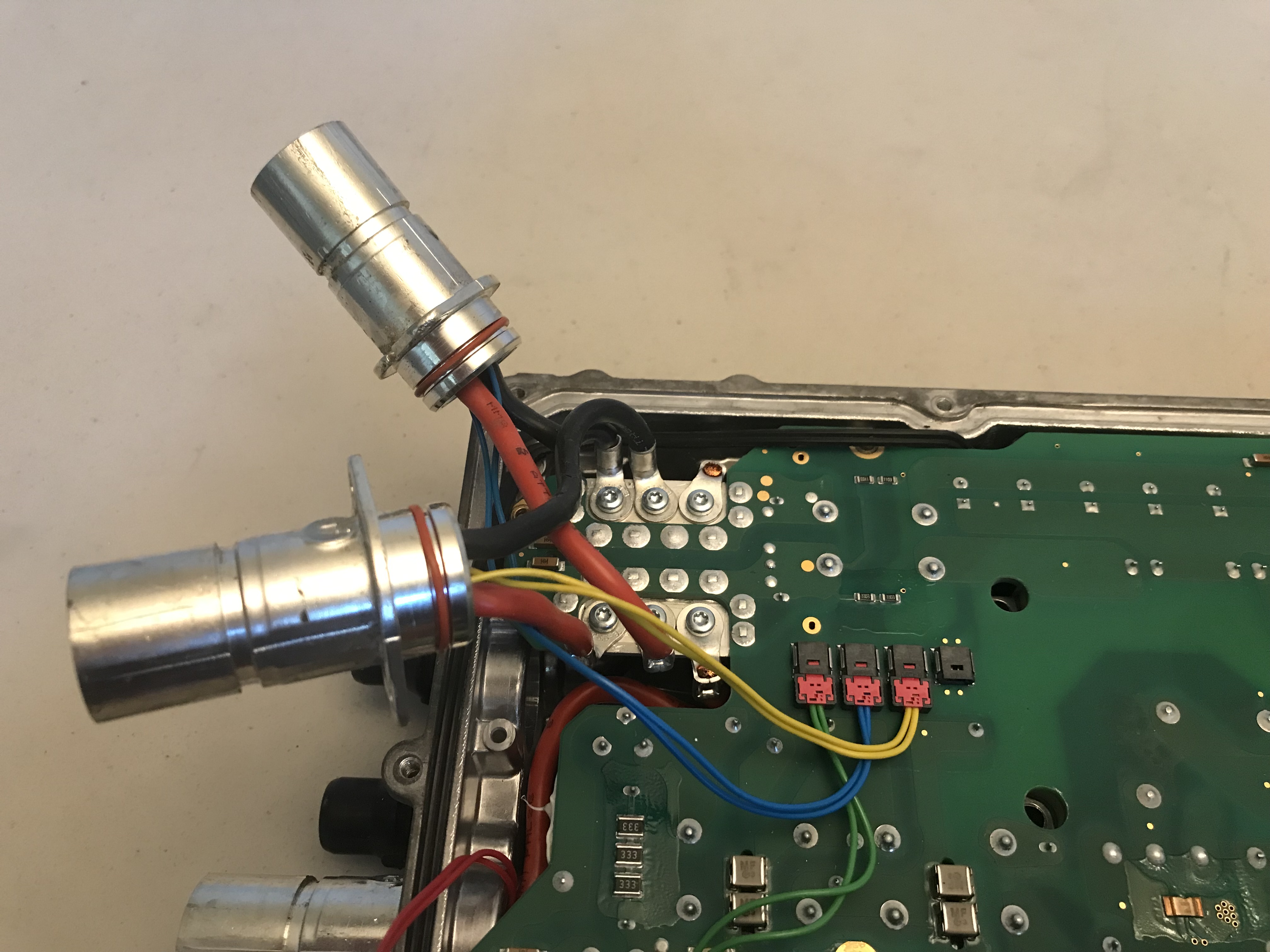

some more pictureness

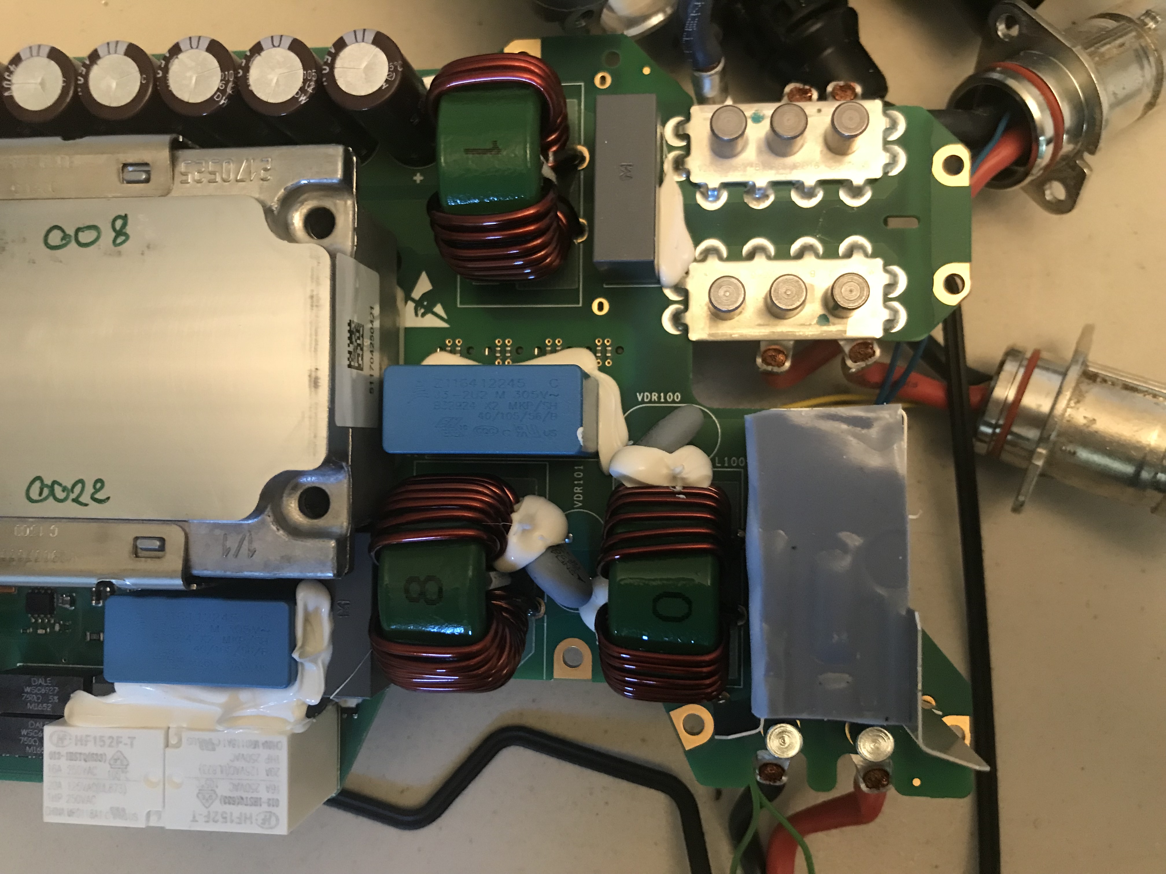

one of the do dads going to the main bus bar thingie
another of the do dads going to the same bus bar thingie

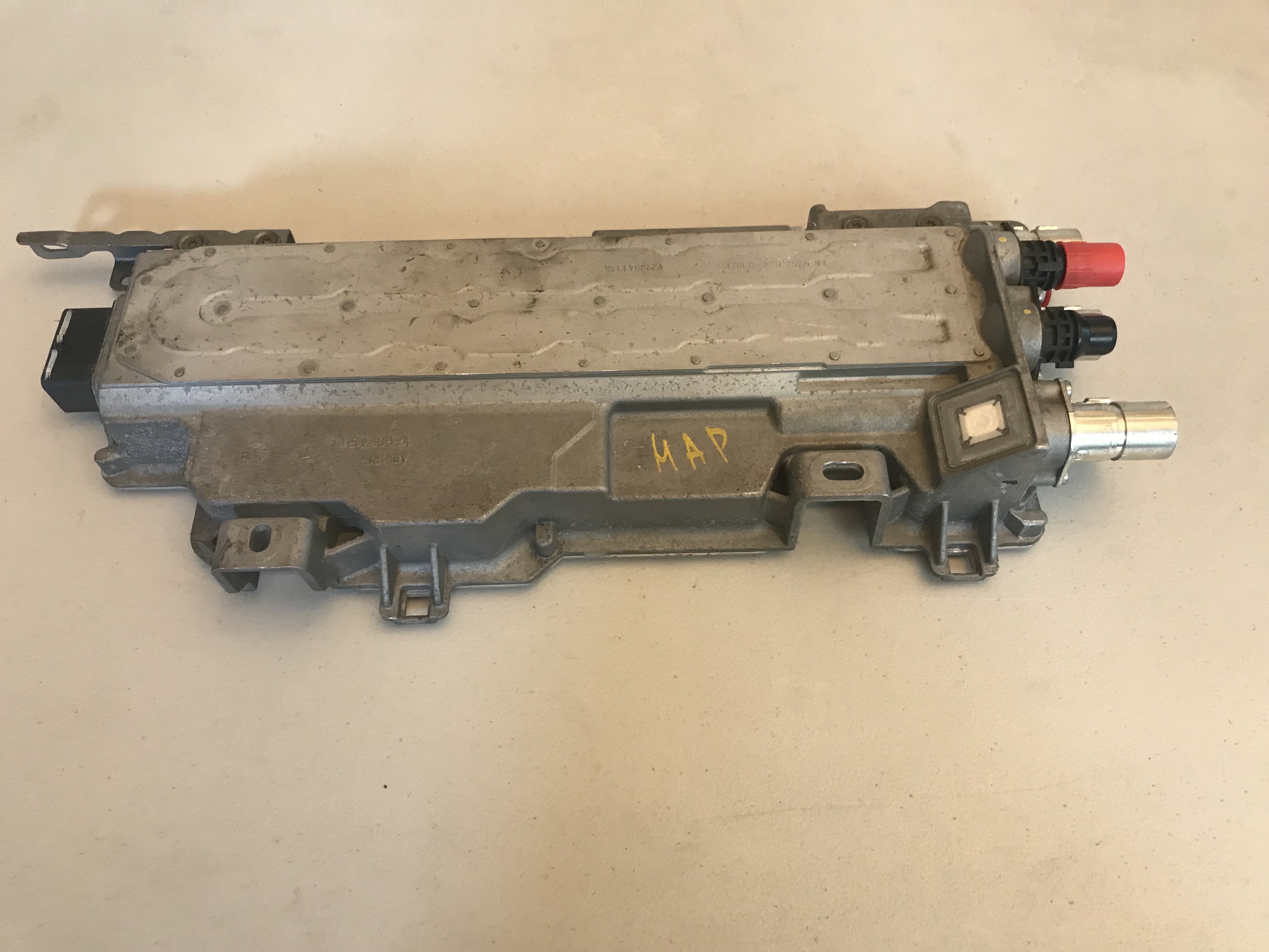

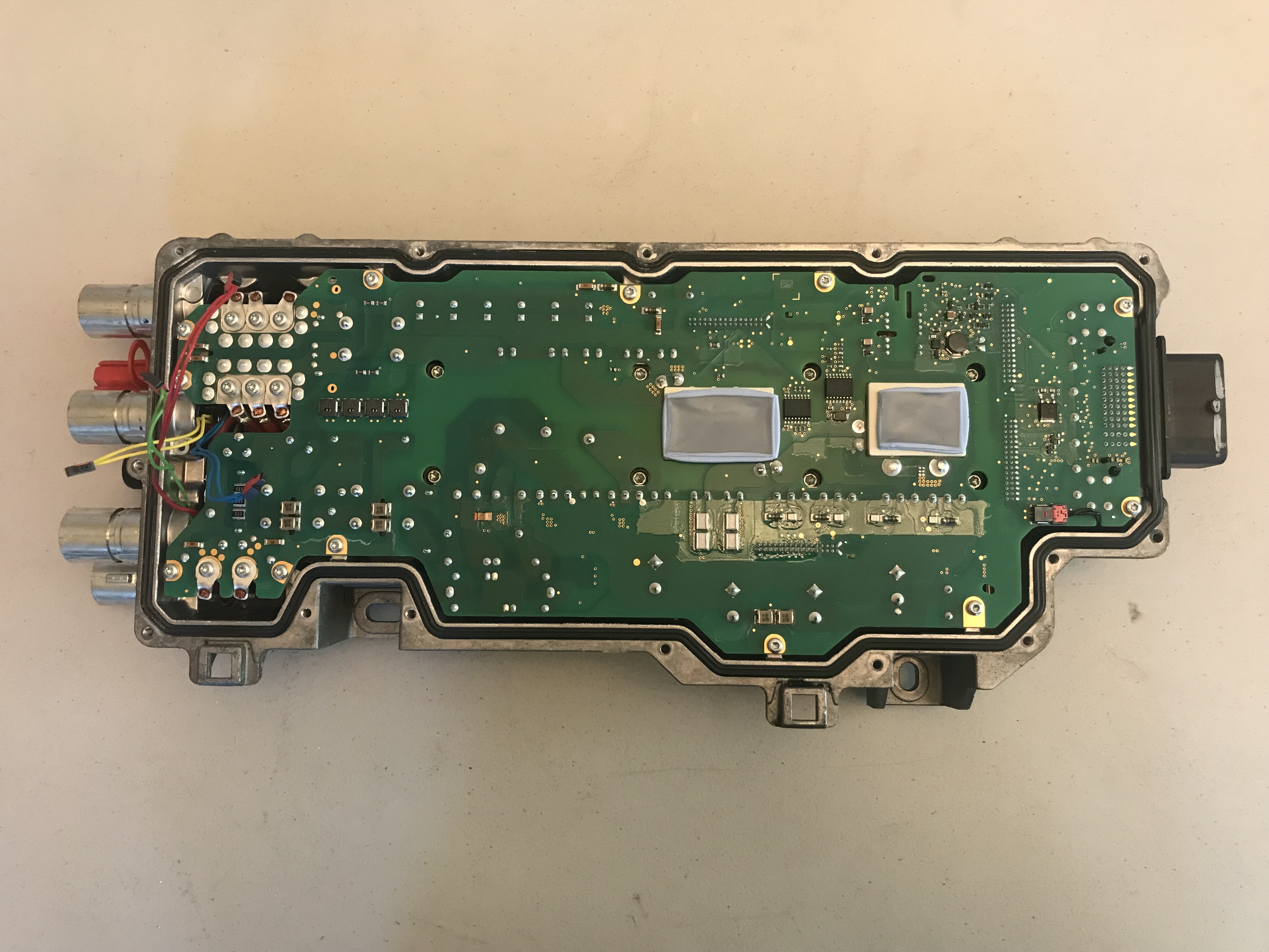

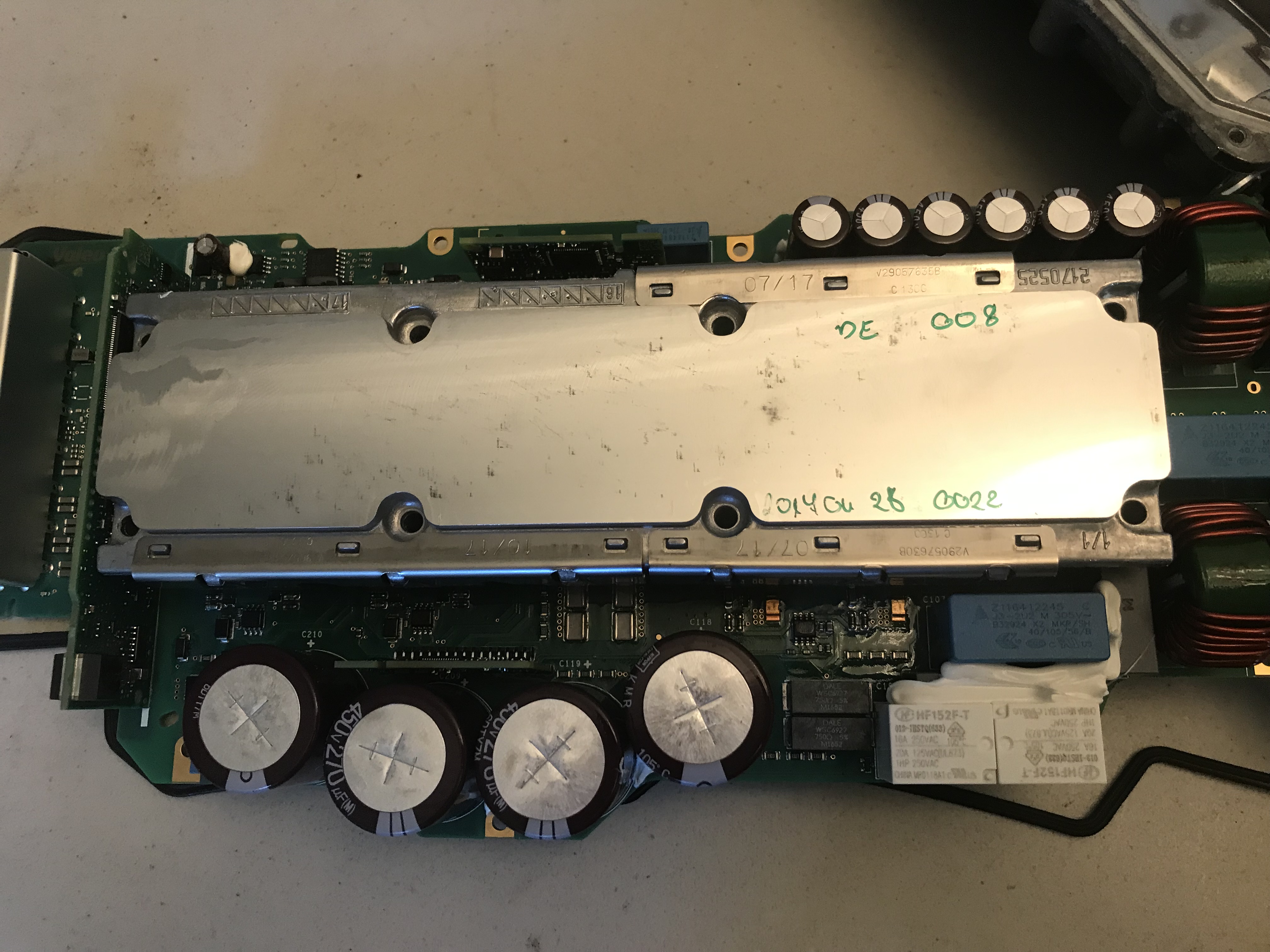

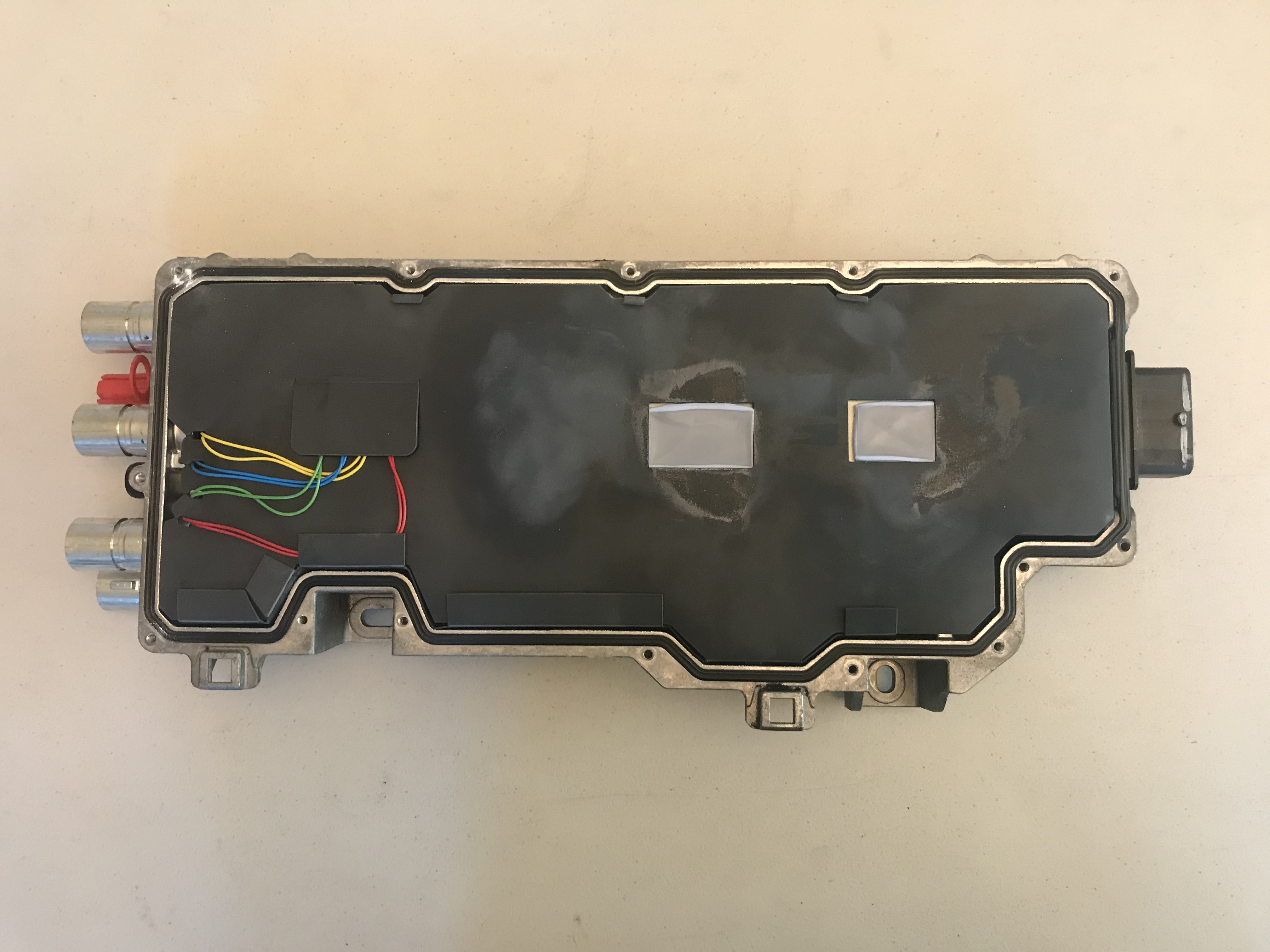

and I took the guts out and flipped it belly up
Gregski
Posts: 2873
Post by Gregski »

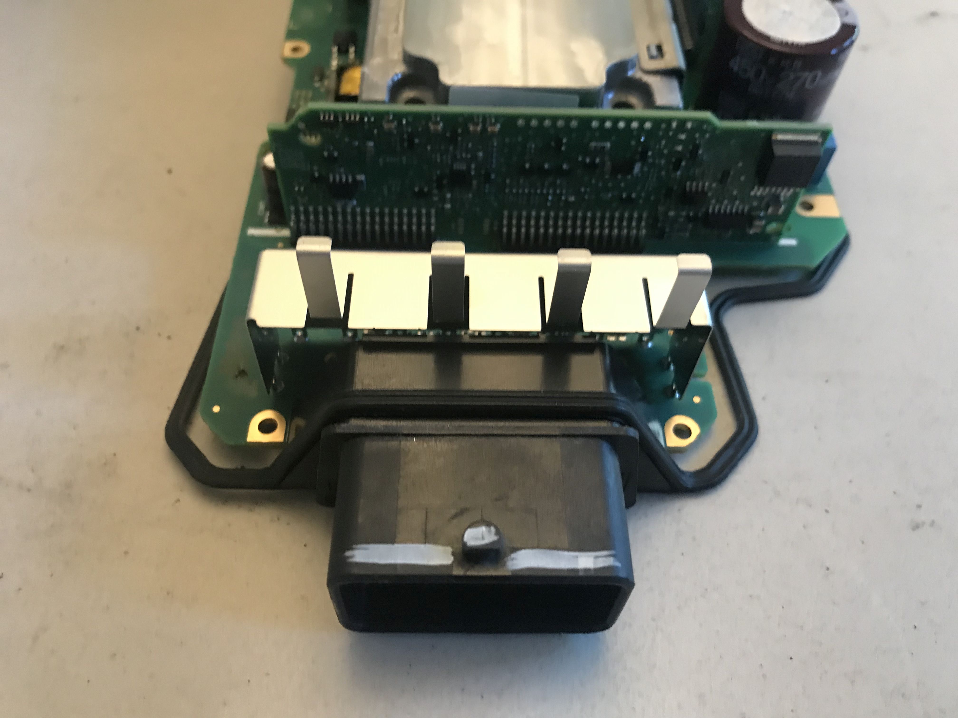

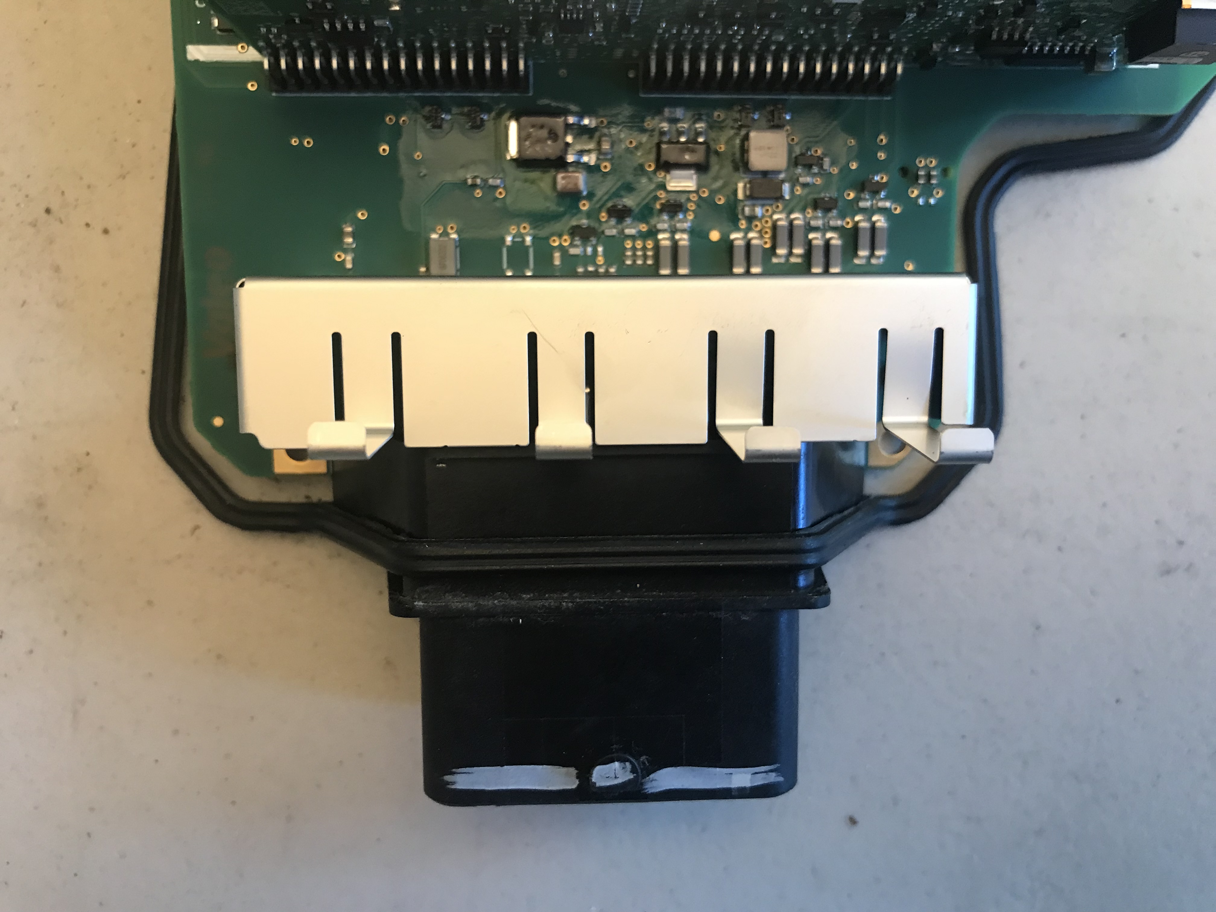

I wanted to see where these pins ranned to but there's a dam preventing it from happening

Based on the charging speed for those vehicles, it's a 3.6 kW single phase charger. It's used across the BMW plug-in hybrids and on the Mini Countryman Cooper SE plug-in hybrid. I've been hunting around for the 11 kW KLE for the Mini Cooper SE EV, but keep coming across these. They're quite cheap on eBay, some part numbers for this or similar KLE's are 61449485031, 61448742334, 61448699722, 61-44-8-742-334, 61-44-9-469-686, 61-44-9-456-002, 61448742334, 61449469686, 61449456002, 61-44-8-697-850, 61-44-8-699-722, 61-44-8-741-470, 61448697850, 61448699722, 61448741470, 61-44-8-655-217, 61-44-8-657-865, 61-44-8-661-458, 61448655217, 61448657865, 61448661458, 61-44-8-678-851, 61-44-8-654-202, 61-44-8-654-728, 61448678851, 61448654202, 61448654728, 61-44-8-663-249, 61-44-8-667-579, 61-44-8-671-959, 61448663249, 61448667579, 61448671959, 61-44-8-677-319 61448677319, 61445A02157 61449456002; 61449469686, 61-44-5-A02-157, 61-44-9-456-002; 61-44-9-469-686, 61-44-5-A2A-F55
