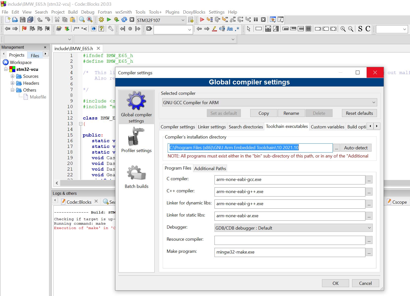

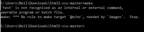

Hi johu, I wanted to check that I am on the right track. When you mention the 'printf' issue, I am taking this as only referring to the 'Makefile' file in the stm32-vcu-master github directory. There are 15 instances of 'printf' in that file, and I've shown a few example of what they were and what I've changed them to below (originally just replaced printf with echo but from your example looked like the " \n" etc info also gets removed).
I have make.exe installed, Codeblocks should be looking at this as set in the Toolchain Executables section of Global Compiler Settings, but still getting an error:
-------------- Build: STM32F107 in stm32-vcu (compiler: GNU GCC Compiler for ARM)---------------
Checking if target is up-to-date: make.exe -q
Running command: make
Execution of 'make' in 'C:\Users\Neil\Downloads\Stm32-vcu-master' failed.
My thoughts are that echo.o wouldn't be correct and I only need to worry about the @ commands. Also thrown by 'make' reference to the Stm32-vcu-master folder, should this be Makefile if I've done it right?

Re: Zombieverter .bin compile help - Codeblocks
Looks right. Can you run make on the command line?
- Posts: 509
- Has thanked: 284 times
- Been thanked: 65 times

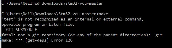

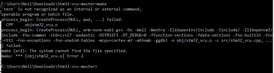

When I first tried 'make' from the command line I got errors about not being a command. Fixed the path's and should now be working.
Running 'make' from the stm32 folder gives me this reply, not sure yet what this means:
EDIT: Retried building in Codeblocks now the 'make' path was changed and get the same error as above

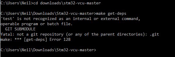

- Posts: 5791
- Has thanked: 157 times
- Been thanked: 1023 times
Ok, one step further then. Just run "make get-deps" once, then remove "get-deps" behind the "images:" label in line 63.
Code::Blocks just executes the make command so you'll always get the same result as on command line

Thanks johu,

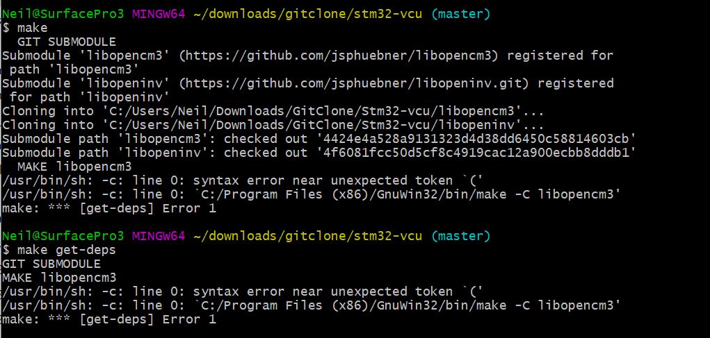

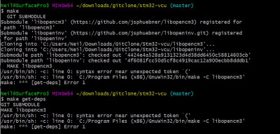

Ok. So ran make get-deps once and got a similar error:
Then opened the Makefile in Notepad and edited line 63: images: get-deps $(BINARY) to images: $(BINARY) and ran 'make'. This looks to do more but something still annoying it:
Wondering if your suggestion to remove 'get-deps' might mean remove the whole line, I tried removing the rest of that line $(BINARY) and ran 'make', but this still gave an error:
I'm thinking the 'make get-deps' didn't do what it was supposed to above

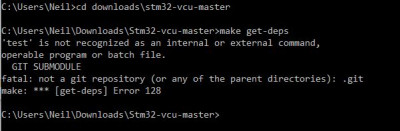

Googling some forums and working through this. Originally I had only downloaded the repo zip files so went back and cloned it properly and using git bash tried the 'make' command again. More happening this time. Stopped on an error again, ran make get-deps and got another error.
As per previous suggestion, I edited line 63 of the makefile (images: get-deps $(BINARY) and removed get-deps from the line). I know get-deps didn't run right but tried anyway. Running make again gives similar error to before.
More homework to do
More homework to do

Oh I thought you were already compiling per your other thread.
I faintly remember this happening on Zapateros Windows machine. I "solved" it by copying the already compiled libopencm3 over
In fact you only need the static lib for the STM32F1, attached it. Extract it into libopencm3/lib
Then, with get-deps removed you should be able to just run "make"

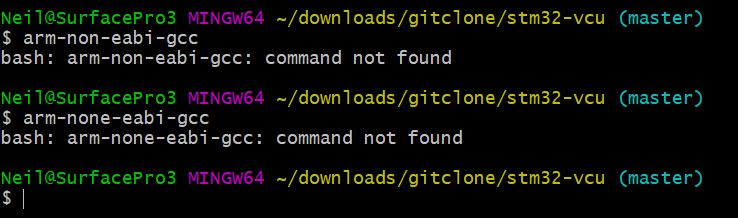

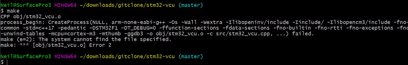

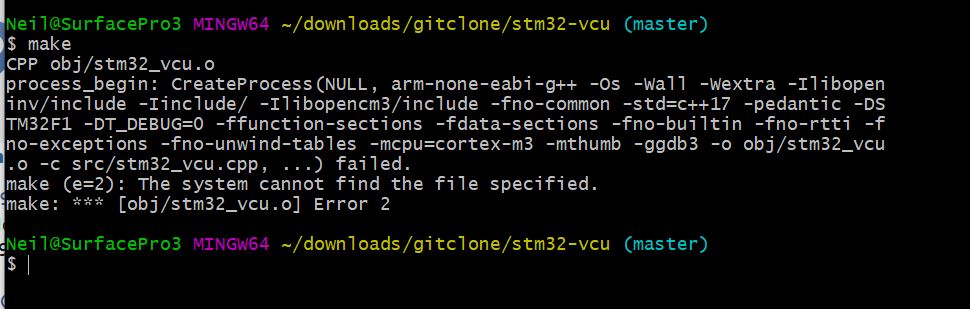

Ran 'arm-non-eabi-gcc' and 'arm-none-eabi-gcc' and got following error so yes, looks to be issue here. They do show up in codeblocks on the toolchains though:
Copied over the 'libopencm3_stm32f1.a' file above and unzipped into the lib folder of libopencm3 in the clone repo. Just ran make before I figure out how to fix eabi issue out of curiosity:
- Posts: 5791

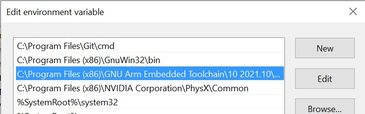

The settings in CodeBlocks are irrelevant, the toolchain has to be in your path variable

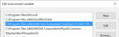

Ahh, ok. Thought I had that done but was the GnuWin32 I did recently instead. This should be it now.

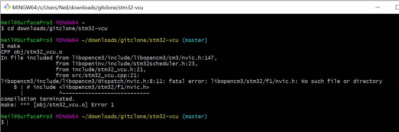

Rebooted and ran 'make' again. Still something with libopencm3:

Ah crap, the .h files are partially generated by some python scripts. So, attaching some more. Goes into /libopencm3/include/libopencm3

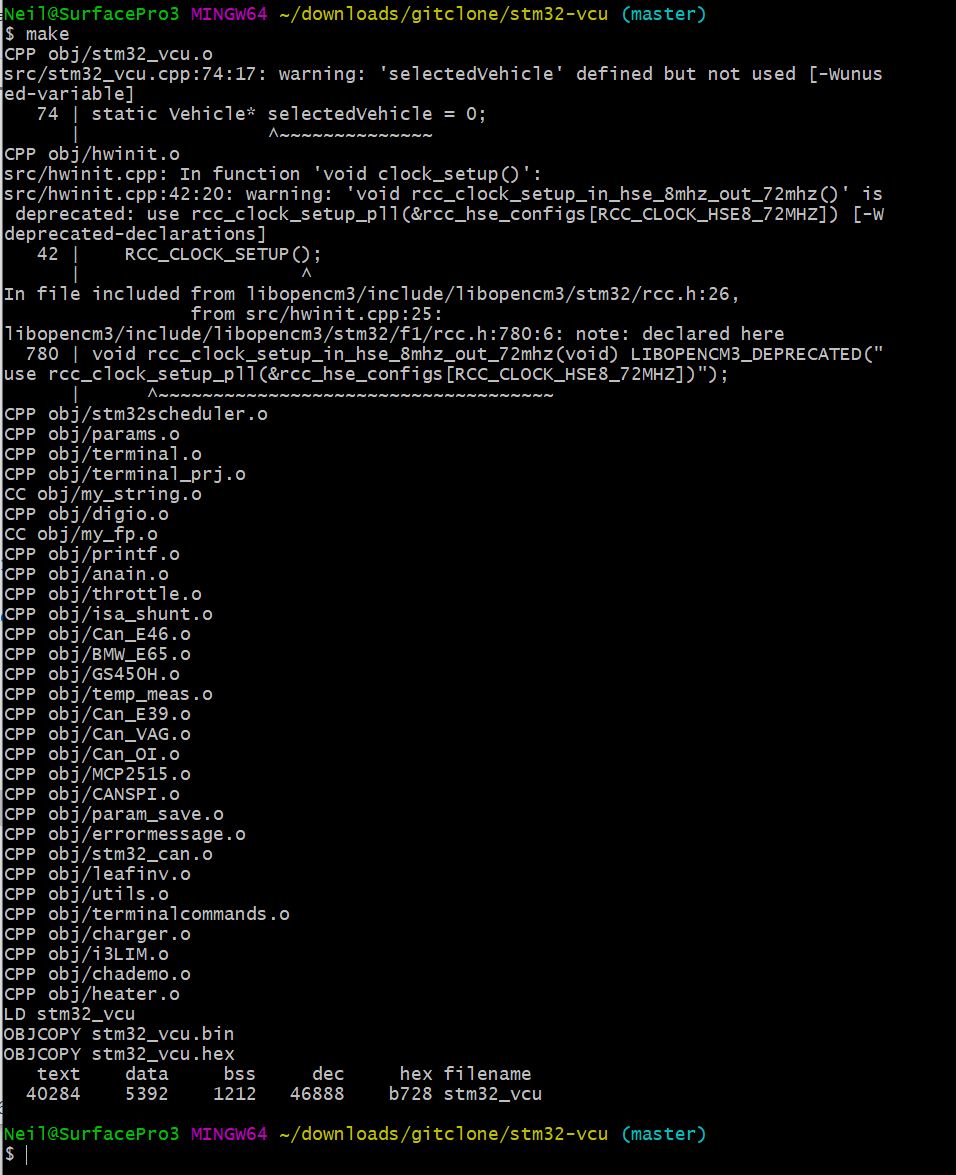

Johu, you the man! Looks like we have lift off! Bin and Hex have been created in the folder

So after a few days trying to compile the stm3-vcu.bin file. I found a readme which gives a "simple way to compile" the files
The main thing is to get the software listed and install it all, don't get the latest version of anything.
The list is,
**For Windows:**
Download and install:
- msys - http://sourceforge.net/projects/mingw/f ... 1.0.11.exe
- Python - http://www.python.org/ftp/python/2.7/python-2.7.msi (any 2.7 release)
- arm-none-eabi/arm-elf toolchain (for example this one gcc-arm-embedded version 4.8 2014q3)
Run msys shell and set the path without standard Windows paths, so Windows programs such as 'find' won't interfere:
export PATH="/c//Python27:/c/ARMToolchain/bin:/usr/local/bin:/usr/bin:/bin"
At this point the cursor changed to a blinking triangle so I exited msys shell and then re started msys shell
Now, in "msys shell" run, "git clone https://github.com/damienmaguire/Stm32-vcu.git"
Then, "cd ~/Stm32-vcu"
followed by, "make get-deps"
then, make
you will find the hex and bin file in, C:\msys\1.0\home\<username>\Stm32-vcu
