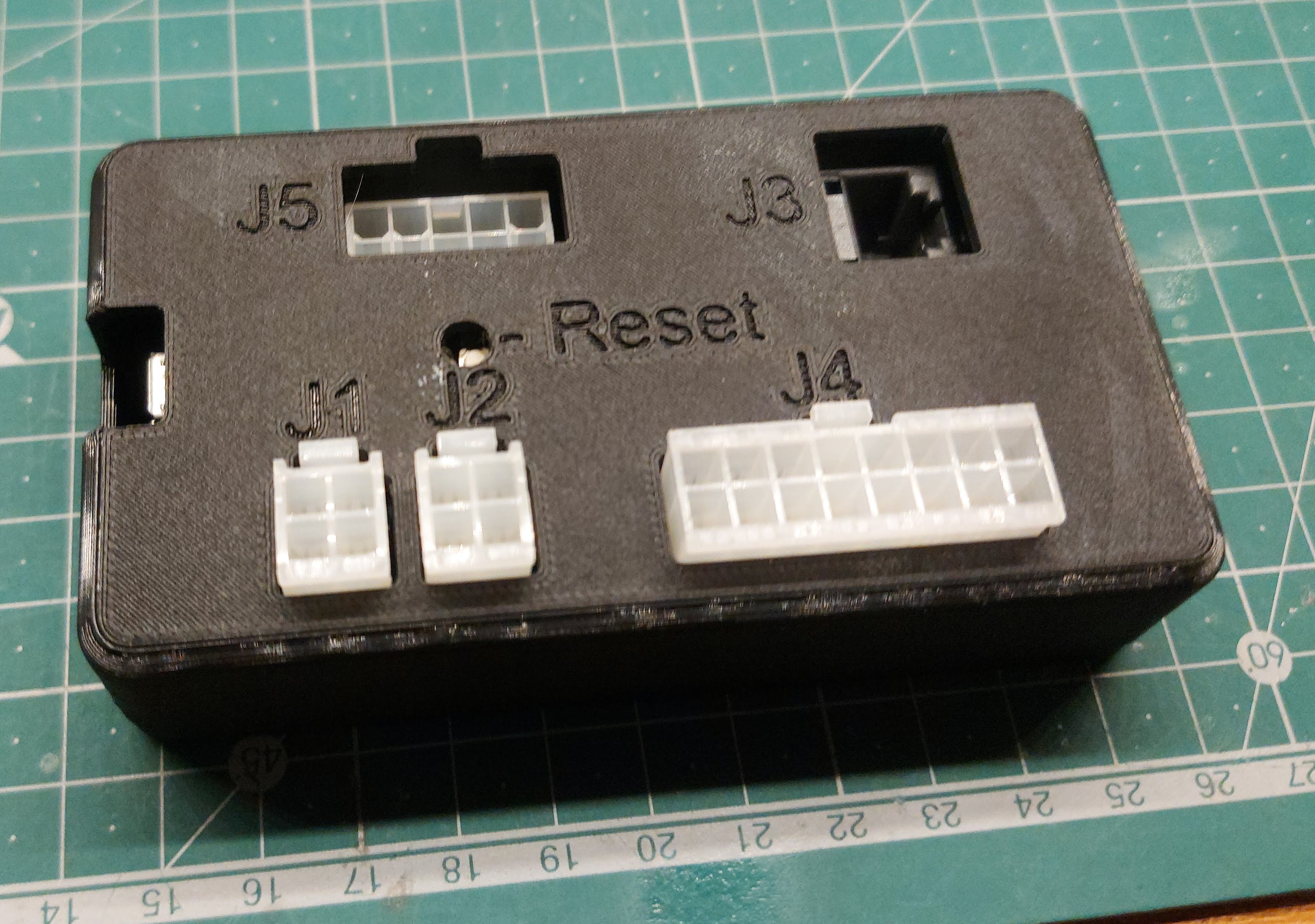

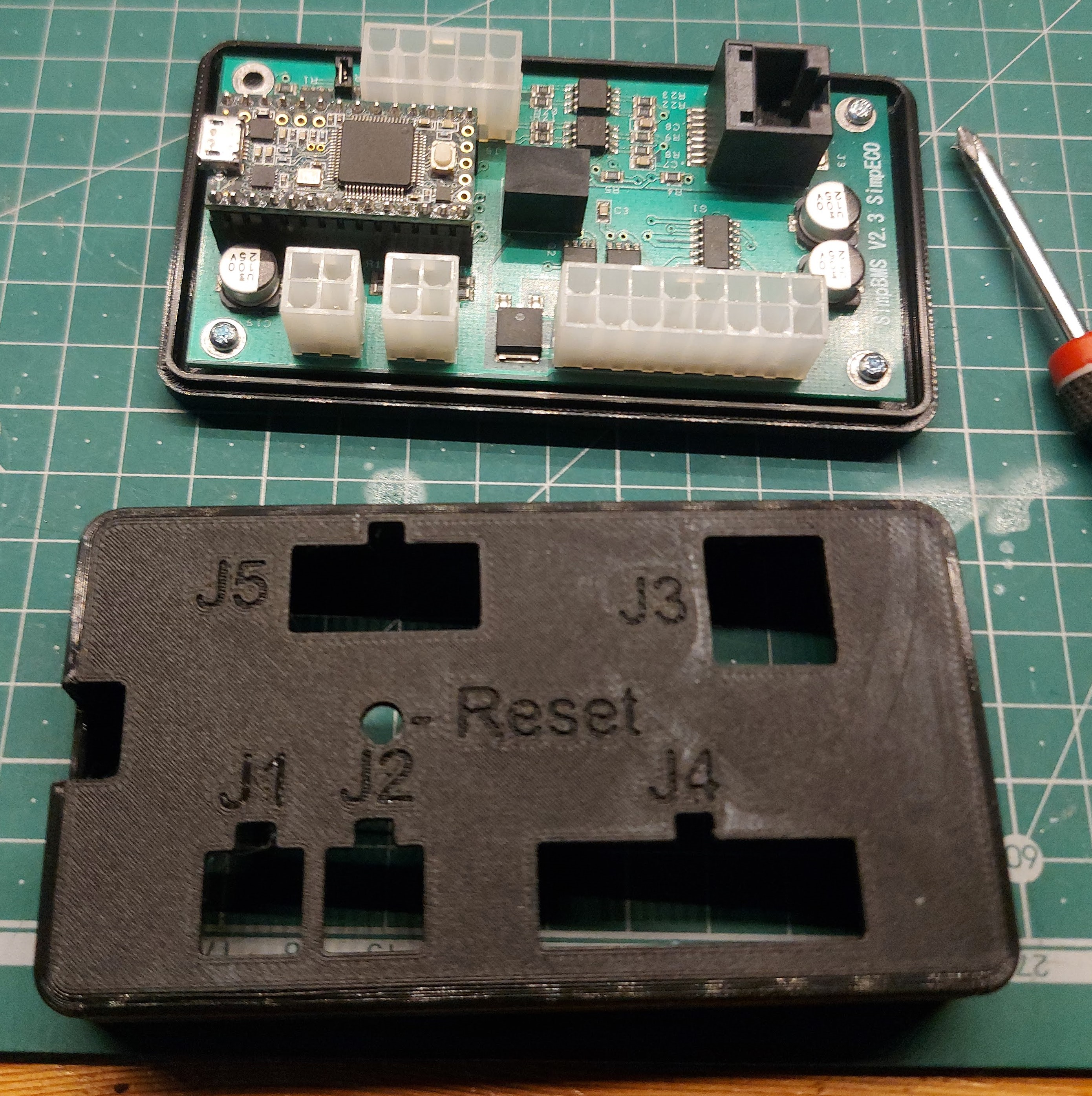

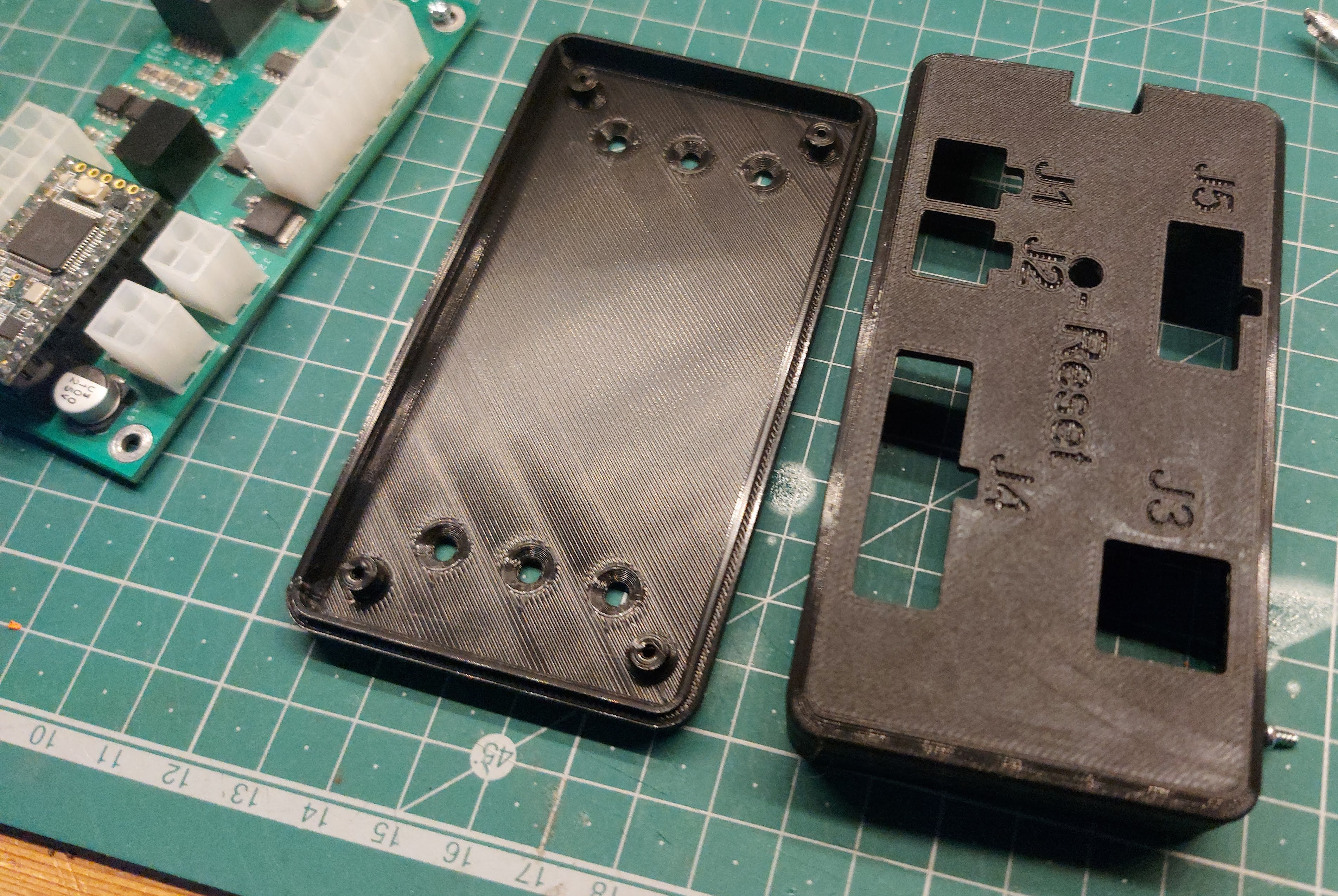

A couple of people have asked about a 3d printed housing or a housing in general for the SimpBMS.

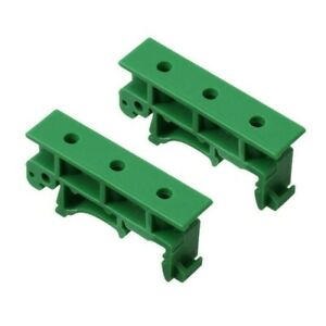

I have drawn one up, it comes in two pieces a bottom and a cover. It is deigned to work with drg-01 din mounts if so desired.
The top half just fits snug on the bottom so no true "fixings" are used. The SimpBMS is held into the base with 4 No.2 selftapping screws.
Simp Top Housing.stl
(572.25 KiB) Downloaded 270 times
Simp Bot Housing.stl
(626.94 KiB) Downloaded 231 times
