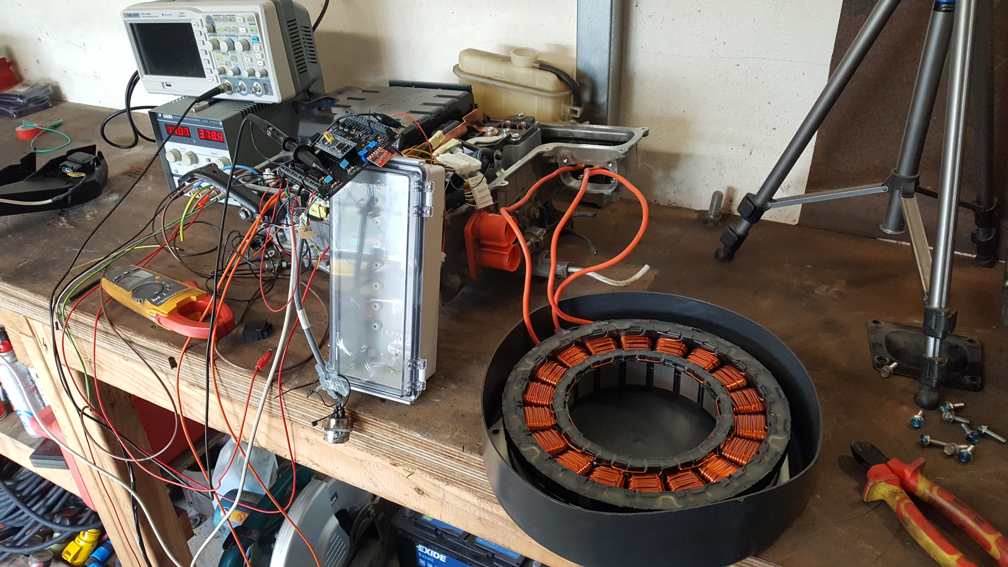

For anyone out there who doesnt think the Gen 2 Prius inverter can handle much current ....
Posts: 3831
Has thanked: 75 times
Been thanked: 696 times
Re: Toyota Prius Gen 2 Inverter Controller
210A RMS at 50Hz max current I could push through MG2 with the voltage available and risk of melting the Insight IMA motor stator I was using as a dummy load oil cooled in ATF. No cooling on the inverter. No shutdown or overcurrent trips. At 200A rms MG2 current sensors were swinging +/-7.5V perfect sine wave.

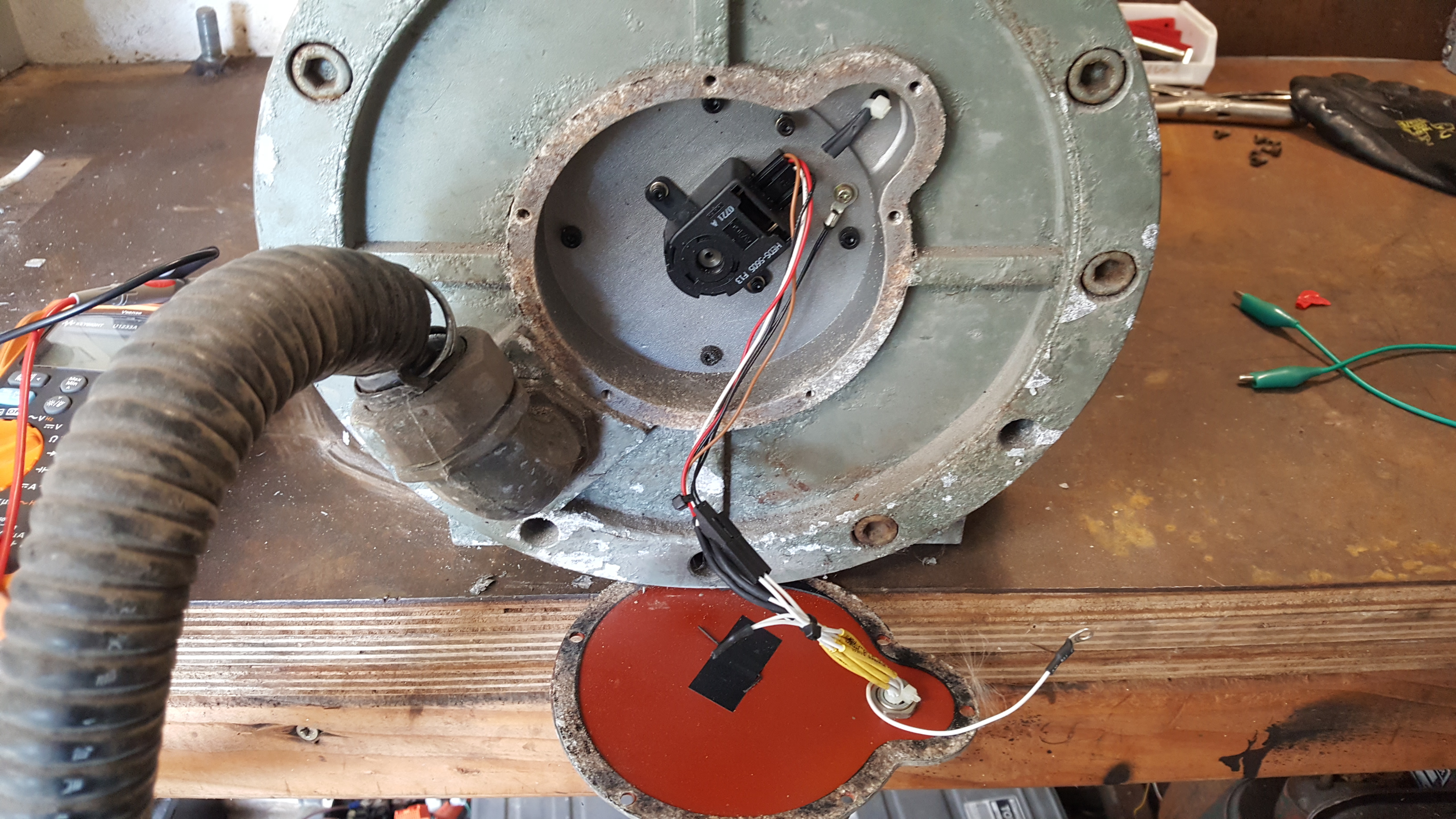

Was also able to run an induction motor in full closed loop mode once I realised the stupid morons at Enova had wired the encoder cable screen to the motor casing :x
