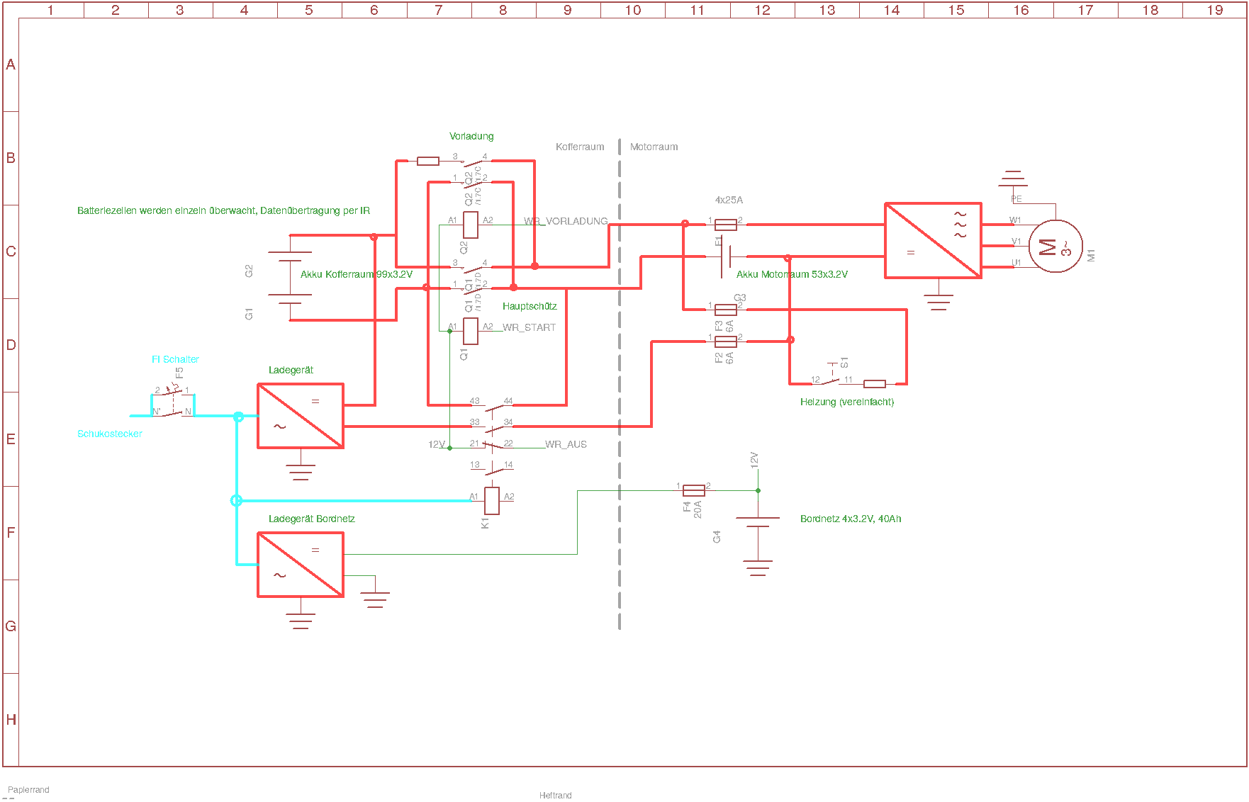

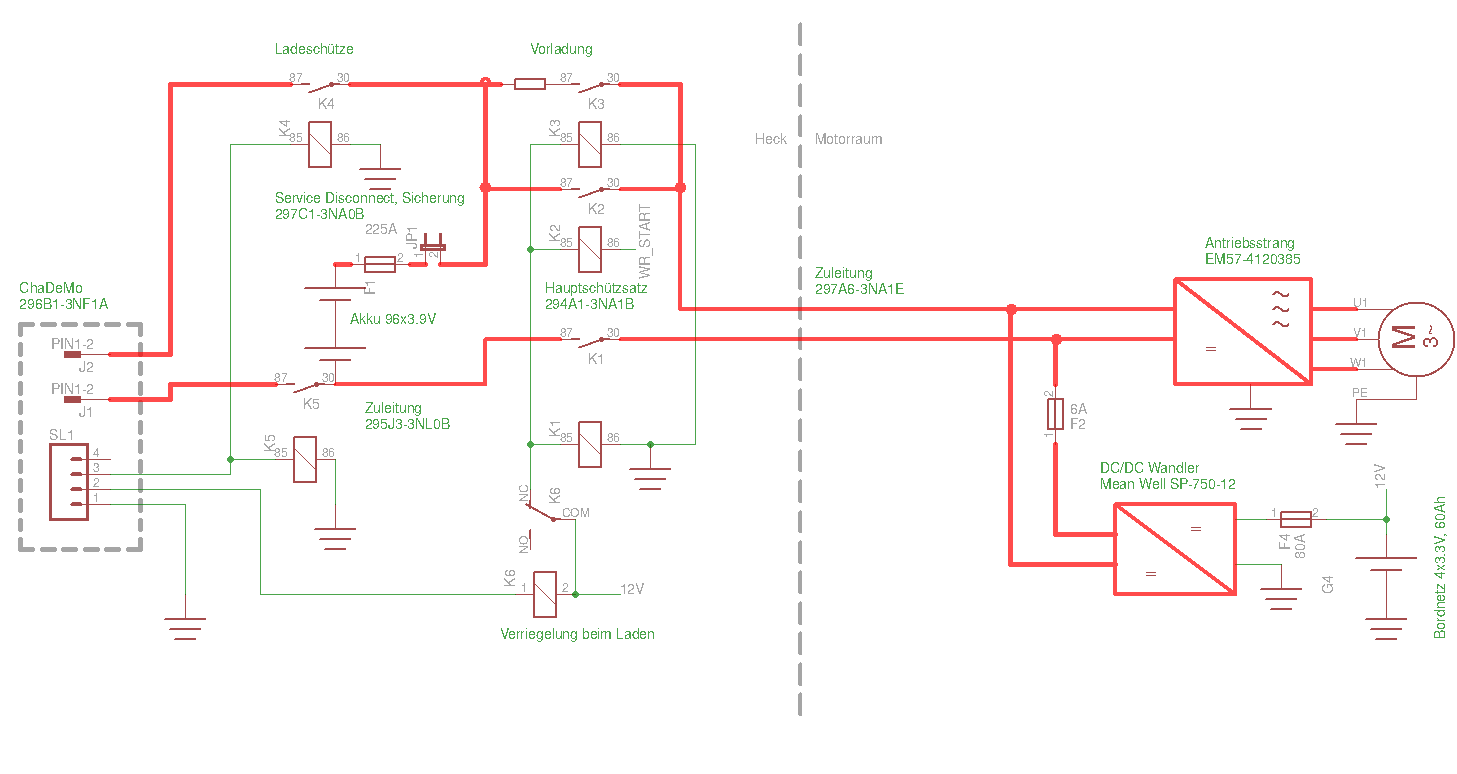

Hi, wiring diagrams are not my strong point. I cannot find much variety online and none in a easily editable format. Could anyone happy to do so please share your drawings in this thread? It would be useful for others too. Im keen to to see how you have your contractors wired up. Various devices such as the vacuum pump. Etc.

Not the most complete, but hey
Wiring diagram Touran
Wiring diagram Polo
Wiring diagram Polo
