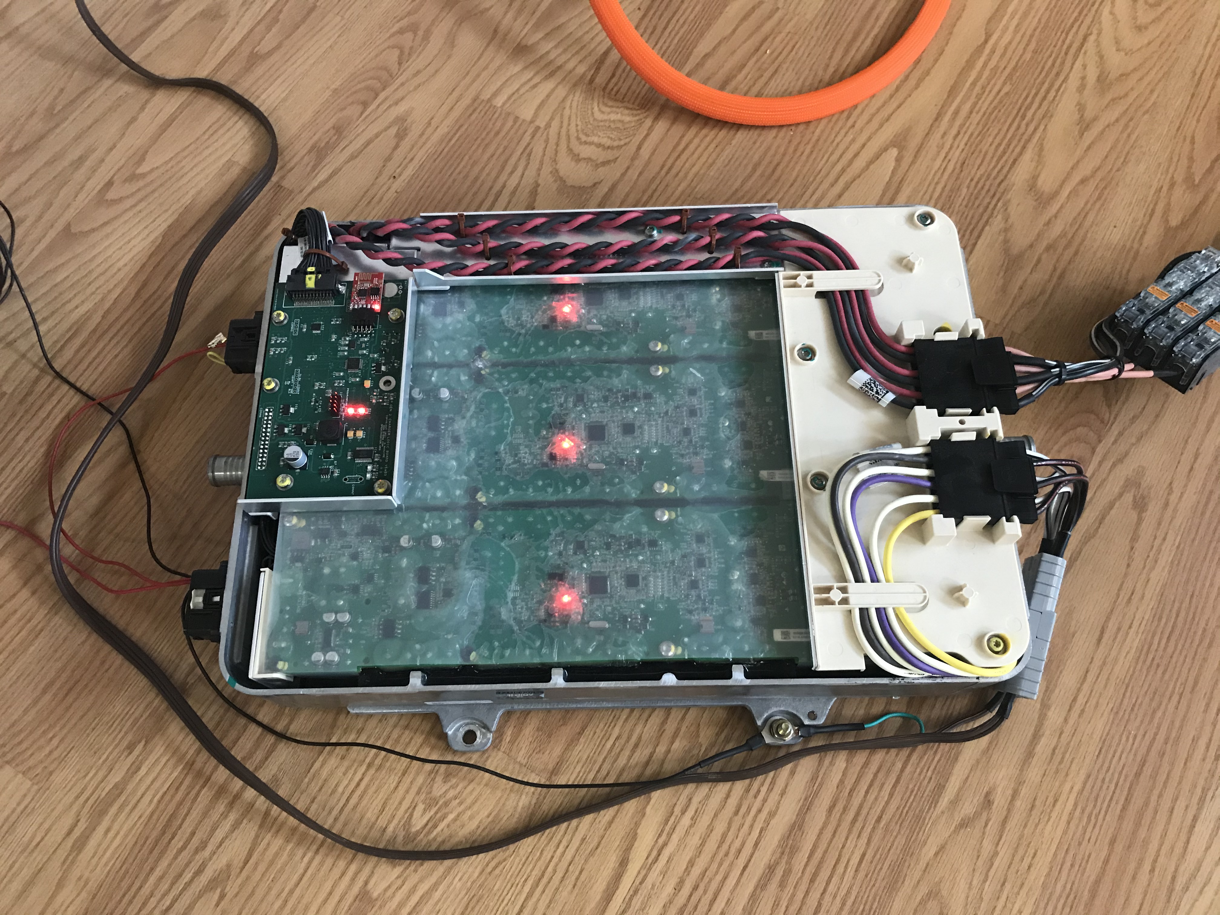

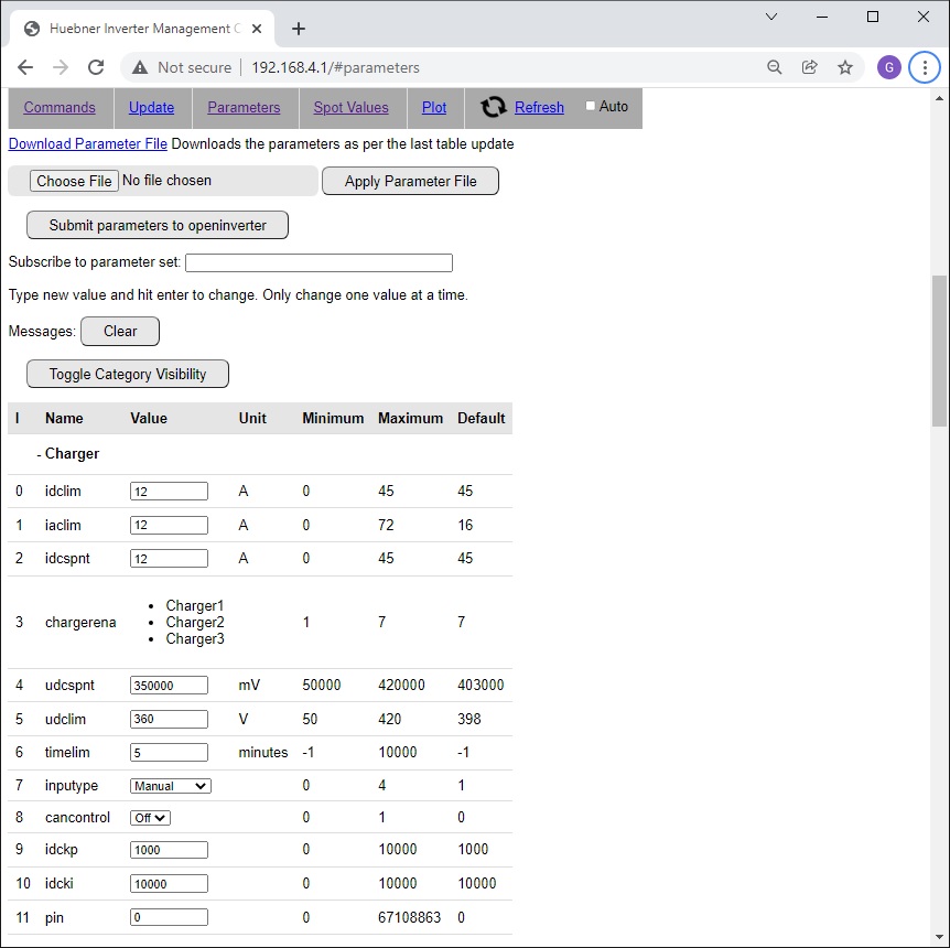

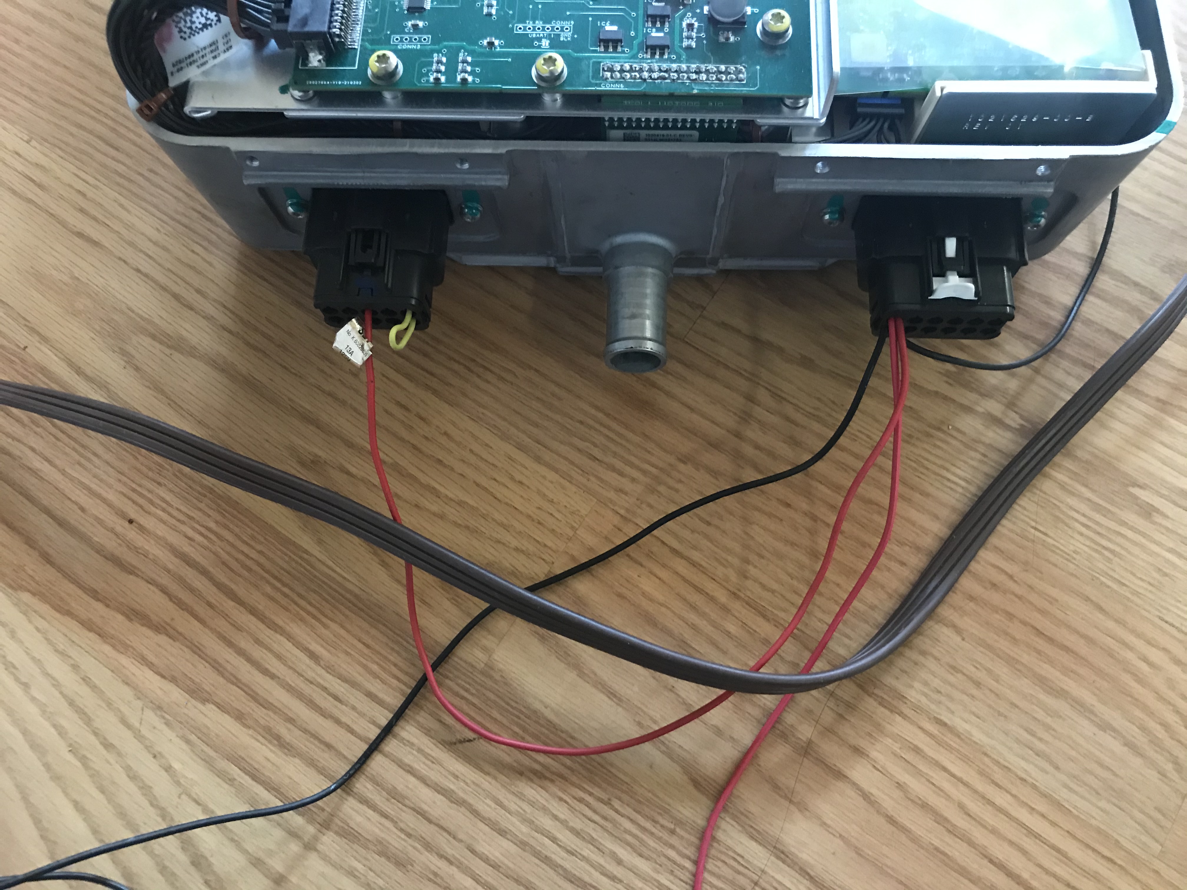

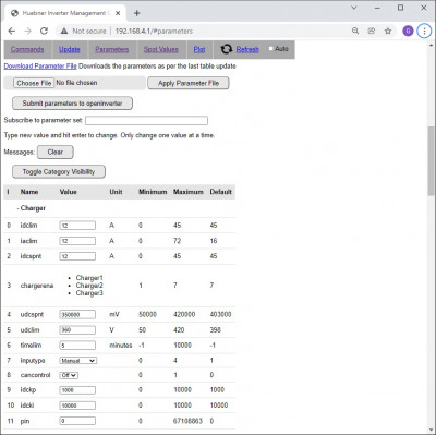

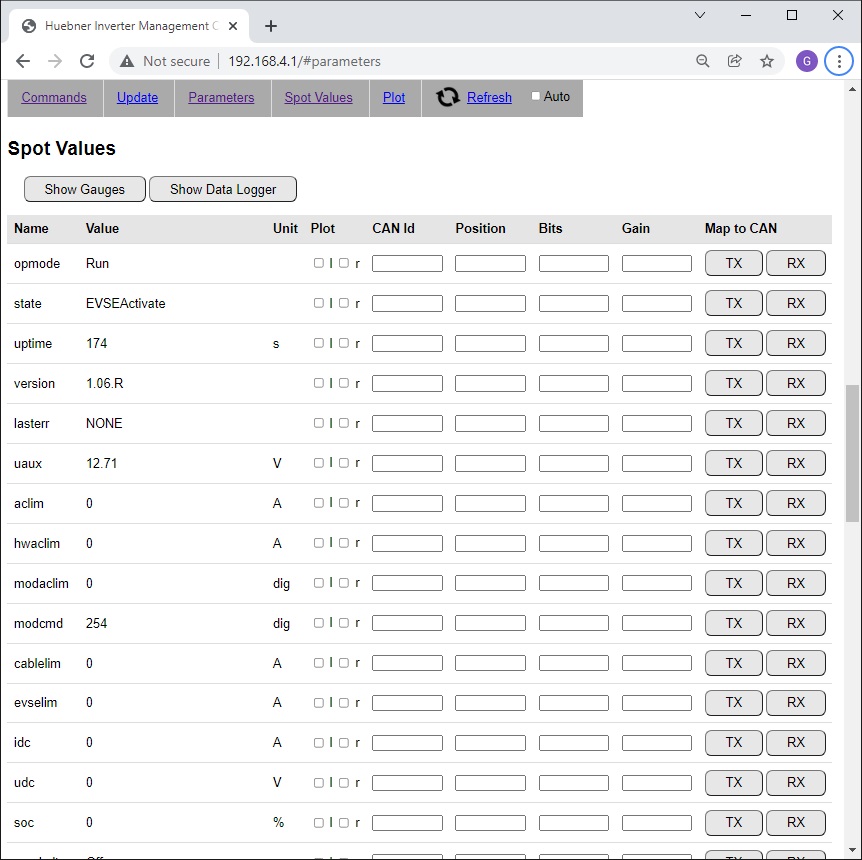

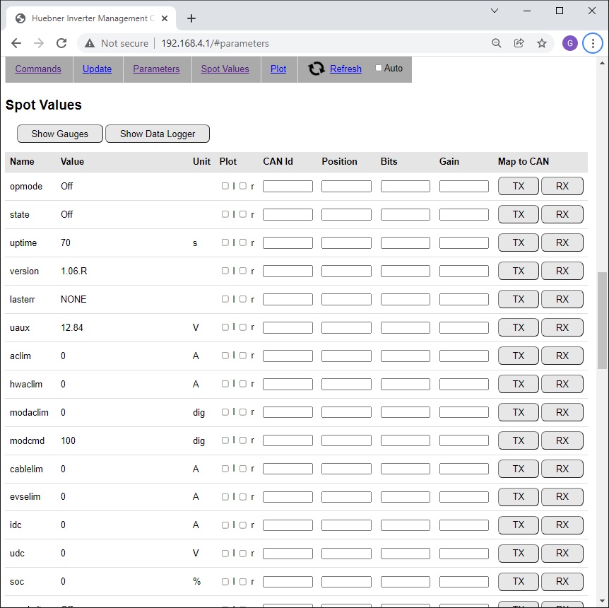

total newb here, looking for help, trying to charge my BMW 530e battery pack (current voltage of 346v ) with a Tesla Model S Gen 2 Charger (TPN: 1014963-00-K)
I believe I am all wired up for Manual (non J1772) charging on 120 volts, I can get all three power modules to power up (or at least light up the red LEDs)
I do not hear any contactor clicking coming from the charger and the state EVSEActivate I don't know what that means
Been thanked: 1918 times
Re: state EVSEActivate Tesla Gen 2 first charging attempt

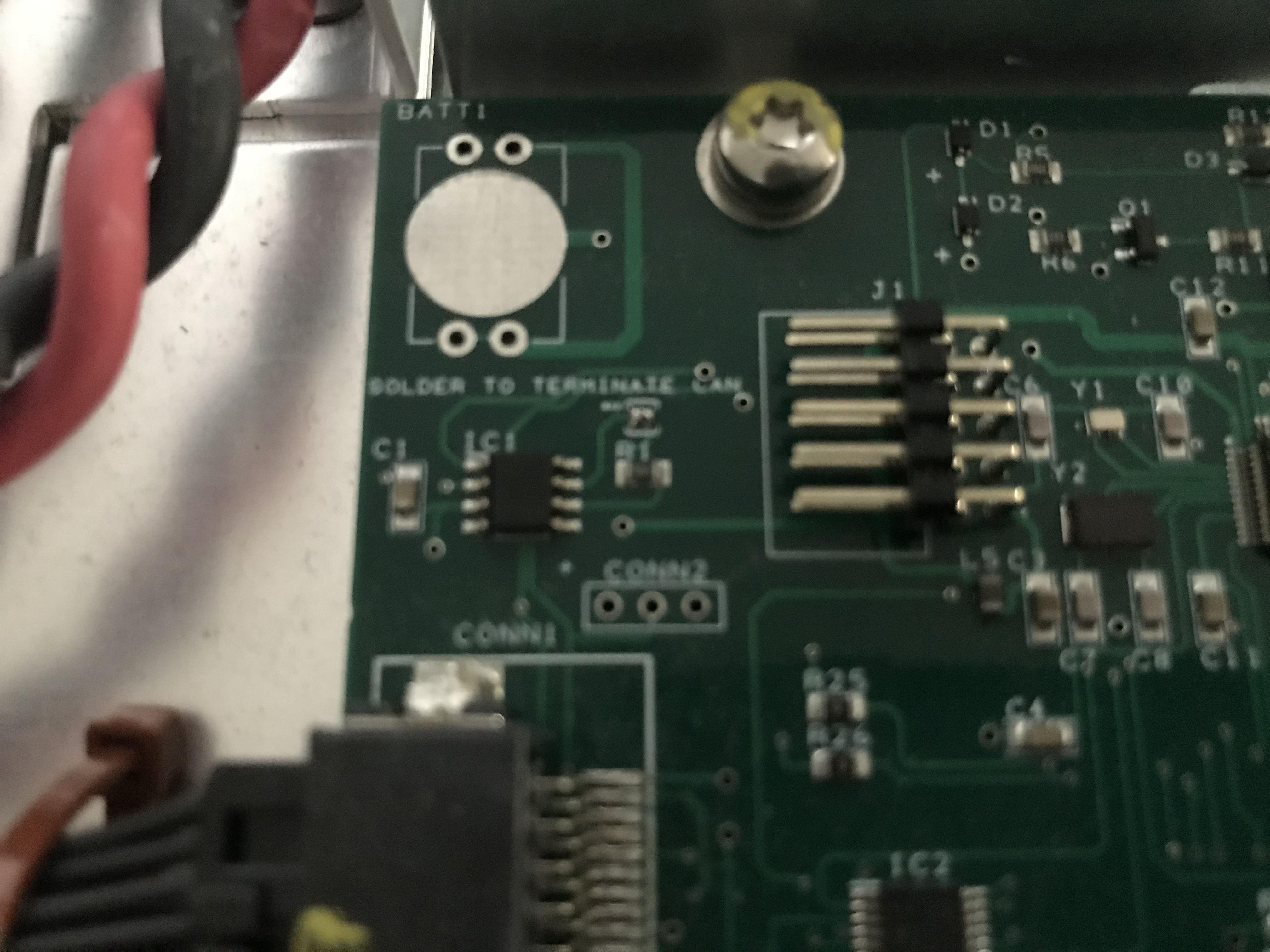

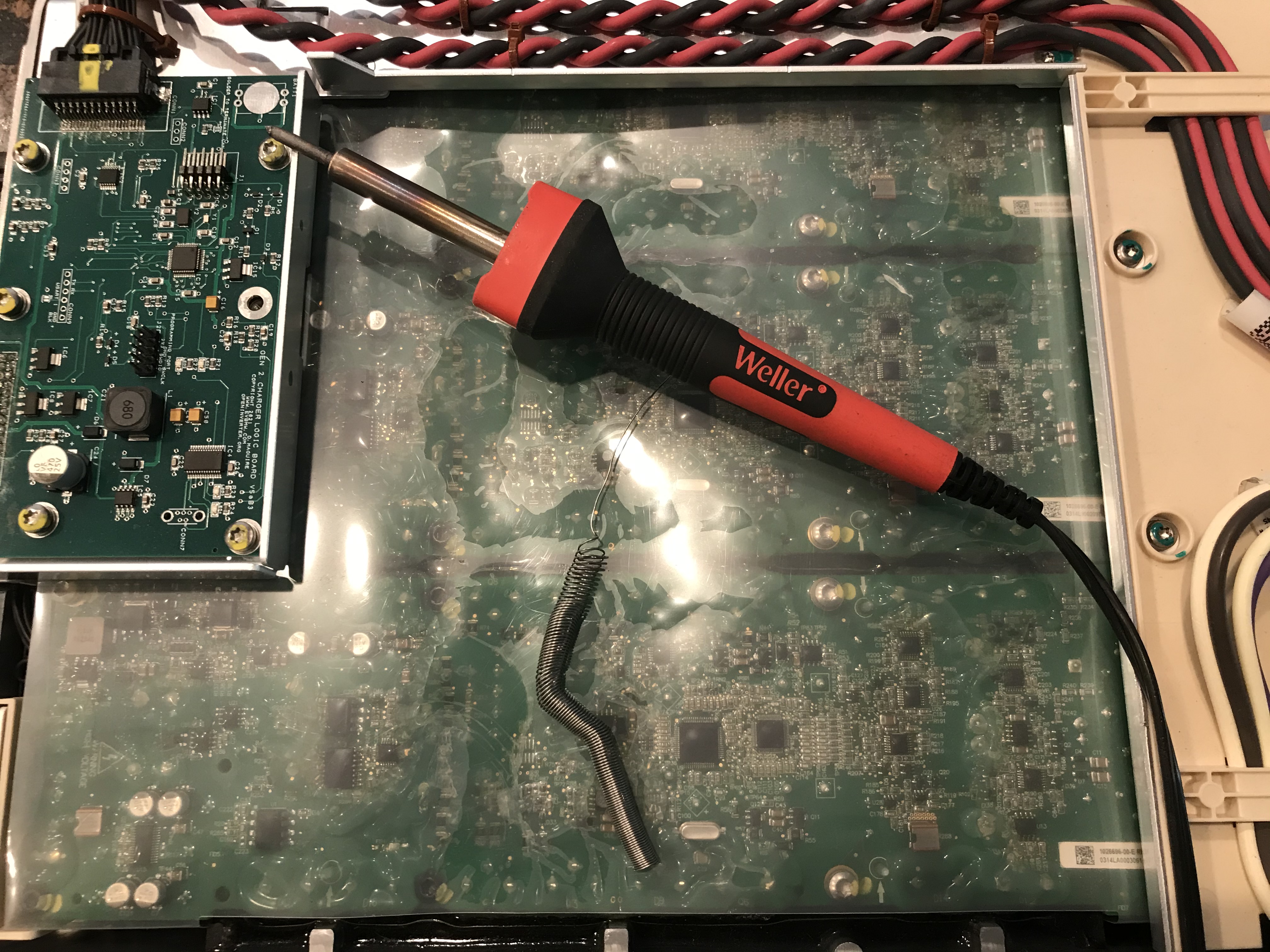

Many values are suspiciously 0, I'm thinking you need to close that solder jumper below the wifi module (CAN termination)

johu wrote: Sun Jan 09, 2022 10:01 amMany values are suspiciously 0, I'm thinking you need to close that solder jumper below the wifi module (CAN termination)
Talk to me Goose
yep, open. Close it :)

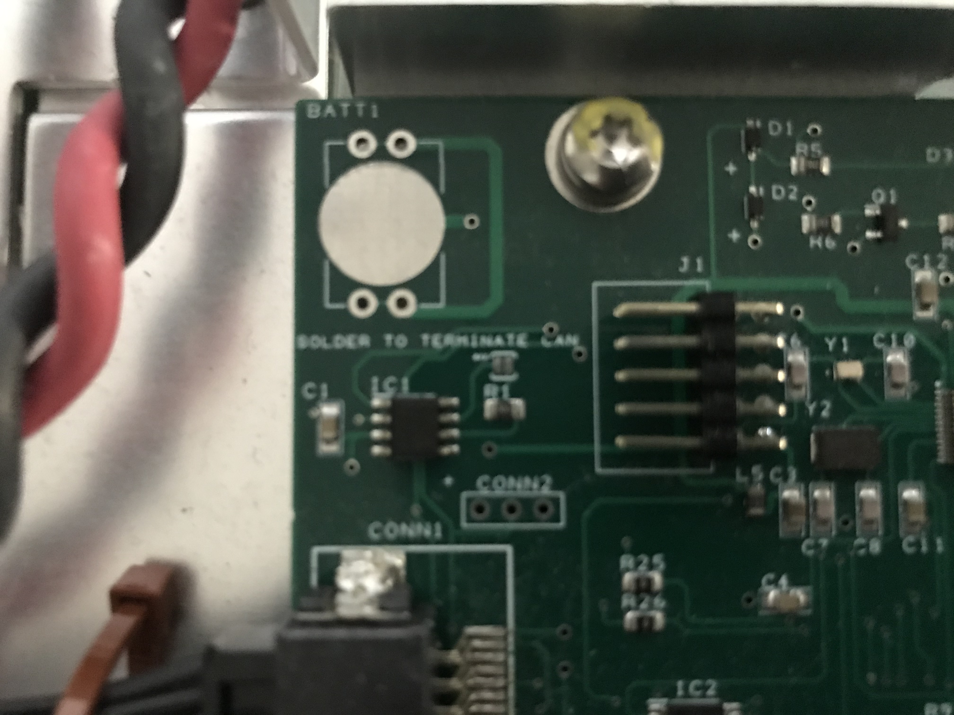

so....
Gregski
Posts: 3170
Has thanked: 635 times
Been thanked: 1610 times
Post by Gregski »
johu wrote: Sun Jan 09, 2022 10:01 am Many values are suspiciously 0, I'm thinking you need to close that solder jumper below the wifi module (CAN termination)
and a few moments later
click
Click
CLICK
I luv you bro, that was it, it's working now, I am soooo happy
Great!
We need to FAQ this, it happens so often. Wait. argh! https://openinverter.org/wiki/Tesla_Mod ... al_CAN_bus
