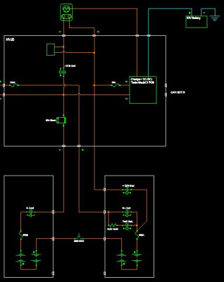

Electrical:

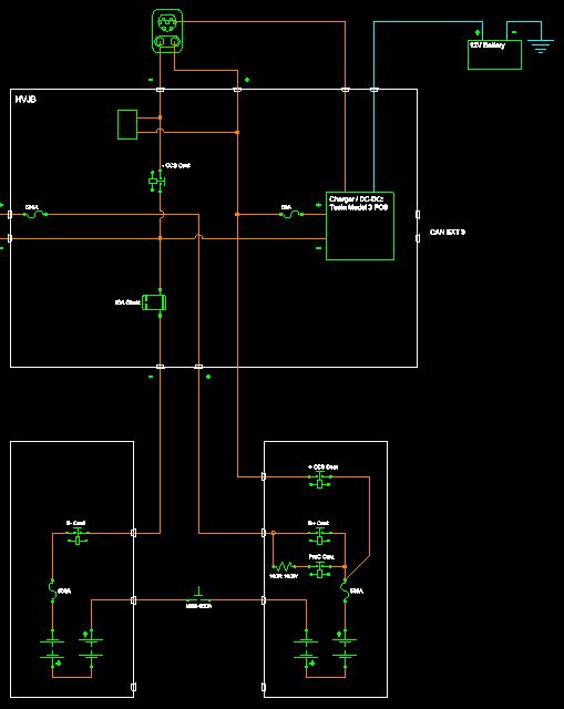

The list of components and interlinked systems adds up quickly, so have been laying out a general schematic to help me get my head around what needs to happen! These are still work in process and I will continue adding more detail such as the low voltage system.
Lots of various discussions on the forum around the right way to set things out but depends on what the project will allow. Here, the two battery boxes are tucked underneath with a 3m to 4m run of HV cables to the HVJB in the front. I'm considering separate fuses and contactors in each of the battery boxes, but in order to keep good access to the ISA shunt and CAN buses etc, it looks like the neatest way is to double up the positive and negative contactors in the HVJB. This means seven contactors including the charging contactors though, so maybe some overkill I can simplify.
I also need to figure out the interaction between some of the controllers. Both the LIM and PCS controller expect CP and PP signals but these can't be used by two controllers. Some work to do here.
Open to any comments or suggestions to correct errors, or simplify things, or address any safety requirements!?
Electrical schematic WIP:
Schematic with cooling/heating system hidden:

I'd at least drop the negative relay in the HVJB, more likely I'd drop all 3 battery relays there and move precharge to box 2 next to the B+ relay. That way the long run back to front is unpowered with the vehicle off and so is the HVJB.
Or maybe I haven't understood why you want to double up the relays

Thanks for your reply Johu.
Ideally I don't want to double up relays so your suggestion would be much tidier. I do want the HVJB and cable runs from battery to be unpowered when car is off, but was thinking I needed the ISA shunt the battery side of the main contactors. I want the shunt in the HVJB for accessibility for now at least, so that is where the second set of contactors came from.
Thinking about it more, the ISA shouldn't need to be battery side so your suggestion makes good sense.

Yes, I'd be surprised if there was current flow across the ISA shunt while the battery box relays are off

I’d put positive contactor/precharge and positive ccs contactor in the battery box. delete negative contactor in the HVJB, and run pcs threw the positive ccs contactor.
this way your not running pcs or ccs through pre charge at any point accidentally. And you cut back on contactors and the HVJB size

Thanks for the suggestions Bratitude. I'm going to rejig the layout tomorrow and see how it looks. I've left myself tight on space in the battery boxes, but with the space in the engine bay I have a good size electrical/HVJB I can make use of so might have to come to a bit of a compromise with the CCS contactor location.Bratitude wrote: ↑Sun Jan 16, 2022 4:19 am I’d put positive contactor/precharge and positive ccs contactor in the battery box. delete negative contactor in the HVJB, and run pcs threw the positive ccs contactor.
Not just sure what you mean re the CCS positive and the PCS. I tried laying it out as it is in the TM3 battery pack. If I understand what you're saying, you'd run the PCS positive cable through the CCS positive, so the CCS positive would have to come on for drive and charging?

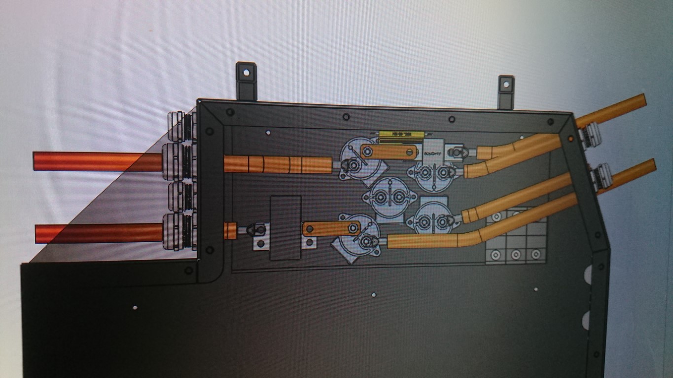

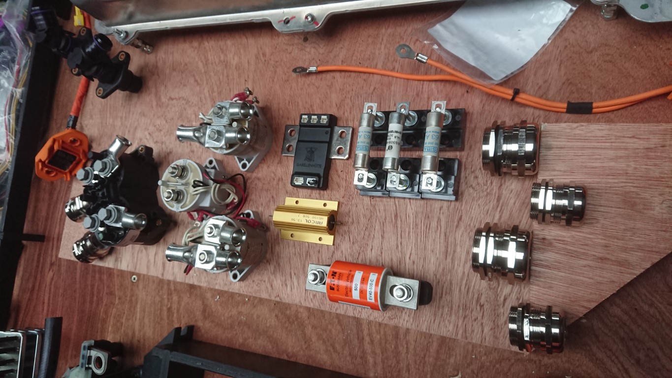

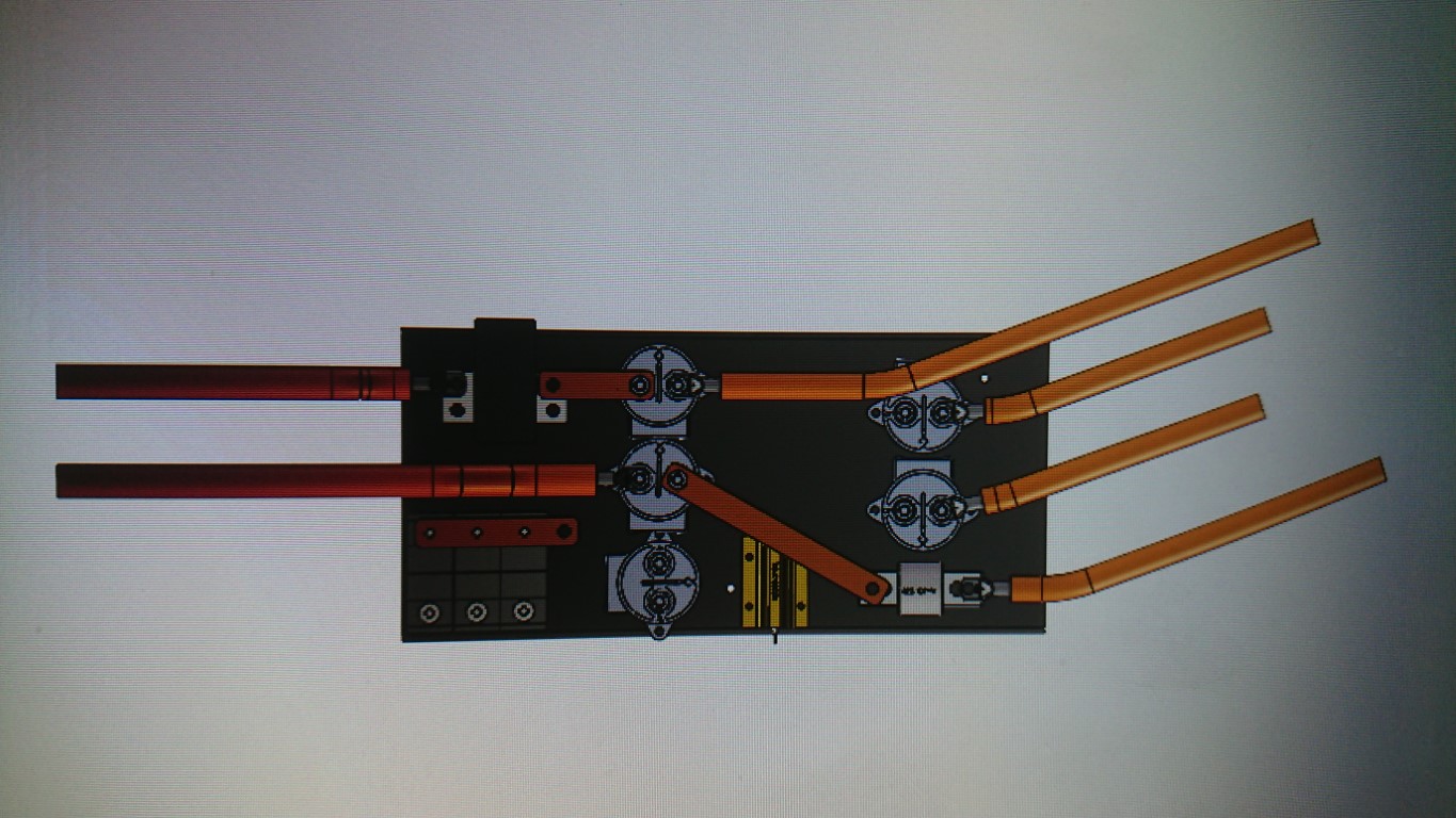

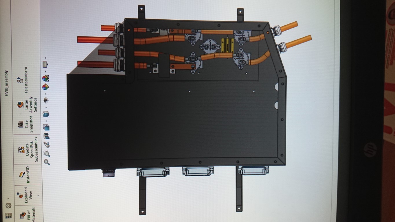

HVJB / Electric:
Maybe a little prematurely (some layout mods being discussed in previous posts ), but I've been looking at a neat way to house the TM3 PCS, the VCU and controllers, and contactors etc in the engine bay. With no batteries being mounted in the engine bay, this leaves a lot of space above the motor. I have a rough idea where things like the steering pump and brake vacuum pump and accumulator are going so time to get things mounted.
Originally I had planned for the battery and precharge contactors, as well as the CCS charge contactors to be housed here, but after some suggestions on better layout, I'll see what I can move to the battery boxes and this will free up space for the BMS possibly. The VCU, PCS controller and LIM will mount on the outside edge of the enclosure near to the RRV engine electrical box
Played around with a number of layouts. Plan is for the CCS combo charge port to mount at the front, somewhere behind the front grill. Was a tight fit where the original fuel filler would have been, and makes it tidier to have everything close in the engine bay anyway

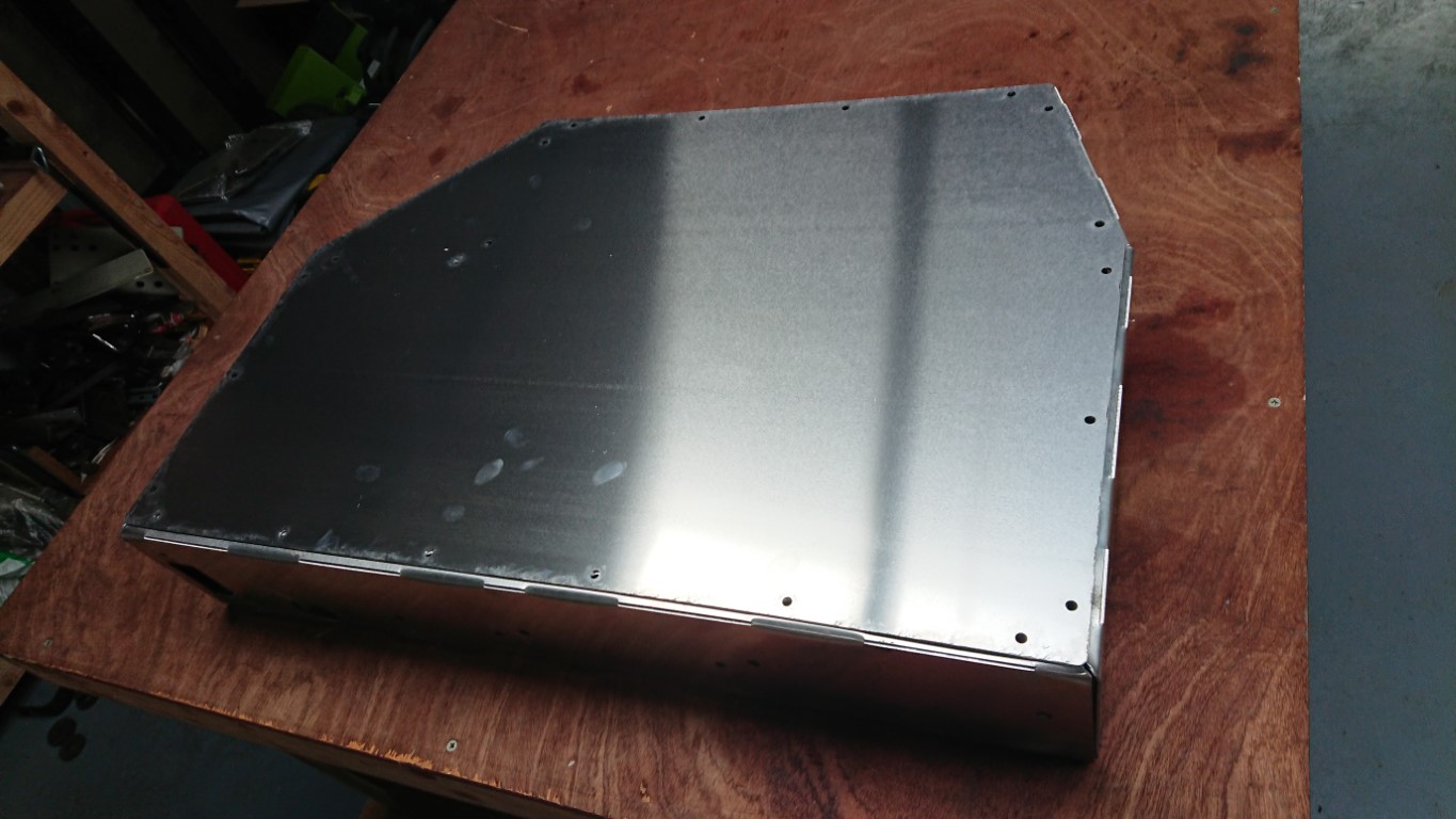

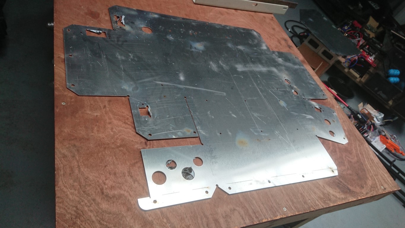

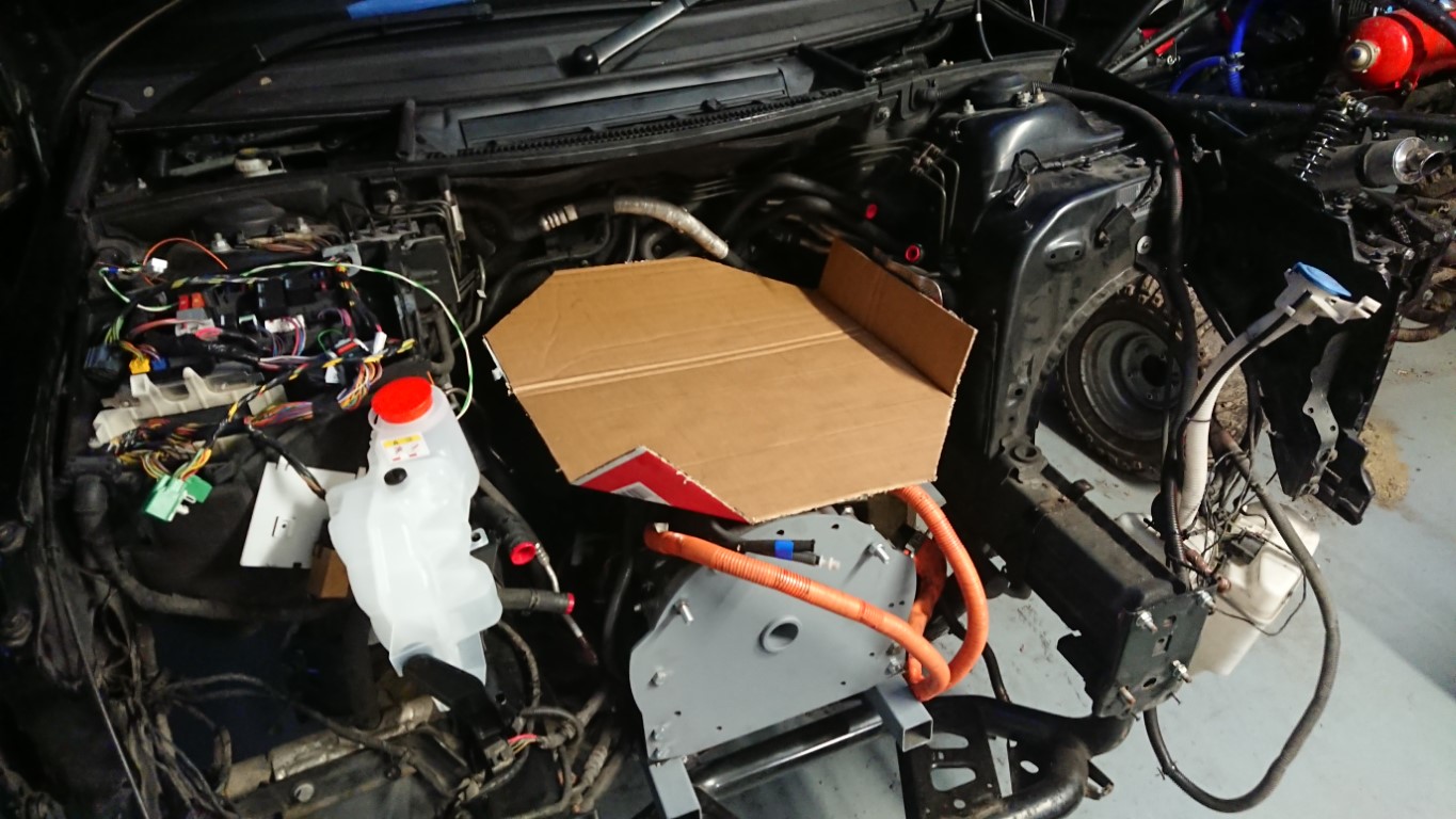

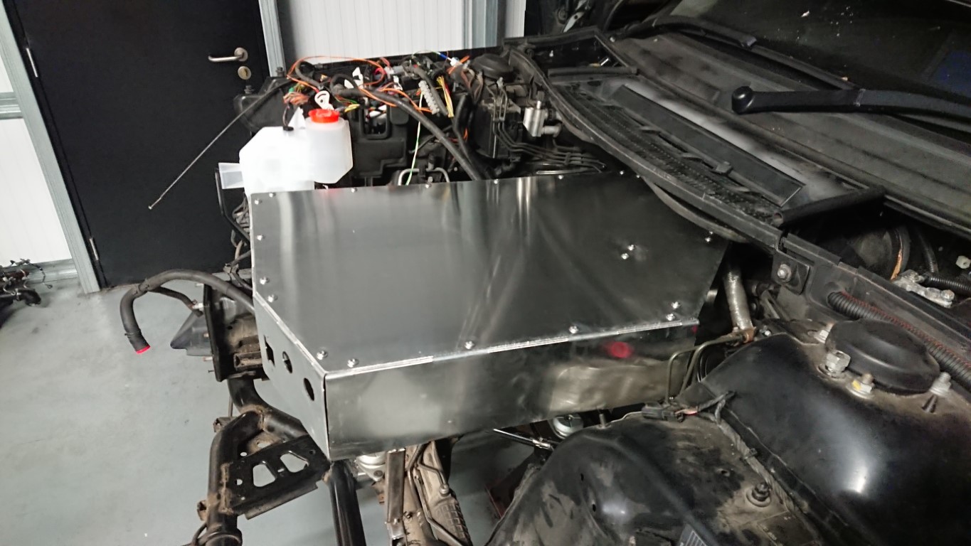

- Posts: 512
- Has thanked: 287 times
- Been thanked: 67 times
Re: L322 RR Vogue - The beached whale
HVJB / Electric:

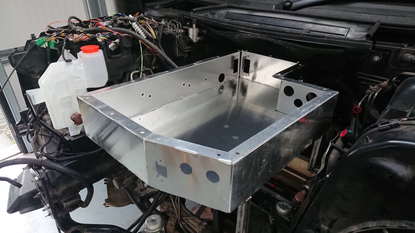

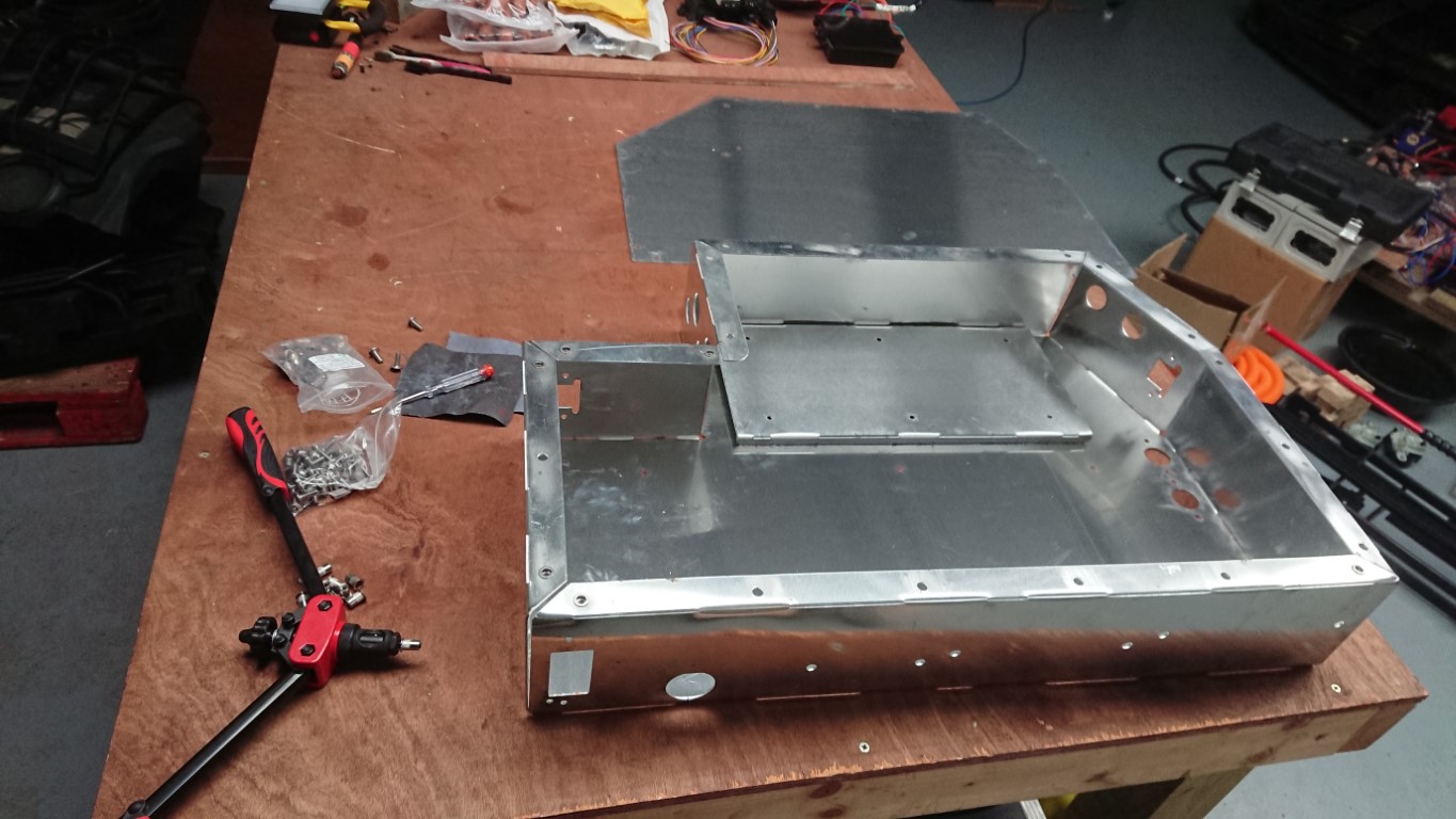

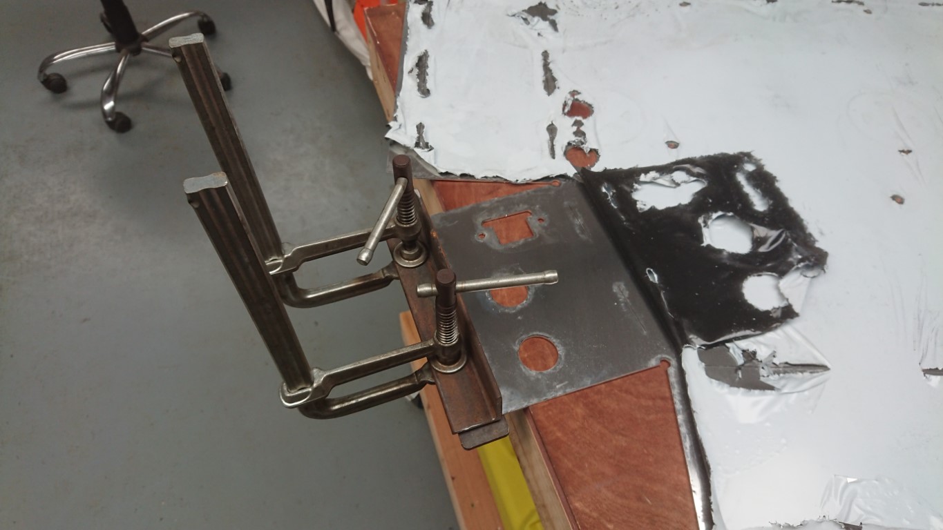

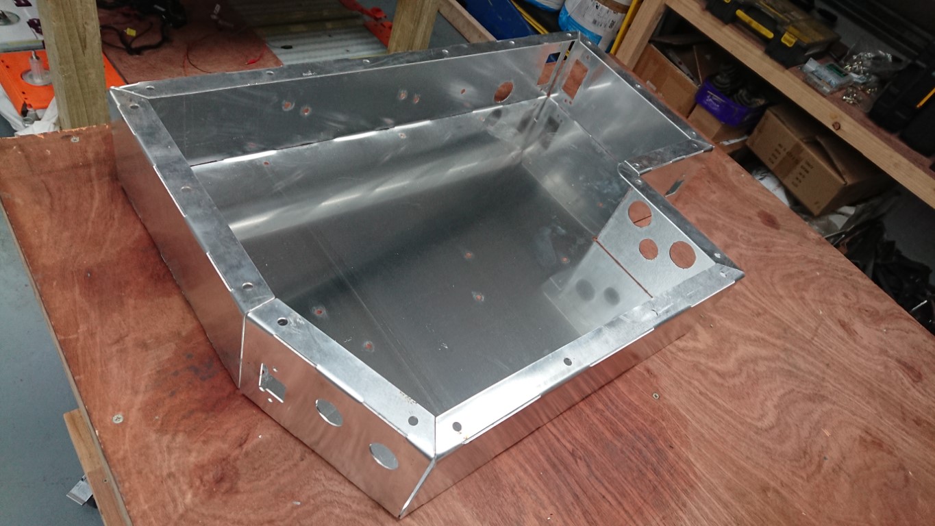

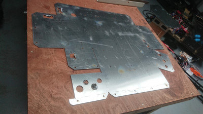

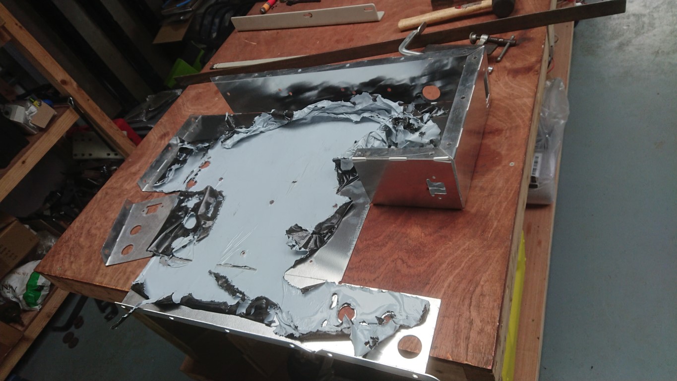

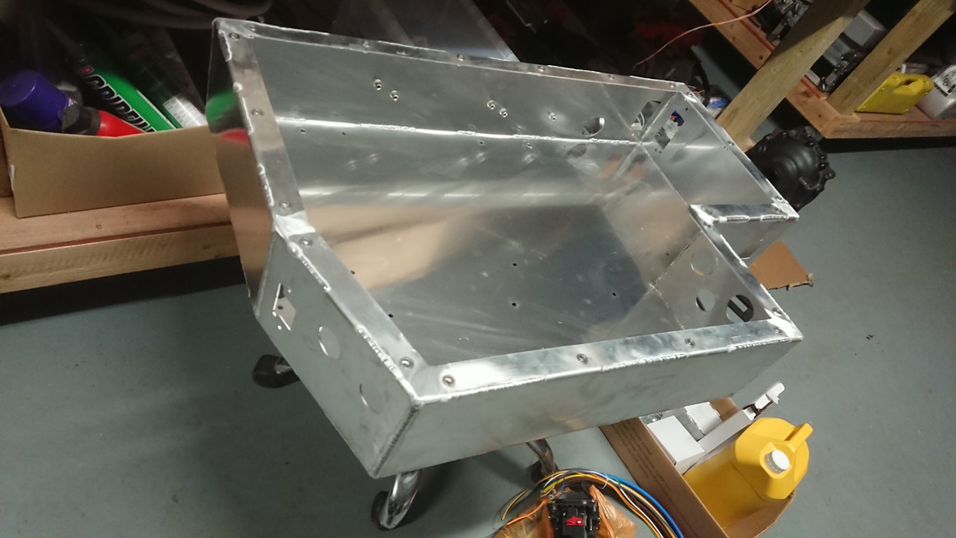

Drew up an enclosure to be laser cut in aluminium. I didn't have a way to fold properly, so I stitched the fold lines to allow it to be folded by hand and these would have to be welded later on. Was looking for a clean design (to bug anyone looking for the V8 later on ) but wanted to steer away from just rectangular. This added complexity to the flat pattern and folding etc, but as its one piece and hand folded it worked out. I have a single aluminium lid for now but could consider smoked perspex later, depending on what might be worth seeing inside
Some test fitting. HV battery cables through the rear as well as the feed out to the inverter. CCS charging HV cables in through the front. Reusing the TM3 connectors for 12V, auxiliary, AC charging, cooling, etc so essentially remaking a Tesla Model 3 penthouse!
Electrical components will mount on a removable backplate. M6 rivnuts used to give threaded mounts for the lid and controllers. Not good for the IP rating but thinking about what to do for that
Welded up
Welded up

oh no sorry I mean the pcs positive would share the same contactor as the positive end of ccs. (Which is in parallel with the main positive/pre charge - connected to the battery)
Pcs negative would be on the main Negative contactor
Ccs has its own negative contactor.
Just cuts down on contactors, that’s all

Electrical:
A revised electrical layout following some comments by Johu and Bratitude. Modified to show how the PCS will be inside the enclosure and moving some contactors to the battery boxes. Tight on space in the battery boxes but should fit this much
Am I correct that pre-charge is needed at the start of charging in the same way it is for powering up the inverter? Is this for the batteries or because the inverter see's HV during charging in this sort of setup (just the inverter has no 12V/run signal)? Is this acceptable?
Bratitude, you mention separating PCS and CCS from the pre-charge, but I'm still not 100% sure how you mean and I thought I needed to have the pre-charge when charging also. Showing a rough layout of my understanding below but think you mean PCS + to the other side of the + CCS contactor but then I'm seeing extra HV cables between HVJB and Battery box or live CCS + charge port pins during normal running? Know I haven't picked up what you're describing correctly
Revised Electrical layout:
That is a great idea - i'll be borrowing in the future!!nkiernan wrote: ↑Sun Jan 16, 2022 8:18 pm HVJB / Electric:
Welded up
Who did you use to laser cut?

A company called Four Dee NI (www.4d-ni.co.uk). Have been really helpful for small one off orders for this project and a few others

I like the circuit diagram a lot, I'm just wondering about the position of the main fuse. I would install it in the line to the battery, then the CCS port is also fused. And there is no need to connect the CP and PP signal to the PCS control. Both signals can be handled by the LIM and are available in the CAN bus.

There is no need for recharging the pcs.
precharge is only for the drive inverter to protect the drive inverter igbt’s from inrush currents and voltage spikes. It just slowly charges the capacitors up, instead of instantly.
the reason to not have other HV components connected to your main/precharge path is if the pcs or anything else were to draw power during precharge, you’ll most likely blow up the precharge resistor.

I do not think so. In any case, the capacitors must be charged slowly in order to protect the contactors. It is also no problem to connect all HV components firmly to one another and to supply them with power both when charging and when driving. Of course, you can only demand performance when the main contactor is closed. So only enable DC/DC converter, A/C compressor, heater, motor, charger etc. after the main contactor is closed.Bratitude wrote: ↑Tue Jan 18, 2022 5:07 pmThere is no need for recharging the pcs.

Agreed, usually any HV equipment has capacity inside that you want to precharge.
The PCS can precharge itself and other components on the DC bus by transferring power from the 12V battery to the HV side. Makes the precharge resistor redundant. Not that it is supported in the recent firmware...

Thank you for the comments Muehlpower, Bratitude and Johu, that helps me a lot. I've moved the main inverter fuse and deleted the CP/PP line to the PCS controller. Yes, I'm assuming the PCS controller is not controlling the PCS pre-charge function for now but this may be a neat revision in a future firmware update. Like others, I still need to get the PCS properly functioning. The final piece of the puzzle to settle on now is the BMSmuehlpower wrote: ↑Tue Jan 18, 2022 4:31 pm I like the circuit diagram a lot, I'm just wondering about the position of the main fuse. I would install it in the line to the battery, then the CCS port is also fused. And there is no need to connect the CP and PP signal to the PCS control. Both signals can be handled by the LIM and are available in the CAN bus.

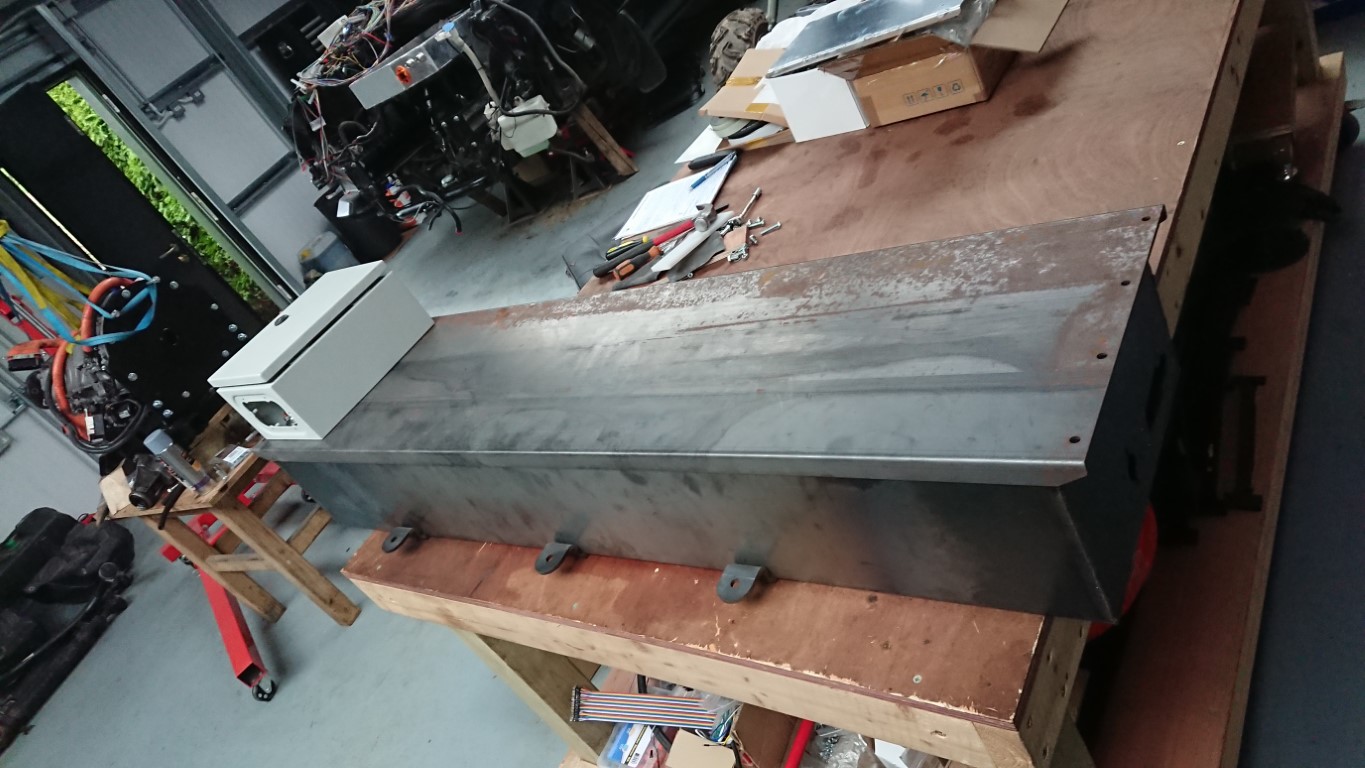

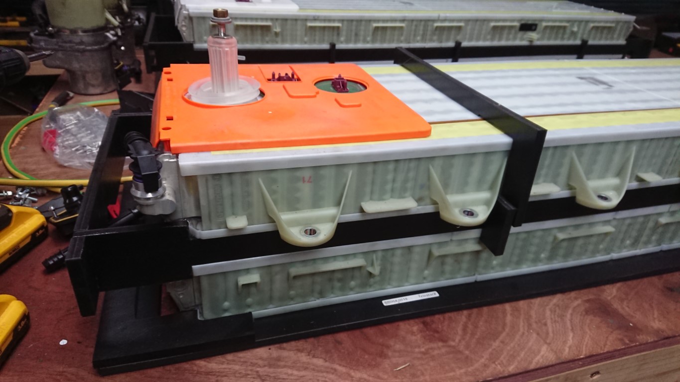

- Posts: 512

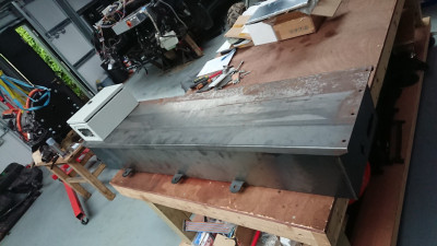

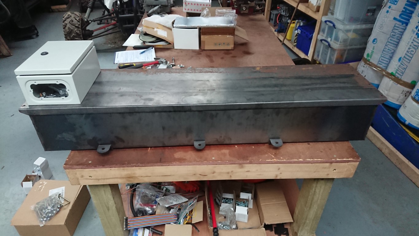

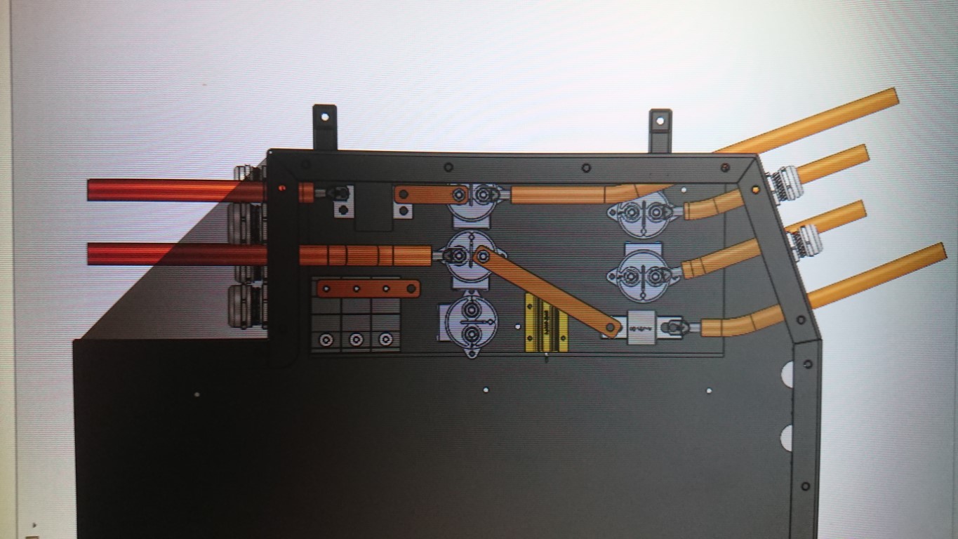

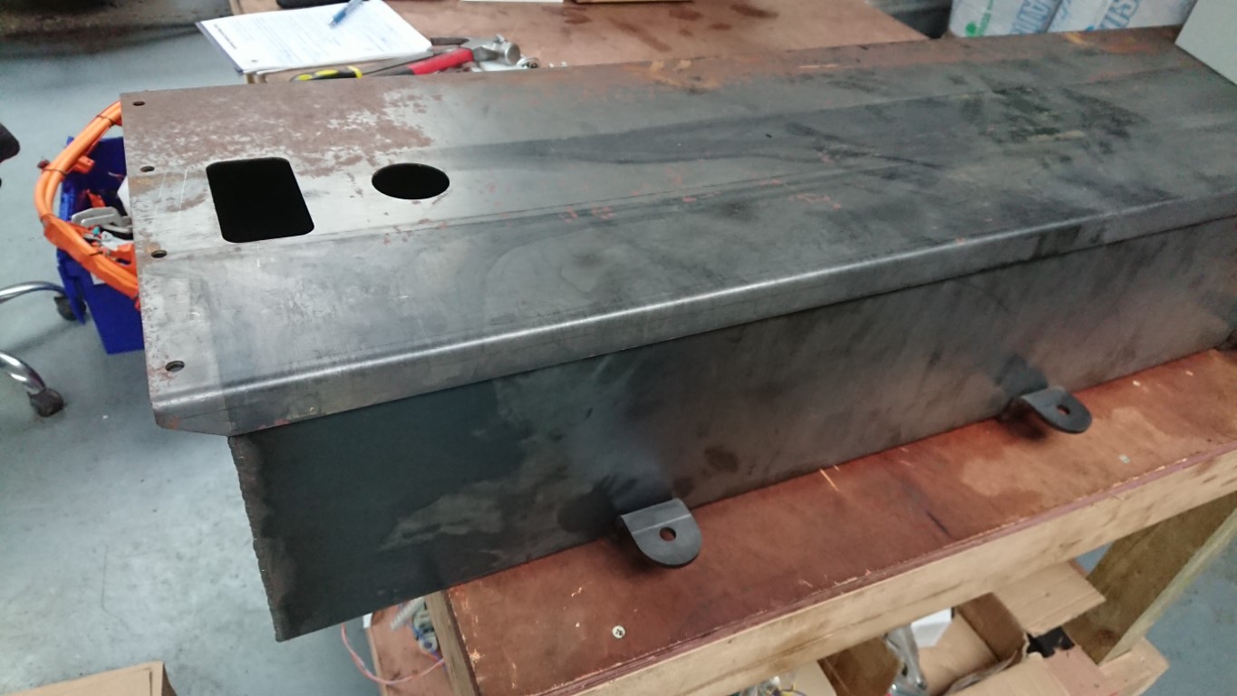

Battery Boxes:
The battery boxes are designed to accommodate the stubs for the battery module terminal connections as the space available for the batteries meant the overall length was restricted. This will allow me to work with the contactors etc on top of the battery boxes and this fits in the space where the fuel tank would have been
The idea was to let the stubs protrude up through the lid of the battery boxes, along with the mid pack terminal connection point and possibly the BMS harness
Looks like a standard enclosure could work well for this, and provides a back-plate for the contactors and fuses and leaves an easily serviceable access point rather than having to remove the battery box lid if needed

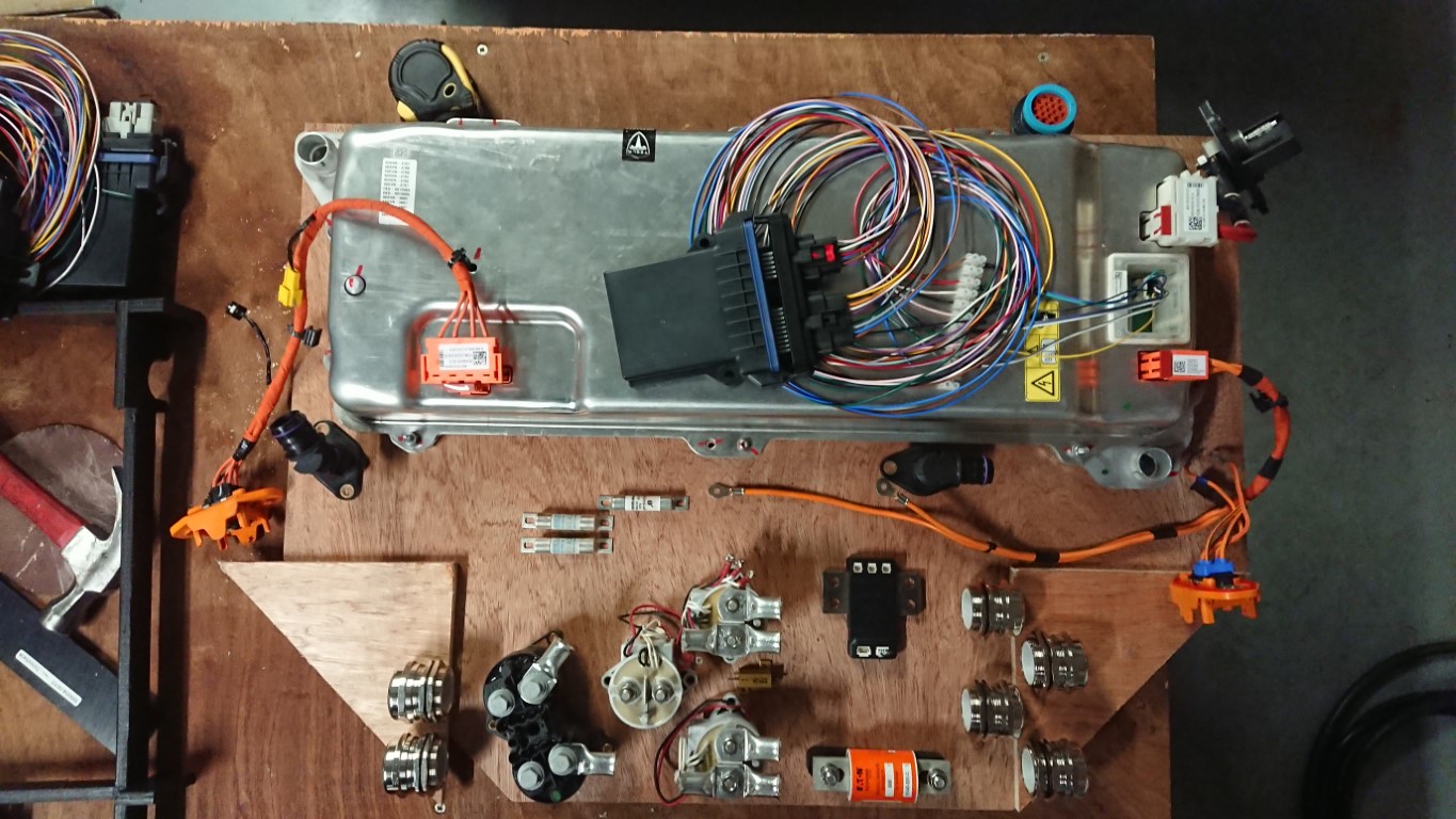

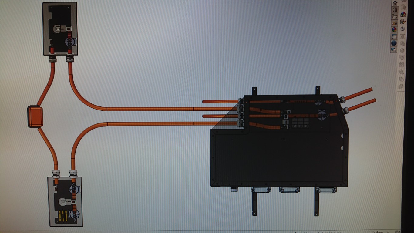

Trying out a few component layouts between the HVJB and the battery box junction boxes to find the simplest layout

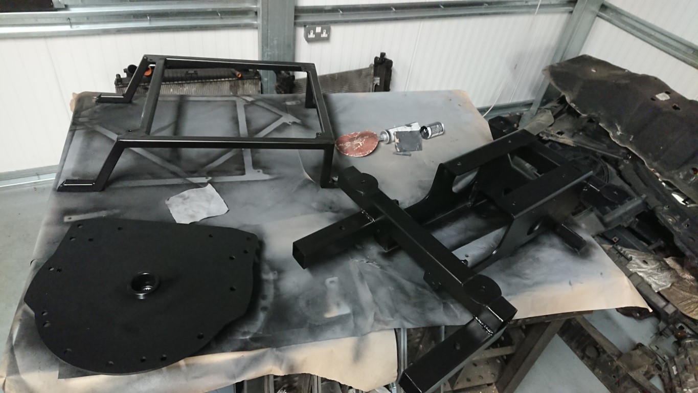

Mechanical:

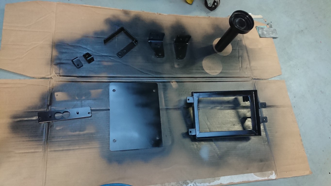

Must be getting confident there won't be any more chopping and changing, the paint cans are out!

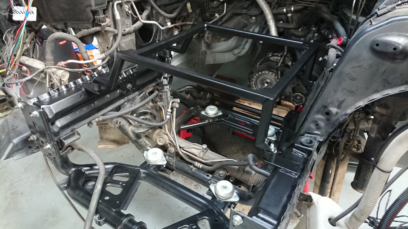

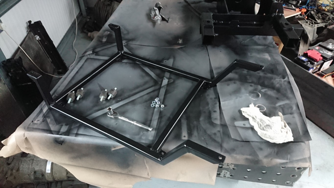

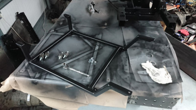

Parts for mounting the inverter and front axle tube
Anti-vibration mounts for the HVJB frame

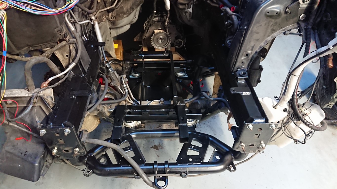

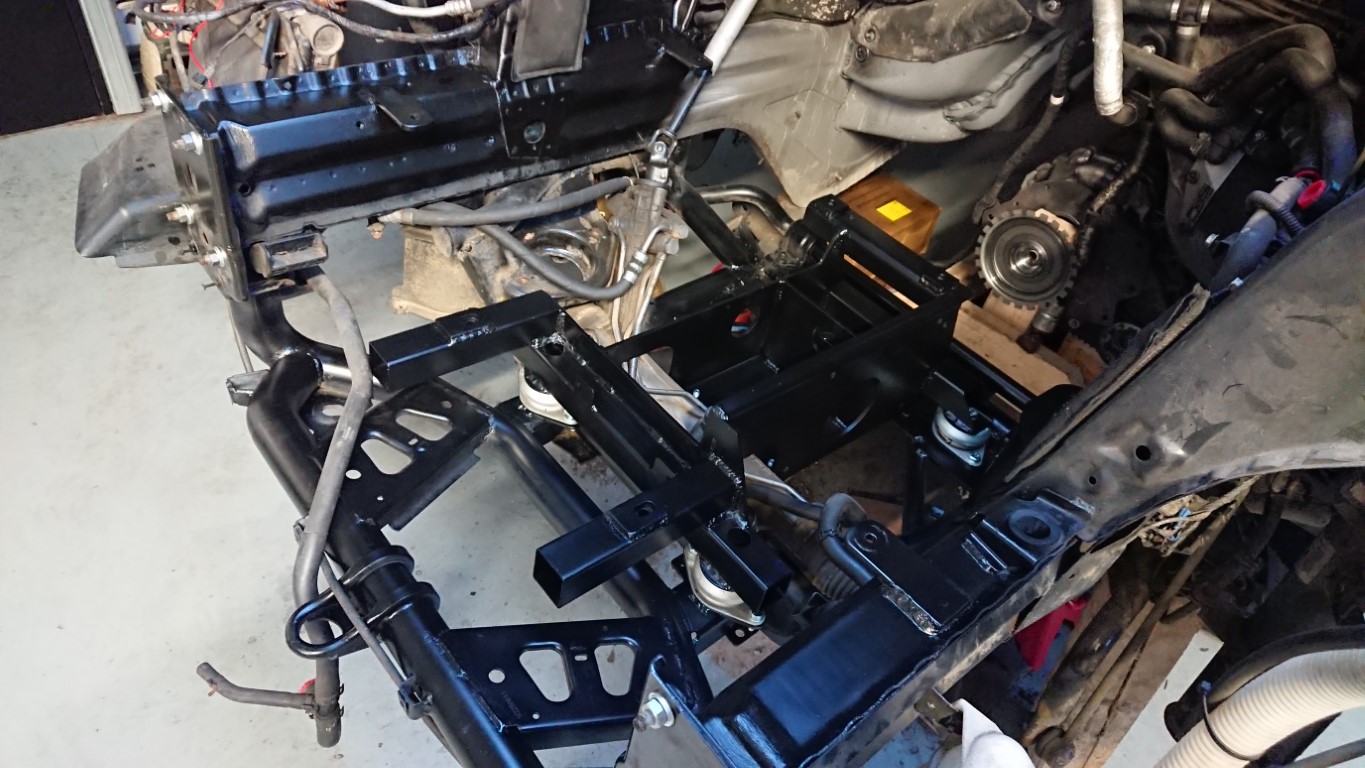

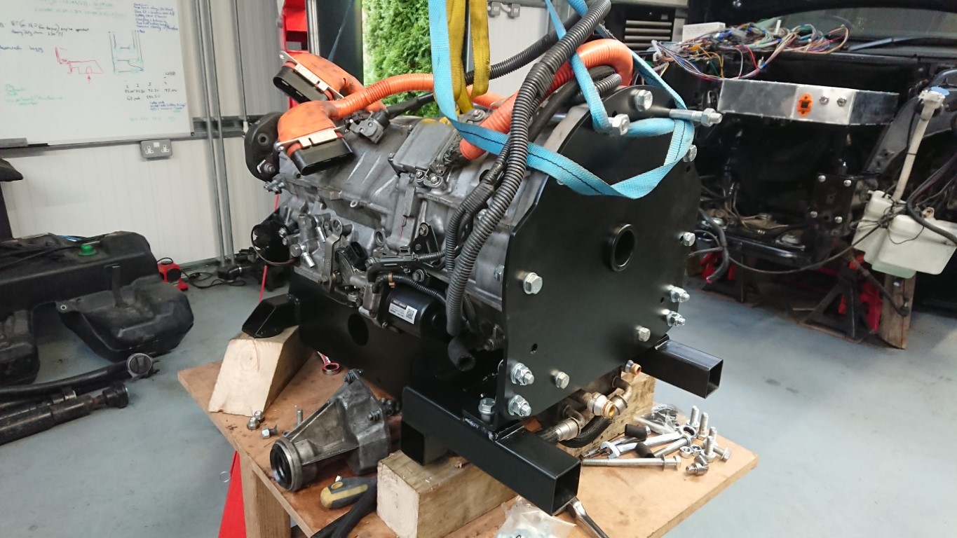

Final test fit for the transmission and differential mounting frame to locate the anti-vibration mounts for the transmission
Test fit for the HVJB frame before building up the HVJB

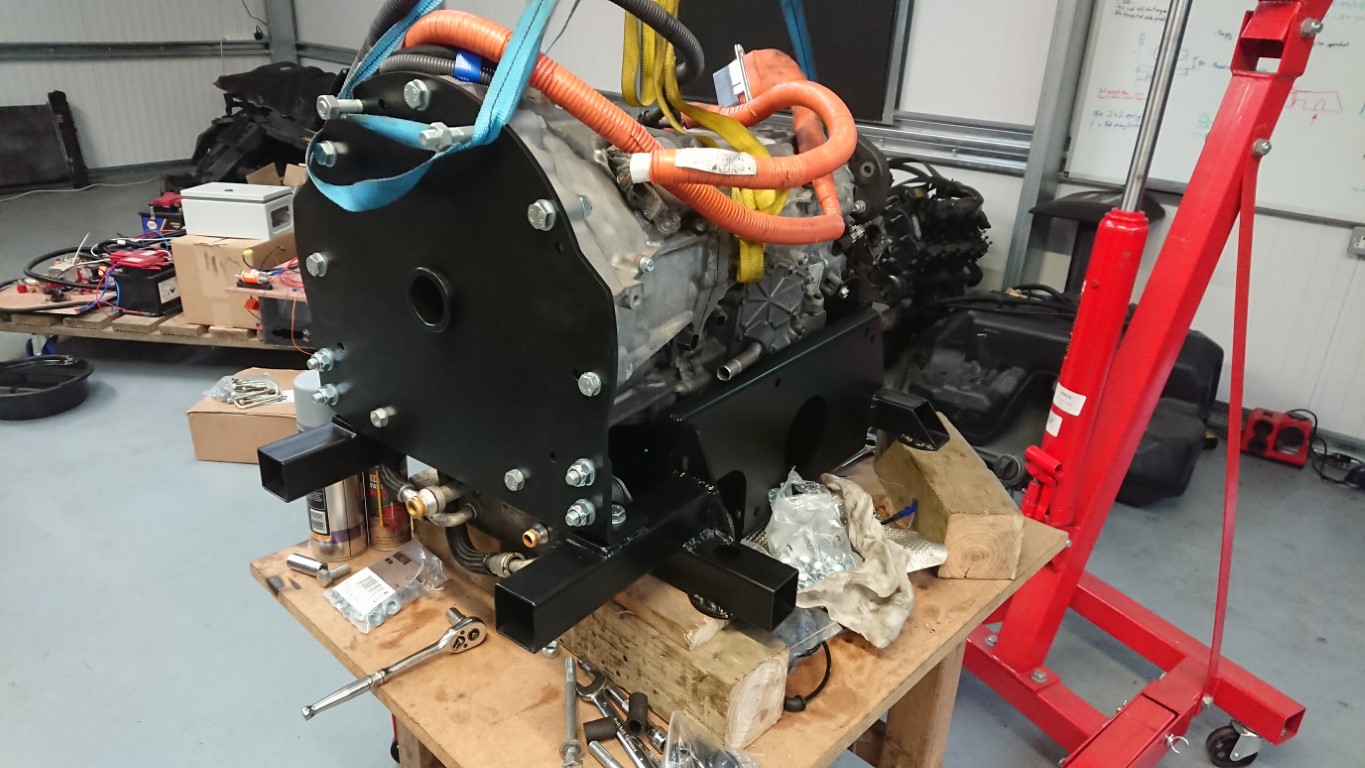

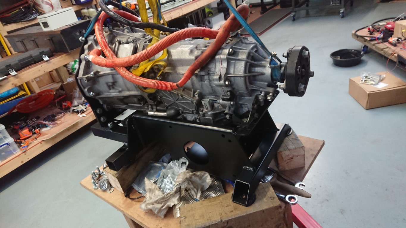

Transmission frame assembly which needs the front differential and axle supports mounted next
