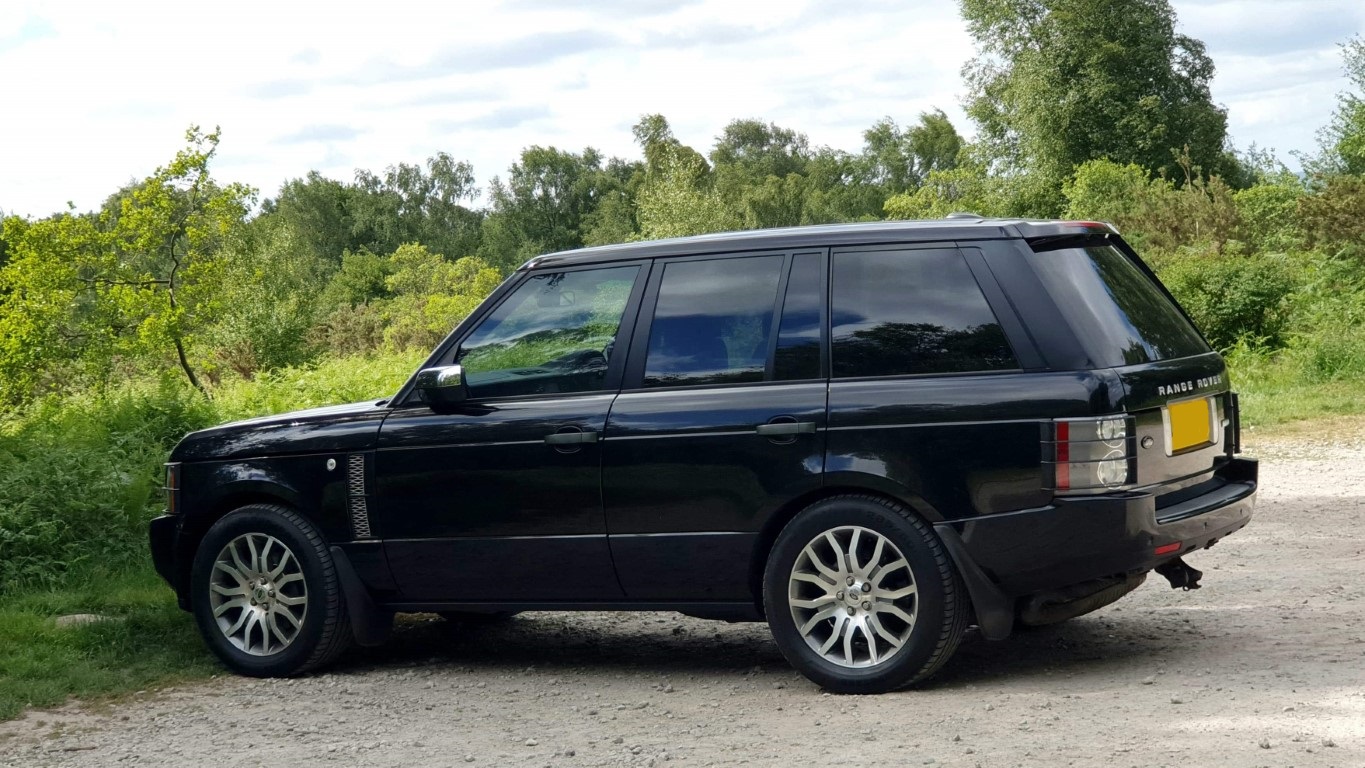

In February 2021 I found a 2008 Range Rover Vogue 3.6 TdV8 with some serious engine issues and due to the cost of repairs, it was destined for the breakers. This could be perfect, mechanically in great condition (once you didn't try start it :oops: ), ridiculous options and comfort...has more TV's and computers than my house! Price was already low, but after selling off some of the components removed, this part of the project will almost become cost neutral! Originally I was looking at Defenders, but these are already popular for conversions and prices are ridiculous for what you get compared to the RRV.
I've been slowly working through the project in my spare time and hope to share a number of updates over the next few weeks as this forum has been an invaluable resource for all my questions, so maybe some of the info I share can help others.

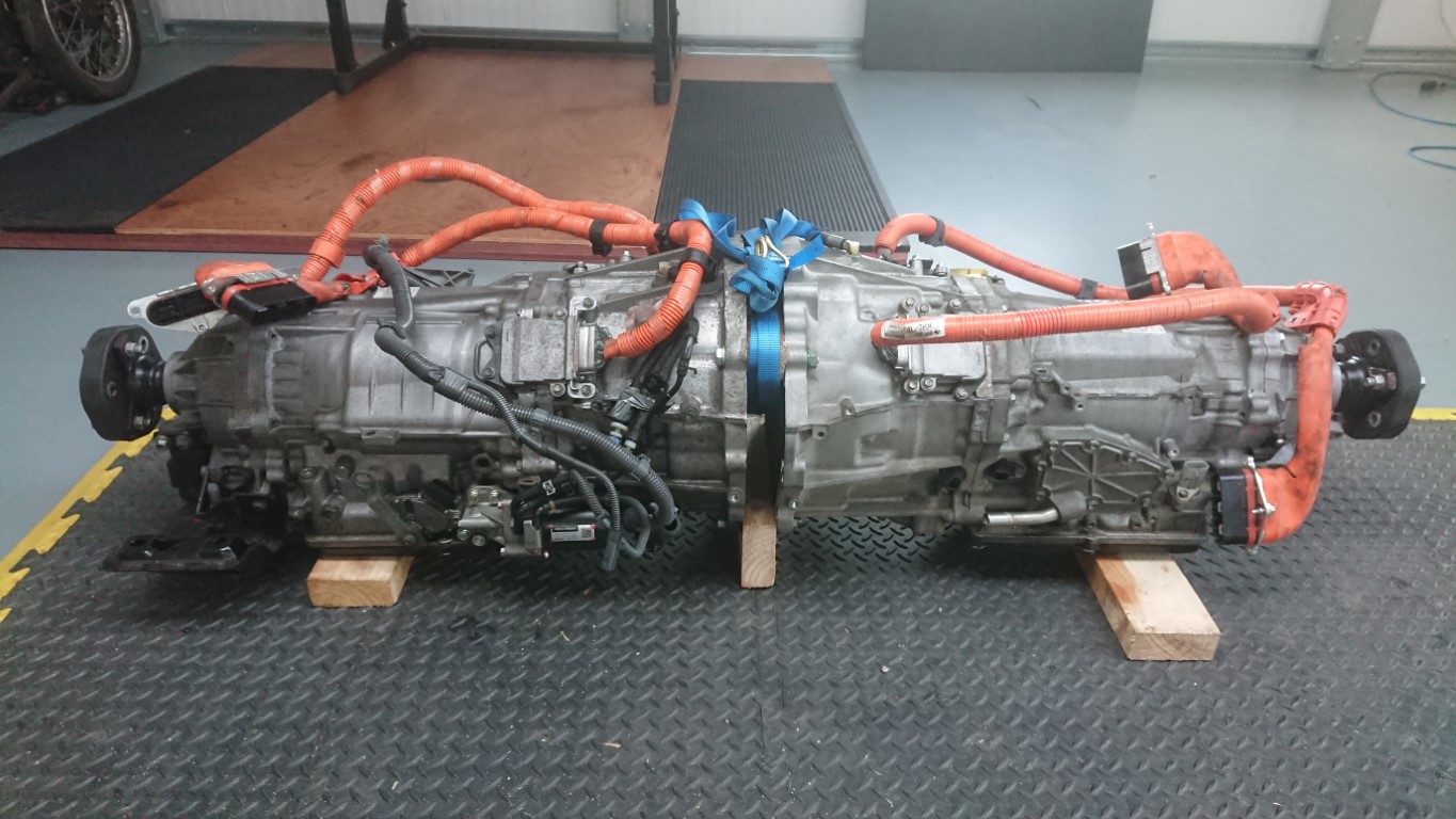

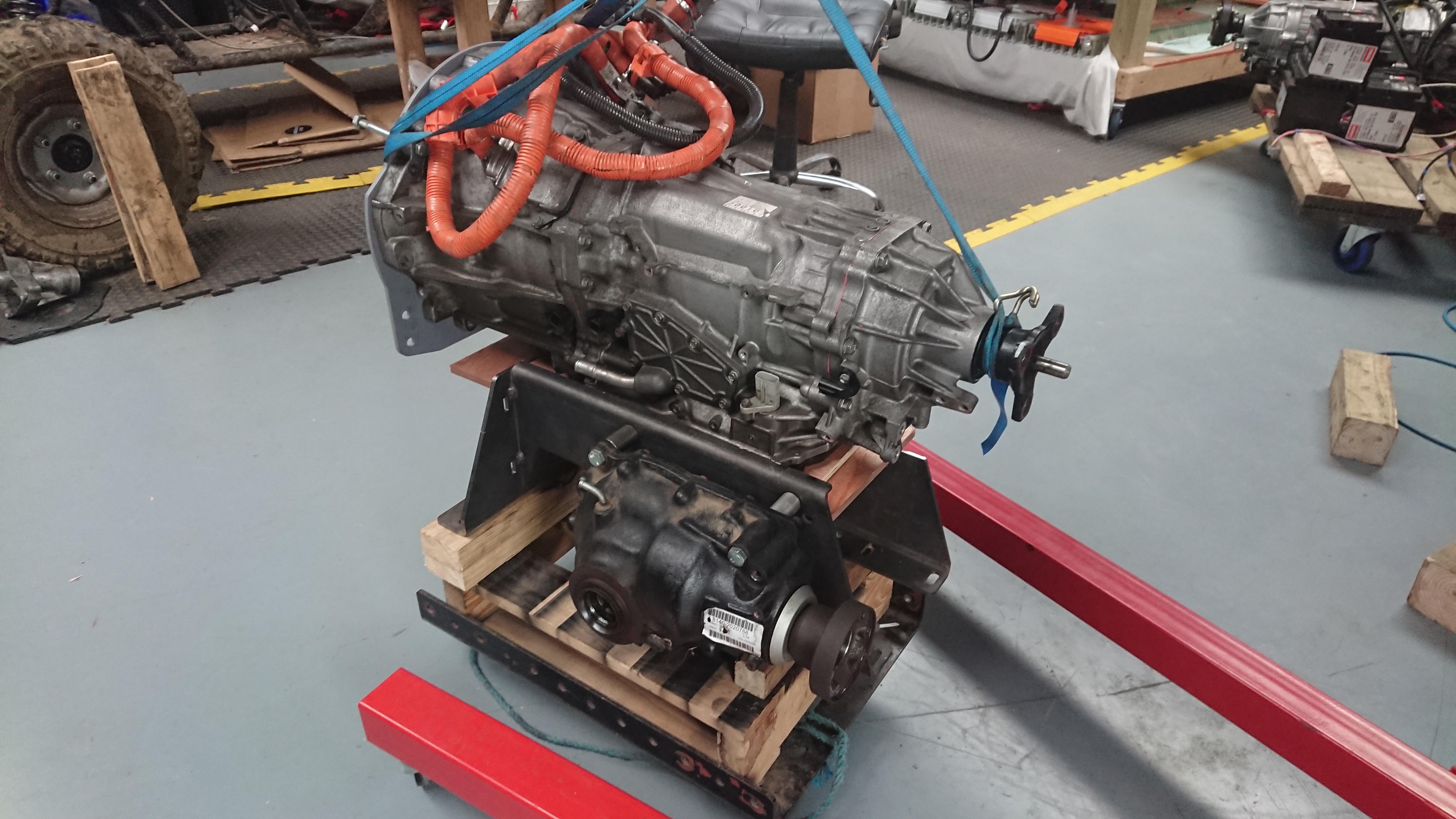

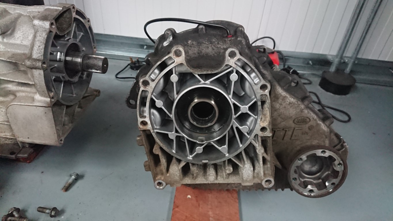

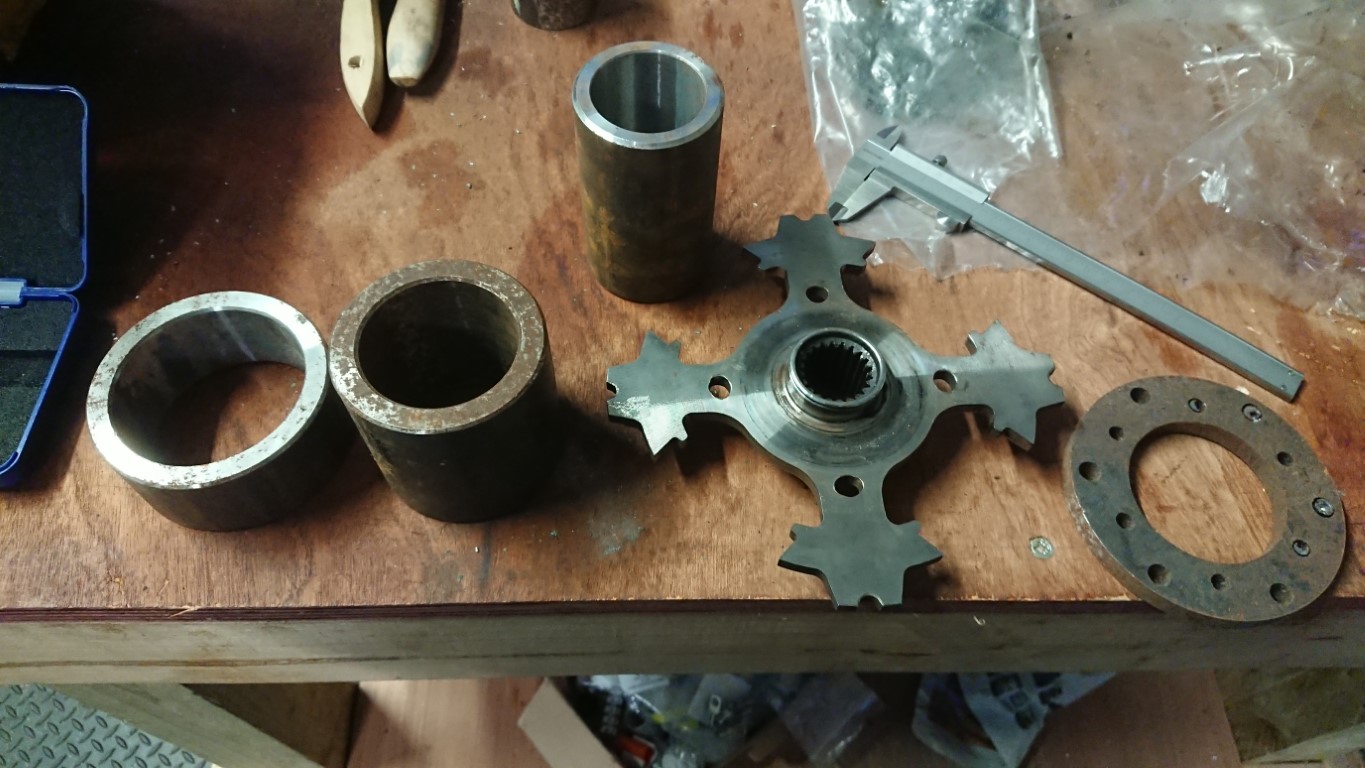

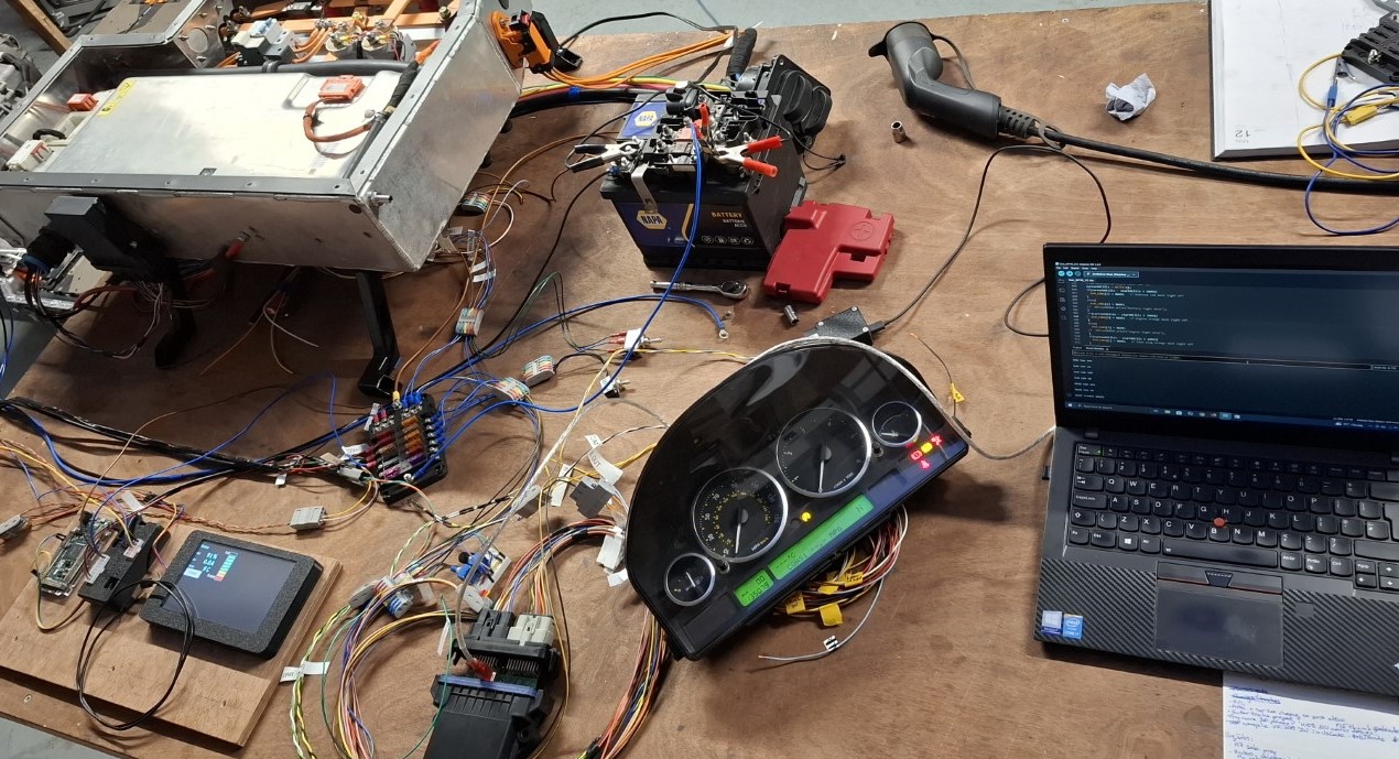

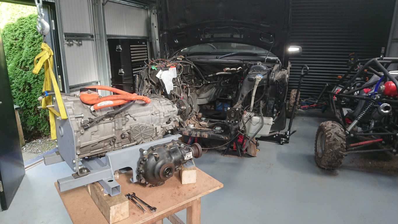

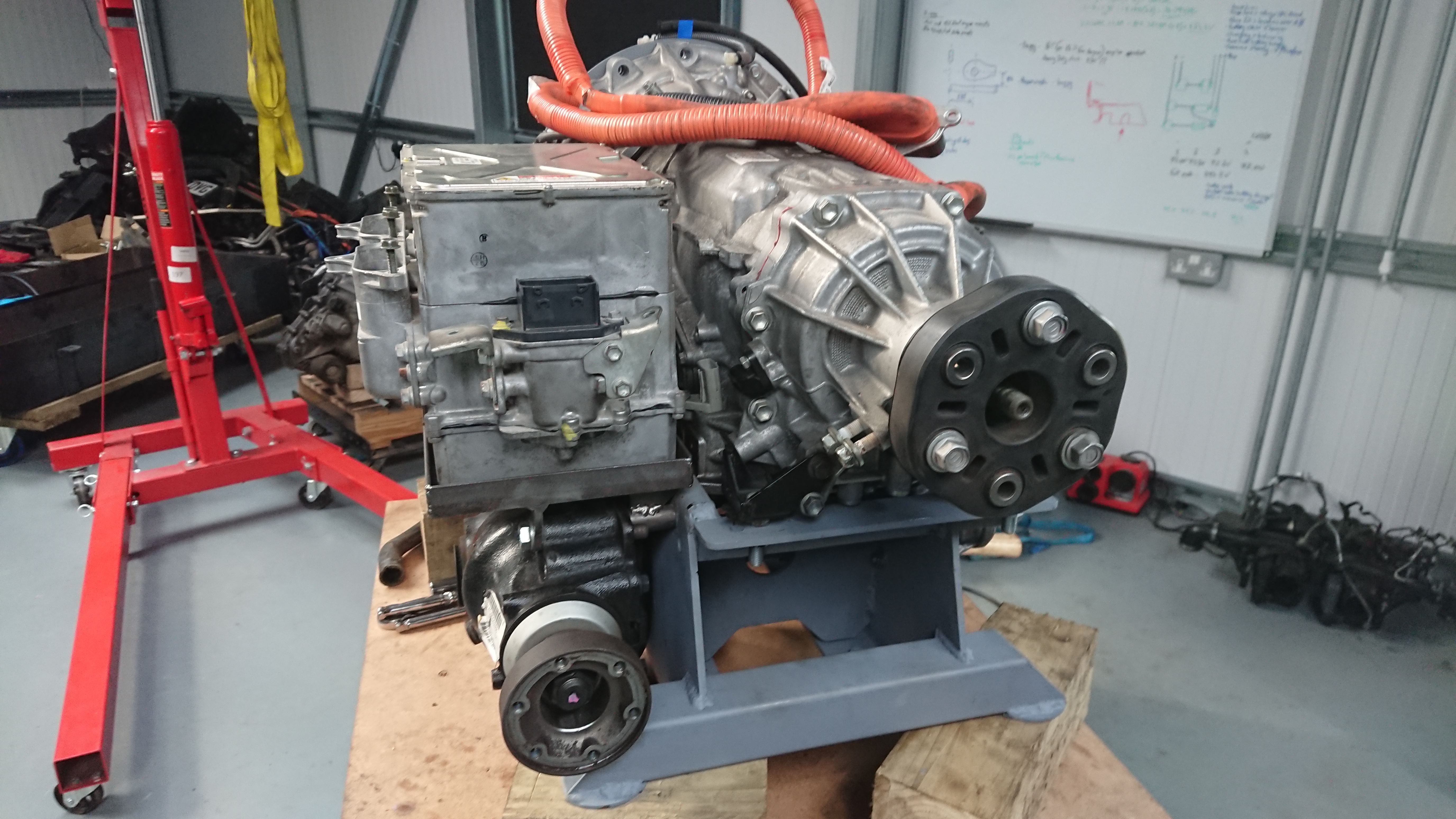

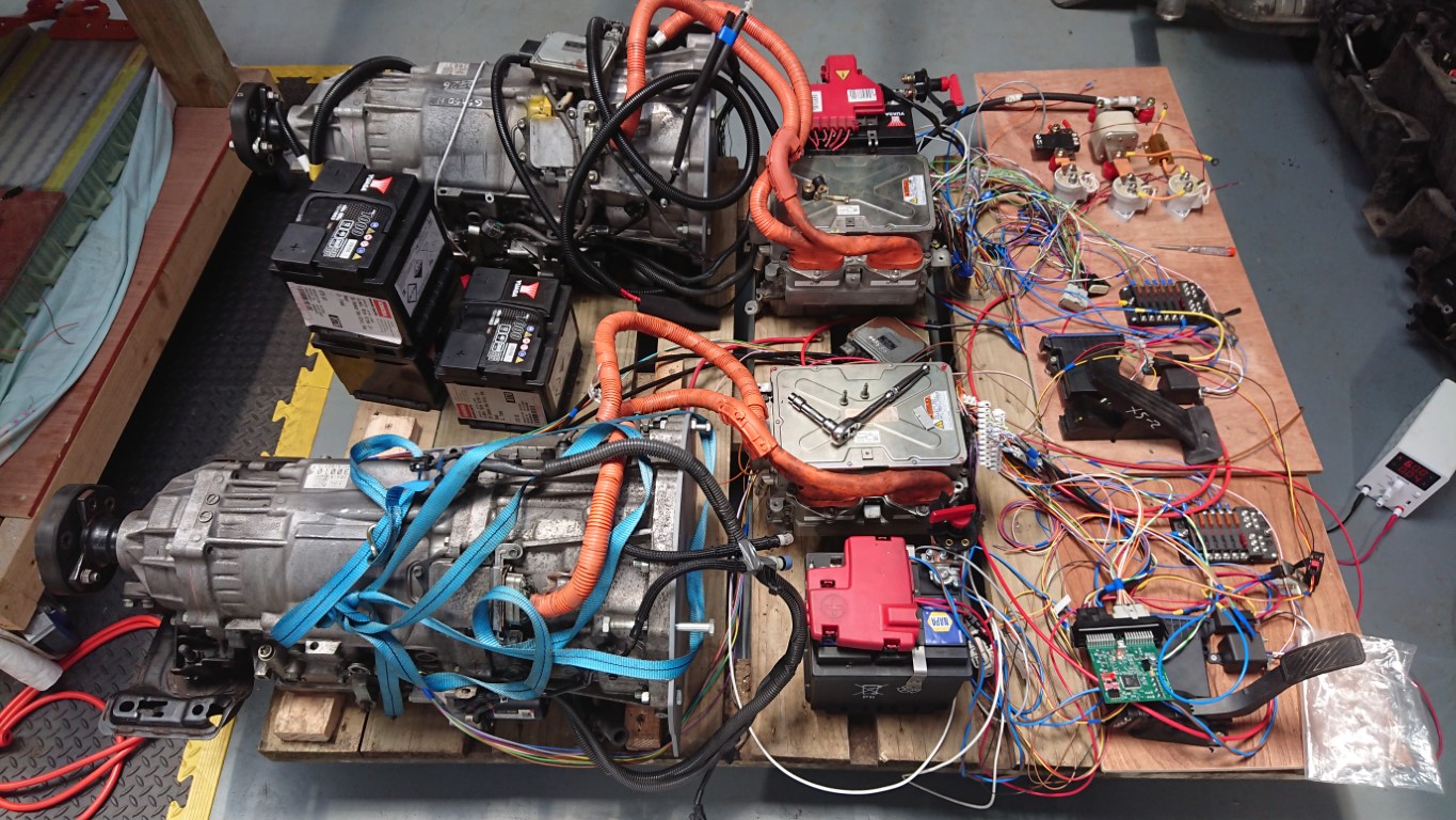

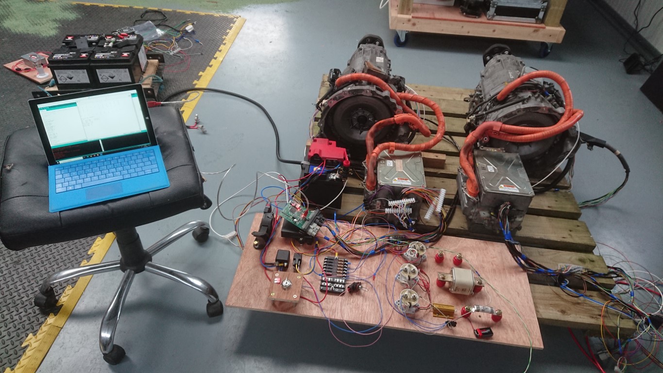

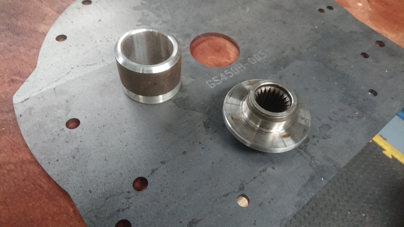

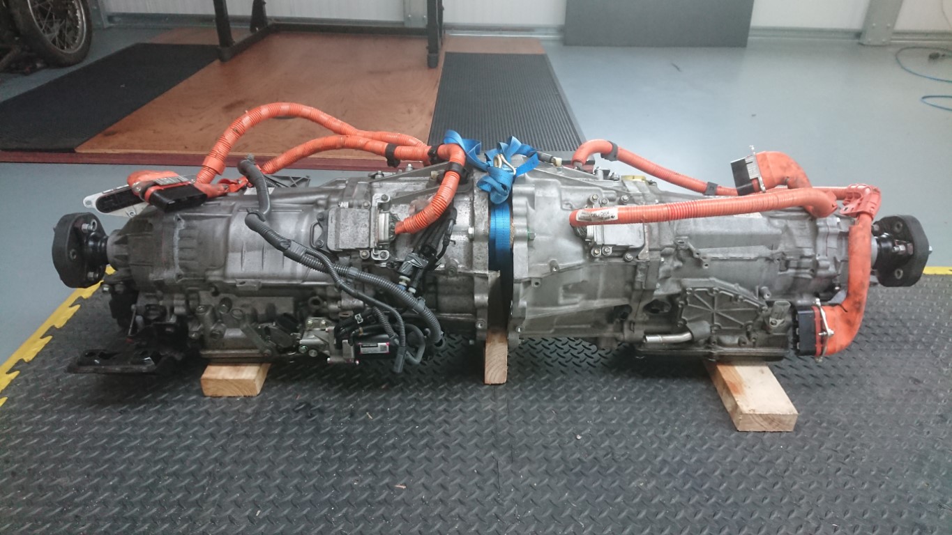

Driveline:
Following the New Electric course, I had settled on the GS450H driveline setup for my future project, whatever that may be...without thinking it all through fully (found and bought two GS450H gearboxes before I had settled on the RRV)! The first GS450H gearbox came without the oil pump as is typical but the second one showed up including the oil pump and controller and flex plate etc cheap as I was searching for the first oil pump so couldn't resist.
I ordered up two GS450H VCU's from EVBMW and I found a GS450H inverter in the UK and then a Camry inverter in the US. Gathered up some loom sections, connectors, pedals, etc and worked on getting the two drivelines running on the bench...

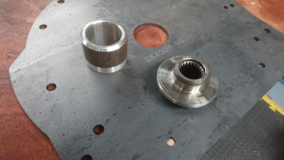

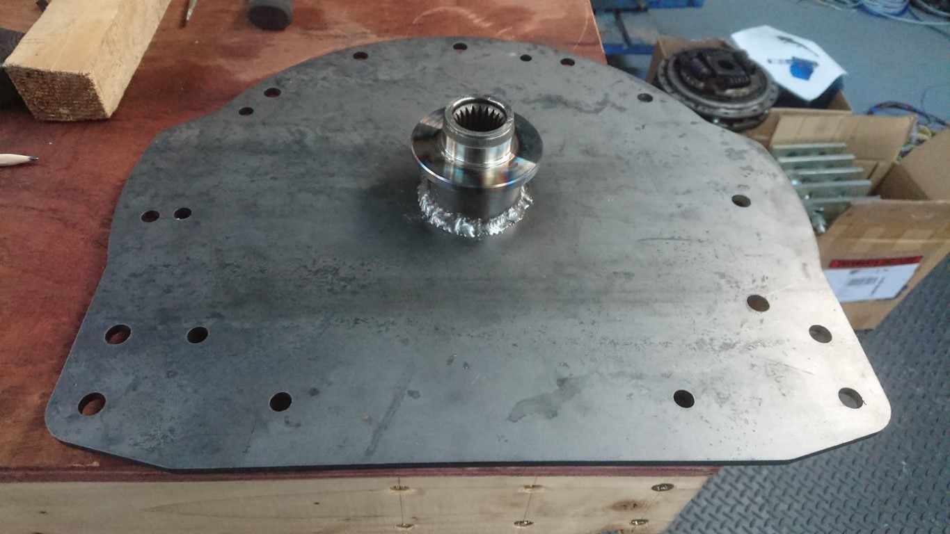

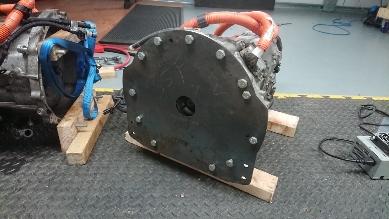

Next I replaced the oil pump bearings and fabricated a locking plate for the face of the GS450H gearbox.
On the course, during one of the breaks there was a random chat about two GS450H units back to back for a four wheel drive setup, one to each axle diff! In a moment of madness I considered this...and the face plate was designed to have a number of symetric holes to align two gearboxes!
Physically these take up a lot of space, even though there is decent space under the RRV. So the plan was brought back in line and the intention is to run a single GS450H gearbox to the original RRV transfer box. This has its own controller, is 1:1 straight through with a low range and variable clutch set up for off road use. This is going to be a phase 1 solution as I'm not 100% happy with this route yet. Max gearbox rpm, transfer case loses, axle diff ratios, etc will mean limits on top speed but for now I'll work with what I have and have been looking at possible phase 2 and phase 3 solutions!!!
Since starting the project, I was watching the Zombieverter project with interest so have now bought one from EVBMW to use instead.

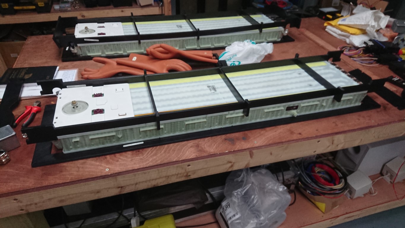

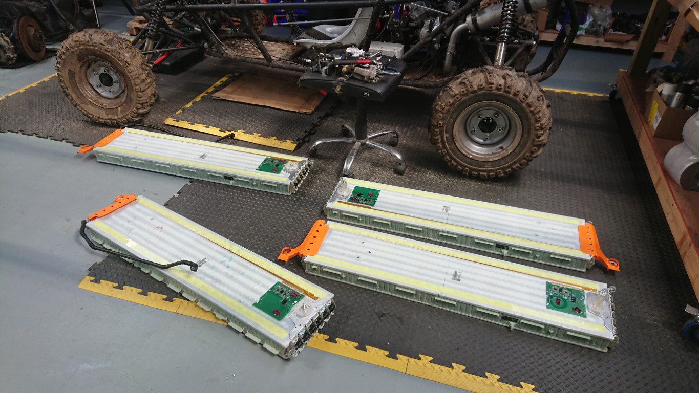

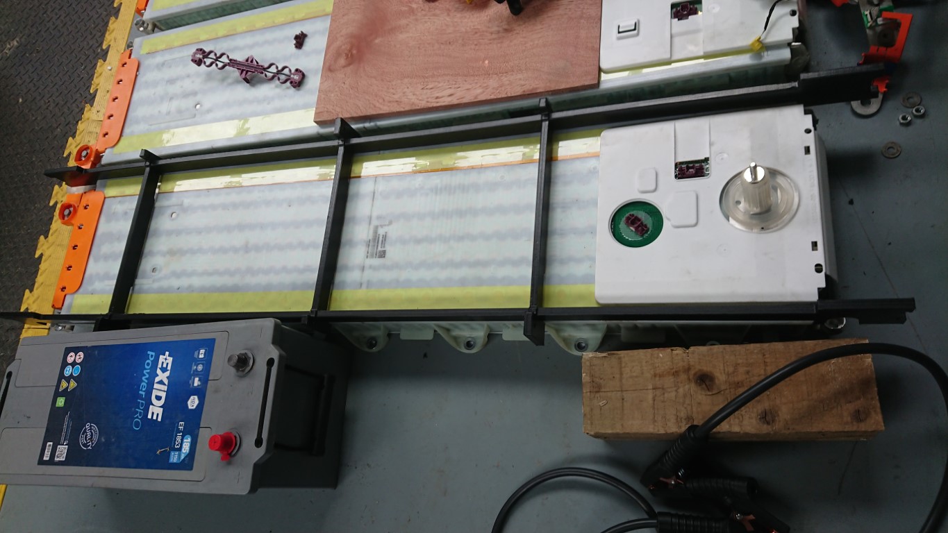

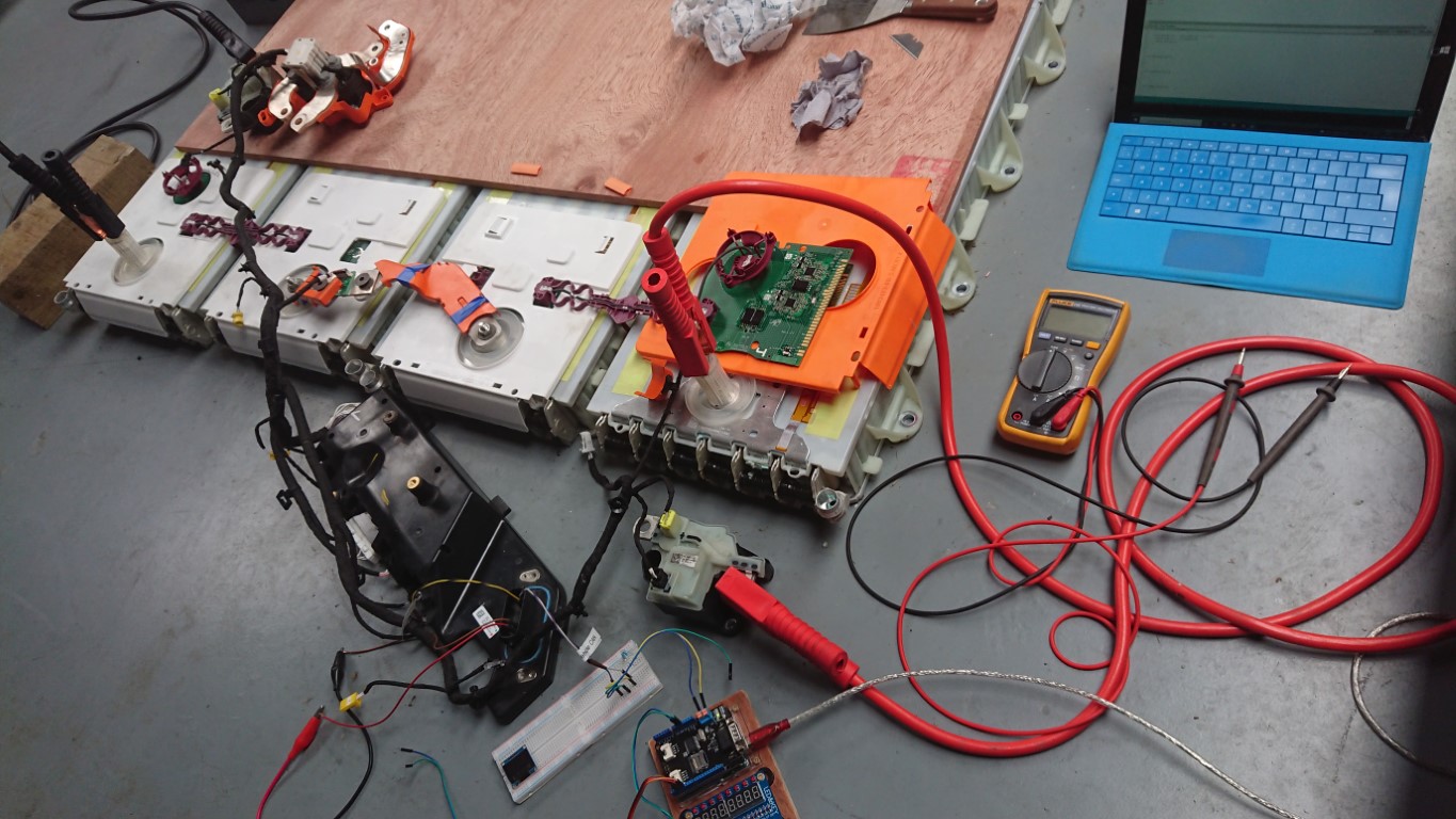

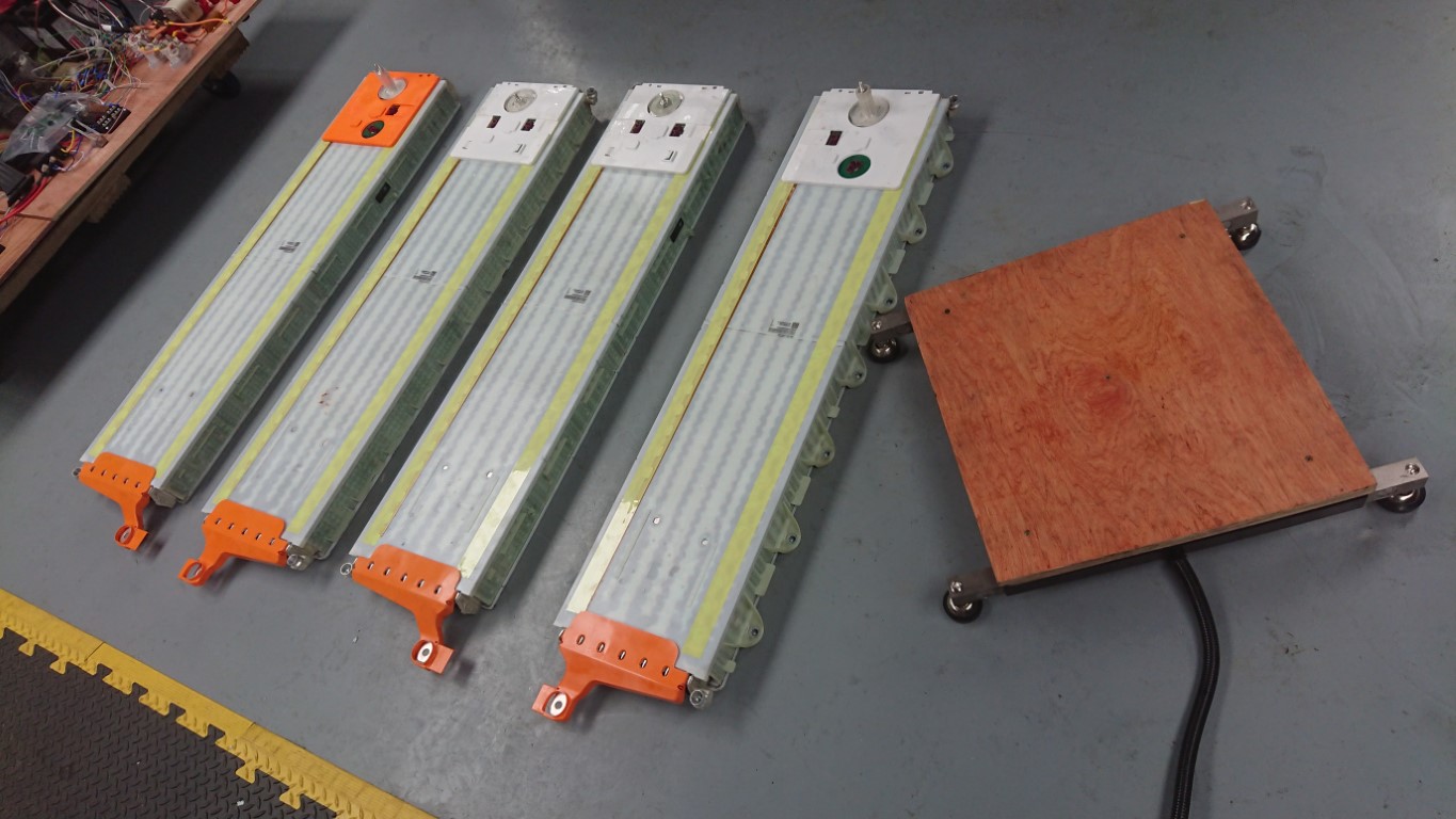

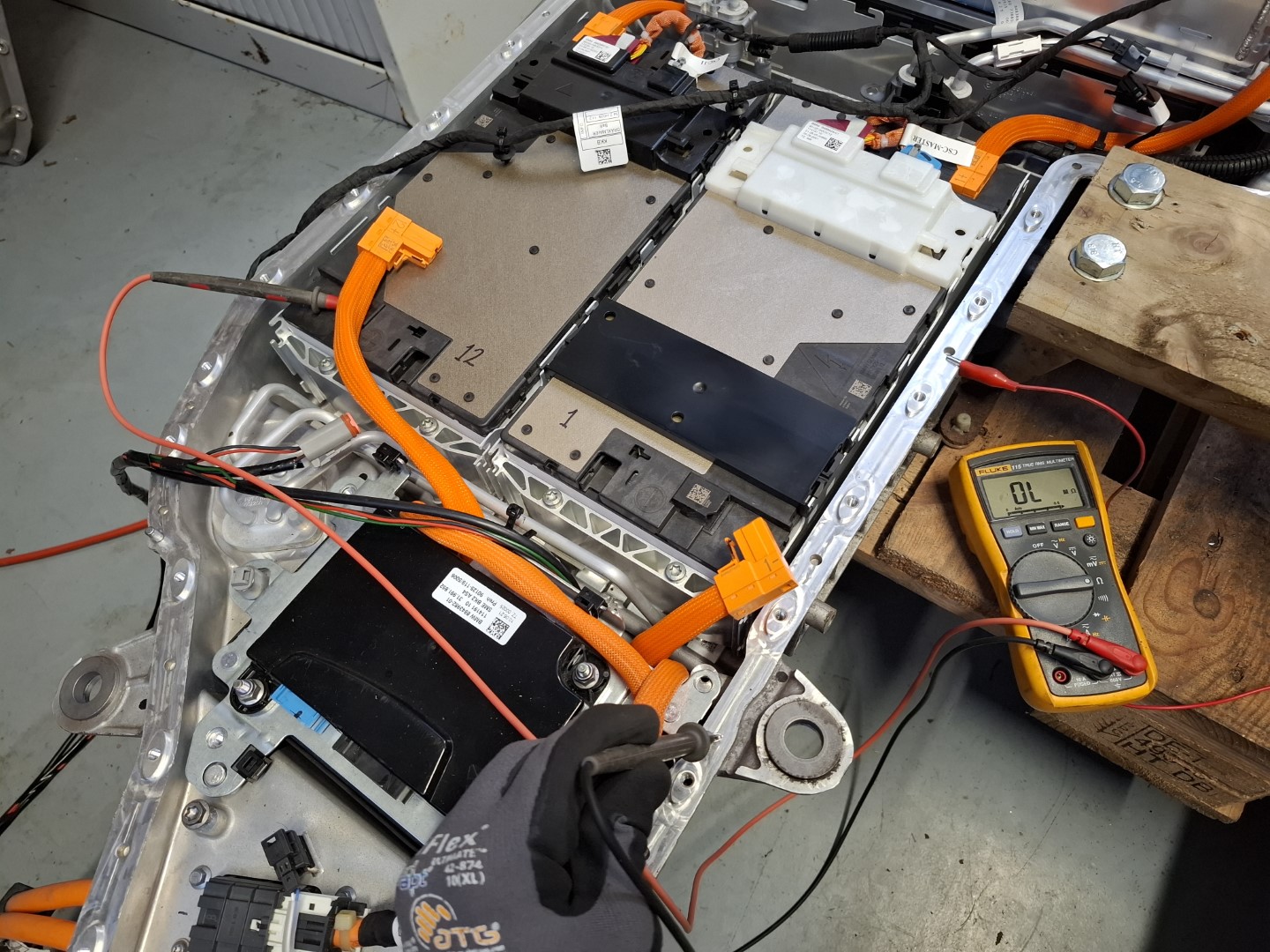

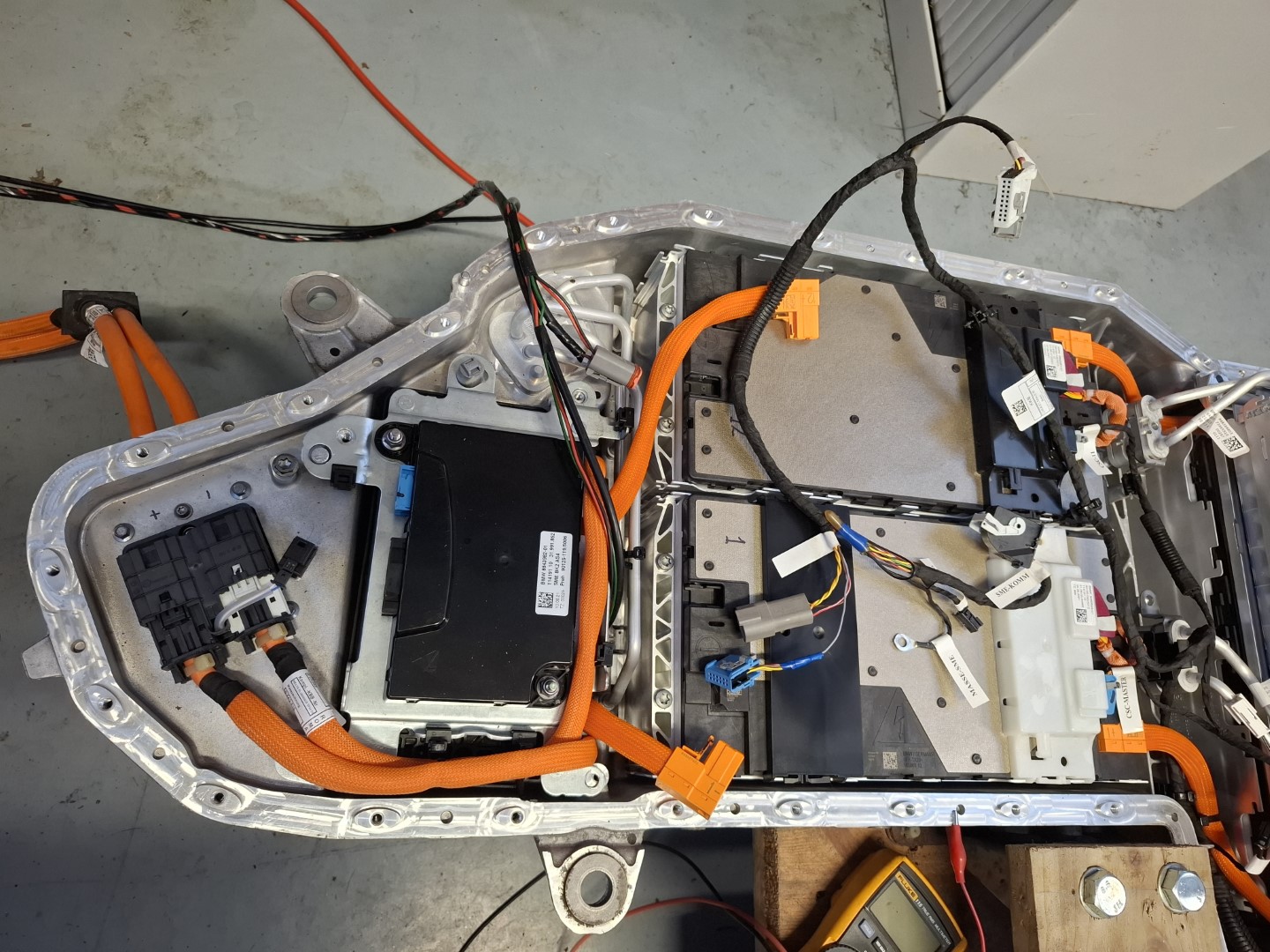

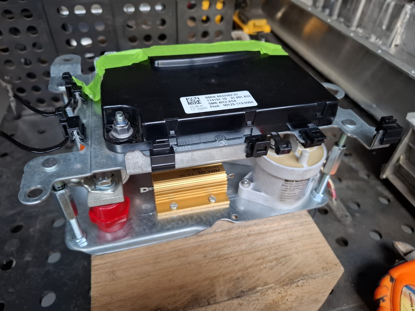

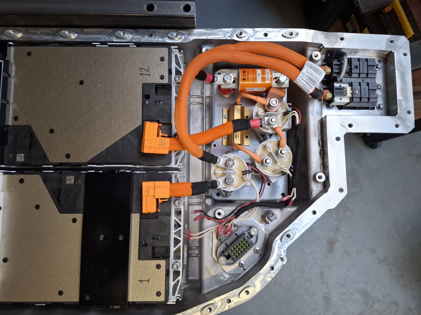

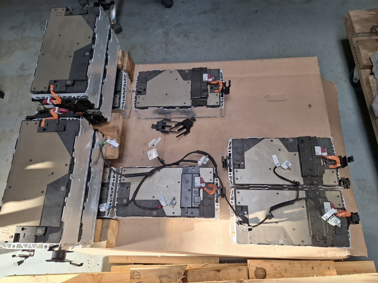

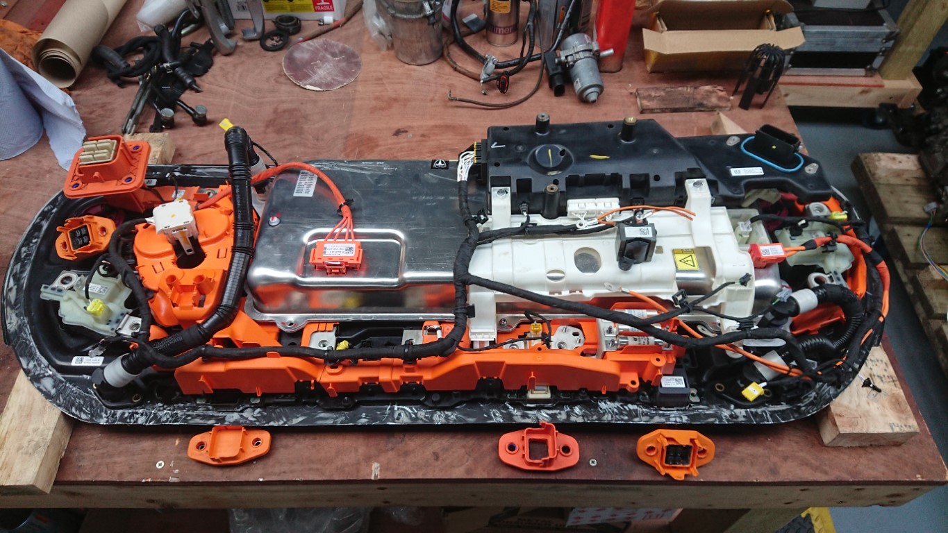

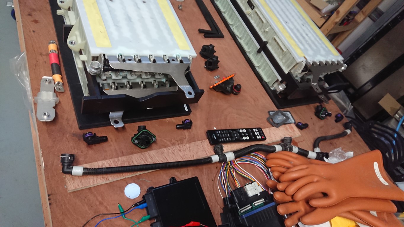

Batteries:
With the size and clearance underneath the RRV, this gives more options than many others may have for batteries. With help from Calvin at EVBreakers, I have a 55kWh SR Tesla Model 3 battery pack to use.
To maximise range, I'd like to use a larger battery pack, but this may be a phase 2 project! The SR battery modules are shorter than the 75kWh modules and fit underneath the RRV without issues. The longer modules would not fit. Also, as the TM3 modules are unmanageable for many car conversions, they are in less demand so come at much better prices.

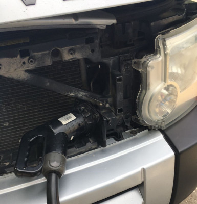

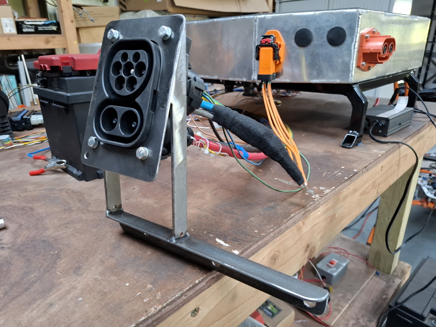

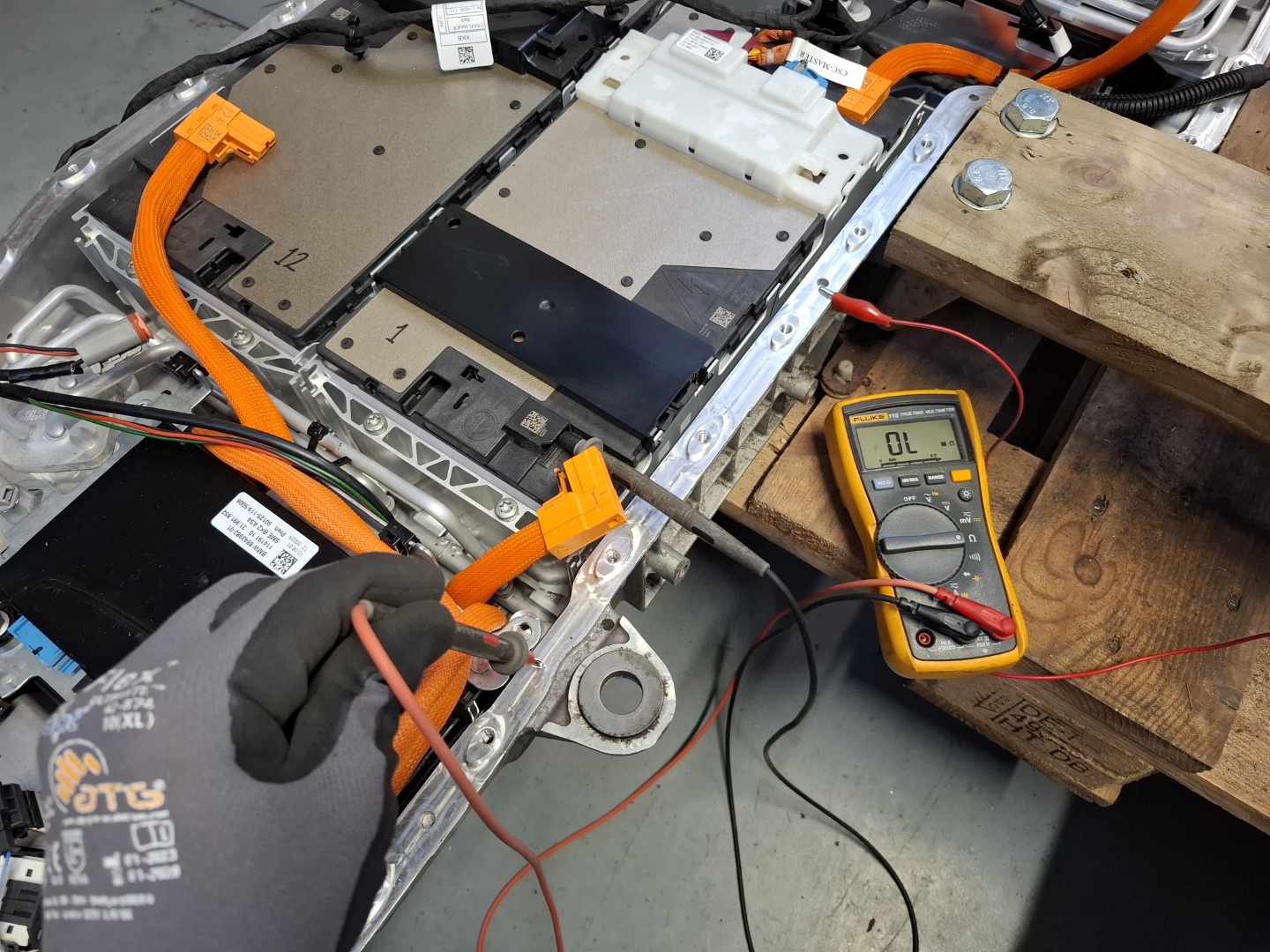

I will use fast/CCS charging (TM3 PCS and BMW i3 LIM) which will aid any longer trips rather than carrying round the larger battery weight but depending on how my driveline choice may change in the future, I have considered using an IPace 90kWh battery pack.

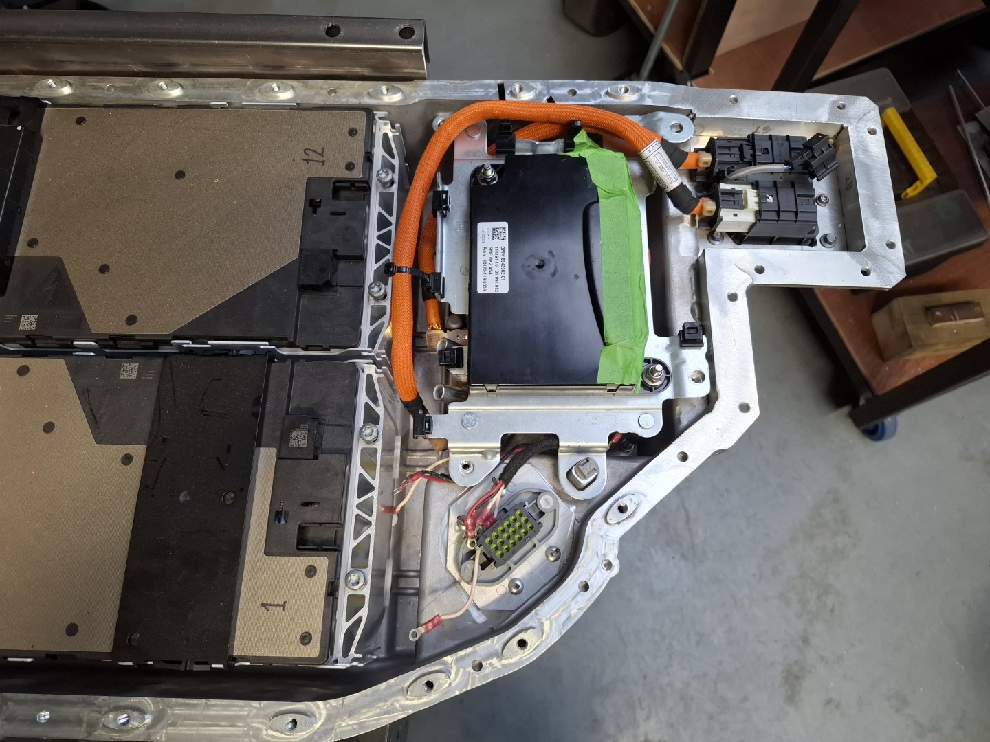

Made a weigh scales to keep track of all component weights and each of the modules come in approx. 59Kg, so 236Kg for the four modules shown below.
With a lot of great help and support from members on this forum, I got connected up to the battery CAN buses and can read all 96 cell voltages and other key info. I've not settled on a BMS option yet, the TM3 BMS isn't just available for use in conversions yet unfortunately but Orion 2 is a possible option. The preference is to use the TM3 option but I don't need to finalise this for now.

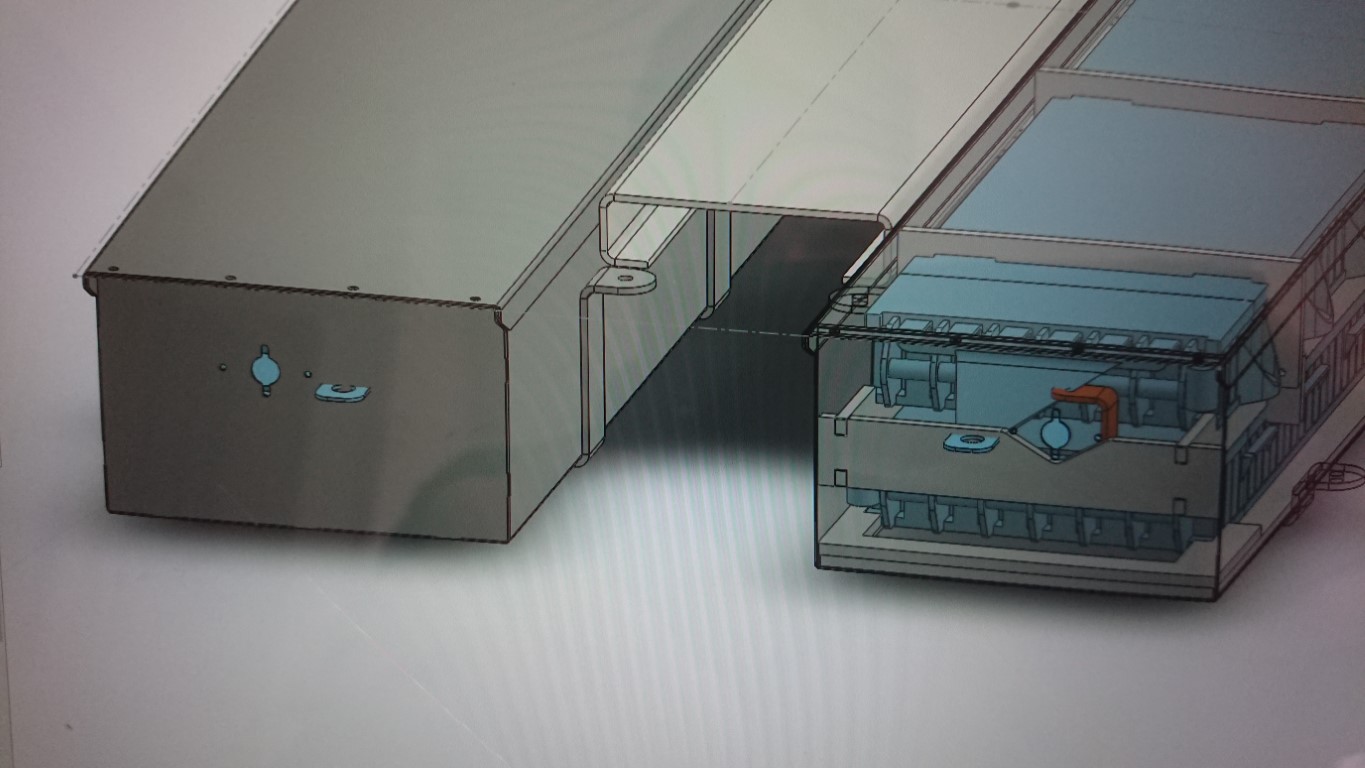

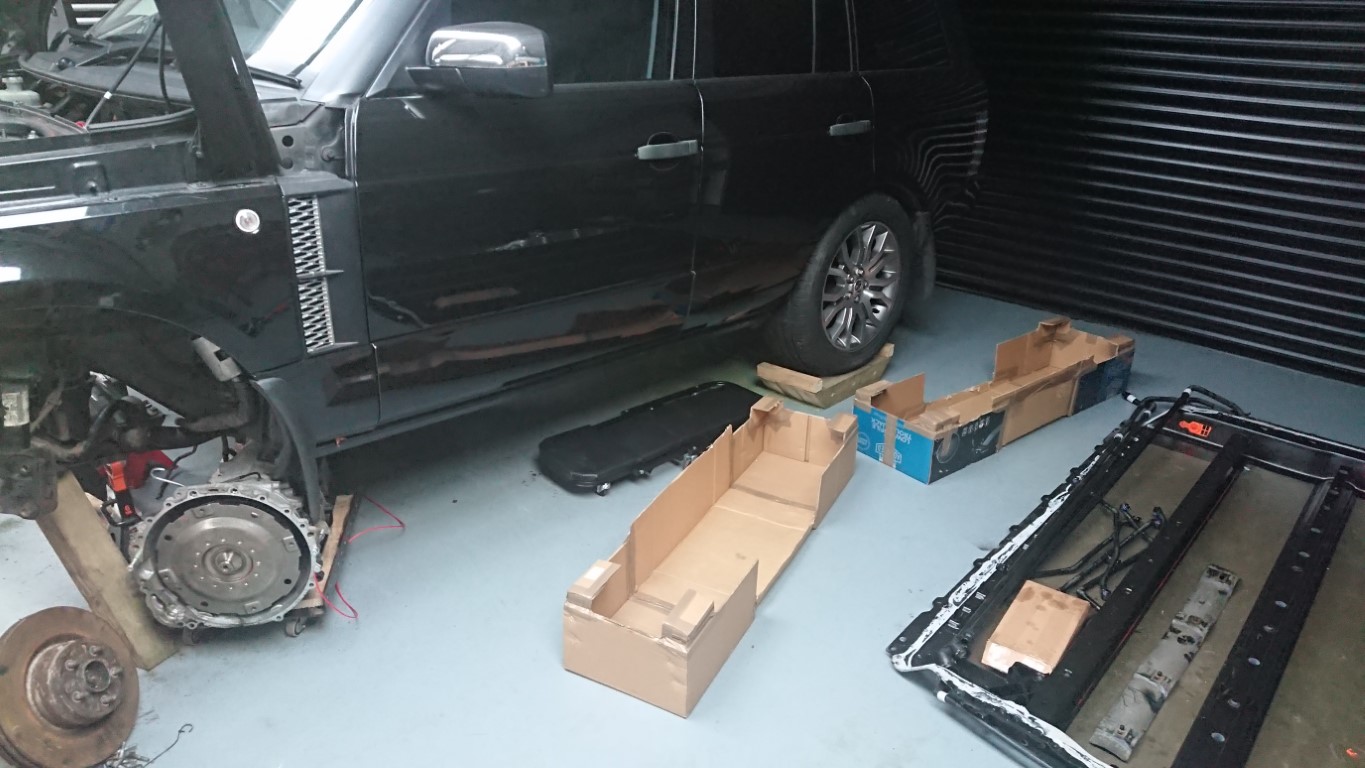

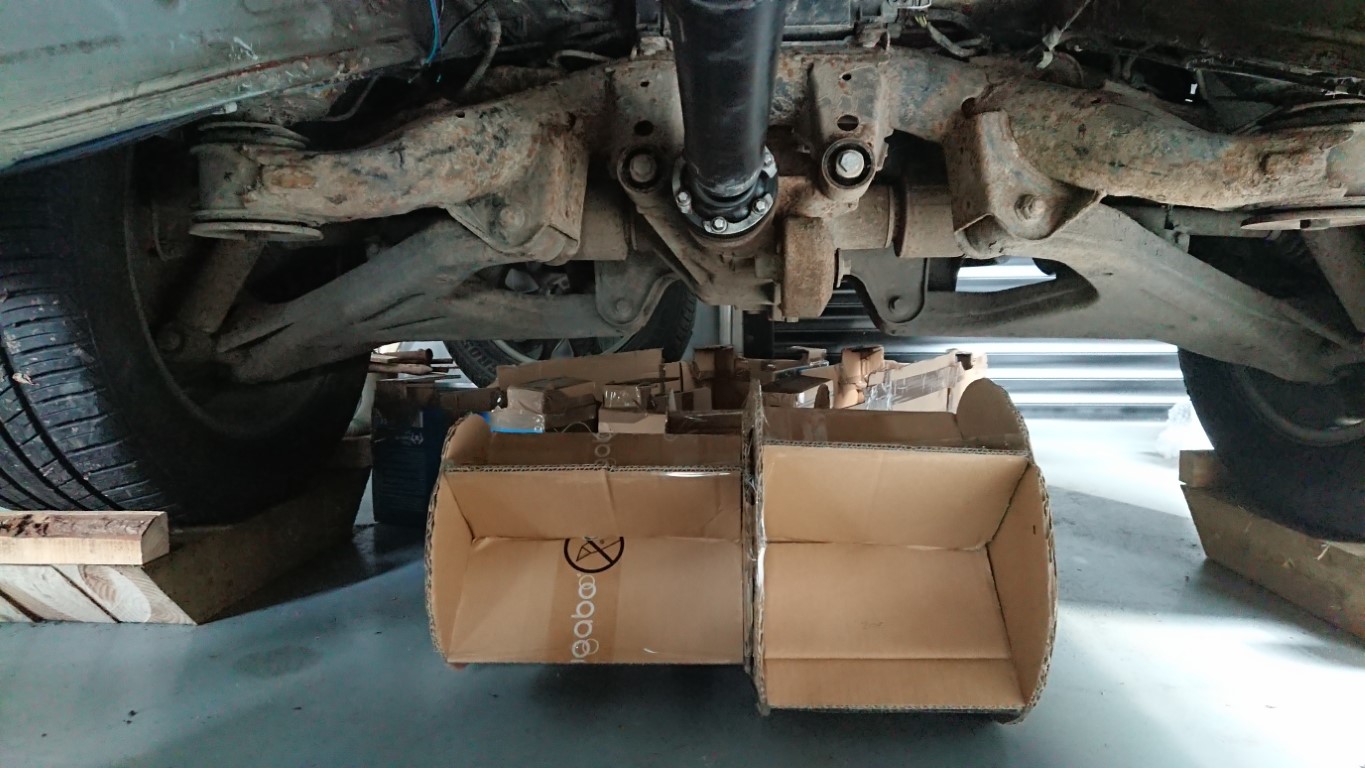

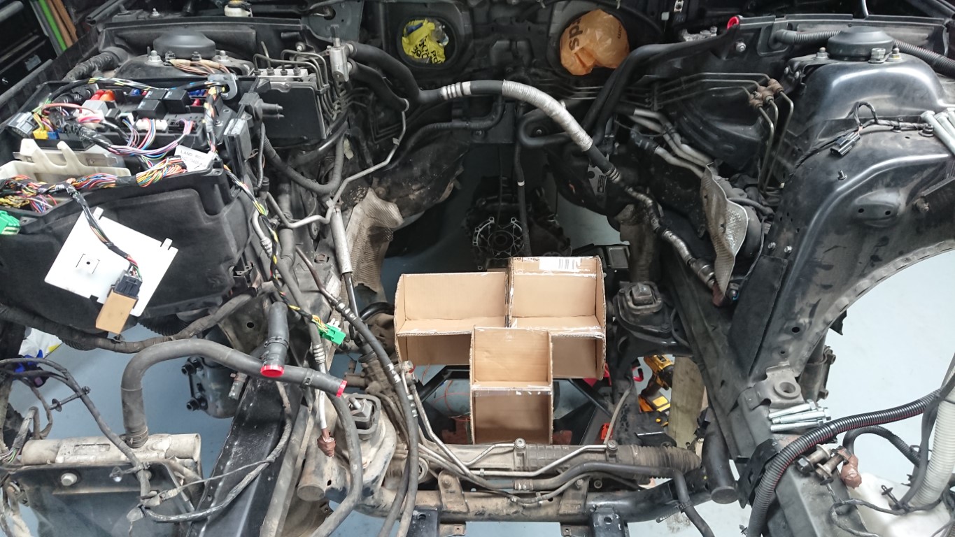

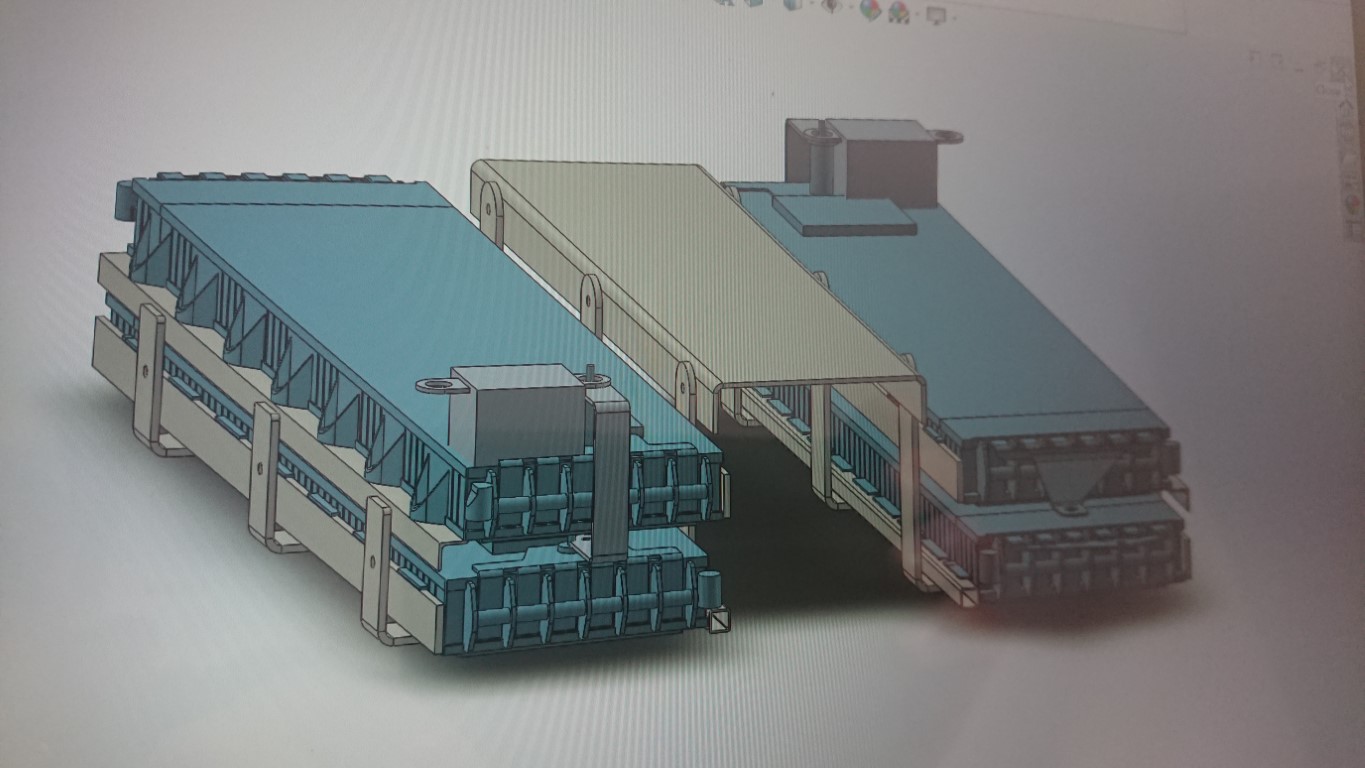

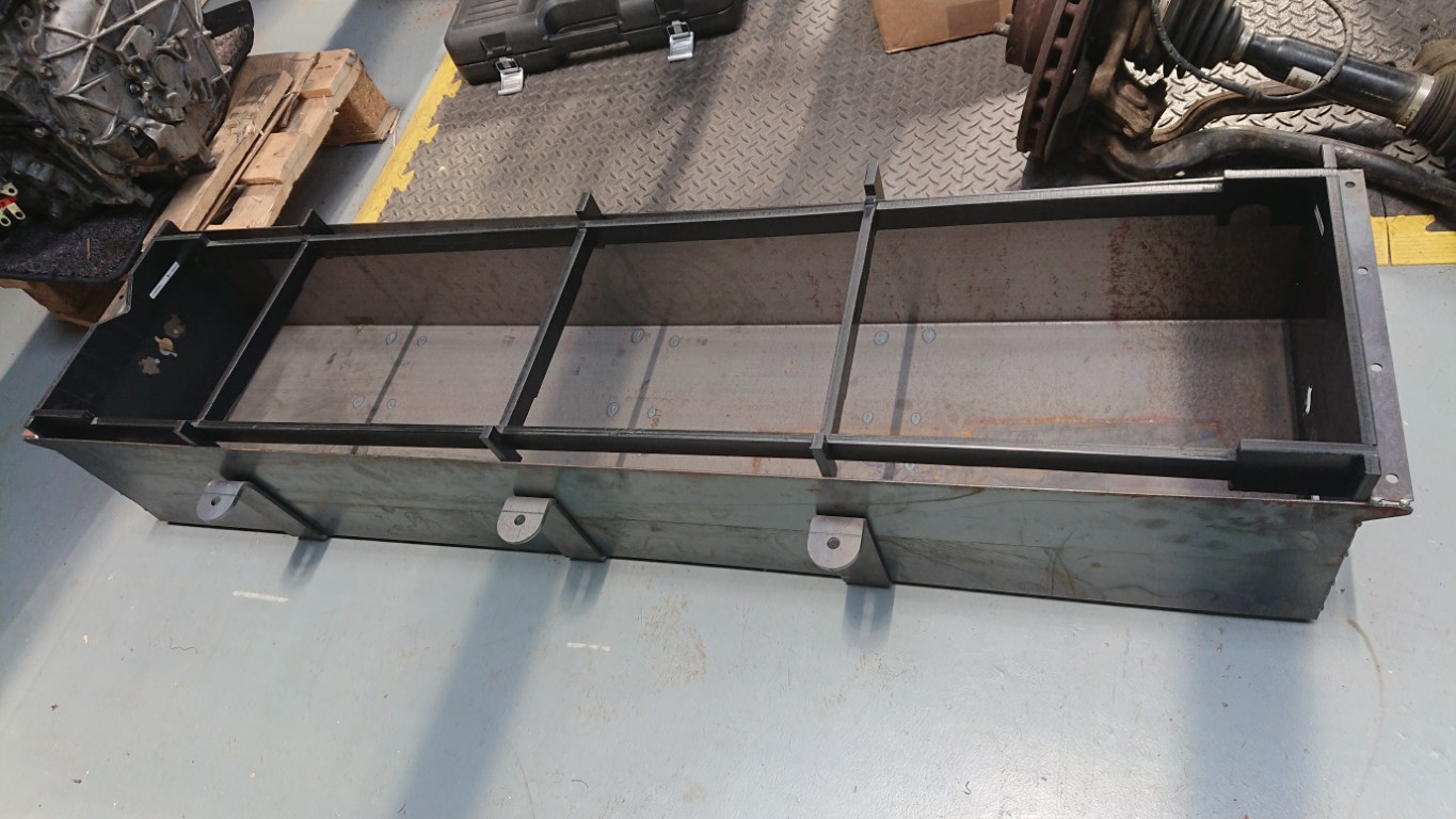

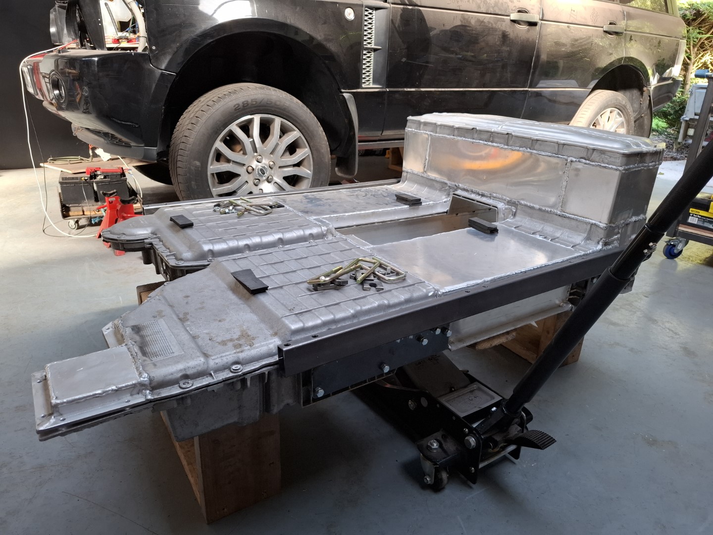

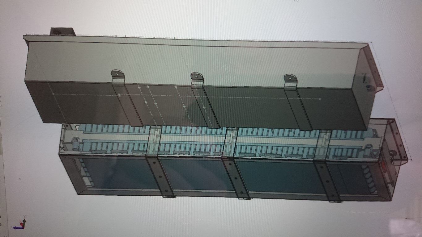

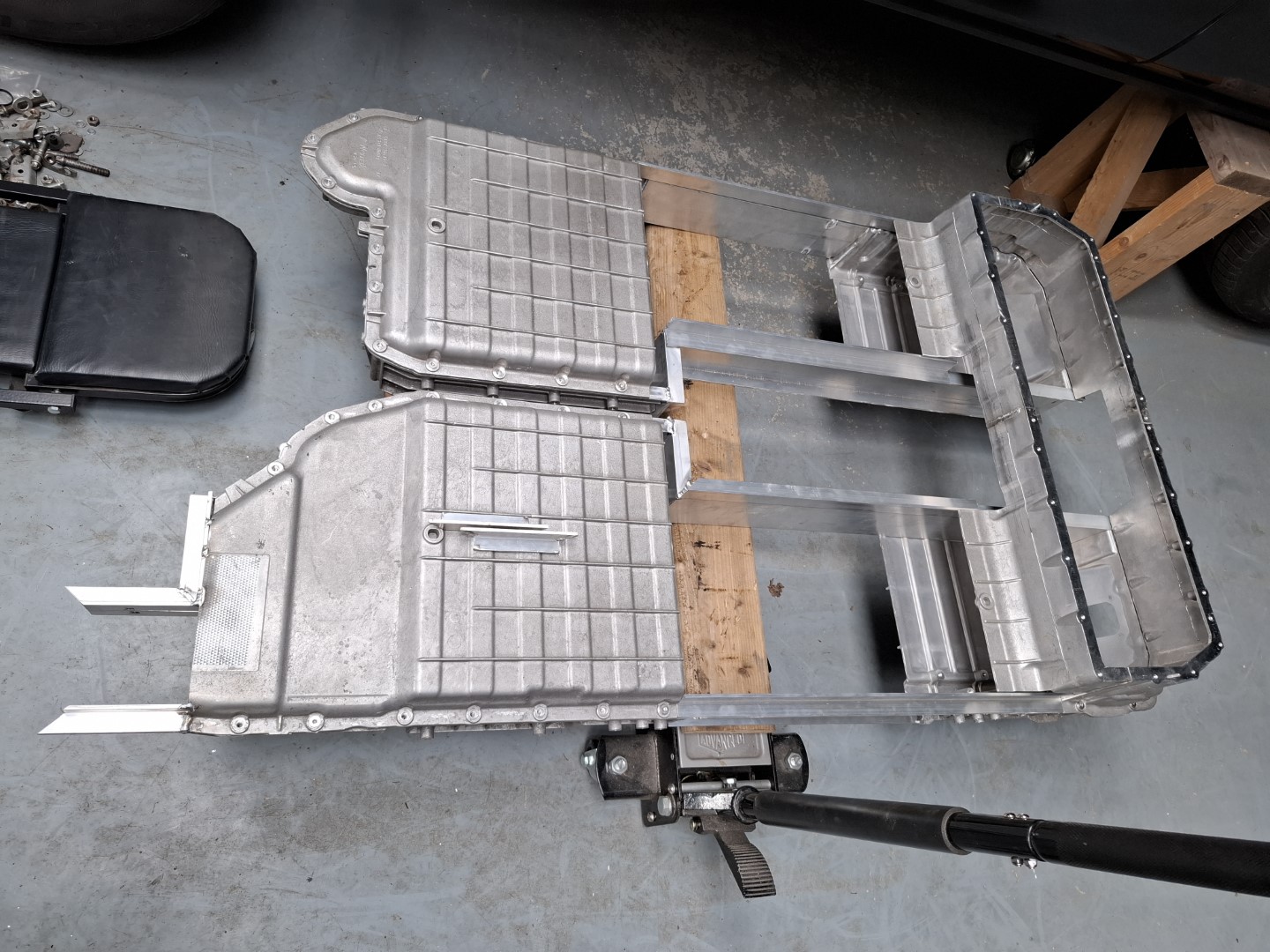

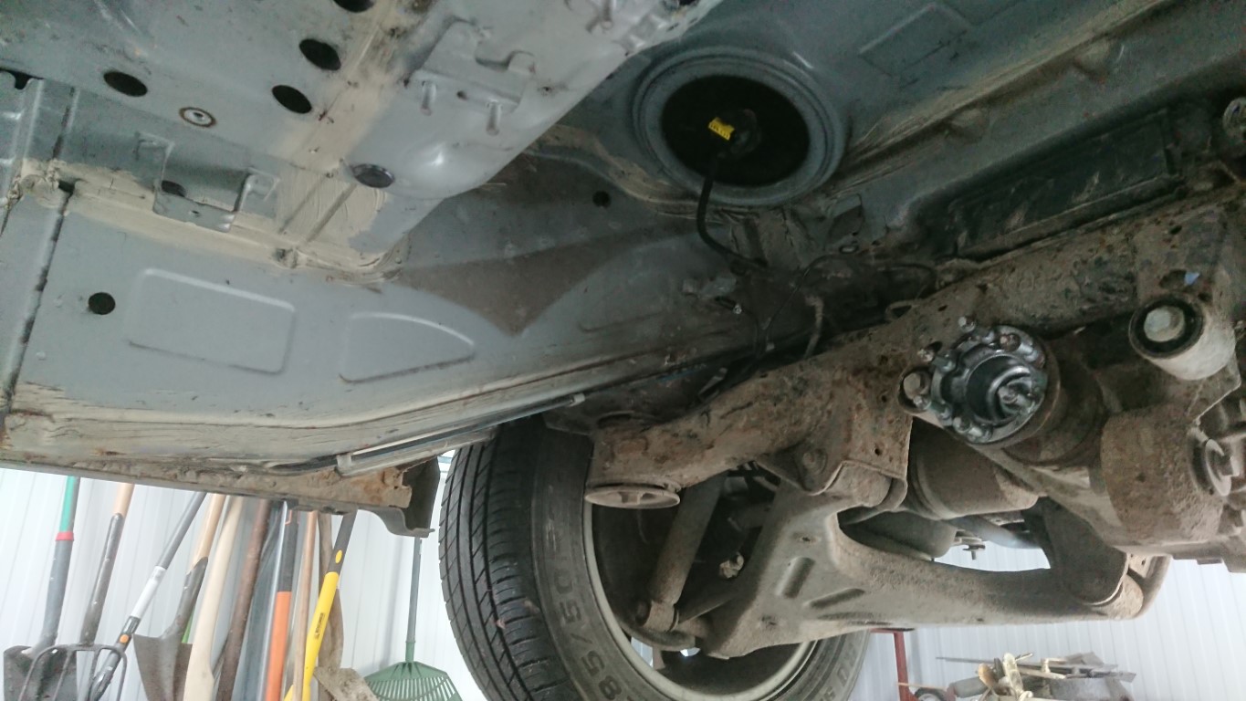

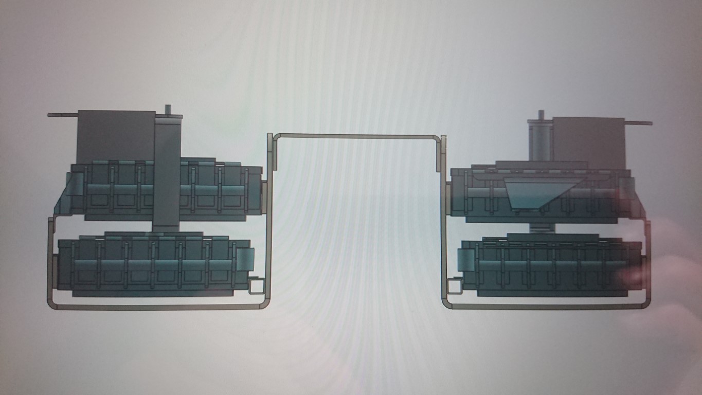

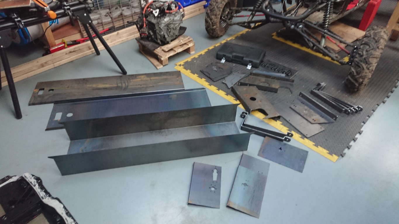

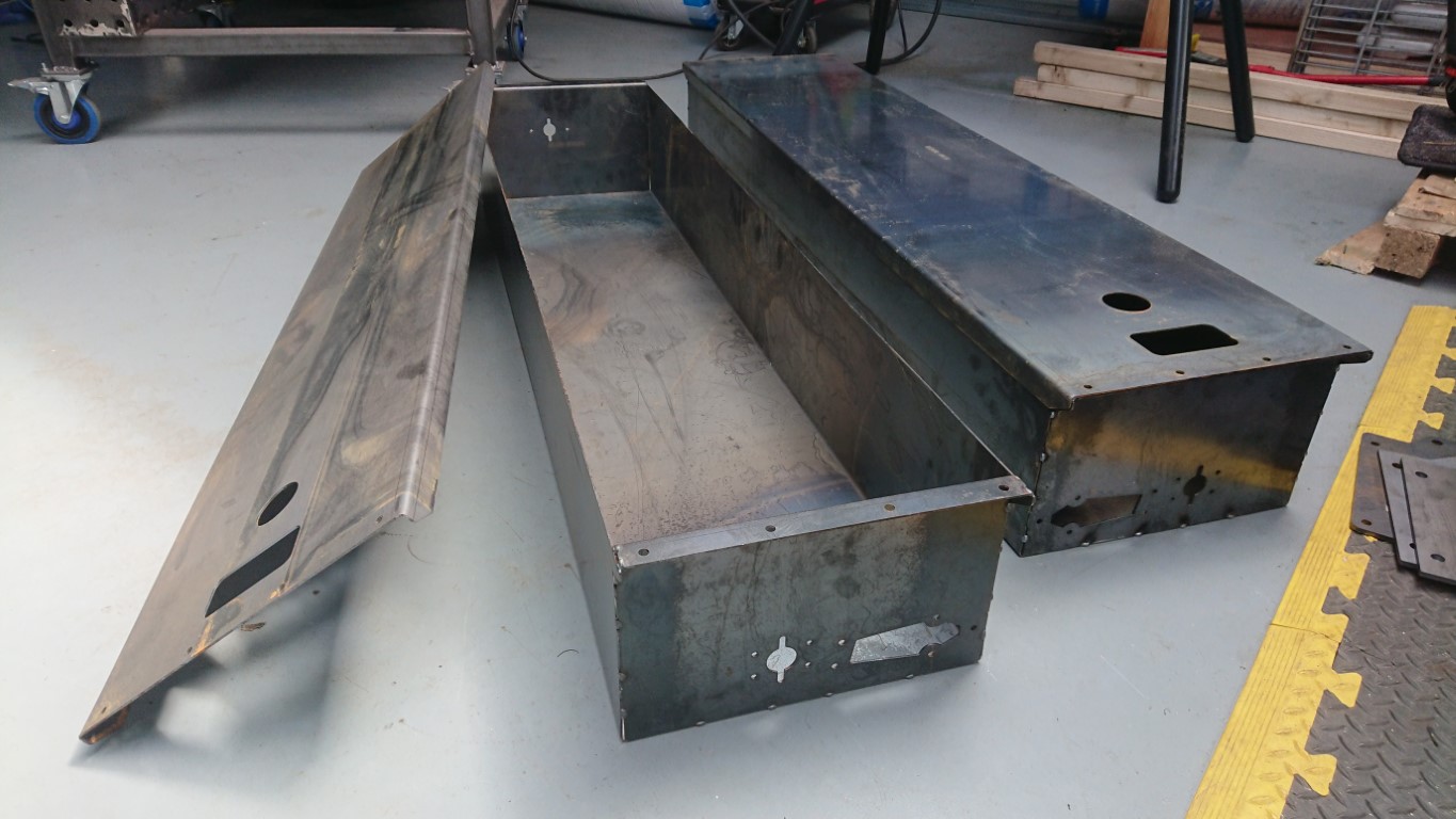

Battery Boxes:
So the head scratching began, out with the cardboard mockups, and on to Solidworks...time to figure out the battery boxes. Reusing the main components from the TM3 battery pack, the breathers, coolant inlets and outlets, etc.
I needed to split the battery boxes either side of the rear prop shaft. In future this may be revised if I change the drive setup. Plan is to stack two modules on top of each other in each battery box.

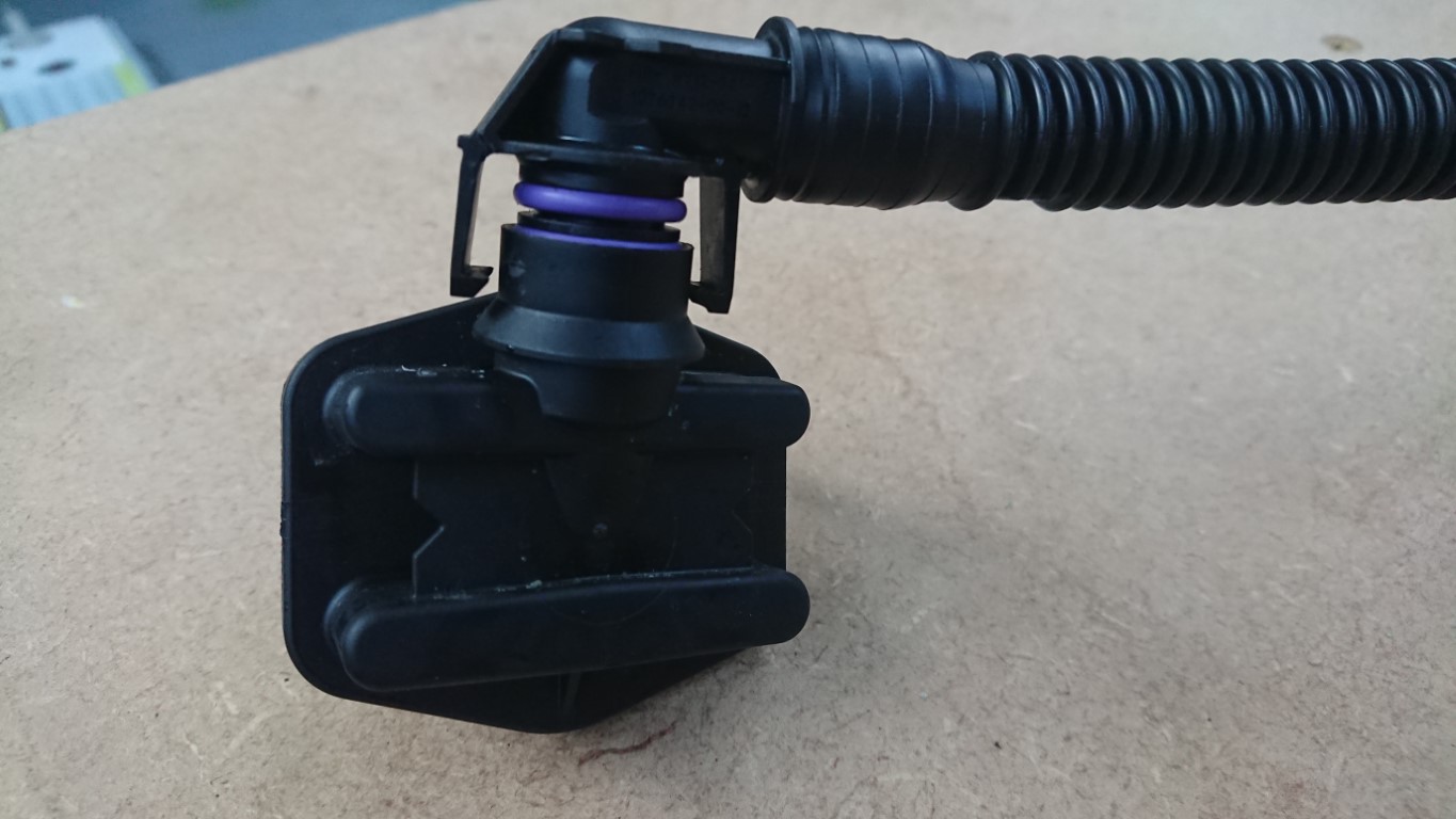

Some rough work in SW to figure out clearances and coolant inlets and outlets
Measuring up the ports and components from the TM3 pack
Parts drawn up and ordered from laser suppliers for fabrication

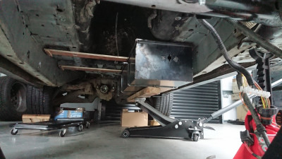

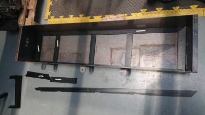

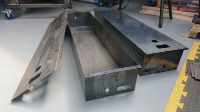

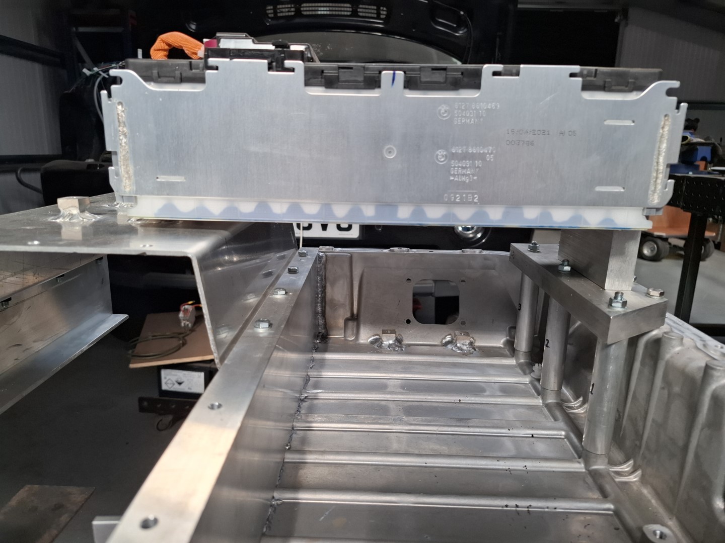

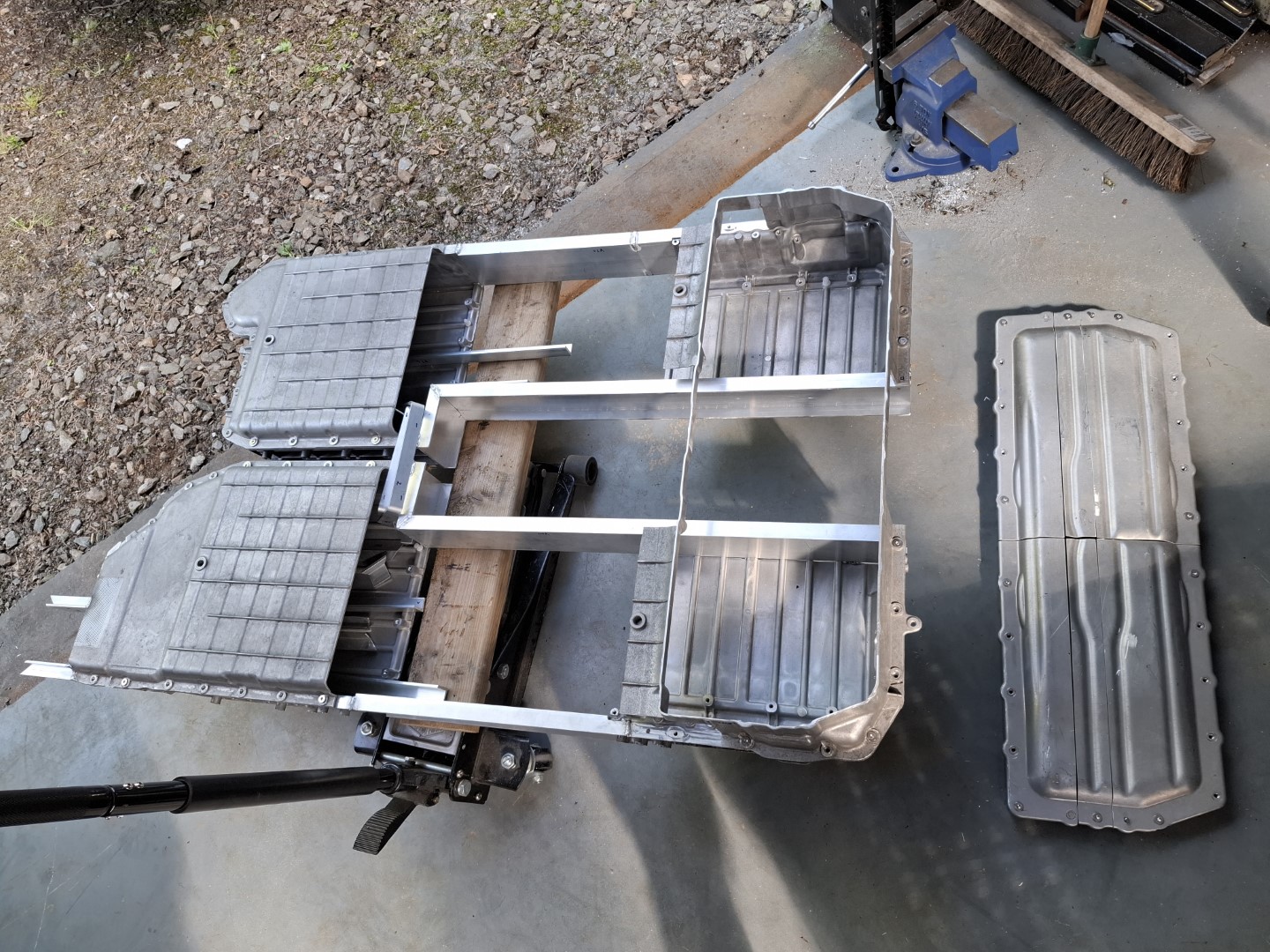

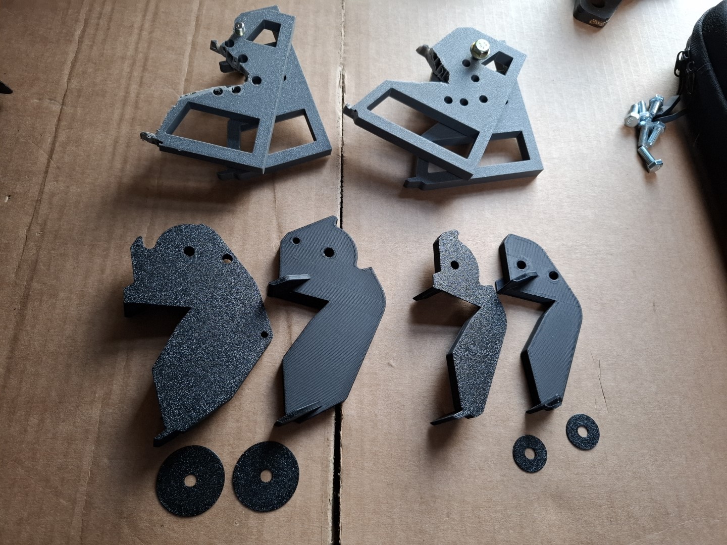

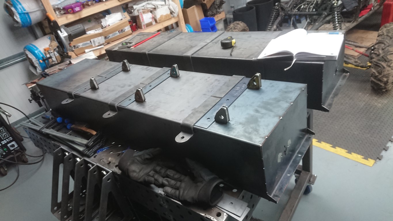

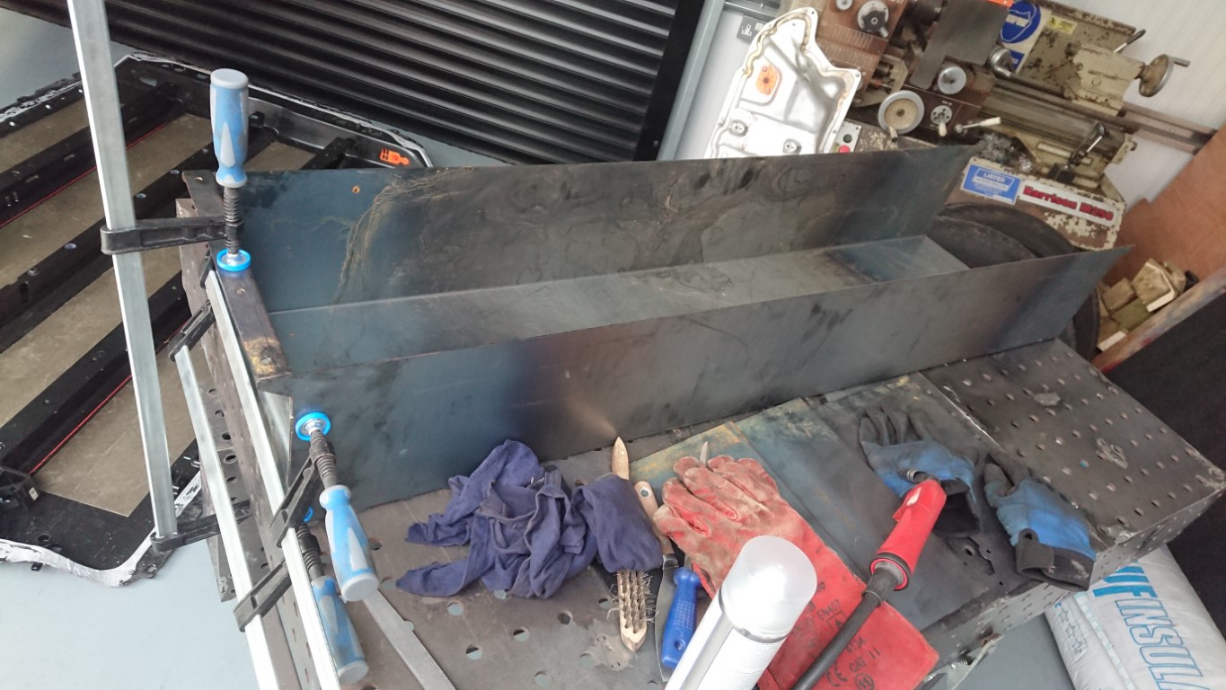

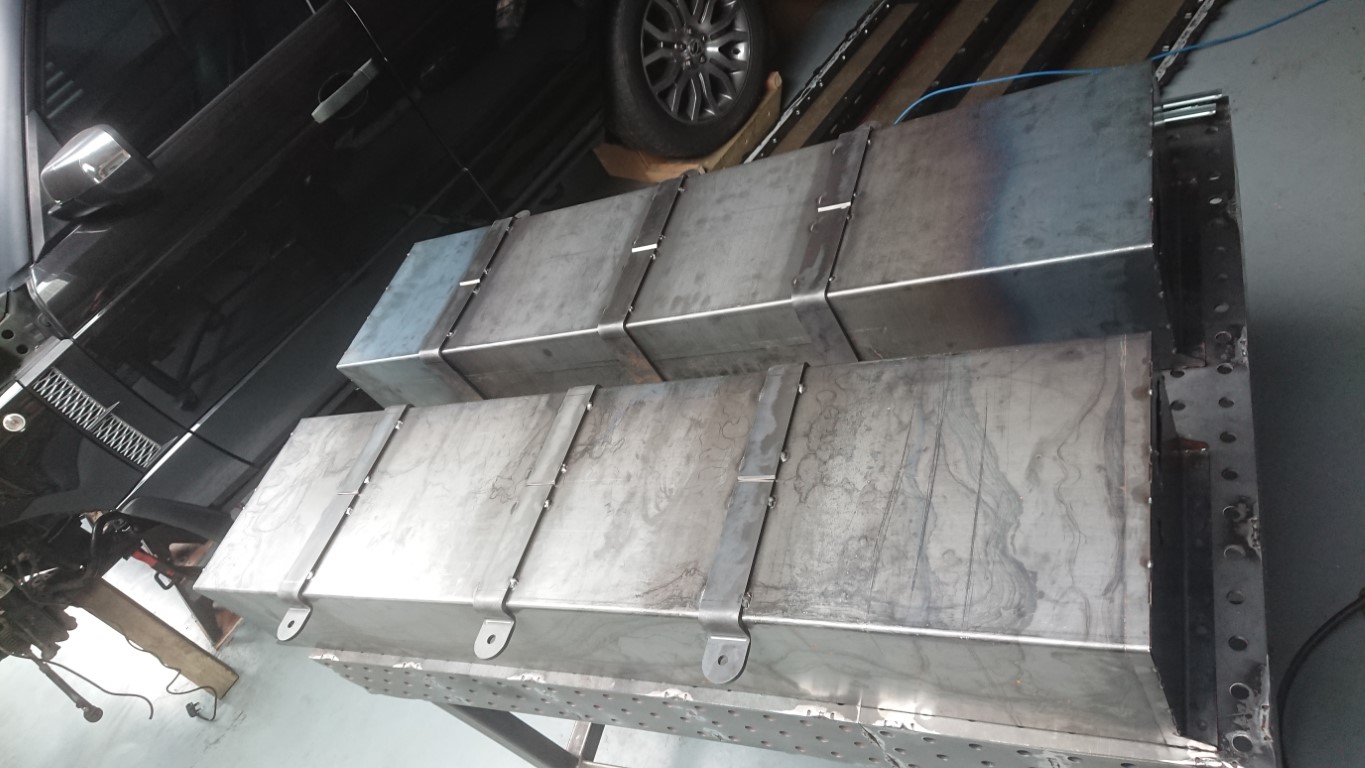

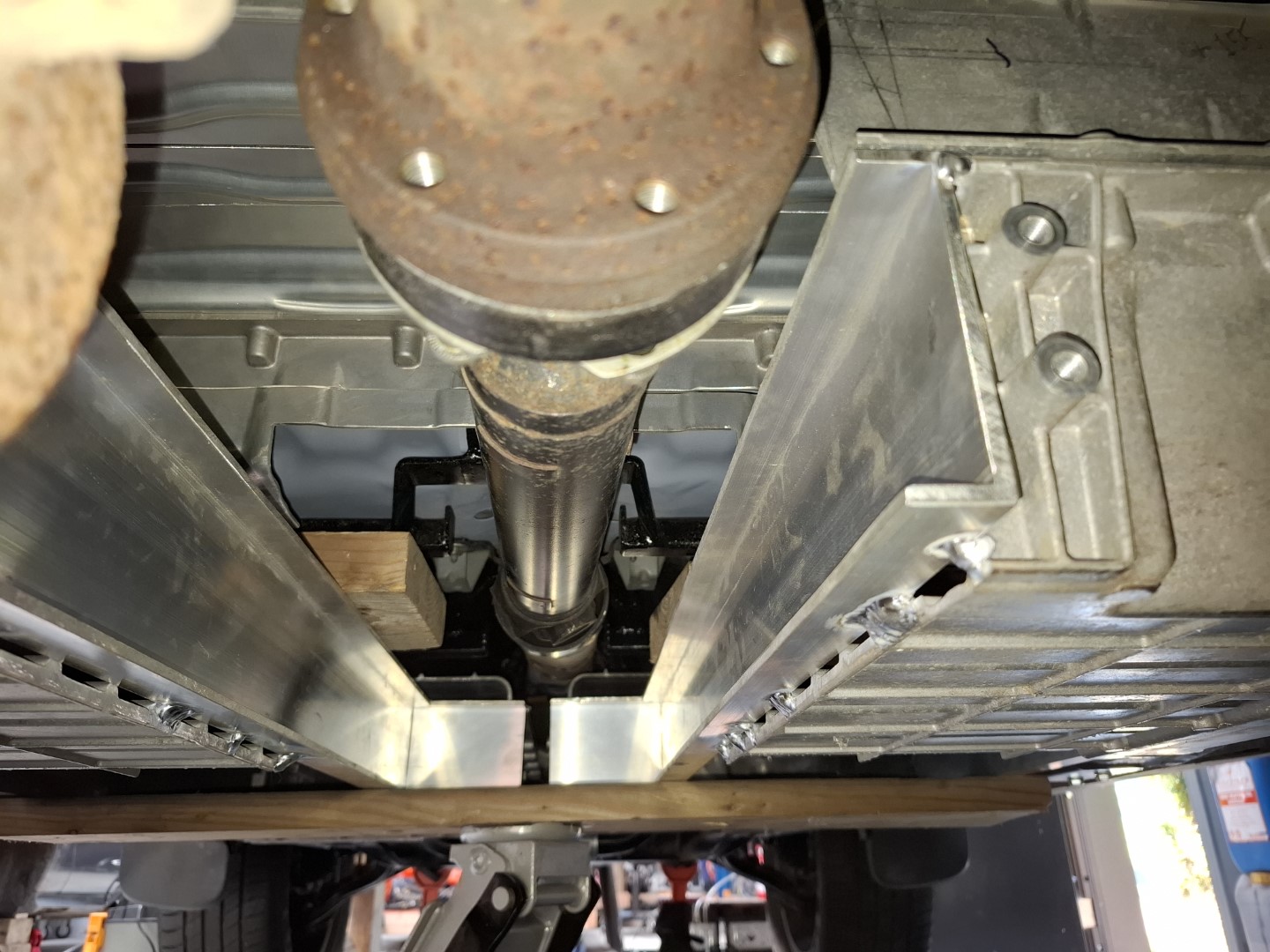

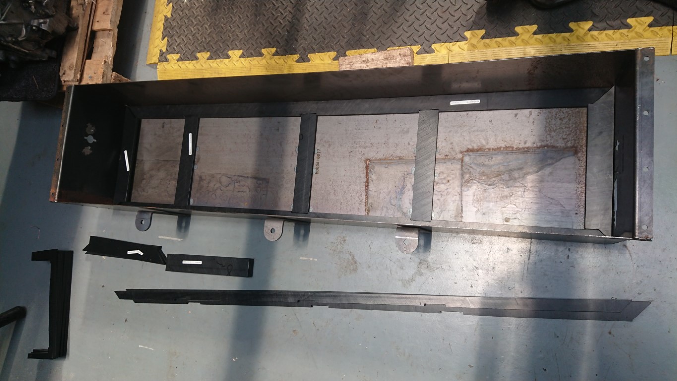

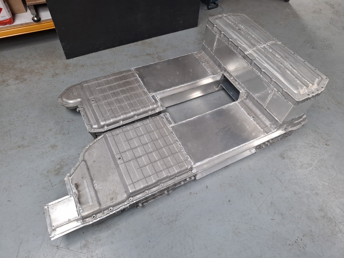

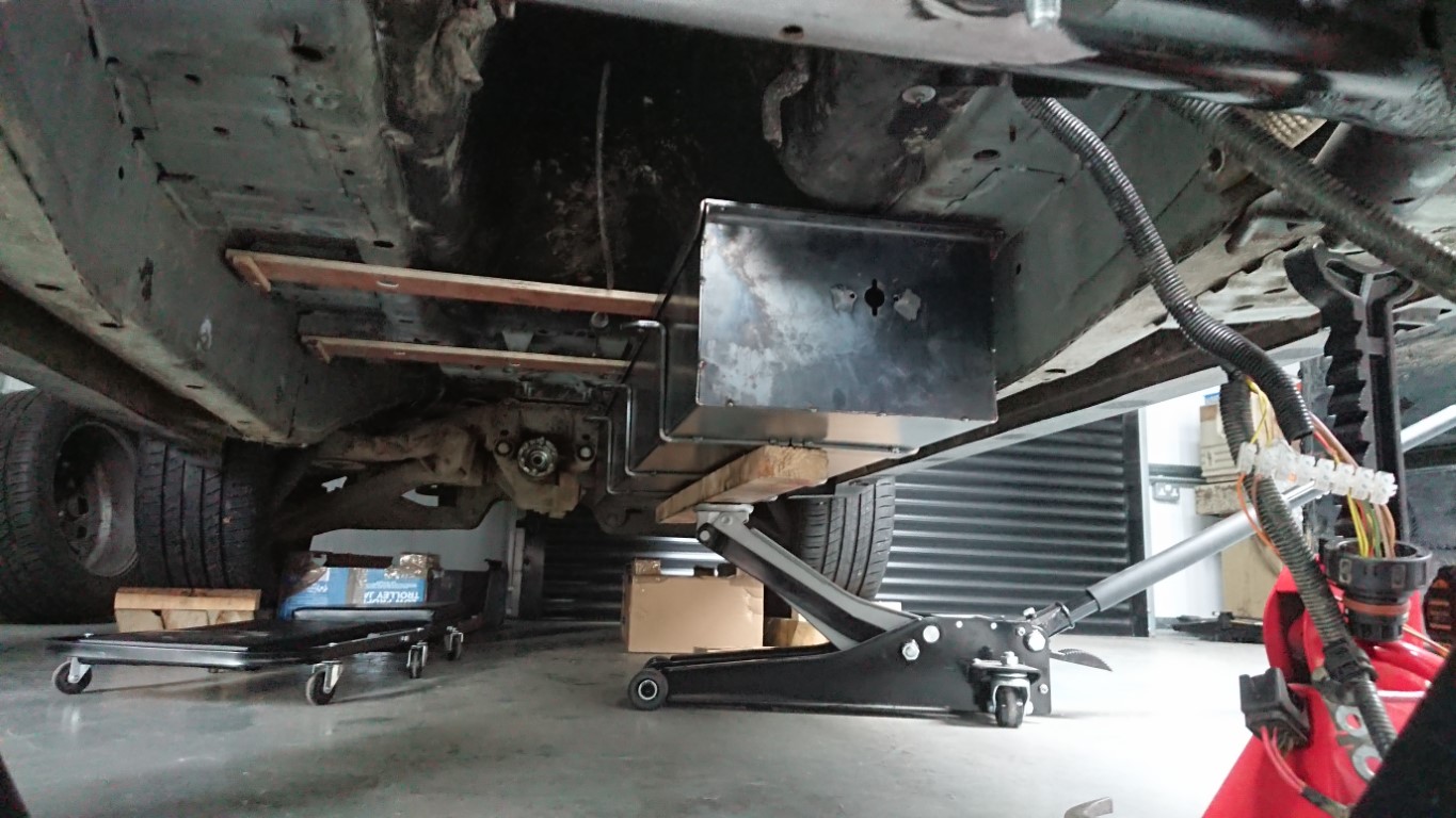

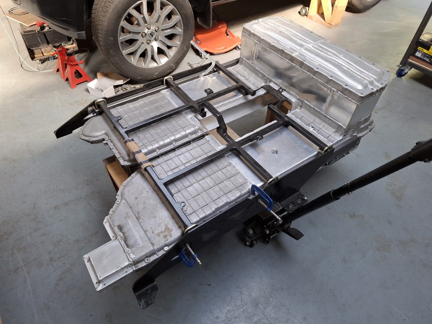

Battery Boxes:
Tacked up the battery boxes to let me check layout and mounting details.
Tried to keep the battery boxes as shallow as possible. They sit below the chassis rails but are not the lowest ground clearance section. The front sub-frame and rear a-arms sit lower, so happy with ground clearance especially with the air suspension. I will look at a protective frame across the front though

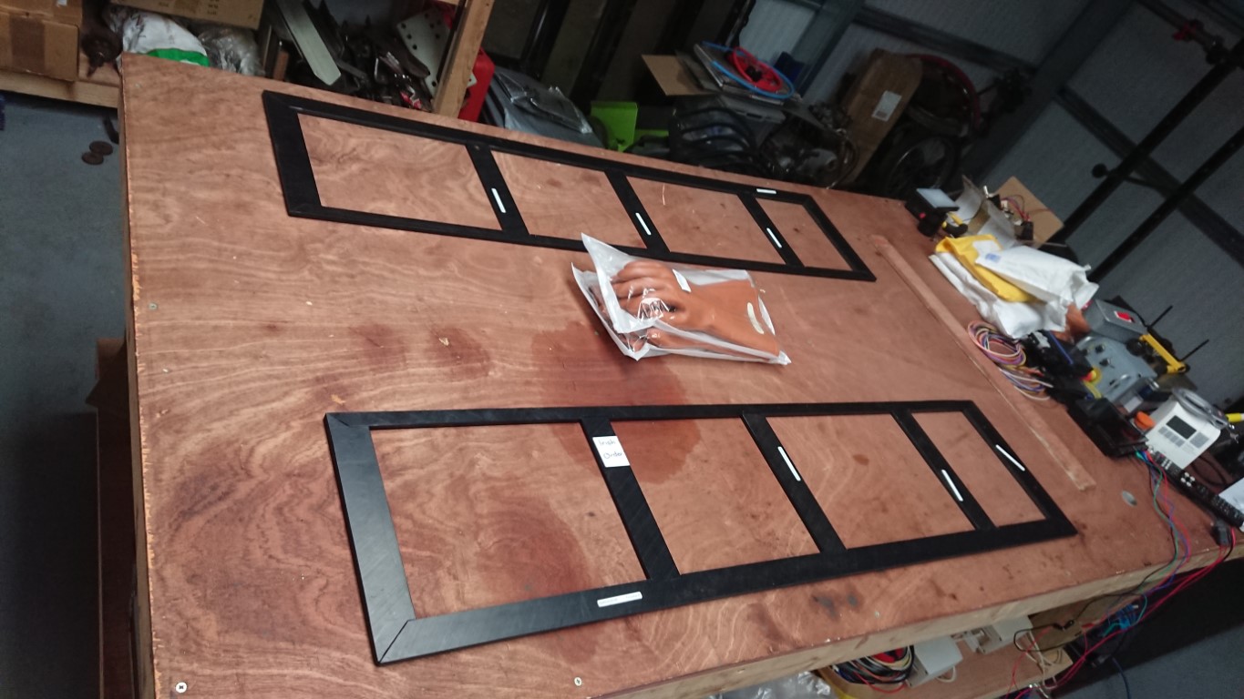

Plan is to mount the battery modules in a profiled plastic support frame that fits together using slot and tab to add rigidity
nkiernan
Posts: 587
Has thanked: 514 times
Been thanked: 95 times
Re: L322 RR Vogue - The beached whale
Post by nkiernan »

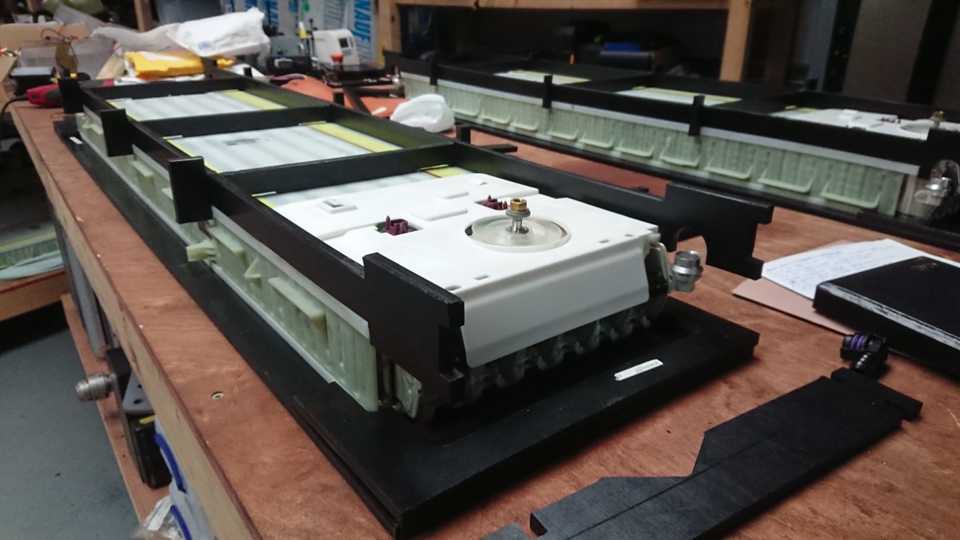

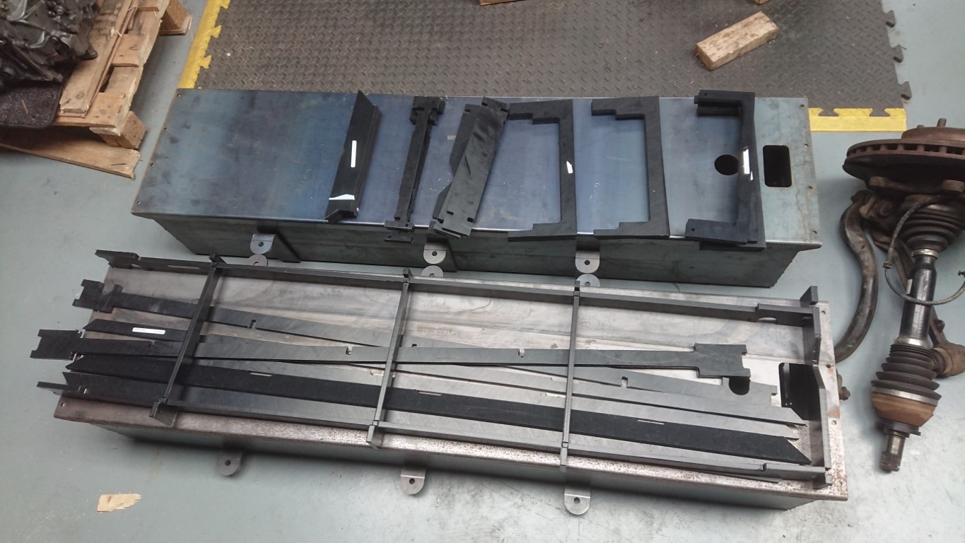

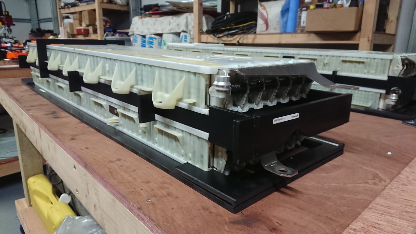

Battery Boxes:
Test fitting the skeleton plastic frame on the battery modules and in the battery boxes. Tight fit all round and the plastic supports line up with the battery box mounting straps intended to hold everything as solid as possible.
A layer of plastics will sit on the base of the battery box to protect the underside of the battery modules. The modules have a structural casing around the outside so this is where the plastic support frame sits stacking the strongest areas and providing clearance across the center
More plastic supports will sit down on top of the top battery module so when the battery box lid sits on top, the battery modules are sandwiched in plasce
Battery connectors will be trimmed back inside the plastic support and then connected to link the modules

hugow93 wrote: Sun Jan 02, 2022 5:41 pm Class Neil! I'll follow this one with interest. Bigger the better. I've a Hilux Surf I'd consider doing when I eventually make it through my current project, so looking forward to seeing what you decide on. Are you still planning to use the 2x GS450h gearboxes?
Well Hugh. The dual GS450H would be tricky to fit and pretty unnecessary for this build I figured, so maybe save that for another project 8-)

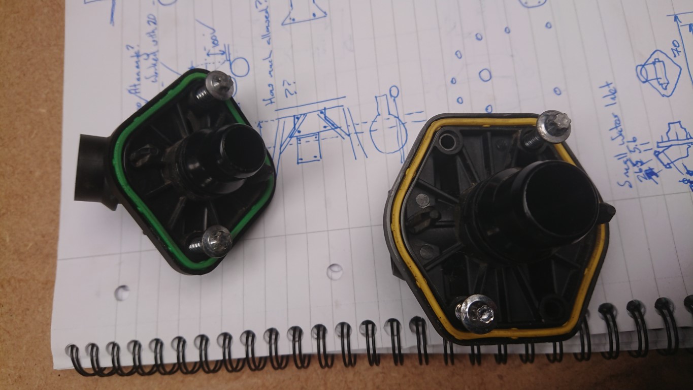

raine wrote: Sun Jan 02, 2022 8:32 pm Nice project. Good work. How are your plans regarding battery thermal management? I am scratching my hair off when considering options regarding isolation, heating and cooling. Obviously, local conditions are different here in Finland where good isolation and heating are on top of my mind. Not sure about cooling. Pls share your thinking with this topic.
Thanks!

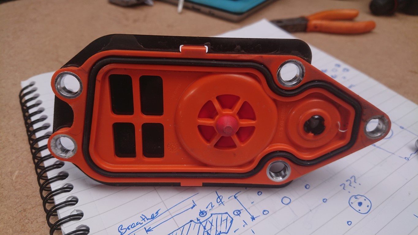

I haven't fully settled on plans for this yet. I have a BMW coolant pump and 6-way manifold with some solenoid valves that could work to turn on/off different heating/cooling loops which was one plan. Have more research to do around heating options.
I didn't realise it was there when I bought the car, but when I started disassembling it, I found an auxiliary webasto fuel fired heater system which is an option on these. This can be set on timers from the car or by remote control to use diesel from the fuel tank to heat coolant. Solenoid valves are used to route around the engine or into the cabin to pre-heat. This is looking like a nice option to test out, fit a small fuel tank and change the control to use temp sensor output to bring on heating if needed.

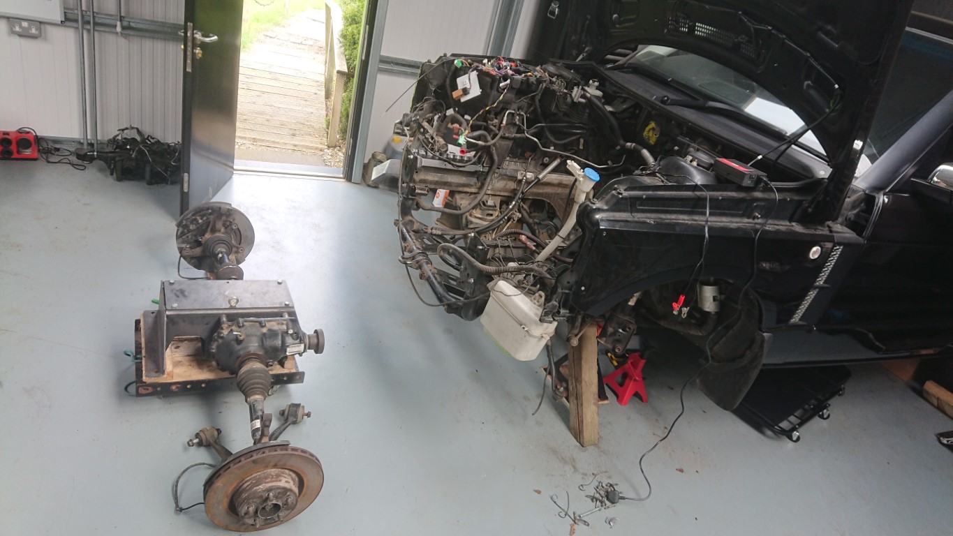

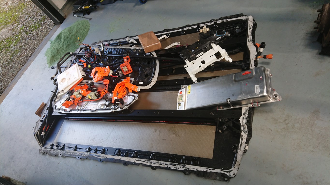

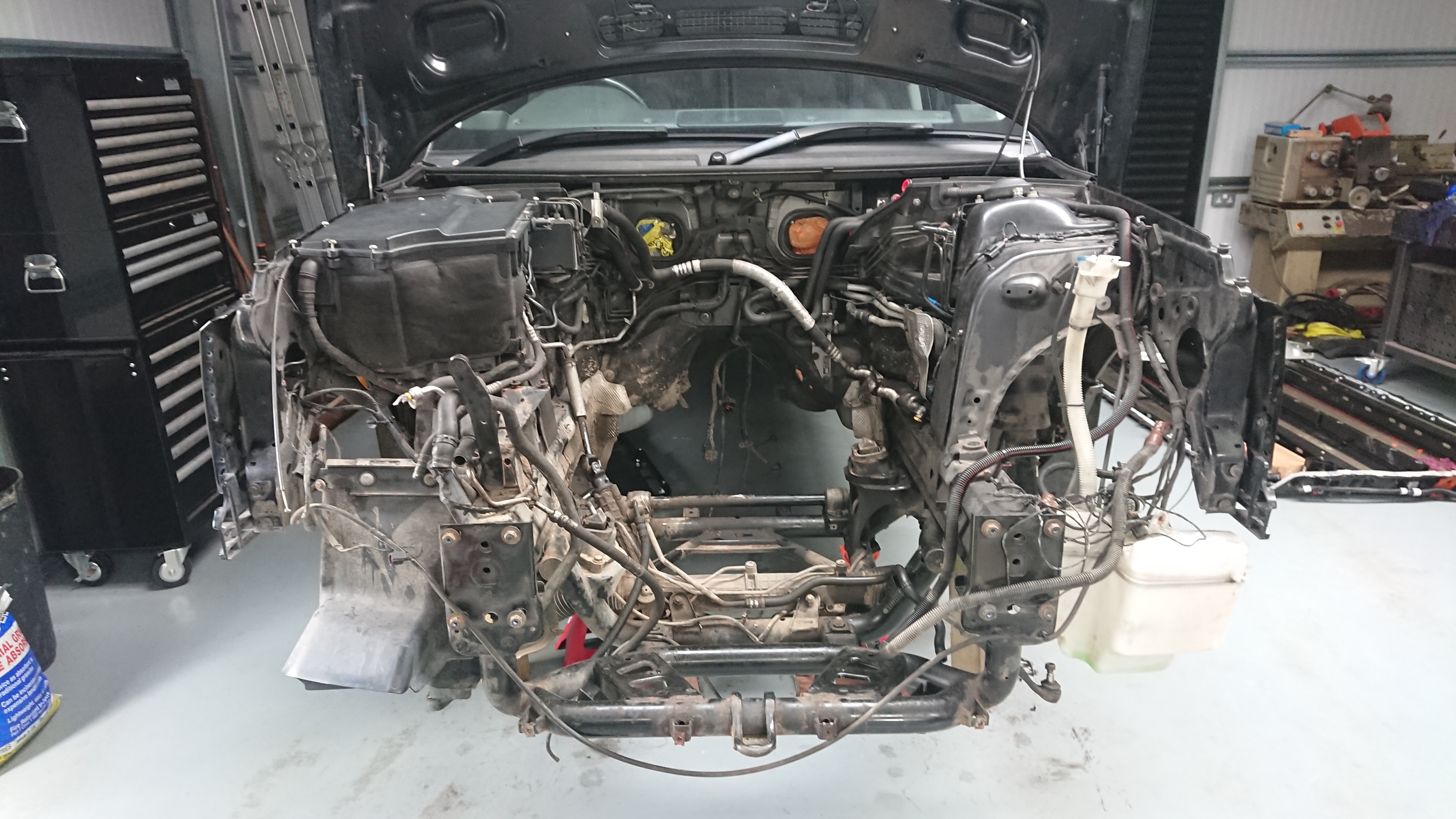

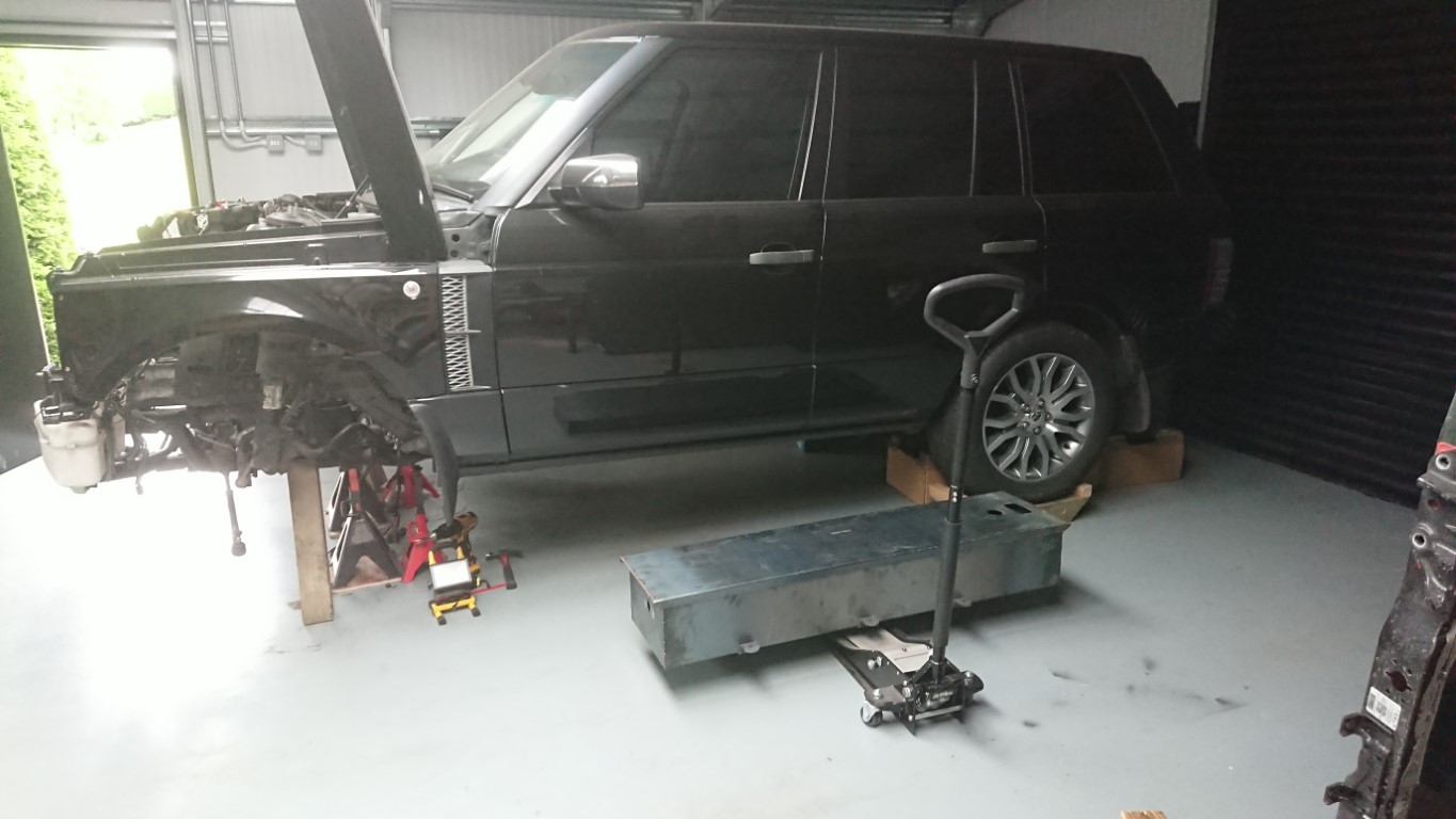

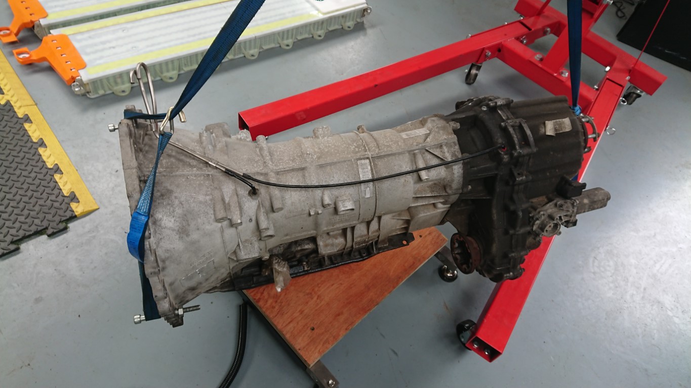

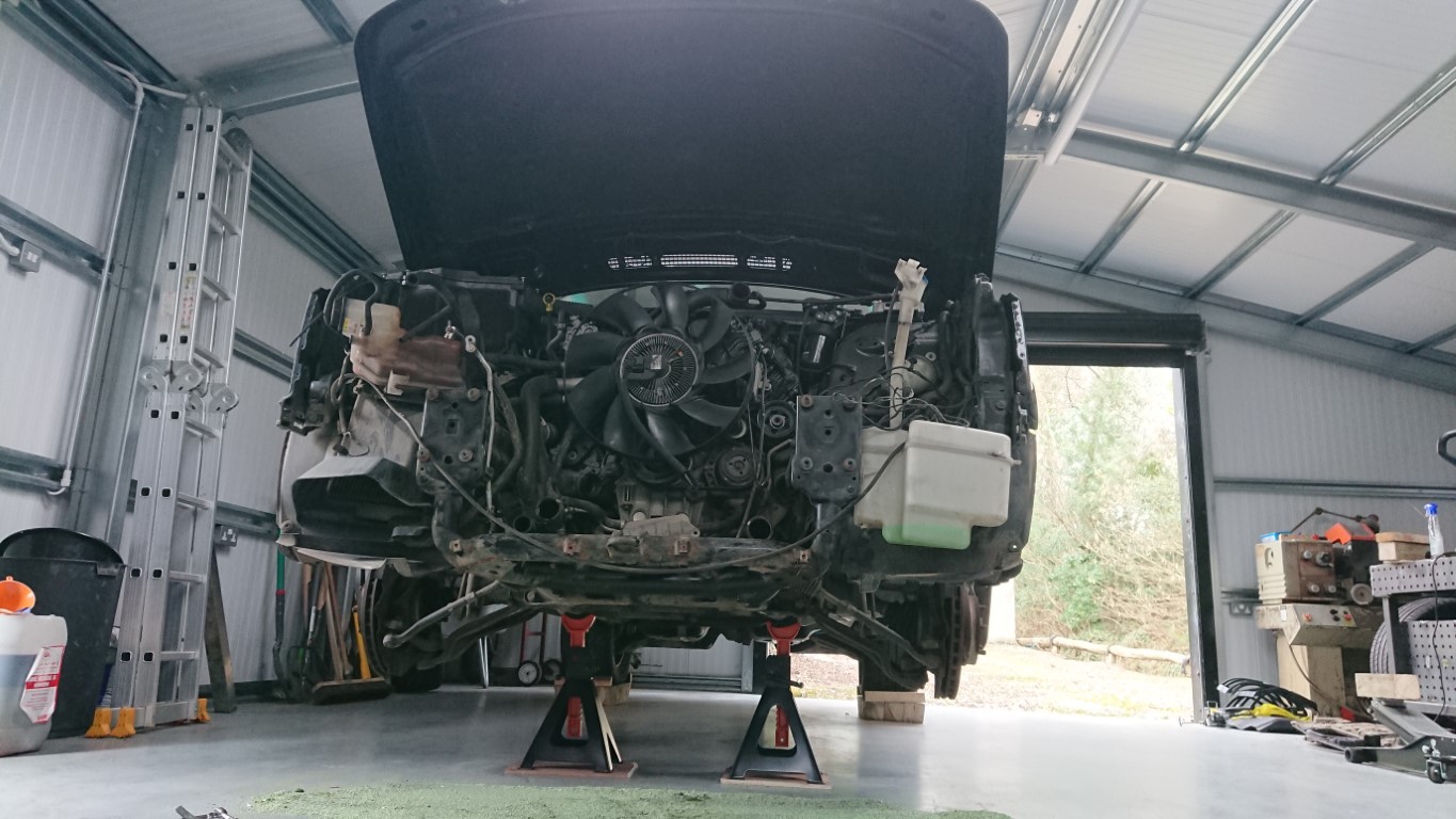

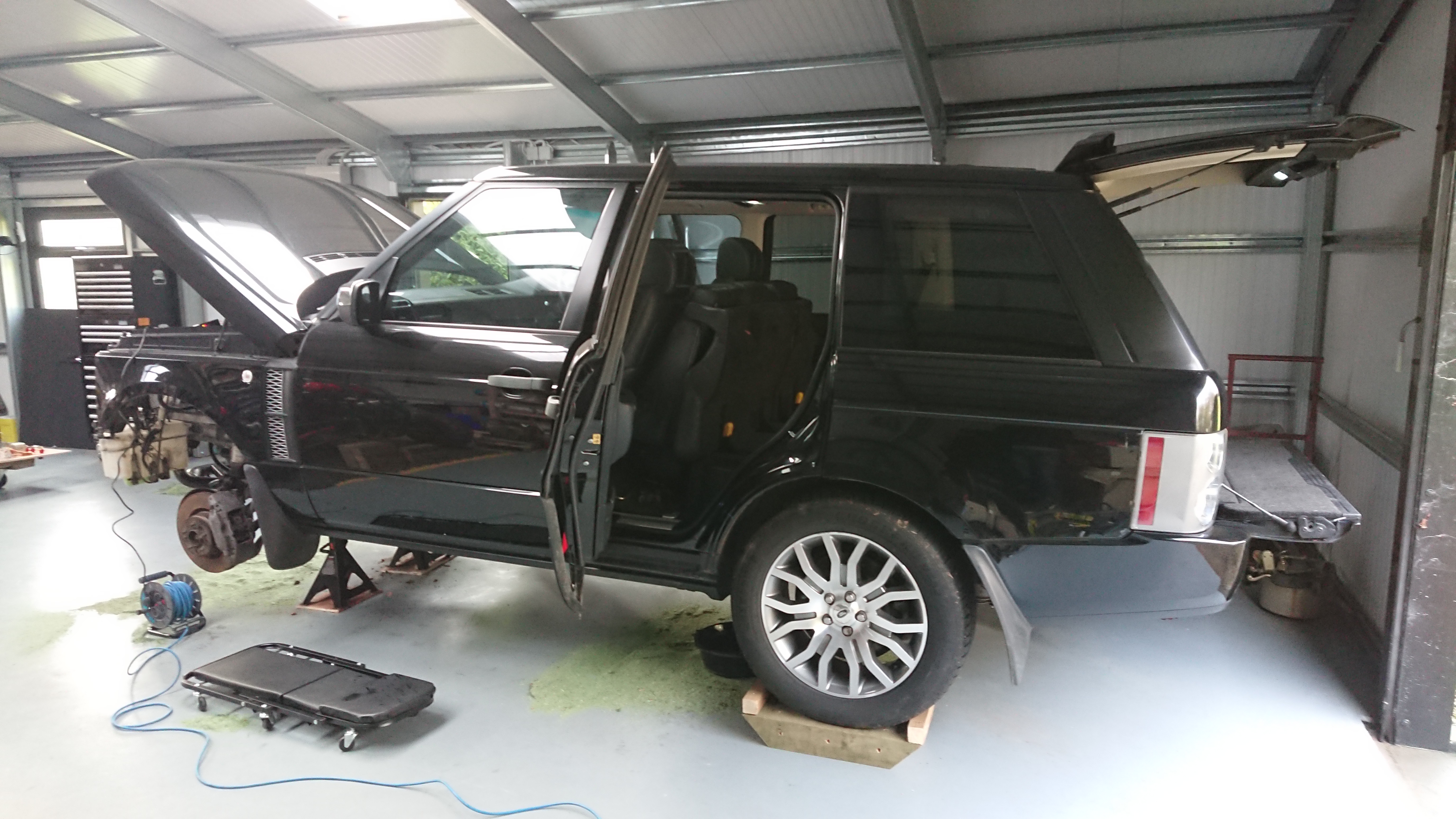

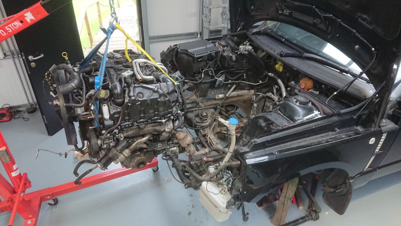

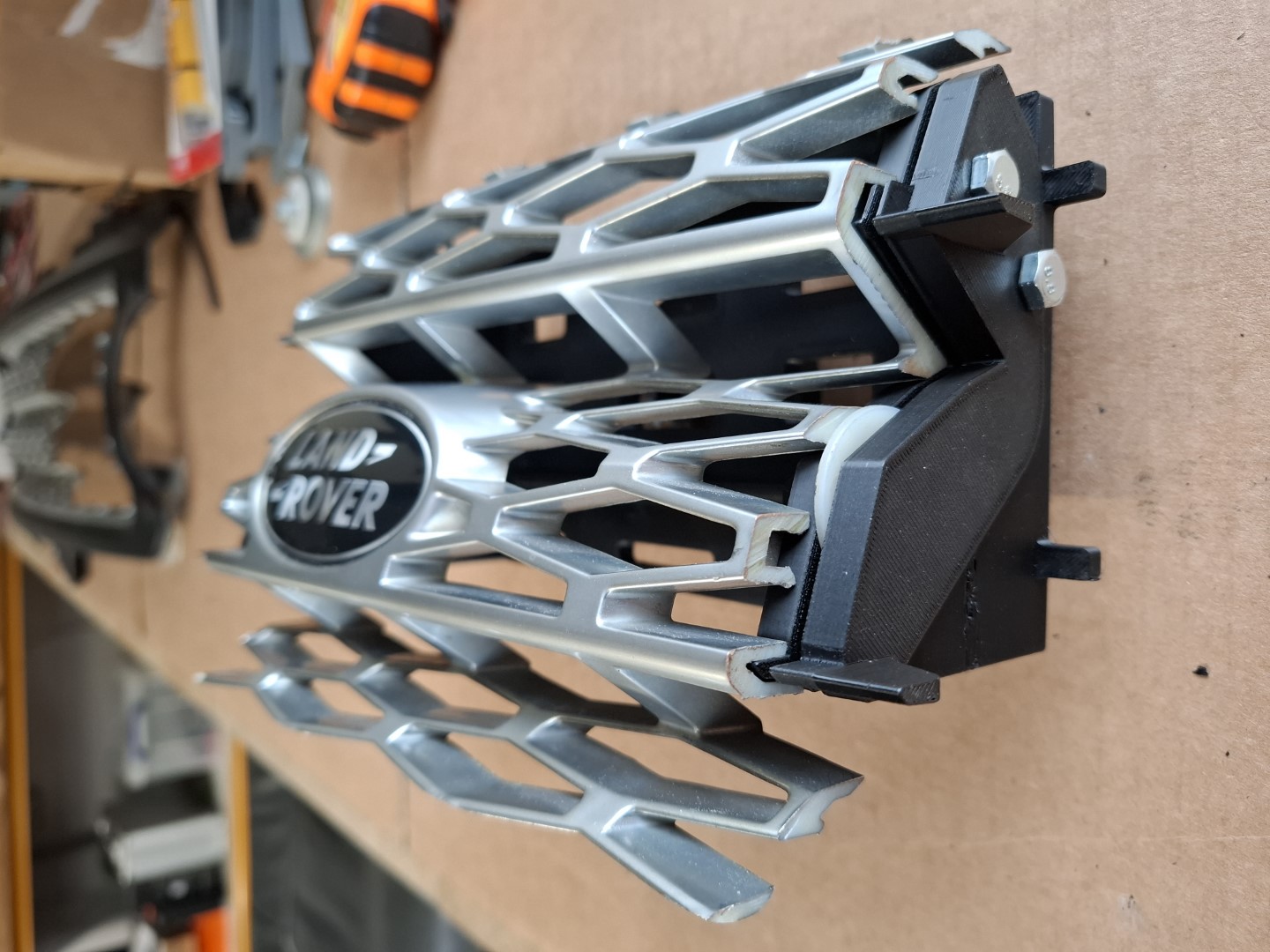

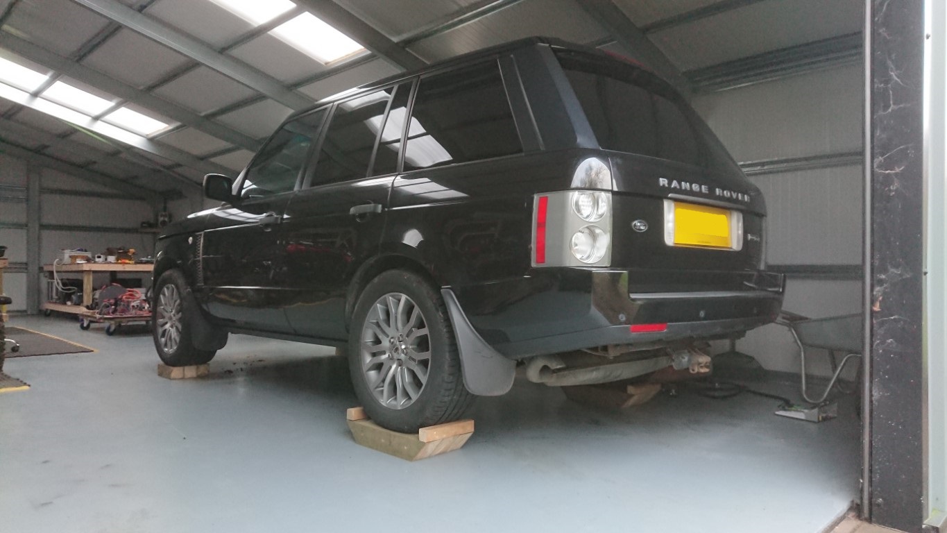

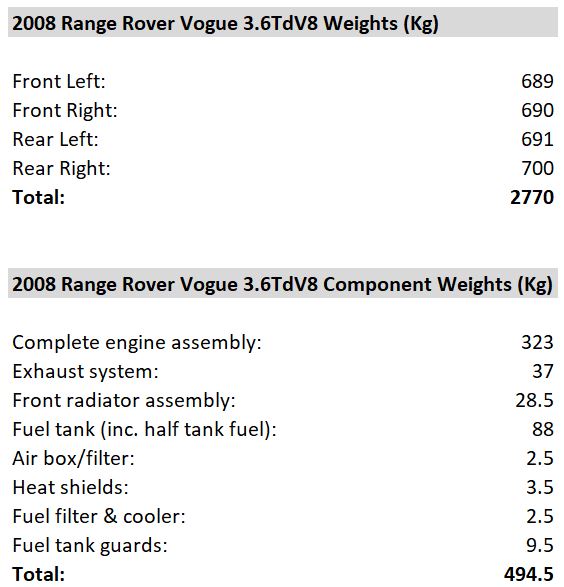

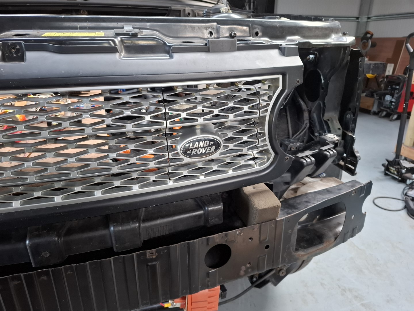

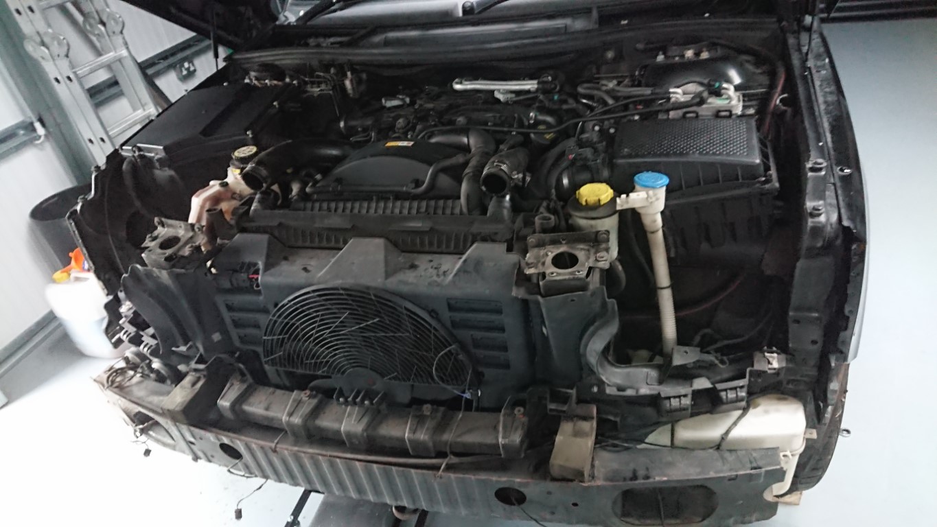

Tear Down:
One thing I didn't anticipate is the amount of parts that can get stripped out and the amount of space they take up! Never removed an engine before so this was a bit of fun, and easy enough on the RRV with the whole front section removable.
The first job was to weigh the car to know where I started, so had to measure each corner once all four wheels were up on the blocks. Then I could weigh each of the main components as they were removed.
Curious to look a little closer at the V8 later on to see if the issue is fixable
Weighing the gearbox and transfer case
Good space left where the fuel tank lived for modular batteries like the IPace in future maybe!

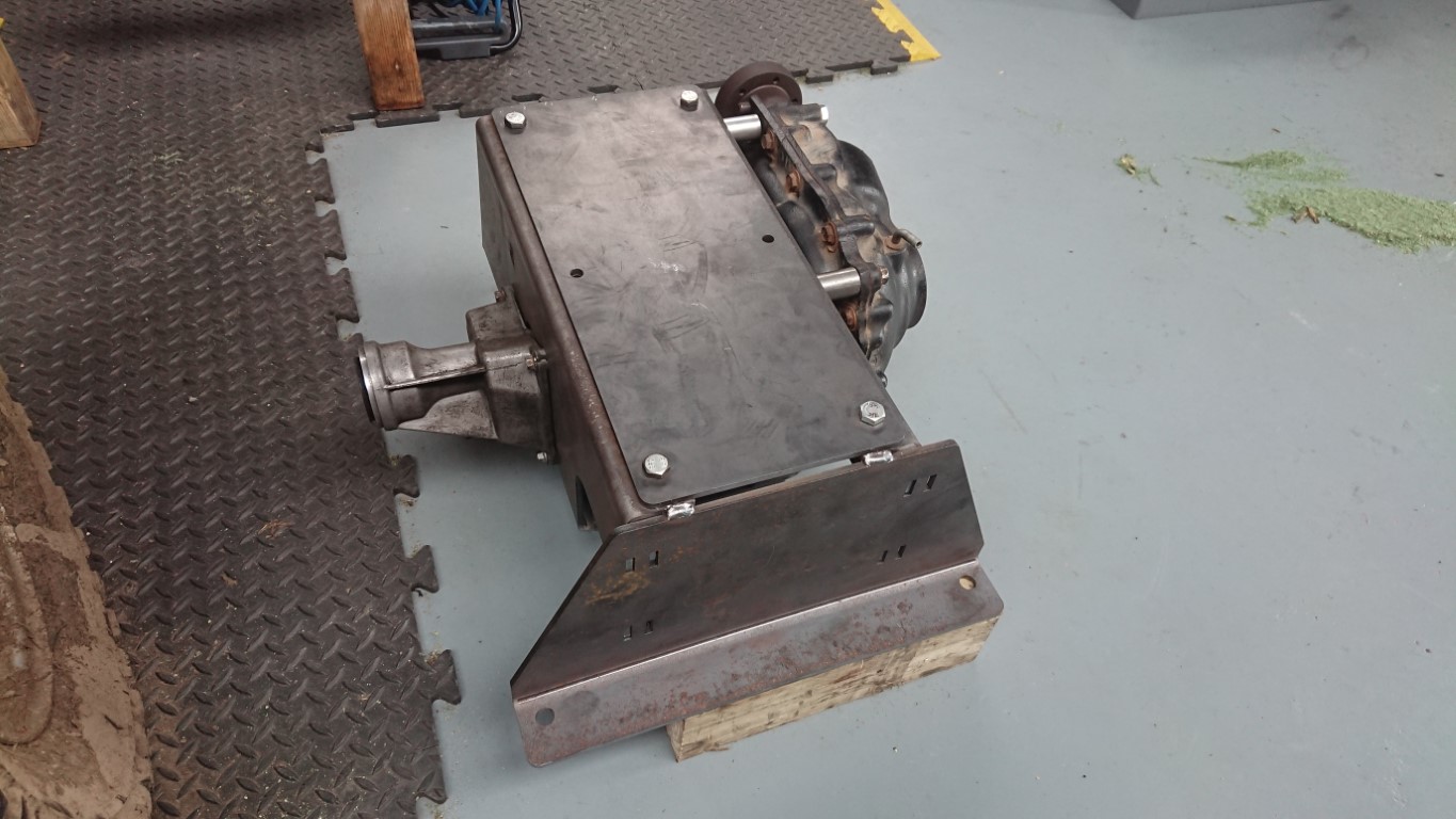

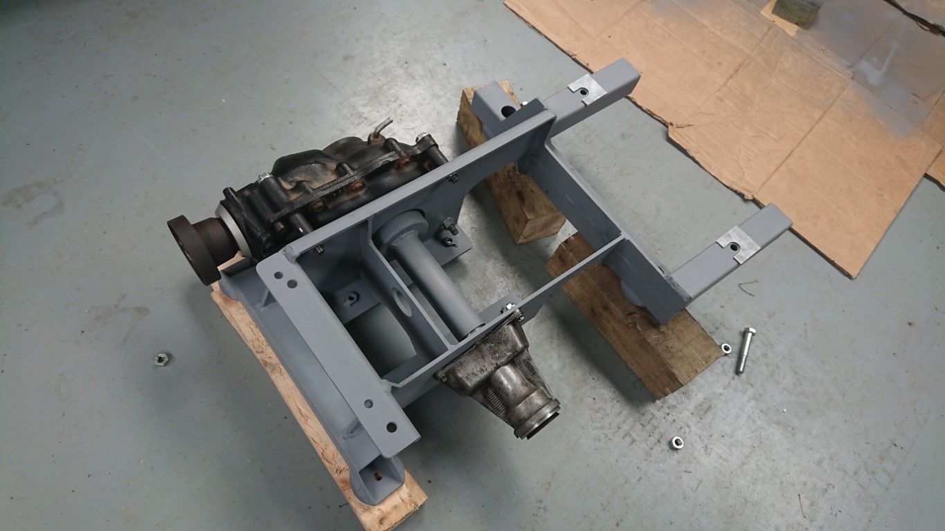

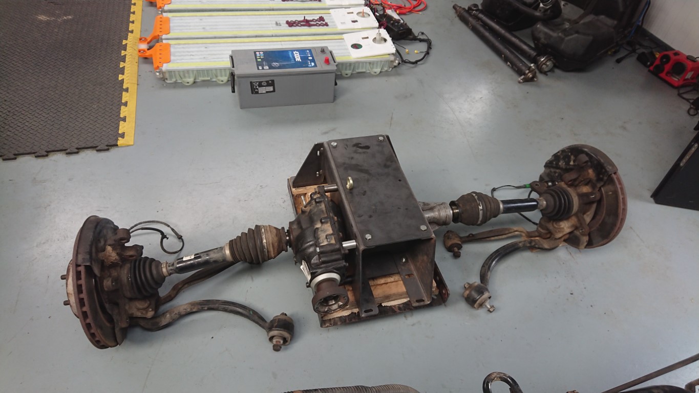

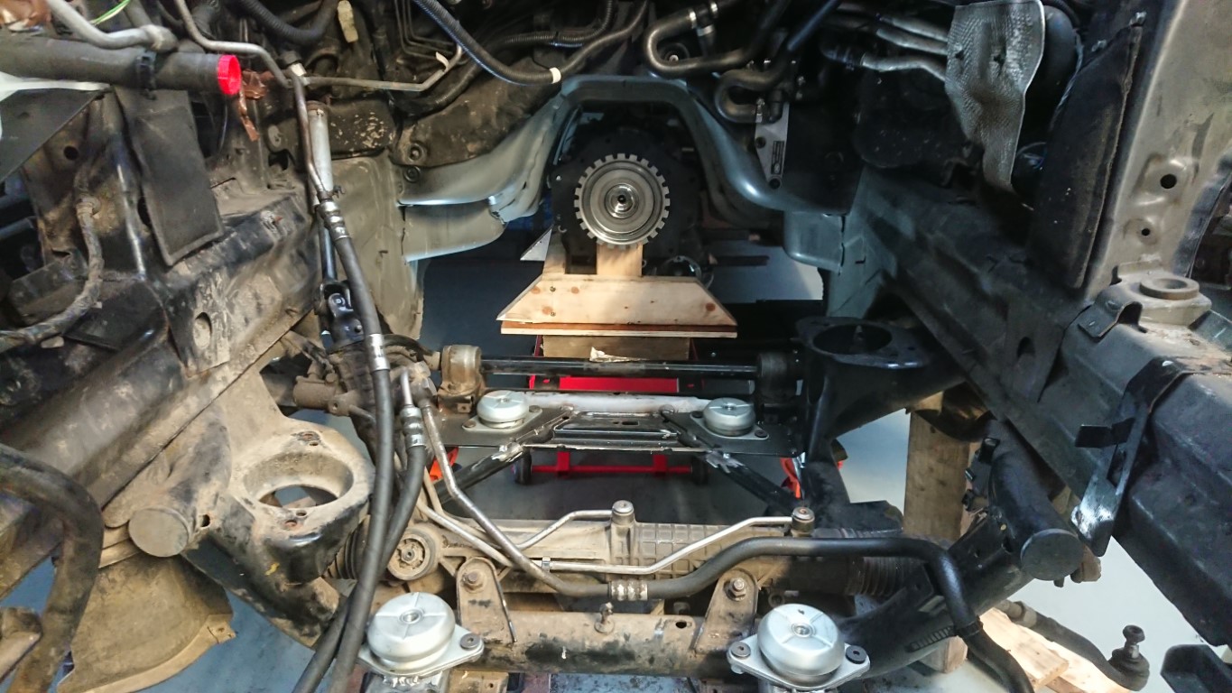

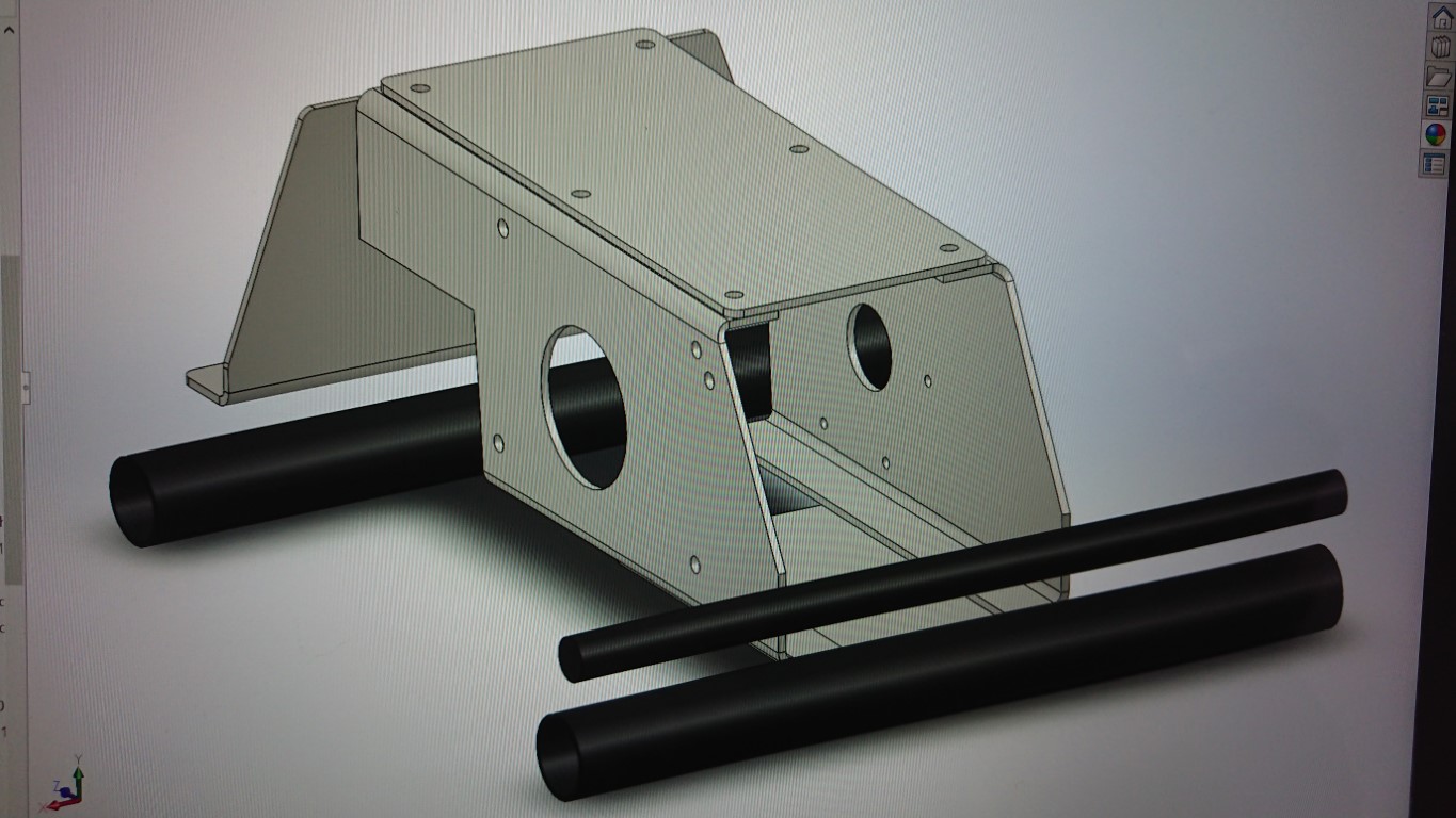

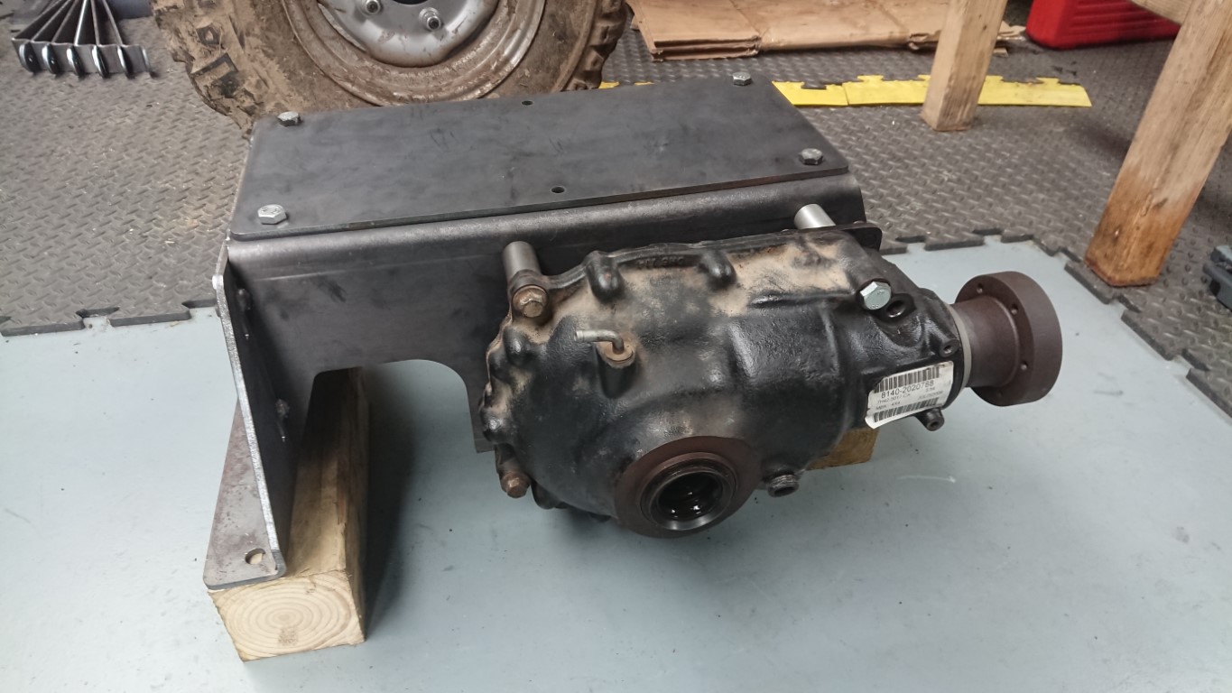

Front Axle Mount:
The front differential and opposite side axle mount fit onto the sides of the engine sump and the axle itself actually threads through the engine sump. So with the engine out, an alternative support was needed for the front diff and axle.
First design (which later went through a few revisions with the grinder!). Picked up on some existing mounting holes and gives clearance around the steering rack. Plan was for the GS450H transmission to mount above the diff mount although alignment to the transfer box was going to be an issue. Original design also mounted direct to the front sub-frame with no anti vibration which I later decided was a requirement!
nkiernan
Posts: 587
Post by nkiernan »

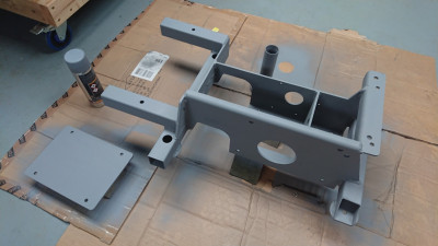

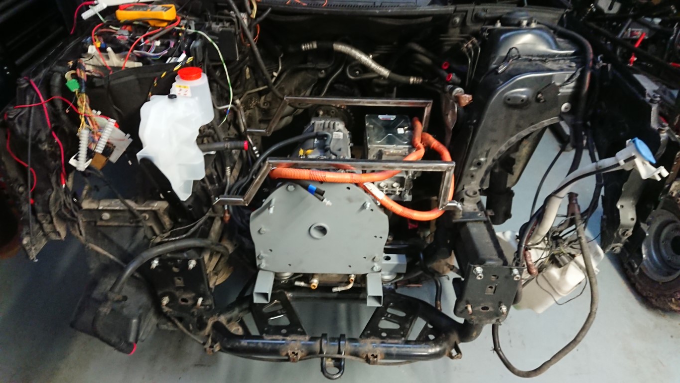

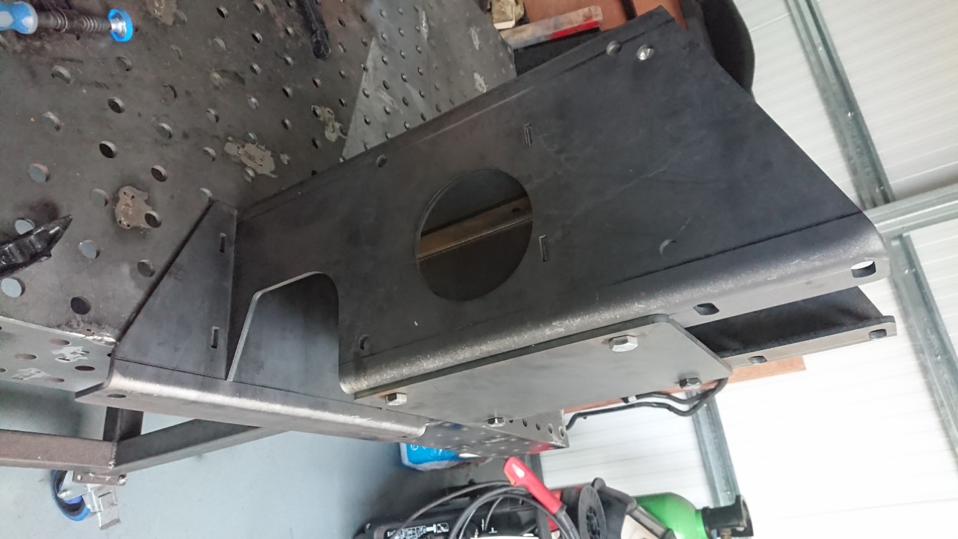

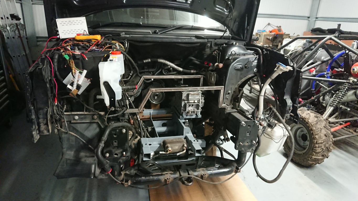

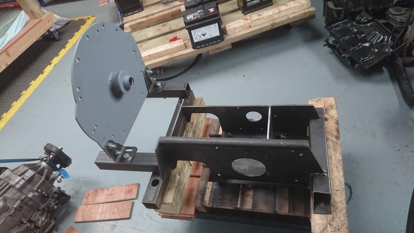

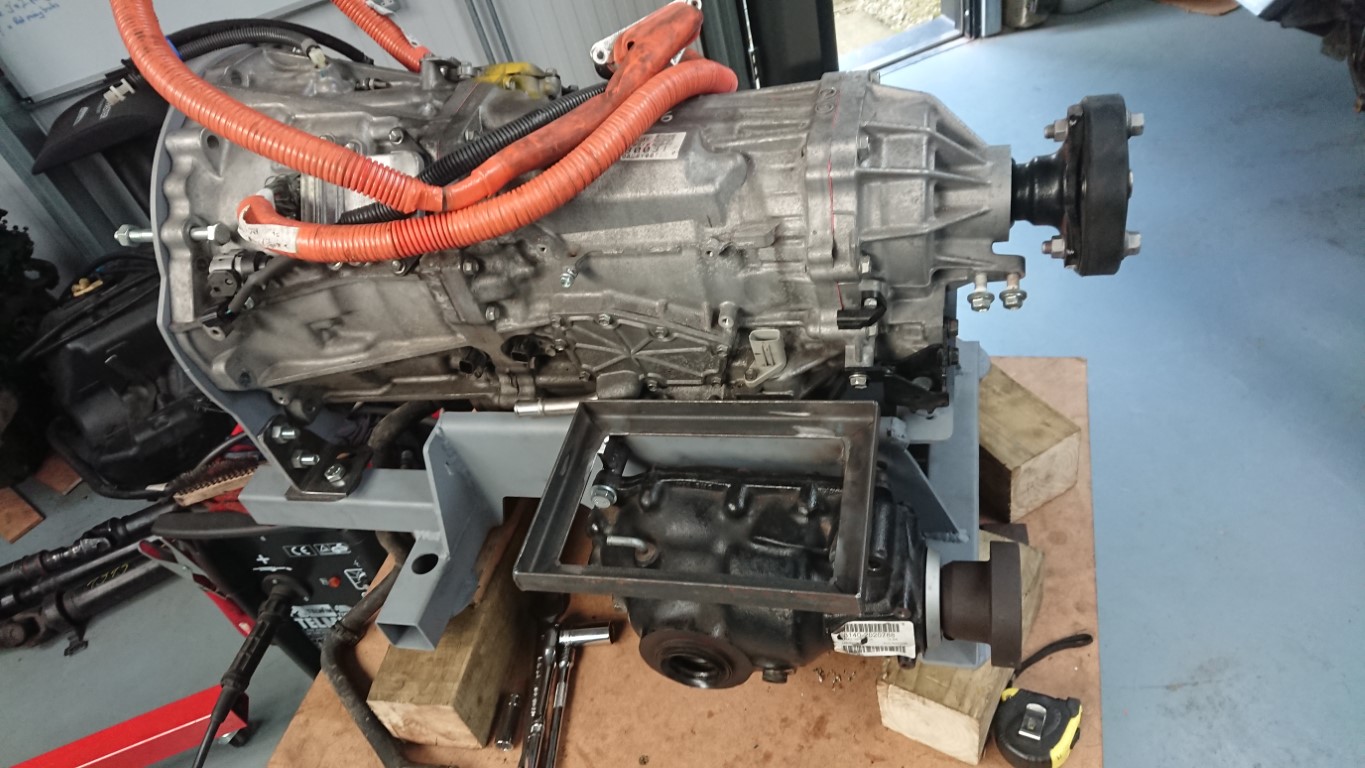

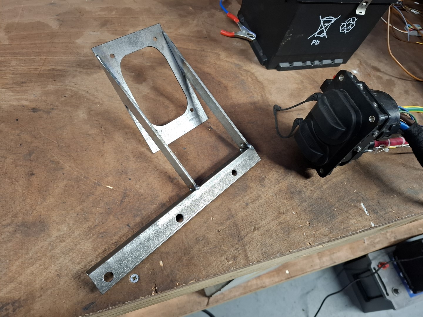

Transmission Mount:
After a little test fitting I decided the misalignment between the transmission and the transfer case could be improved so decided to modify the front diff mount to bring the transmissions as close as possible to where it should be
Adding a mount for the inverter
Final sub-frame design takes the front diff and axle, transmission and inverter to allow a simple single lift in and out
Decided to include anti-vibration mounts for the sub-frame
Looking at a frame to mount above the transmission which would later hold the charger and HVJB. This will also mount on small anti-vibration mounts

You battery box is really nice. Well engineered and done. How much time did it take to do it like that?
nkiernan
Posts: 587
Post by nkiernan »
Ruudi S wrote: Mon Jan 03, 2022 9:22 pm You battery box is really nice. Well engineered and done. How much time did it take to do it like that?
Cheers :) I drew up all the steel and plastic parts in Solidworks and had them all profile cut and the steel folded by suppliers here to save trying to do them manually. This cost a bit more but saved a lot of time and more accurate. I'd like to have made the boxes longer to include space for contractors and to ensure the coolant lines have good clearance but was restricted by the location of the transfer box for now. Waiting on some coolant line adapters and can then see how it all fits. Have a plan to fit small junction boxes on the top rear which will sit in the fuel tank space and house the contractors and fuses. More to follow on that soon
