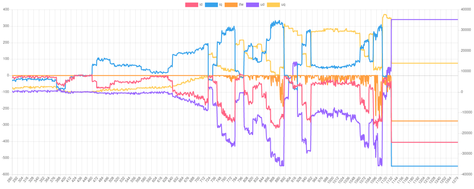

Here's the log file. It was quite tricky to pull the log as everytime i started to log the connection to the inverter got lost. I had to restart it to gain a connection again. With a higher sample rate it happened even more drastically. So i set the sample rate to 500 and included min and max values. Maybe someone got an idea why i keep loosing the connection when pulling logs?
But anyways, here's the best log that i could get for now!

- Posts: 5791
- Has thanked: 157 times
- Been thanked: 1025 times
Re: suggestions for the next release 5.13 -> 5.14
The log file is indeed surprising, despite being a little coarse. The unwanted regen starts in line 15 where frequency drops from 480 to 400 Hz in just 1 second. It then keeps dropping to 314 Hz within another 4 seconds.
In that time iq hovers around -70A so the strong regen current certainly doesn't show as iq. And therefor the FW controller has nothing to work against. But also id isn't very high either, just -43 A average. So the strong current doesn't show up either on iq or id. How is that possible? Even diode conduction should show up.
The process repeats starting in line 29. There we can also see that fw current is commanded to 0.
In all your braveness, can you check how syncadv affects this? Try setting to 15 or so.

Here are 2 more logs:
First run with syncadv 18. Problem is very strong here BUT the car runs VERY powerful
Second run with syncadv 5. Problem doesn't occur at all, but the car is sluggish as hell. No power at all in field weakening.
The run i posted above is with syncadv 12, what i run all the time at the moment. But i'm tending to syncadv 15 but the sudden regen is scary!
Also i discovered when i let go of the accelerator slowly it doesnt occur, just if i get of the pedal quickly!
More test driving today. Problems to be tracked down
I also tried to drive with curkifrqgain=0 and that also works well. With curki=5000 the car becomes sluggish at higher rpm but with curki=15000 it is quite lively again. Maybe even more is good. One speed dependence eliminated, I don't mind.
As for the shock I haven't found a solution yet besides slowly coming off throttle at high rpm, if traffic permits.
- Way too much regen above 4000 rpm. When requesting strong regen you got like 3x what you wanted. Worse at higher speed
- Painful stuttering when requesting regen above 4500 rpm
- Painful shock when transitioning from acceleration to regen above 5000 rpm
Problem 3 now also kind of solved. I correctly implemented the downramp for throttle but most of all the last 3% are ramped with regenramp.
So say you set throtramp to 10%/10ms and regenramp to 0.5%/10ms then the fall from 100% to 3% would happen in 97ms and from 3% to 0% in 60ms. Hmm theoretically, now that I'm writing this I realize the loop resolution is 10ms.
Anyway, even with that the painful shock when quickly coming off throttle is now completely gone. But still, above roughly 6000 rpm there is still the strong unwanted regen. So strong that it blocked the front wheels on a relatively dry road! I have caught that with a plot. Thankfully the hardware trips out and stops the regen mayhem.
During the test drive I had completely disabled regen, so it's pure "phantom" braking. At least the plot now shows what I expected: excessive negative q-current of -550A (0A is control target!). The FW controller tried to counteract by commanding -280A field weakening current on top of the MTPA current. Indeed id reaches -400A but apparently that is not helpful. Remembering that mystery post that was deleted after a few hours, too much id might actually no longer result in field weakening.
fwkp was at -300.
The idea is: if I slowly come off throttle all is good. That's what I want to mimic.
