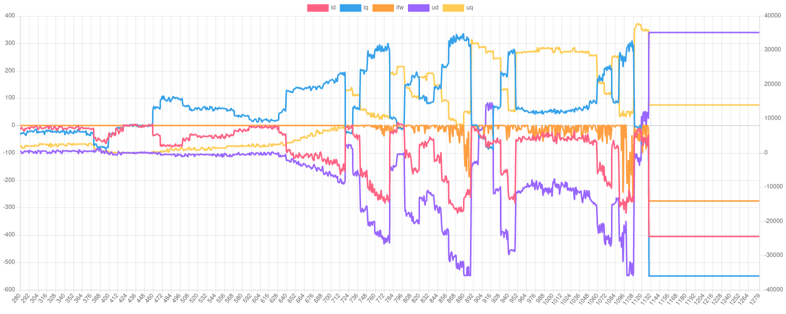

Problem 3 now also kind of solved. I correctly implemented the downramp for throttle but most of all the last 3% are ramped with regenramp.
So say you set throtramp to 10%/10ms and regenramp to 0.5%/10ms then the fall from 100% to 3% would happen in 97ms and from 3% to 0% in 60ms. Hmm theoretically, now that I'm writing this I realize the loop resolution is 10ms.
Anyway, even with that the painful shock when quickly coming off throttle is now completely gone. But still, above roughly 6000 rpm there is still the strong unwanted regen. So strong that it blocked the front wheels on a relatively dry road! I have caught that with a plot. Thankfully the hardware trips out and stops the regen mayhem.
During the test drive I had completely disabled regen, so it's pure "phantom" braking. At least the plot now shows what I expected: excessive negative q-current of -550A (0A is control target!). The FW controller tried to counteract by commanding -280A field weakening current on top of the MTPA current. Indeed id reaches -400A but apparently that is not helpful. Remembering that mystery post that was deleted after a few hours, too much id might actually no longer result in field weakening.
fwkp was at -300.
The idea is: if I slowly come off throttle all is good. That's what I want to mimic.
