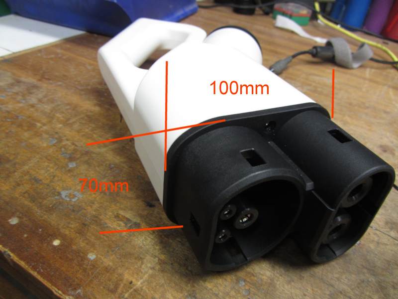

This is a Duosida plug - it's possible that others (e.g. liquid cooled) might be bigger

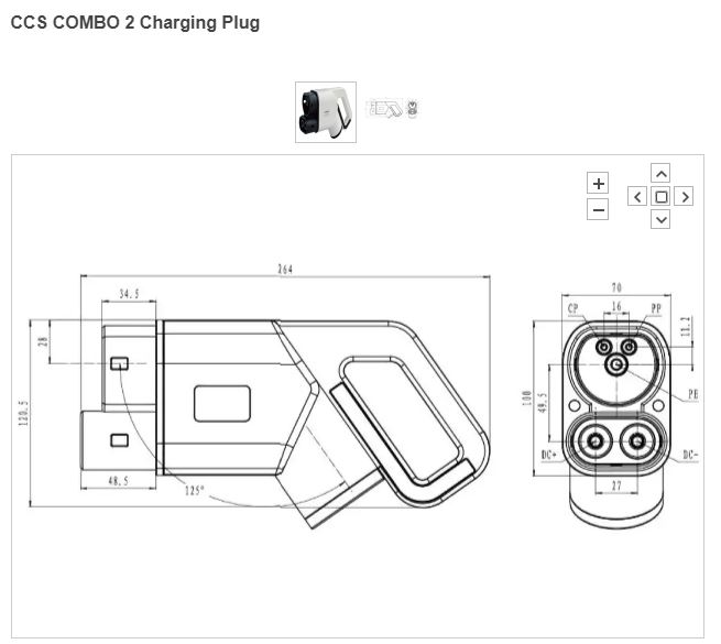

I found this one!
So i guess the standard is 100x70mm...
it' s the DUOSIDA
Damien can you confirm these dimensions? i saw one in one of your movies...
