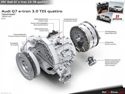

I have a Audi q7 quatro Hybrid gearbox that has a 308Volts 98Kw 3 phase motor
The gearbox Itself wil be controlled with a HTG gearbox controller that can be hooked up to the engine management of the combustion engine via canbus. This controller is open source and has a lot of parameters to fiddle with.
The exact working principle of the electric motor coupled to the rest I’m still studying on, but what I can see from the technical drawing and exploded views is that it consists of a servo actuated dry clutch that can switch between Full electric, full combustion and combo. How that wil work in the end is not clear yet. If it involves some manual intervention, than that is fine as long as it is safe.

The Q7 has a permanently excited synchronous motor according to the service bulletin

I was thinking, 350V on a 308V motor, is only a 12% overload. That will convert into 1st: extra power, thats good. 2nd is more heat. If i upgrade the cooling system, for example bigger radiator and put the electric motor first in line to receive coolant from the radiator, I dont think it wil be damaged long term, what do you think?

Dont think of it as overload. In truth you will almost never use it like this. When you setup your openinverter for the motor to run smoothly it will conform voltage sourcing to motor. What extra V is there you could use for extra RPM. In truth extra power is there but it is short term power and at that you already burn extra amps and heat up motor core.Robthetramplingman wrote: ↑Tue May 11, 2021 2:53 pm I was thinking, 350V on a 308V motor, is only a 12% overload. That will convert into 1st: extra power, thats good. 2nd is more heat. If i upgrade the cooling system, for example bigger radiator and put the electric motor first in line to receive coolant from the radiator, I dont think it wil be damaged long term, what do you think?
Every motor can work at higher voltage, it is up to inverter to appropriate that voltage to smooth out the motor (PWM).

I found out that the prius has a Synchronous motor and the Audi Hybrid as well so that should be a match
