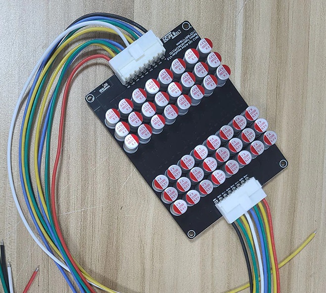

I have found this active balansing BMS
I think i will buy capacitive version for 8S just to see how they work.
https://www.aliexpress.com/item/1005002 ... 0031639067

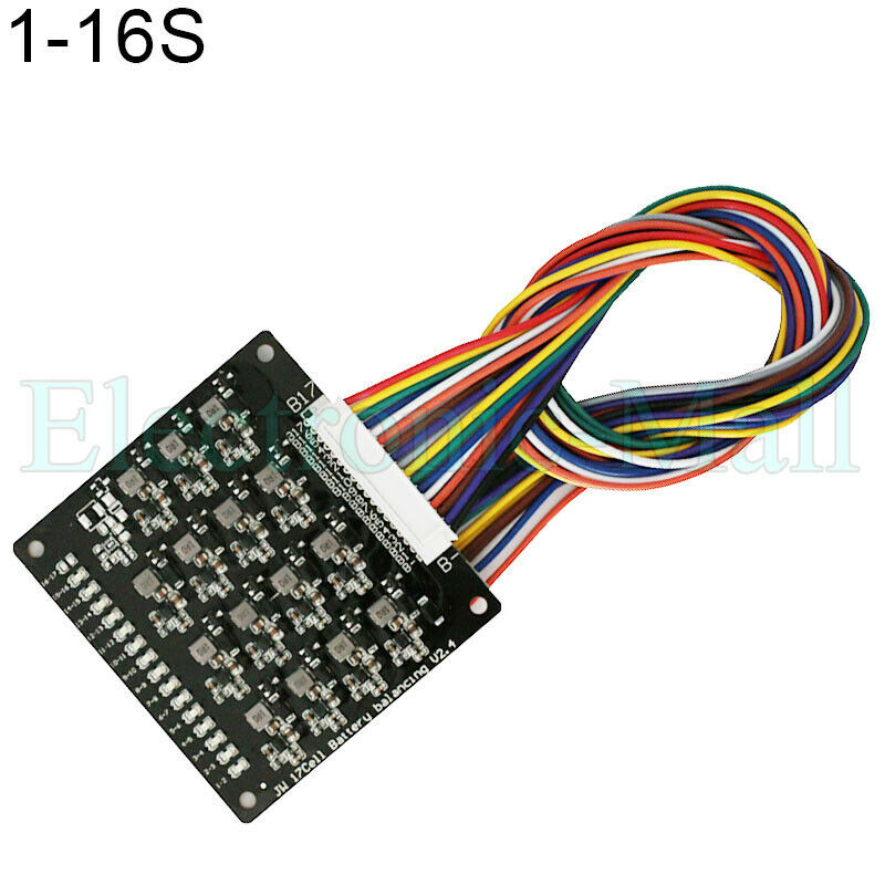

Ok, i ordered one 16S board of latter inductive BMS board. It is supposed to balance with 1.2A. I choose inductive type over capacitive type because it takes less space. But i am also willing to test the larger capacitor variant. That should balance at 5A which is a lot!arber333 wrote: ↑Wed Jul 14, 2021 3:06 pm I have found this active balansing BMS
Then there is inductive Active BMS too.
https://www.aliexpress.com/item/1005002 ... 0006025309
I think 16S is best for me. At least i have some cells to draw my average from. If this is successful i will order 6 boards and complement them to my BMS board.

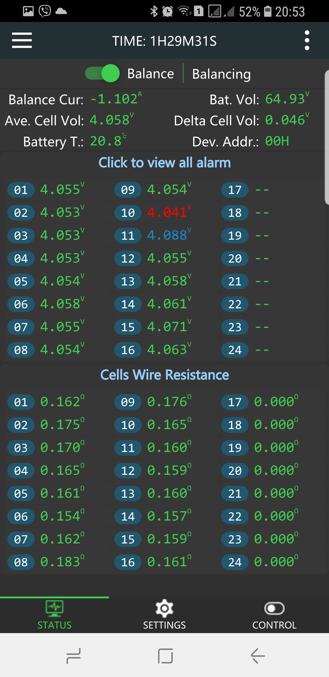

I've been using an ANT BMS on one ebike and a Daly on the other for over a year with no issues. Whether I would trust one with my car pack is a different thing. Maybe If it was only monitoring the voltage of each cell and not controlling the load I might consider it.LRBen wrote: ↑Sun Apr 25, 2021 2:15 pm I used an aliexpress ANT BMS for my 48v quad bike. It died with a charge mosfet error after about 4 months and maybe two charge cycles.
Currently using a more expensive Daly BMS from aliexpress for that bike now.
But I'm not sure I would trust anything from aliexpress for a car sized battery.
Tony from Vorteks on Youtube is the expert on ANT BMS

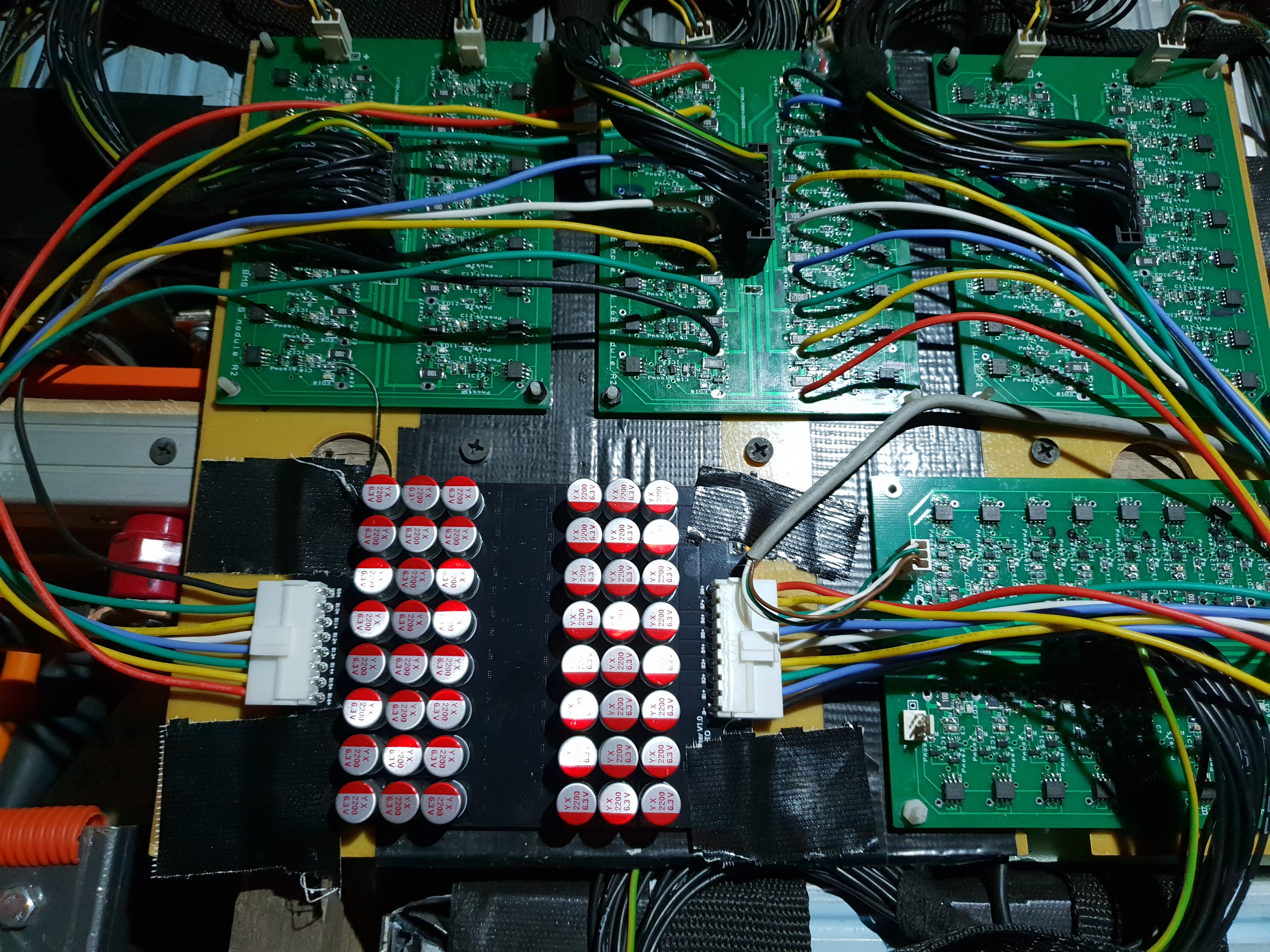

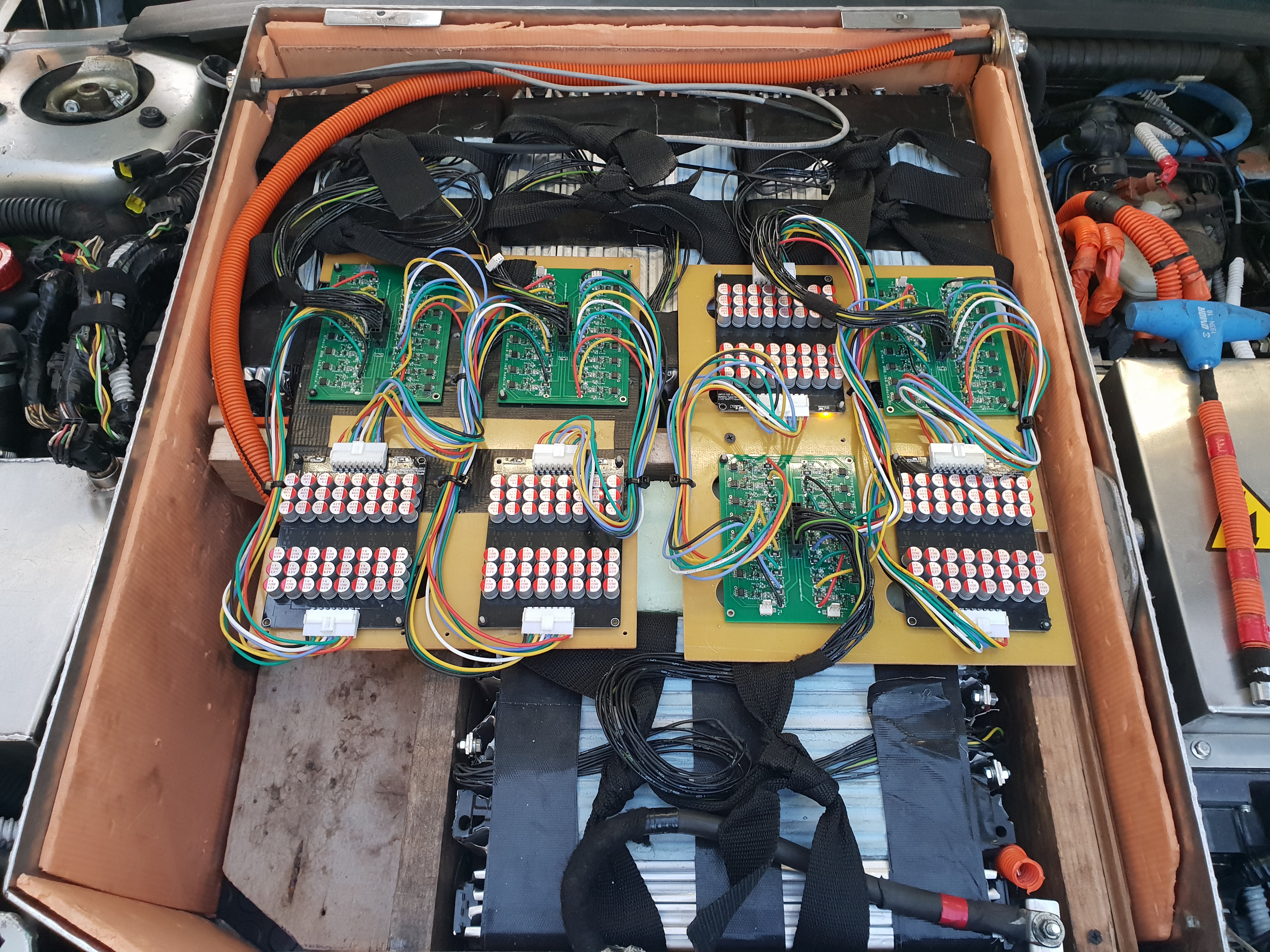

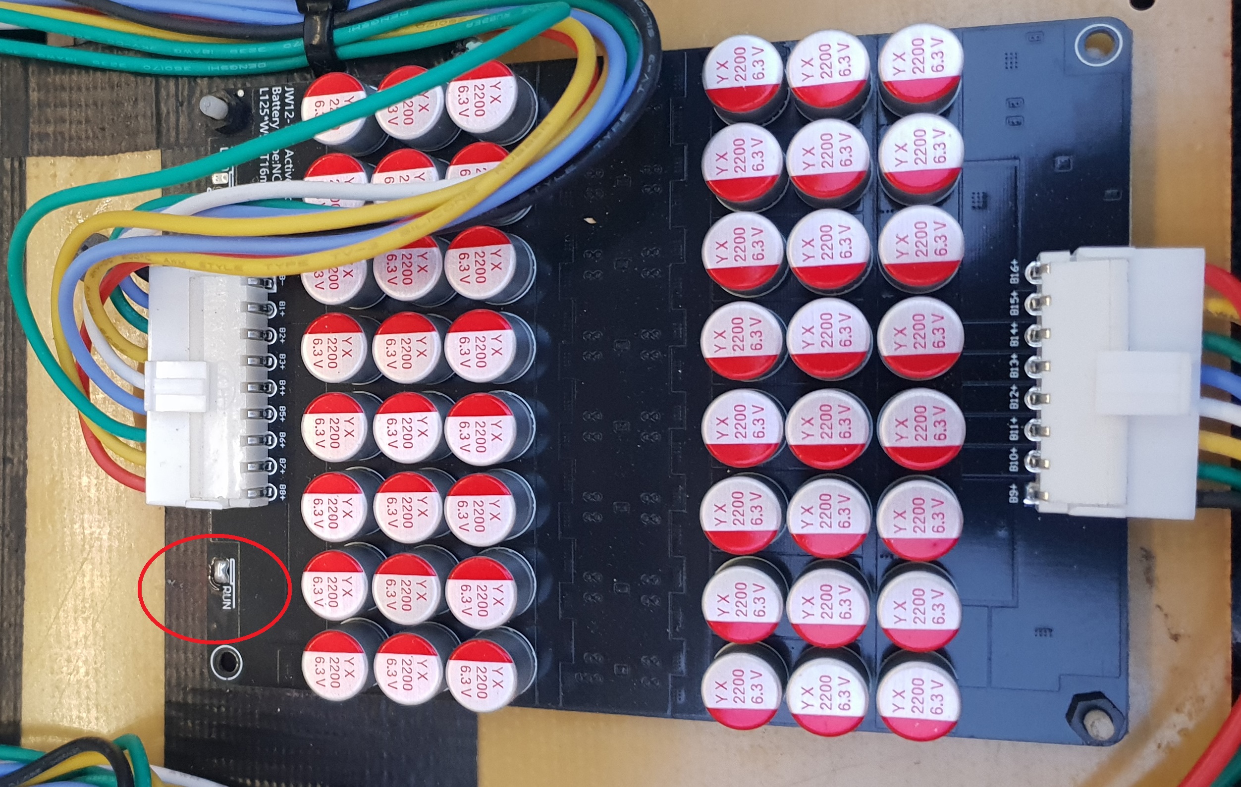

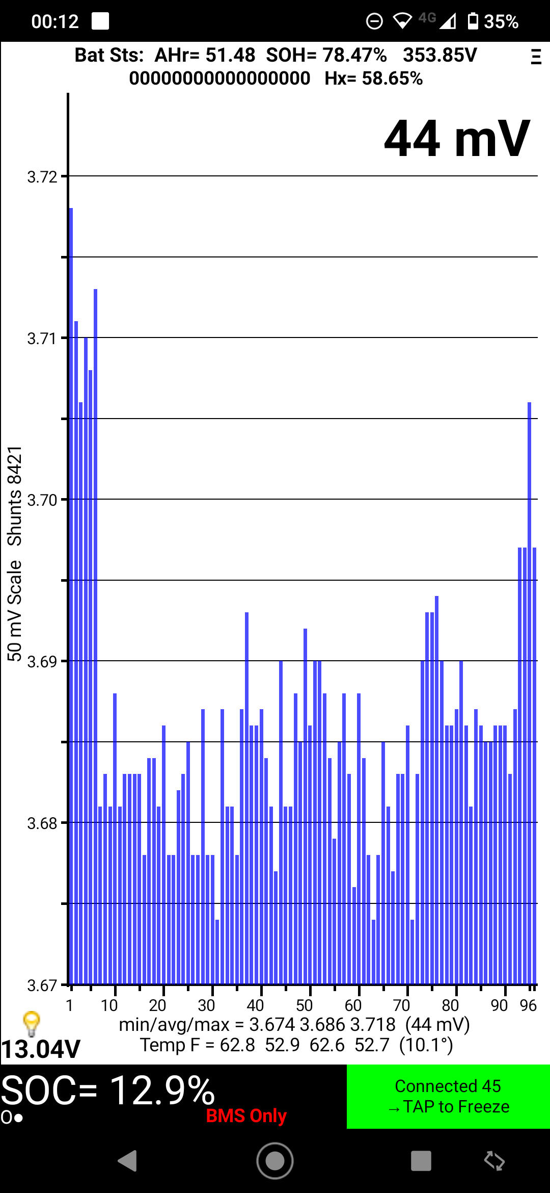

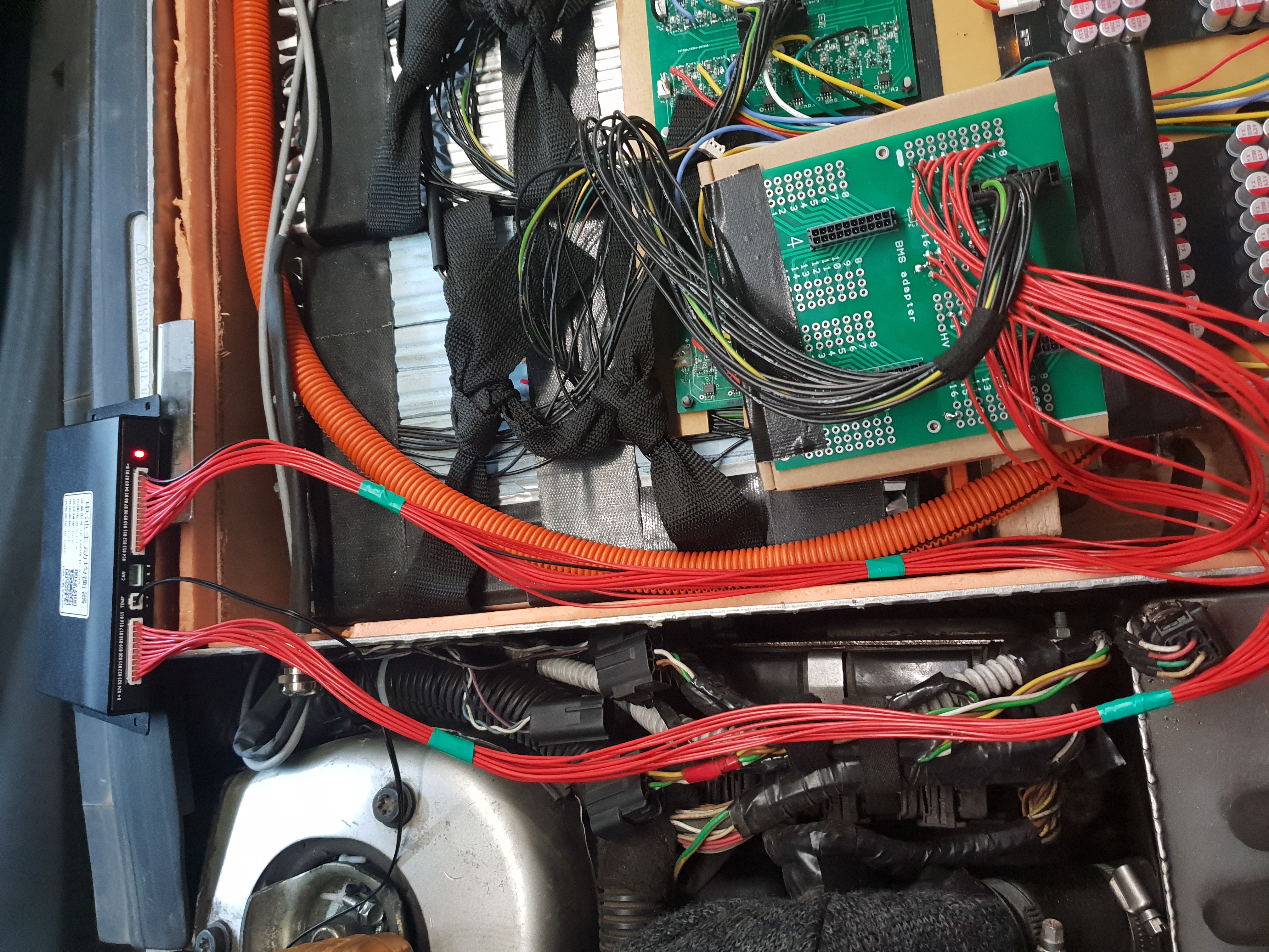

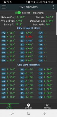

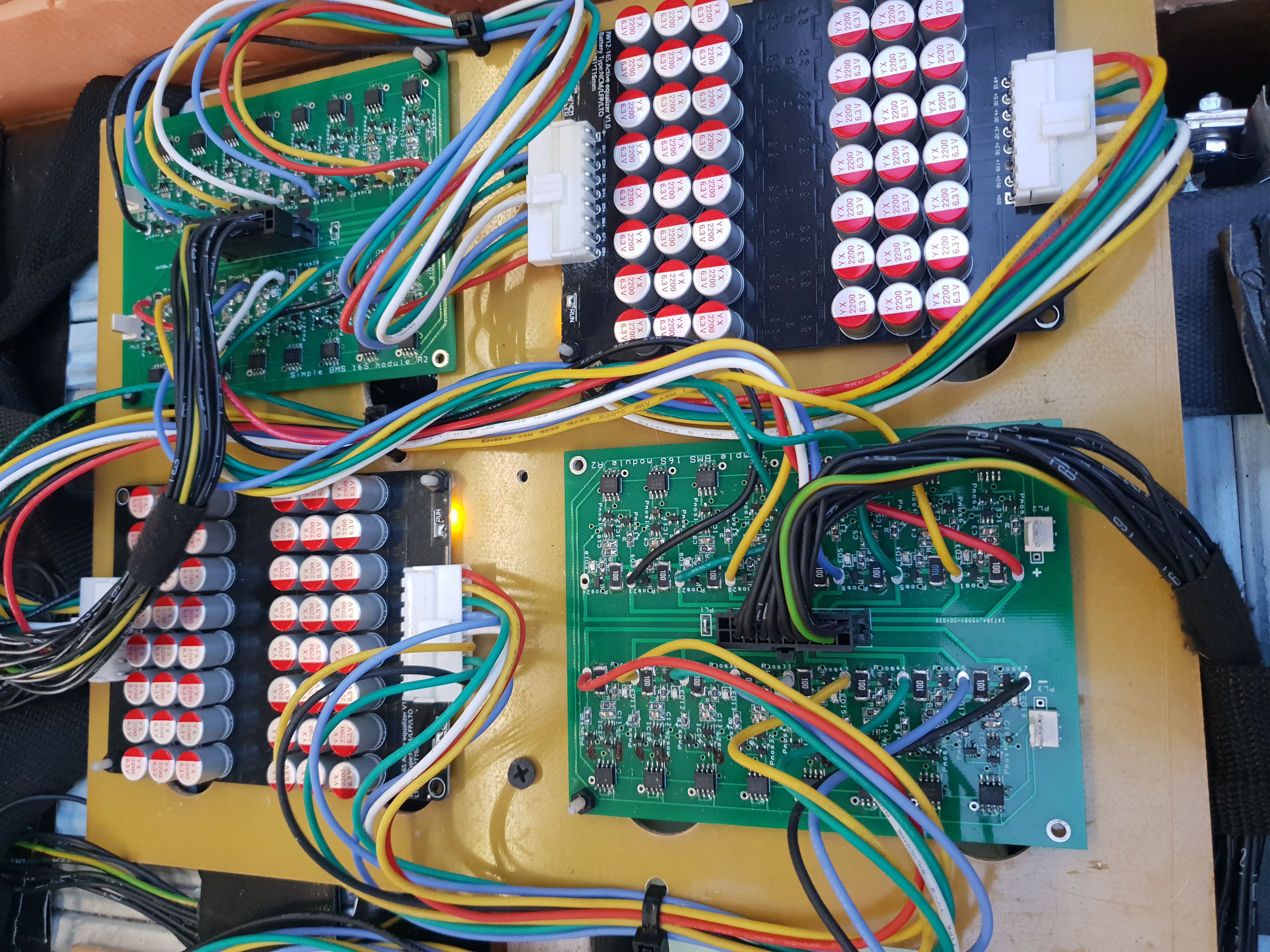

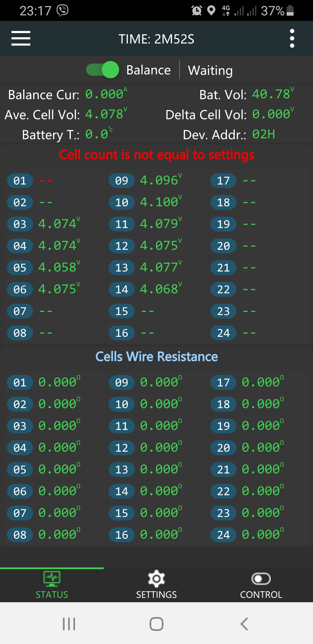

I put this one in my car on one of the more varying cell voltages
After the first test for several hours it seems that it takes charge from adjacent cells to top up the lower cells in 16S module. This slowly depletes the cells of voltage (in the range of 0.01V) but complete module voltage seemed to remain at 61.8V. Current involved that i registered was in the range of 0.8A to 1A. While i left balanser connected overnight it seemed to correct voltage on once cell from 3.85V to 4.01V and there was still 0.2A flowing. It seems this to be a real deal.
EDIT: I will run this in my car for a week and compare to adjacent modules.
It seems modules can be cascaded.

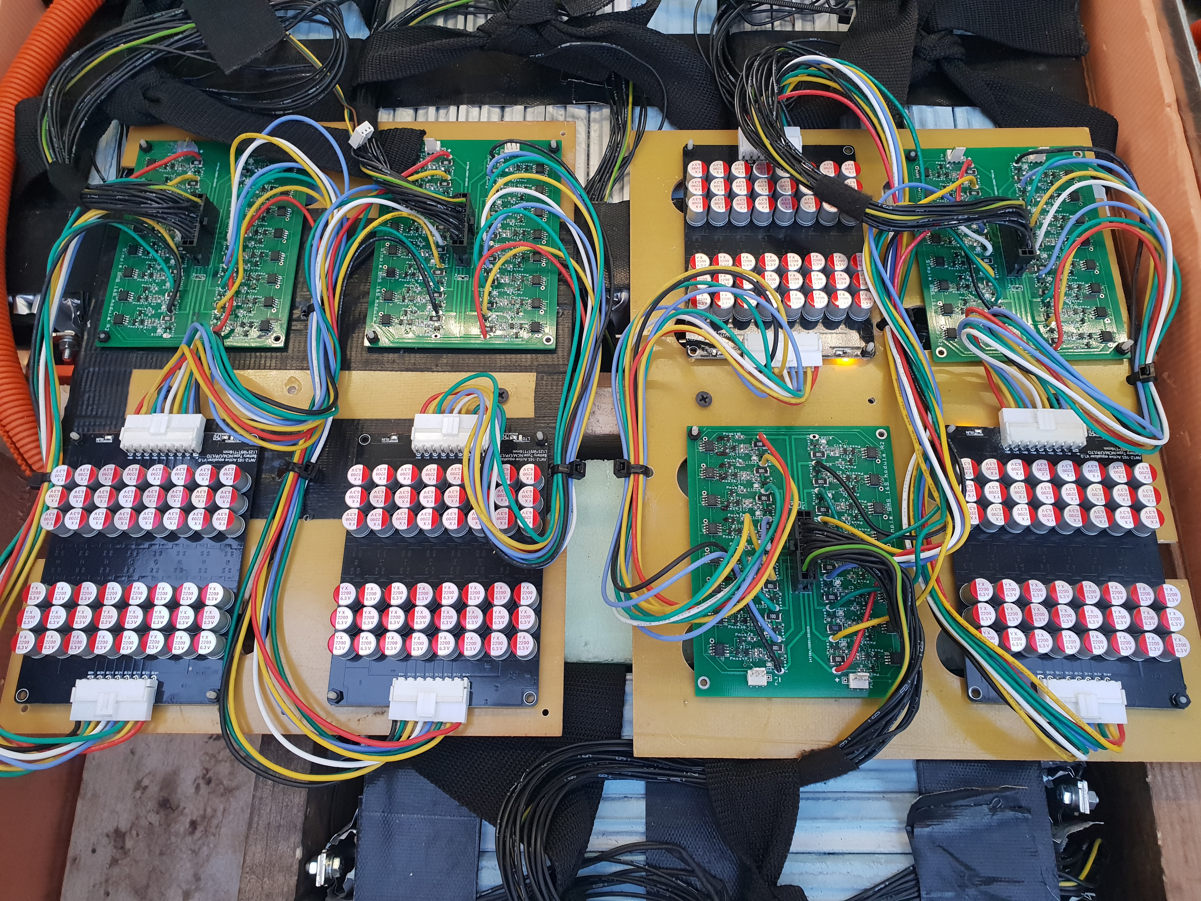

What do you think would happen if you have several of these overlapping?arber333 wrote: ↑Mon Aug 16, 2021 7:18 amI put this one in my car on one of the more varying cell voltages. I will inspect voltages after a few charges and drives.

I was thinking the same thing. putting 6 of these on a 96S pack could be interesting but of course would not balance between those 16 sets. overlapping could solve that. hmmmm

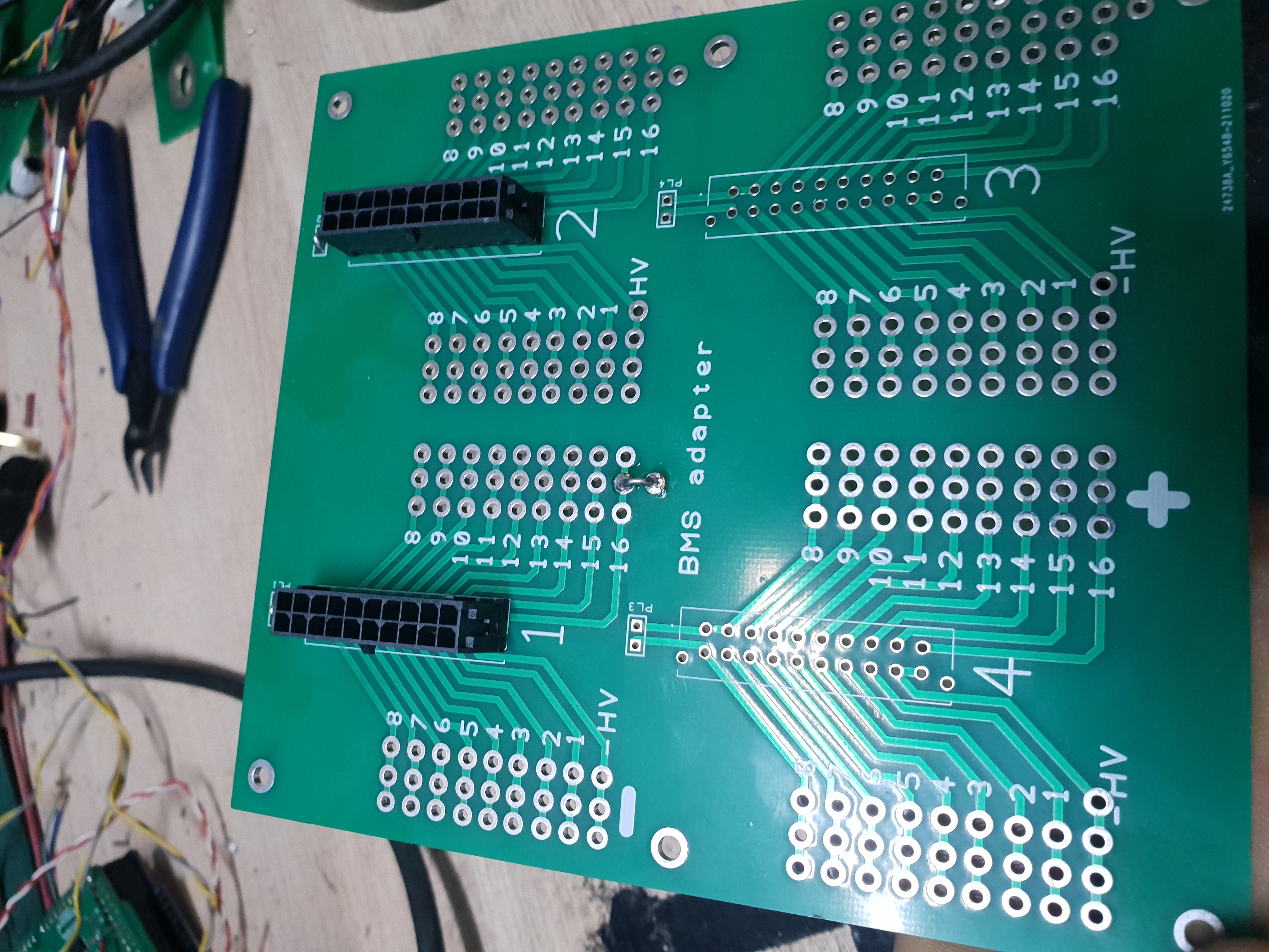

I will probably make my diyBMS without balancing. I intend to make 16S boards to fit over the balanser board. It will hold only the sensoric part and comms. This should then report voltages while driving and regulate charger(s).
I will report later with design...

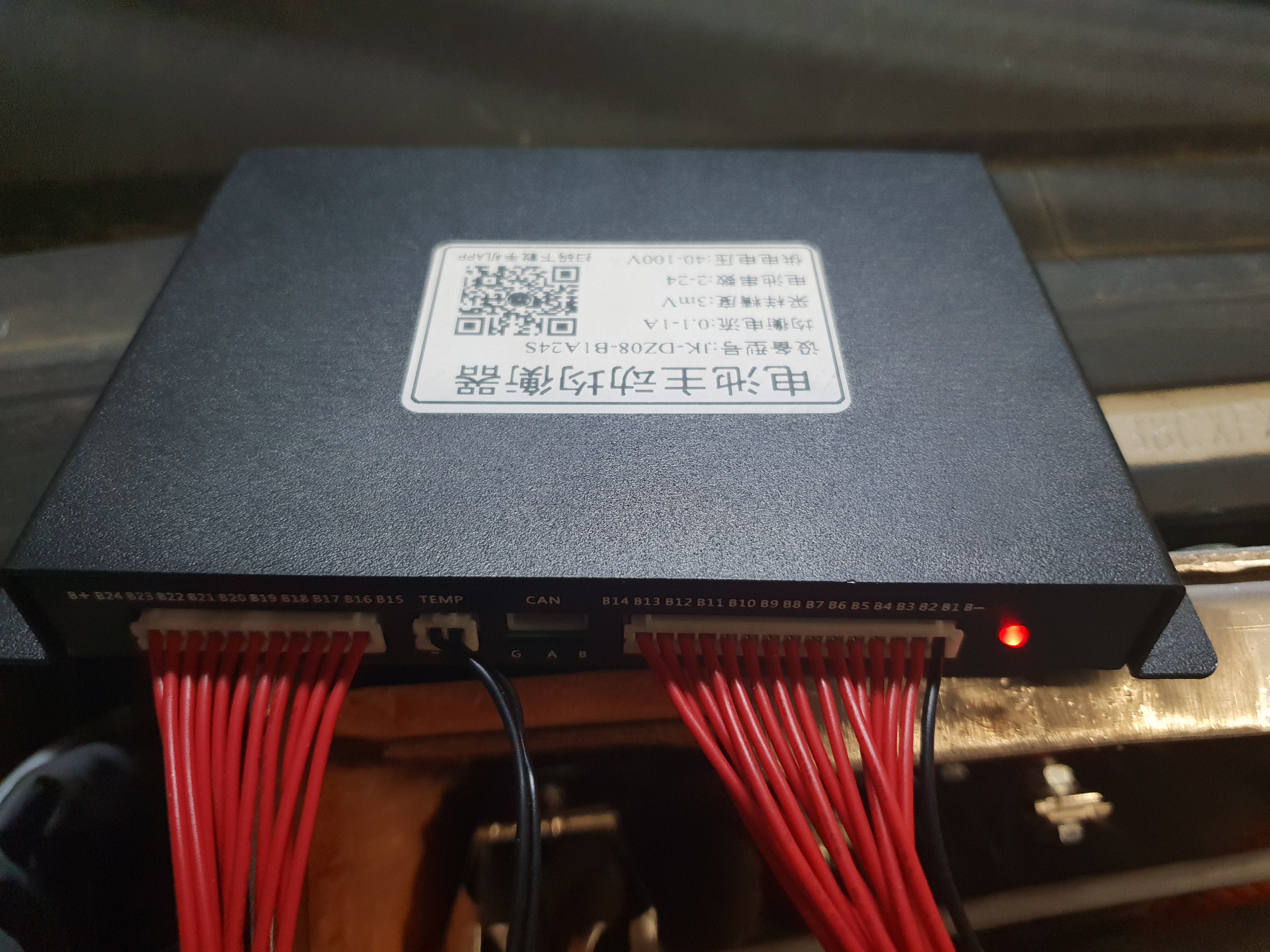

I was in touch with Tony from Vorteks and he said ANT BMS cannot be cascaded or overlapped but mentioned this
https://s.click.aliexpress.com/e/_AkHH2o
It is similar to the capacitive balancer above but with an app and it can be cascaded.

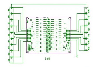

These say they allow "cascading" in the descriptions of those Ali BMSs you showed above, which is daisychaining them to higher series counts.
Even shows pics:
Which makes me wonder...
How difficult would it be to figure out how to daisy chain a power tool BMS?
I.E. I've got hundreds of 5s Dewalt BMS's, I would only need 20 for my build, can they be daisychained? Or is this a "reverse engineer it to find out" kind of answer that's far and above my skillset?
Even shows pics:

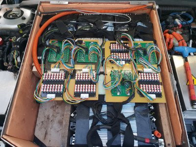

Yes i decided i will not overlap my balansers. Too much spagetti wires. Instead i will top off my modules periodicaly with 63V power supply and balancers will take care of the rest. I dont charge upwards of 4.05V per cell so i will be safe here. In any case i will use my BMS to provide me with cell voltages. I also think of designing CAN bus into master unit so it will provide Chademo controler with temp and voltage signal.Alibro wrote: ↑Tue Aug 17, 2021 7:59 am This is part of the email I got from Tony
"Yes, you can wire the ANT BMS in series as long as they're kept completely isolated from each other. If you overlap them, you're going to end with fire. The downside is, you might have 24 cells at one voltage and another 24 at another voltage etc"

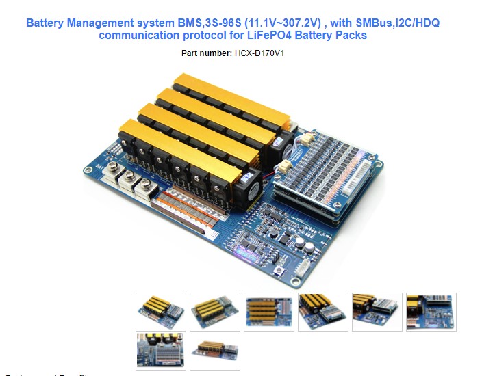

I keep coming back to one of these options. That is if my Leaf BMS doesn't work out.
https://www.aliexpress.com/item/1005001 ... w668o&mp=1
http://www.bestechpower.com/communicati ... 170V1.html

I emailed bestech and they claimed that 80s is too big for their BMS systems. So that rules them out from most car applications.

I emailed them to confirm this. They said that BMS is obsolete. Shame since it looked pretty good.
