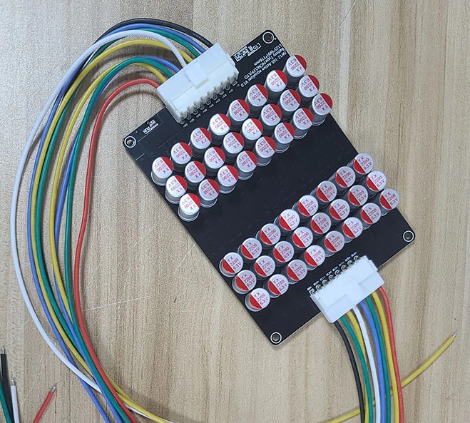

I have found this active balansing BMS
I think i will buy capacitive version for 8S just to see how they work.
https://www.aliexpress.com/item/1005002 ... 0031639067
Then there is inductive Active BMS too.
https://www.aliexpress.com/item/1005002 ... 0006025309

You are missing my point. I will add one 8S board to my DIY BMS (16S) which keeps track of single cell voltage. I will then leave it inside and observe difference. Should be like fire and forget add on...
Posts: 3795
Been thanked: 411 times
Re: Cheap(ish) BMS from Aliexpress
arber333 wrote: Wed Jul 14, 2021 3:06 pm I have found this active balansing BMS

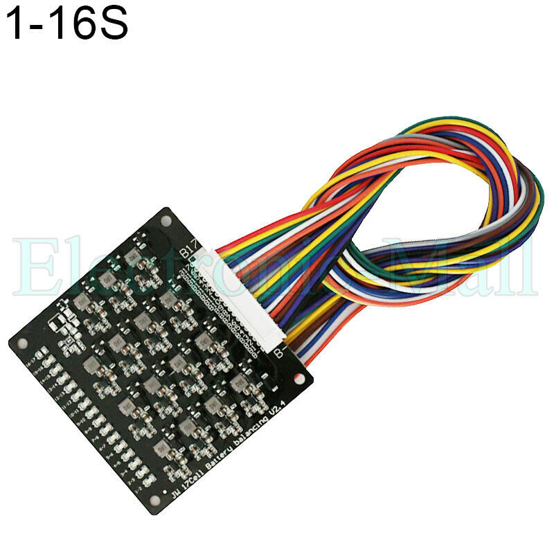

Ok, i ordered one 16S board of latter inductive BMS board. It is supposed to balance with 1.2A. I choose inductive type over capacitive type because it takes less space. But i am also willing to test the larger capacitor variant. That should balance at 5A which is a lot!
I think 16S is best for me. At least i have some cells to draw my average from. If this is successful i will order 6 boards and complement them to my BMS board.

I put this one in my car on one of the more varying cell voltages :). I will inspect voltages after a few charges and drives.
After the first test for several hours it seems that it takes charge from adjacent cells to top up the lower cells in 16S module. This slowly depletes the cells of voltage (in the range of 0.01V) but complete module voltage seemed to remain at 61.8V. Current involved that i registered was in the range of 0.8A to 1A. While i left balanser connected overnight it seemed to correct voltage on once cell from 3.85V to 4.01V and there was still 0.2A flowing. It seems this to be a real deal.
EDIT: I will run this in my car for a week and compare to adjacent modules.
It seems modules can be cascaded.
What do you think would happen if you have several of these overlapping?

I was thinking the same thing. putting 6 of these on a 96S pack could be interesting but of course would not balance between those 16 sets. overlapping could solve that. hmmmm

These say they allow "cascading" in the descriptions of those Ali BMSs you showed above, which is daisychaining them to higher series counts.
Even shows pics:
Which makes me wonder...
How difficult would it be to figure out how to daisy chain a power tool BMS?
I.E. I've got hundreds of 5s Dewalt BMS's, I would only need 20 for my build, can they be daisychained? Or is this a "reverse engineer it to find out" kind of answer that's far and above my skillset?
