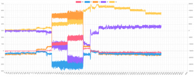

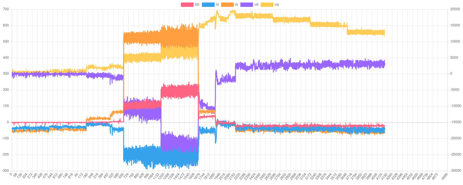

Anyway, I did a test drive and plotted BMS measured idc and inverter calculated idc. Turns out at low throttle they are not too far apart. Which makes sense because at low throttle MTPA avoid reluctance torque and feeds mostly iq to the motor.
But then at full throttle I saw 350A on the BMS and just 100A on inverter.

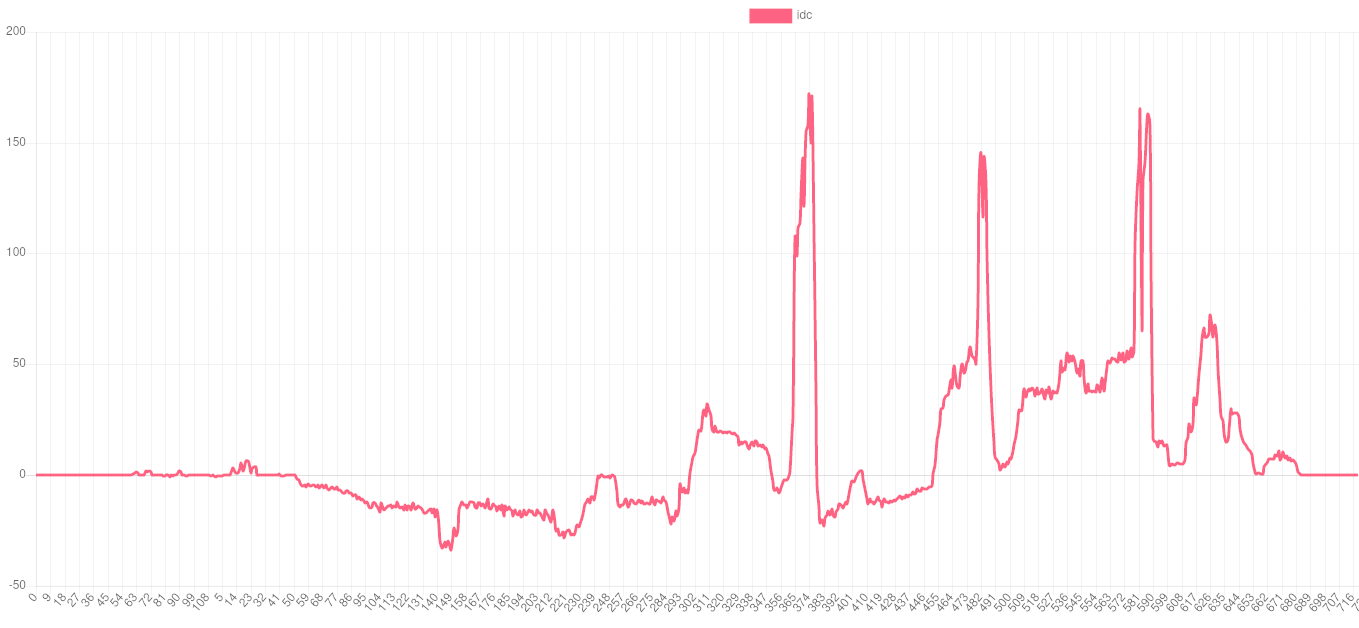

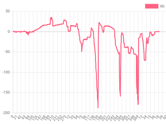

Now I applied the formular as suggested:
idc = (iq * uq + id * ud) / FOC::GetMaximumModulationIndex();
idc = FP_MUL(idc, FP_FROMFLT(0.81649658092772603273));
And the result is indeed much better :) Observe polarity is swapped. Inverter regards regen as negative and BMS regards regen as positive.

So turns out this needed a bit more tweaking, reason being quite noisy current measurements:
Now just added some heavy filtering to idc which removes stuttering when the limiter steps into action.
Not so happy about this much noise in general but it doesn't seem to have practical implications.
