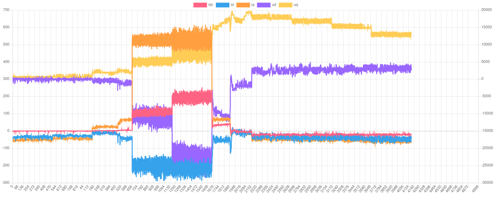

Anyway, I did a test drive and plotted BMS measured idc and inverter calculated idc. Turns out at low throttle they are not too far apart. Which makes sense because at low throttle MTPA avoid reluctance torque and feeds mostly iq to the motor.
But then at full throttle I saw 350A on the BMS and just 100A on inverter.
Now I applied the formular as suggested:
idc = (iq * uq + id * ud) / FOC::GetMaximumModulationIndex();
idc = FP_MUL(idc, FP_FROMFLT(0.81649658092772603273));
And the result is indeed much better :) Observe polarity is swapped. Inverter regards regen as negative and BMS regards regen as positive.
Maybe add a 1.05% factor for estimated inverter efficiency and we should be pretty good.
