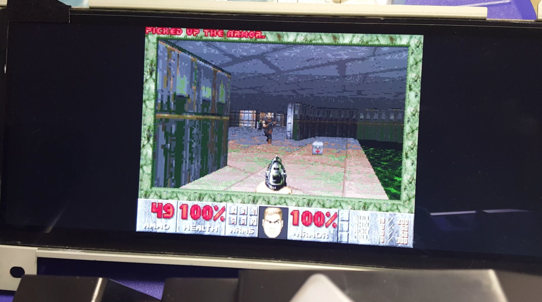

wk057 successfully ran Doom on the Tesla IC (Likely by X11)

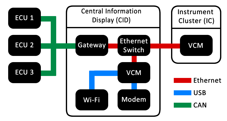

Weirdly I'm getting mixed answers regarding the IC CAN lines. Half say the IC has a CAN transceiver, the other half say it's only there to send the signals over ethernet to the CID. I'm hoping you know better.

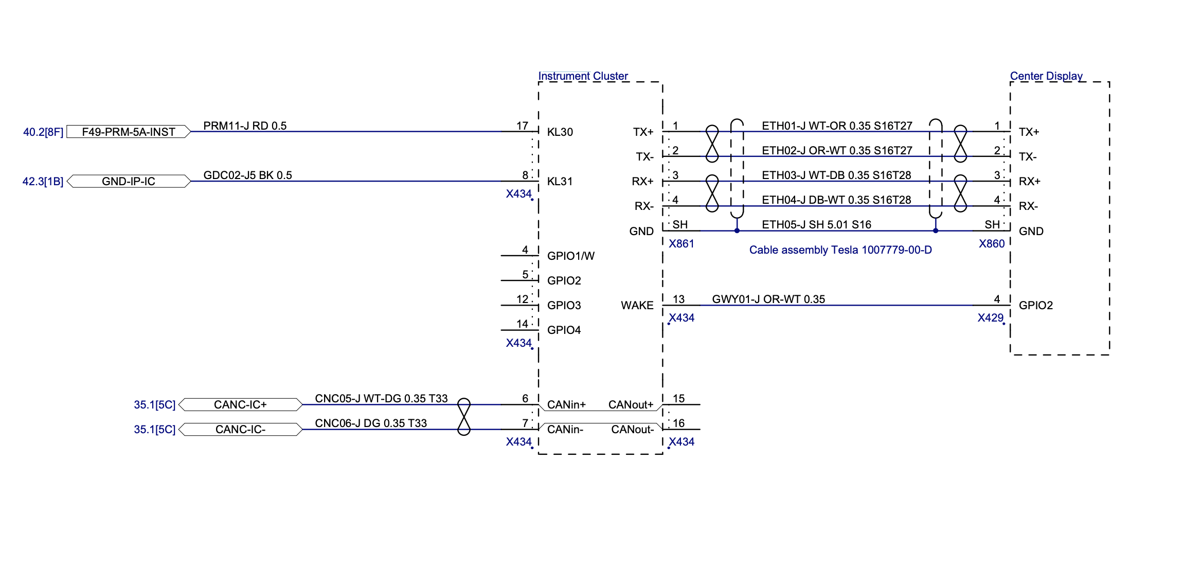

Pen Test Partners detail the comm connections as ethernet only to the ID. Still not sure why there are CAN pins on the Tesla wiring diagram though. I'll crack it open and figure out where they lead.

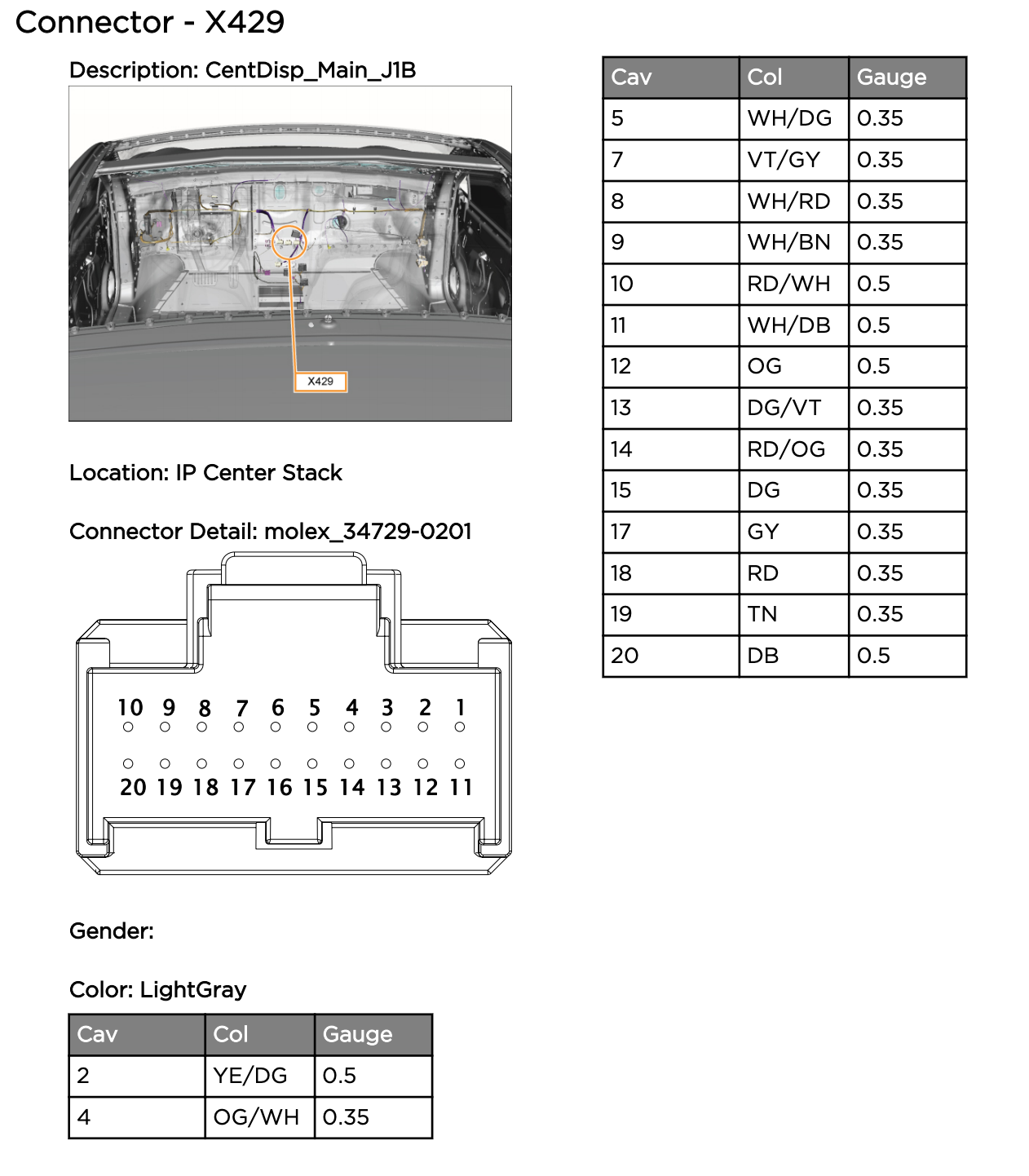

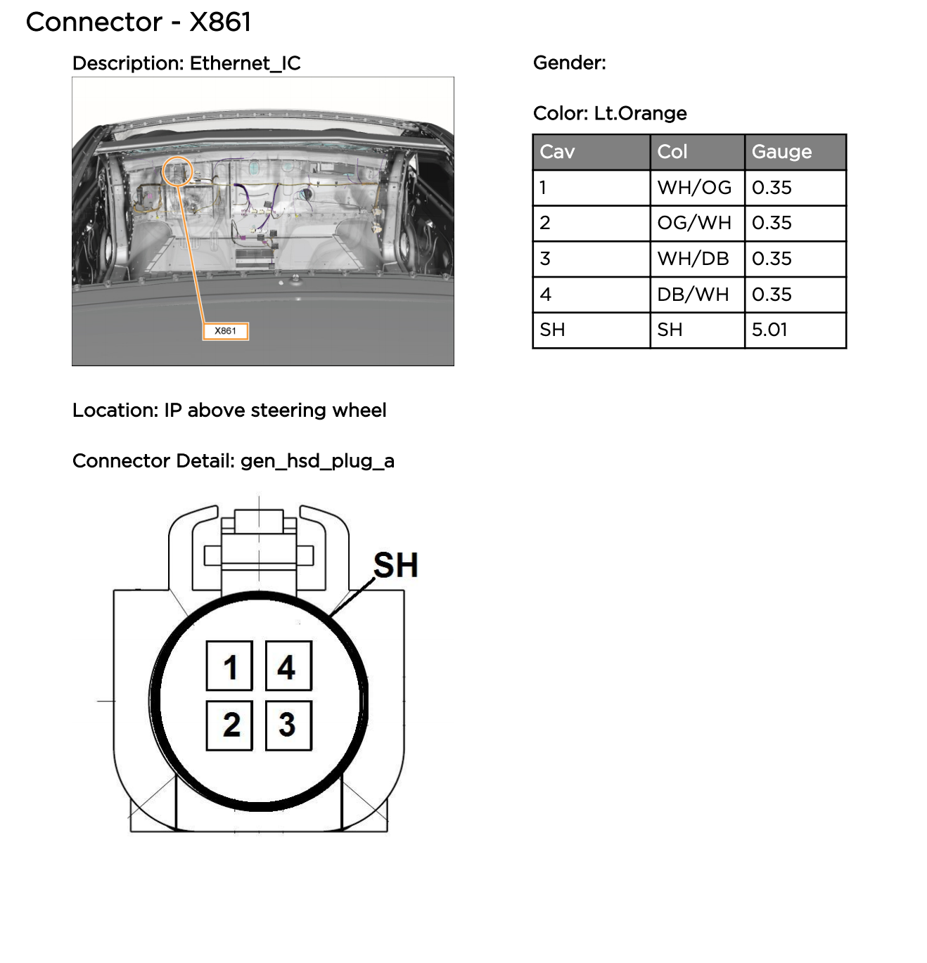

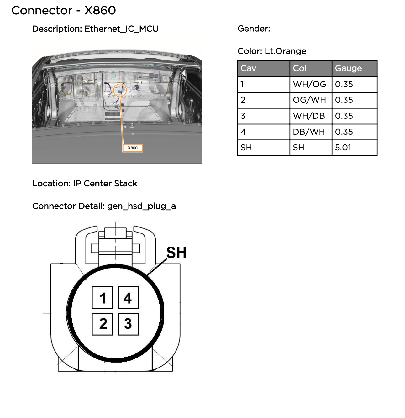

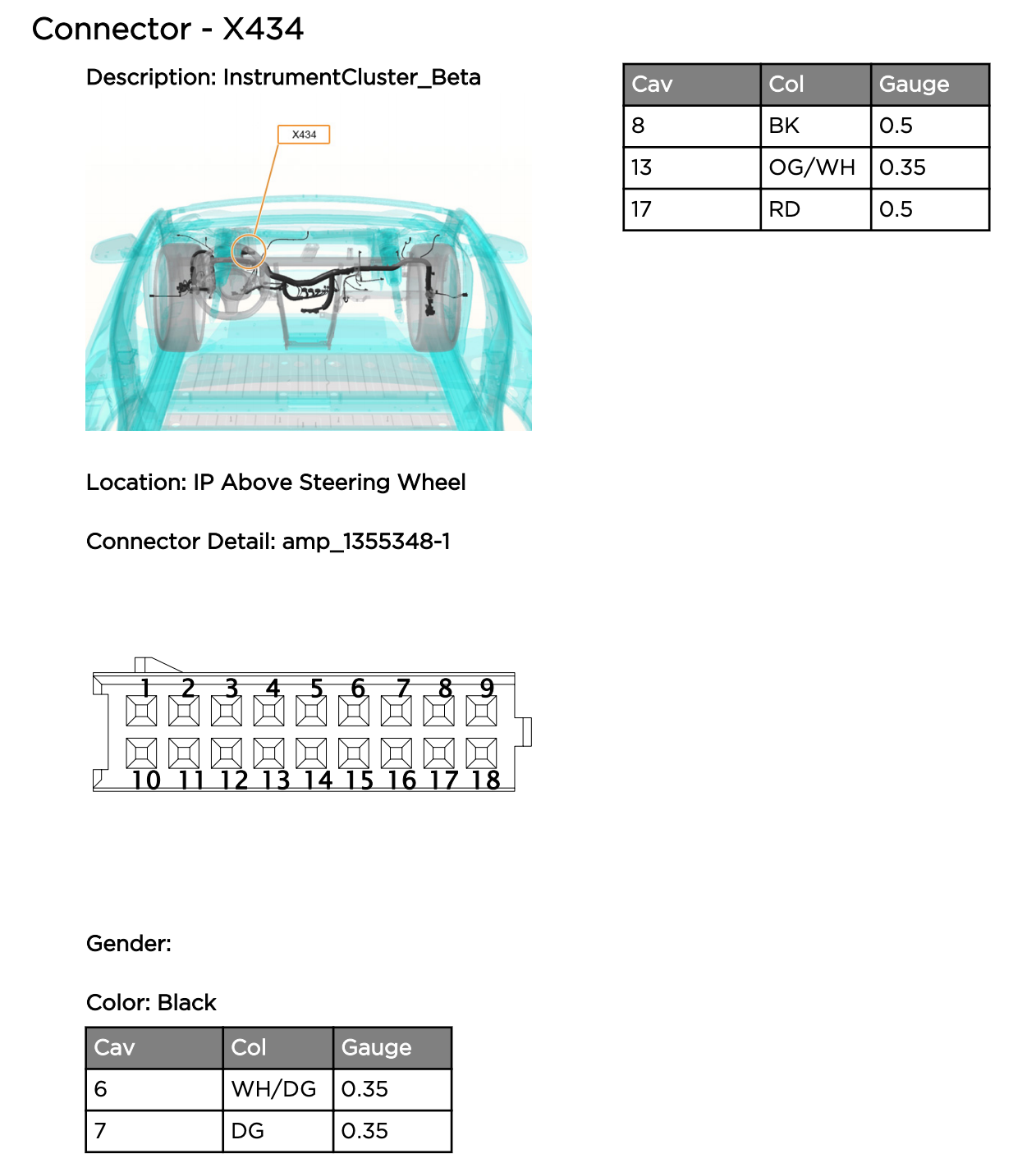

Re: Tesla Instrument Cluster (IC) Center Display (CID/MCU) Retrofit
MCU1: Nvidia Tegra : Model S and Model X before March 2018
MCU2: Intel Atom E8000 : S/X after March 2018, all Model 3

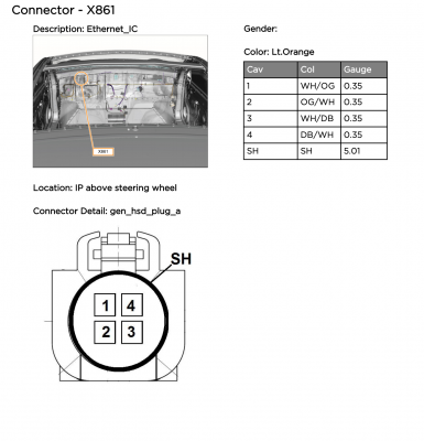

Connectors:
(X861 - X860) Fakra HSD Ethernet IC to CID:Amphenol 095FPZFJZSG-012
(X434) 18pin IC: AMP 1355348-1
(X434) 18pin IC shield: AMP 1-1355350-1
(X434) Crimp pins: AMP 928999-1
(X429) GPIO/CAN CID: Molex 34729-0201
(X429) Crimp pins: Molex 0348033212

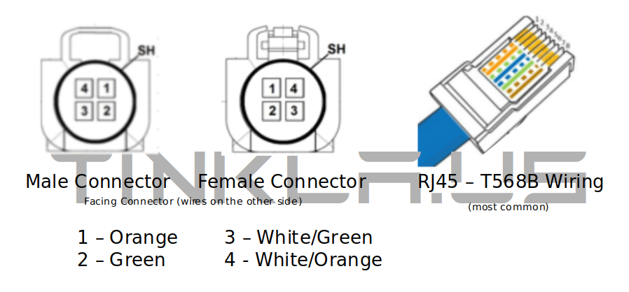

Would be easy enough to cut a Fakra cable in half and crimp the RJ45 on for debugging.
Fakra HSD to RJ45: Pre-made Cable

The answer is still the same basically. Both the IC and CID are linux computers. They use TEGRA processors which are ARM. So, you run linux ARM executables on them. Once you get to the point that you can log into the things and obtain root you can use them just like any other computer with a touch screen. The CID has a CAN gateway on it that can send CAN frames for you (it's connected to the rest of the system via ethernet so you send commands to it over IP).
