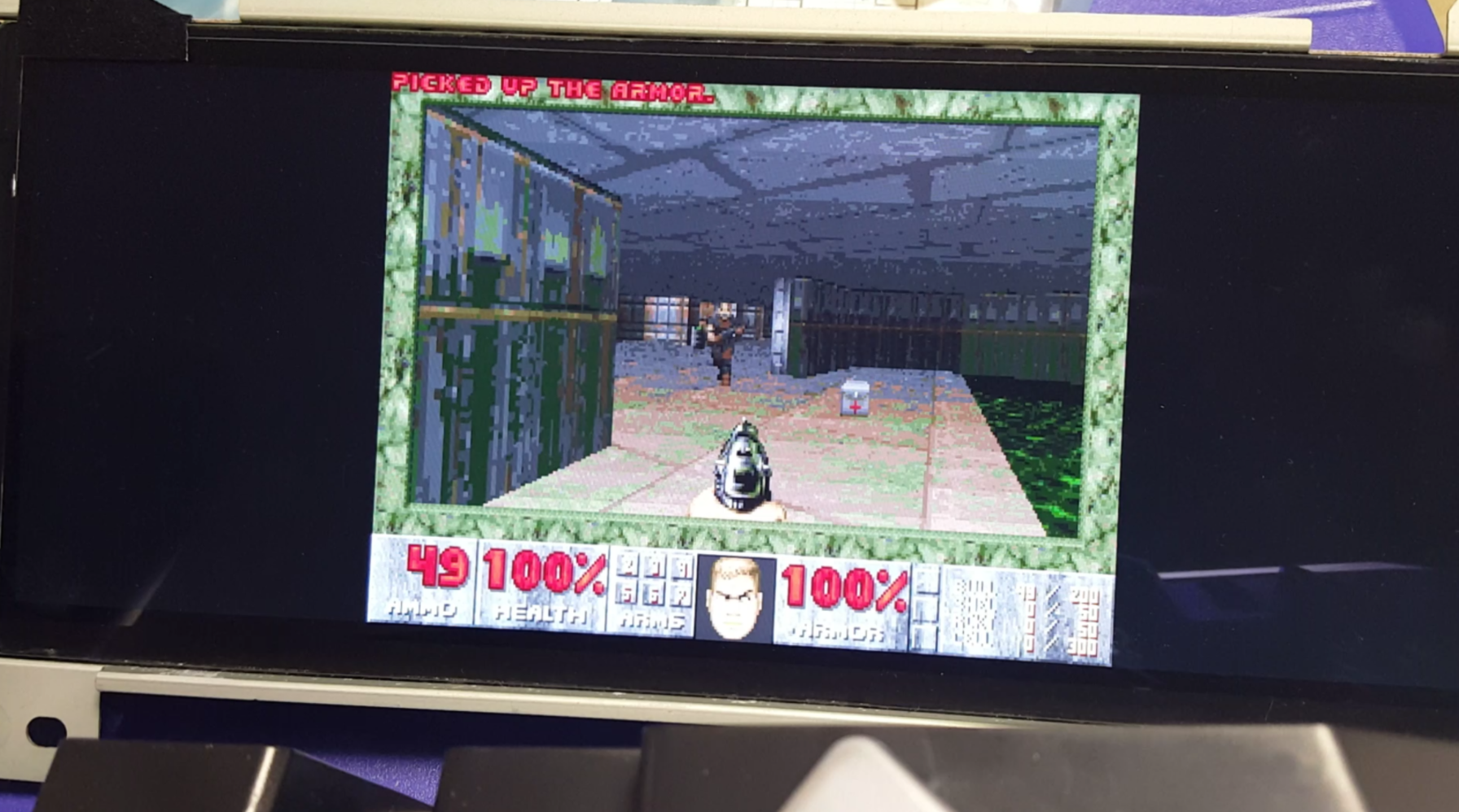

wk057 successfully ran Doom on the Tesla IC (Likely by X11)

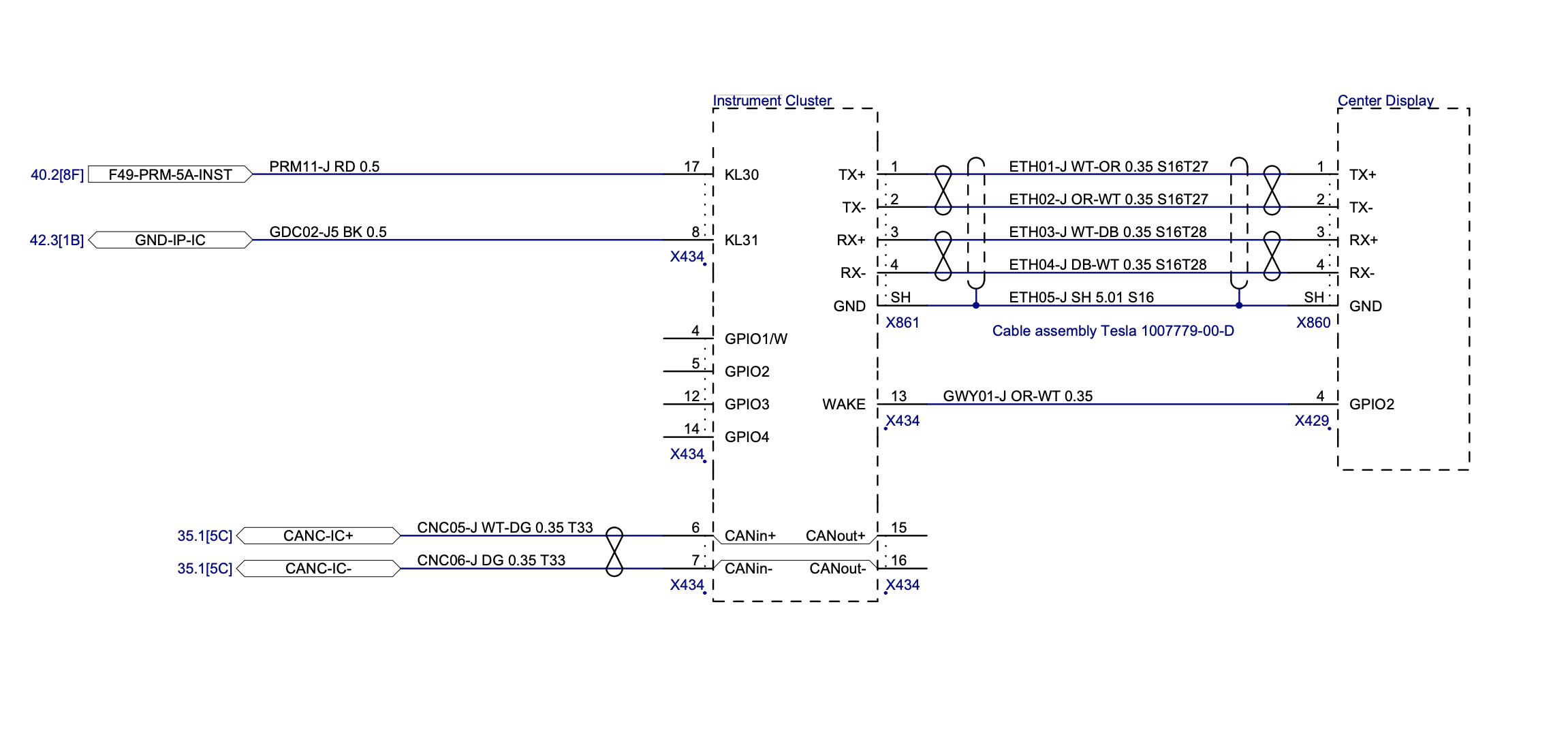

Weirdly I'm getting mixed answers regarding the IC CAN lines. Half say the IC has a CAN transceiver, the other half say it's only there to send the signals over ethernet to the CID. I'm hoping you know better.

Pen Test Partners detail the comm connections as ethernet only to the ID. Still not sure why there are CAN pins on the Tesla wiring diagram though. I'll crack it open and figure out where they lead.

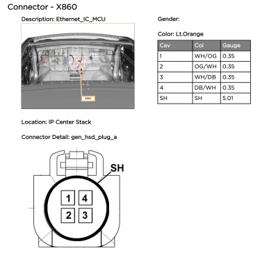

(X861 - X860) Fakra HSD Ethernet IC to CID:Amphenol 095FPZFJZSG-012

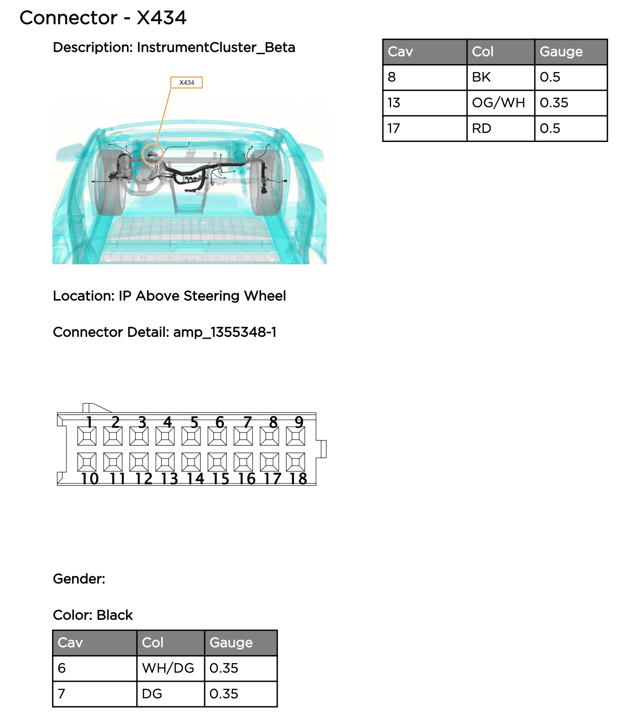

(X434) 18pin IC: AMP 1355348-1
(X434) 18pin IC shield: AMP 1-1355350-1
(X434) Crimp pins: AMP 928999-1

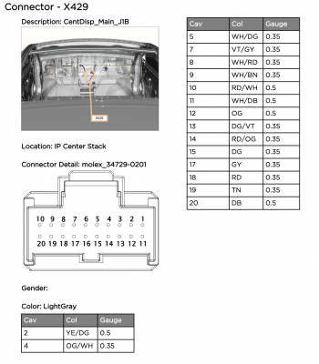

(X429) GPIO/CAN CID: Molex 34729-0201
(X429) Crimp pins: Molex 0348033212

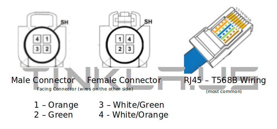

Would be easy enough to cut a Fakra cable in half and crimp the RJ45 on for debugging.
Fakra HSD to RJ45: Pre-made Cable
