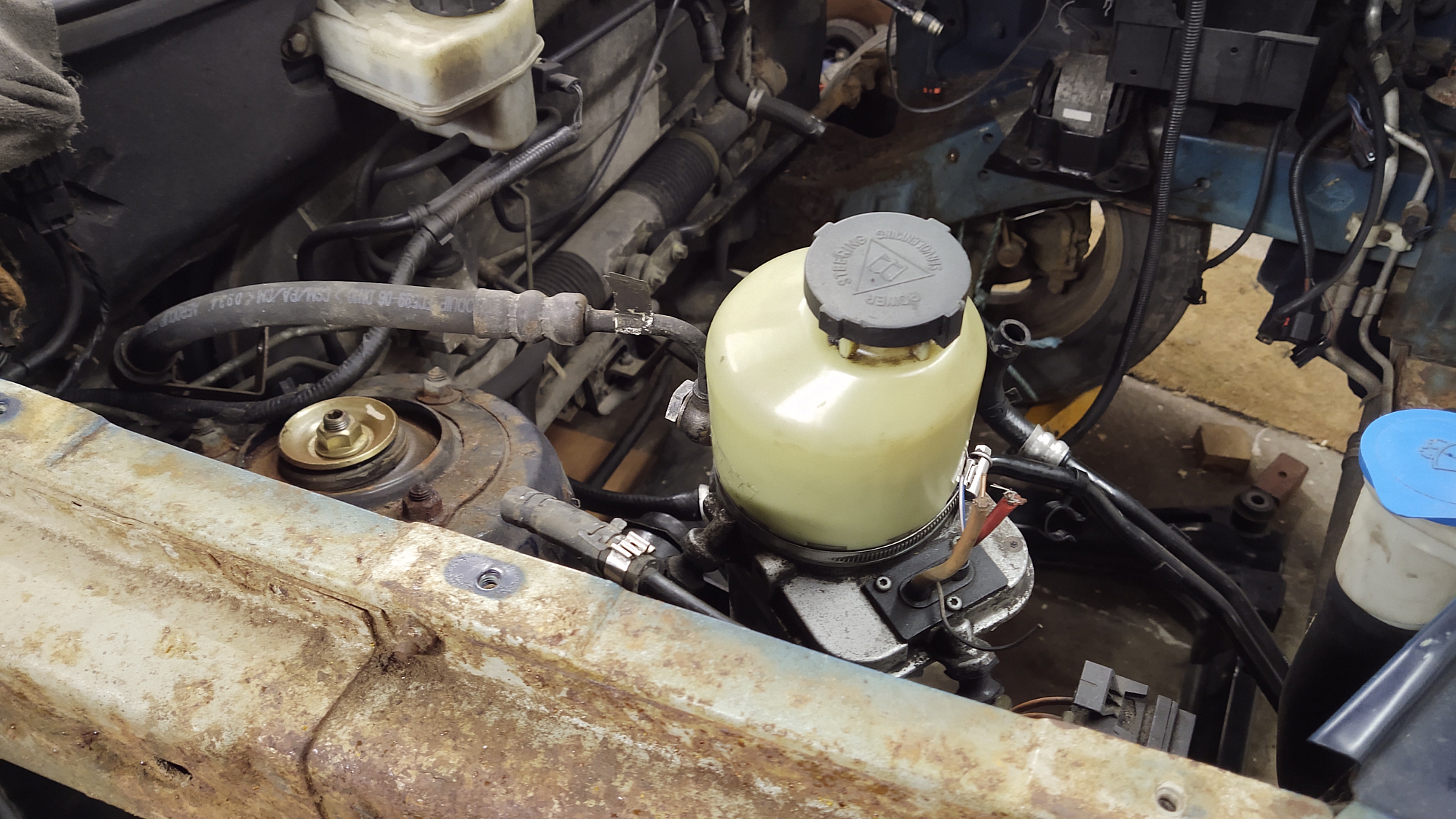

Hi guys
I bought a Zafira power steering pump a few months ago and finally got round to connecting it up last night.
It works but I was a bit surprised at how loud it is and how much current it draws, at idle it was drawing over 20A and when turning the steering it was over 40A.
Is this normal? Judging by the size of the conductors I guess the current draw is normal as they must be 5mm or 6mm sq
Do other folk have it operating only when moving slowly?
I could live with the noise but 200W to 300W for power steering alone seems a lot.

Hm... Mine is from Opel Astra G and it draws about 8A on idle.
Yes when full tilt it draws more than 60A! So i use 80A fuse on its line.
Maybe you need to check your steering rack. Maybe its pathways are cloged or something. Pump actually reacts to pressure drop and tries to follow so if yours draws 20A you must have something in the lines that is obstructing fluid flow...

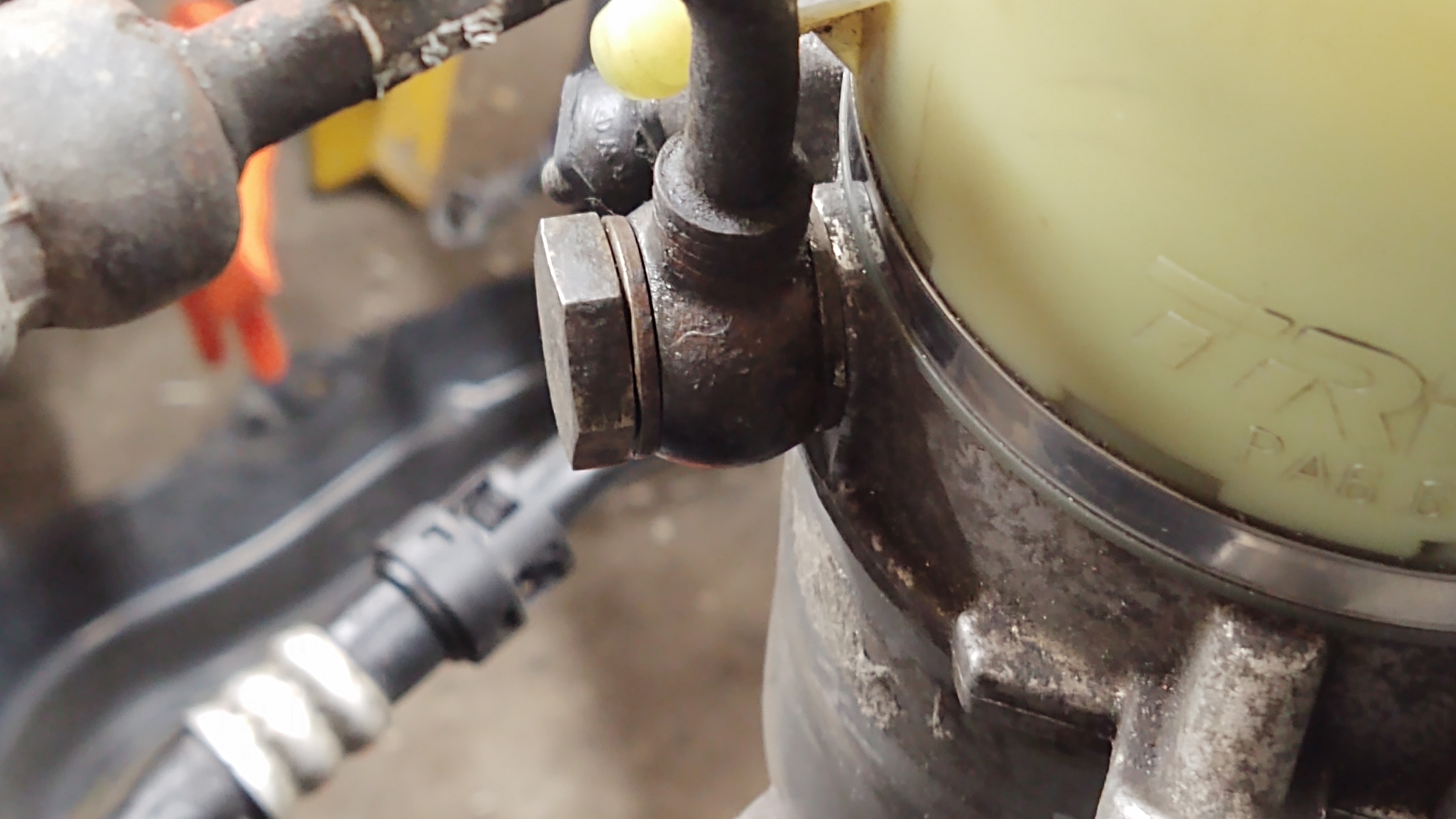

Maybe its the way I have connected it.
The original power steering pump had a banjo bolt connection and for testing I just flattened the area around the case of the pump where the old hose bolted in and bolted the banjo connector to the casing. It works but maybe isn't ideal. I'll get a new hose made up at a local hydraulics shop with the correct connector and see how it goes.

Re: Zafire Power Steering Pump
Actually, I think, the pump gets louder and uses more amps when fluid starts moving. A power steering rack should block fluid movement when there's no torque applied to the steering wheel. Then the pump only needs to maintain pressure without flow, which consumes less power.
I agree it's loud and uses lots of current, but there should be a huge difference in the sound and current in idle vs. when turning. As there isn't, the rack could be bad.
Alternatively, maybe the rack might have an overpressure valve that causes flow at the pressure the pump wants to maintain?
Is it possible the rack just isn't bled properly? I've never had to bleed a rack before but I thought it just needed turning lock to lock a few times.
I'm still hearing some gurgling though so will give it another try.
It's 28 A idle in the video, and while it's hard to tell, I guess the idle sound is louder and sharper than it should be. When it's providing steering assist it sounds roughly right.
Can you somehow plug the output and then check whether you get less amperage and noise? This would get your steering rack out of the equation. Keep in mind that it's a lot of hydraulic pressure so be careful. Make sure to bleed the plug.
What fluid are you using? I think I'm using Mobil ATF 220 or something like that in mine and it has worked fine for years.
As the pump builds up speed it sounds pretty loud at 8A but is much much louder at 28.celeron55 wrote: ↑Wed Dec 30, 2020 8:56 pm It's 28 A idle in the video, and while it's hard to tell, I guess the idle sound is louder and sharper than it should be. When it's providing steering assist it sounds roughly right.
I could give that a try I guess, It should be easy enough to block the output.
I'm using Dexron 3 which I was told was correct for the Rack in the Freelander.
I would go as far as to guess the pump is bad though. Luckily it's not very expensive to get another one to test with.

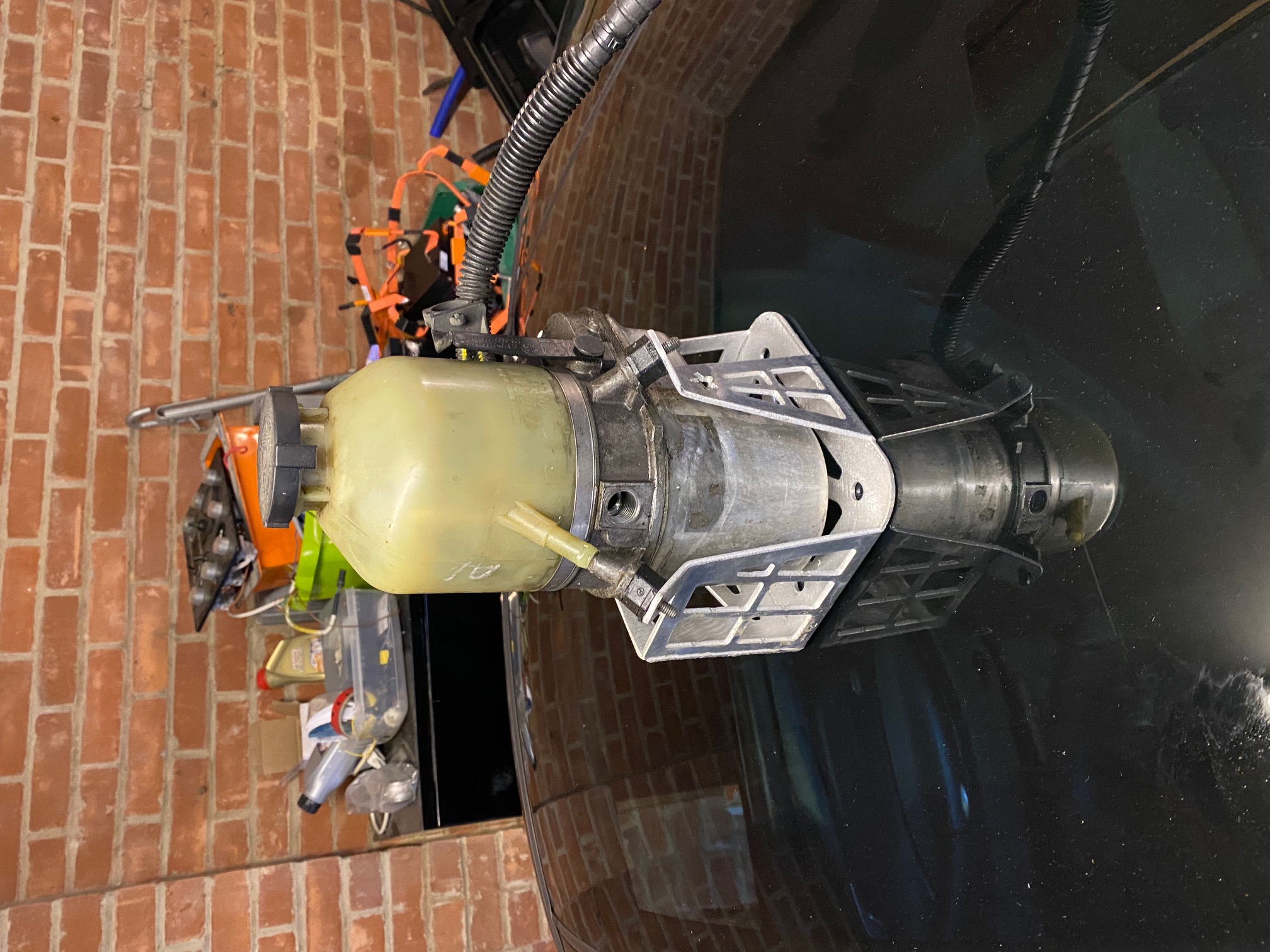

Little thread hijack, but I recently had this frame made, giving flexibility to mount the pump on a vertical or horizontal surface. Shouldn't be too hard to reproduce, so If anyone needs one I can get prices to make a few more.

Not a thread hijack at all mate. Bang on topic I would say.Boxster EV wrote: ↑Thu Dec 31, 2020 6:39 pm Little thread hijack, but I recently had this frame made, giving flexibility to mount the pump on a vertical or horizontal surface. Shouldn't be too hard to reproduce, so If anyone needs one I can get prices to make a few more.
So have you connected yours up yet and if so what current is it drawing?
I haven't connected it up because I cant bear the noise.Alibro wrote: ↑Thu Dec 31, 2020 6:54 pmNot a thread hijack at all mate. Bang on topic I would say.Boxster EV wrote: ↑Thu Dec 31, 2020 6:39 pm Little thread hijack, but I recently had this frame made, giving flexibility to mount the pump on a vertical or horizontal surface. Shouldn't be too hard to reproduce, so If anyone needs one I can get prices to make a few more.
image0 (3).jpeg![]()
I'm thinking about mounting it in a sound proof box.

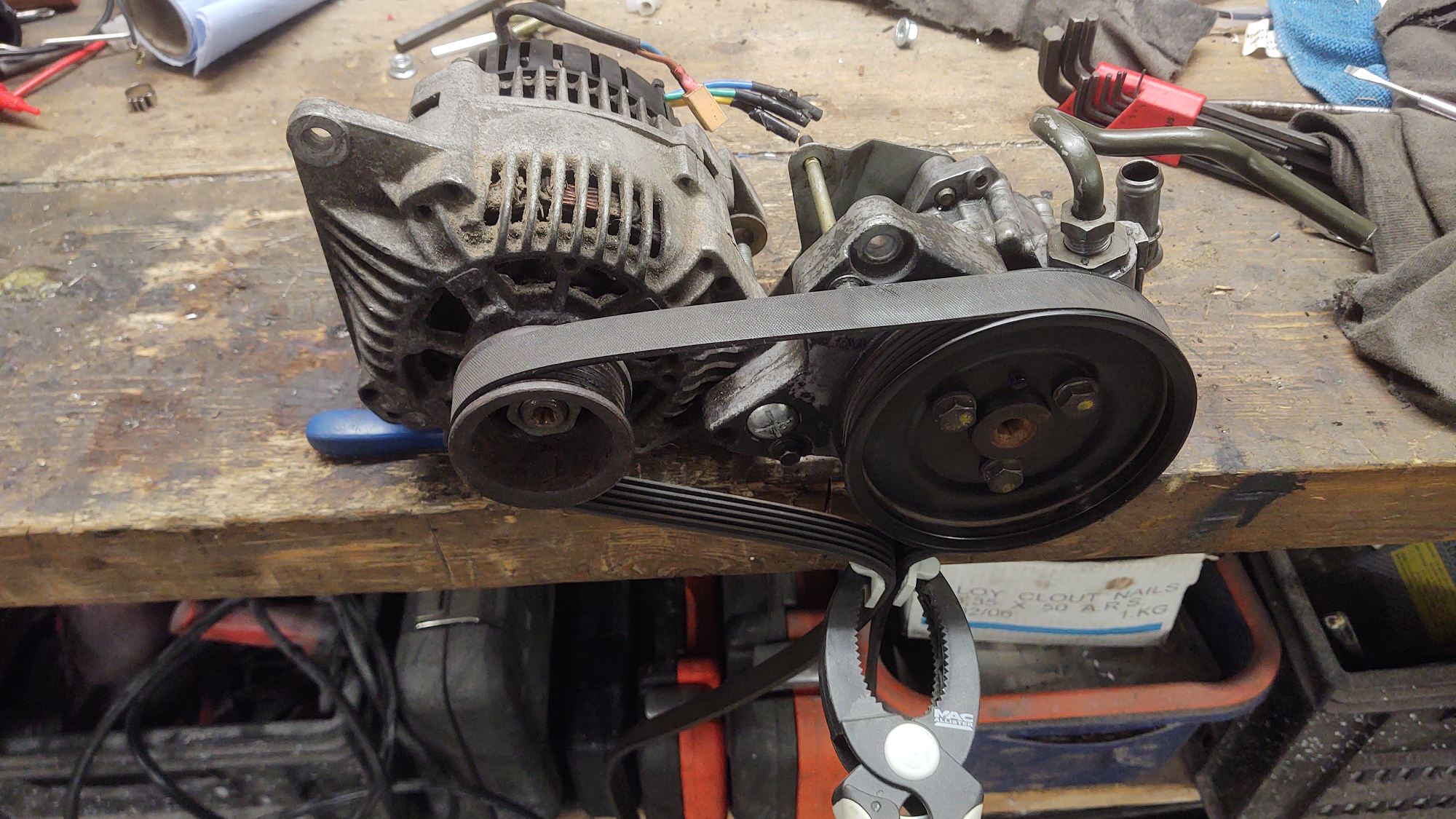

No mate. I didn't try that but for now I've given up on this pump.
I've removed the Freelander power steering pump and am rigging it up with an alternator motor (I built an ebike with it a couple of years ago
